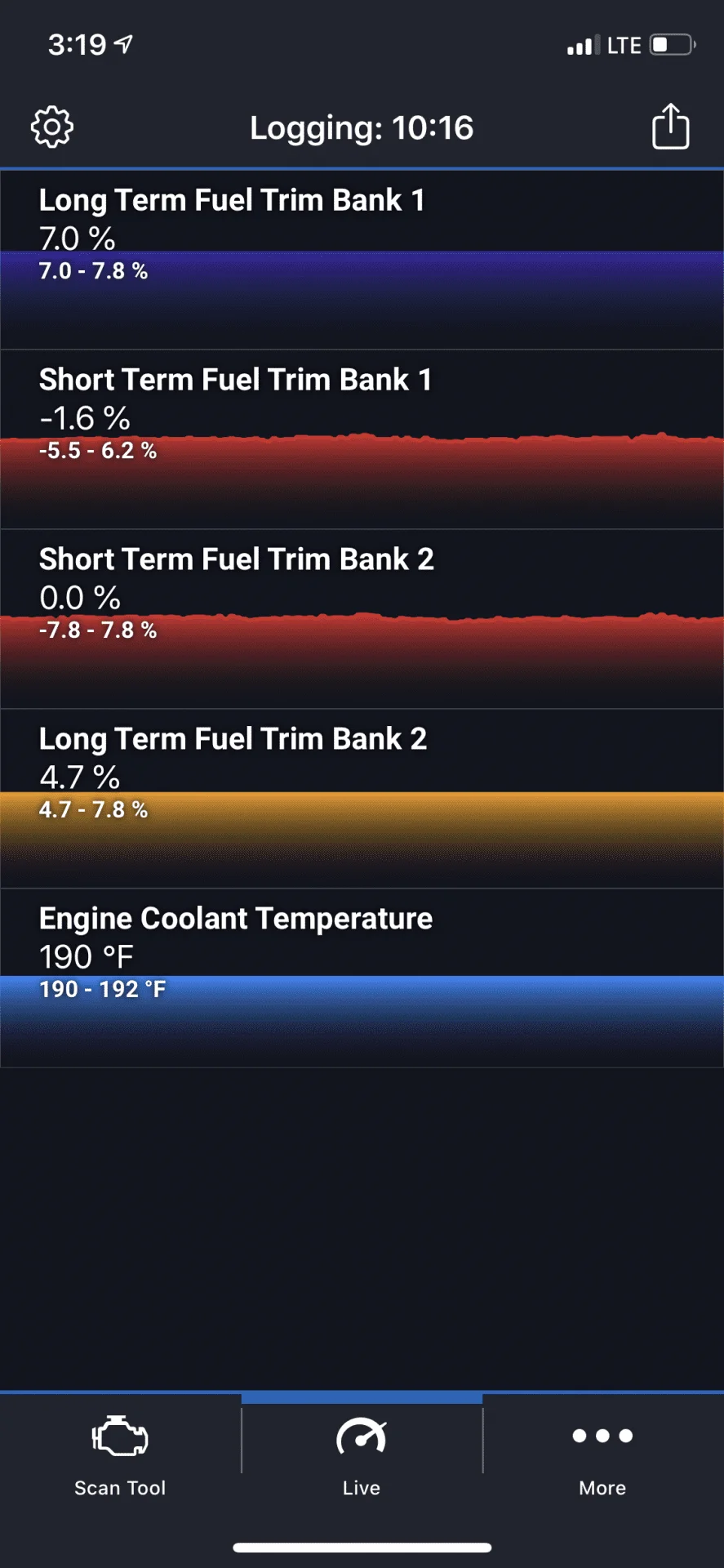

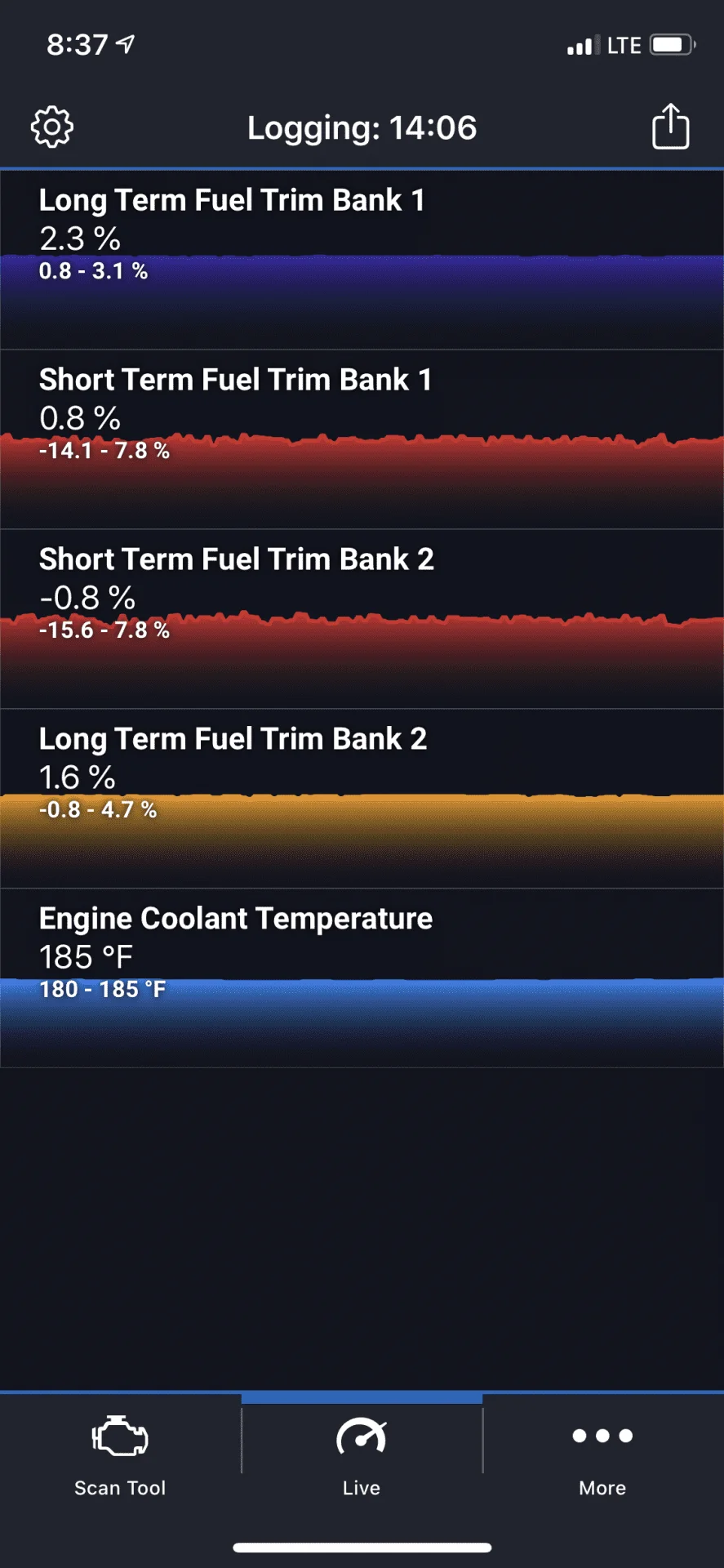

Thorough cleaning of radiator fins and now much better:
I had him bring it back over. I need to take a better look at radiator. What I found, was coolant/engine temp was still going up. So pulled #1 skid plate and really clean the radiator. In fact, it was the worst/dirtiest I'd seen. I must have gotten a shove full or more, of bugs, cotton, grass, gunk, etc out of fins
Notice how bank 1 long term fuel trim is 7%. That is a bit high. Long term indicates what the ECU is doing to adjust for short term. So this indicates, bank 1 running lean (HOT). Fuel line run along side Bank 1 CAT.. :hmm:
Just idling before fully cleaning radiator fins (after lite cleaning, no AC), after tune and coolant flush with new thermostat & Cap. Also used BG flush/cool kit.:
After fully cleaning radiator (hours). Notice how temps and fuel trims improved.
I added a can of 44K to fuel tank, the night before my test drive. After which I kicked-up Fuel injectors to max fuel ~24.8% (my new trick), through tech stream. Than idling a few minutes and shutting down, soaking overnight with this rich mixture of 44K now in the fuel system and combustion cambers.
Now I took on 6 hour test drive, into mountains and city streets.
Engine coolant temp stayed between 184 & 189 most of the drive, OAT 75F to 95F. The one exception was after near 6 hours of driving, I ended up in stop and go traffic in the city, with OAT 95F. Here I saw temps up a little higher. Throughout the day, I stop and remove gas cap periodicity, hiss was normal, with exception of end of day. At which time I heard the hiss for a few seconds. No fuel smells at any time!

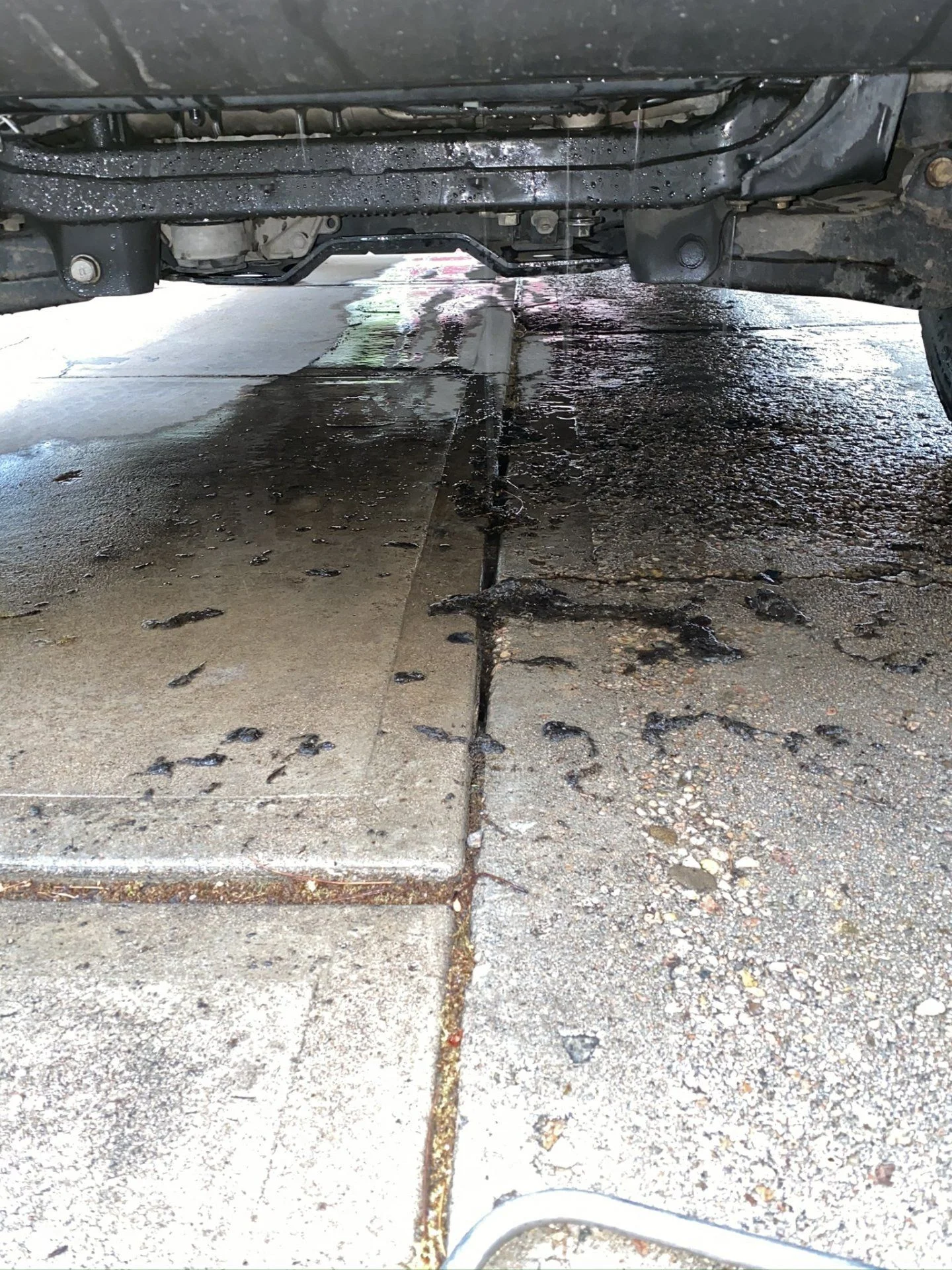

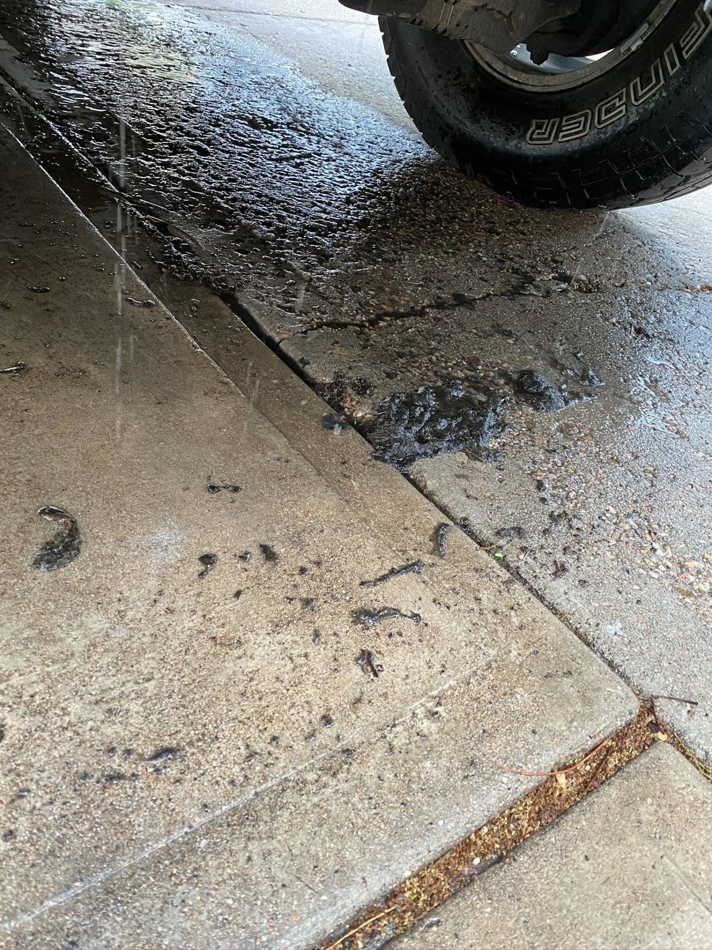

Gunk from fuel boiling, over pressuring fuel tank and EVAP:
Cut off valve: I've never look at one, until I saw picture just a few days ago. It made me wonder about gunk causing it to stick.
I say gunk, because I noticed something on this 99's gas tank skid plate. That it was kind of gunky, rather than painted metal or rust. Kind of oily looking. Then I recalled the Unicorn , which had a very badly overheated engine, it blew the head gaskets and cooked the engine. I believe the Unicorn had and overheating issue, due to low coolant from improper burping of coolant system. That issue went on for 20K miles (~1 yr) and kill the engine for good. It also had a palatially clogged radiator (fins) from cotton, grasses and Styrofoam. With the Unicorn, I had noticed a lot of gunk in gas cap area under lid. I remember thinking, how could this area under gas cap cover/lid of body, be so gunky. Was PO putting in some strange fuel or what. In fact, it was in part, why I drained that fuel tank. I now realize it was fuel tank boiling over. Pressure building in tank, due to gasoline being overheated by the hot engine and hot CATs heating the fuel lines. That the fuel as it boils, an fumes blow out gas cap, from high pressure. It leaves behind a gunk. I got further anecdotal evidence of this last weekend, while working on a family from FL 00LX. They'd been traveling here from FL and started having issues with shutting down and EFI fuse. I found the engine was likely overheating due to coolant issues. It's reservoir hose was not straight in the reservoir. It got hung up on the shelve within. This cause radiator to suck air during cool DN cycles. So air bubble get in radiator. Then next cycle reservoir overfill as air displace more coolant, and blows off excesses in reservoir and more air is sucked in radiator. The cycle leads to low coolant level. He was 2 qts low in radiator and 1 qt low in res. I checked gas cap area, and sure enough some gunk on gas door/lid and inside area.
So this same gunk may be getting into cut off valve and VSV valves of EVAP. I need to look closer and get better understanding of the venting and valves of the fuel re-circulation and EVAP and venting. But this sticking may not trip a DTC, and may be effect by filling gas tank and going up rough mount roads. The cut off valve "may" (IDNK), be limiting venting. As we fill tank, than get into shaking/sloshing fuel going up mountain off road passes. It may push up the shut cut off valve, and it may stick up in a near or complet cut off position. Again I do not have a good understand of this cut off valve. This is just a thought that I need to explore. The valve may not have anything to do with venting. It may just function to stop fuel from leave gas tank, in a rollover or too great and angle.
But in at least this 1999 case. I'm sure overheat was the factor the cause the issues of fuel smell and fuel cap pressure (long hiss). That the bank 1 CAT was running very hot, heating fuel lines due to engine overheating. That it is very likely most all excessive fuel pressure issues, without a DTC being set off, is due to engine not running properly. Other cause that may not set off a DTC, could be things like missing heat shield or damaged CAT (fuel soaked over heating of CAT).

So I dont know how to link my other previous posts from my phone here, but I have this problem, just had it happen today, notnboiling but if I had driven another hour I bet it would have been, definitely venting fumes/pressure from brand new gas cap, almost like a dull farting as it pushes against the rubber/silicone cap gasket. I have 03 as well.
I think for some reason some of our engines are running hot to where the return fuel line gets too hot. I did some random googling for fuel boiling/hot fuel issues on any cars and this seems to be the most common culprit. So now the question to me is how do we keep our fuel cool (seems to be that old carburated engines this was common place to rig up some sort of ice box situation to avoid vapor lock/fuel heating).

The part that bugs me most is I ran me obd2 app and while my old 03 combined with whatever app/obd2 product I'm using (bluedriver) same me engine coolant temp never even got over 195 the whole trip today. But when I got home I opened hood and I could see how return fuel would be boiling hot with how freaking hot the area of engine/bay was where the fuel returned are. Also if you read my old posts, yes I have replaced the ECT with OEM part so I dont think I'm getting false reading on engine temp. Also toyo dealer just rechecked evap system this last week and reported no issues
