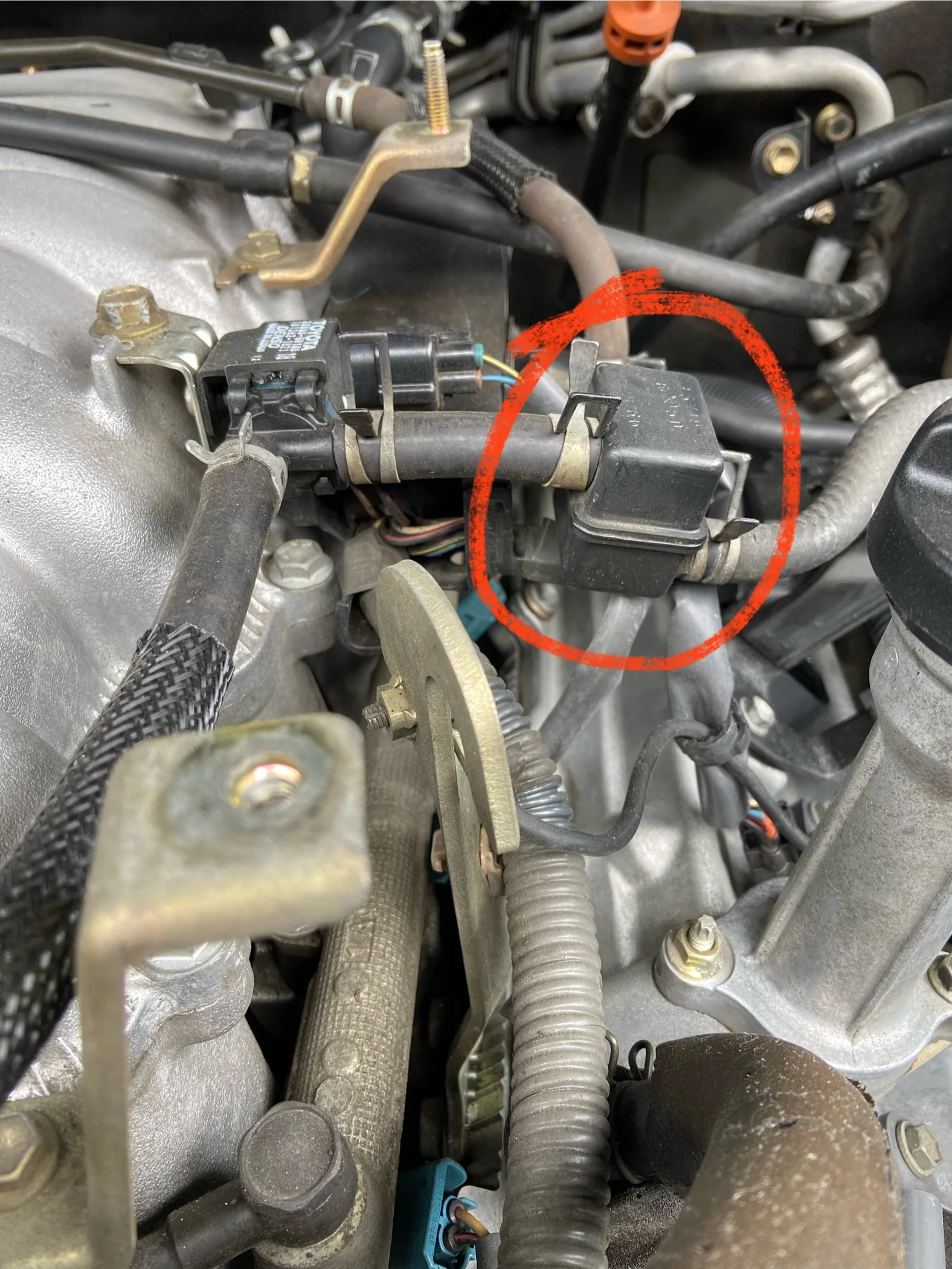

Check operation of EVAP VSV on BK1 side of intake manifold.
Also do a fuel pressure test. May have a bad fuel pressure regulator.
Make sure no vacuum leak.
Check all EVAP lines for blockage.
Also monitor ECT & fuel trims.

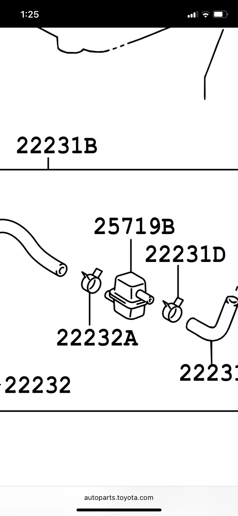

One q: I recently changed one of the evap system hoses between the CC and the VSV. All else with evap is original, but rad was just replaced with OEM, new hoses, full flush with fresh Toyota Red.
It’s possible I reversed the vacuum reservoir between the VSV when reattaching. It lives between the VSV and the CC. Does it’s orientation matter?
Here is how I installed it:
Here is how it’s pictured in the parts diagram:
See how the engine side nipple is on the lower half and the CC side nipple is on the upper? When I started on the truck, it was actually sideways.
