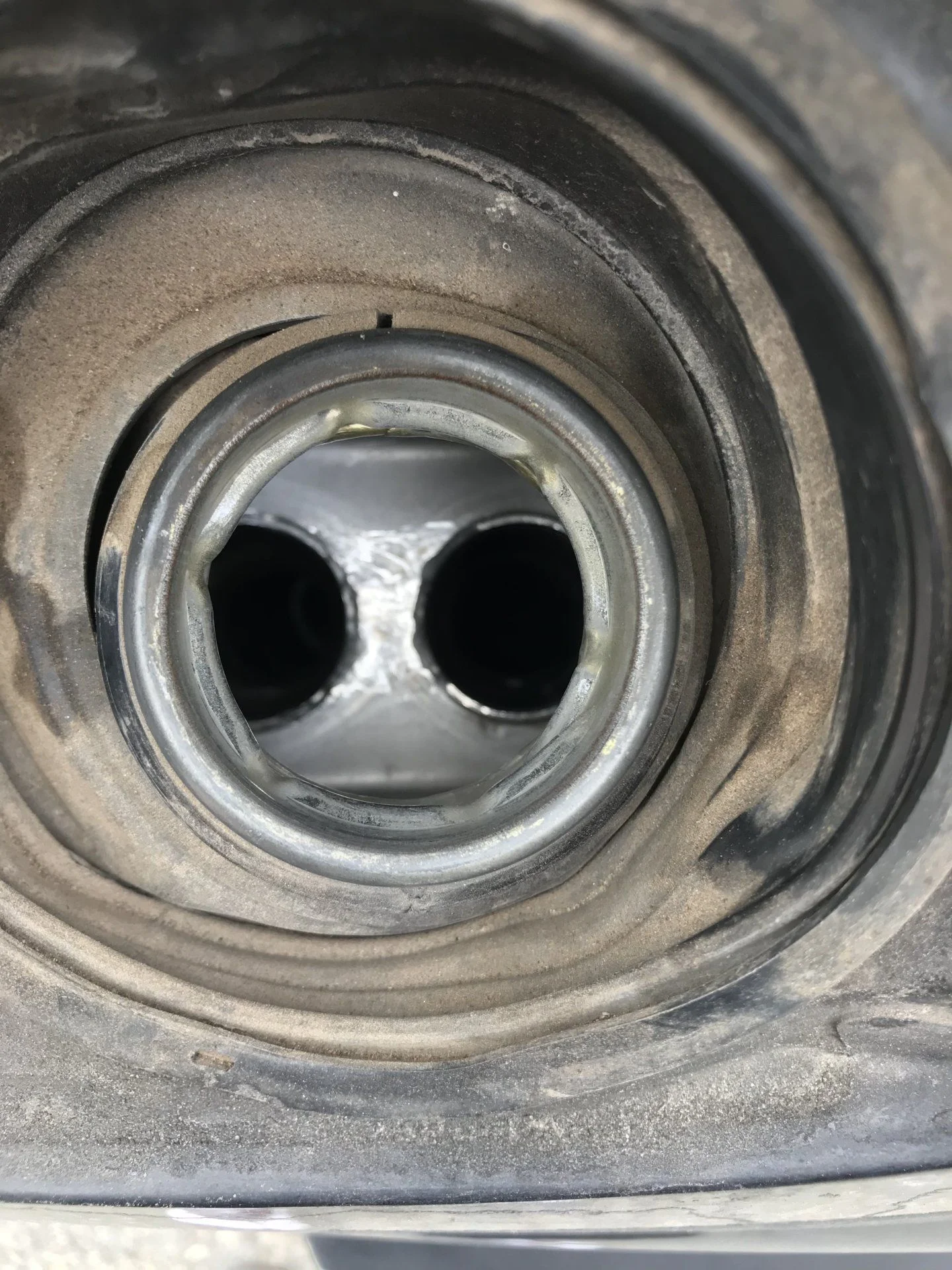

Hmm why so certain? Your photo is looking directly at a SEAM in the plastic. Have you aged it for 13 years and gave it plenty of use? How does the plastic ring seal against the metal tube? No possible way? I'm looking at one possible way...
Also this neck is not the same as the neck on my 2007 which has two vent tubes, one from the tank and one from the CC.
The plastic bushing rotates semi-freely. Go spin yours. There is no seal. As part of the LRA aux tank install (98-07), you cut the seam on the OE bushing and install onto LRA filler neck. Notice the cut at the 12 o'clock position?

Your rubber glove test is flawed. The gas cap seals against the metal filler tube, not the plastic bushing.
img_7454-jpeg.2270312
Again, mine is different to yours. Mine does not rotate. As you can see in my photo there is a 2nd vent tube that is fully encapsulated in plastic keeping it from moving.

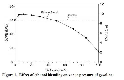

Ethanol blends are neither bad nor good just need to be used in systems designed for them. Since the majority of our fuel is now E10 I think it is good that a number of you are testing modifications to improve how our vehicles deal with E10. Keep up the good work.
Scientific data below.
While ethanol does boil at higher temperature (i.e. has lower vapor pressure) than gasoline, blends have a non-linear relationship.
For blends below about 40% ethanol the vapor pressure can be over 10% higher than gasoline. In order to market E10 the EPA granted a waiver on vapor pressure requirements for E10 as it could not meet the EPA requirement on gasoline.
The following graph is from the National Renewable Energy Laboratory which is part of the US DOE.
From the NREL report.
However, when blended into gasoline at relatively low concentrations the more numerous gasoline molecules disrupt the attractive forces between ethanol molecules and allow the ethanol to readily evaporate, raising the vapor pressure of the blend.
