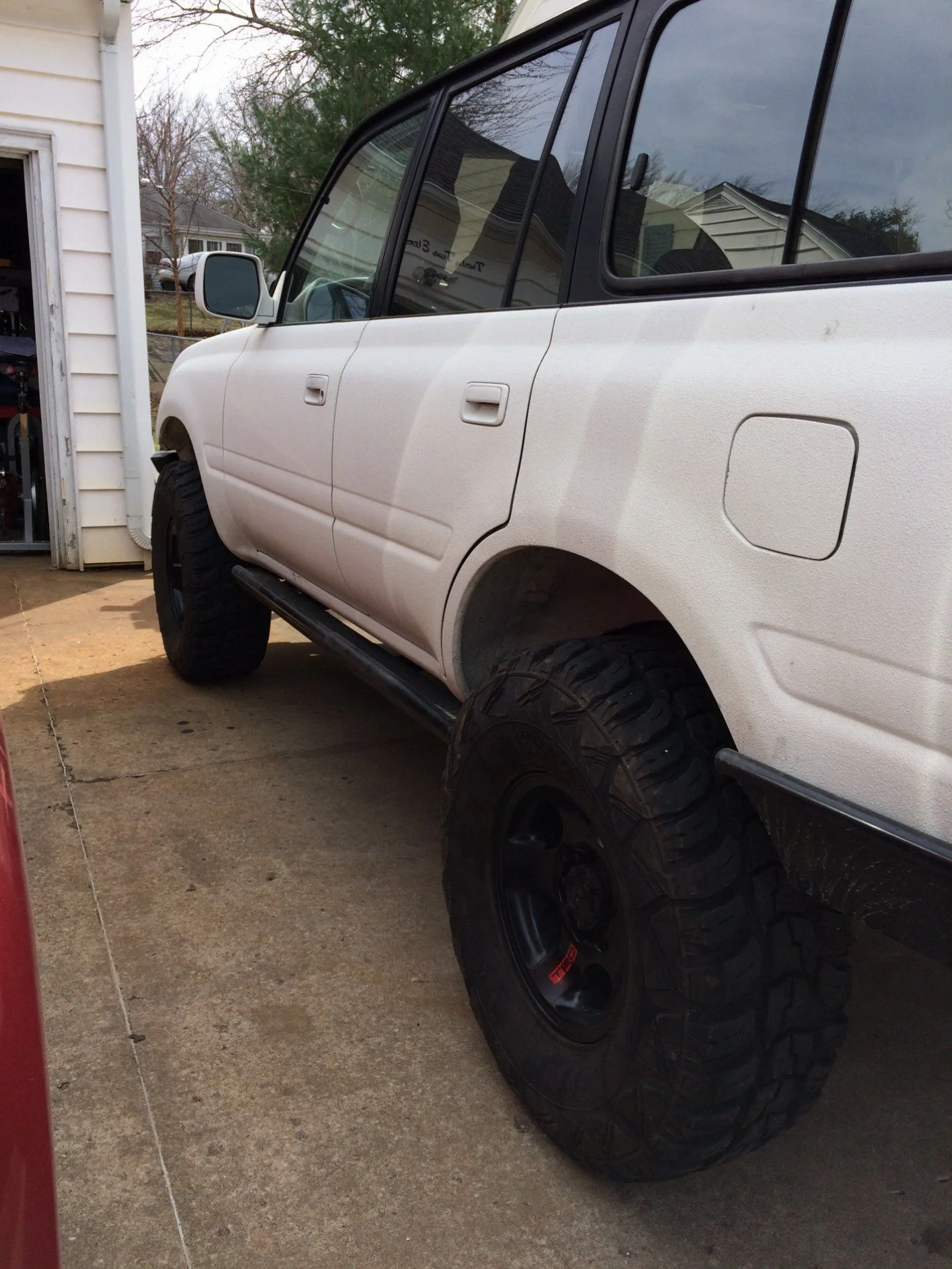

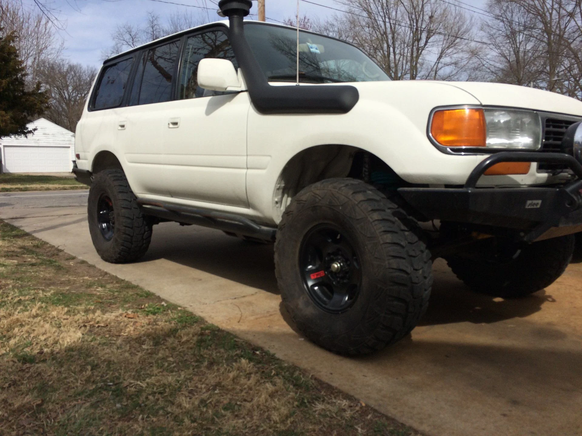

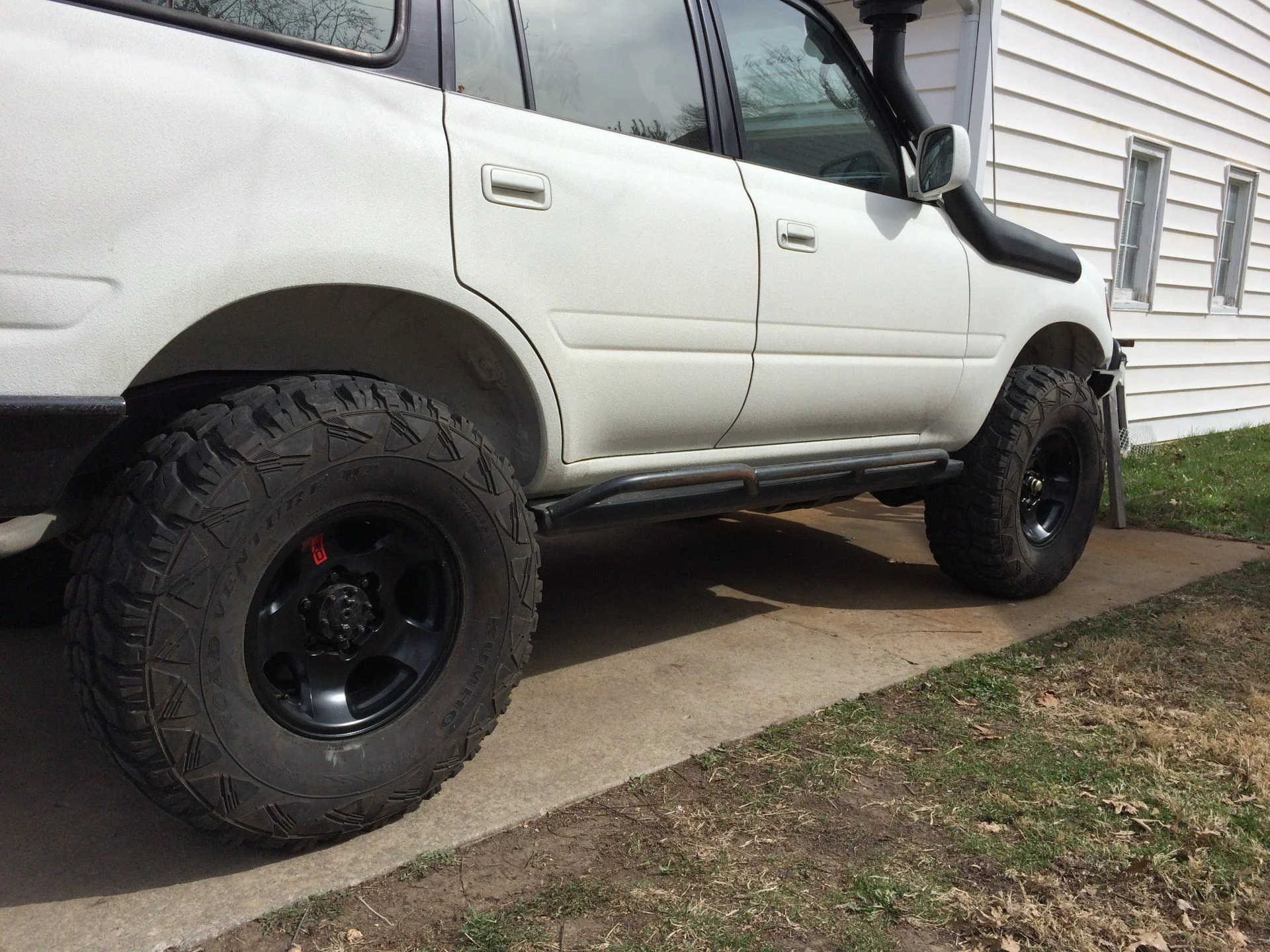

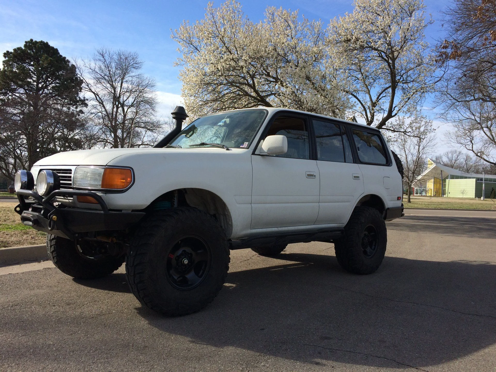

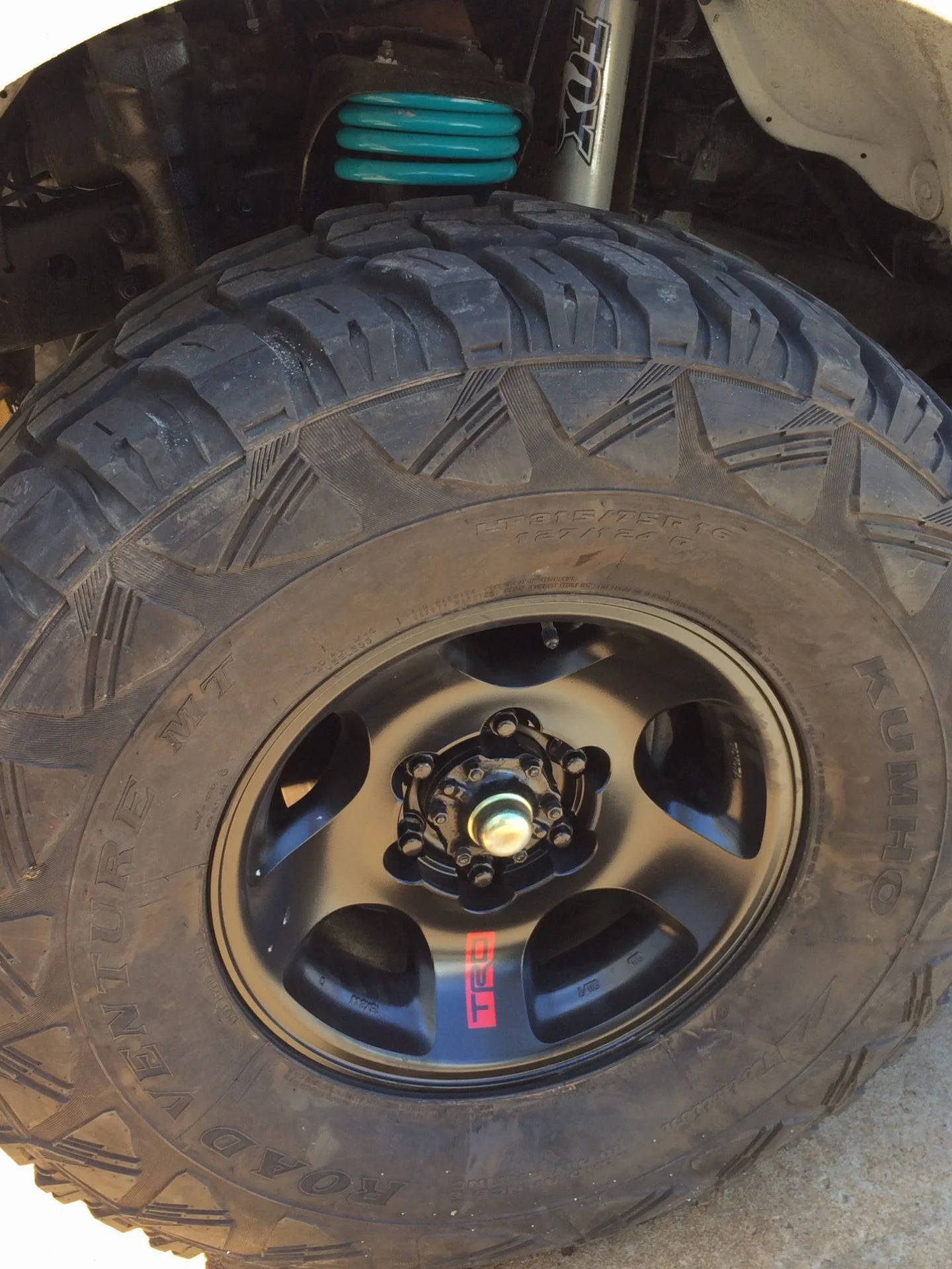

A couple of shots for those that want to see the stance of it. This is ride height with my normal load out. For trips there would be an additional 400-600lbs of gear towards the back. I will have pictures of that soon.

Like the wheels.
Thank you. I blatantly stole that idea from another mud member !
