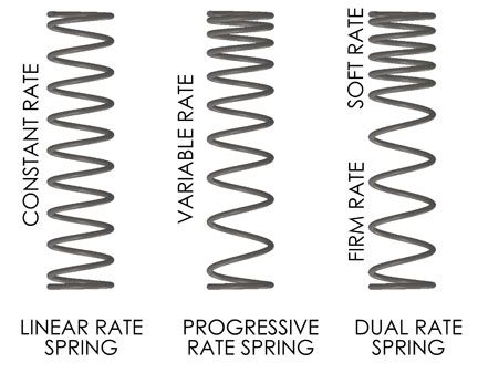

You are describing a Progressive spring, like what you have. Tighter winds are only part of a dual rate spring, the smaller diameter wire is what allows for a secondary spring rate through part of the range. There are three types of coils, linear, progressive and dual rate that are the most common for any of us to be dealing with.
“Linear rate springs” have one defined spring rate per inch of deflection throughout most of their range of deflection. For instance, if we have a 300lb/in linear rate spring that is 12 inches long, it will take approximately 300lb to deflect it 1 inch. The next inch of deflection will take another 300lb of load and the next inch of deflection will take an additional 300# of load (and so on until the spring goes solid). At this point there will be 900lb of load on a 12 inch long spring that has now been compressed to a 9” spring height.
The “linearity of rate” makes it quite easy to calculate a given spring length at ride height and this helps in setting up the ride height of a specific vehicle. If we know that we have 750lbs of sprung mass on a corner and we want to run a 250lb/in linear rate spring; we know the spring will compress 3 inches (750lbs ÷250lb/in = 3 inches). That helps us anticipate the total travel of the spring. Also, by measuring the total travel of the damper, we can easily estimate the total load placed on the spring during an event.
OME springs are linear rate.
“Progressive rate springs” are generally classified into two sub-types: 1) constantly increasing rate springs and 2) a “dual-rate” spring with two linear rates connected with a rate-transition range.
The first type (constantly increasing rate) of springs are most often used as “load-compensating springs” on the rear of a vehicle when the vehicle will often see significant load changes in the cargo area. These are most often stock replacement type suspension springs. They are identified most easily by continually varied spacing between the coils. One area of racing where constantly increasing rate springs are used is dirt modified racing where pull-bar springs, using a constantly increasing spring rate, are used to control rear axle wrap during acceleration. These springs are not suspension main springs, but are supplemental springs.
The particular Dobinsons are Progressive rate.
The second type of progressive rate suspension springs, the dual-rate spring with two linear rates connected with a rate transition range is a much more sophisticated suspension spring. The design is much more focused on the specific use for the spring. These types of springs are used primarily in road racing and high performance street and GT applications where the vehicle trim package will stay in a very predictable range. These springs are easily identified by having a few closely wound coils at one end and then wider, equal spaced coils at the other end. They have rates described as 200/425lb/in. This means that the spring has an initial rate of 225lb/in through some range of deflection and then the rate transitions to 425lb/in through a deflection range of 1”-1.5.” The big advantage of these springs is that they can provide “roll control” in addition to roll control provided by sway bars.
Slinky or Icon springs are Dual rate.

I'm not meaning to derail the review of the Dobinson's with the discussion on progressive rate vs dual rate but its important for those reading the thread to understand what they are getting and what type of performance it will have if they decide to consider these springs.
Progressive rate springs have many good traits so I'm not sharing any of this information to "bash" the Dobinsons or any other progressive springs. Just describing differences.

I also do not want to derail this review, however, I will have to disagree with @Box Rocket as to these being progressive springs. In actuality anything other than a linear rate will be "progressive" so it is somewhat semantics. However, the top coils have the same spacing, the next set of coils have a different spacing, but they are consistent all the way to the bottom of the spring. Therefore you have two different rates and only two rates.
What most people think of as a "progressive" rate spring will have spacing that increases all the way to the bottom of the spring. In that case you can't say its a 160/260 spring rate because it depends on where the coil is in its travel. The TJM springs were a good example of this. You could clearly see that the last two coils in them had the widest spacing and were therefore the stiffest rate. The illustration above is not the best example of this because its very difficult to tell that the coils are getting "progressively" spaced out. However the website where that information came from does a good job of describing the differences.
