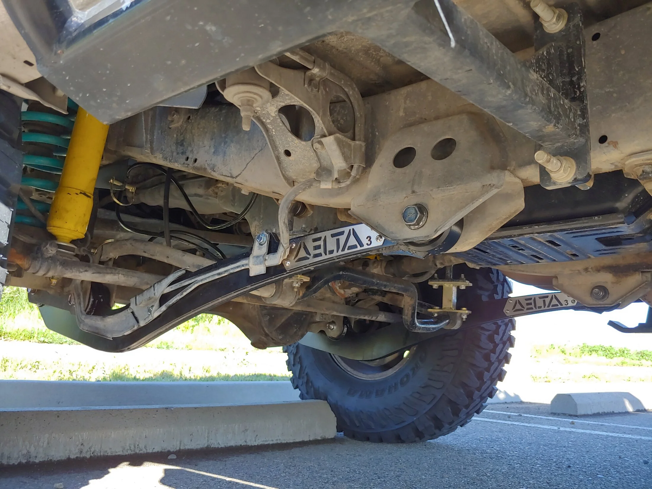

I also think the @eimkeith radius arm drop brackets are worth consideration. There's something to be said for changing the pivot point for the arms - any sort of leading arm suspension benefits from links that are as close to level as possible. Drop brackets improve this in a way nothing else (fancy new arms included) can do.
^^^ this 100% But at the cost of ground clearance. If your not rock crawling a none issue.
If no brainer equals "price is no object", then well, yes, Delta arms are a no brainer.
I run Landtank caster plates on my 80 because my 80 budget isn't sufficient to afford Delta arms.
Yep, in the price category the arms are a tad spendy but are a bolt on solution. I always thought the plates were kind of a band-aid. That sounds bad and I am not casting aspersions on the product, just wasn't my cup o tea. Like painting an 80 pink, I just don't think they look good. And no, my cuiser is not a pavement pounder, Its got more desert pin striping on it than miles!

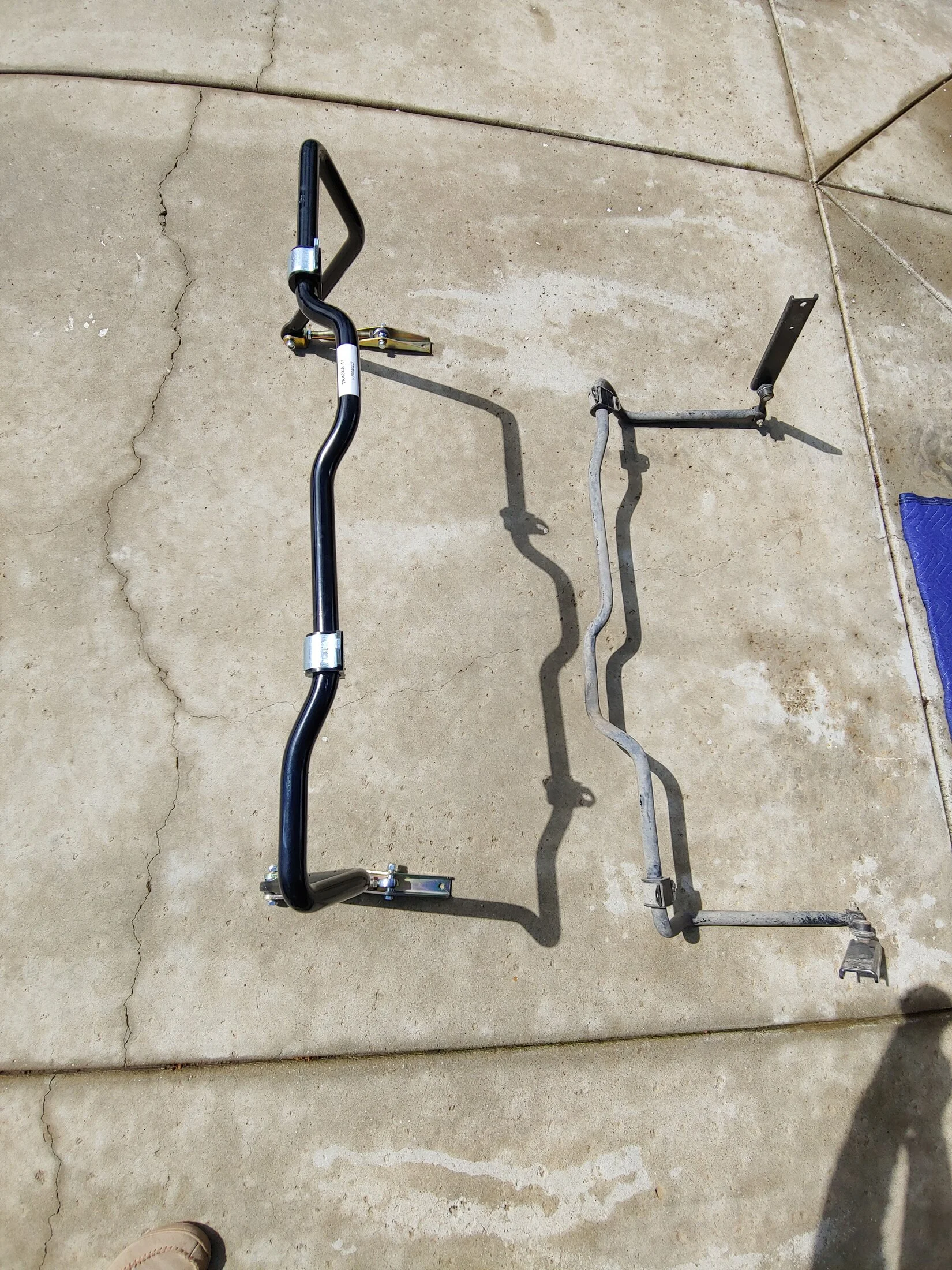

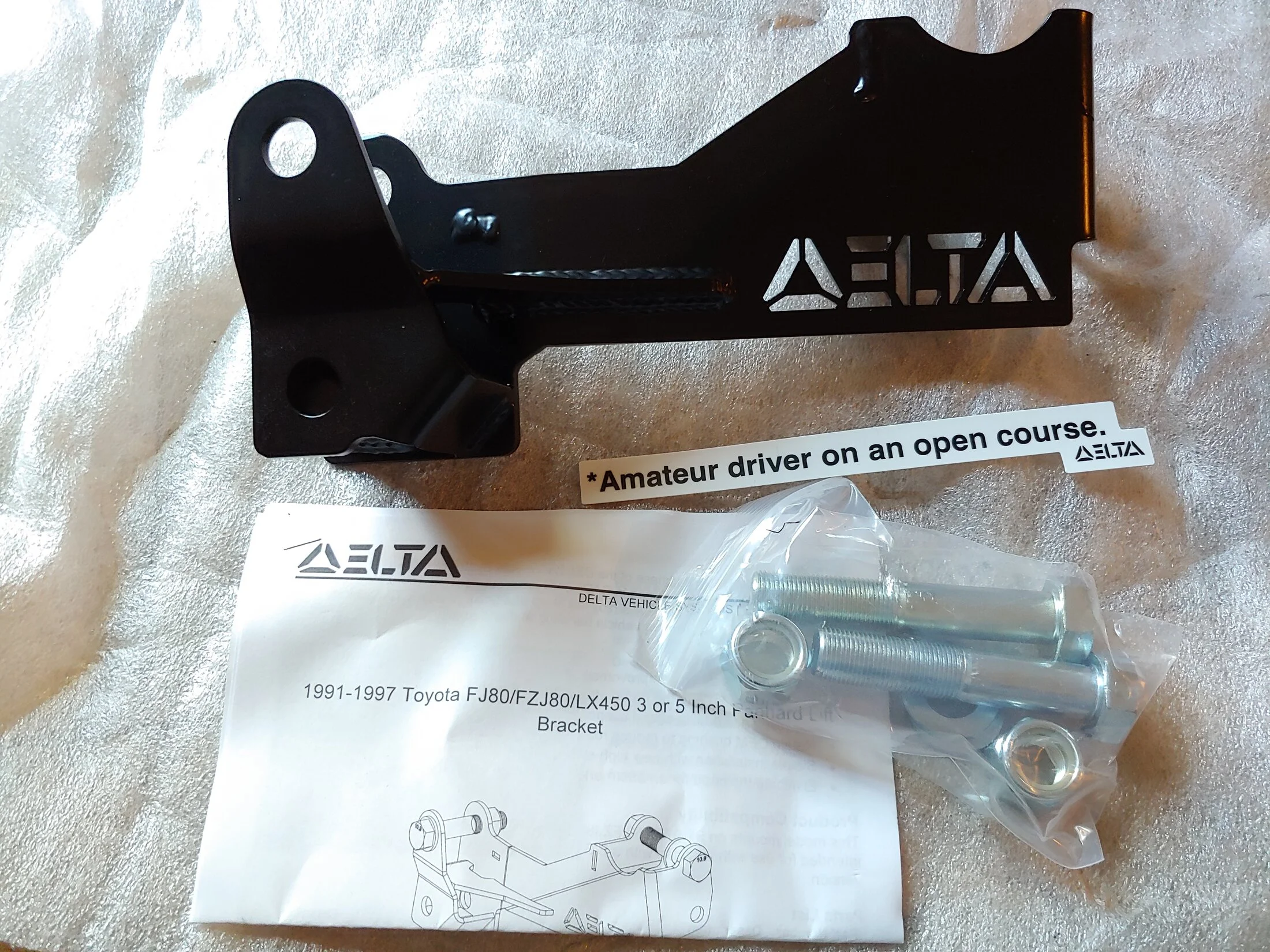

You will also need/want with your 4":
Whiteline rear sway
Delta's panhard bracket
LCP or landtank rear swaybar drop kit

One thing plates can not do is move the axle forward to its original location or further in order to fit 37”+ tires without a 10” lift or sheet metal removal behind the tire.
If you buy plates get the kind that rotate the axle around it’s axis not the kind that rotate the axle around the forward arm bolt axis otherwise you will have a tie rod to leading arm clearance issue. Been there and after grinding over 1/8” off the top of the arm still wasn’t completely in the clear under all circumstances.
Not all arms move the axle forward 😎 there are other ways to move the axle forwards.
