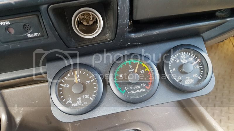

IsoPro gauges for: Oil Pressure, EGT’s, Boost

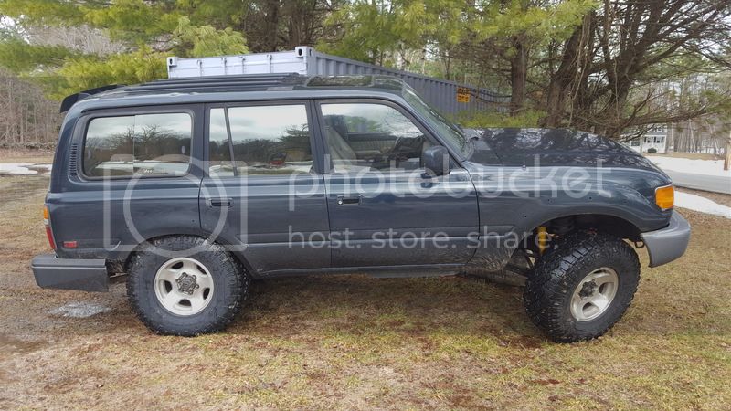

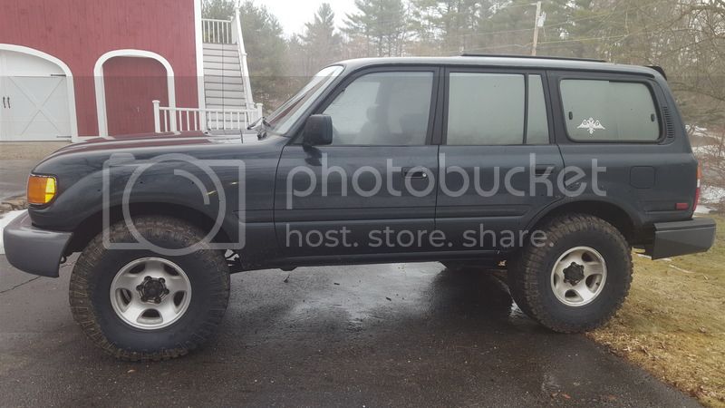

Here's what the Cruiser looks like now:
The first thing that I did was buy some 315 Duratracs for it. I sure changed the way the rig looked overall.

With big thanks to the knowledge of the diesel guys on here ( @IanB @mudgudgeon @CycloSteve @Rock40) , I believe that I am running a little rich AFR, creating high EGTs. The fix will be another 5-10psi of boost. Hopefully, I'll get lower EGTs and more power at the same time.

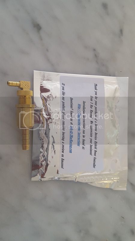

So, I bought a manual boost controller... it's a Dawes MKII. (Only $47 shipped!)

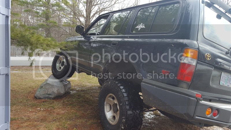

Basic rock flex testing (Sway bars on): Pass
Looks like I need to find some taller rocks...

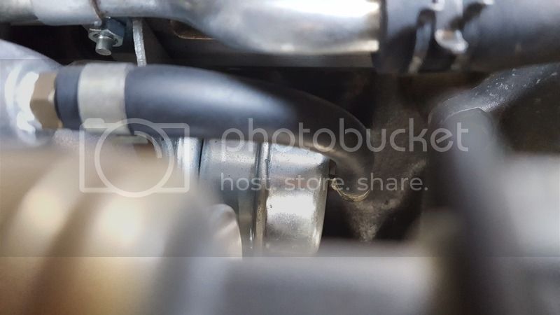

Oops! Here's a basic pic. I can get some better ones this weekend. Better yet, maybe I'll get a startup video. It's amazing how quickly it starts even without glowing!

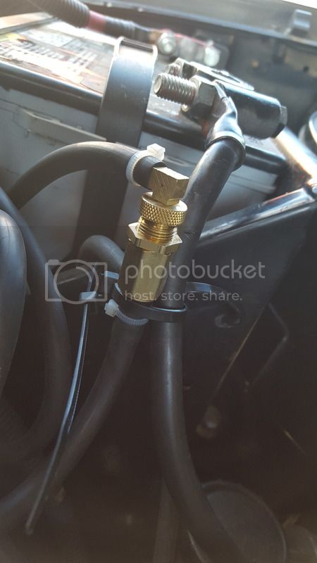

Installed a manual boost controller today. It only took a little over an hour... pretty straight forward!
Here's the Gturbo Grunter:
Here's the line that get's the boost controller inserted into it:
Boost controller installed:
I bumped boost up to 24psi. EGTs are staying much lower and power is up a bit too. Really, this rig needs a full tune, matching fuel, air and injection timing. But, for now it's running well enough to quit messing with it and enjoy it for a bit.
