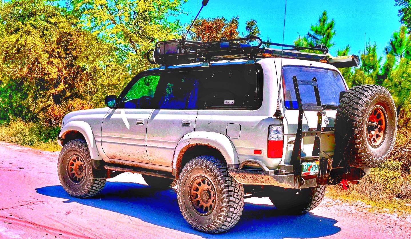

This is mine on cv 97 144 and 145’s…I’m running icon 2.5 shocks…but basically what you are looking to do.
To do it all right, you’ll need delta arms, white line sways front and rear, slee sway bar drops, extended brake lines and a delta bracket for the rear panhard rod…it’s really not a case of shocks and springs and hope the rest plays nice.

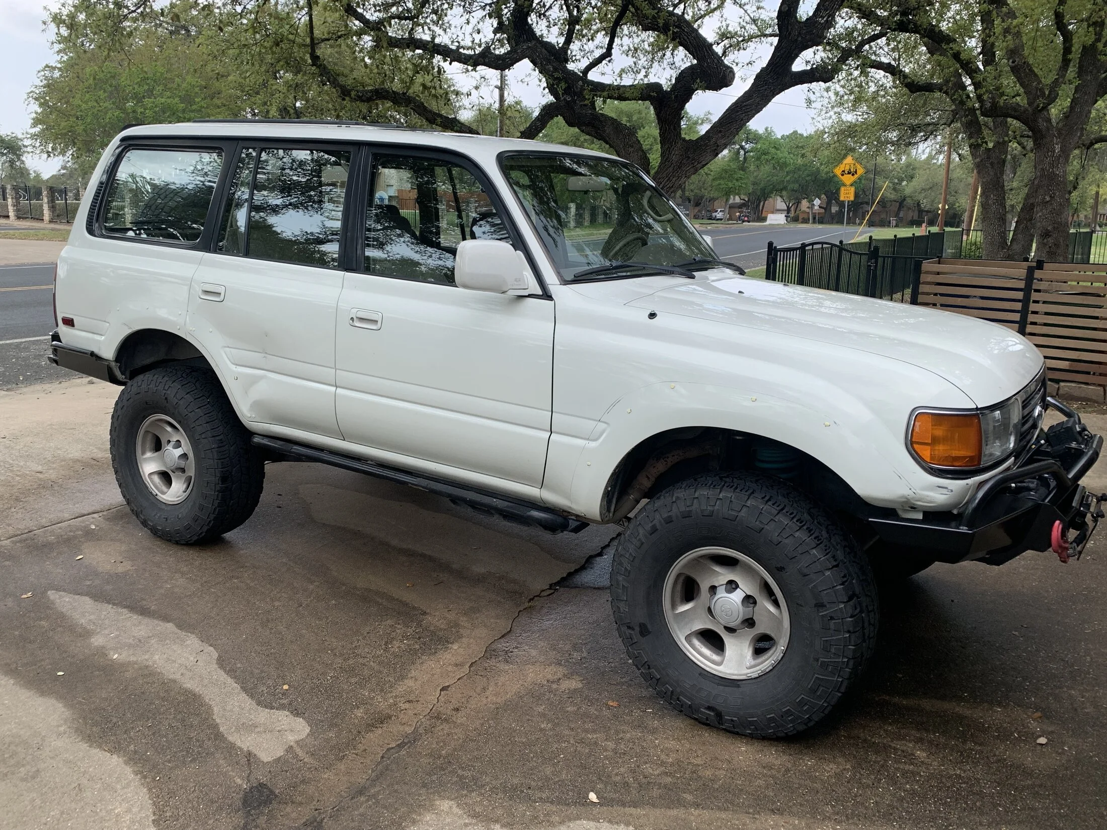

I picked up my springs second hand so I landed here a little be accident, but no regrets for me. I’m a little tippy with the lighter weight rig just running around town but overall like the ride height and performance of the suspension. If I changed anything I would consider the flexi’s for my lighter weight rig to reduce the tippy feel at times, but not to change the final height. I’m fine where I am and really like the wheel travel off-road

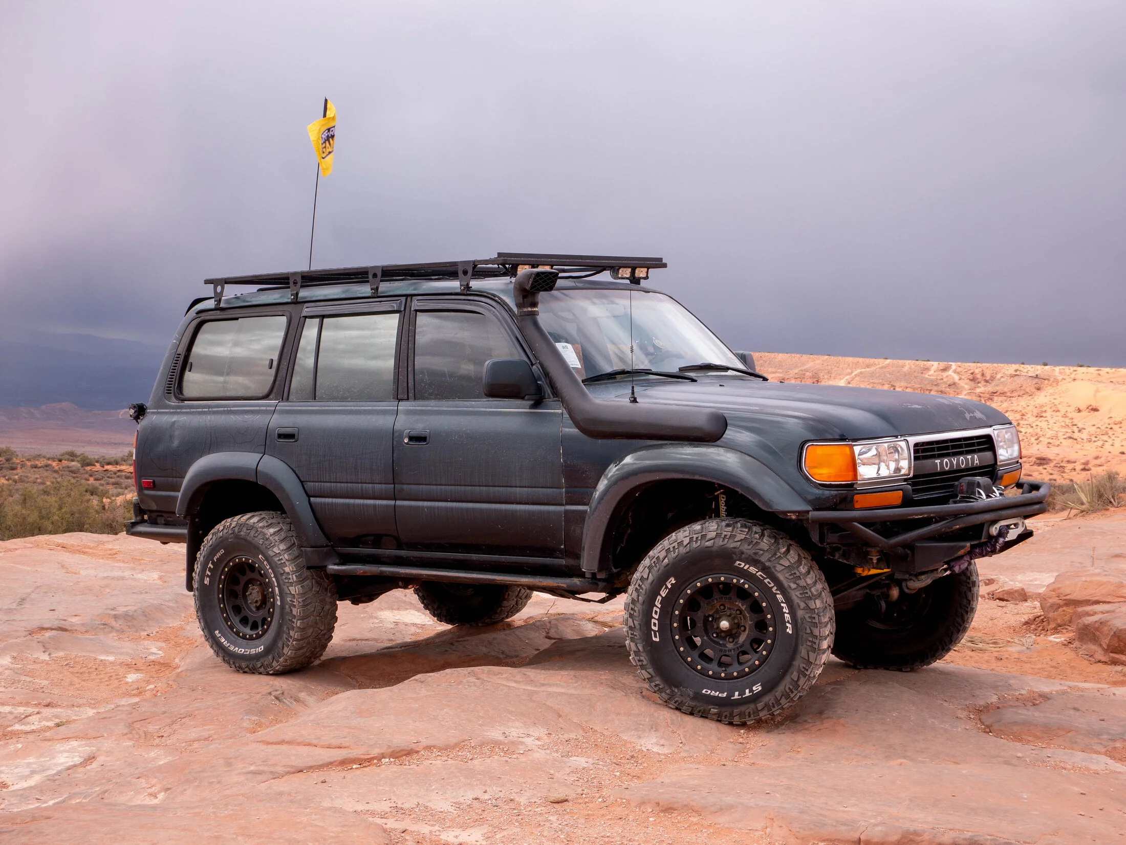

I’m running 35s with the dobinsons 2.5” dual rate spring in the front and the 2” (may be advertised as a 2.5 online but the box said 2”) dual rate in the rear with 4” MRAs and some timbren bumpstops. I’m running bumpers with a swingout and winch as well as a drawer system in the back with a battery. Sits about an 3/4-1 inch Lower than my old J spring setup.
There is no comparison between MRAs and nitros. They take a bit to get set up to your liking but I’ve had my 80 airborn over cattle guards without feeling any loss of control or discomfort.
This isn’t on completely level ground but it’s pretty close.
