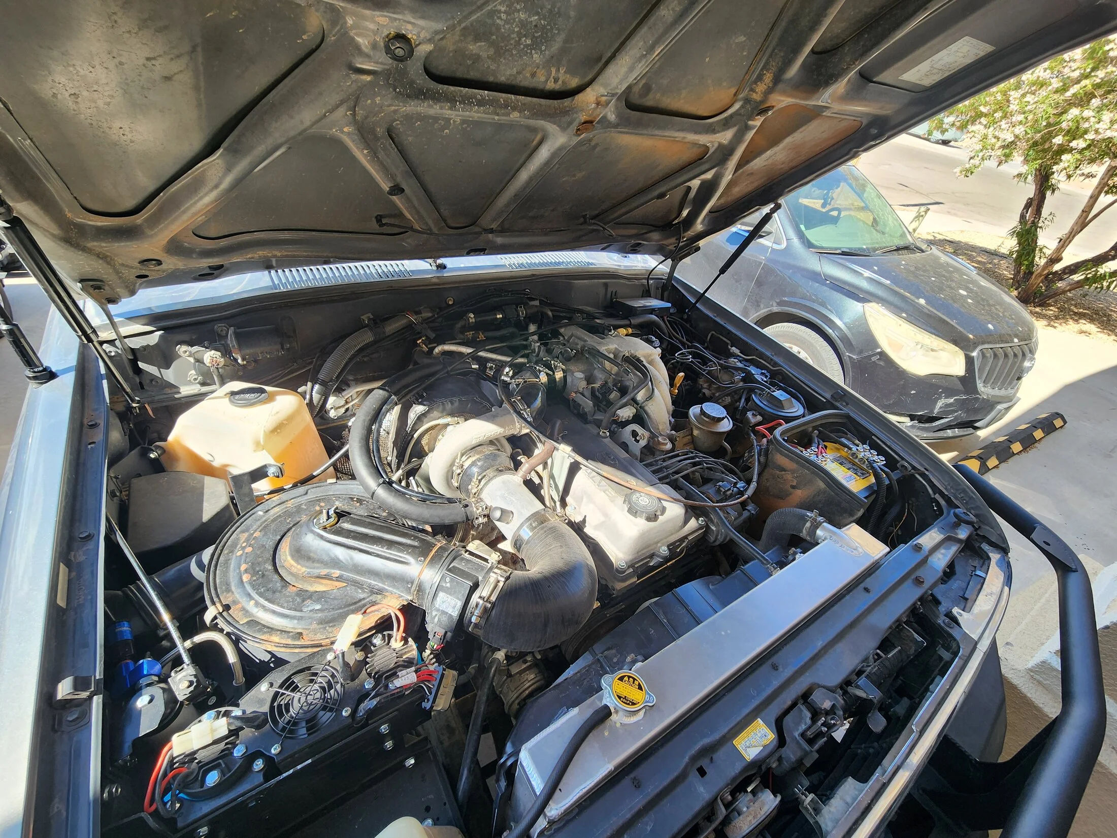

The thing that sold these for me are that they have mounting provisions for a brace so that we can tie the J pipe back to the head to make it extremely rigid side to side.
This is a nice improvement over Wits End J-Pipe. I noticed that my turbo has some vibration without anything to support it (more when the oil is 2 qts low and crank is splashing about 🤣). The vibration is transferred down the exhaust and rattles some s*** at idle sometimes.

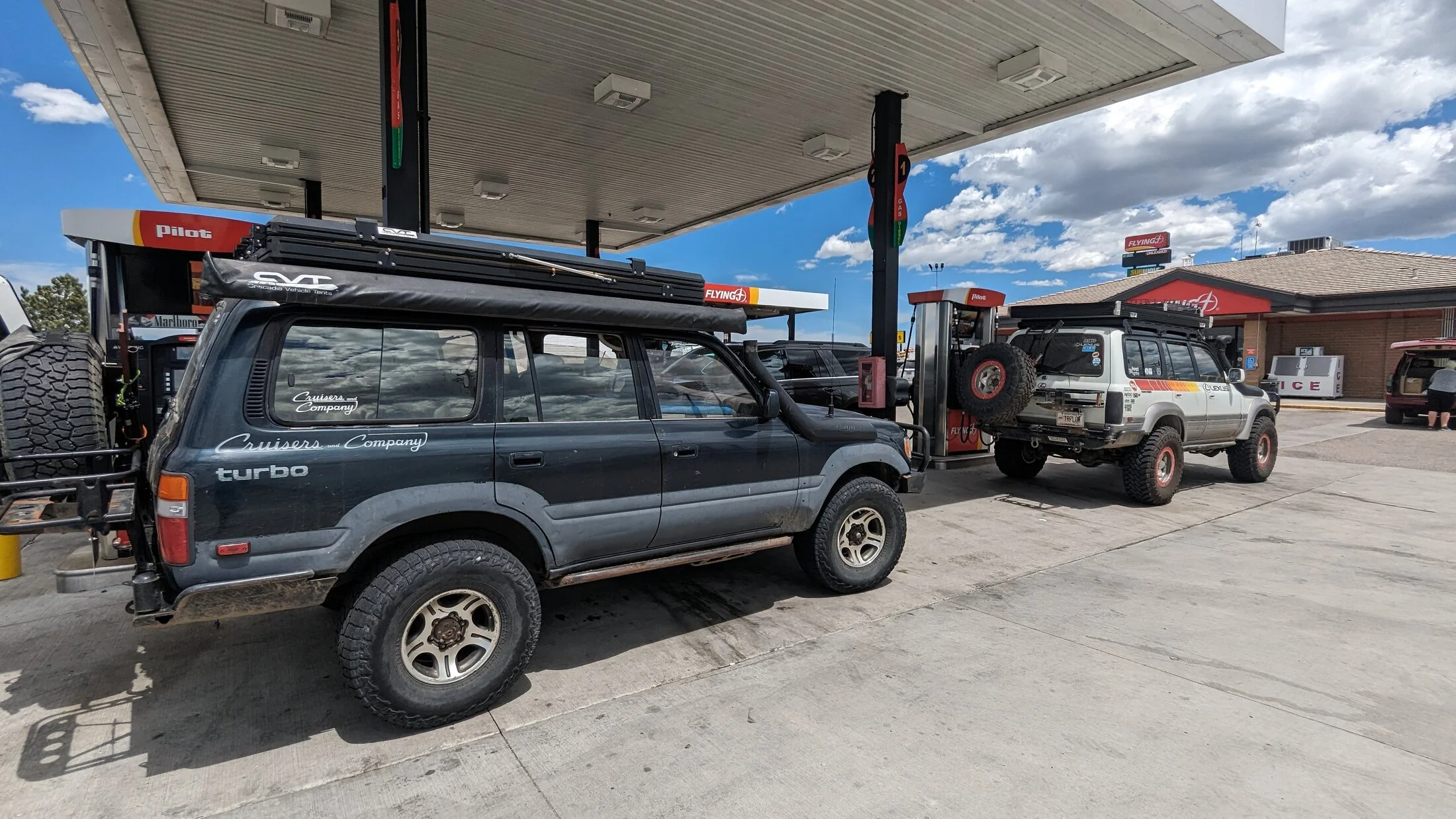

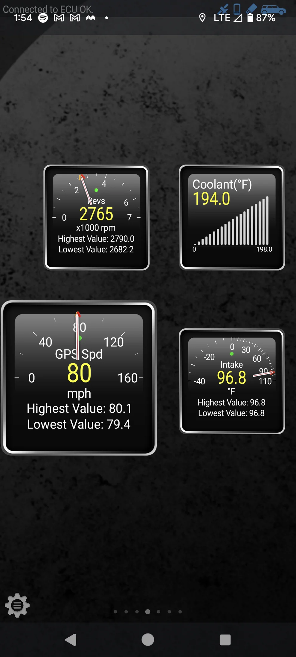

Doing typical 80 series things in the middle of Wyoming... Also, typical Wyoming, we've had very strong headwinds today but both trucks have been flawlessly running at 75 to 80 mph the entire day. Both trucks are turbo'd. It's 85 degrees ambient and the highest water temp between the two trucks so far has been 201 up a long long incline maintaining 80 mph with sustained 5 psi. This was on the white one which is on Toyo Mt 37s, trail gear bead locks (~135 lbs tire wheel combo), fully armored with the rtt. It's a brick to be pushing uphill into a stiff headwind. Typical cruising down the road flatland has been 194.

Thanks! No, not Spears. I looked heavily at his flanges and they are nice products. If this thing wasn't so cantilevered off the manifold his would work great. The thing that sold these for me are that they have mounting provisions for a brace so that we can tie the J pipe back to the head to make it extremely rigid side to side. American made by a small business too! Proto brace shown below.
I think I need to do something like this when I install my wits end kit in a month or so
Maybe get a longer studs so they poke out under the T4 flange so that a removeable brace can be attached to the underside with nuts?
