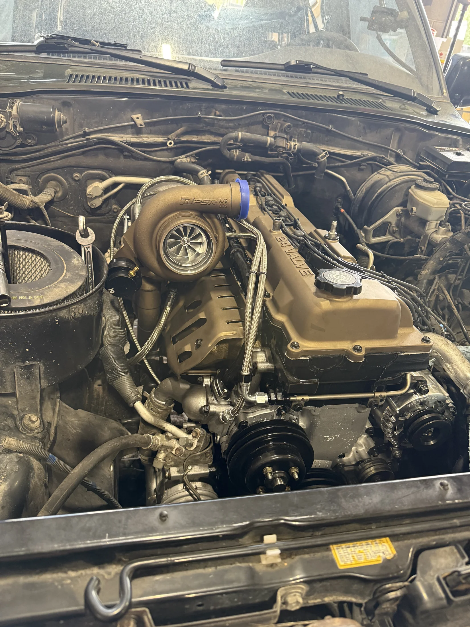

Stage 1 on a truck with 35’s and 4:10s with a 350k+ mile trans made 64 horse more and 100 more ftlbs to the ground on 7 lbs. Ground #’s 146 hp to 210 and 190 ftlbs to 290. “stage 1” on 93 should be able to produce more because of the more advanced/tunable ecu. Add big fuel injectors/intercooler and then turn up the boost you’ll have more oomph in an 80 than you’ll ever need.How many more Cheetos will the turbo Produce? I’m asking because I’m in the process of moving to 37 with my 93, and obviously gears will be my first mod, but thinking about more power down the road…

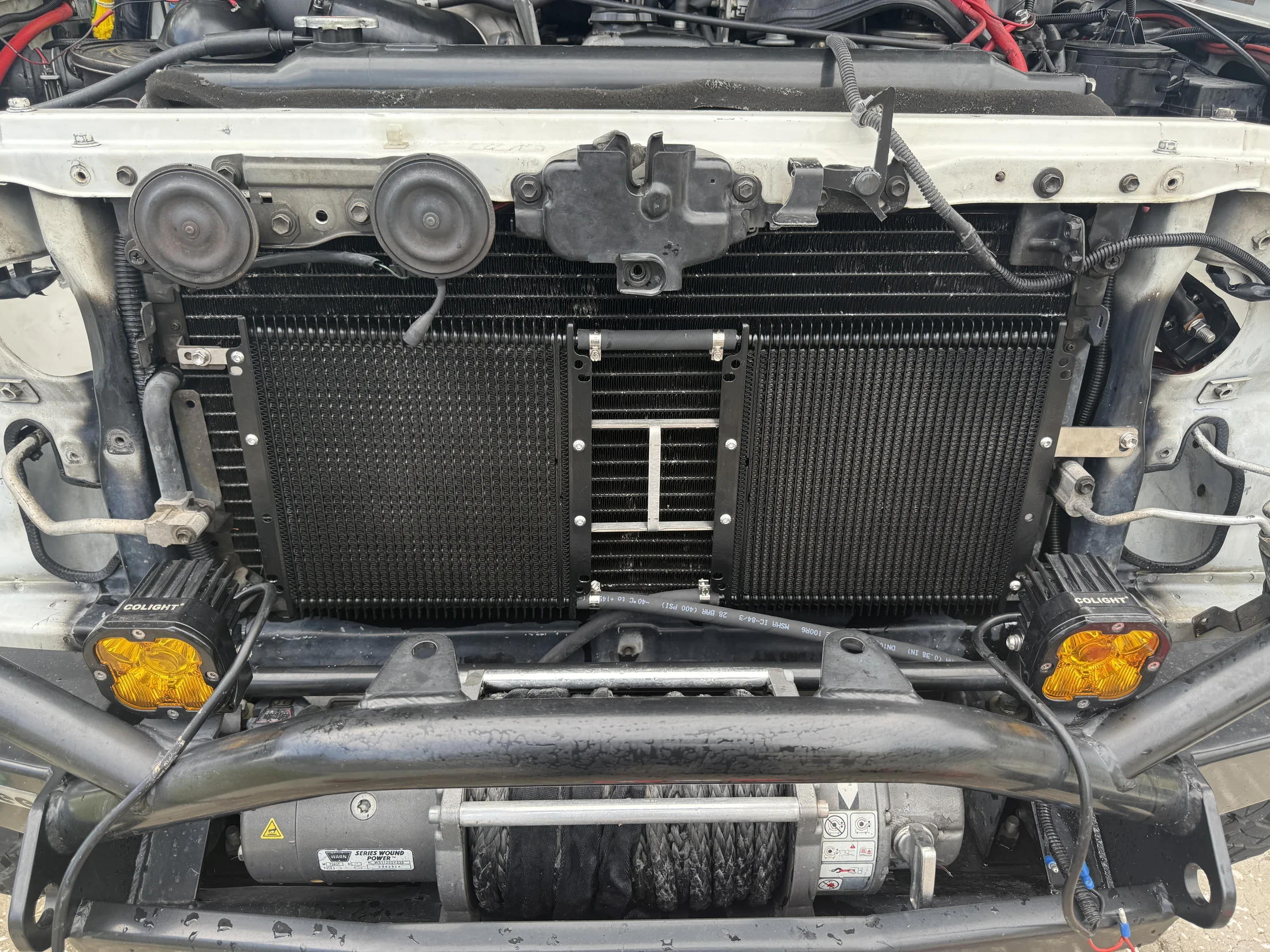

See how well the Cooler is working?

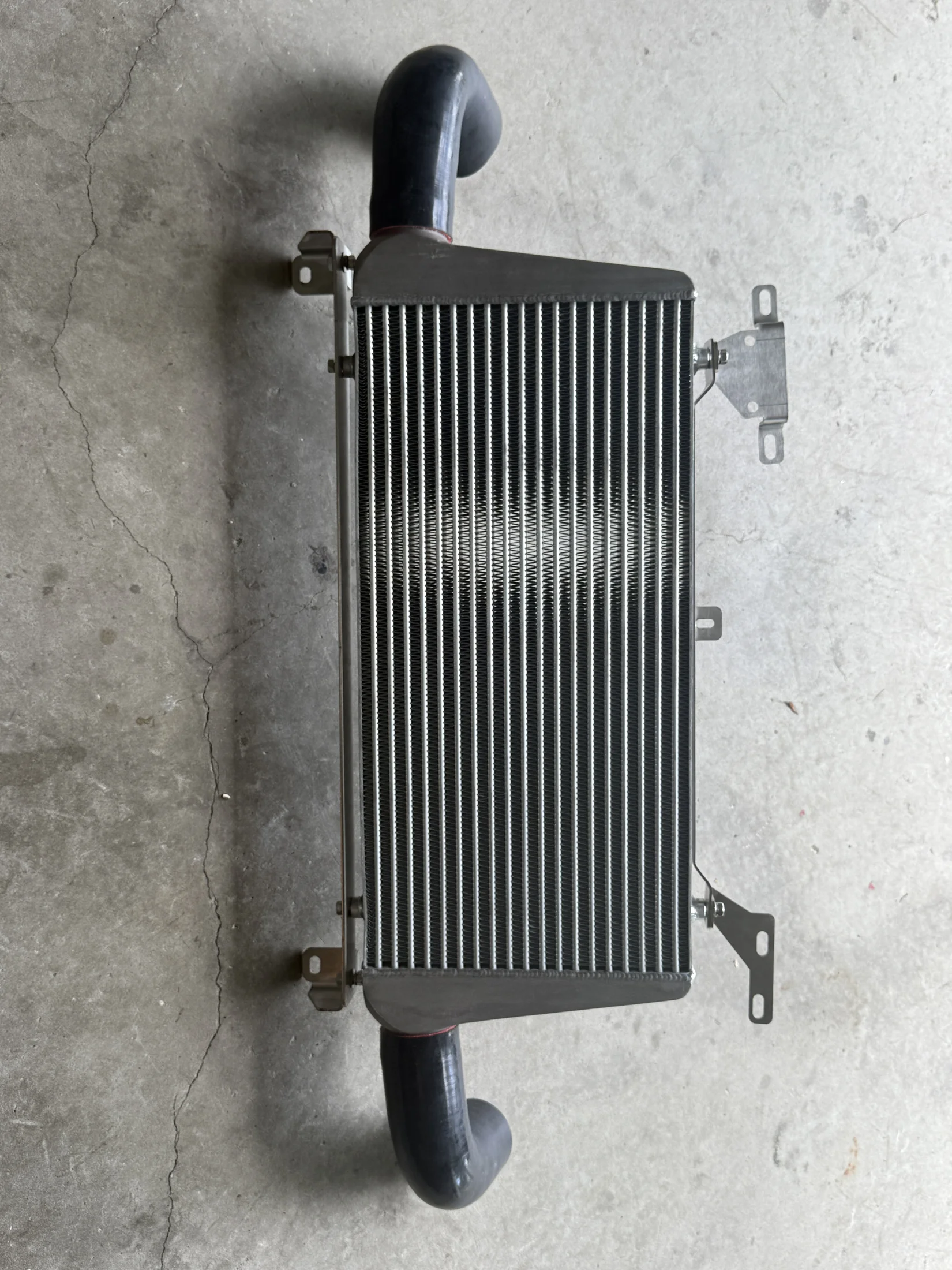

A few pics of the intercooler kit…
Be aware you will have to remove headlights, bumper, both battery boxes and lower apron to do this install correctly and cleanly without committing further damage to the existing vehicle.
You will also need to either cut or use a 3” hole saw on each side of the car for the lower IC hoses to pass through.

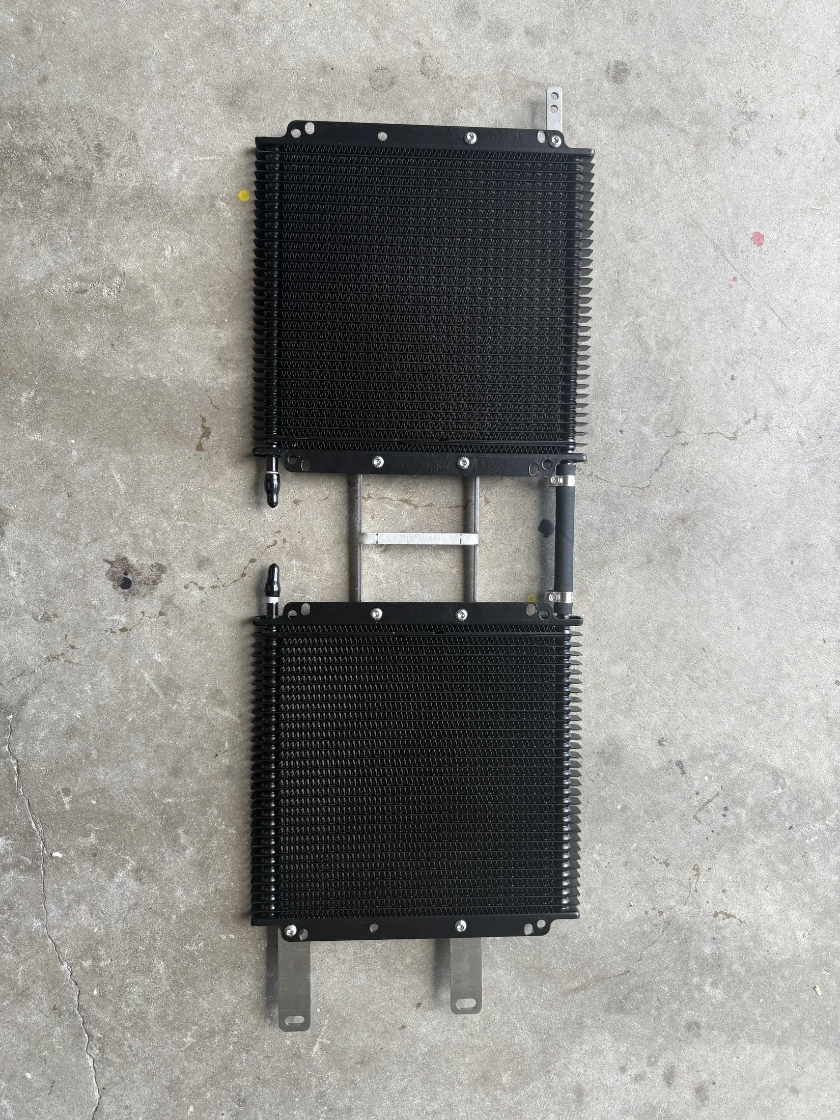

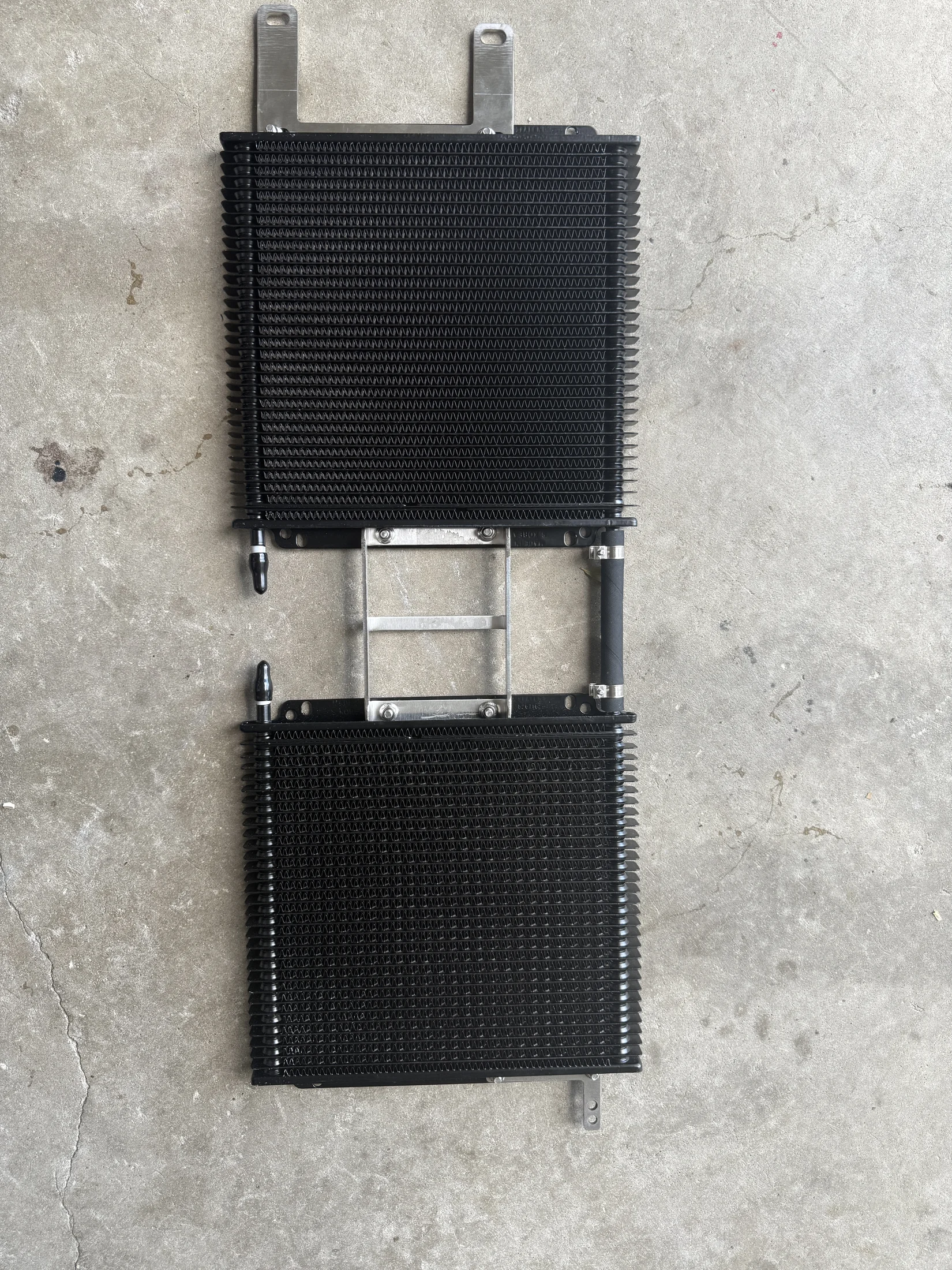

Here’s some pictures of what I have assembled so far…might come in handy for others
Yeah it’s close to the limit…but still cools like a champ…Thanks for posting these details. I was giving thought to getting that trans cooler even though I’m installing the 7psi kit that comes minus that and the IC.

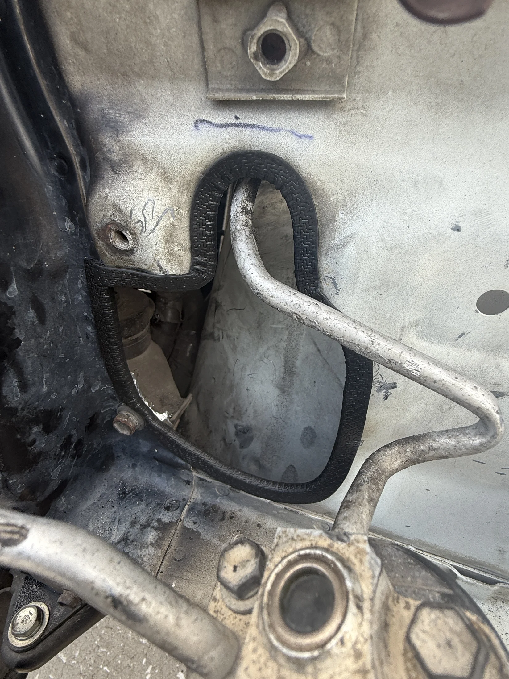

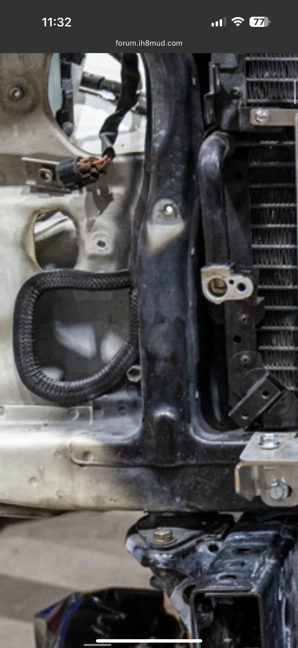

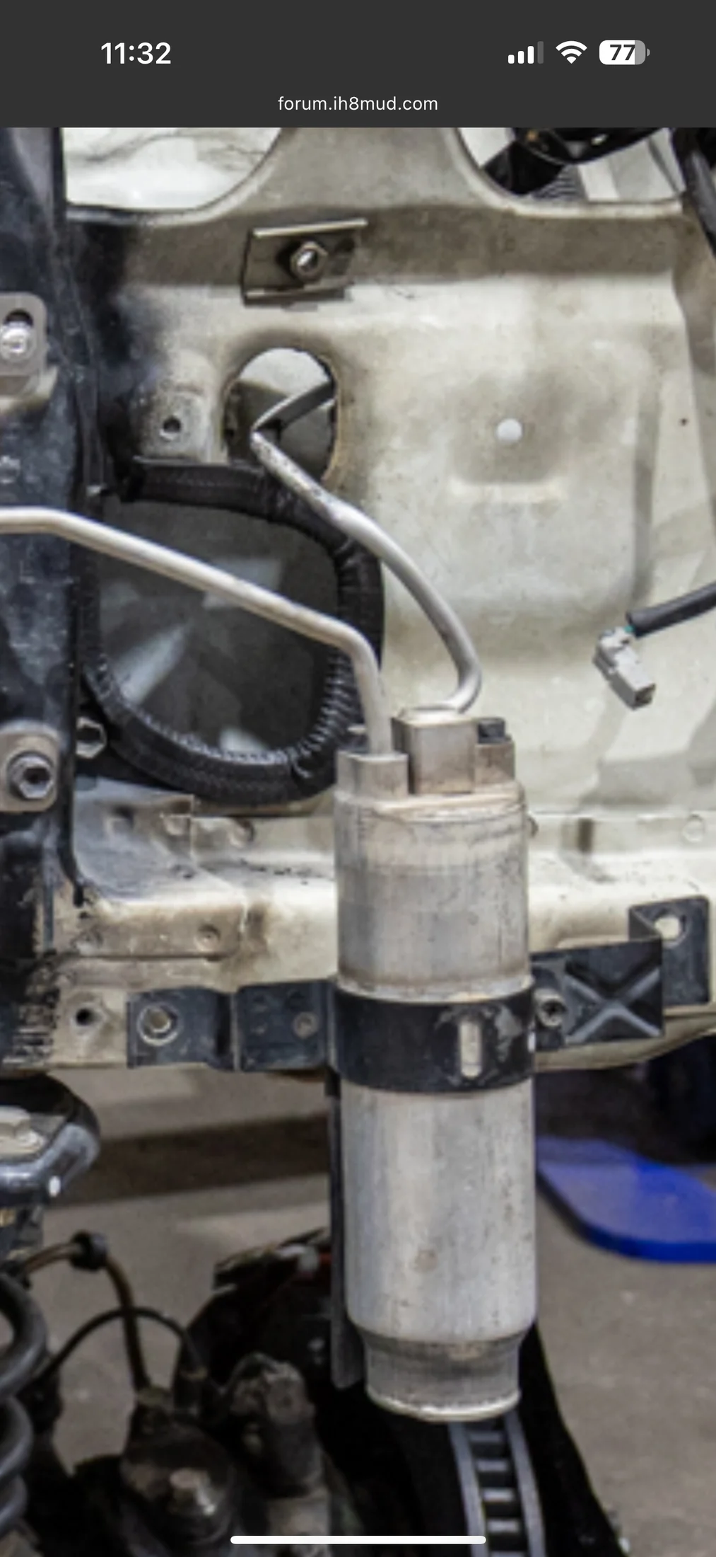

There are threads pertaining to relocating the AC dryer up beside the battery where the R12 system dryers were from the factory. I plan to do this and bought unions so I can cut the tubes and then splice the dryer into its new location. The one tube in your photo’s appers to be nearly kinked.
Any luck with the OBD-1 pricing? I’m in the same boat wanting more power from the 1fz.Stage 1 on a truck with 35’s and 4:10s with a 350k+ mile trans made 64 horse more and 100 more ftlbs to the ground on 7 lbs. Ground #’s 146 hp to 210 and 190 ftlbs to 290. “stage 1” on 93 should be able to produce more because of the more advanced/tunable ecu. Add big fuel injectors/intercooler and then turn up the boost you’ll have more oomph in an 80 than you’ll ever need.
