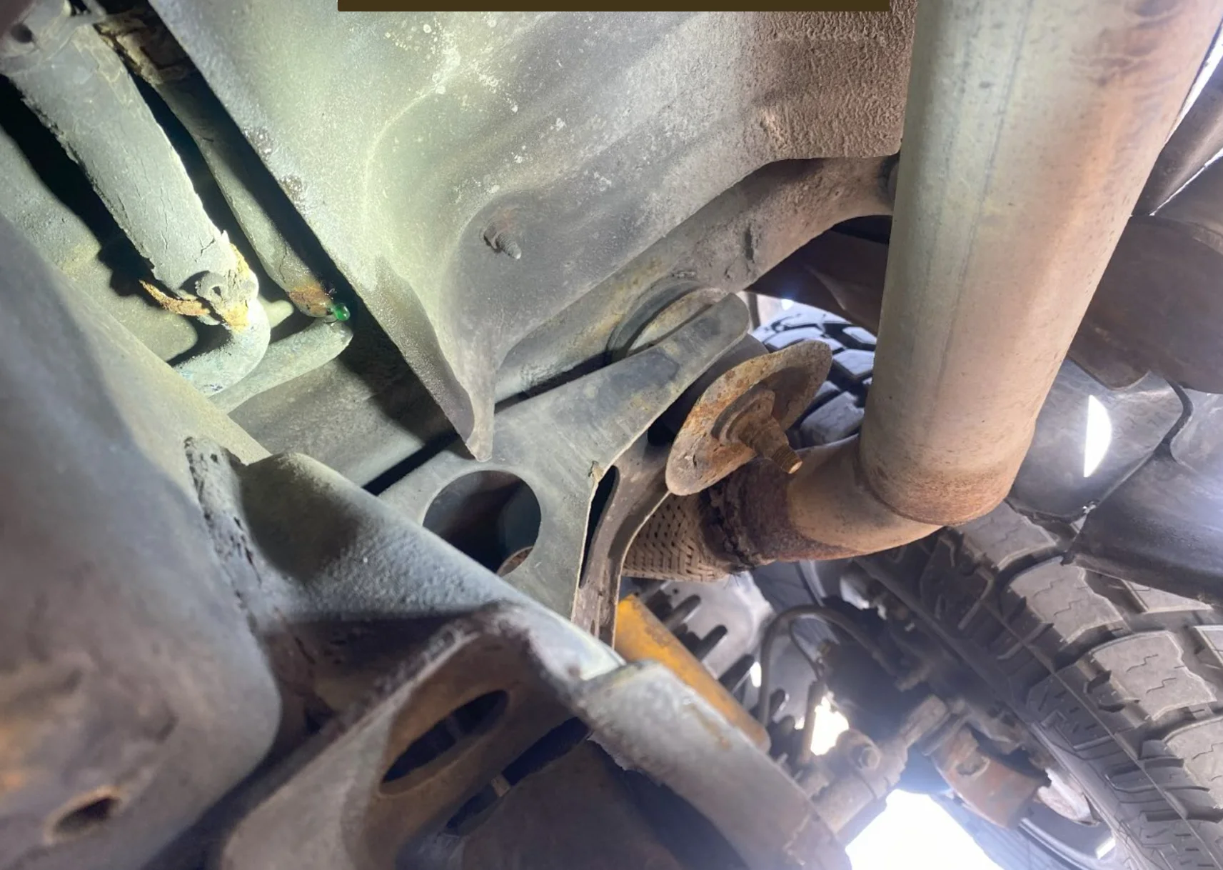

Rear heater pipes (going to the rear heater located under the right front seat).
Remove the heat shields (held up by 10mm nuts on short studs, spray with penetrating oil first), to get a closer look.
Could be from the hoses or the pipes (or clamps) have corroded.

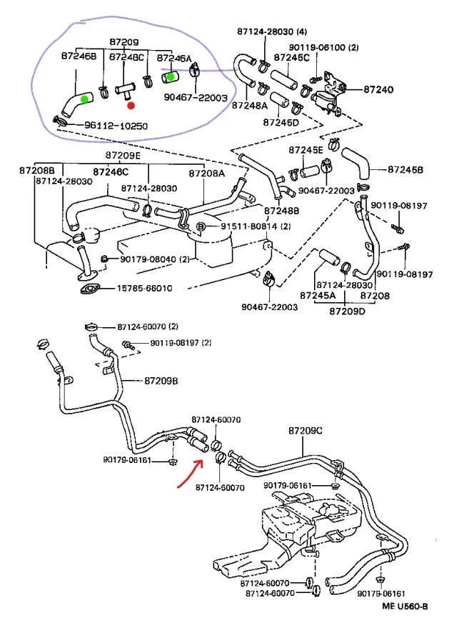

See Red arrow (the water heater hose/pipe diagram is for a FZJ80 so will not be exactly the same as your Turbo Diesel 80)
FZJ80 water heater hose pipe diagram leak between front and rear pipe sections.jpg

See Red arrow:
Thank you very much Kernal! Are those two pipes the same diameter? It seems one is bigger than the other to me? Also, can I use 1/2 inch silicone hose to replace them or I will have to order them from Toyota. Thank again!
Those specific hoses are not available from Toyota as the pipes originally came with the hoses attached. You could find another Toyota 1/2" ID
heater hose (from another application) and cut to fit or (easier) use the Gates Green Stripe 1/2" heater hose which is equivalent in quality as OEM. Do not use silicone hoses, they don't/won't stick to the metal pipes (which helps decrease leaks) and water (vapor) can even leak directly through the walls. Gates Green Stripe will last 30 years like the OEM hoses. Also, IMO, do not use Generic cheapo heater hose.
Expect to find at least some corrosion of the pipes, might be under the hose.

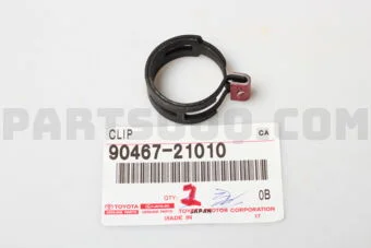

Do you also have any recommendations on the hose clamps?
OEM Toyota spring type clamps work well, just need to find the correct size for the OD of the hose you're installing.
One example of an OEM hose clamp (90467-21010) that fits a 5/8" ID OEM Toyota water heater hose
(it may fit the Gates Green Stripe 1/2" ID hose for the rear heater system, but double check)

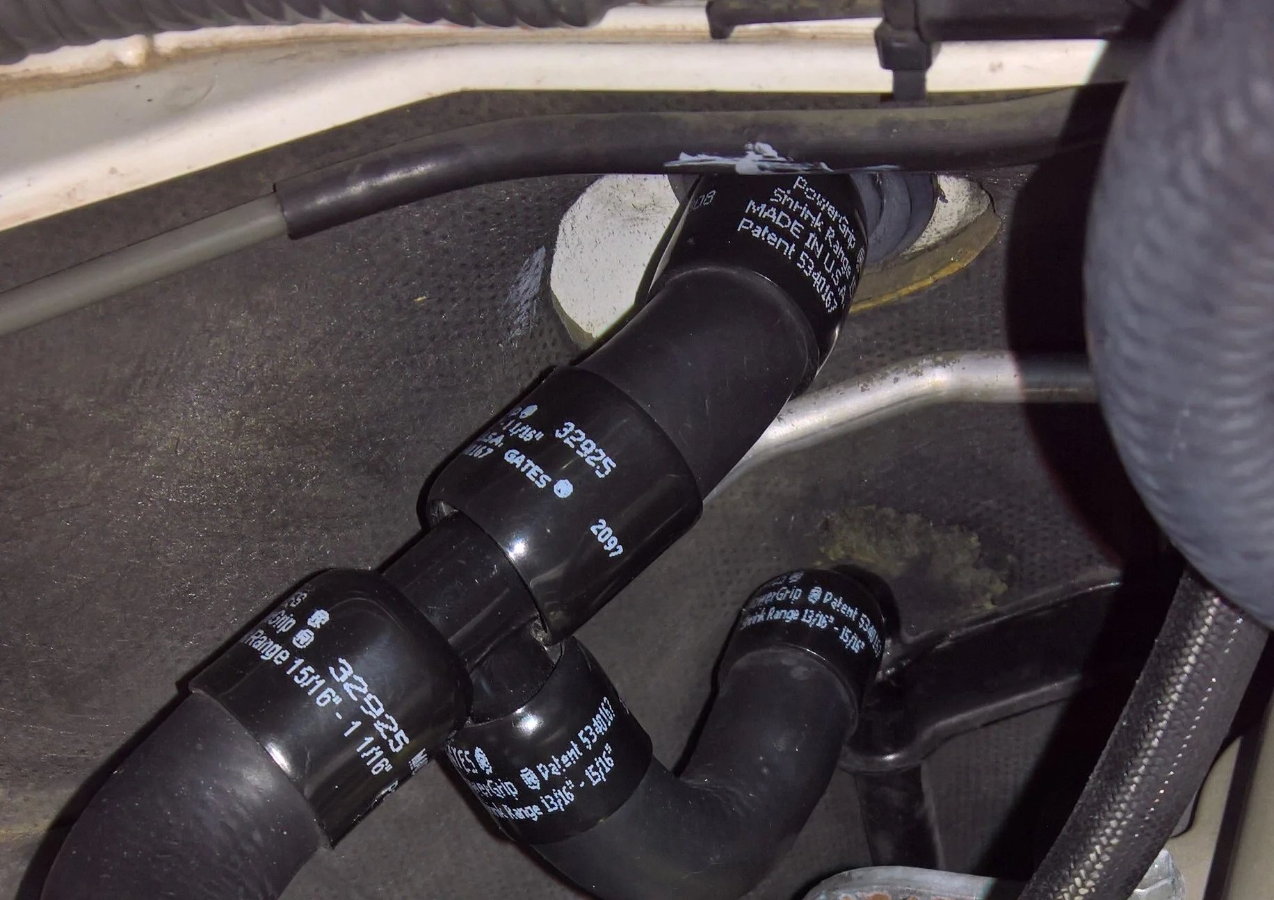

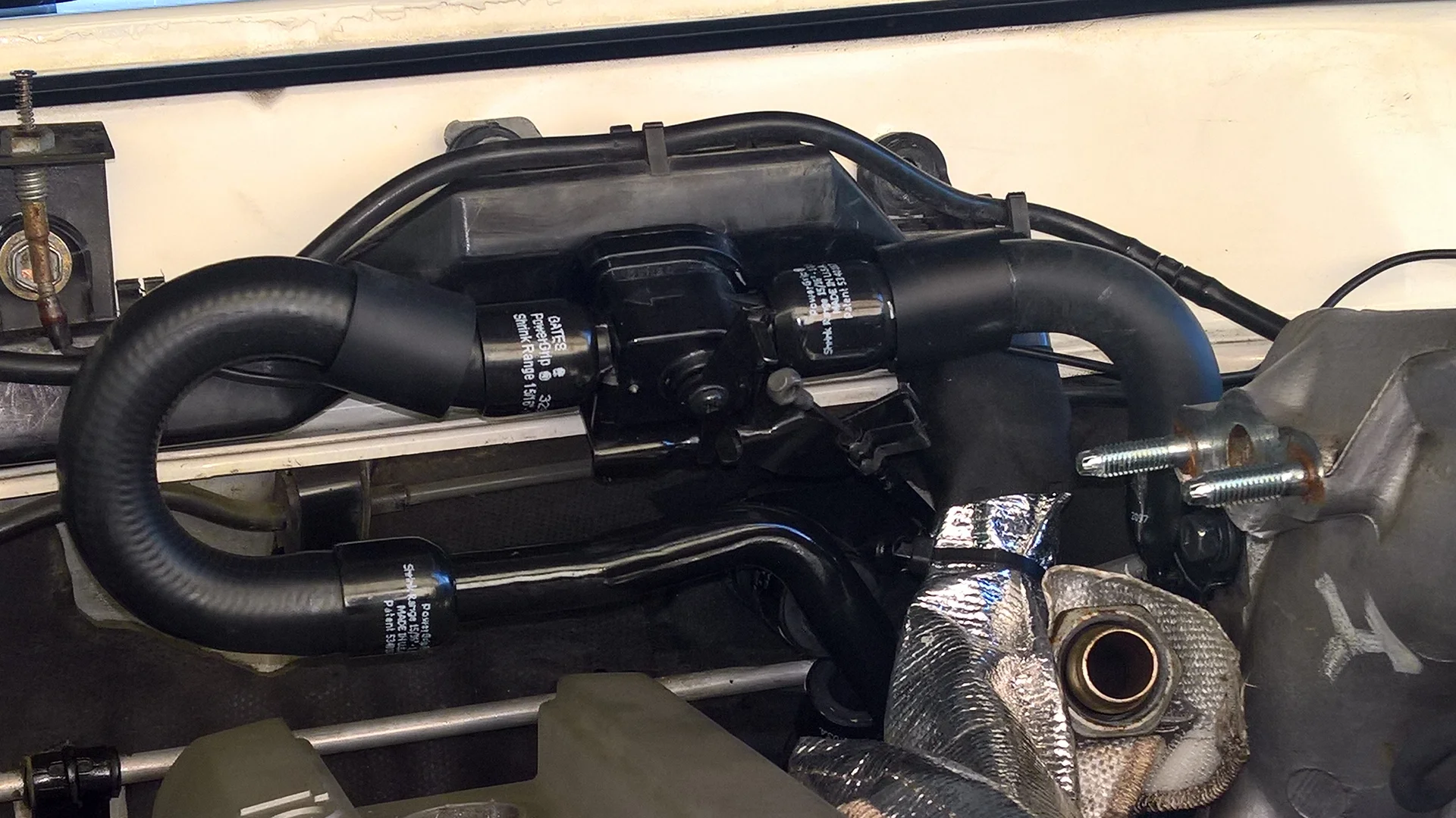

Here's a couple of photos:
Gates 5/8" hose on the left. OEM Metric hose on the right.
Top Hoses off the T: one Gates 5/8" inch fraction formed water hose, one OEM metric (FZJ80) hose, and the bottom ~90' metric hose (formed section cut from a 100 Series water hose):

is there a hardline inside the rubber hose?
Rubber hose connects to the hard lines. Kernal, in post #2, posted the parts figure, which shows the hardlines. There are two hardlines, an upper and a lower. Looks like your leak is where the two hardlines meet with a rubber hose.
@xna0329 asked: "is there a hardline inside the rubber hose?"
If you're asking is there a hardline inside the rear heater hoses under the vehicle (where your leak appears to be in the photos), then the answer is no.
There are two sections of pipes (hardlines) with hoses connecting those sections to each other (see the diagrams above).
If you're asking if there's a hardline inside the U-shaped hose connecting the heat control valve on the firewall to a black pipe (that has two side pipes, not shown), the answer is also no.
I modified that section of the water heater circuit ie: I removed the Original metal U pipe and the two short OEM hoses and replaced those three pieces (hose-U-pipe-hose) with the U shaped (formed) hose shown above. This mod also eliminated two hose clamps.
(note: this applies to a US spec FZJ80)
