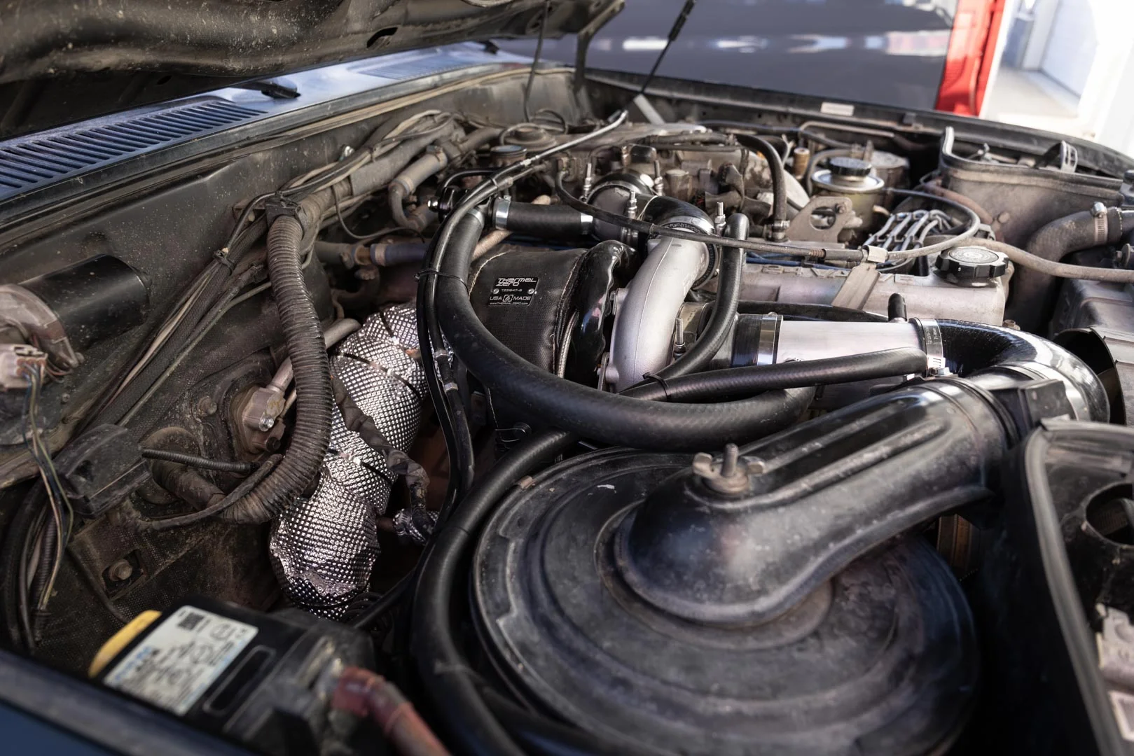

What comes in the box! I am going to list this from intake to exhaust by individual section.
  • Intake pre compressor using factory airbox - Silicone 180 coupler, an aluminum intake pipe with 3 ports on it (one for recirculation valve dump and then 2 ports for crankcase ventilation (one for stock hose, one for using our catch can system which is coming soon), silicone reducer, 4x T Bolt clamps, bracket to clock the MAF (intake piping works with dual batteries
  • Turbo - Pre clocked Pulsar 6682, Internally gated with .5 Bar (7.25 lb spring)
  • Intake Piping post compressor - Silicone 90, Silicone reducer, Cast aluminum 90 with port welded on for recirculating BOV and port pre tapped for wastegate reference, 4x Tbolt clamps, and silicone cap for throttle body port no longer used for crankcase venting.
  • Spark Plugs - 6x Denso PK20R8 3127
  • Recirculating Valve - Turbosmart Recirculation 25mm valve, 1" reinforced high temp silicone hose for plumbing to pre compressor, 4 tbolt clamps, vacuum source tee that also works well as boost reference spot for interior gauge, 3/16 barb aluminum 90, 3/16 silicone vacuum hose to connect vacuum source tee to turbosmart valve
  • Water Lines - 2x premade AN 6 lines, AN 6 water fittings for turbo, AN 6 fittings to connect water lines to the two 8mm water bypass lines at the front of the motor
  • Oil Supply Line - A Tee to connect to where the factory oil pressure sending unit is, adapter to AN 4, premade AN 4 Line, AN 4 Oil restrictor
  • Oil Return line- AN 10 Turbo Drain flange, AN10 45 Adapter to clear the JPipe and orient the return properly, premade AN10 Return line, AN 10 Flange with hardware that mates to upper oil pan, template for where to drill and tap for oil return into upper pan.

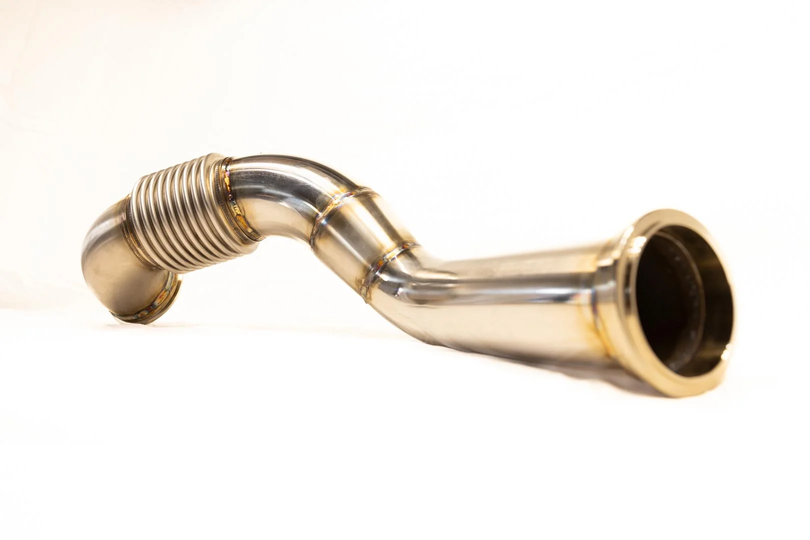

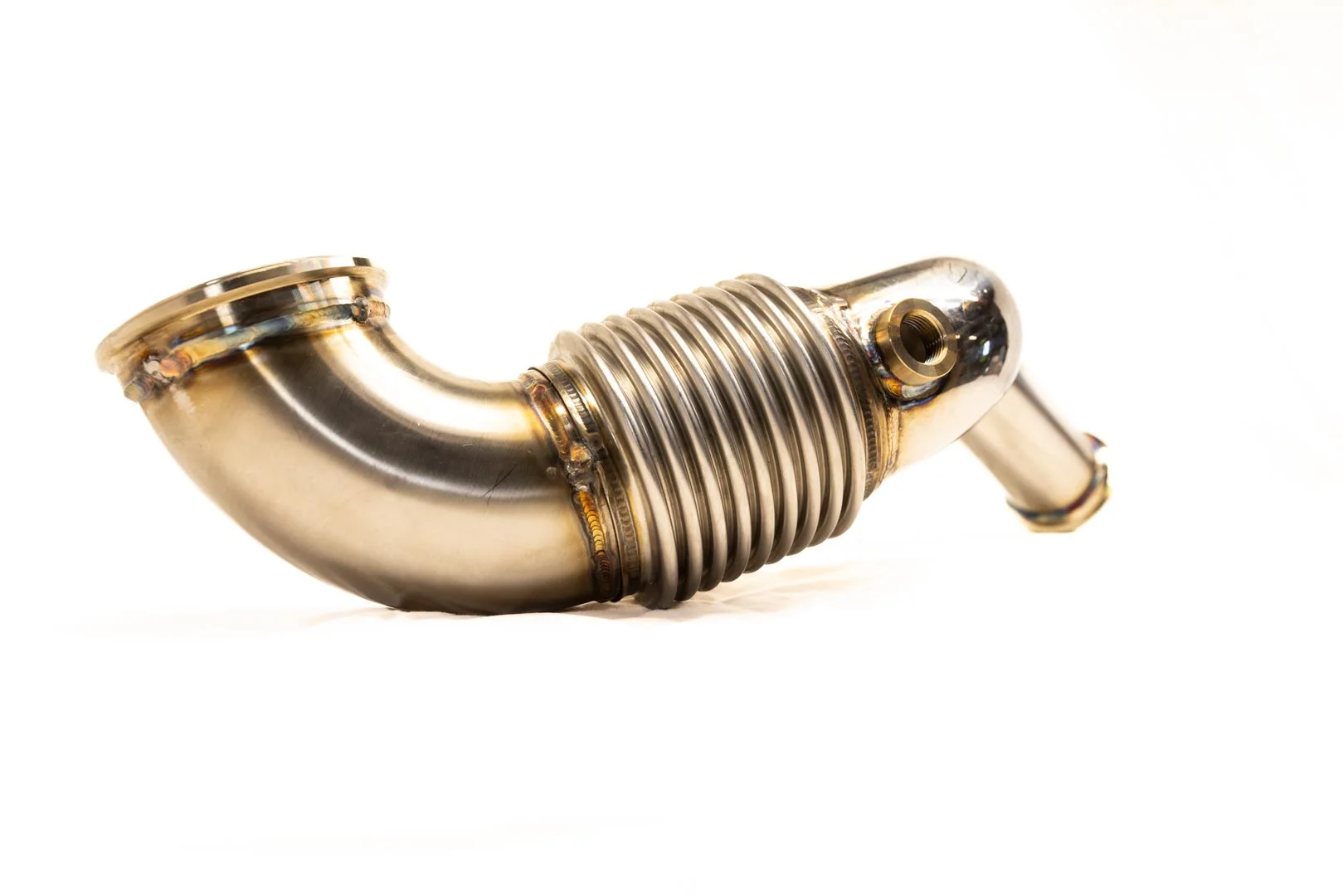

  • Exhaust Pre Turbine housing - JPipe with all new hardware and gaskets to connect to factory manifolds, hardware to mount turbo, stainless steel bracket to stabilize J Pipe with hardware.
  • Exhaust Post Turbine Housing - 5 bolt flange to 3" v band adapter with stainless hardware with gasket, downpipe with m18x1.5 bung for AFR gauge, 1x extra v band and some exhaust pipe for the diyer to connect to factory exhaust or take it to the exhaust shop
  • Heat management - Turbo beanie, 12" x 48" Heatshield Products 1/2" heatshield with template and stainless zip ties to wrap downpipe and AC line

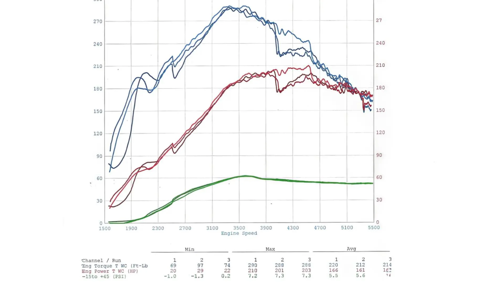

We've tried extremely hard to make it as comprehensive as possible and have been heavily testing it. The test truck has been driven from ~1,100 feet to ~12,200 feet, has had multiple days being driven for 10+ hours at a time, been up to the Eisenhower tunnel up I70 multiple times from Denver (those who have done it know the struggle in an 80, not anymore), and we are nearing 9K miles on the set up in the test truck. During our testing we've had had a "control" truck also to have a baseline. The control truck is a 1995 80 series 1FZ-FE/a343 with 4:88's 35's and similarly laden with gear as the turbo truck. To reiterate the turbo truck is a 1997 LX450 with 1fzfe/a343 4:10's and 35's. Both trucks have similar mileage on their Robbie rebuilt 1FZFE's and both have over 300K on the transmissions. They are very comparable. Even with the 4:88's the non turbo control truck is not nearly as enjoyable to drive or maintains speed as easily. On highway 80 (Wyoming) with cruise control set at 75 heading from Denver to Flaming Gorge reservoir (800 mile round trip) through Wyoming the control truck would constantly downshift and have to maintain its speed on rolling hills and still fall in speed while the turbo truck would build a few psi and maintain without downshifting. We've had both truck go to the Eisenhower at the same time and the Turbo truck leaves the control truck behind.
Land Cruisers are not meant to be rocket ships and the Turbo truck is still not one but the modernization is very enjoyable and makes going to the mountains/cruising highways much more enjoyable which was the goal with this kit.

So there's no intercooling, and it looks like it would be difficult to add an intercooler.
Nice looking kit! No intercooler needed for .5 bar of boost...just enough punch for that extra power band. Intercooler on this would be more effort than it's worth in my opinion and past experience with other boosted vehicles. Would be a perfect candidate for Meth injection for those that want a little more boost or security of running too hot on the charge or lean on the AFR's.

Intercooler is in the works. We've scanned the front end of Rosie (our current 80 build) and are hoping to have it wrapped up by summer. With the low boost pressure it really isn't all that necessary but I know people will start pushing the boundaries more and more with these kits.

I'm only running 5.25lbs of boost with my turbo on the stock fuel map. The truck is 100x better on overall drivability at my home area 6500-10000' elevation range. 99% people won't need to go beyond the stock map to be happy. If you want more details on my build its in the sig line link.

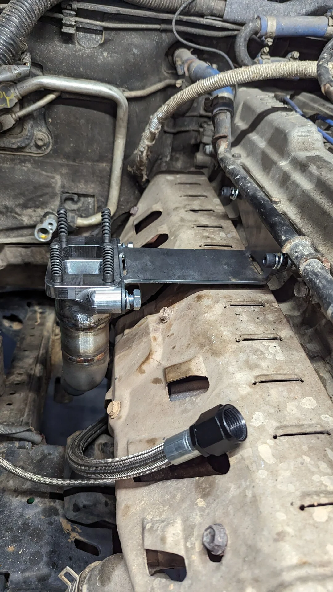

Great job, really like that j-pipe with the bolt on support and cnc flange looks good!
