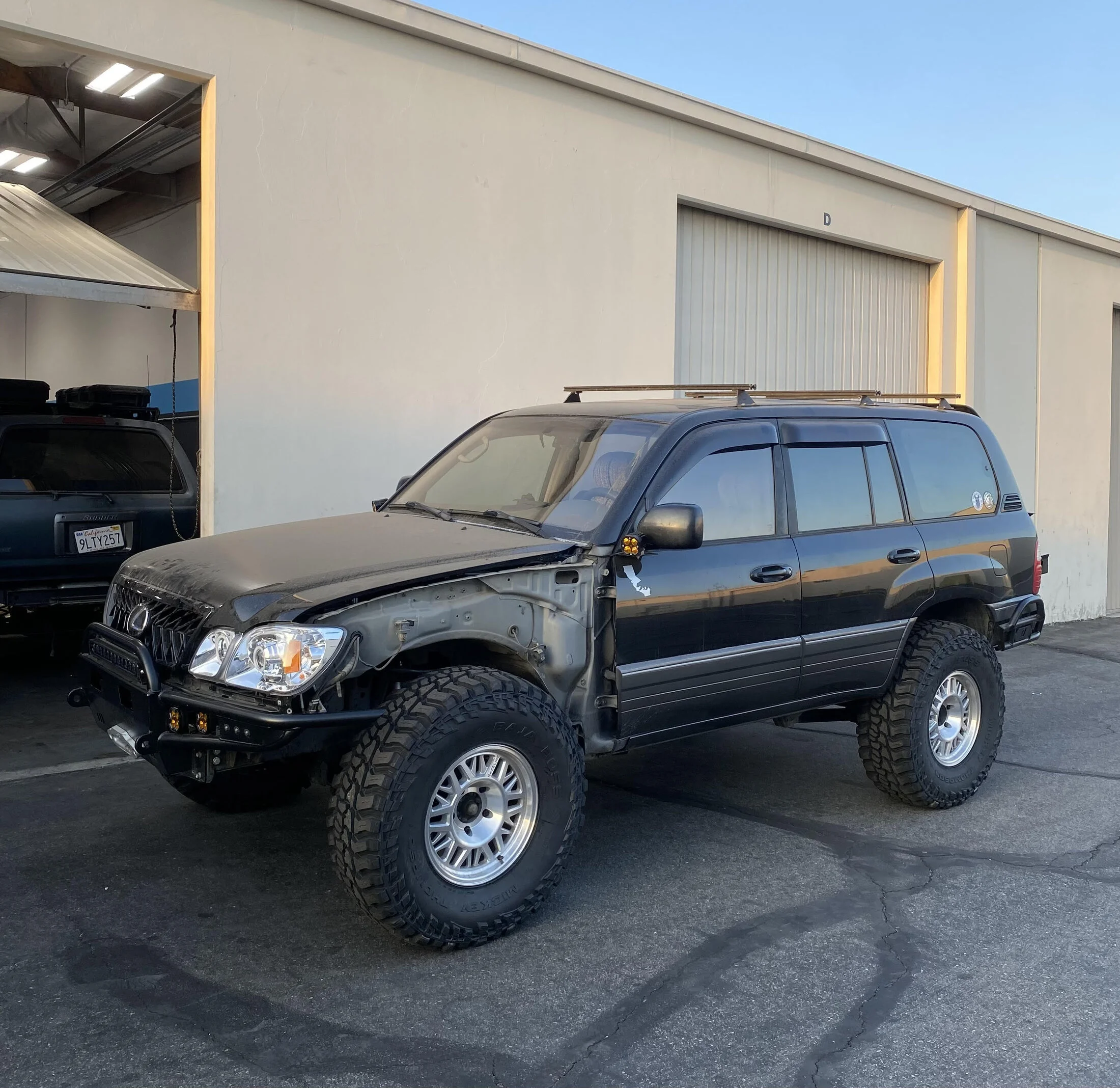

That's part of the reason I decided to go a little more spicy with the 100 build. No body lift. A whole lot of cutting, maybe not a complete tub job, extend those bump stops a little bit, should be good to go. I hope. Although I probably need to address brakes and wheel bearings once this is all done, preventatively.
I'll snap some pics and dump them in here once done.

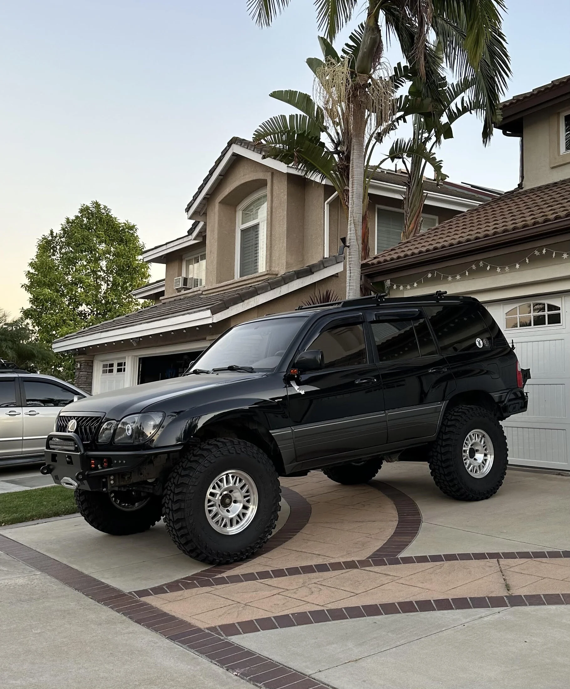

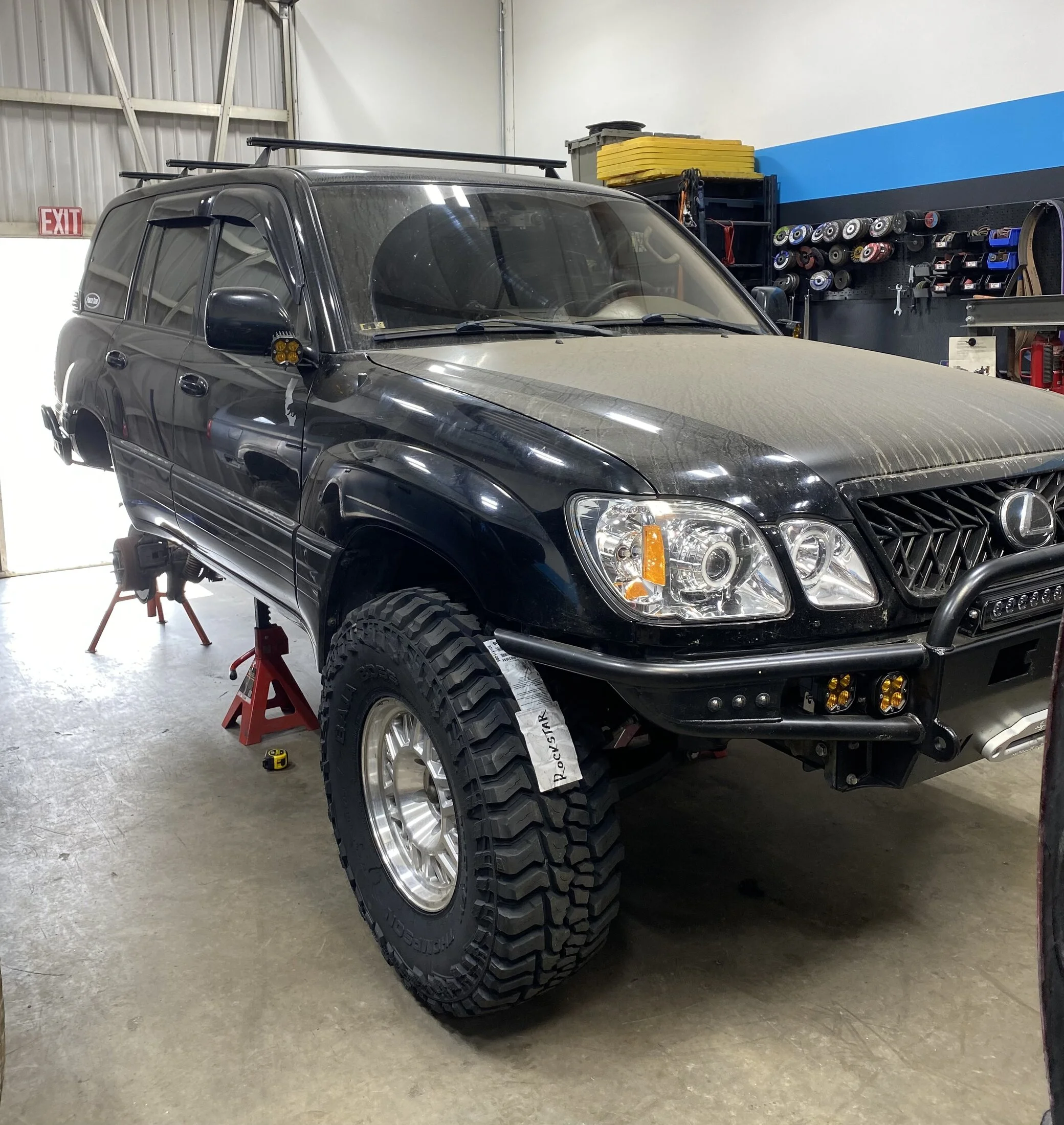

New tires. Fitment in progress.
Looks incredible!
How are the 4.88s with 37s ?
Feels pretty decent, but ask me again once I start going up steep grades! It doesn't feel like it's struggling too bad, I'll have to re-assess with some more time. It definitely doesn't feel like I'm driving on 37" at the moment.

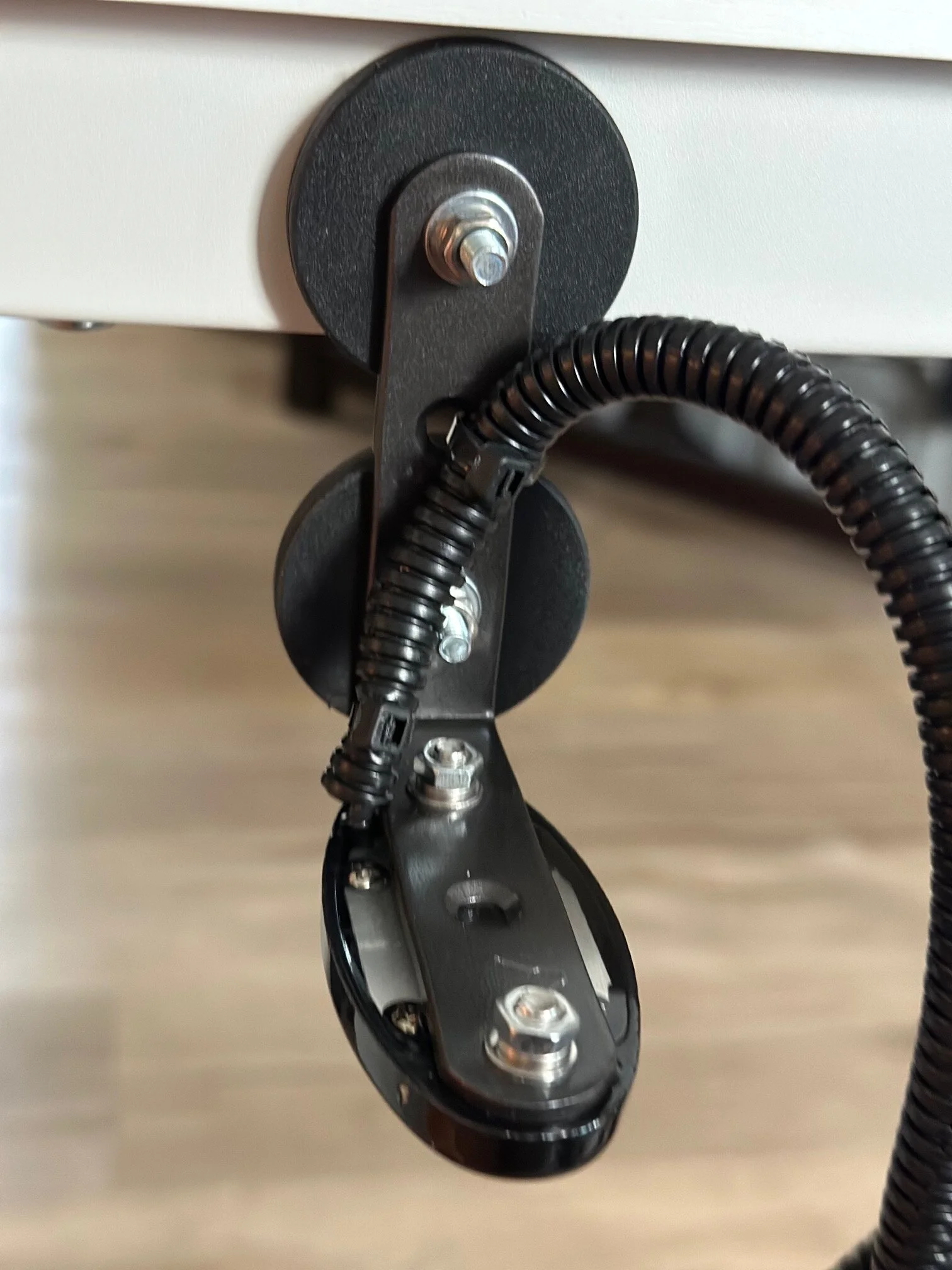

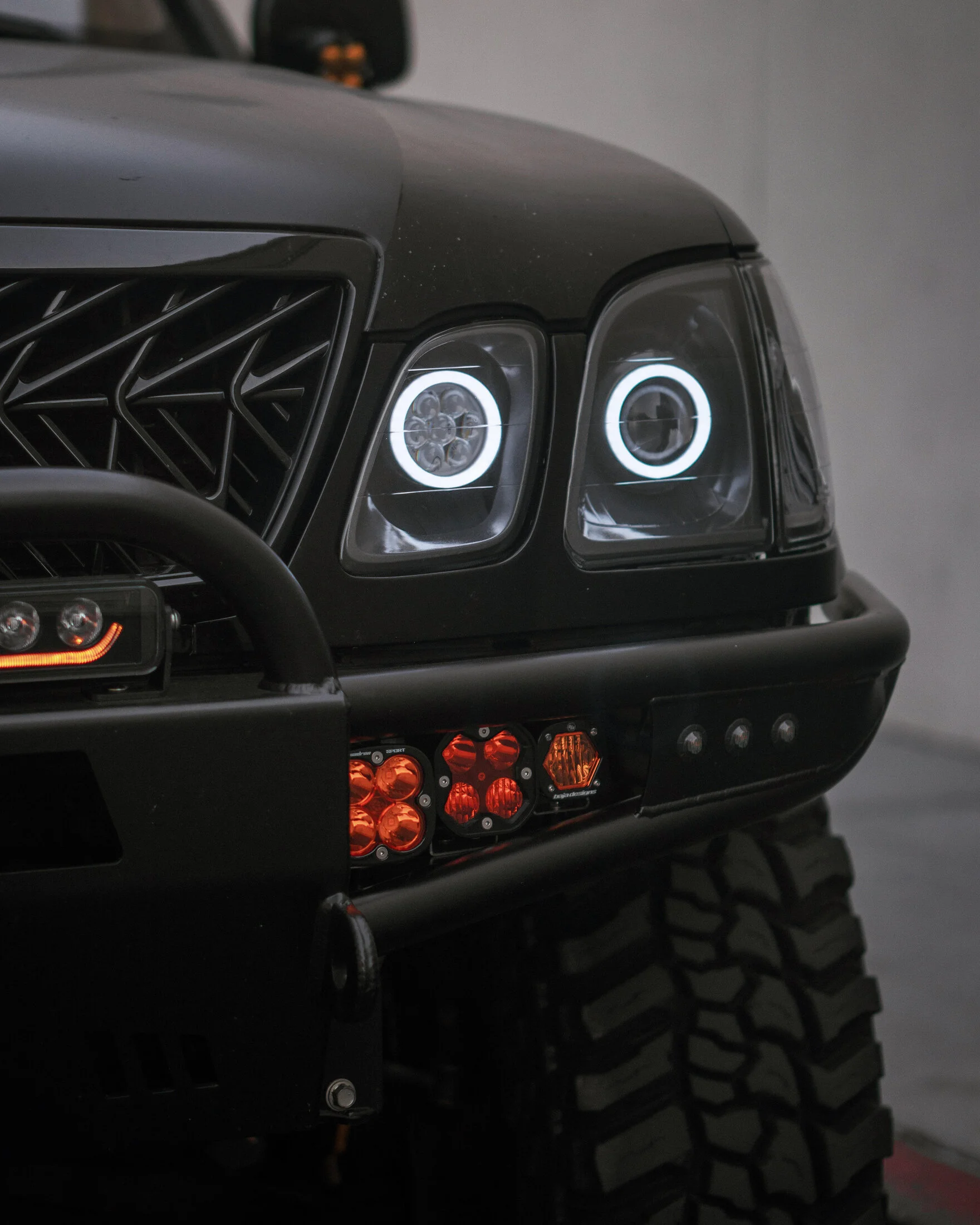

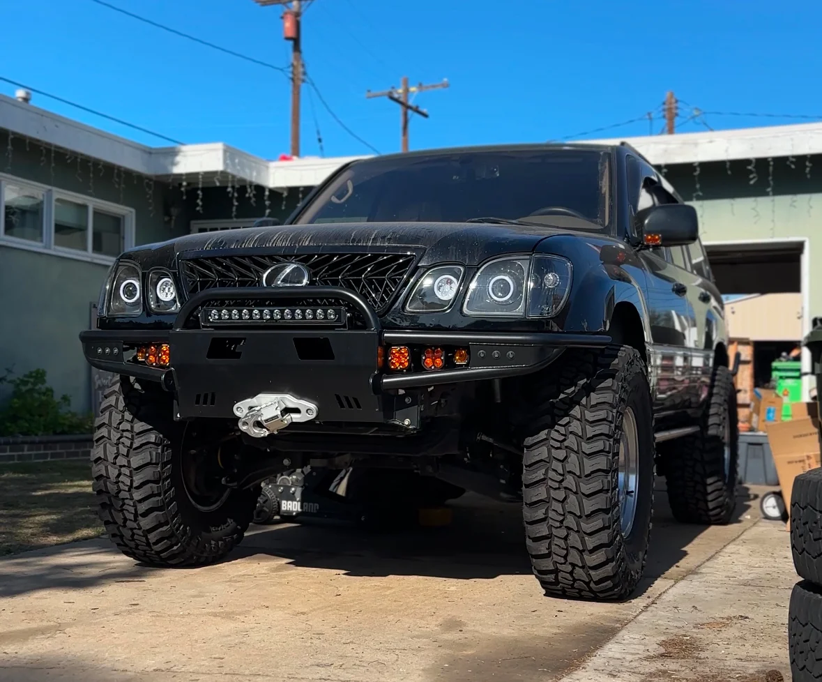

Reutilized my courtesy lights, which have been unplugged and taped up for dunno, a year? Amazon L brackets and rock lights (red, for bugs). Used strong magnets, so I could relocate once I get my sliders made and put back on. Kinda nice it comes on when you unlock the 100 with the keyfob. Also, new Teqcustoms headlights and roofrack.

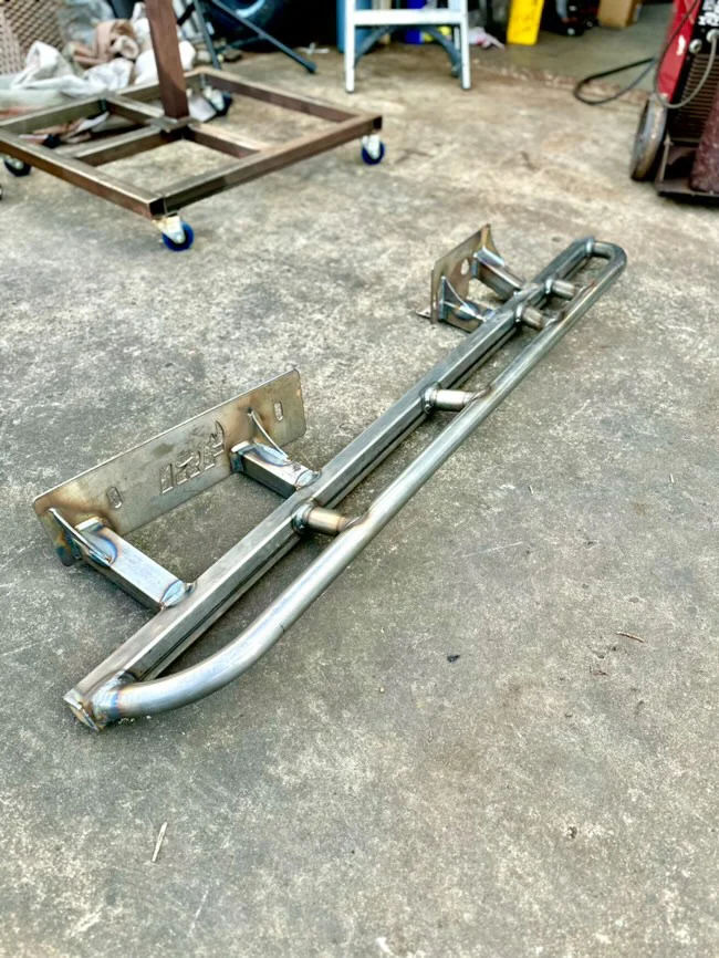

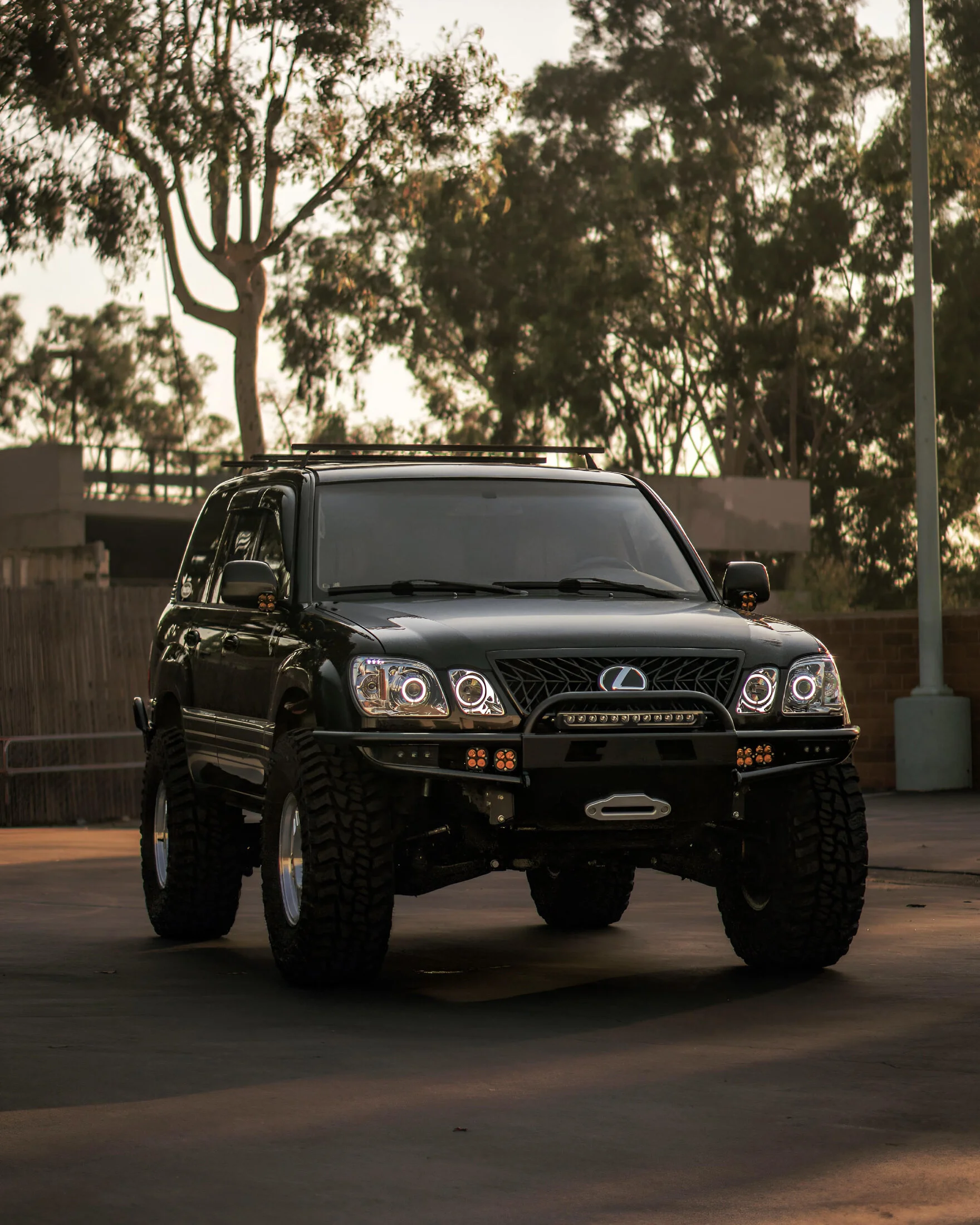

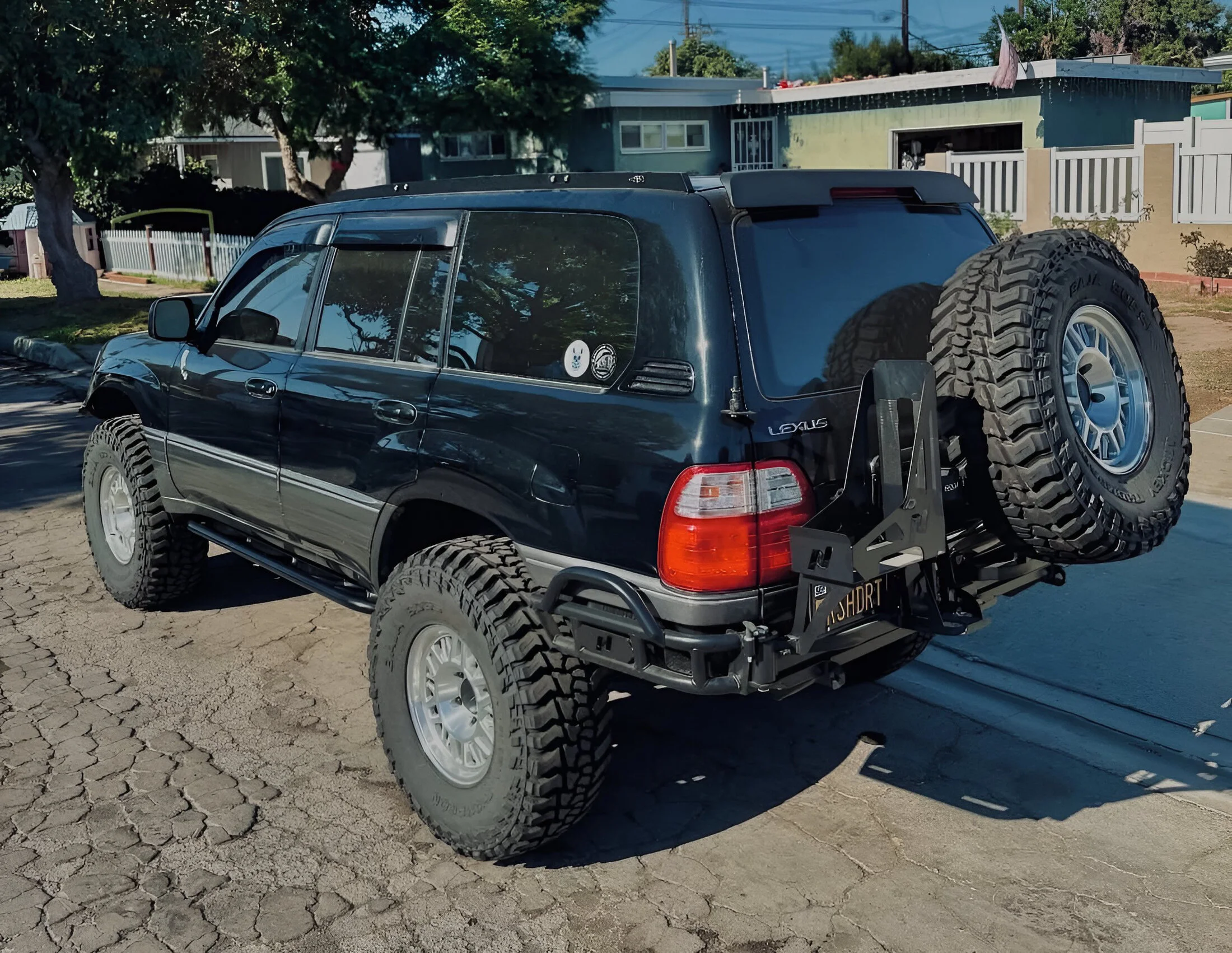

Since I bumped up tire sizes, got new sliders to accommodate this. These are mounted-to-frame custom sliders made by Iron Ryno Fabrication (he works out of his garage in Lomita, CA). More angle, no kickout, tighter to the body, and of course shortened from my previous sliders (also made by Iron Ryno).

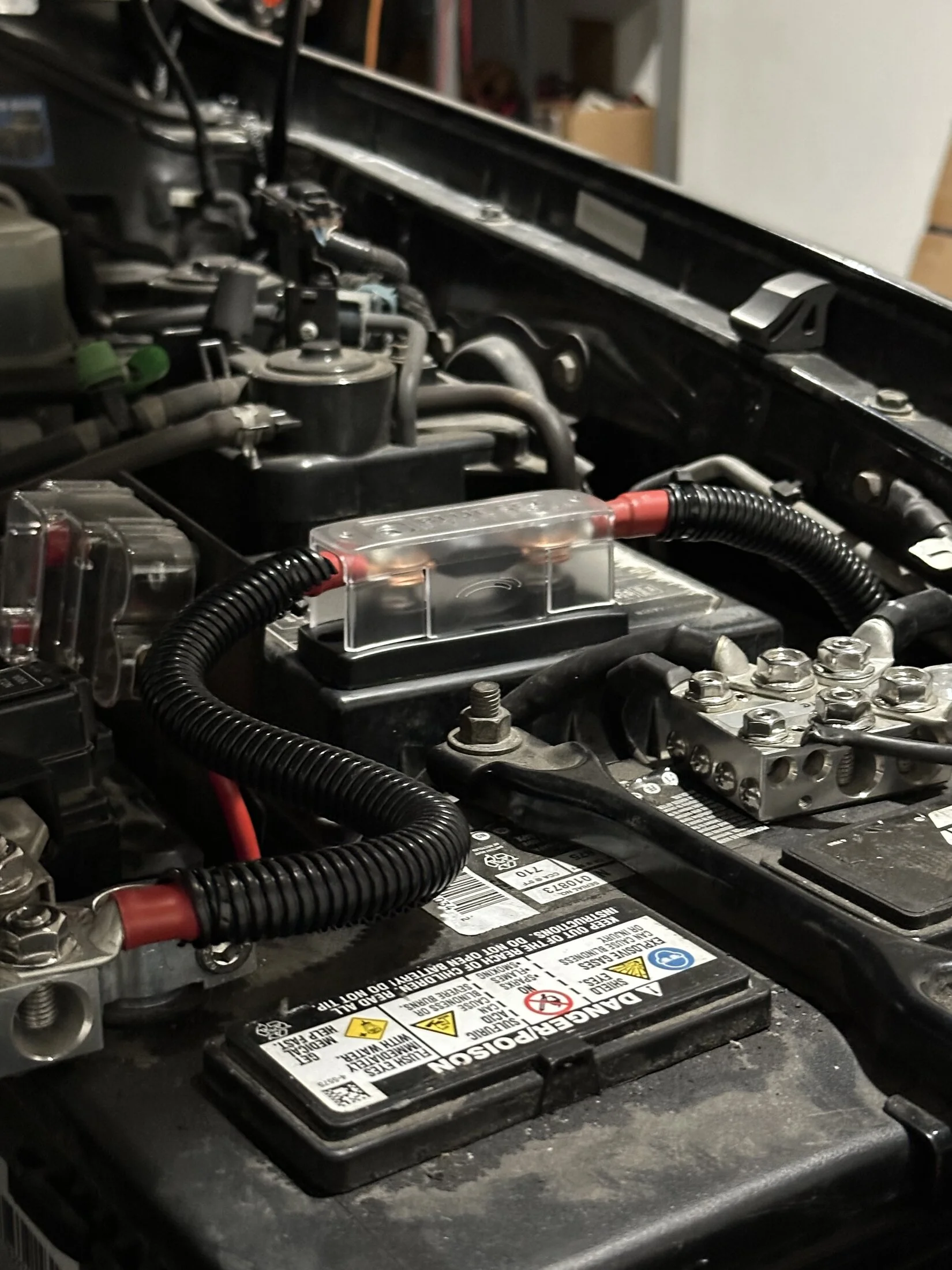

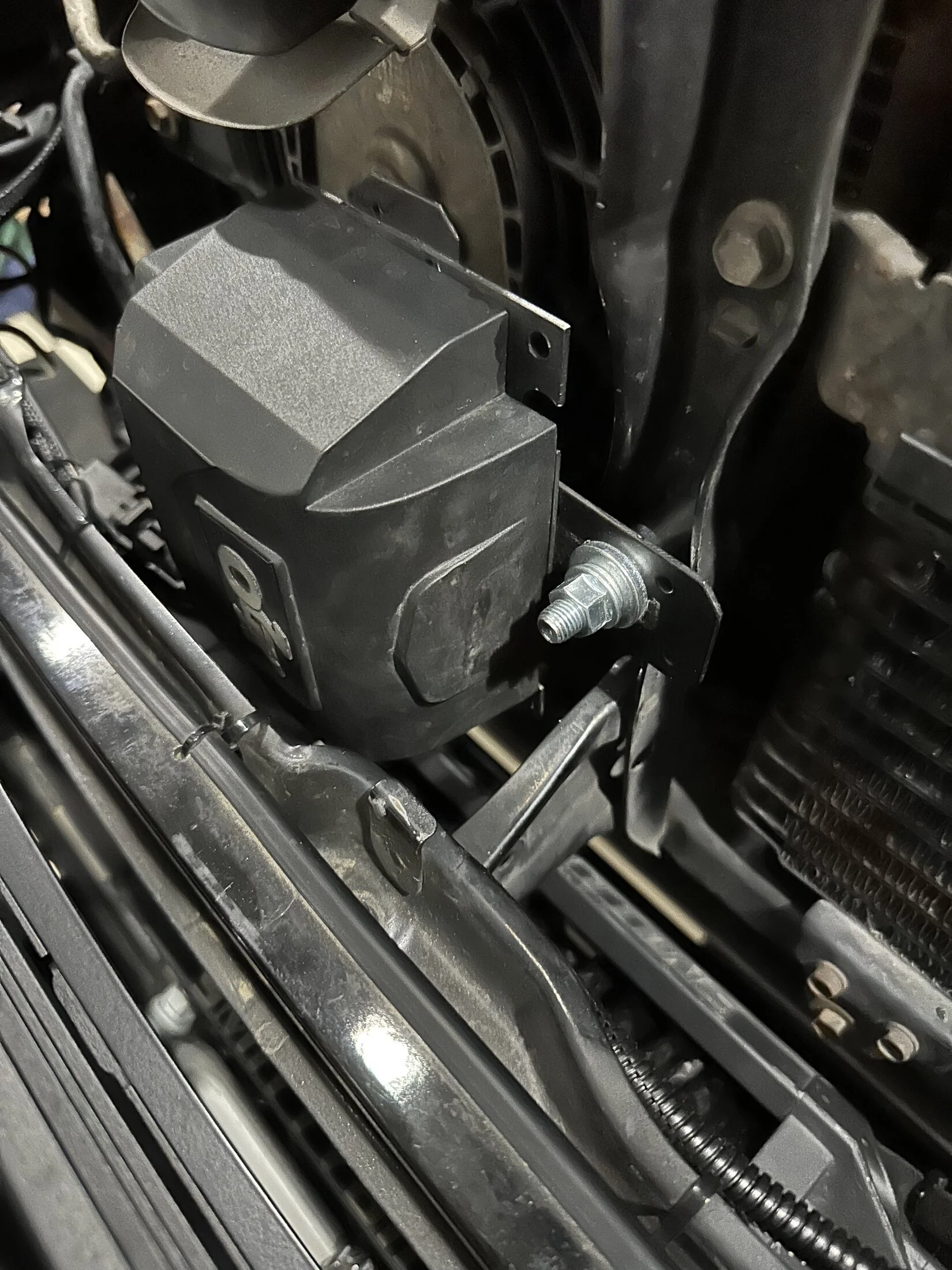

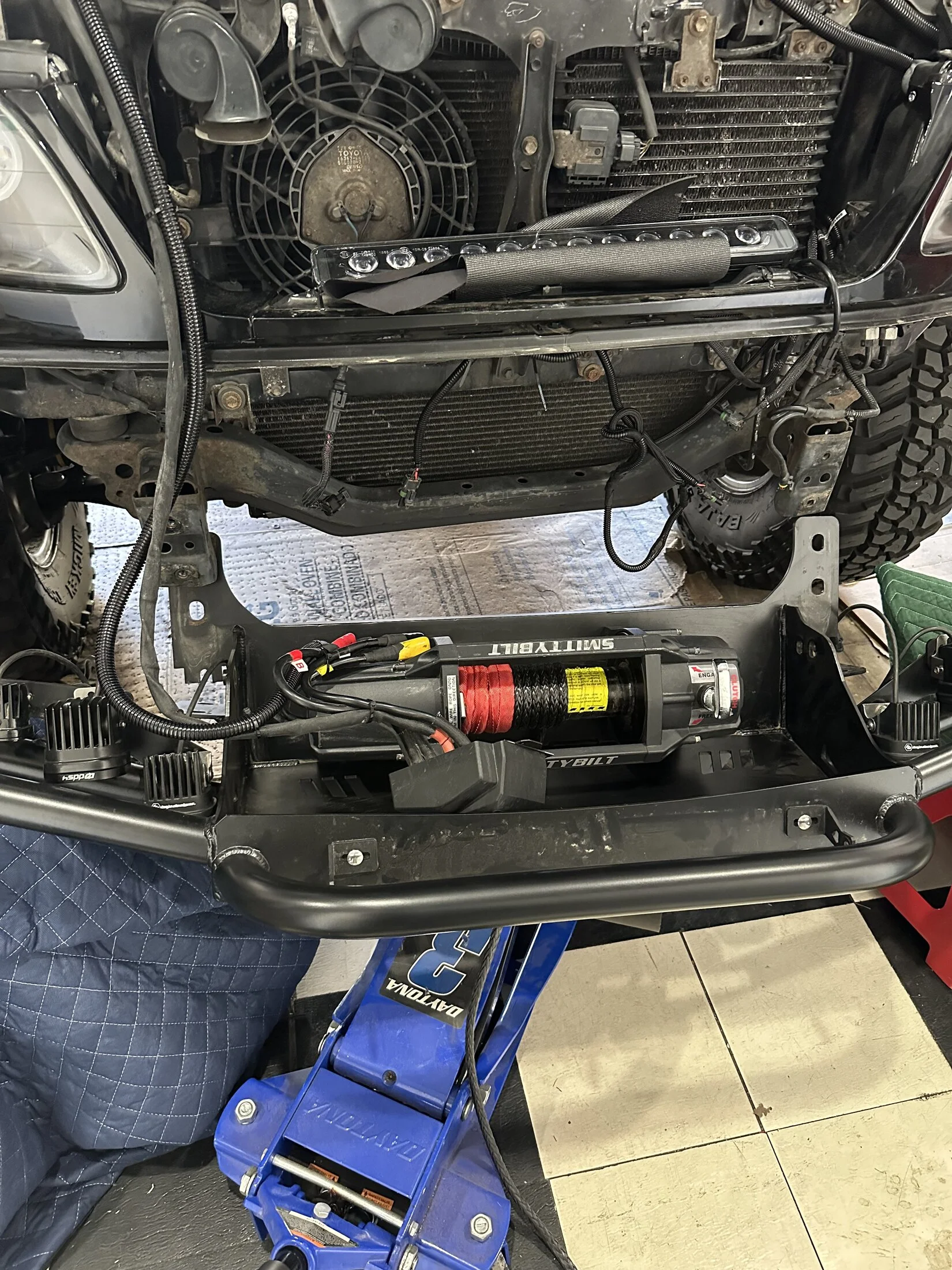

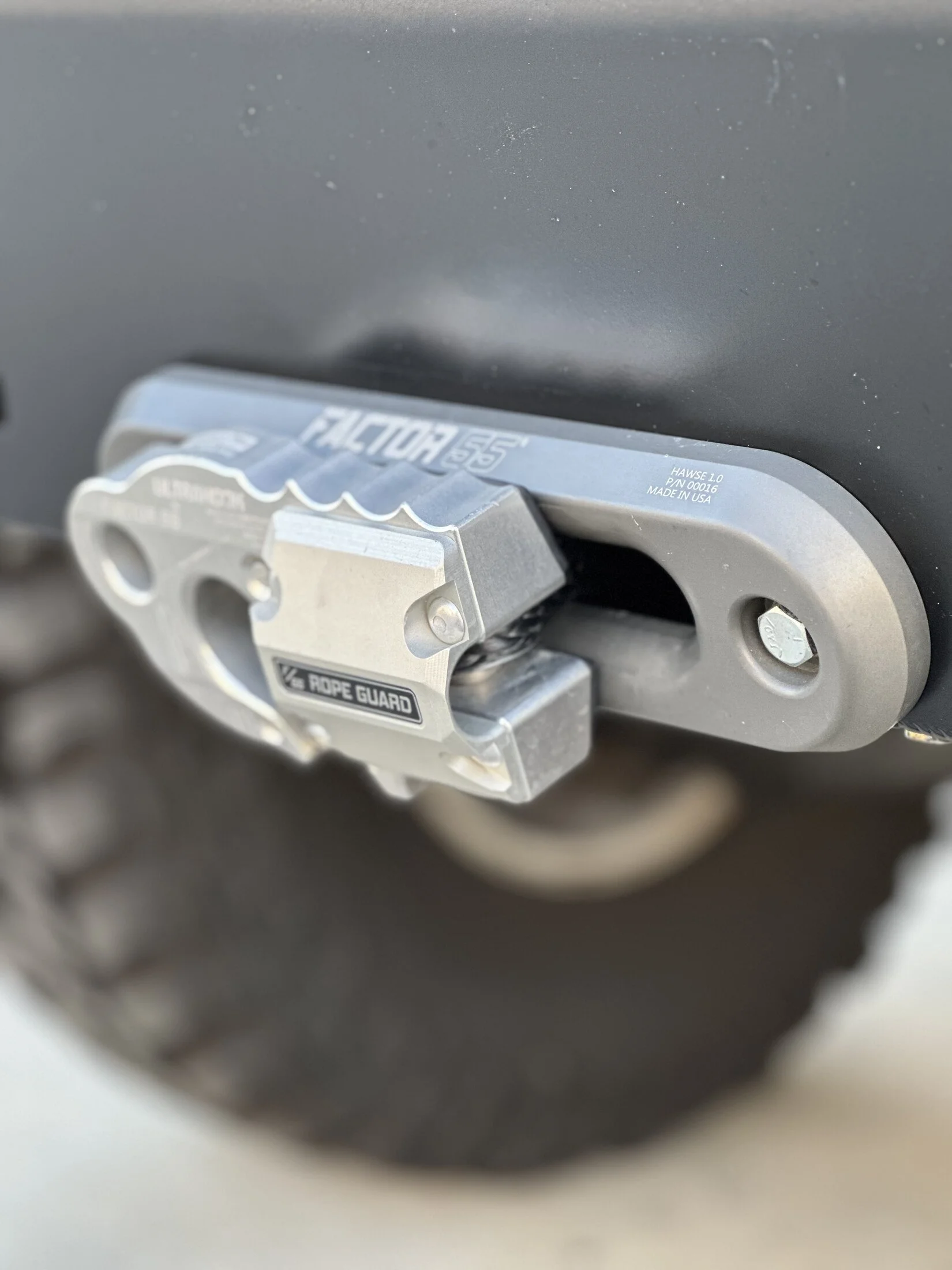

Installed my Smittybilt 10k winch from my old truck, along with Factor 55 fairlead and hook. Fused the winch with a 300a ANL fuse. Also have a quick disconnect, because I'm a little paranoid about my 100 going up in flames. It only gets connected when I'll be needing it on trail day. Relocated the control box.

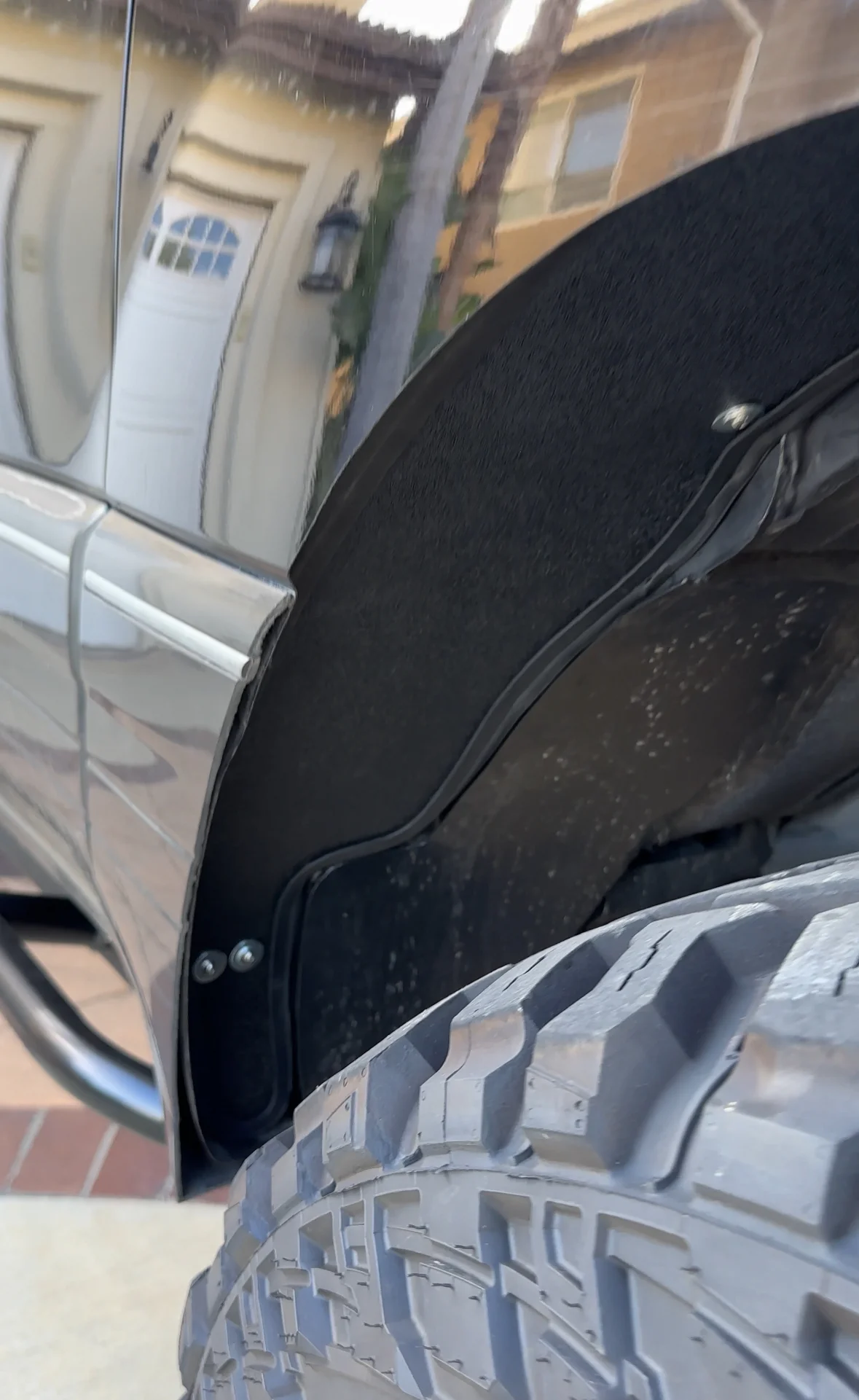

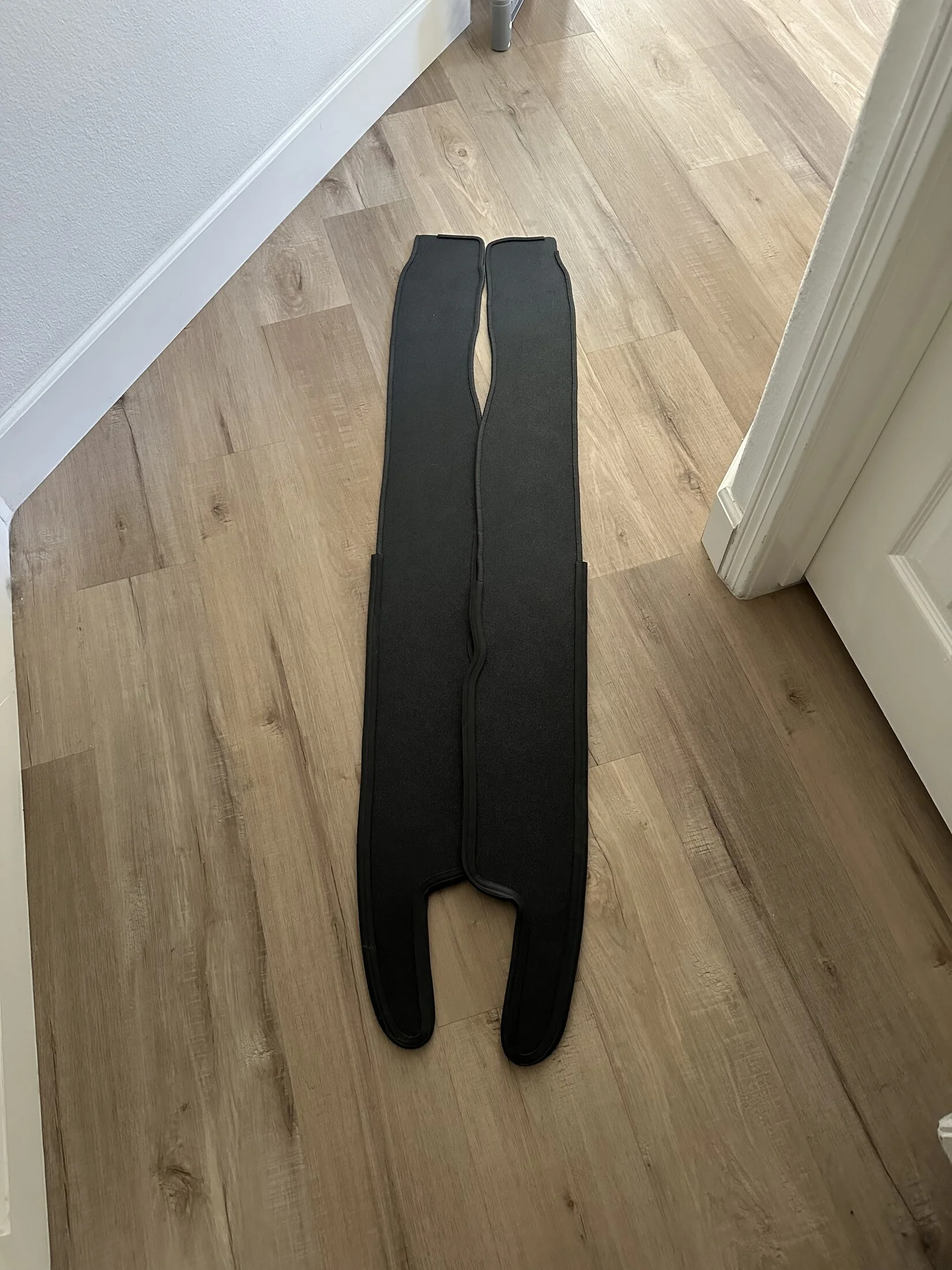

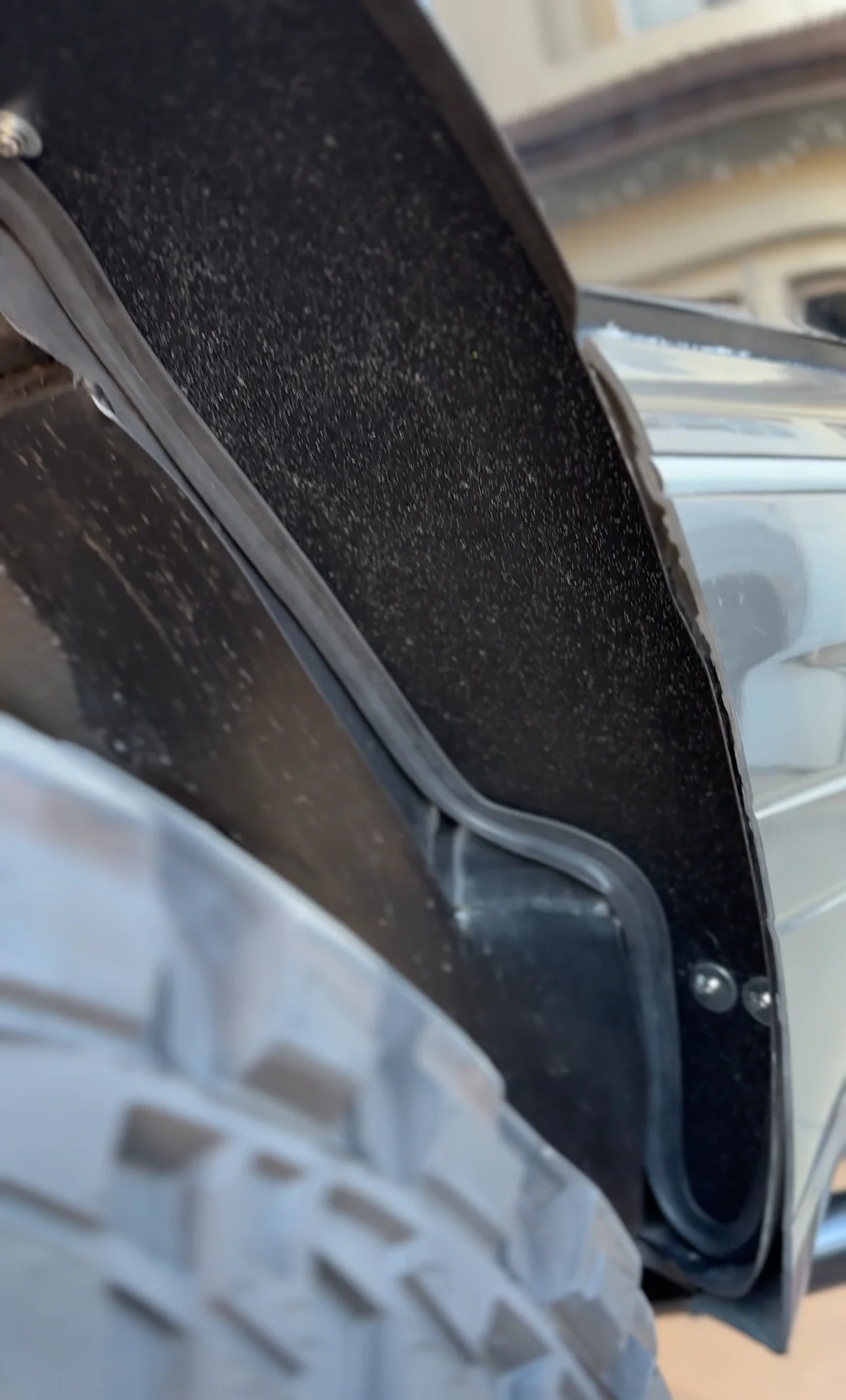

Made my own fender liners using 1/16 abs, edge trim with top bulb, regular edge trim, L brackets, 45-degree brackets, and whole bunch of nutserts. Due to the fender trim and the tubbing, OEM liners ripped out, I needed something to protect my intake.
