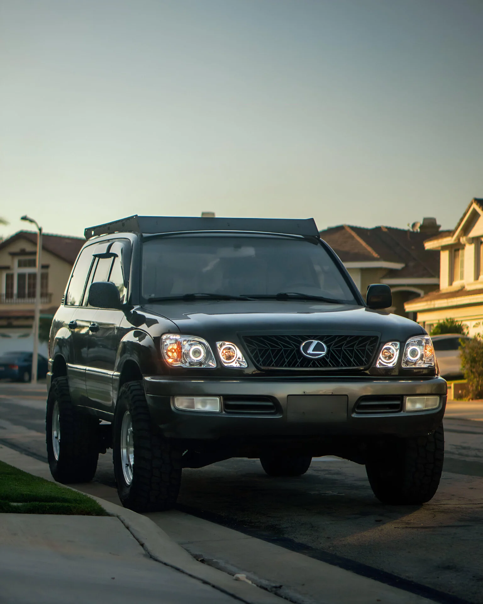

Picked up an Black 2002 LX470 in May 2023 w/ 235k on the odo, bone stock (aside from a AHC-delete), from a single owner that passed the vehicle down to his son/daughter in Newport Beach, CA.
Here's how it looked upon day of purchase:

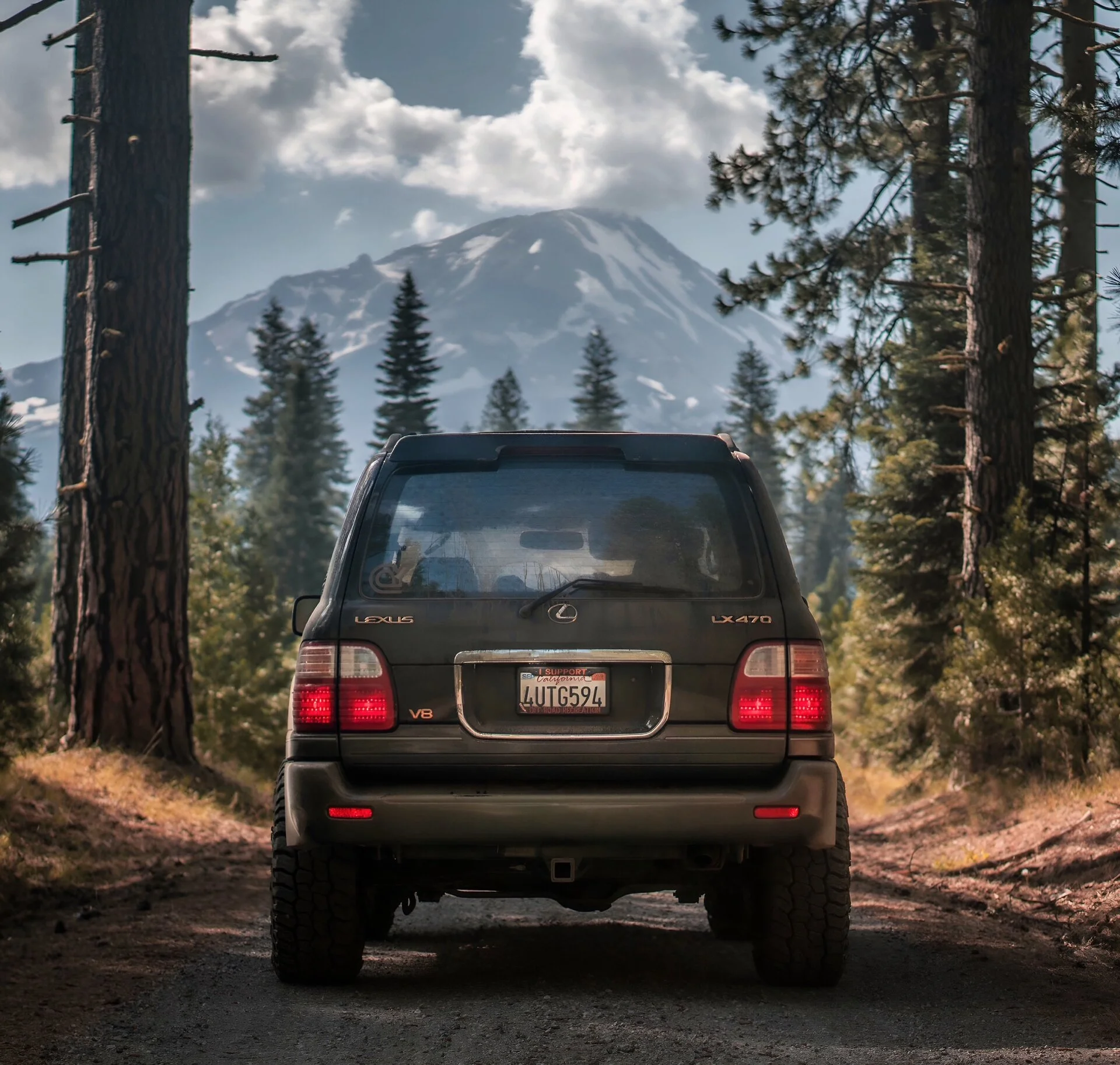

As it sits now (March '25):

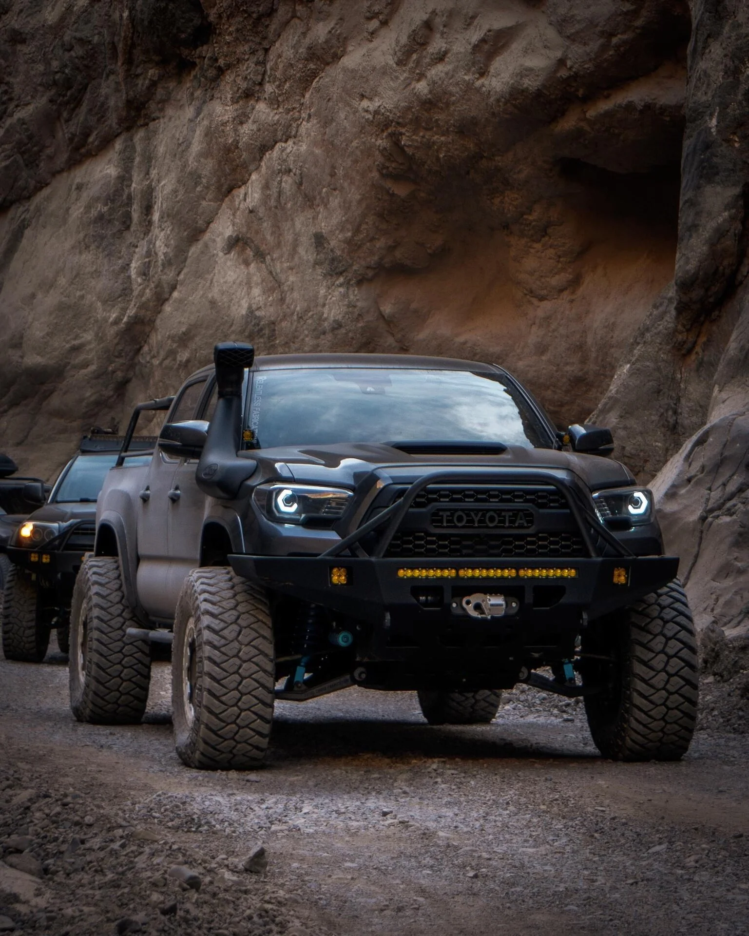

...and this is what I sold prior to the LX:
Here's what went into that: Choyota's 2018 MGM LT+2 TRD *Locked* Sport 4x4 Build - https://www.tacomaworld.com/threads/choyotas-2018-mgm-lt-2-trd-locked-sport-4x4-build.703752/

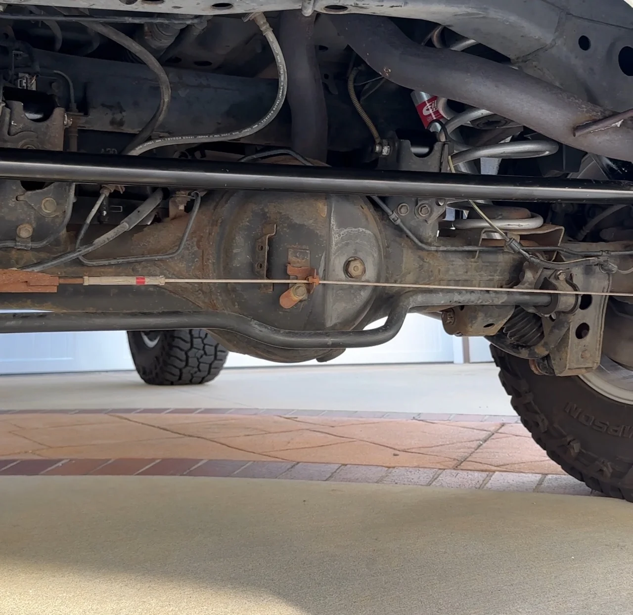

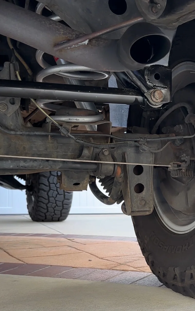

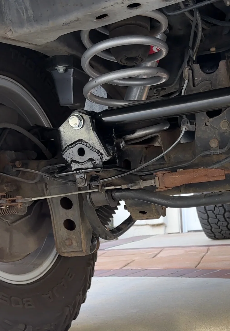

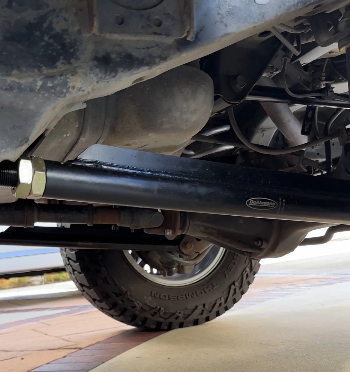

New Dobinsons lower links, panhard bar from Japan swapped in (thanks Ebay), Mevotech upper links from Rock Auto, the eimkeith PCK (Panhard Correction) welded in, and PS hose swapped. Had a leak.
Panhard Bar is now completely horizontal. Love it.
How did you panhard bar look after the axel side only was installed? I just did the axel side and only slightly out of level and it drives much better.
I haven't done the frame side yet out of fear it will make it slightly unlevel the other way.
I haven't seen the angle with just one side, I took it to TJ Auto and Tommy welded in the PCK. Right now, it's basically dead on horizontal. That, along with the new arms and panhard bar with fresh bushings, the rear end rides 10x better.

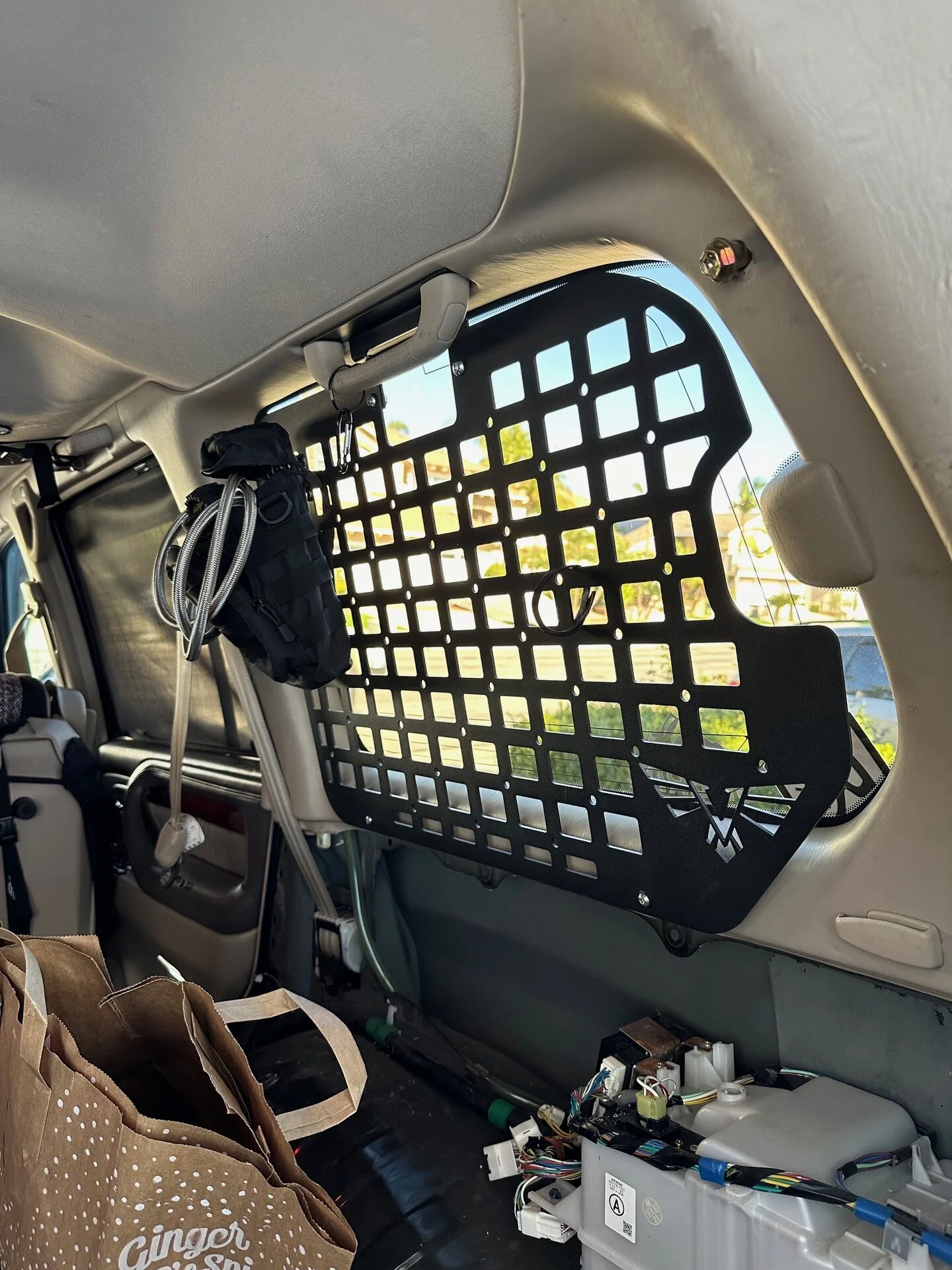

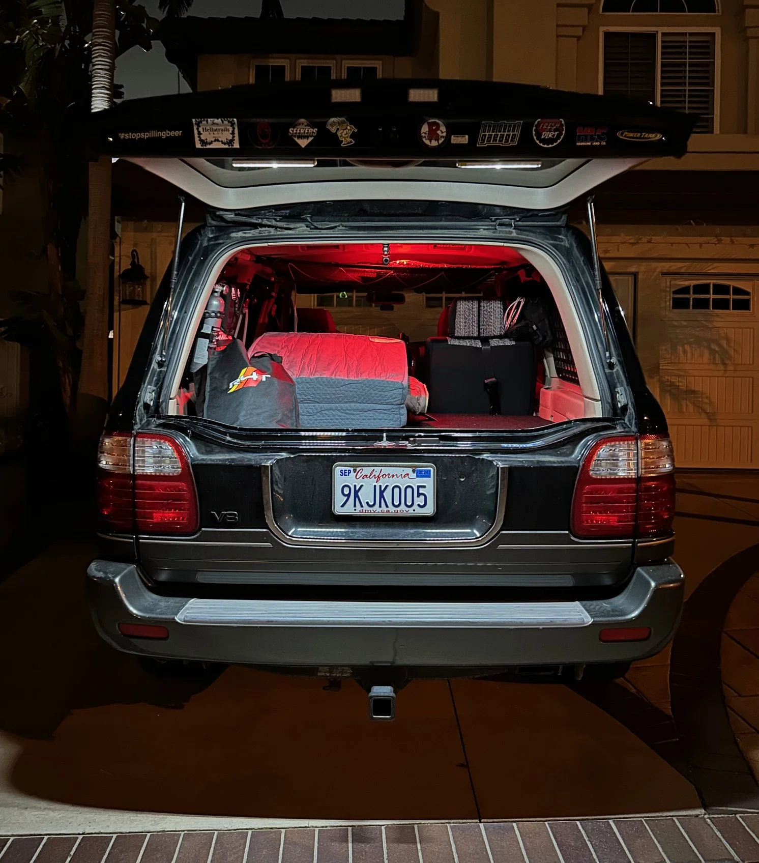

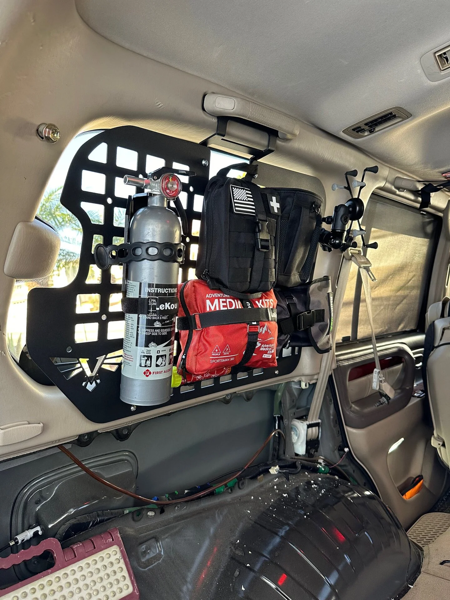

Installed Victory4x4 molle panels. When I pulled the panel off, the original owner had a tshirt stuffed between the panel and the subwoofer. The foam surround disintegrated and fragments were laying on the top of the wheel-well bump. Pulled off the 3rd row seatbelts. Due to the nature of the grab handle orientation and the brackets Victory4x4 provided, the driver side is a little bit higher than the passenger side. No biggie.

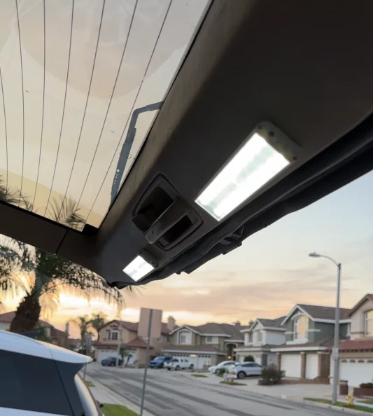

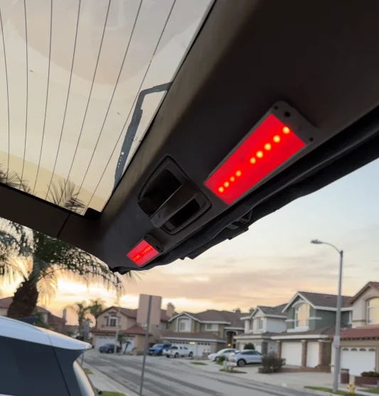

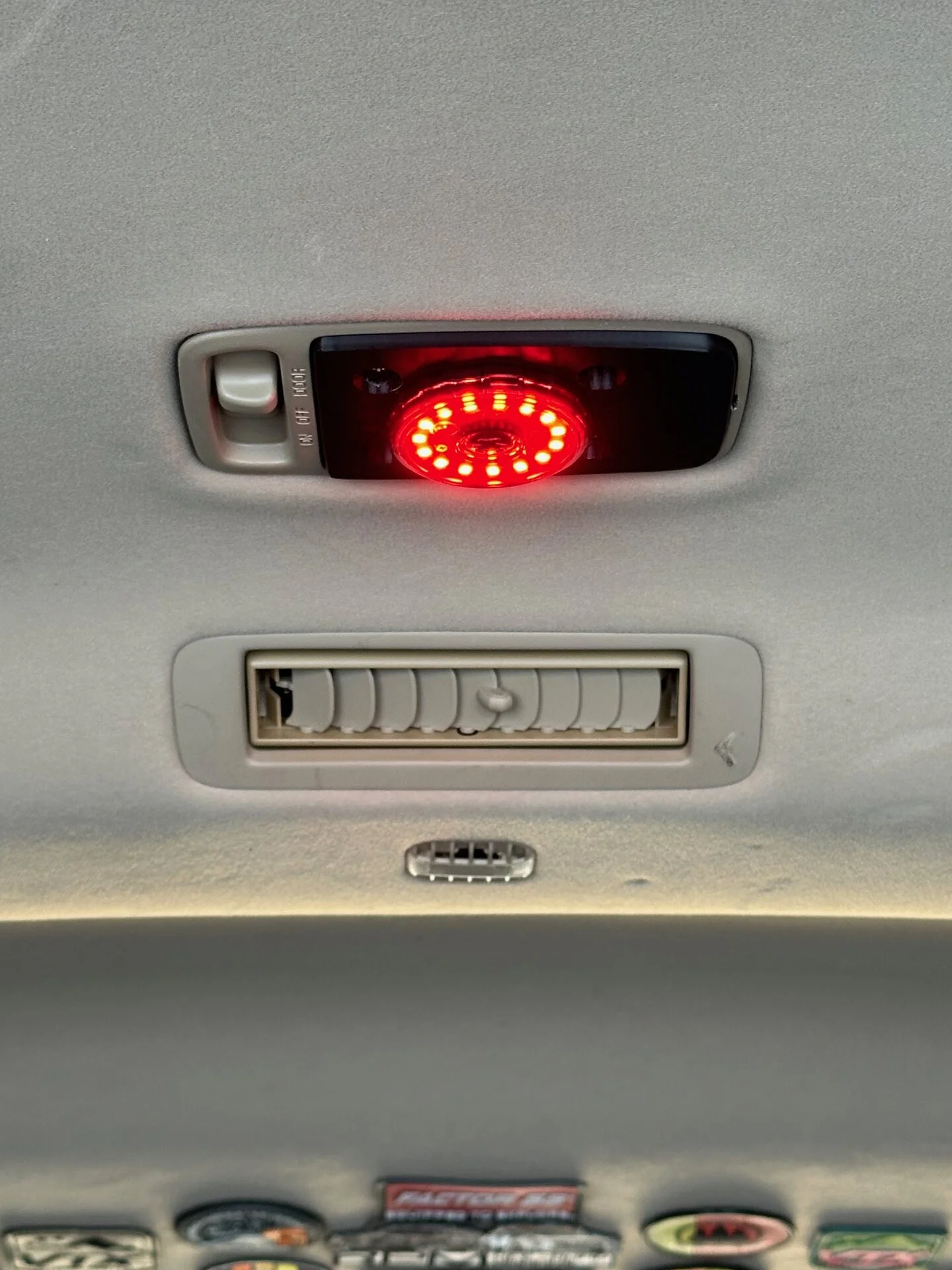

Inspired by many on this forum and Facebook groups, added rechargeable USB hatch lights from Amazon. It also has motion-sensors, but I don't see how it works too well because it hasn't so far. However, it does have a nifty remote and I can change colors between one of many.
Link:
SZOKLED Motion Sensor Under Cabinet Lights, 58-LED RGB Closet Lights Wireless, 1100mAh Rechargeable Under Cabinet Lighting Dimmable Night Lights for Kitchen,Bedroom,Wardrobe,Hallway,Stairs (2 Pcs)
https://www.amazon.com/dp/B0CLQX54FF?tag=ihco-20

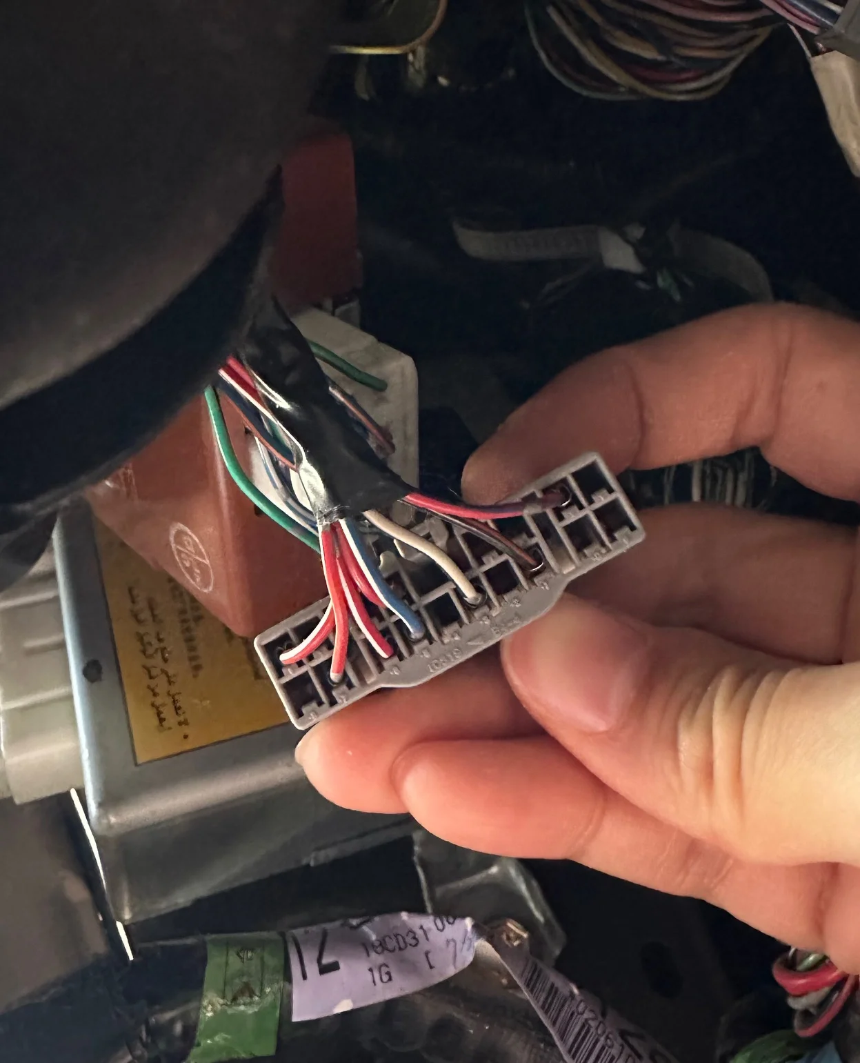

Also I disabled the DRLs by snipping the red-blue wire on the far right. Thanks to the ih8mud forum members who posted about this. Popped in LED hi-beam bulbs once the DRL umbilical cord was cut.

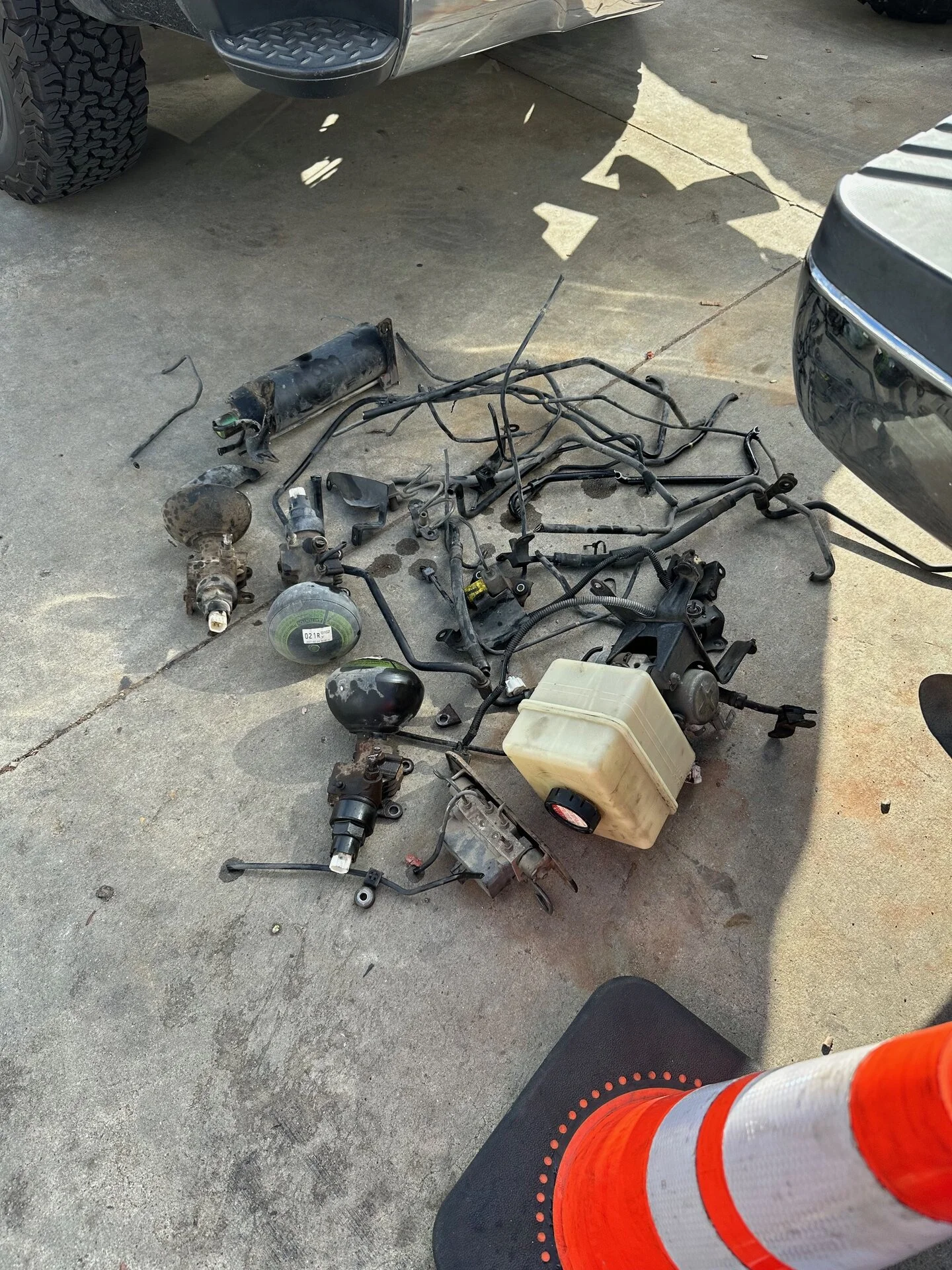

A little bit of the reason in pulling all the AHC stuff off the frame rails.
