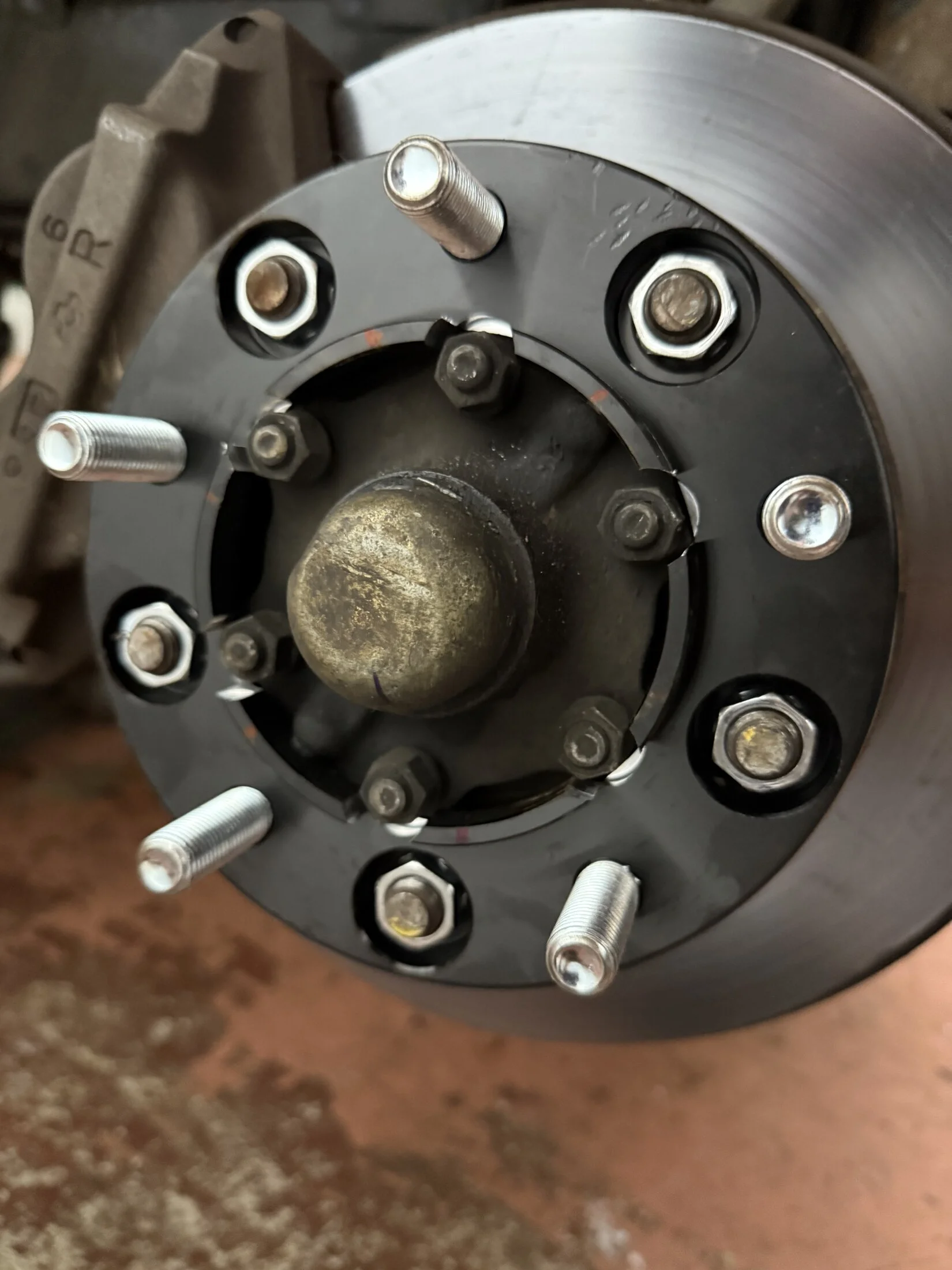

Got the wheels and tires on.
17x9 +58 Lodio Drive Cinq
285/70/17 Kenda Klever AT2
25mm spacers
I’m sure this is obvious to most on this forum, but I didn’t know that the front hub bolts foul the hub centric lip on most spacers. I didn’t want to go to a 1.5” spacer because that would have been too much poke. Ended up having a buddy machine some relief cuts, and it worked great. For anyone wondering, you actually can fit a 17x9 +58 with 285/70 tires in the front with no spacers. It's very close to rubbing on the control arm area but it doesn't.
I did break a front wheel stud removing the stock wheels. Getting the hub/rotor off and separated and pounding out the old stud on a 368k mile truck from Wisconsin was a bitch! Took me most of an afternoon. I had to drill the old stud out almost completely before it would come out.
