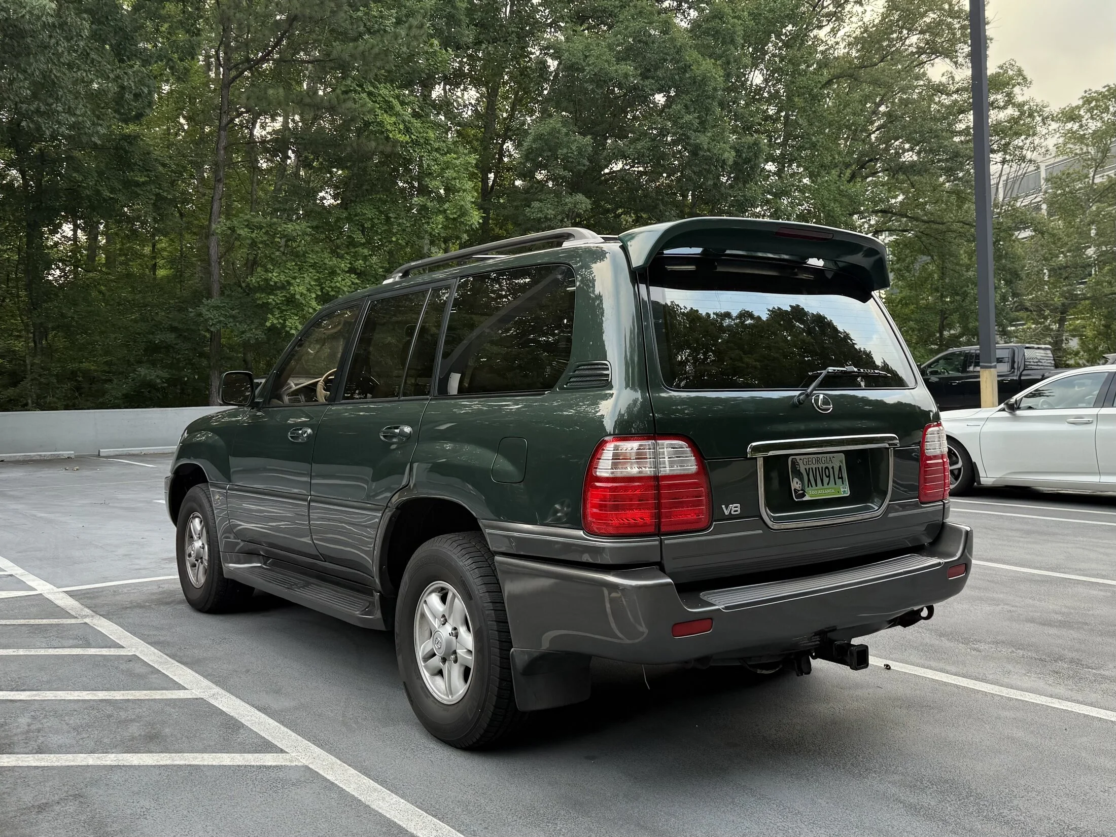

Test drove a few LX470s but ended up finding this on Craigslist of all places in Milwaukee (I'm in Atlanta). It was about half price compared to what I'd been looking at, and I'm trying to save for a down payment on a house and a wedding.... so a cheaper price of entry was great.
Texted the guy, sent him a deposit, flew north and drove it home. Left my house 3:30AM to go to the airport and got home at 9:30PM. The truck did great. I can't emphasize enough how solid and well-built it feels, even though it has close to 400k on it. I'm very glad I bought a high mileage rig with records - my thought was, why pay double or triple for a lower mile example if it'll last forever anyway lol.
Stats:

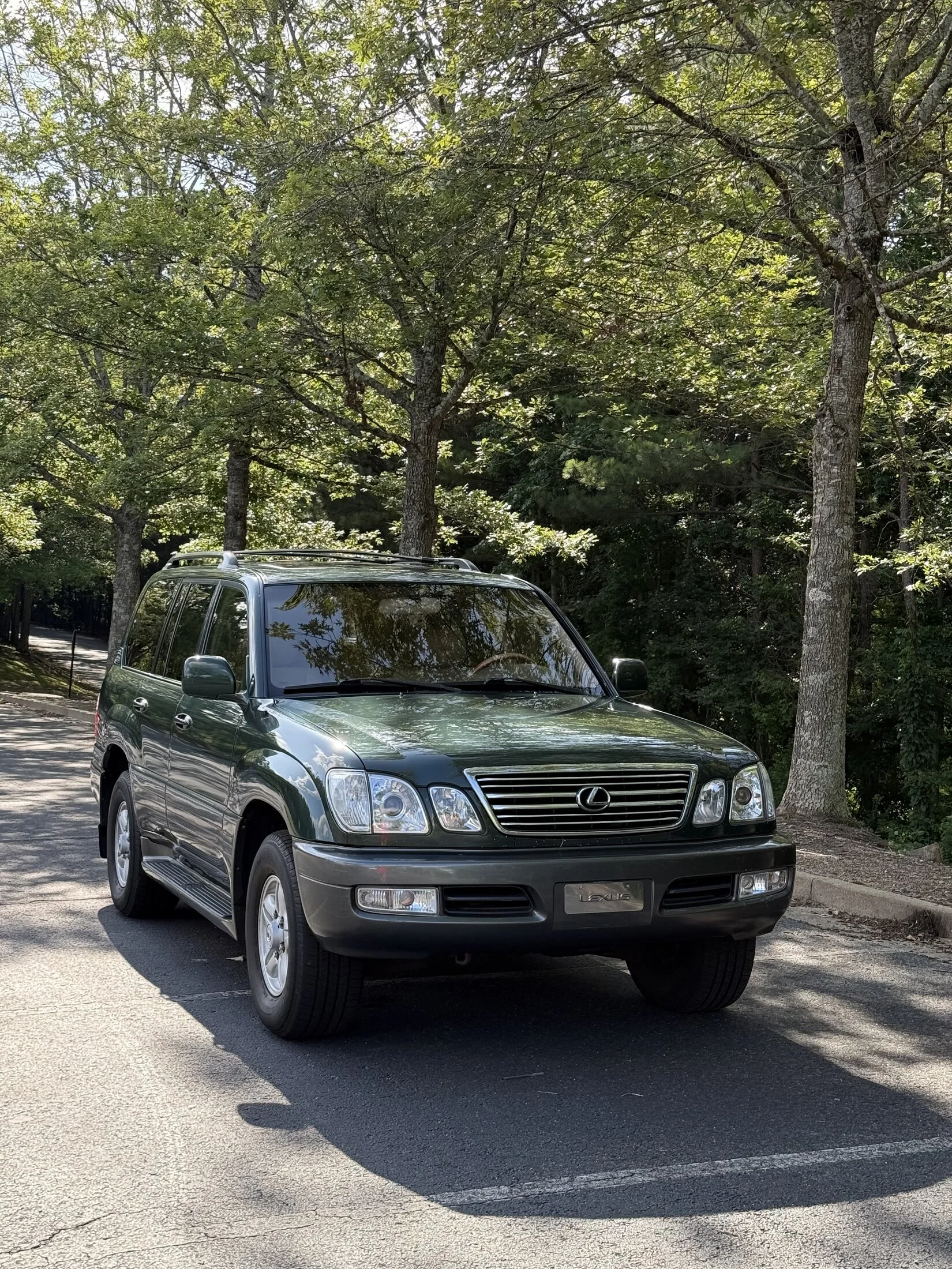

2000 LX470
Woodland Green, paint in great shape with no clear coat peel or major dents
100% bone stock other than Weathertech mats and EXTREMELY dark window tint
Owned by a federal judge from new until 2022, then an engineer who said he tinted it because it was street parked in the city.
Rolled over 365,000 miles on the drive home

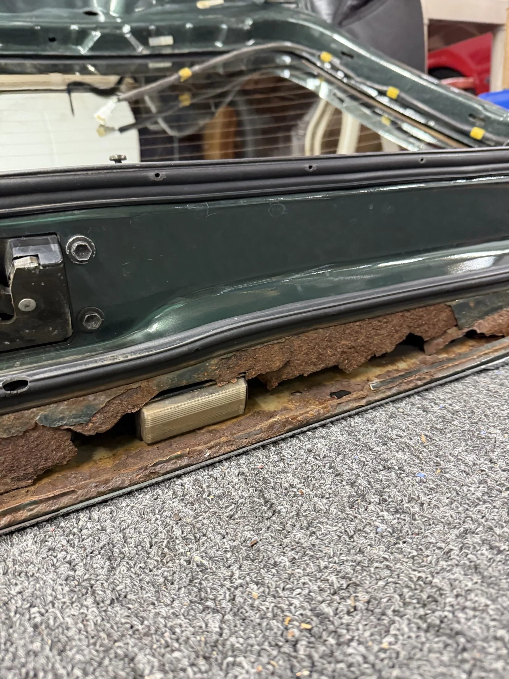

In terms of rust - upper tailgate is bad, and the rear door jambs near the wheel wells. The frame is in really good shape, including the perches and body mounts. It must have been undercoated or fluid filmed or something, just surface stuff down there. I'm going to source a tailgate and I guess have some metal welded in to fix the door jamb area.

Meeting the seller to take it home
Rolled over 365K
Home safe, 750 miles later

Immediately ripped off the window tint. I couldn't see a damn thing out of the truck since they tinted over the factory reflective tint on the rear doors and quarter windows/back glass. That's better. I'd like to find some tint that more closely matches the factory "goldish" tint to go on the front 2 windows if anyone has any recommendations.
Much better.
My fiancee was like "do you want me to cover up the rust spot for a pic?"
Mmmmmm.... patina. The seller neglected to mention this or the tailgate until I'd flown to get it which was super cool. At least I got him to sell it cheaper.
I will need a cutout from a donor to have this fixed probably.

I am willing to bet your liftgate issues are related to the rust. the 3rd brake lights are known to leak, letting water in and causing rust

I bet it's related to the rust too. Does the BT45TOY work with the non nav 98-02 Nakamichi?

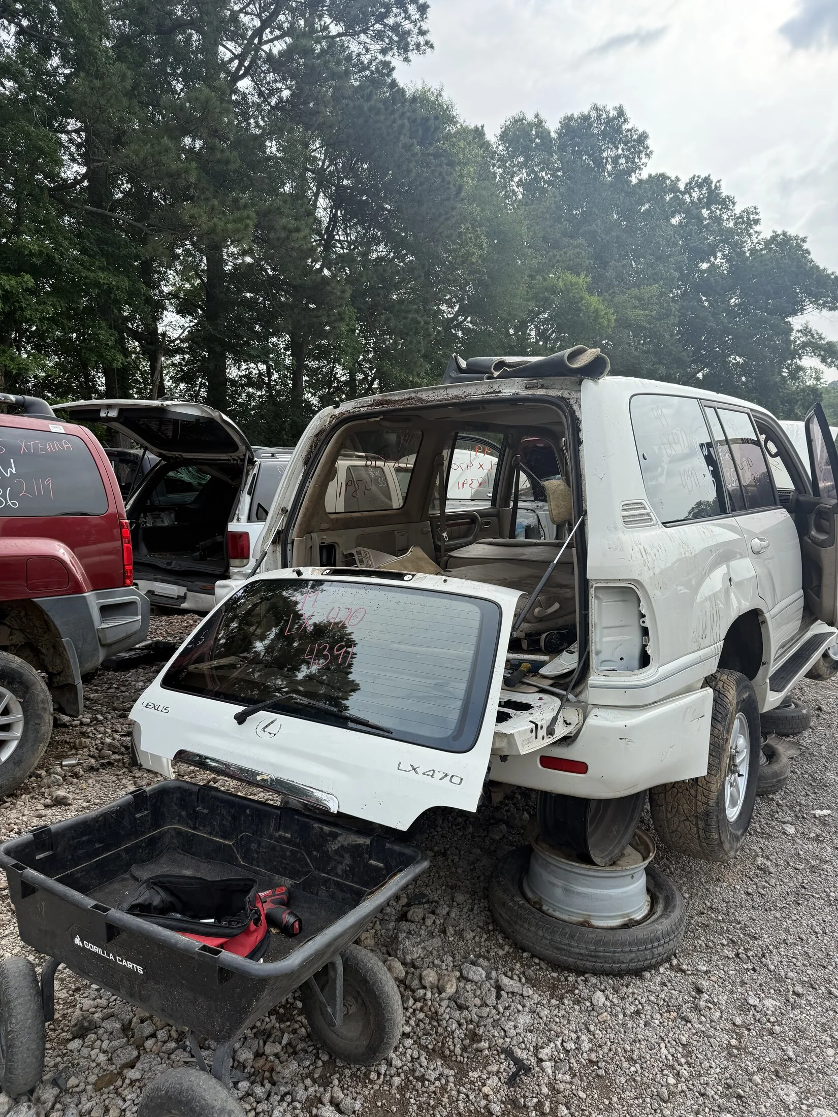

As a matter of fact, I spent this morning dying in the heat at the junkyard. Scored a totally rust free upper hatch, fog lights, rear cargo mat which I don’t have, and a GX470 steering wheel in black. I’ll have to do more research on the wheel, but the splines are the same I think.

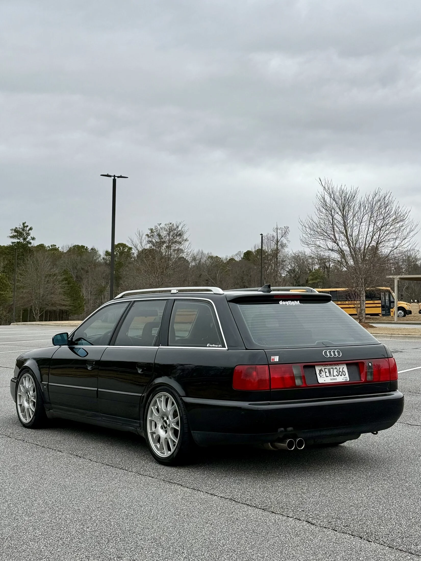

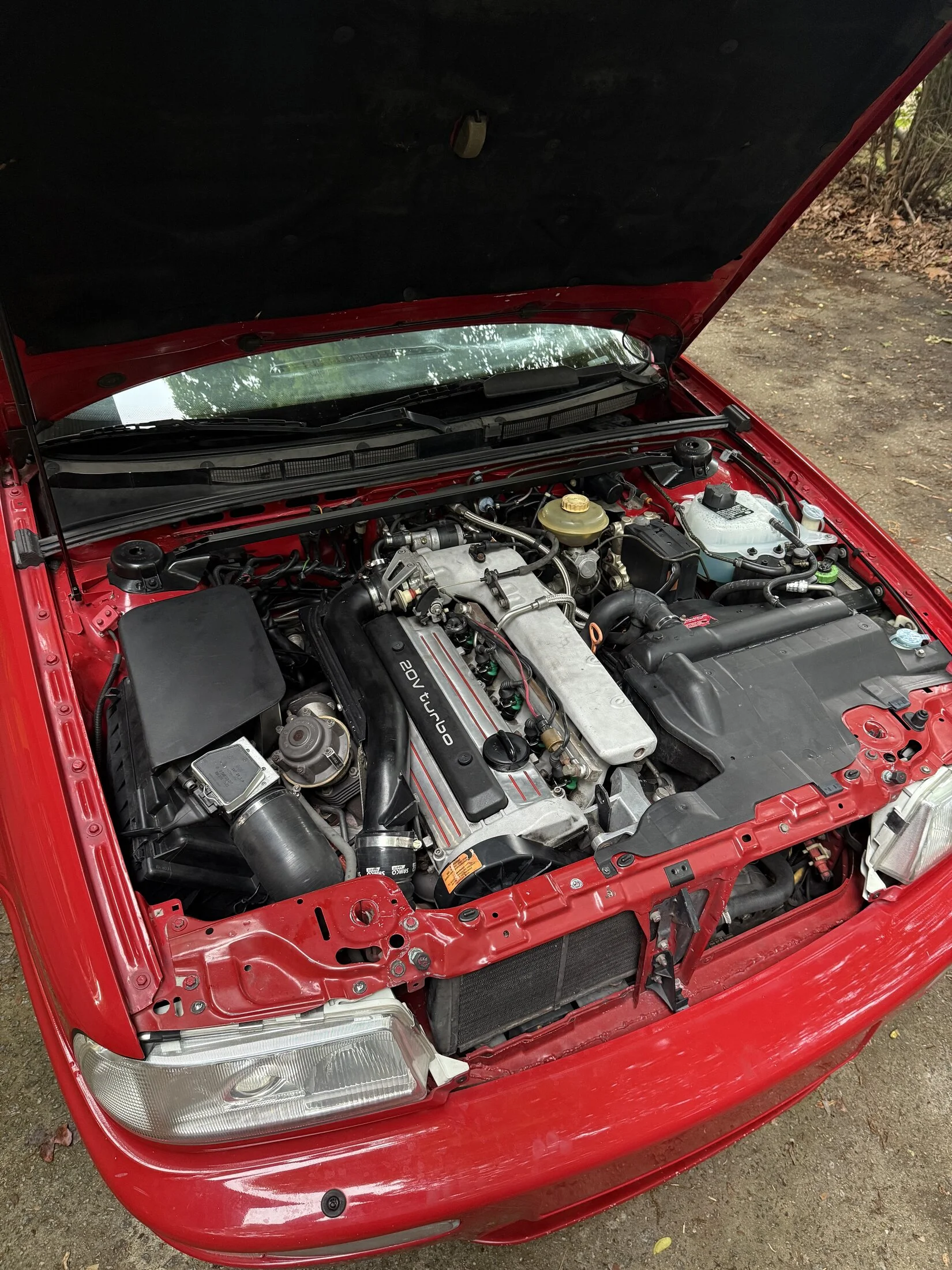

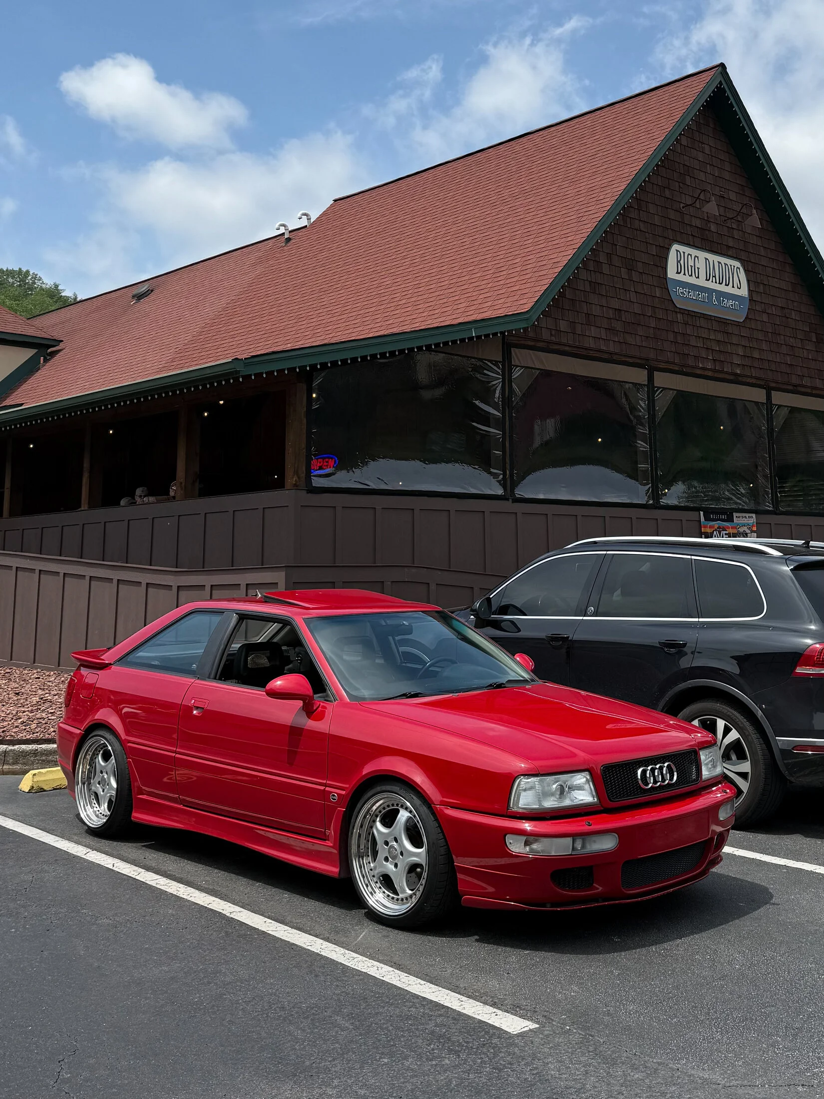

I definitely understand! My drug of choice is 90s 5-cylinder turbo Audis. I have to work on them myself because no one knows what they are or how to do it.
May as well post them.
1995.5 S6 Avant
1990 Coupe Quattro with S2/RS2 engine swap
2006 911 C2. 130k and counting.
So as you can see, I need something reliable lol

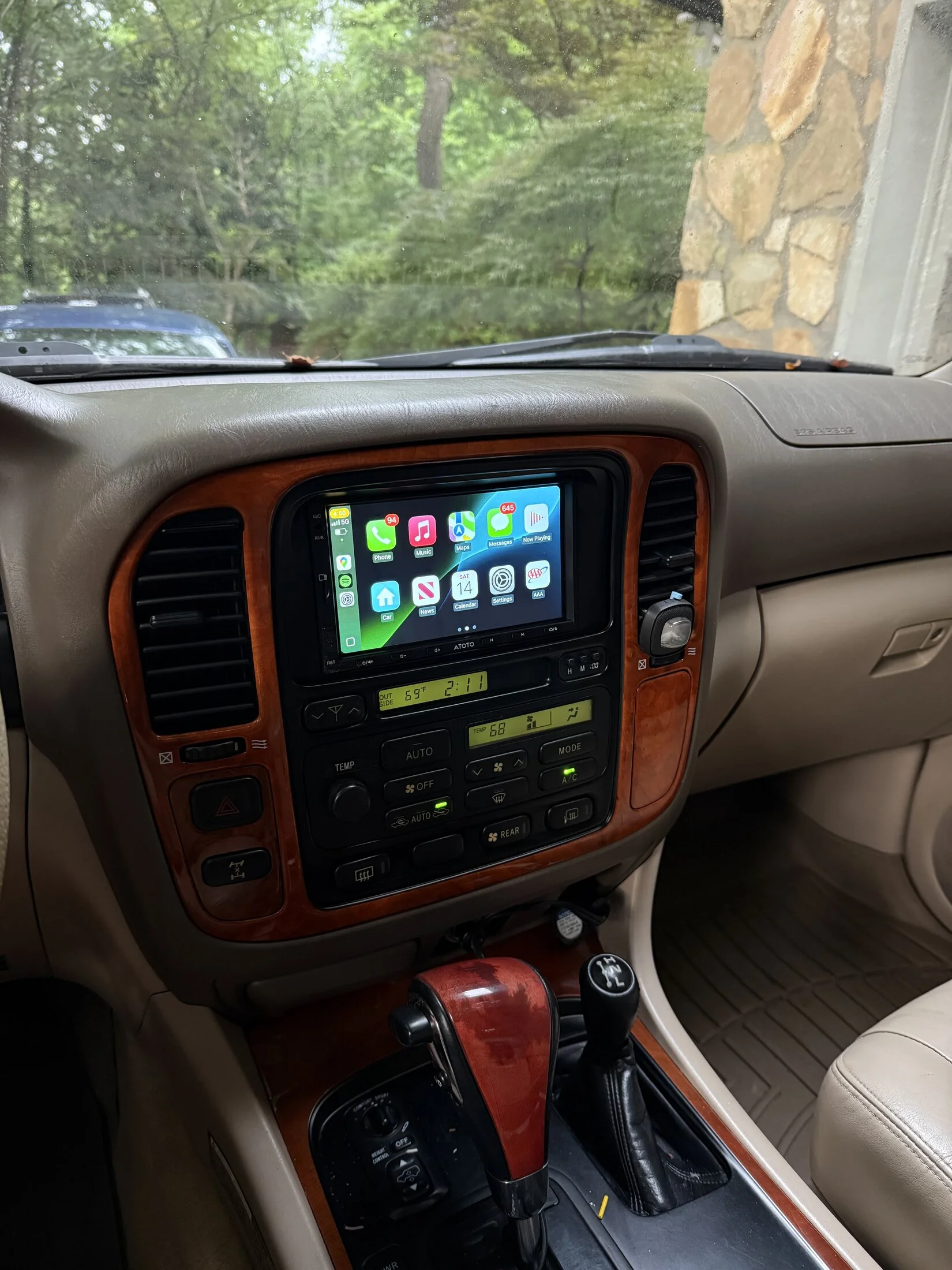

I ordered a head unit. This ATOTO: https://www.amazon.com/dp/B0D9Q5S5F5?tag=ihco-20
Obviously not top-of-the-line but I've had the same brand in my 911 since 2020 with good results. I'll be cutting the factory connector and splicing this one in. Also comes with a backup camera - I personally am in the "just turn around" camp but my fiancee loves this truck and would like her to be comfortable driving it. I'll have to do some research on routing the cable as I've never installed a head unit with a backup camera before.

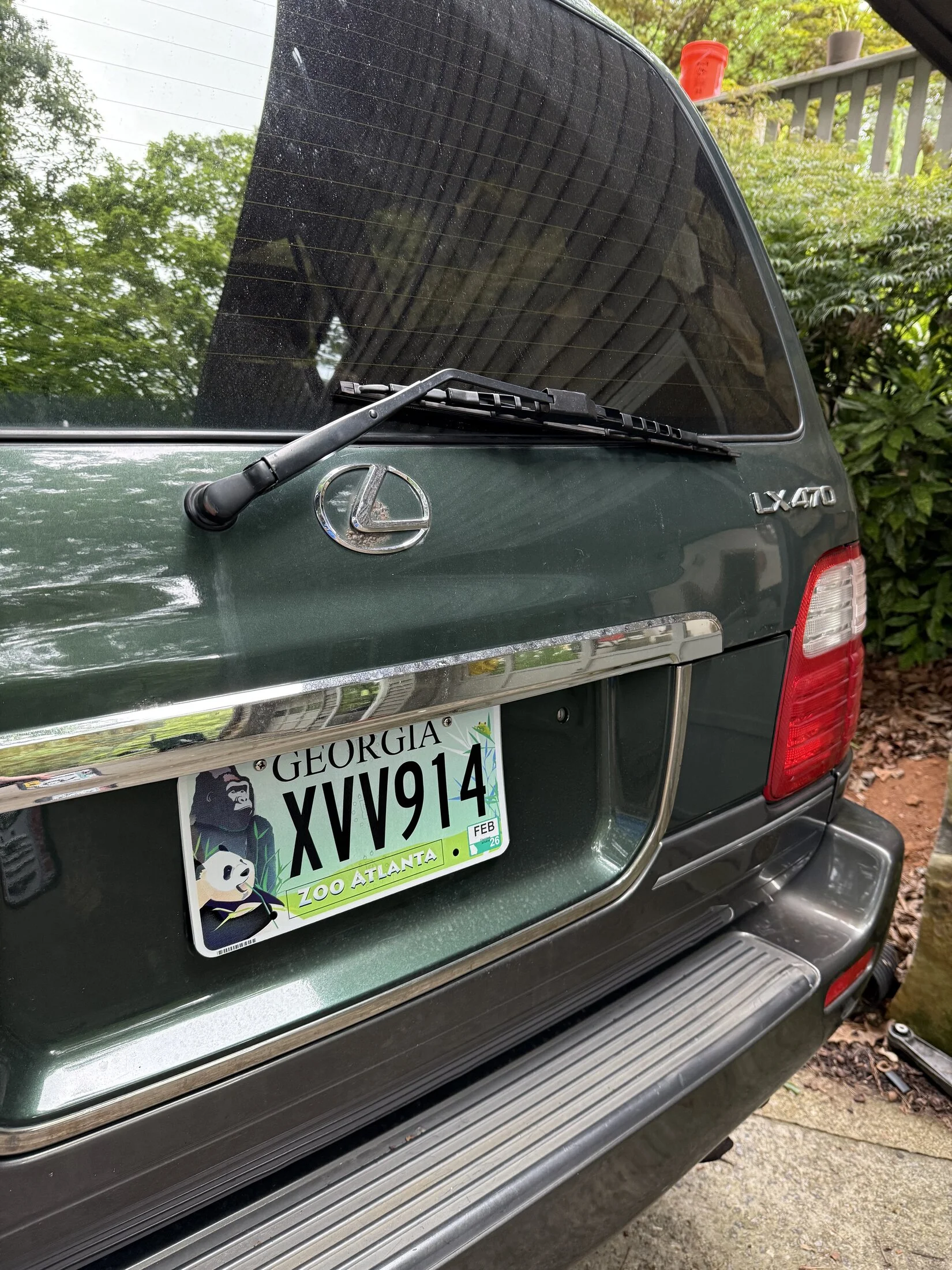

Finally registered it. I like getting specialty license plates that match the car. Zoo Atlanta plate is green so why not?

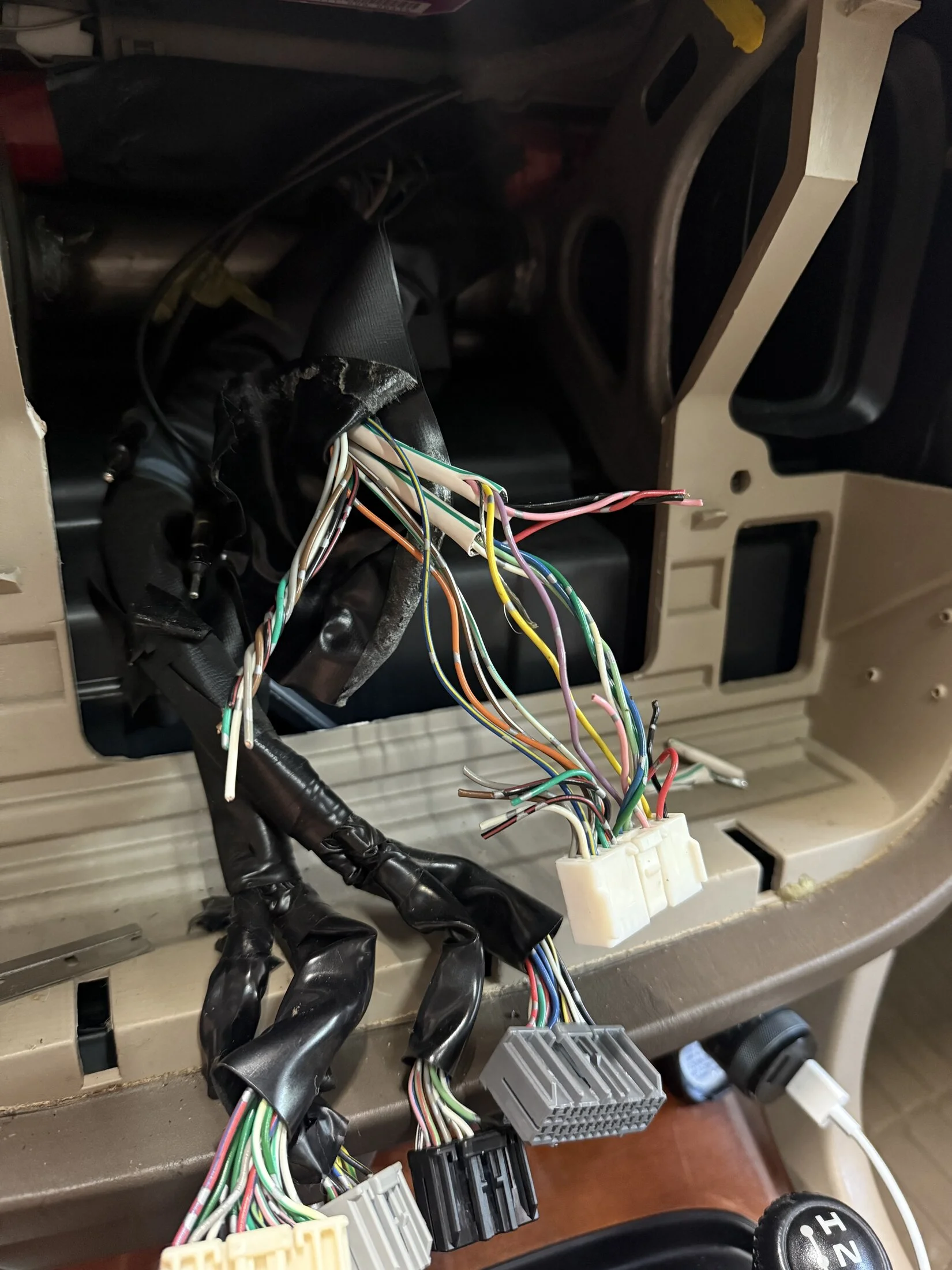

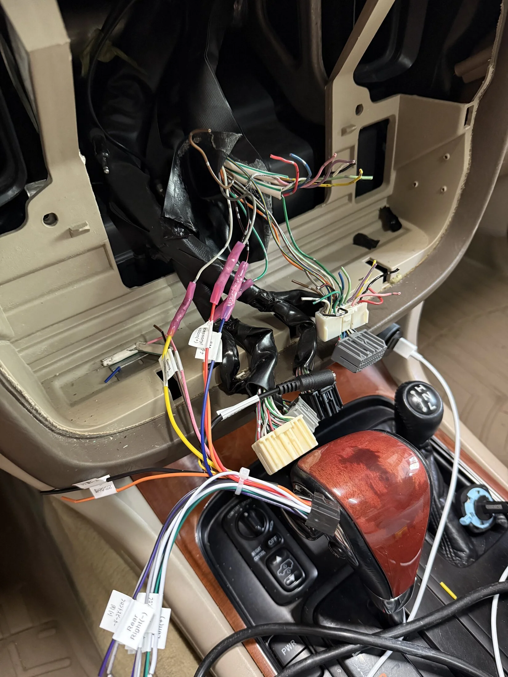

Got the head unit installed on Saturday.
Old head unit out. I followed the guide on Mud that details splicing into the factory harness. I saw a bunch of discussion about using OEM parts to make an adapter, but honestly depinning and repinning, etc etc seemed like more effort than simply splicing into the factory wiring.
Separating out the wiring - cut everything relevant and put them into two groups, speaker input and "general."
Once I got everything cut out of the factory connector, I started to connect everything to my new head unit's plug. I used heat shrink butt connectors and ratcheting crimpers from amazon. Highly, highly recommend ratcheting crimpers if you don't have them. They do a MUCH better job and are not expensive at all.
Had to install the double DIN edges onto the ATOTO head unit. It's crazy how slim things are these days. From here, I installed the OEM bracket onto the head unit.
Finished product! I used the bezel and did some trial and error, it seems to fit decently. One note -- the volume was WAY too loud when I got everything installed. I vaguely remember from installing the radio in my 911 that you're supposed to make sure the volume is either all the way up or all the way down or something before you install an aftermarket radio if you're still using the factory amp. I did not that. I went into the EQ settings and reduced the gain for each speaker down to -12db and now my volume is reasonable. Also, the factory sub wouldn't really activate. I changed the subwoofer settings on the new head unit to be 20-400hz range and that fixed it. Still not bumpin per se but the sub works.

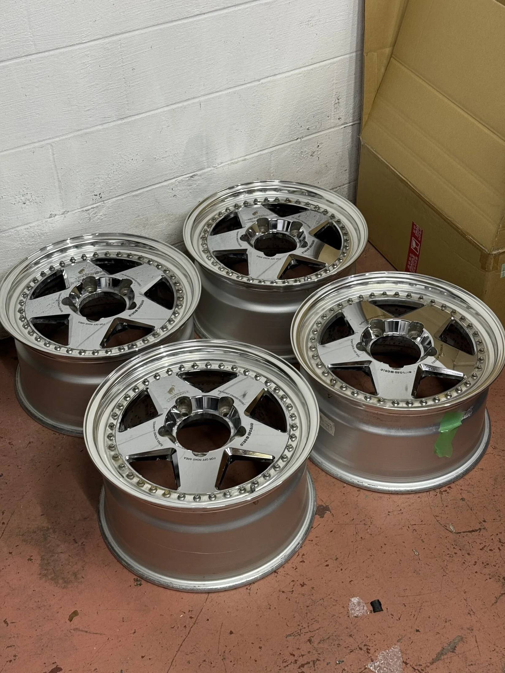

Oh…. I forgot. I won an auction.
17x9 3-piece Lodio Drive Cinqs from Japan.
They should be here in a few weeks, at which point I’ll put some tires on them.

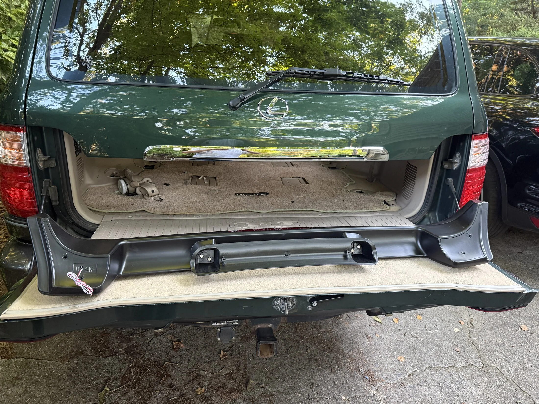

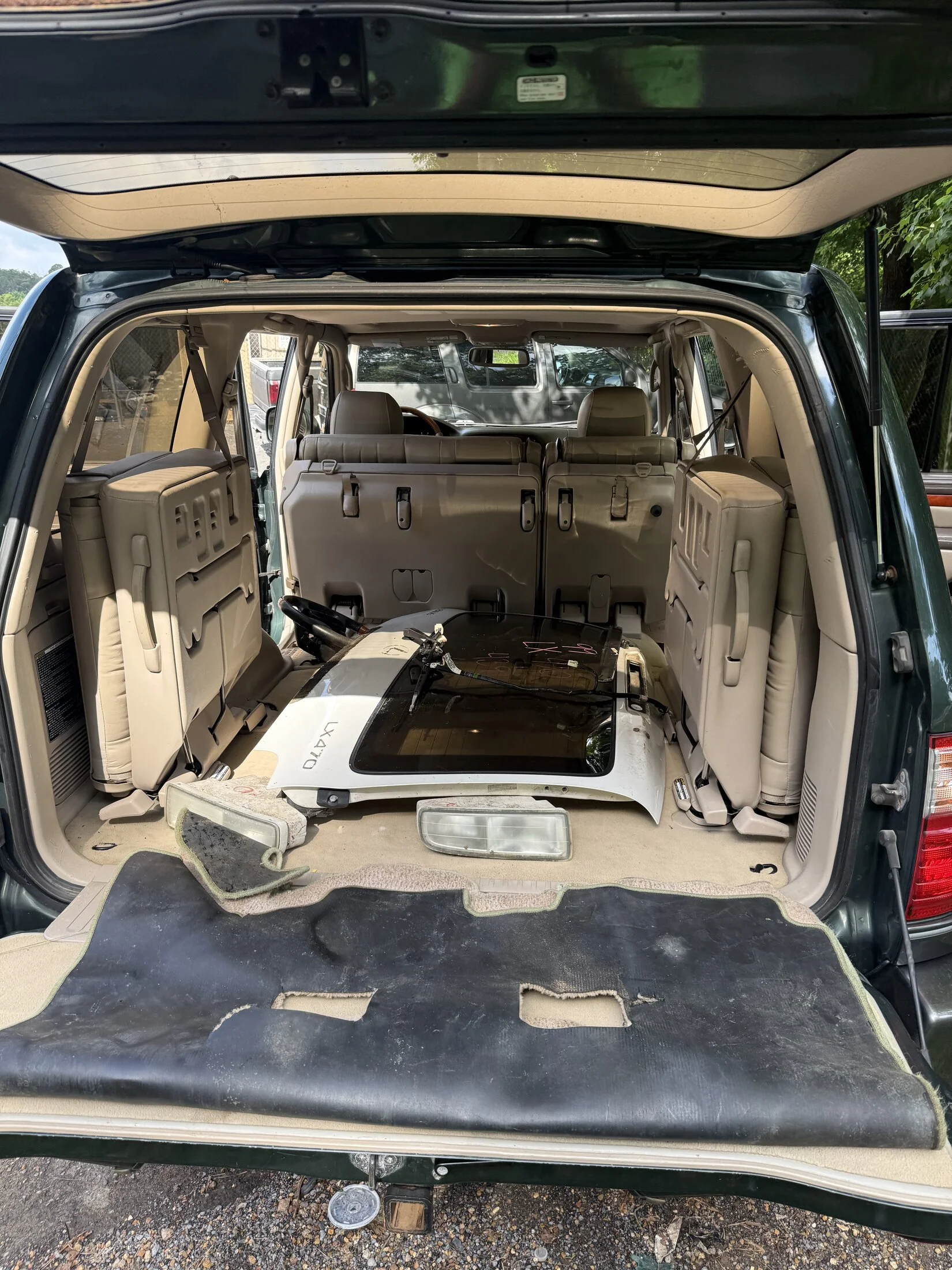

Got to work swapping the hatch. Old one coming off…. Definitely advise keeping the struts connected to make it easier to maneuver. Those 12mm on the hinges want to strip easily since they’re painted.
Nasty old hatch.
Here she is! So nice to have a handle to open the rear hatch.

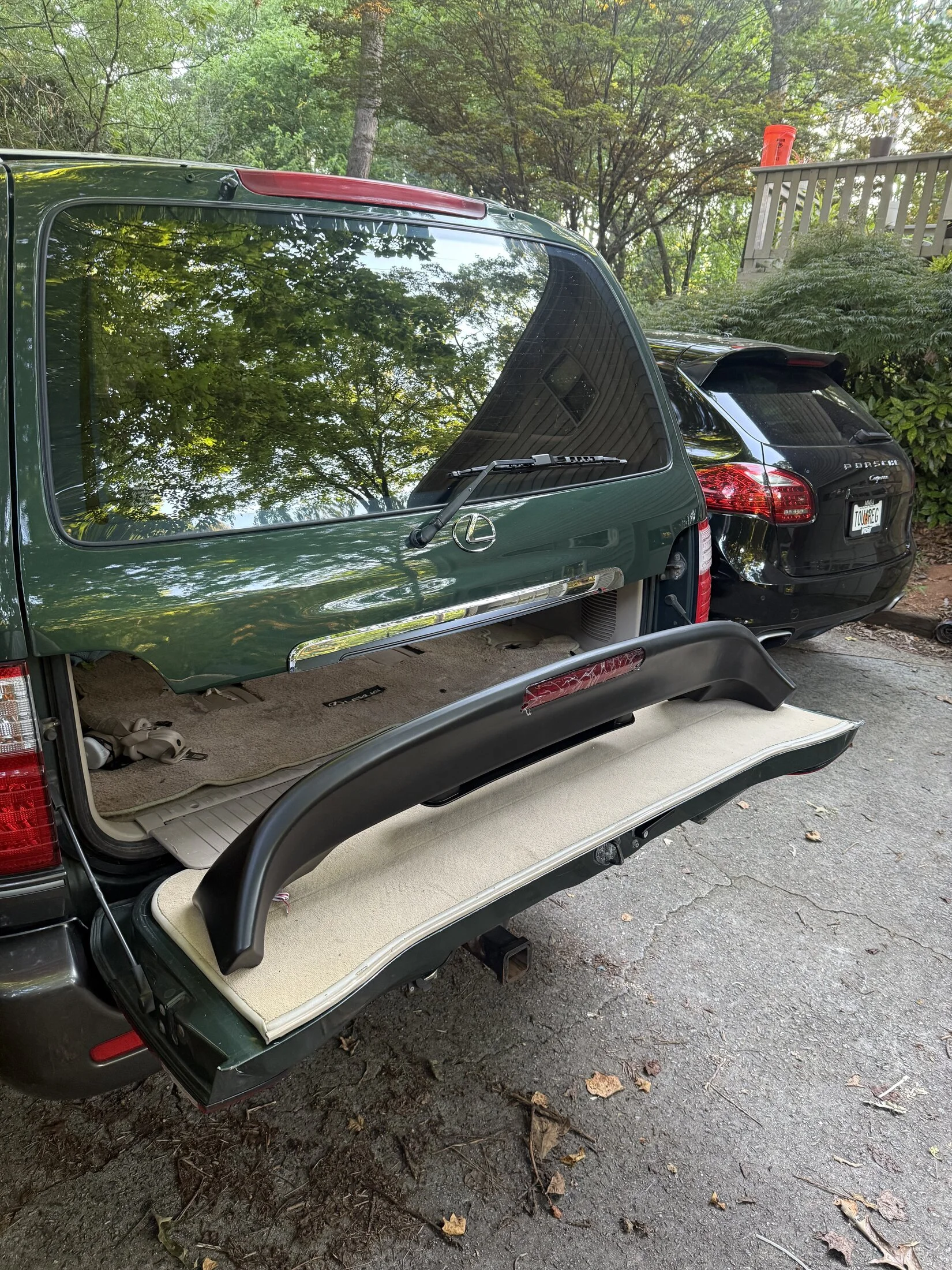

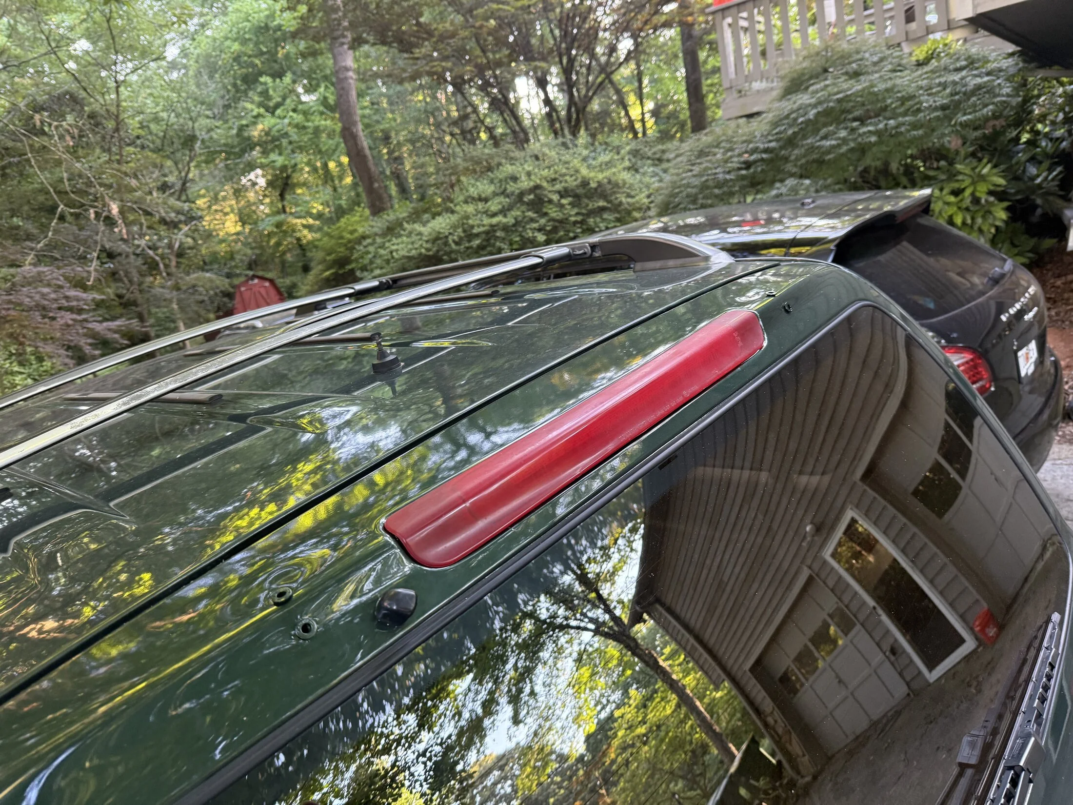

Spoiler arrived. Has anyone had experience with these? Looks like the hatch the truck has on it includes threaded holes for mounting the early “deflector” type spoiler.
I think what I’ll do is mount it with the bolts in the factory 3rd brake light mounts and get mounting tape for the edges and attach to the hatch that way. I’ll have to wire the 3rd brake light on the spoiler in also. I would rather not drill holes in the hatch I just had painted lol. If anyone has any pointers let me know, otherwise I'll figure something out this weekend. I have learned the hard way in the past not to have parts painted prior to figuring out fitment!

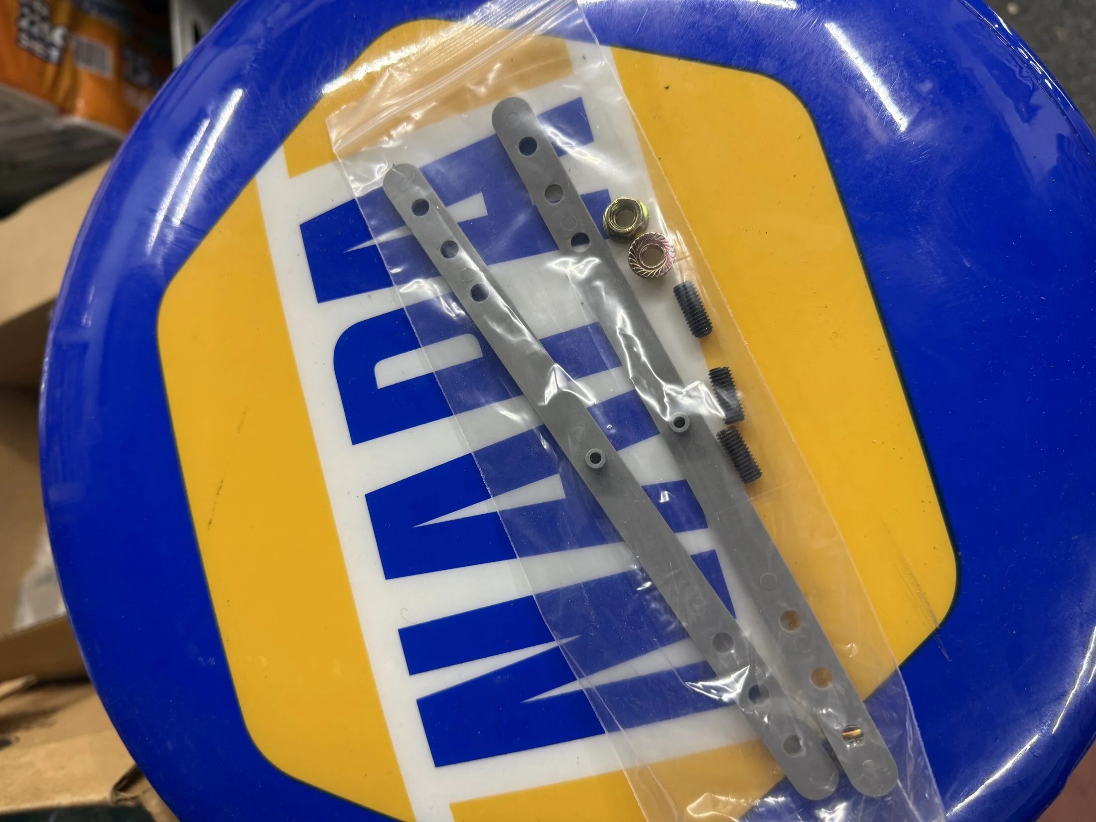

Here's what the bottom of the spoiler looks like/how it mounts.
Another view of spoiler.
Top of hatch
And here's the hardware it came with. Not sure what the plastic things are for. I thought templates for drilling holes but they don't line up exactly.
Got the spoiler installed and took the rig on a trip to NC for the 4th. Another 900 miles down. Current odometer: 367,550.
I’ll need to remove it again because somehow the 3rd brake light wiring got severed during installation; but at least it looks cool.

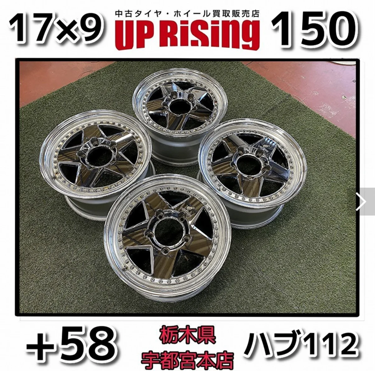

Beginning the search for 285/70/17 or maybe 295/70 for my JDM wheels. They’re 17x9 +52 and I figure I’d use 1” spacers bringing them to about a +27 offset. Thoughts?
Not looking for an extremely heavy tire. Would like an all terrain but as light and quiet as possible. If I have to sacrifice some off road performance at the top end that’s ok.
I’ve heard good things about General Grabber ATX- 46lbs.
Wheels have arrived from Japan!
They are 17x9 +58 so my spacers will put me at +33 offset.
