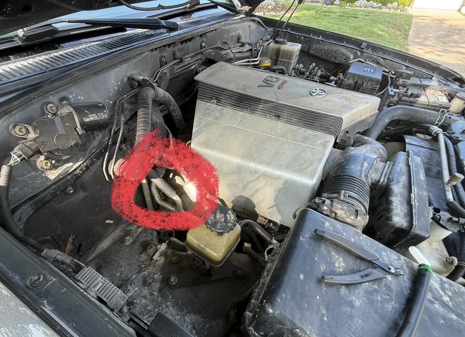

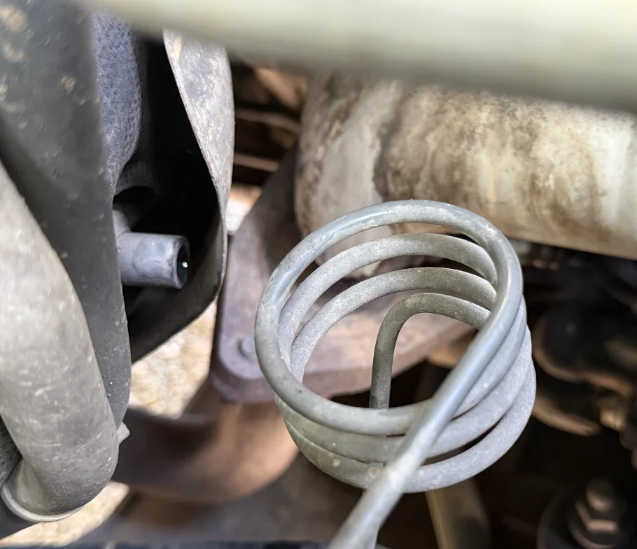

The drain for the HVAC comes out through the firewall and basically just drips straight down hitting the frame before dripping down to the sway bar bushing. In the two pictures below, you can see where in the engine bay the tube drains, this is where you will add the extension.

First you connect the extension tube to the plastic right angle / tube connector - it would be difficult to do this if you installed the right angle in the engine bay first. You then insert the other end of the tube connector into the drain tube shown above. I recommend you do this when the engine is cool. It was a bit of a tight squeeze between the drain tube and the heat shield, I was worried that the plastic tube connector might melt if it was touching the heat shield directly so I layered a few pieces of foil and zip tied the tubes on both ends of the connector.
