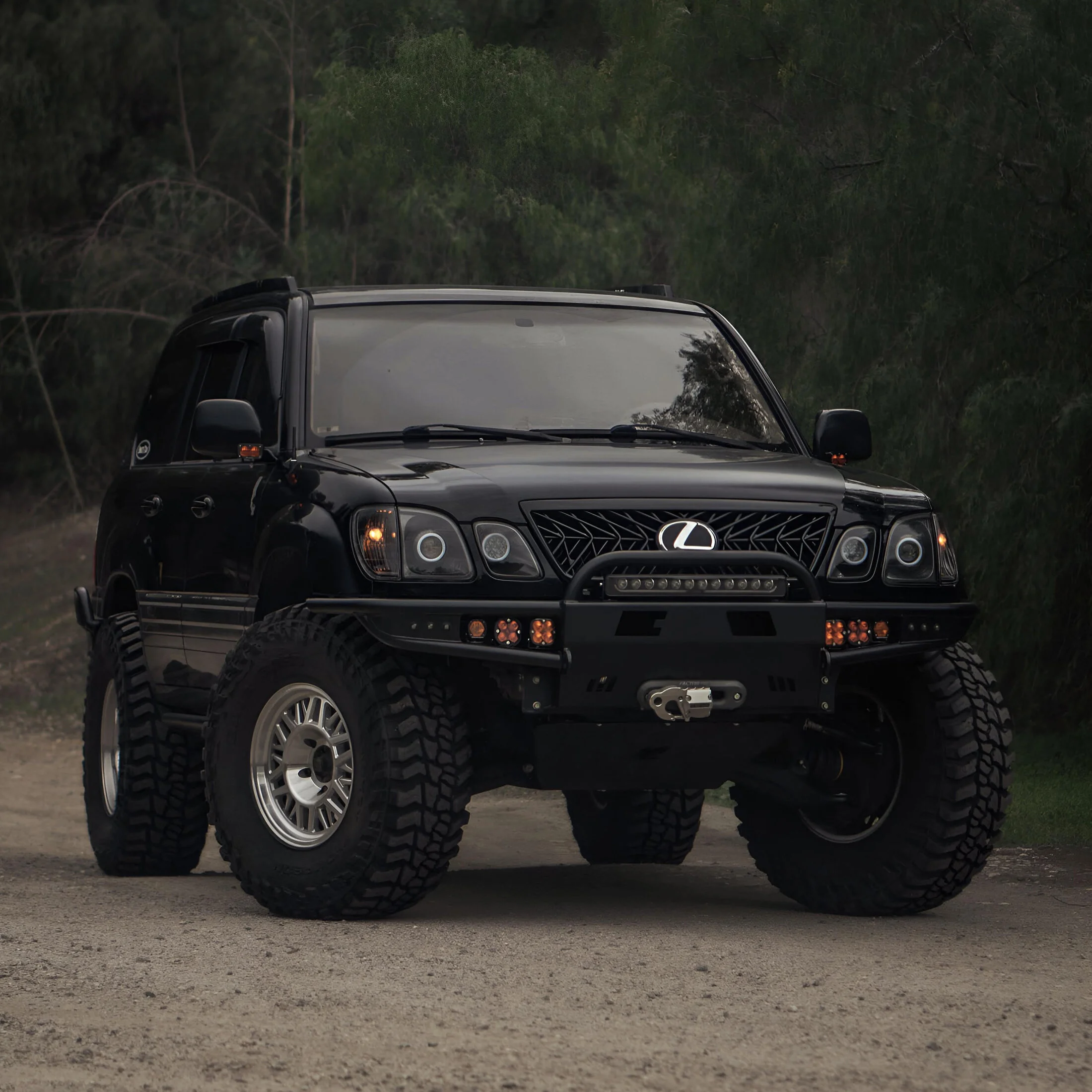

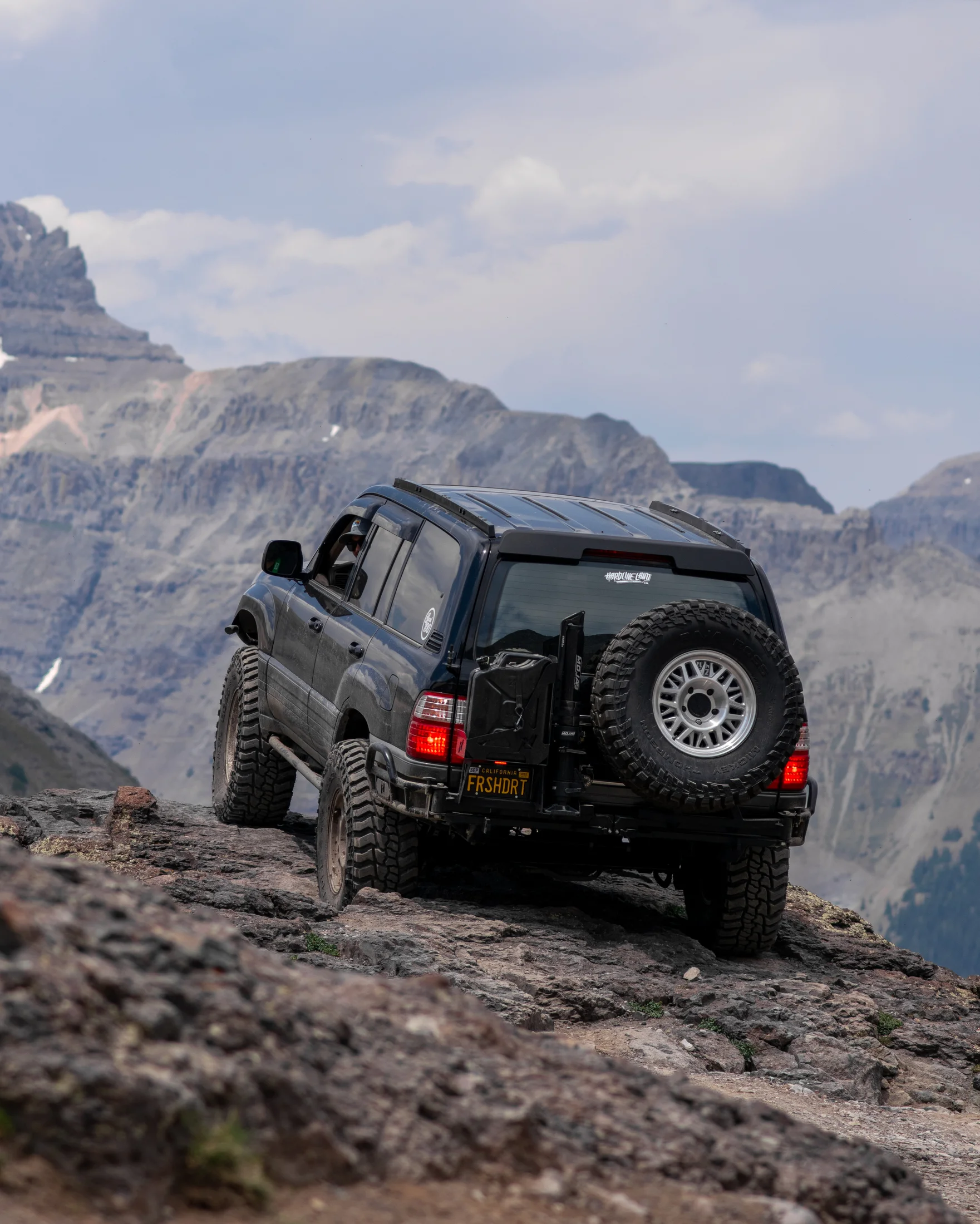

Nice rig. Can you tell me who makes your bumpers? I have gone down the rabbit hole trying to find a good option for my LX.
Thanks

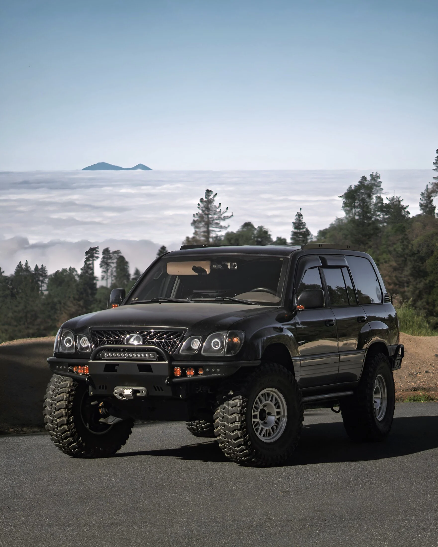

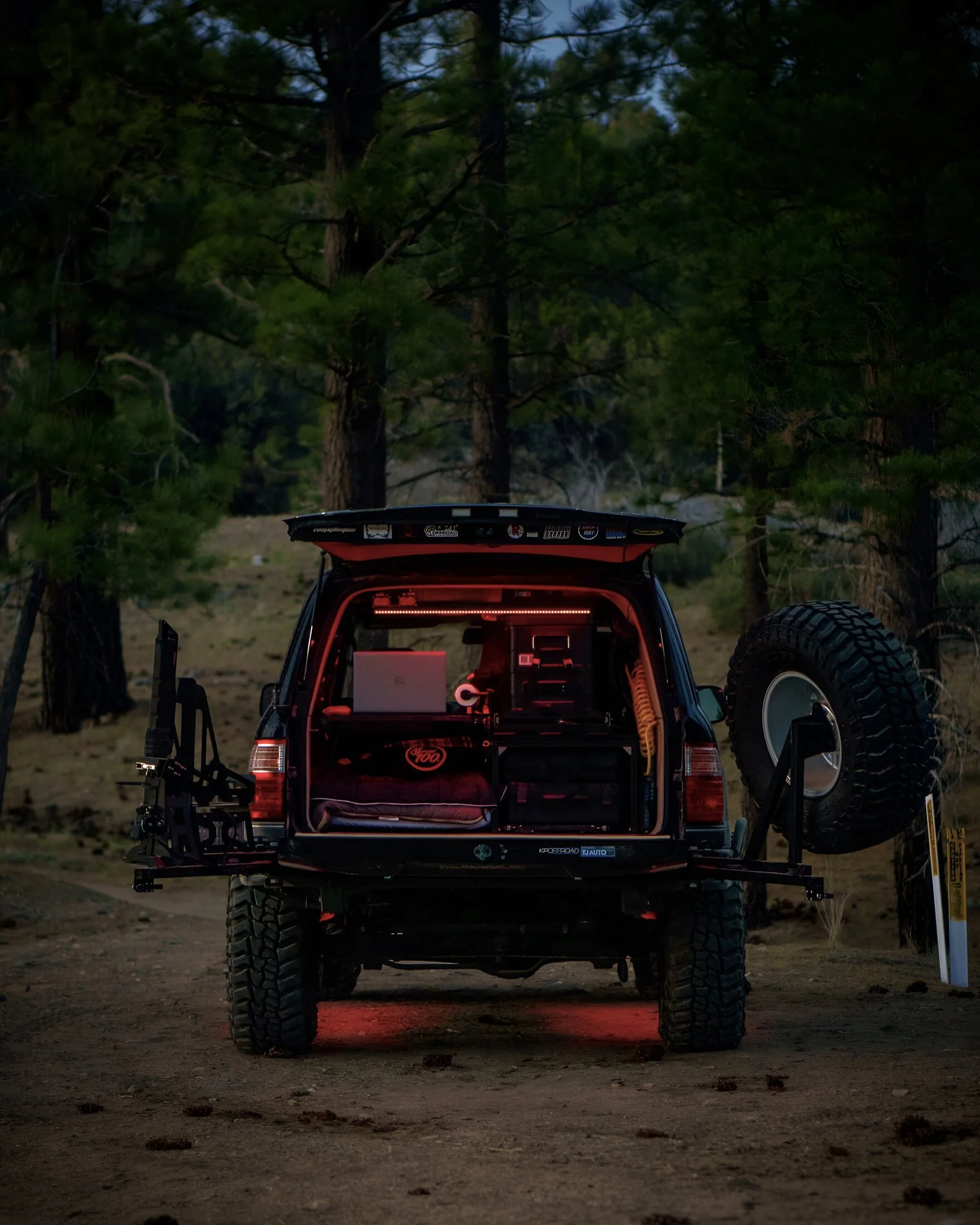

The rear is from Nguyen Works. Right now I'm the only one with it, but they acquired a 100 series for themselves, which probably means they'll go into production for these for other folks.
The front is a Coastal Offroad center section with custom tubing for the "wings". You can buy a center section only from Coastal. I took that center section to a shop not too far (KP Offroad) and Tanner did the welding of all the pieces and made the custom tubing.
Vidal Metal Works (also in Socal) has a new front bumper for 100s, and it should be on their website, without all that custom work: STRYKER 100 - DIY Kit - https://vidalmetalworx.com/products/stryker-100

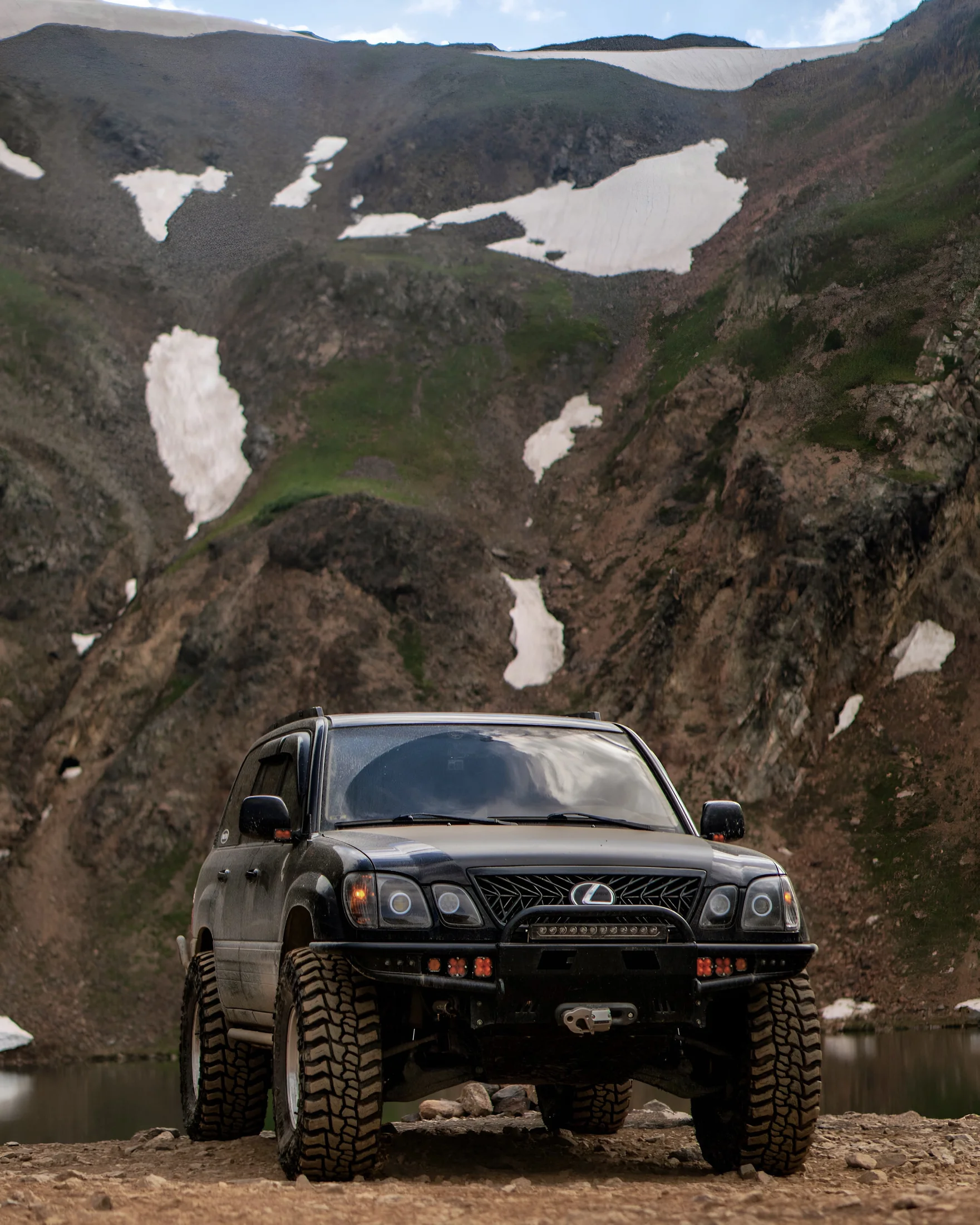

Great info. I have hit up Nguyen Works in the past and they confirmed they have something coming. I looked up the Coastal site the bumper looks good. Do you know the ballpark a welder would charge to put it together. Just trying to get an idea of an all in cost of this bumper.
Thanks
Thanks
Well, it was expensive. I'd call around because it could range wildly. The Coastal kits are going to be good for guys who are good garage fabricators, but it won't really save money if you're paying someone for the labor. It could range from 300-1500 probably to pay someone, depending how custom you're going. The center section was like 400-500 bucks, don't remember exactly.
A good welder I know is Iron Ryno Fabrications, a good guy named Ryan, he's located in Lomita. But he's booked out for a few months, I'd call to get on the list sooner than later.
I took mine to KP Offroad, and they had my truck in their shop for a few weeks.

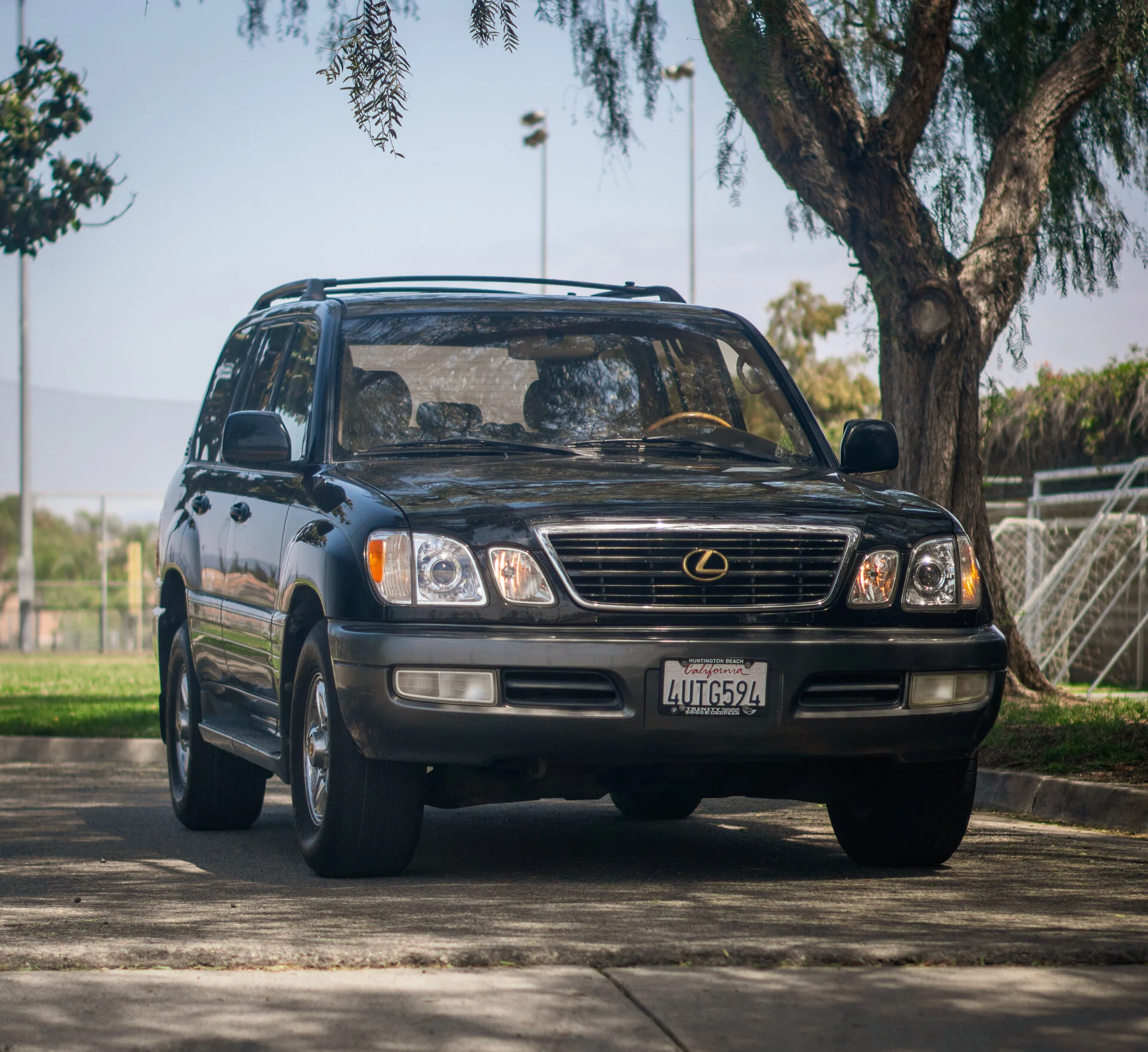

Picked up an Black 2002 LX470 in May 2023 w/ 235k on the odo, bone stock (aside from a AHC-delete), from a single owner that passed the vehicle down to his son/daughter in Newport Beach, CA.
The primary use is intended for light trails, long road trips, solo+family camping, occasional grocery-getter, and not so much hardcore wheeling. I had a long-travel 3rd Gen Tacoma that I sold earlier this year and I wheeled that thing pretty good. I then bought a 2nd Gen Tacoma for the purpose of wheeling but will probably end up selling that, and picking up a 1st Gen Tacoma to get wild with. The goals for this LX won't be the same. Not getting wild, just mild.
Here's how it looked upon day of purchase:

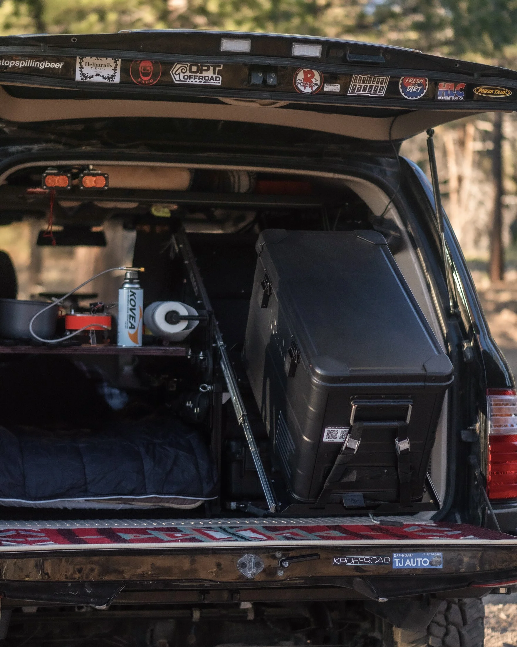

- Drawers/Sleeping Platform
- Replaced with Gear Panel and Shelf (Custom)

- *DONE April 2024 - Coastal Offroad Front Bumper w/ custom tube work from KP Offroad
- *DONE June 2024 - Nguyen Works Rear Bumper w/ Dual Swingouts

- *DONE 2025 - ICECO APL35 Fridge with Ecoflow Delta 3 Battery

That grille replacement. Any issues with fitment? I was tempted to order it awhile back but read that the fitment was dodgy. But damn your to m build looks great!
Yea...the early 100s had that "bracket" thing-a-me-bopper that the actual grill fits onto. I had to ditch it and use an assortment of hardware from the local hardware store to kinda fit it up. The bottom part of the grille kinda sticks out a little bit, but I have my lightbar and tubing that somewhat conceal it.
So yes, it's not a plug-and-play unfortunately. But it's been fine for a few years. I have to reach into the "O" of the Coastal Offroad "CO" cutouts in the bumper to access the hood release.
