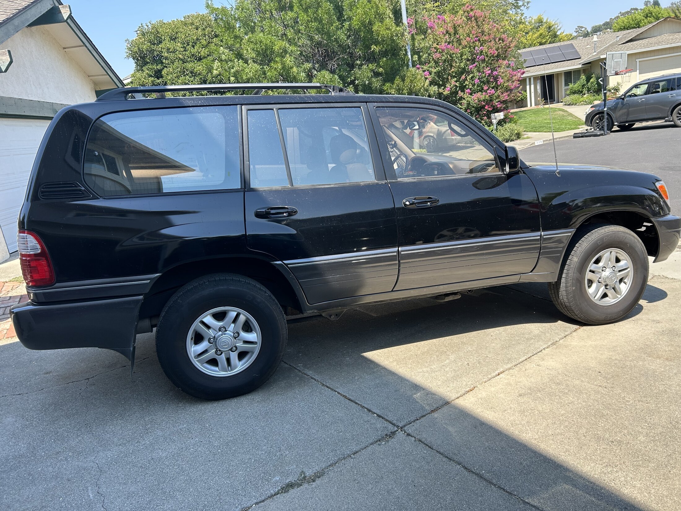

I will start by saying thank you to everyone on here. Past and present. I bought my 470 in February and thought I was way in over my head. If it wasn’t for this forum, I do not think I would be happy with my purchase like I am now.
My 2000 LX470 came with just over 188,000 miles. It is in good condition. I had to do some major upgrades to bring it back to stock when I bought it:
