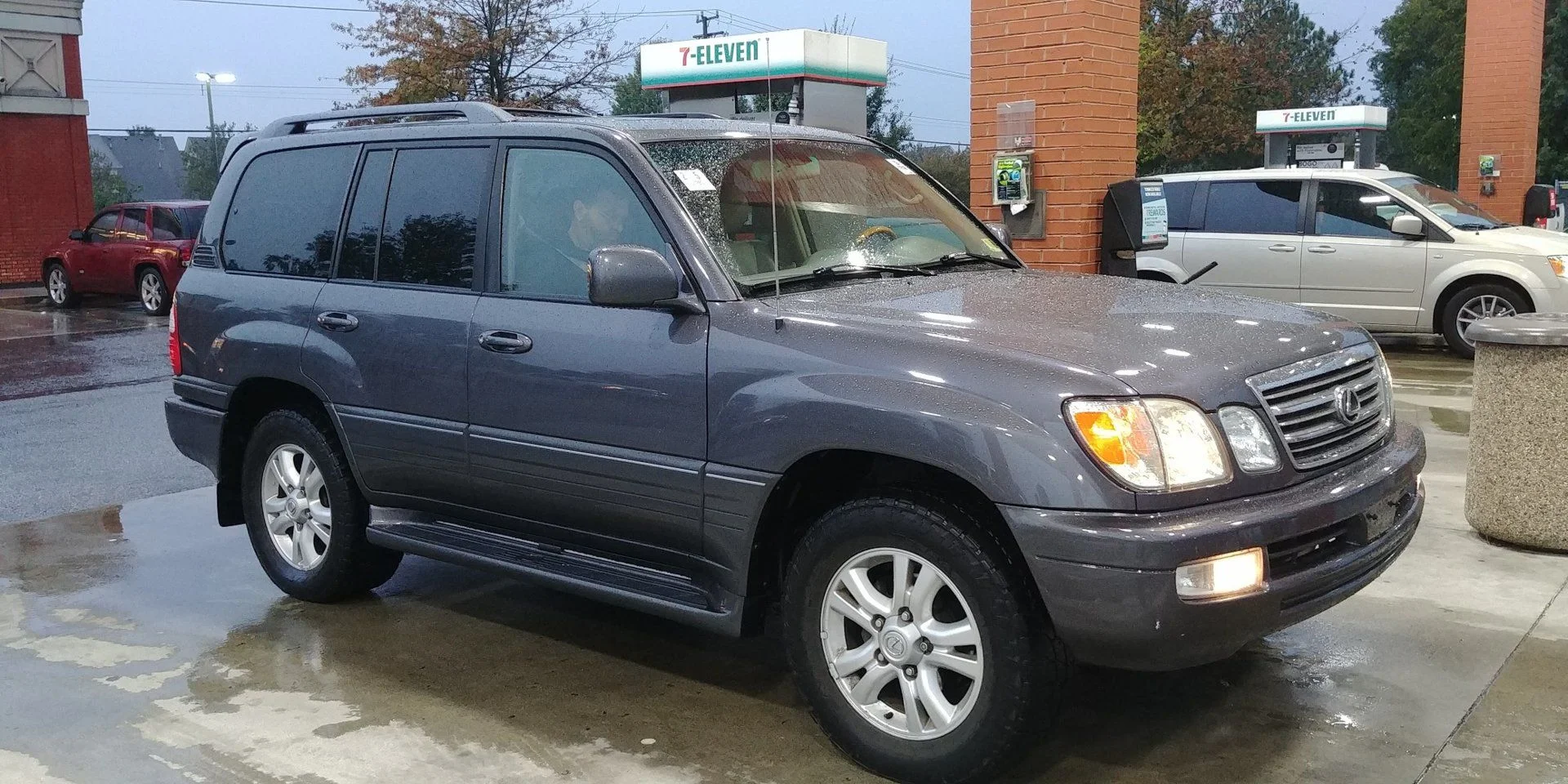

Purchased a beautiful '99 LX470 about 2 years ago. Totalled it in July when a vehicle swerved from my lane to reveal another one stopped right in front of them. RIP Gloria. The day later, I bought a 2000 LC and started building it up. 2 weeks after installing my lift and a ton of other work, I was rear ended by a dump truck and pushed into a semi. RIP Gira.

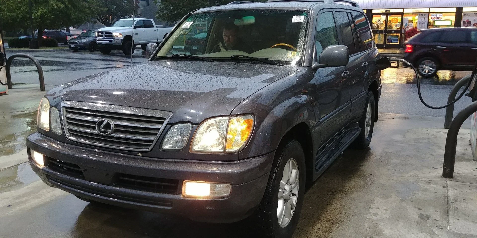

But NOW!!! After a few weeks of anxiety and knowing every single 100 series for sale in the country, I was able to pick up a 2005 LX470. Bone stock, 2 owner, VA car its whole life (the good parts, not the snowy parts). Stack of dealer maintenance records, 210K, and disgusting as all get out. A buddy bought it for me at the local dealer auction and I traveled up to VA to pick her up a few weeks ago. Prior to my pick up we had the timing service done, as well as a new radiator. I still have the new metal heater Ts to throw in this week.

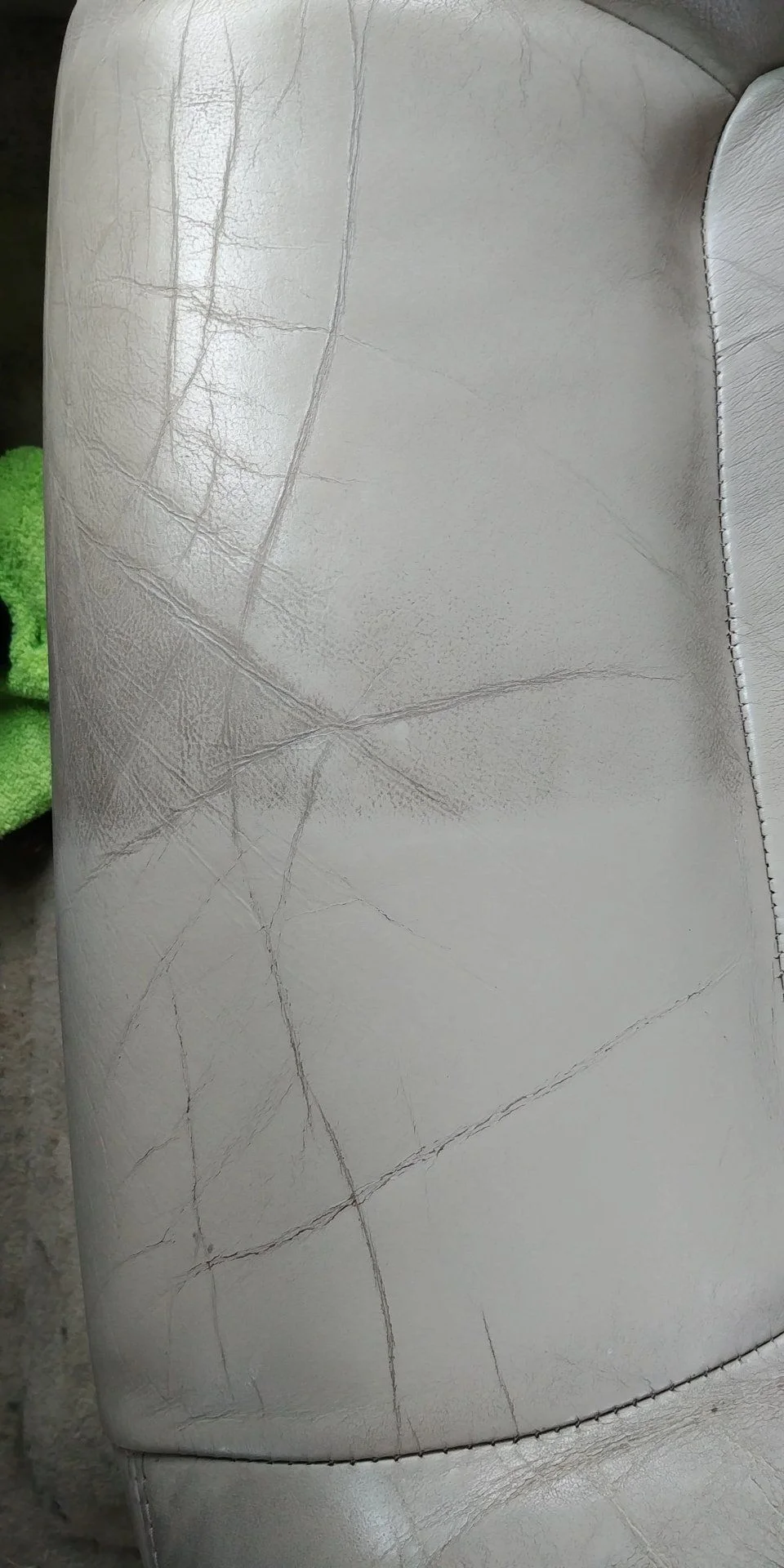

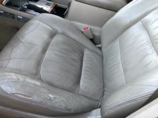

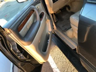

As I found her:

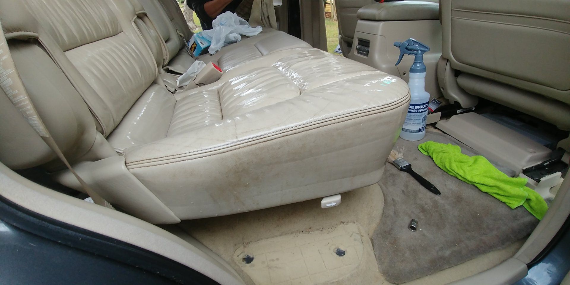

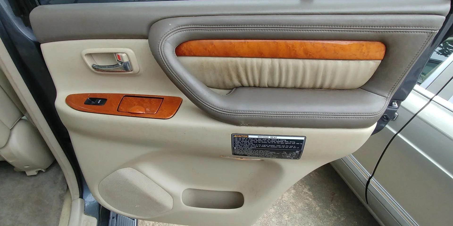

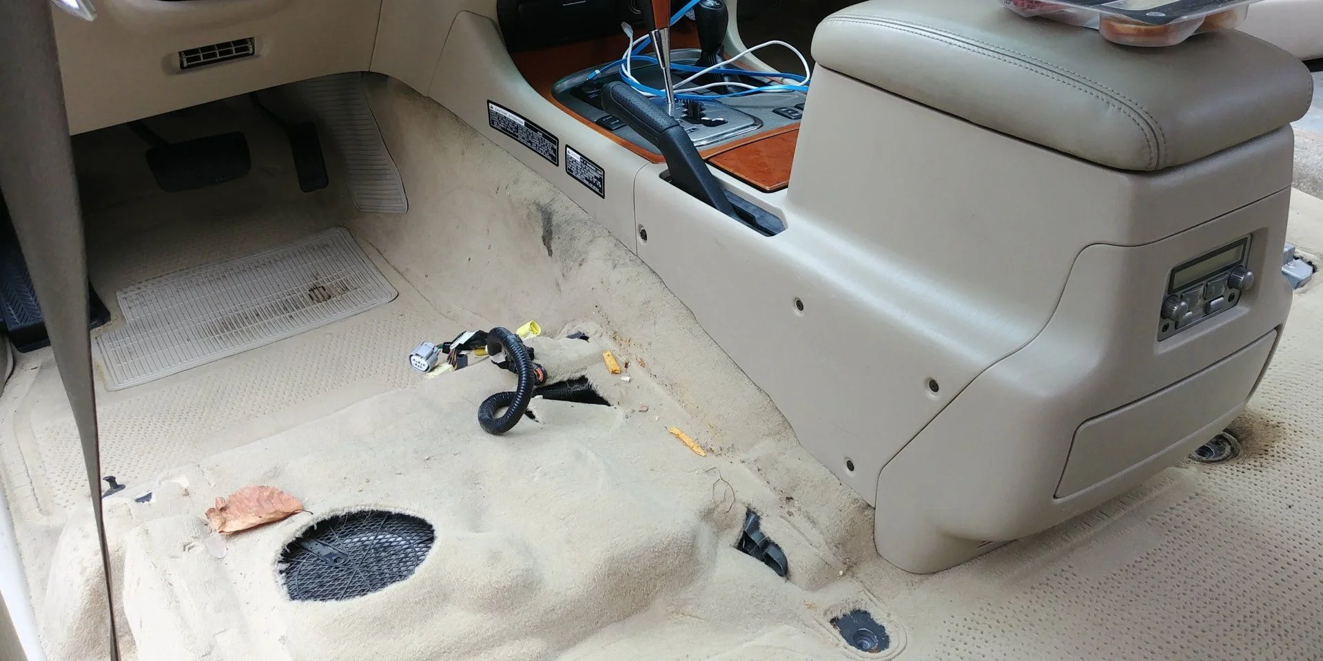

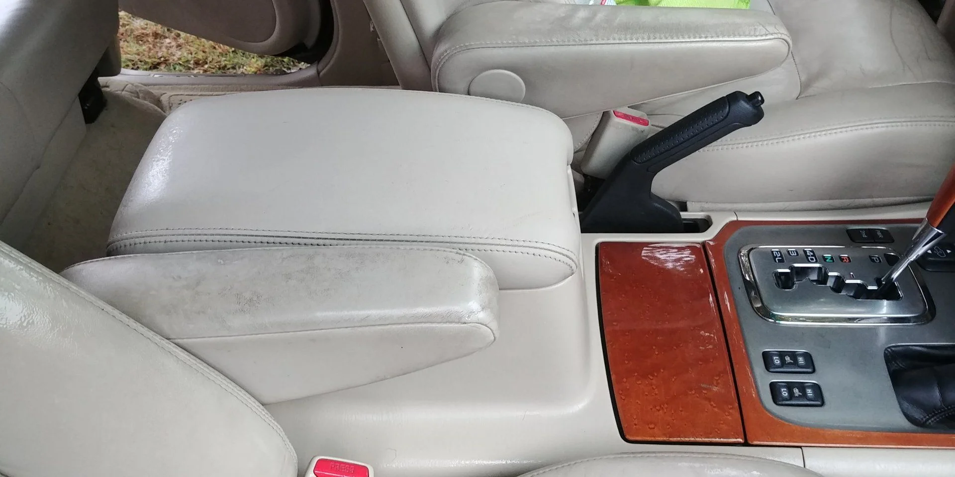

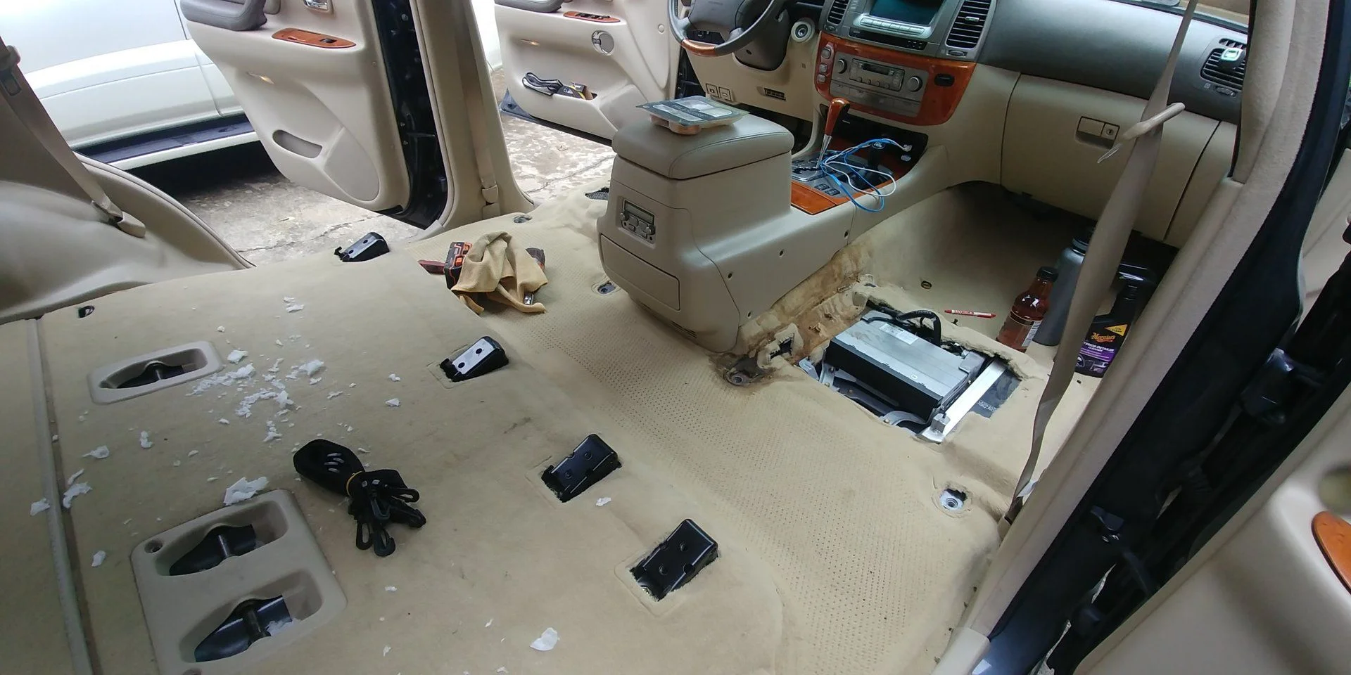

The truck was a dog hauler. And messy people hauler. I take my dog with me to the office every day and have never seen any of my vehicles look remotely close to this. The first day I had her, my mom and I ripped all of the interior out, much of the trim, the console, switches, etc and cleaned everything we could possibly touch. I wish the filth showed up on camera better but there was a solid layer of snot and slobber on most of the rear seat space. The truck was filthy enough that I was able to buy it about $7k behind book!
Uhh.. third time's the charm I guess?
So we set to cleaning. Again, the drama of the difference isn't really captured in pictures but it was rough.
Then I brought her home to ATL where I was able to get to work.

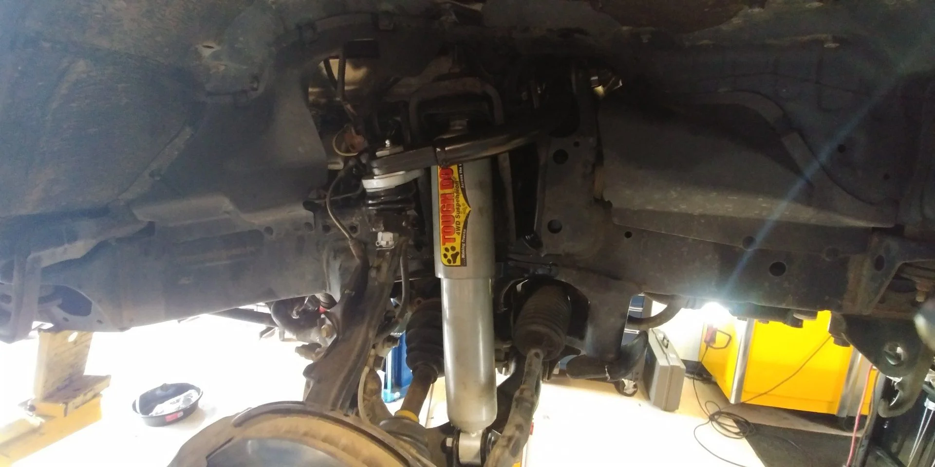

Last week the fun stuff started happening. I made an appointment with my trusty shop Greer Automotive in Woodstock GA to have the AHC deleted and complete suspension installed.
Before doing that, I also had an appointment with my trusty carpet guy. He normally works on investment homes of mine but this truck needed some special attention above what I could do with my hands.
No after pics as it went straight to GAS when he finished with one seat in the whole truck.

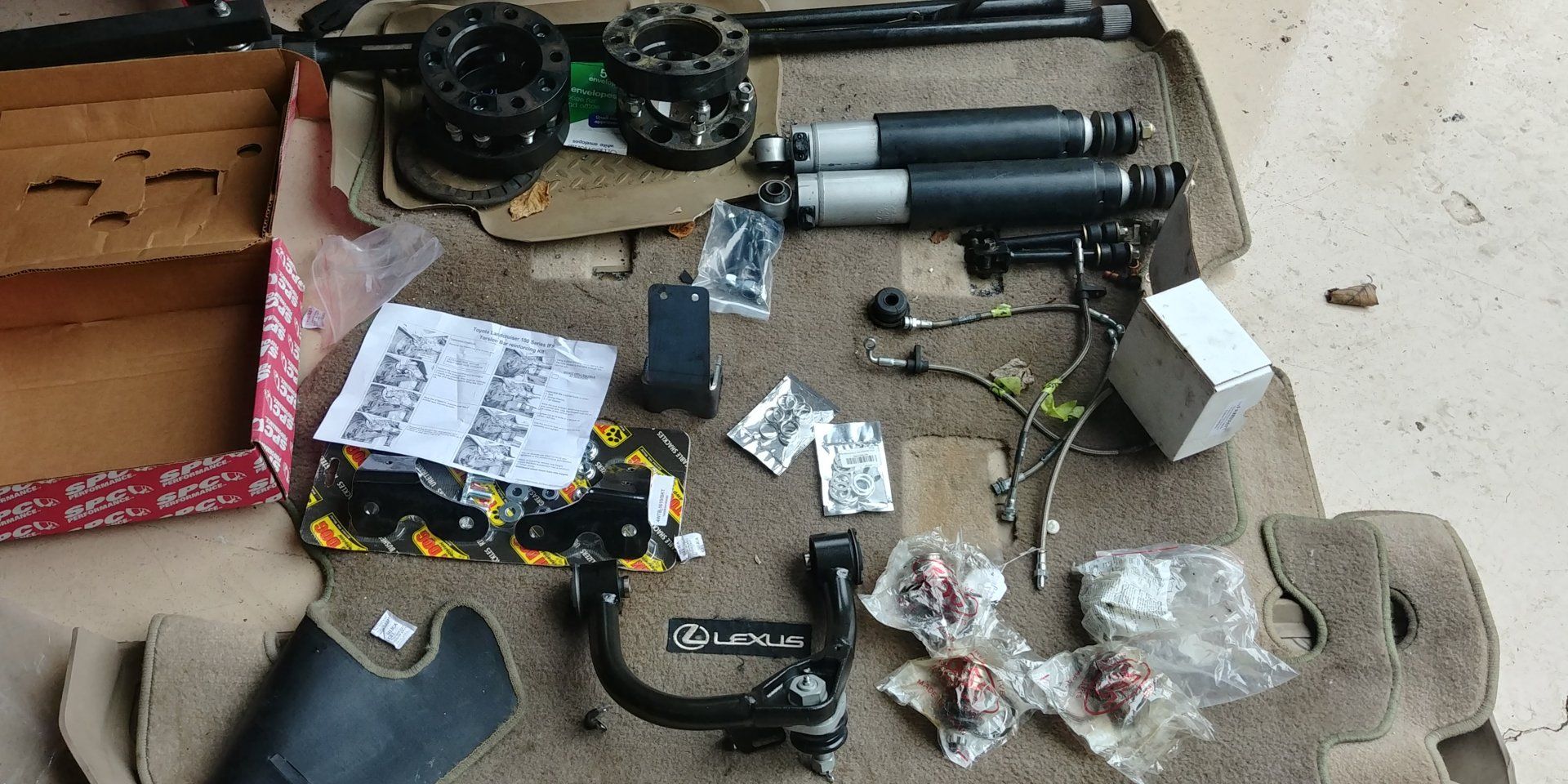

Ended up going with Tough Dog 53MM Ralph shocks up front, 45MM TD adjustables in the rear, TD torsion bars and TB strengthening brackets, and a set of OME 865 coils while I'm still stock weight. Normally I like to do my own wrenching but knowing the fiasco I'd gone through with the last two, they cut me a too-good-to-pass-up deal to delete the AHC and install the lift.

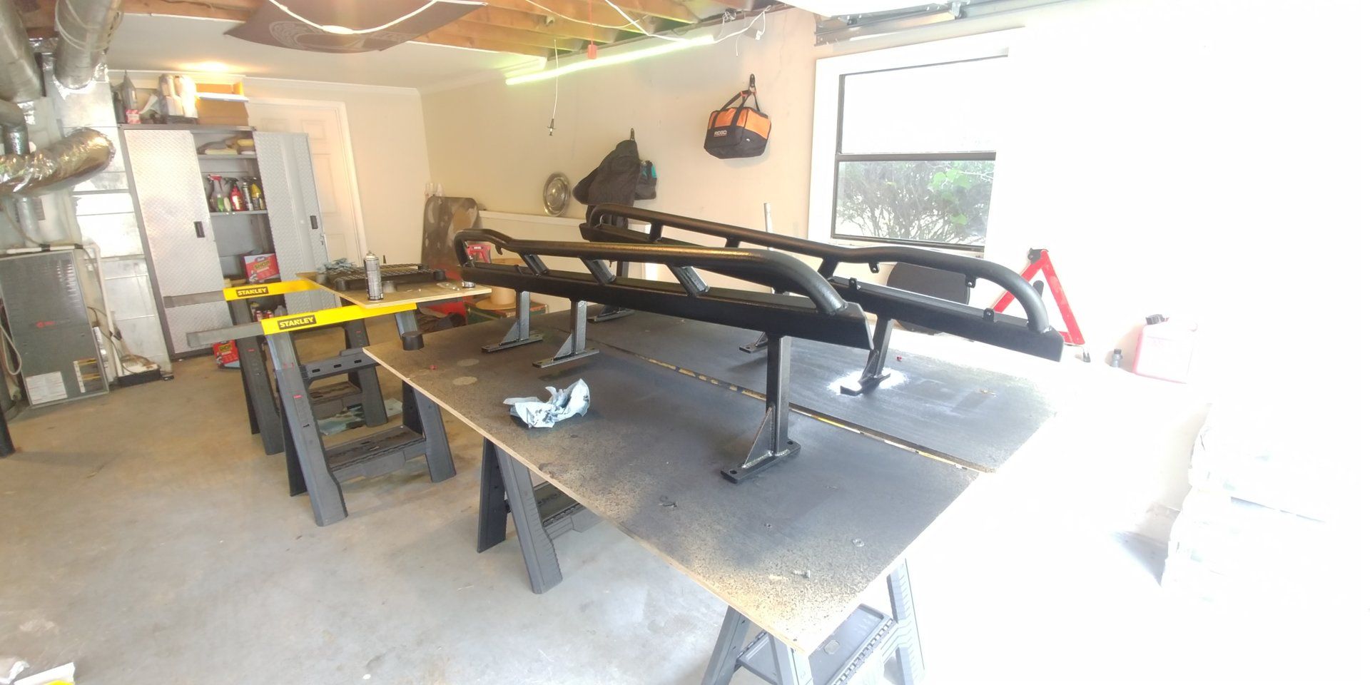

So, I sprayed my new WKOR sliders. Decided on a self-etching primer then Bed Armor (duplicolor?) Anyway the bed liner was s***. The material is too thick for the standard nozzle they put on the can and you end up wasting half of the product when the propellant runs out. That, and it's two weeks in and still hasn't dried to a point where I'd feel confident it will hold up to any abuse. In hindsight, I should have just had them coated by the vendor and touched up with spray paint as needed.

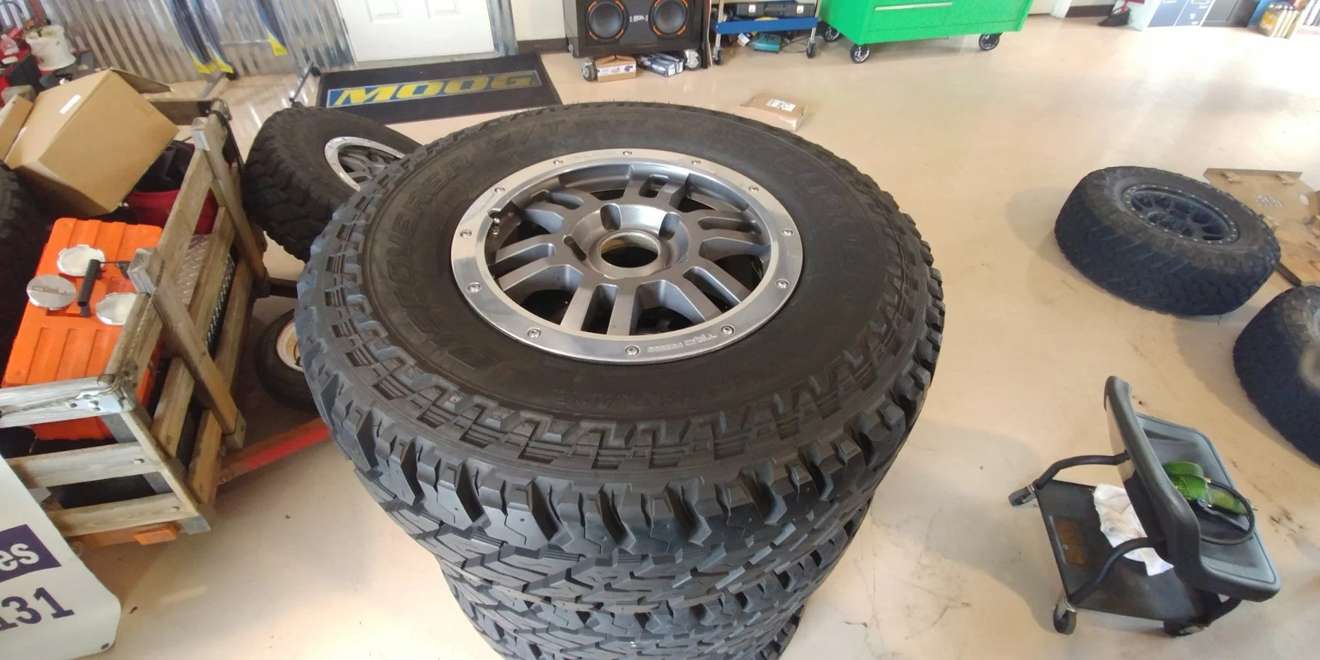

I also checked in on the truck every few days for progress updates. These Cooper tires look awesome on the TRD wheels.

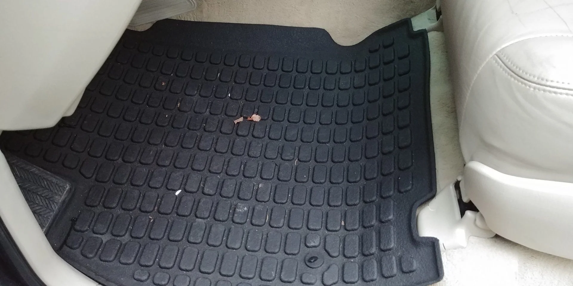

Nothing super cool, but I also got some nice new rubber mats for the truck. After reading some not so great reviews here of the Weather Techs, I decided to search for something else very heavy, sturdy, model-specific, and with good coverage. These came from a company called Star Diamond. I think the 4 piece set (2 fronts, 1 2nd row, 1 third row) was $140? shipped. I like them a lot, and for the price point they're definitely worth a look over some other bigger brands. There's a cargo area mat that I've yet to order but I think I will be.

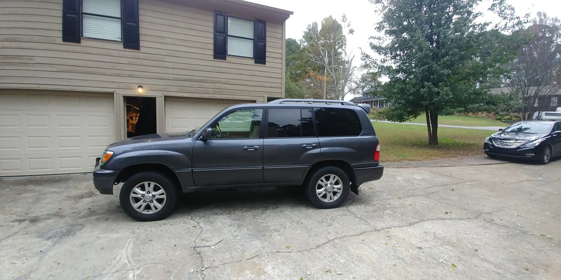

A few current shots from her natural environment:
