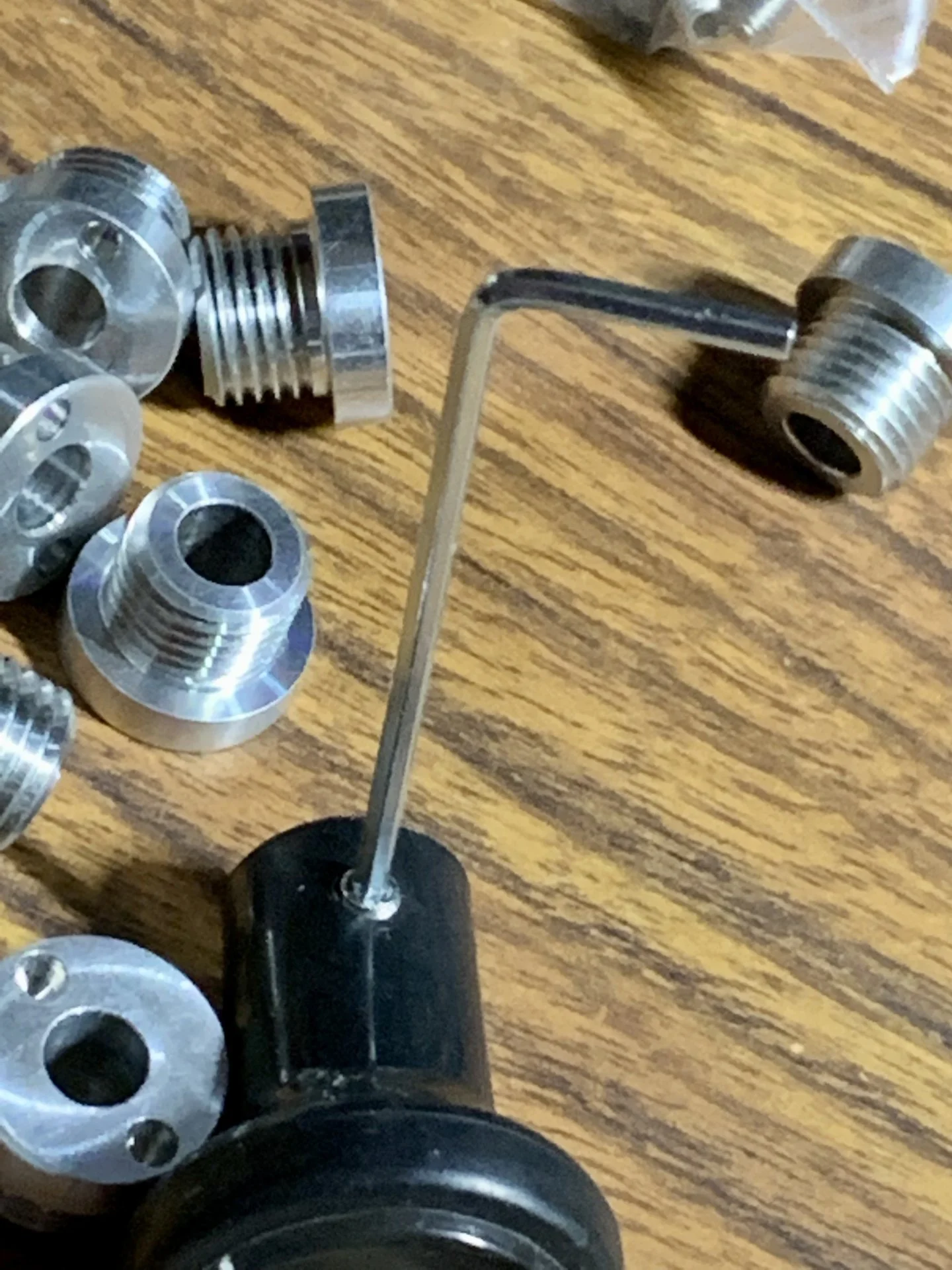

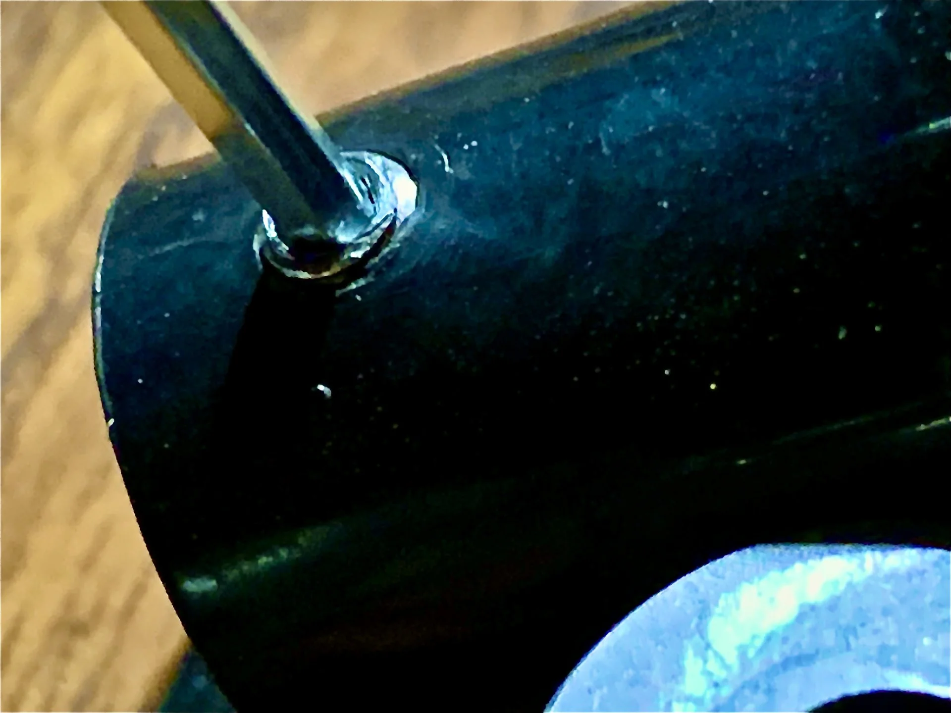

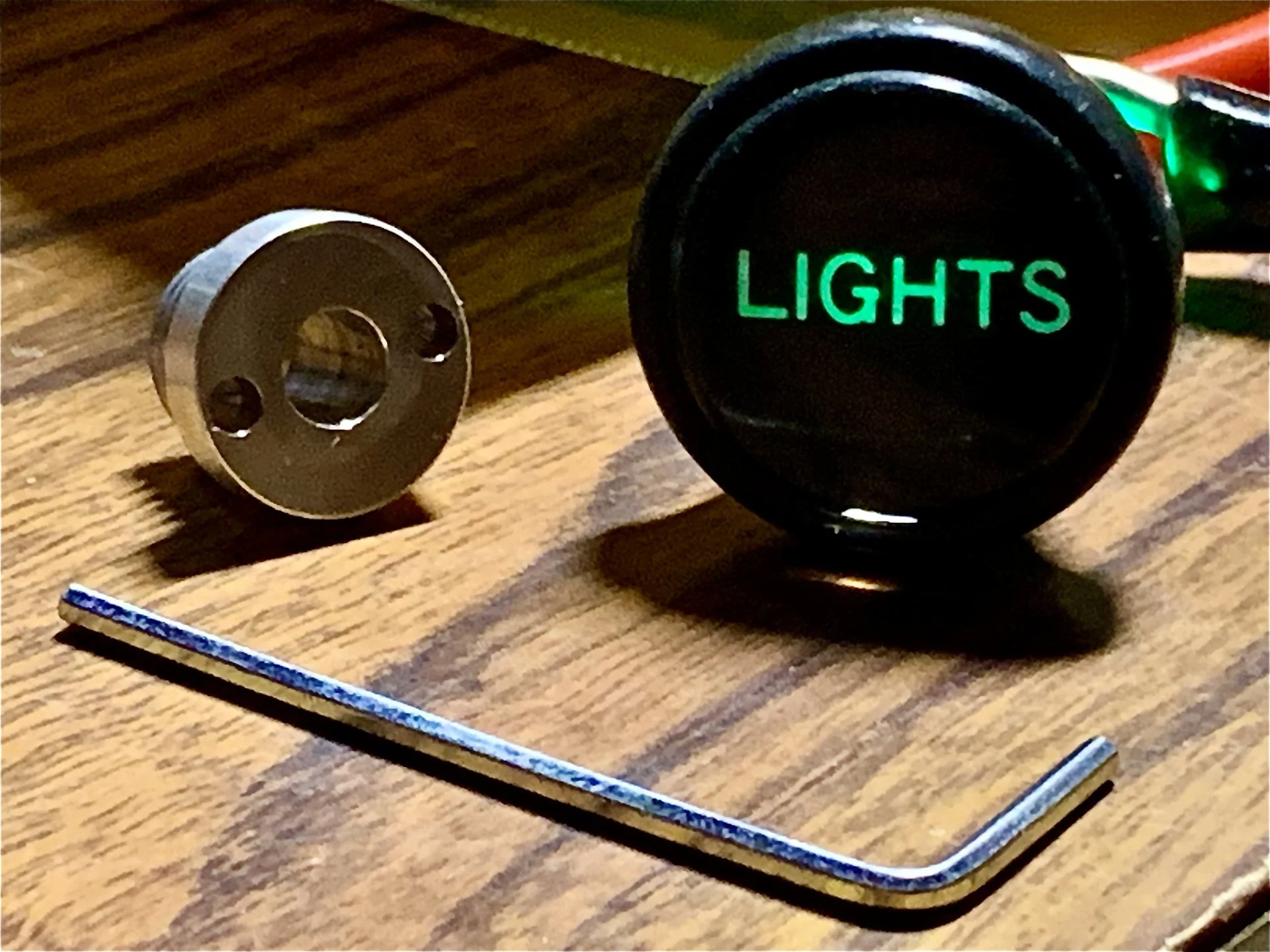

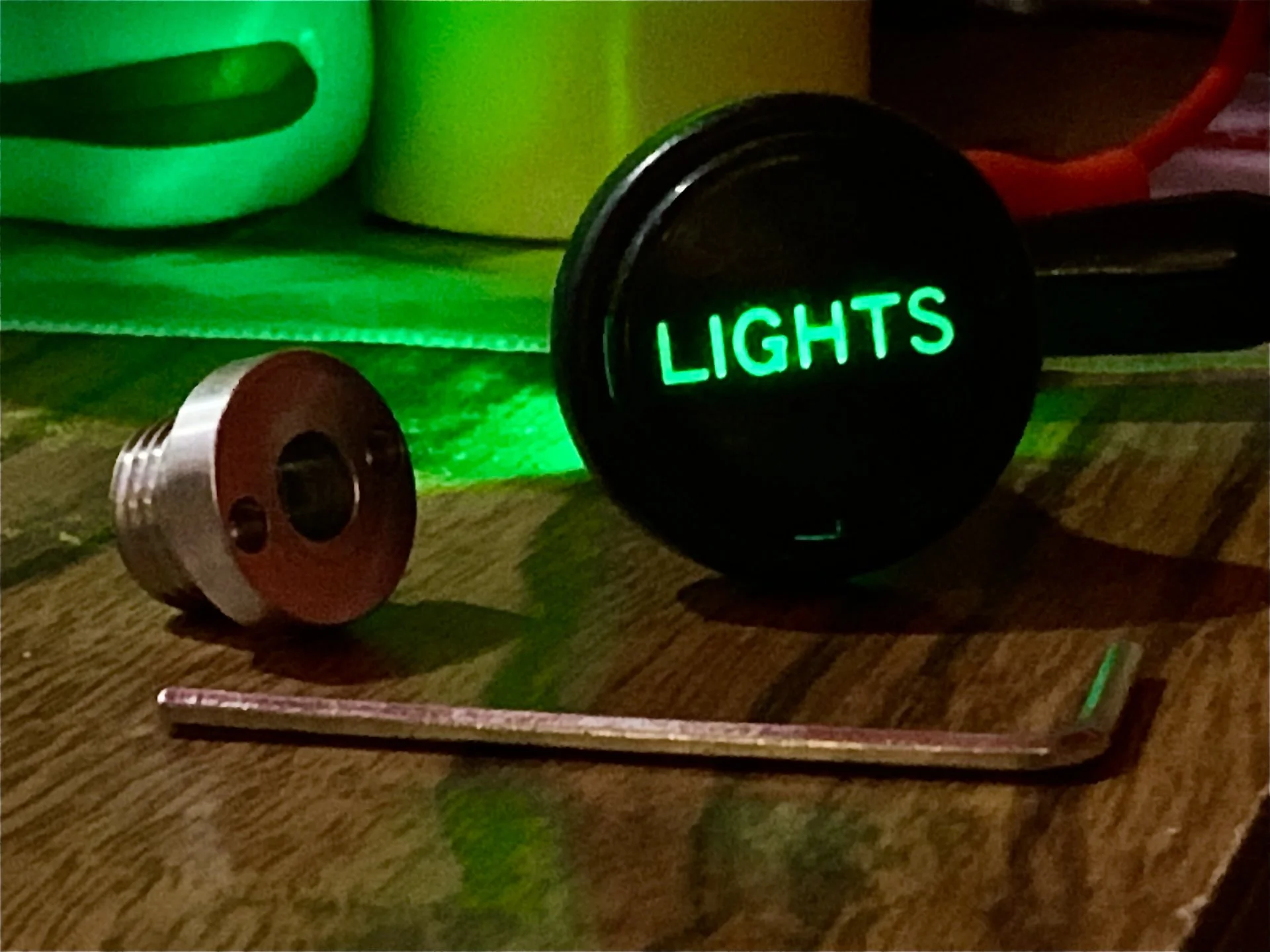

Here is your replacement knob , my reproduction pin wrench nut and 2 Allen keys
I got weary 😮‍💨 years ago of screwing around with those case hardened lock shackle set screws i update anything that comes into contact with me
Stainless steel recessed hex
It’s simply the bomb !
I PM u also reply back shipping addy these in the mail to you …
Holiday spirt you know
Oh special update LED green Lumens oem
Color code period correct too
