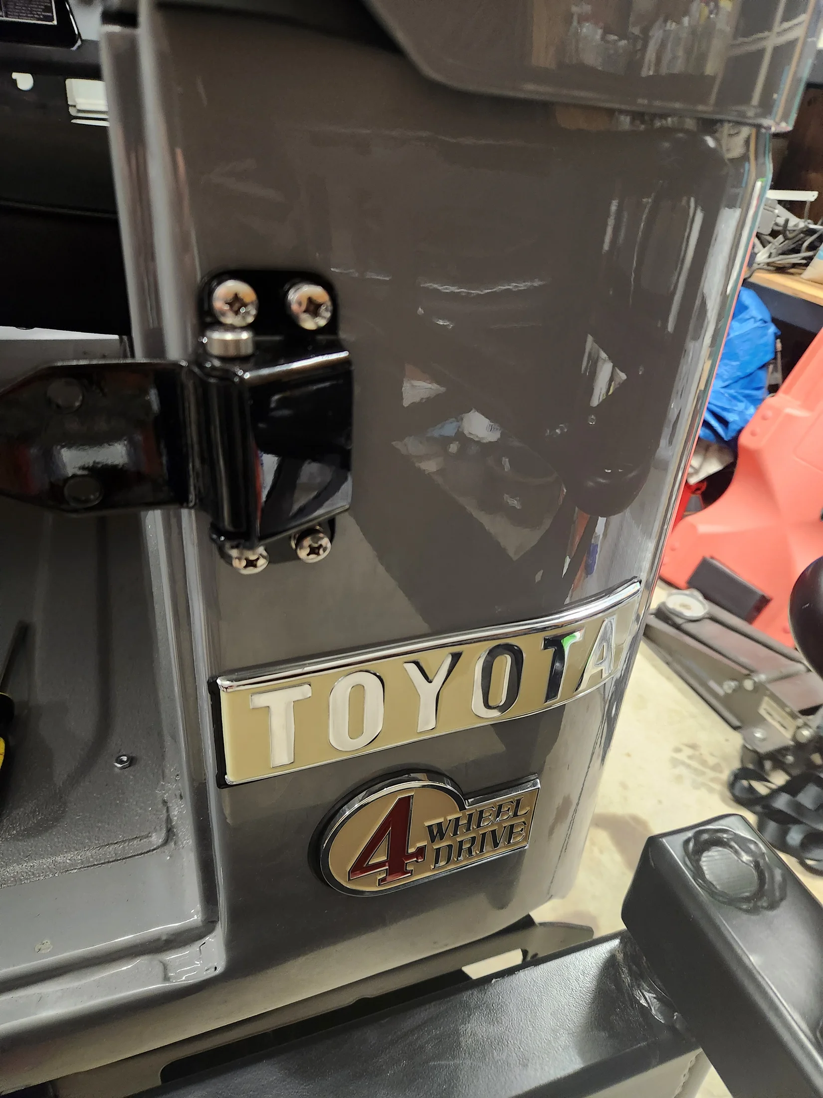

Well thanks to mud I just realized that OEM fasteners for the rear ambulance hinges were screws and not bolts. And im pretty sure I have screws somewhere that are labeled ambulance door. I'll locate them tomorrow. Guess that's what happens when you spread a build over 5 years. I'm also guessing that I may not have an issue with the pins with the smaller headed screw. Will find out soon.
Yep. I screwed up, literally. All good now! Had to get up and take care of it or I wouldn't sleep well. Haha

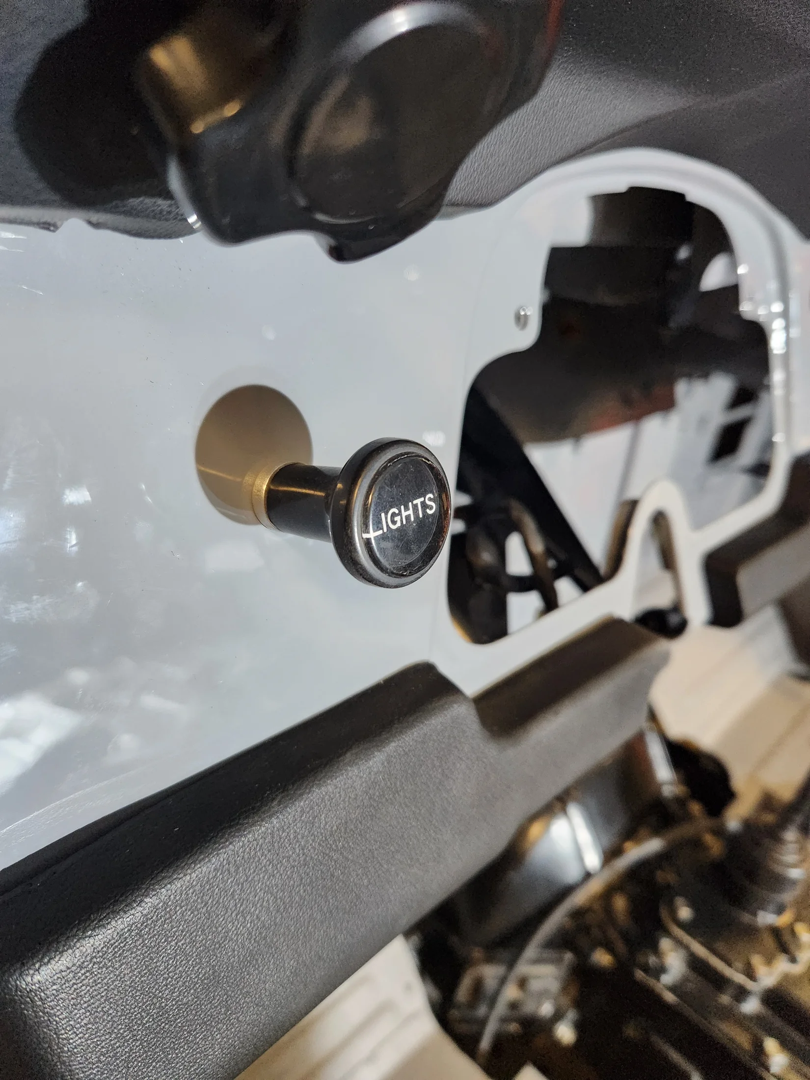

Had the housing for the brake and clutch powder coated some time ago (years, ha). Installed it today. Also worked on the passenger door. New interior pull handle/lock. Ready to add the vapor barrier that @GA Architect made and sent me. Also cleaned up the light pull knob/ switch and installed it. Ordered the Dakota Digital RTX. Plan to have the bezel painted black to match glove box and ashtray. Didn't spend a lot of time in the shop today, but made progress.

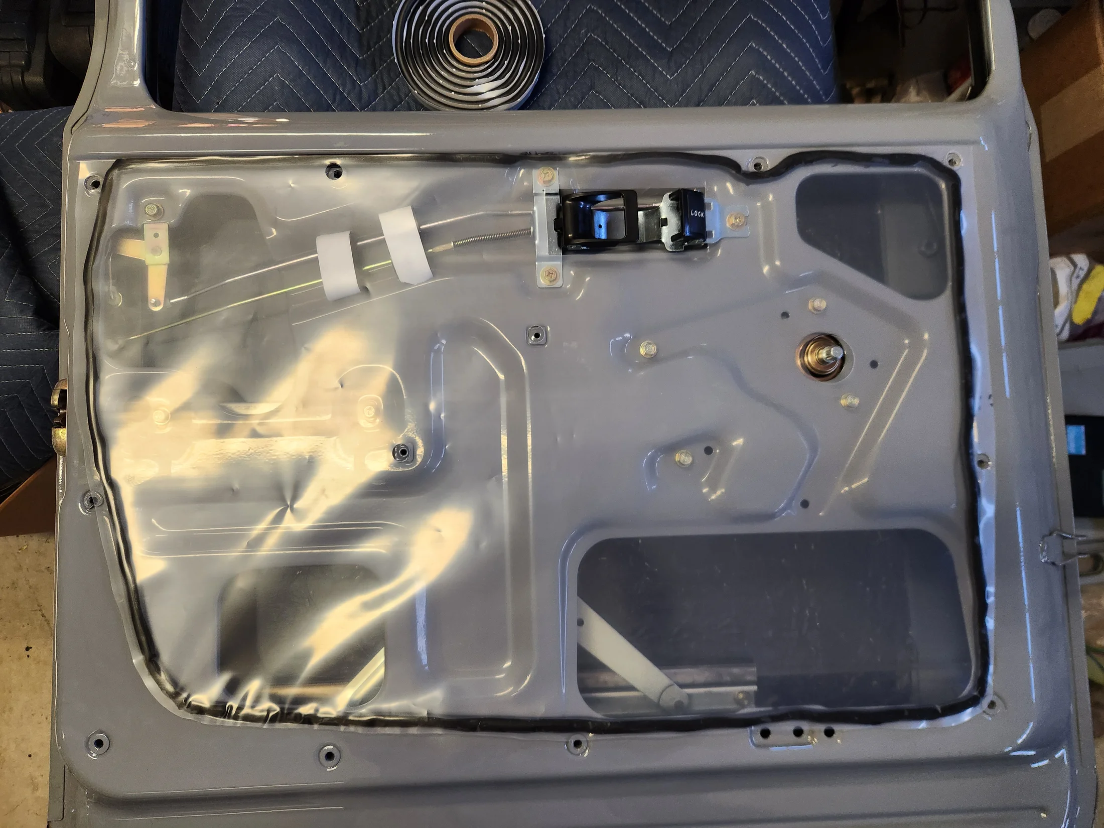

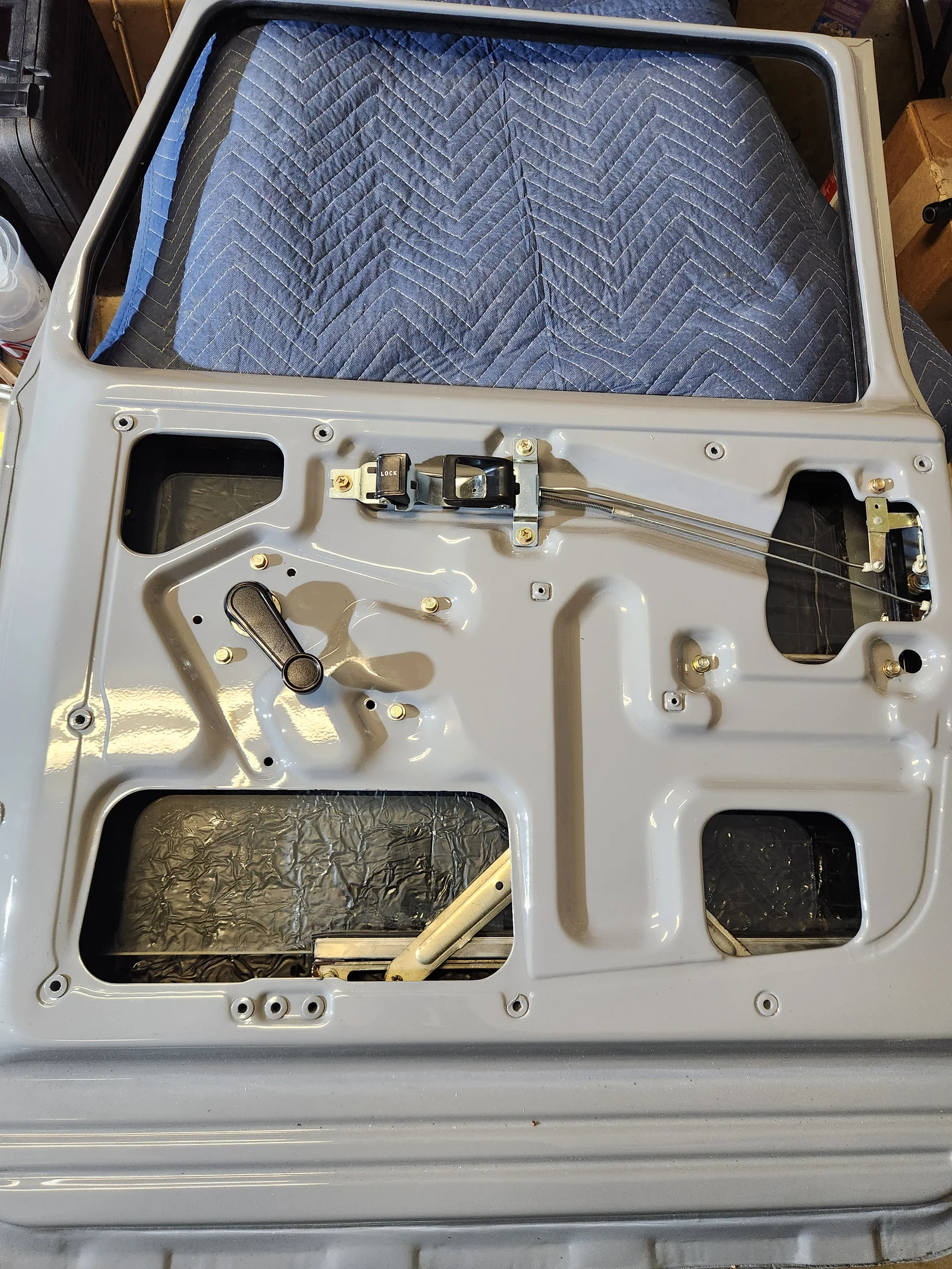

Wasn't happy with the window regulators so ran over to CCOT and picked up some new ones. Got the @GA Architect vapor barrier tacked down with some butyl tape. These things are cut perfectly. I did mess up by running the tape too close to the top and have since fixed it, but didn't get a pic. Not sure why I did that. Live and learn, ha.

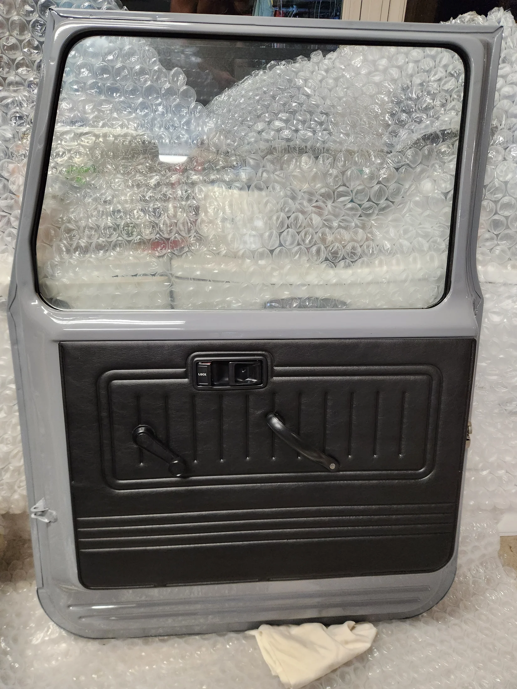

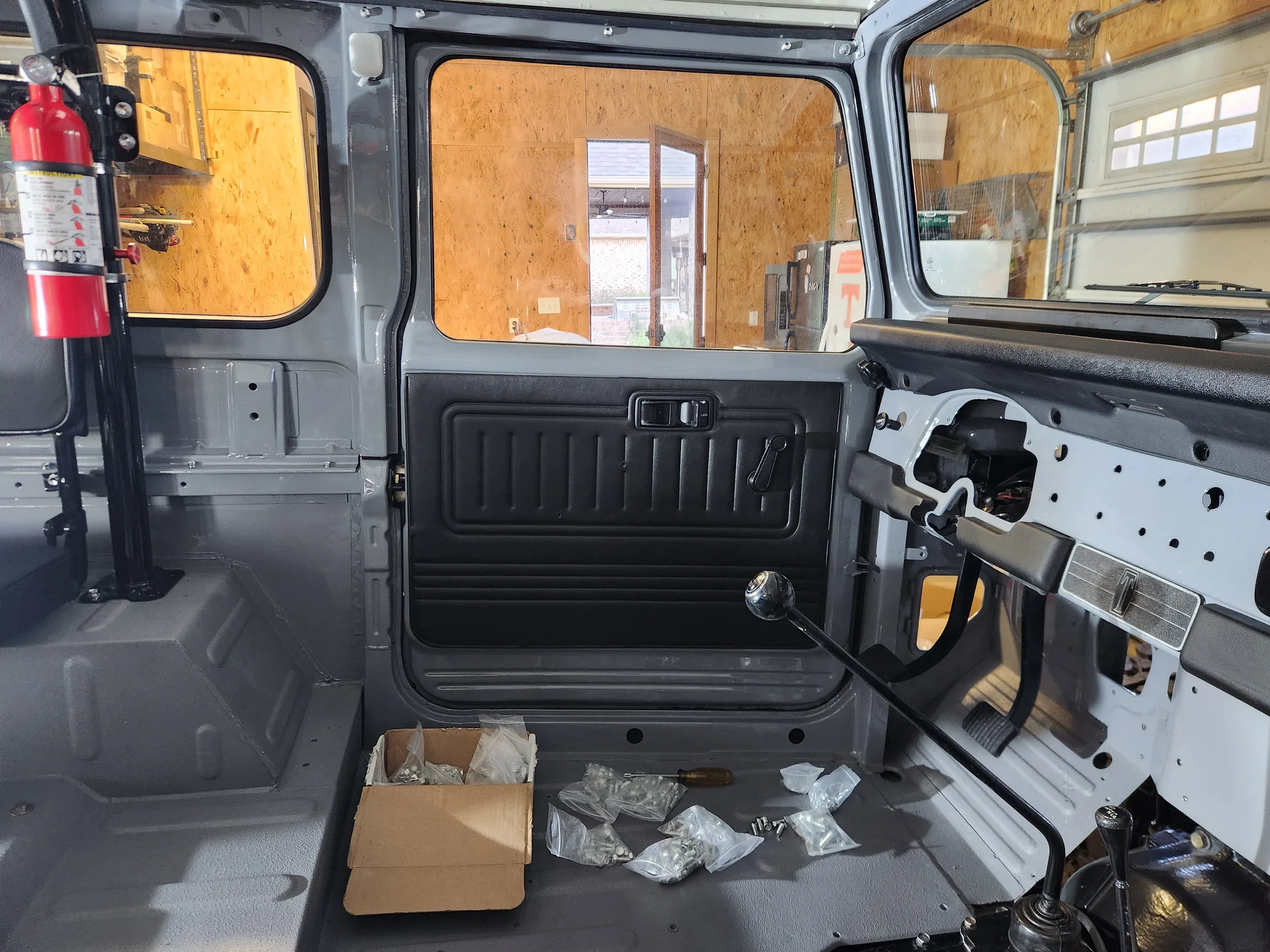

Installed the door cards. I used some vinyl paint to turn the new OEM cards black a few months ago. Installed them and the rest of the bits and now the doors are done aside from weather stripping. Maybe tomorrow on that.

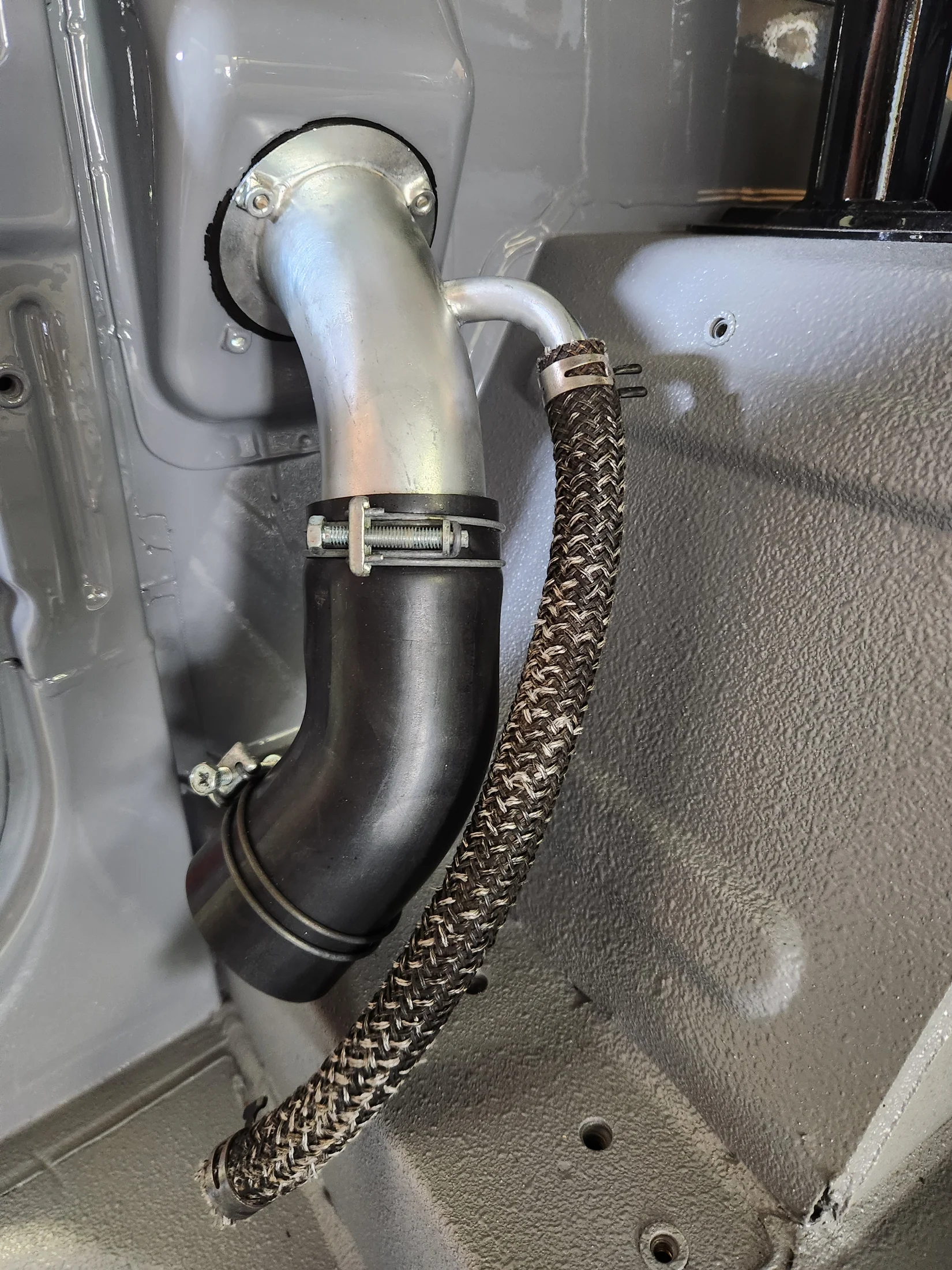

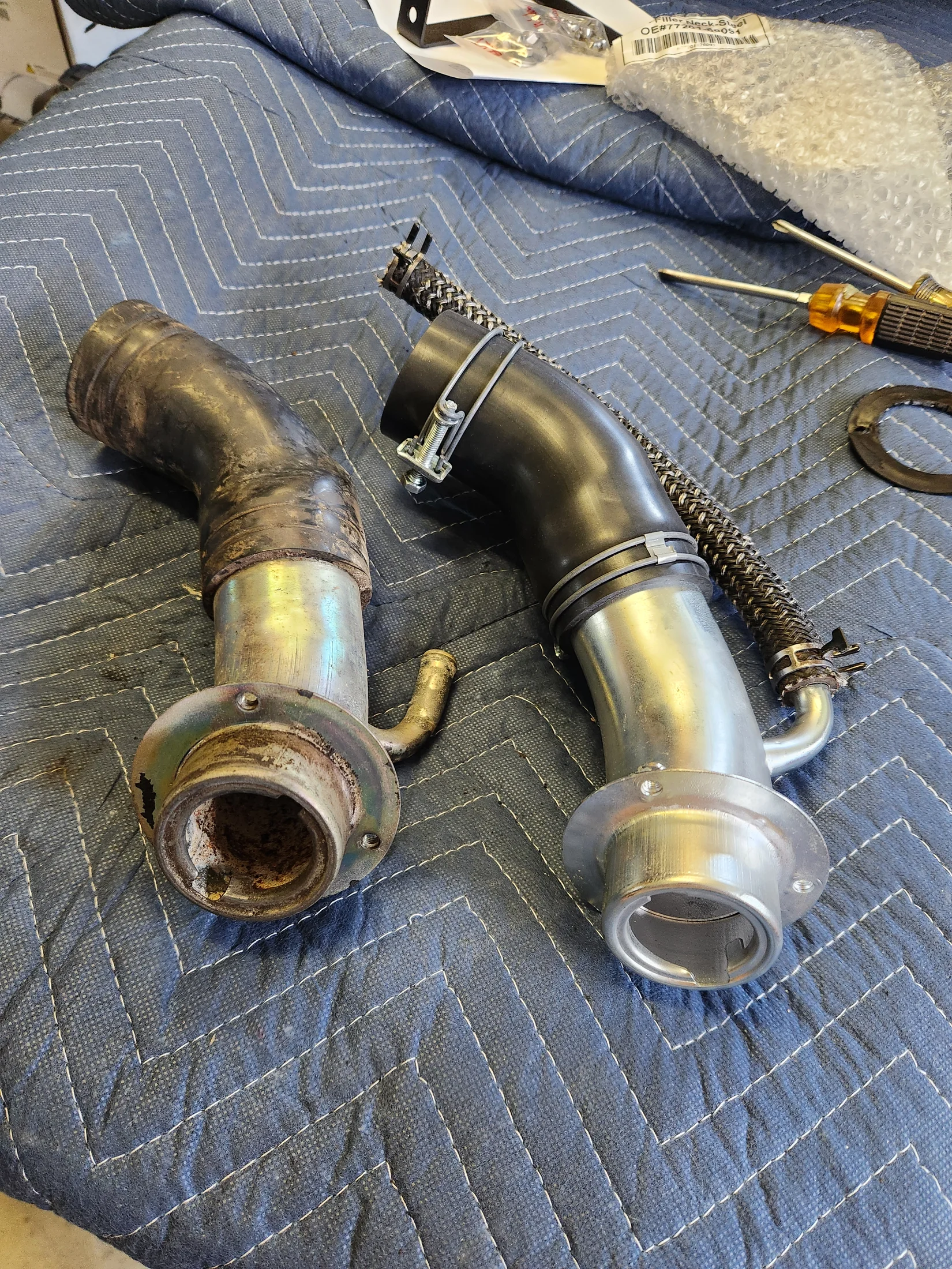

Also picked up a new fuel filler and installed it. Old vs new...

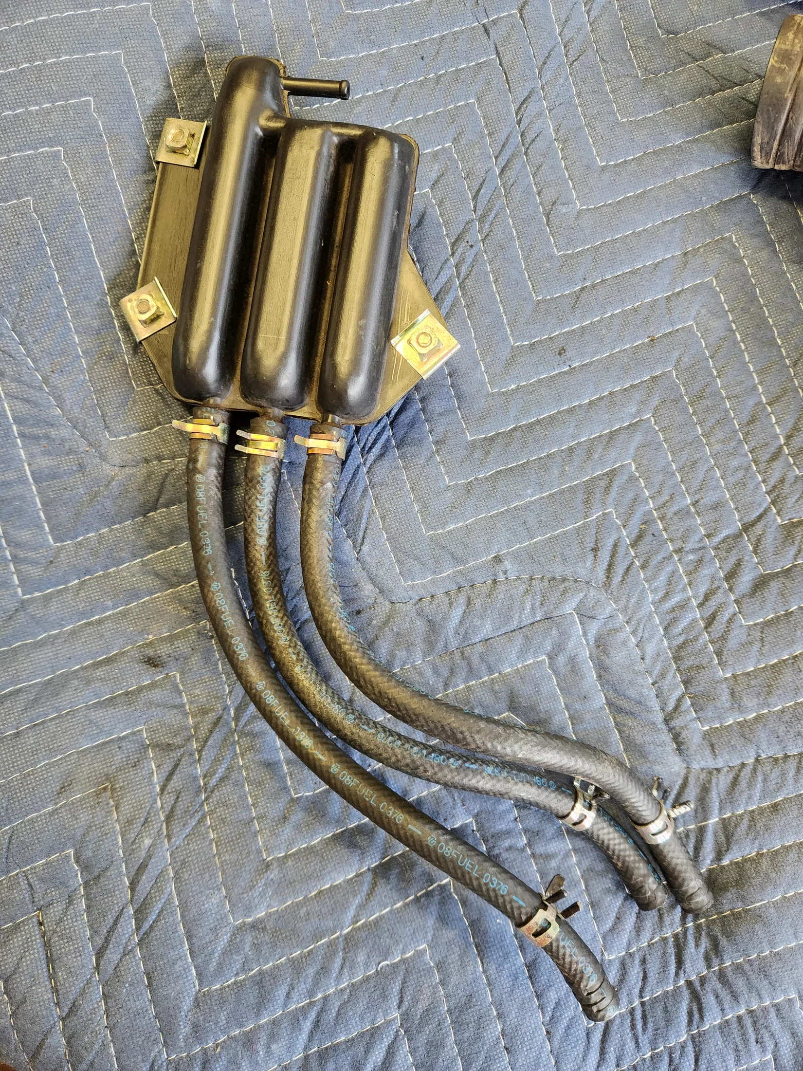

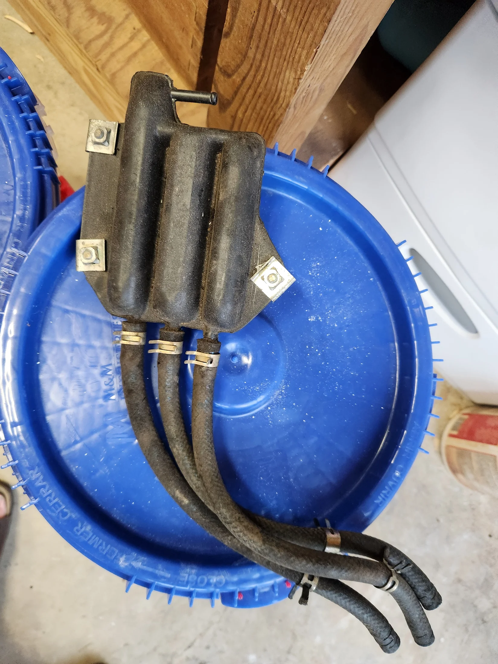

Freshened up the fuel vapor separator. It was in good shape, just needed a lil TLC.

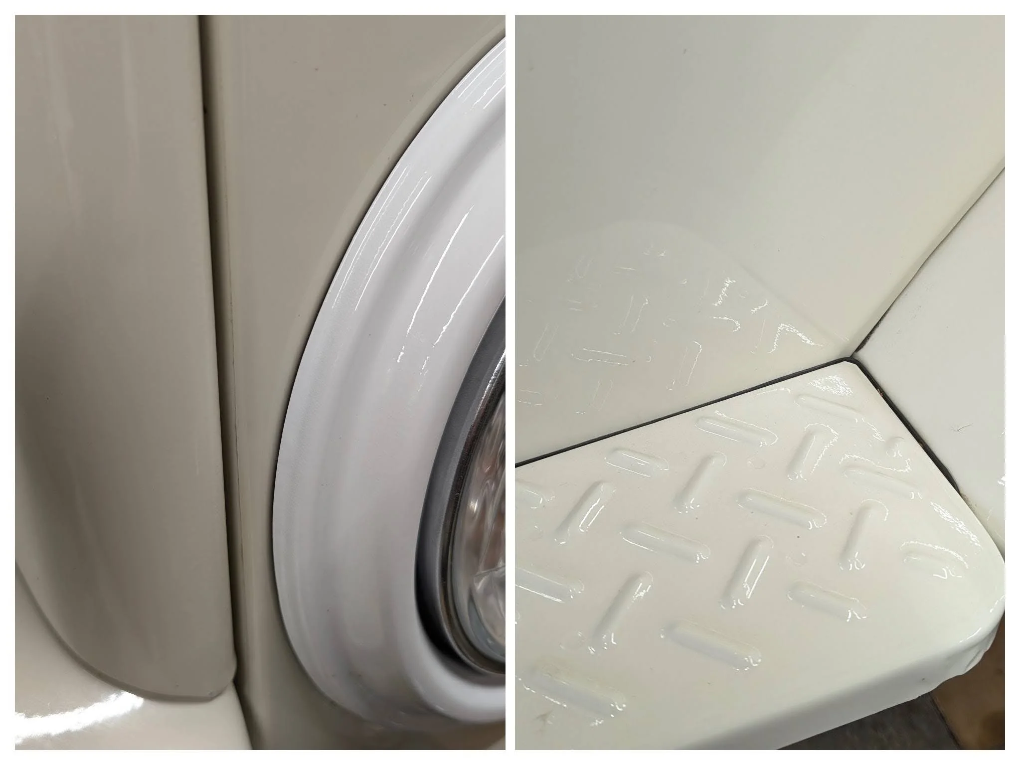

Loosley installed the running board on driver's side. I added a strip of neoprene tape bewtween it and the body. On that note, how is that working for you @zerotreedelta? I picked that up from your YouTube videos. I really appreciate your vids. They have been an extremely helpful reference for me.
Coming up on 4 years already, so far so good. Both the 3M clear PPF and the 45-mil EPDM rubber are holding up pretty well.

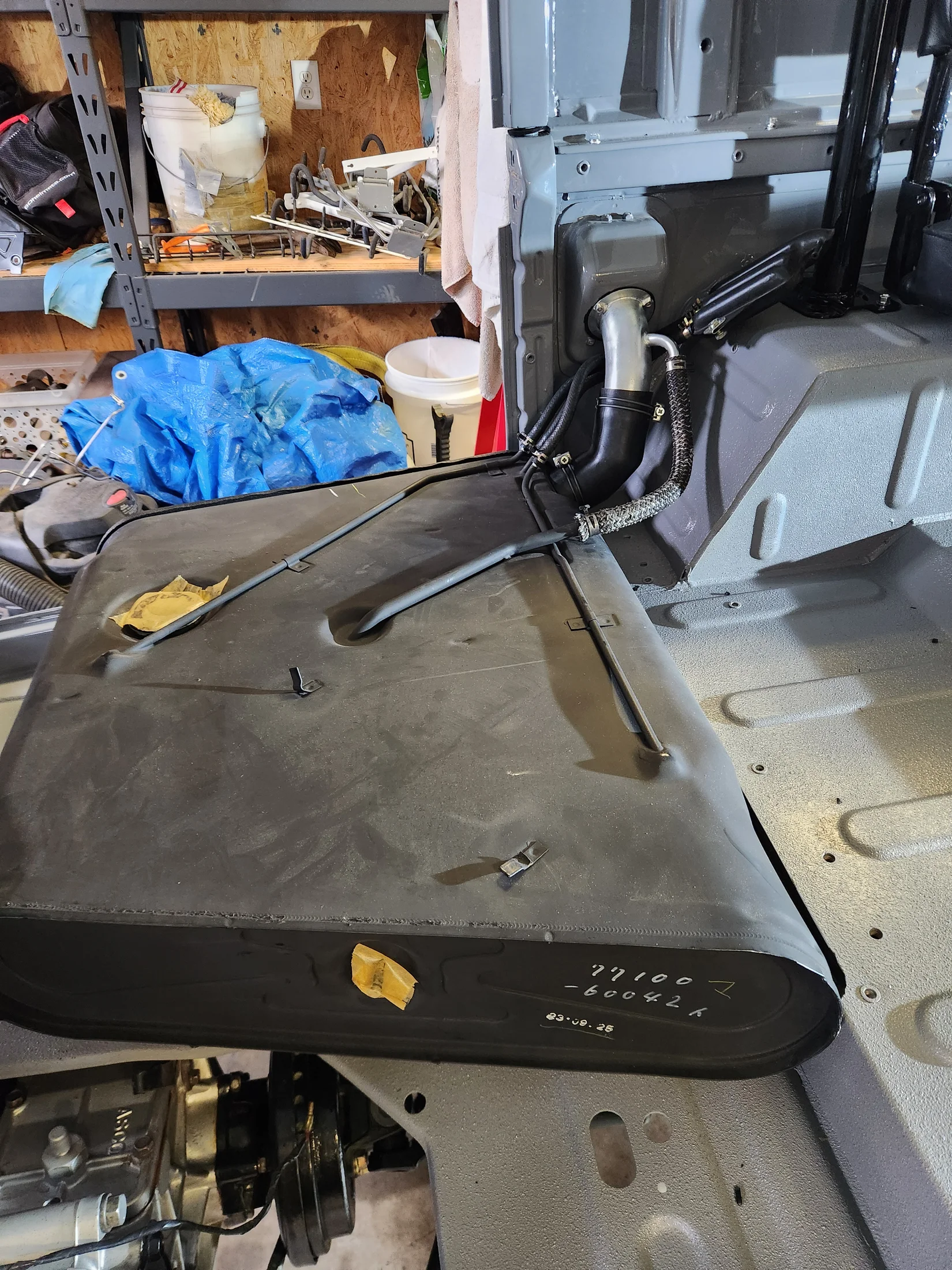

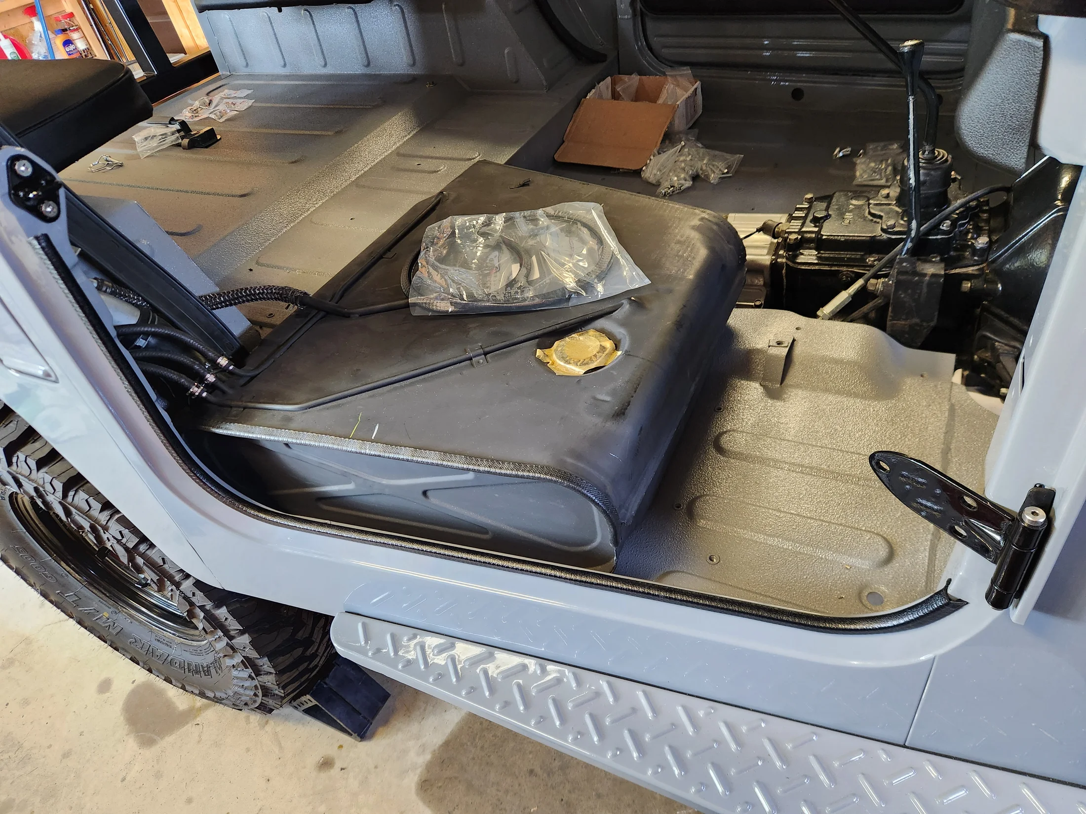

Gas tank is in. Added some neoprene strips for cushion. Hooked up fuel filler and vapor separator.

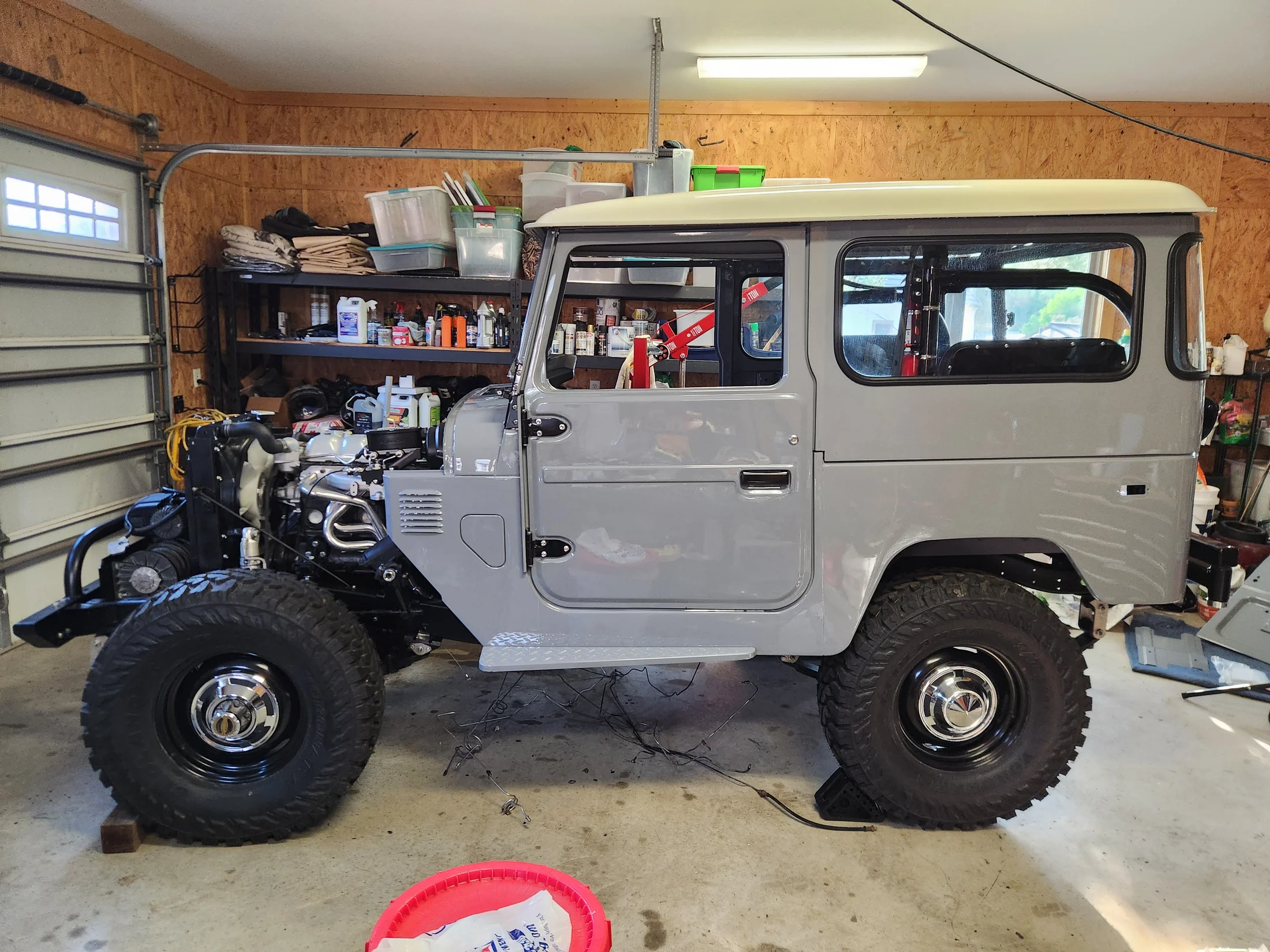

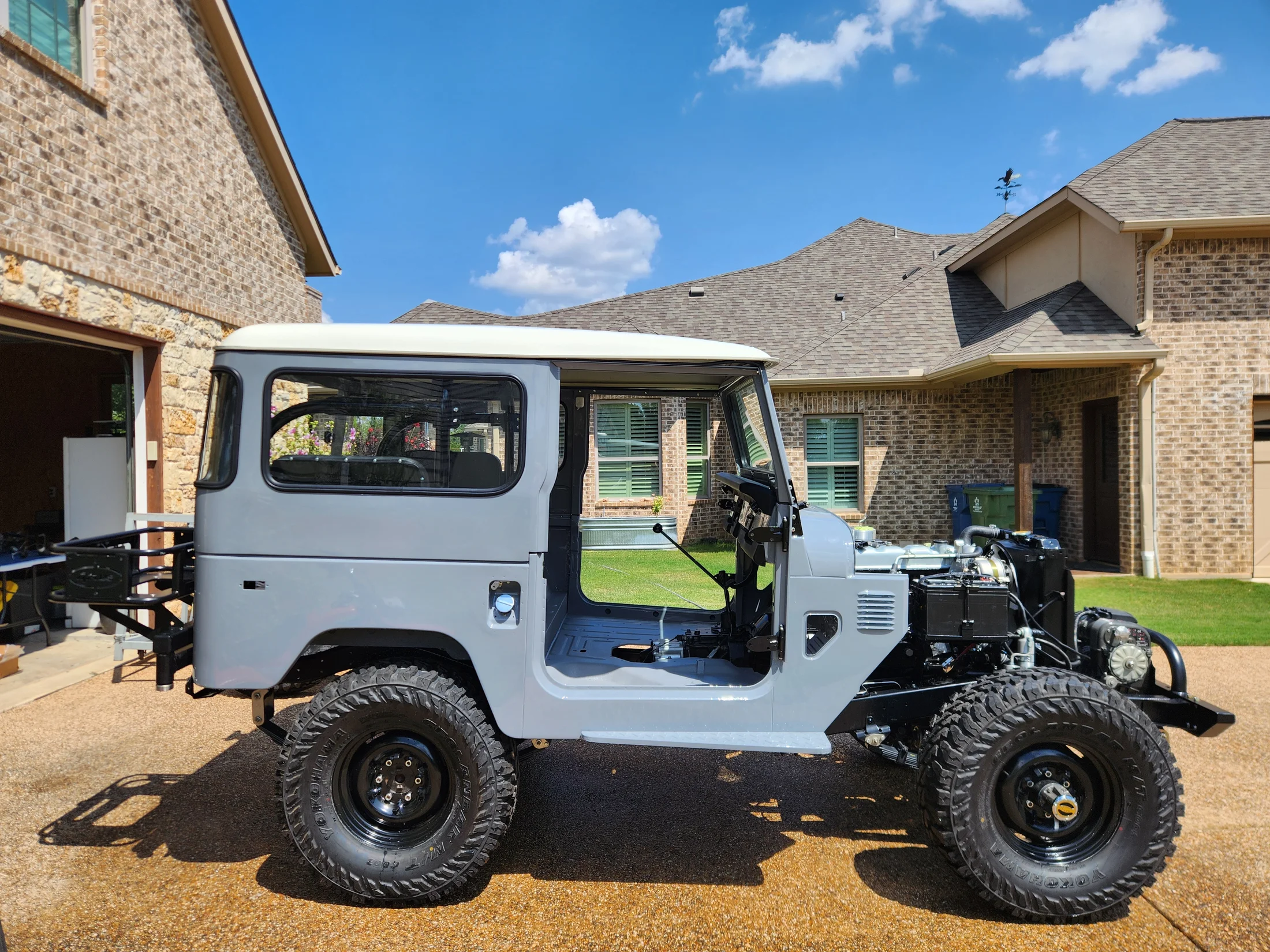

Finished up driver's side door weatherstrip. Loosley installed door, still need to make adjustments.

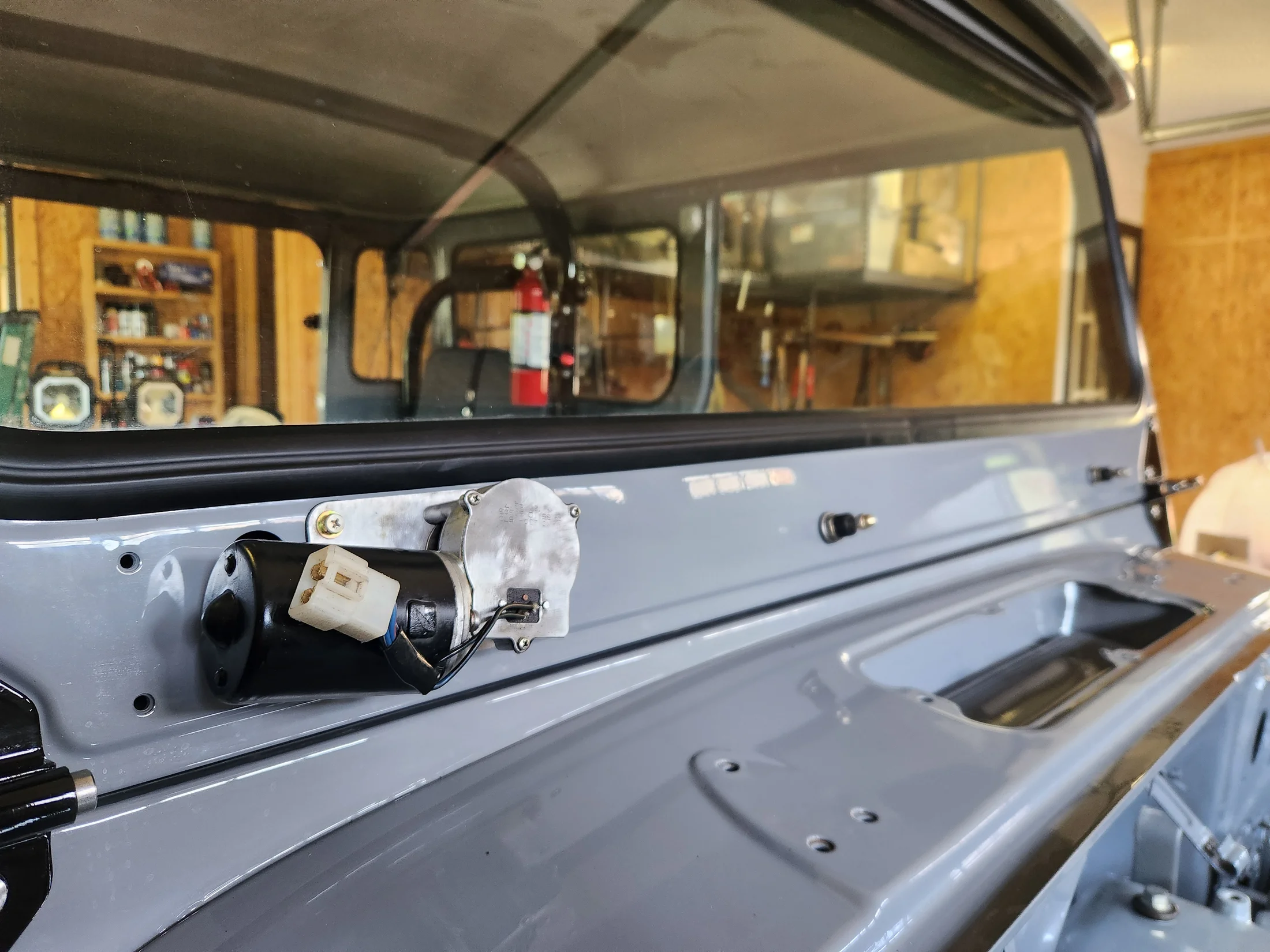

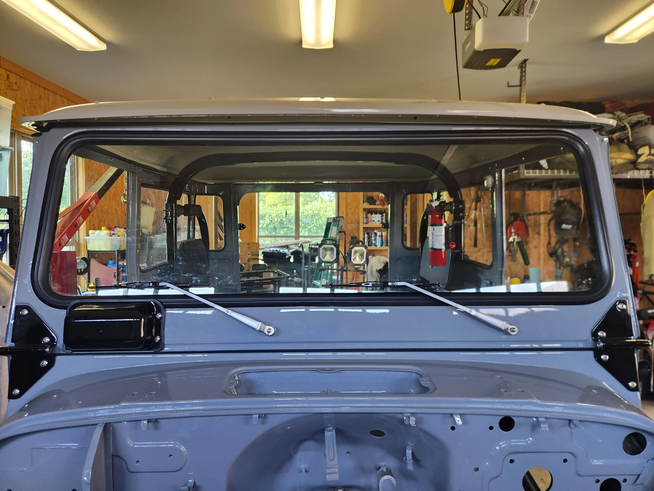

I refreshed the wiper motor months ago. Installed the internal arms then mounted motor. I put the wiper arms/ blades on temporarily. Plan to either paint them black or source black ones.

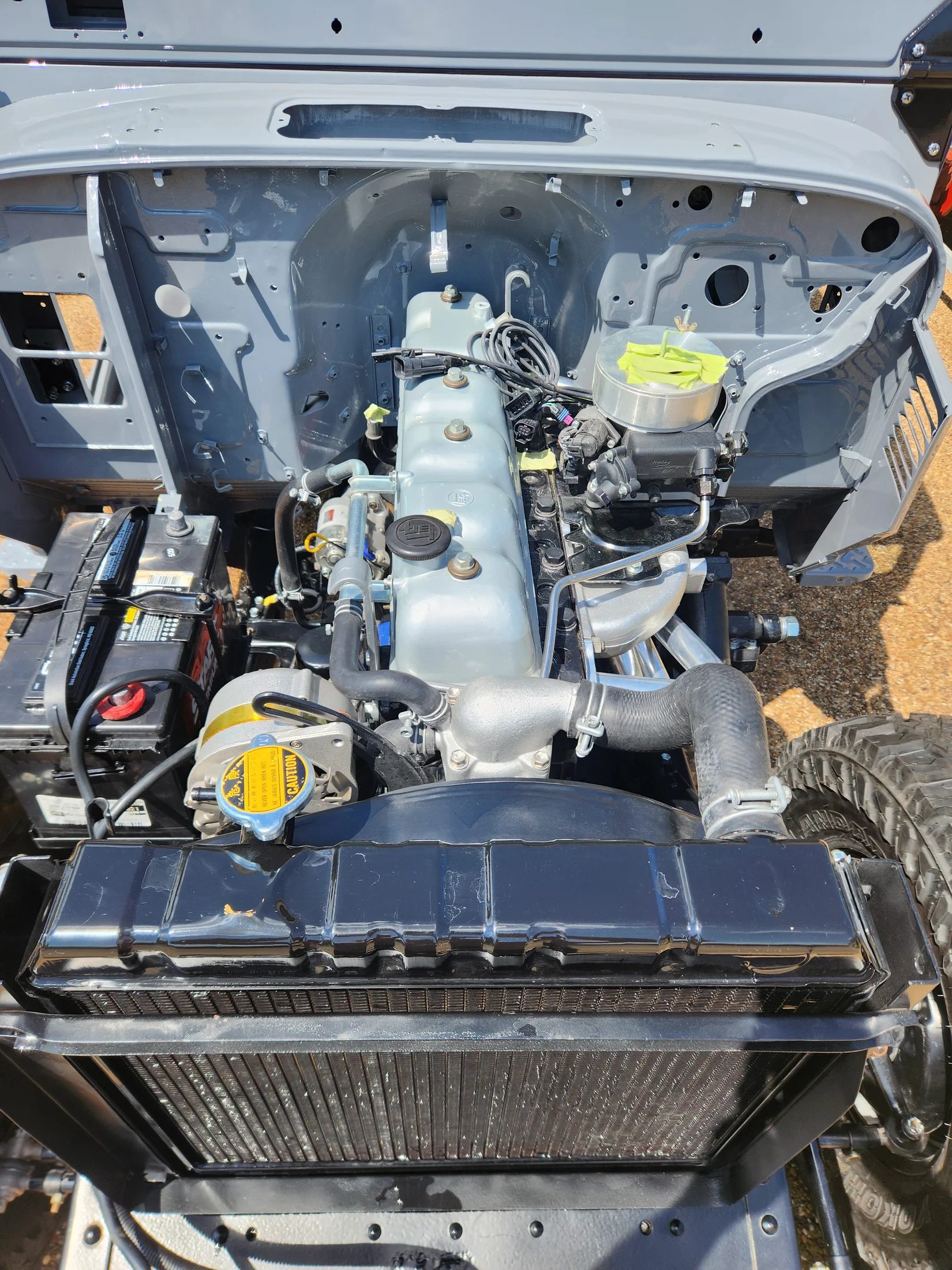

Looks terrific!. Couple questions:

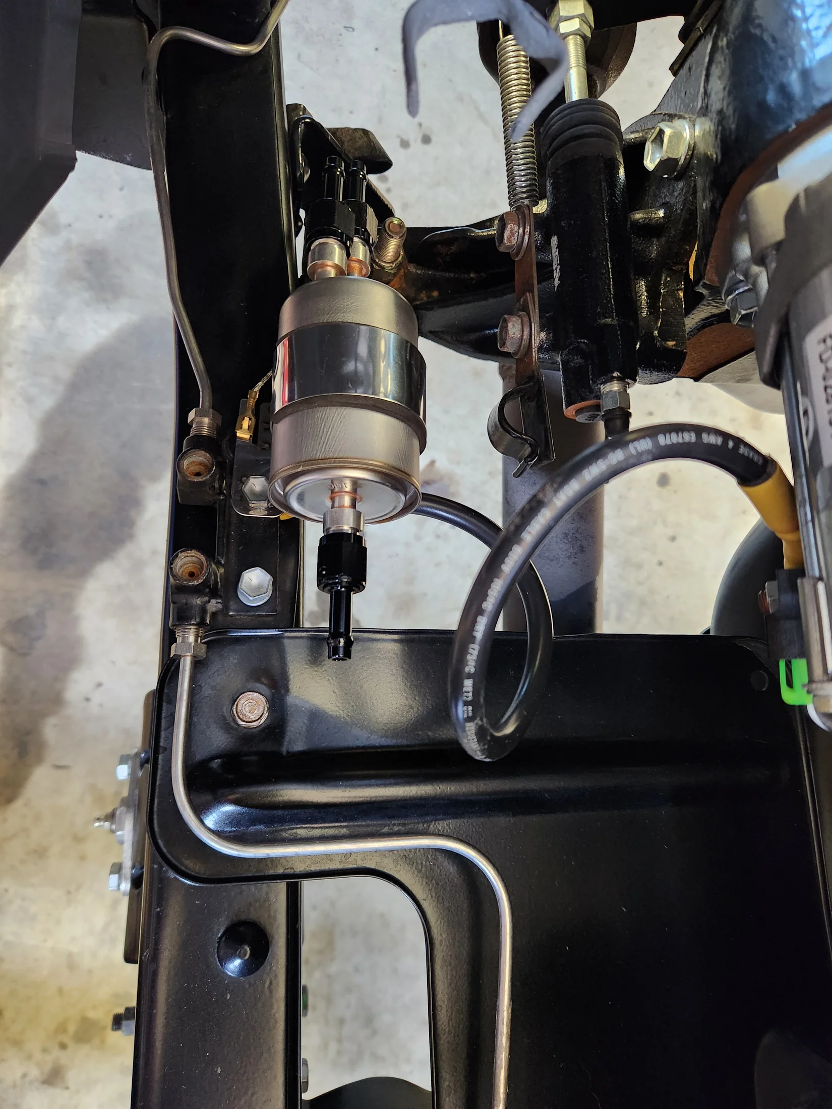

1. Did you make the hard fuel line to the sniper? Or is that a Mosley component?
2. Did Vintage air change the compressor bracket or is that still the OEM alternator bracket I see?
Thanks. The hard line was part of Mosley's sniper kit. That's the OEM alt bracket, I haven't unboxed the vintage air unit yet.

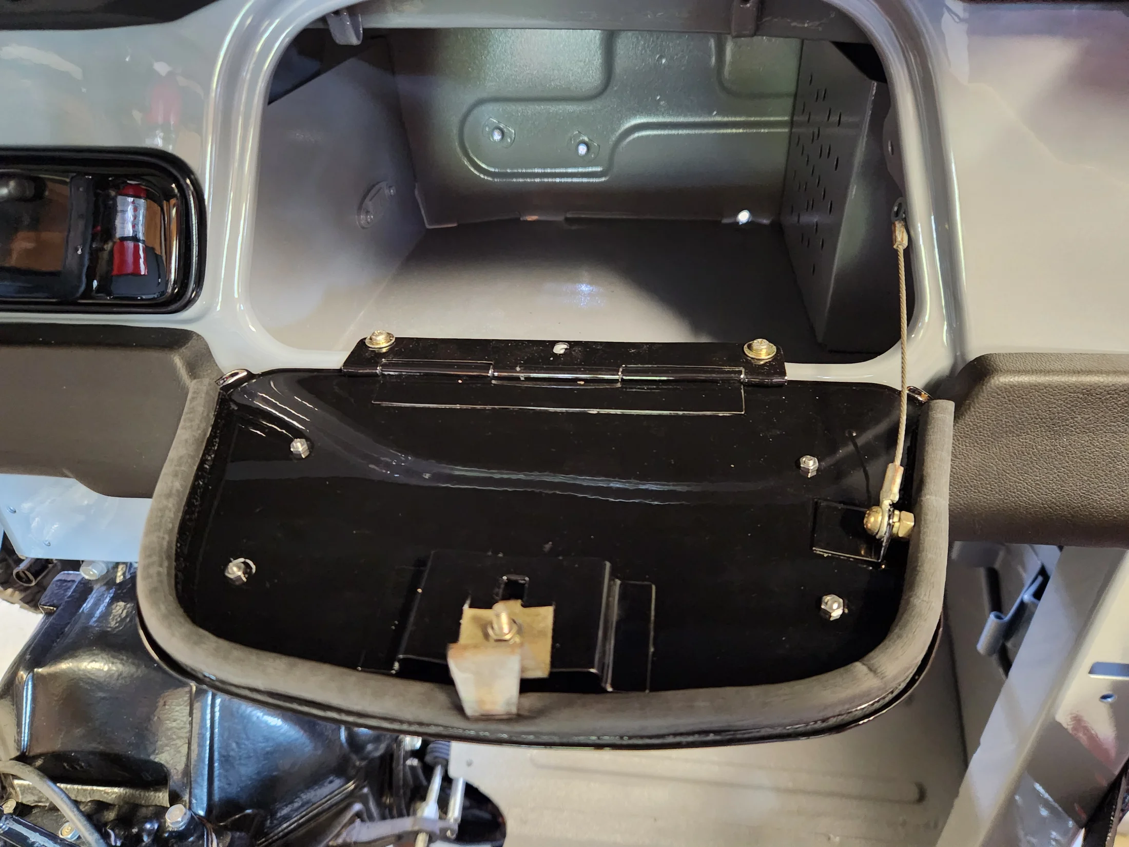

Added seal to glove box door.
Mounted the corvette style fuel regulator. It was part of Mosely's sniper kit.

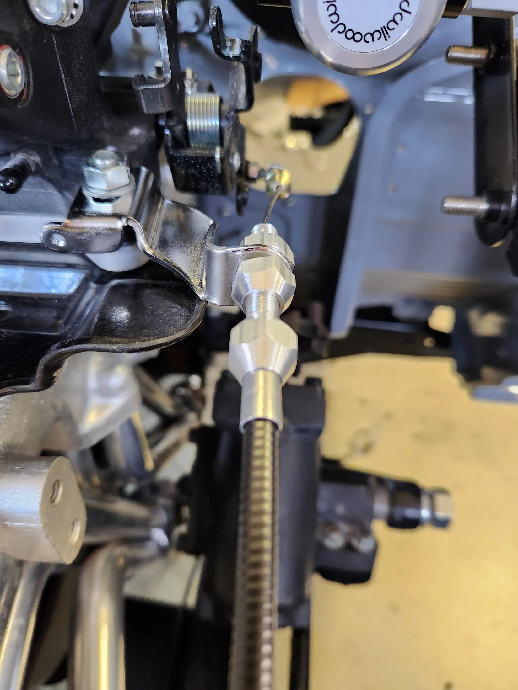

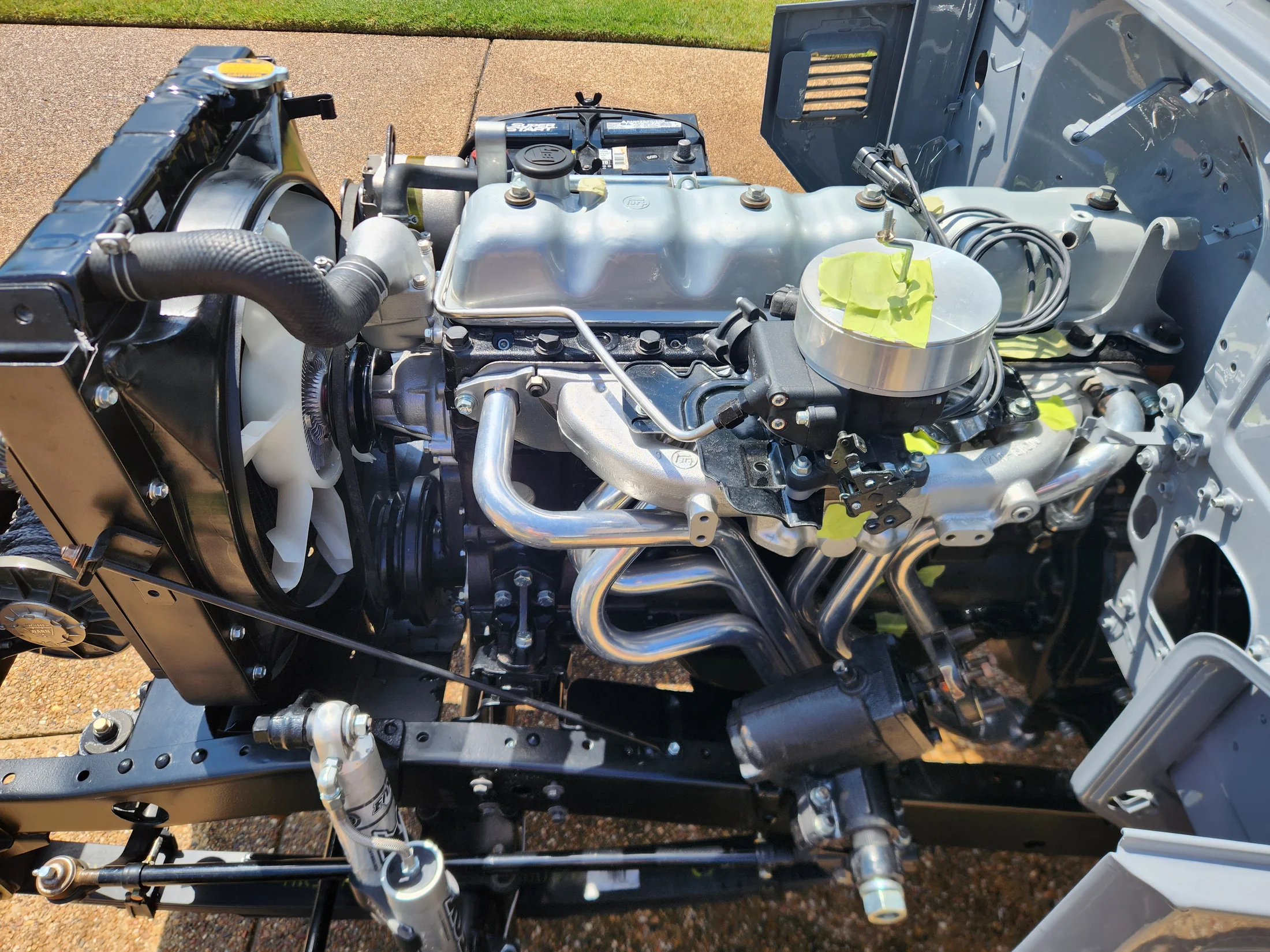

Started working on the throttle linkage. Mosley bracket and Lokar cable.

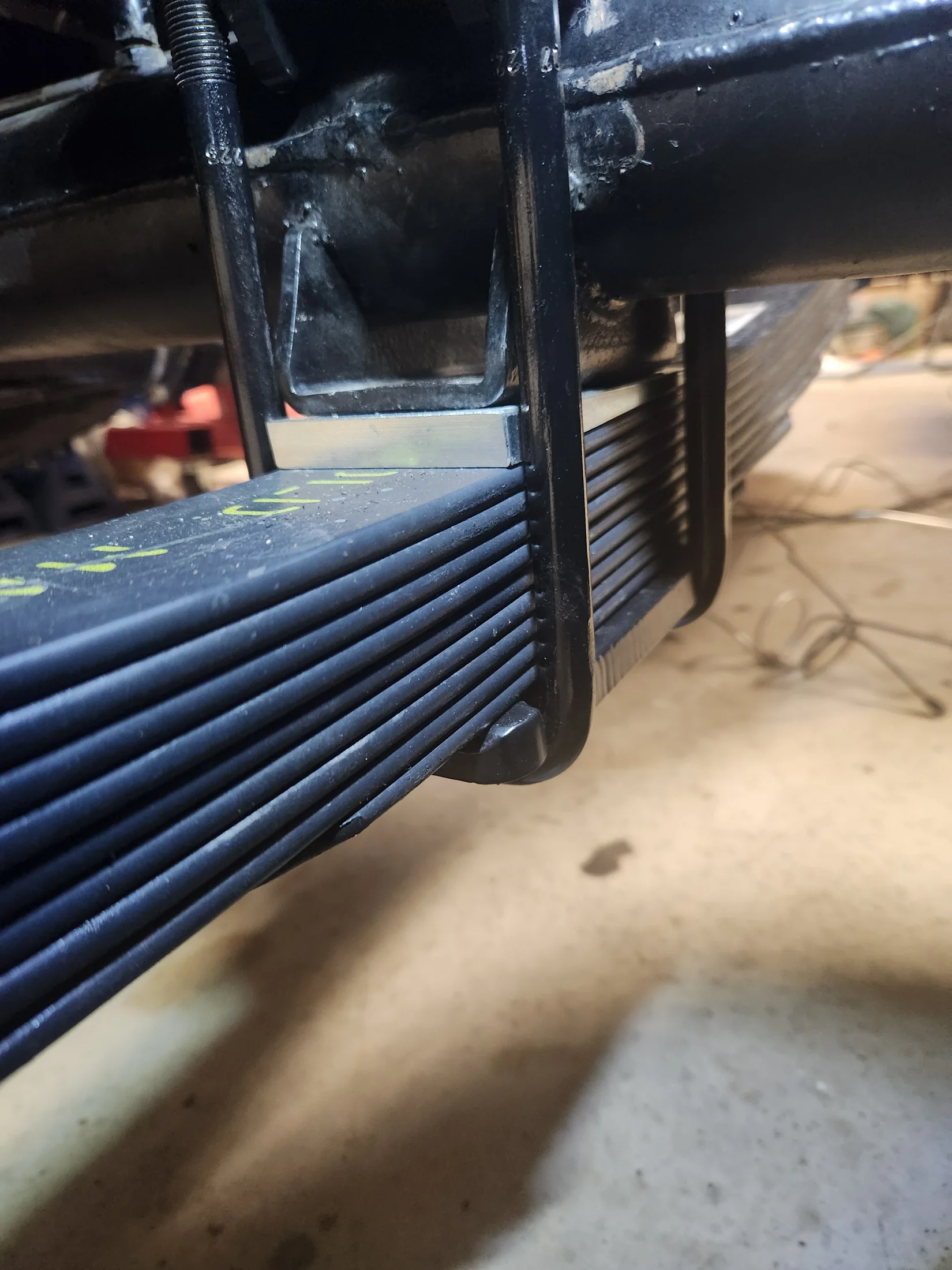

Added shims to front springs.

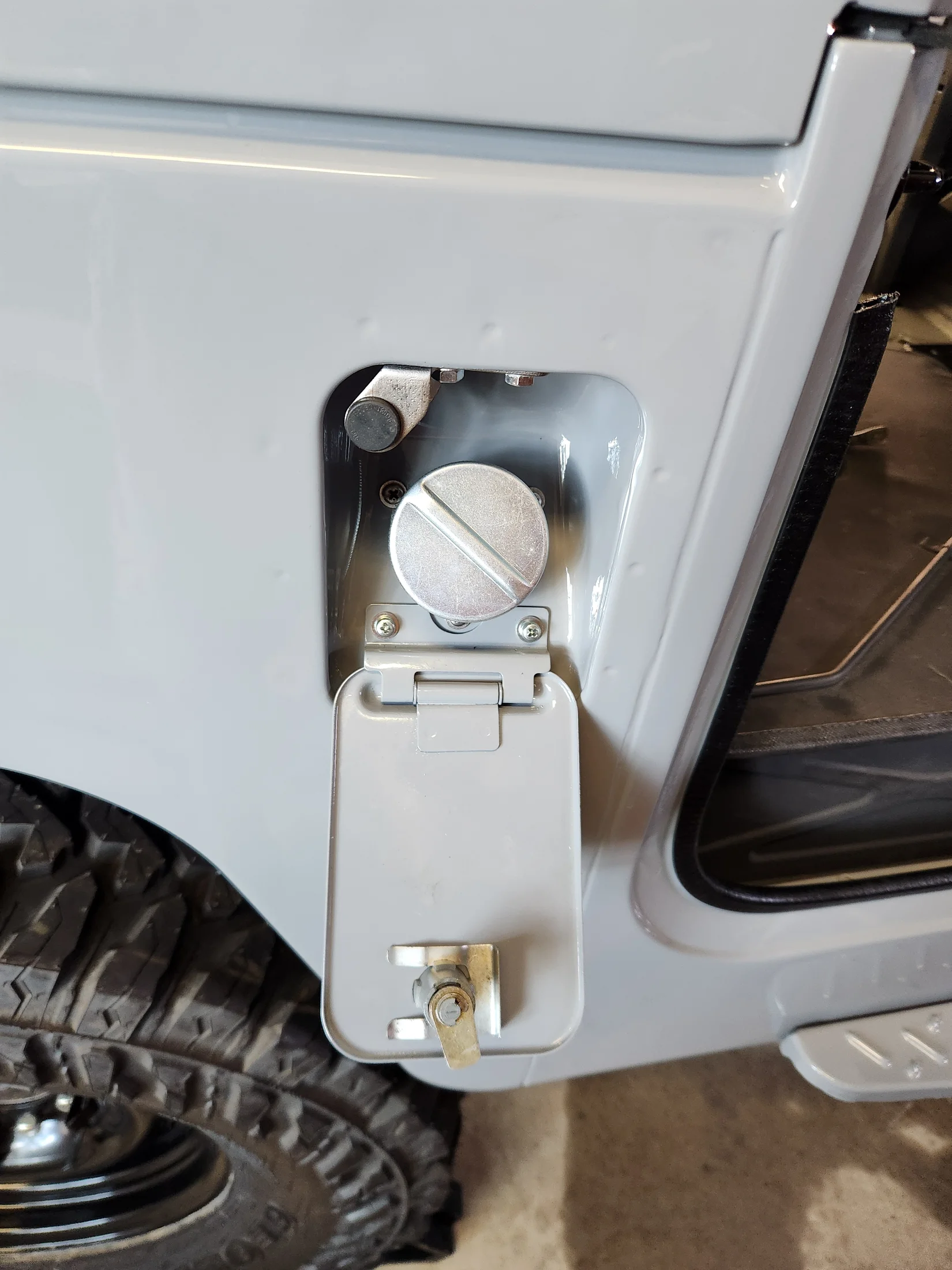

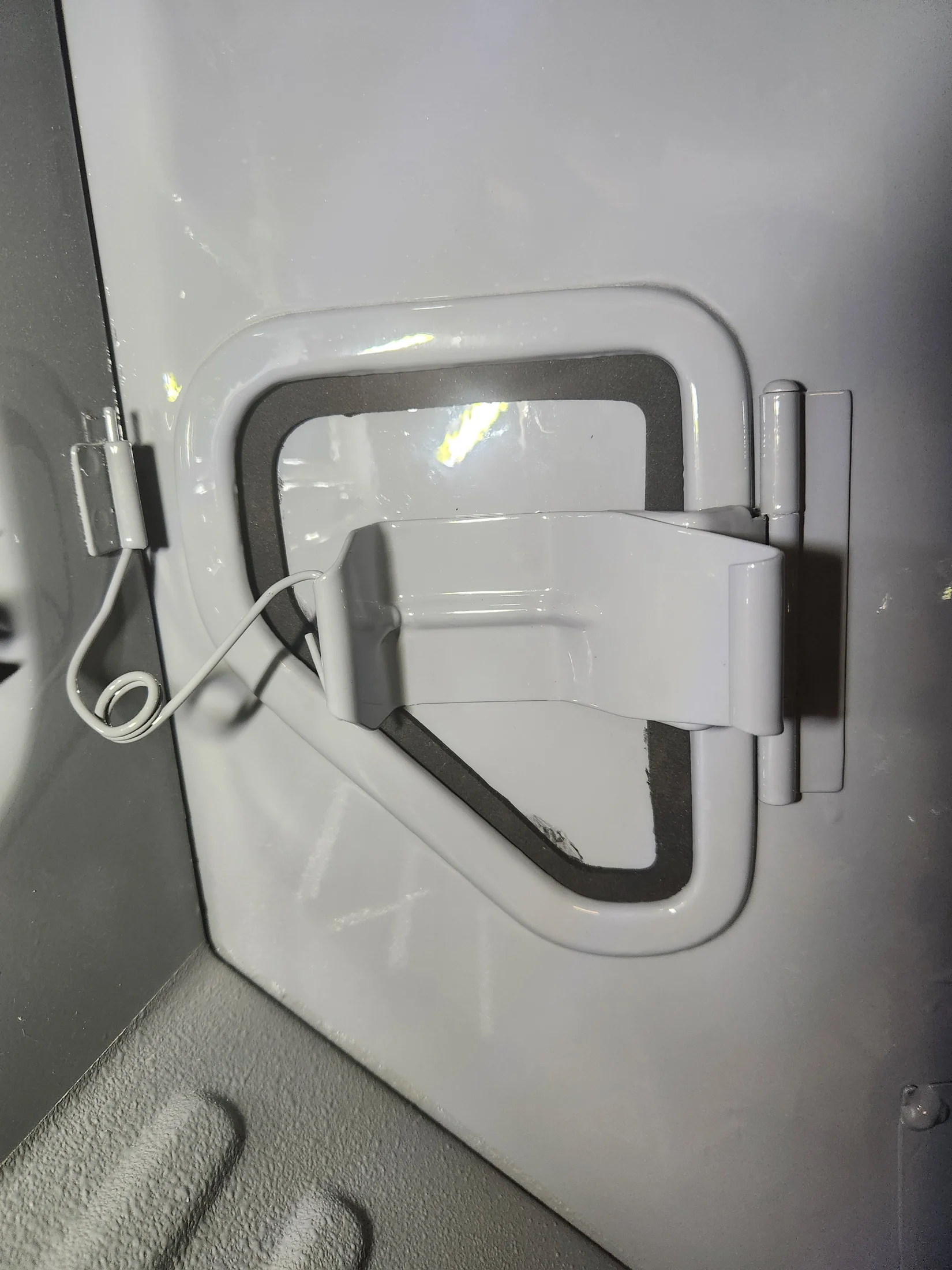

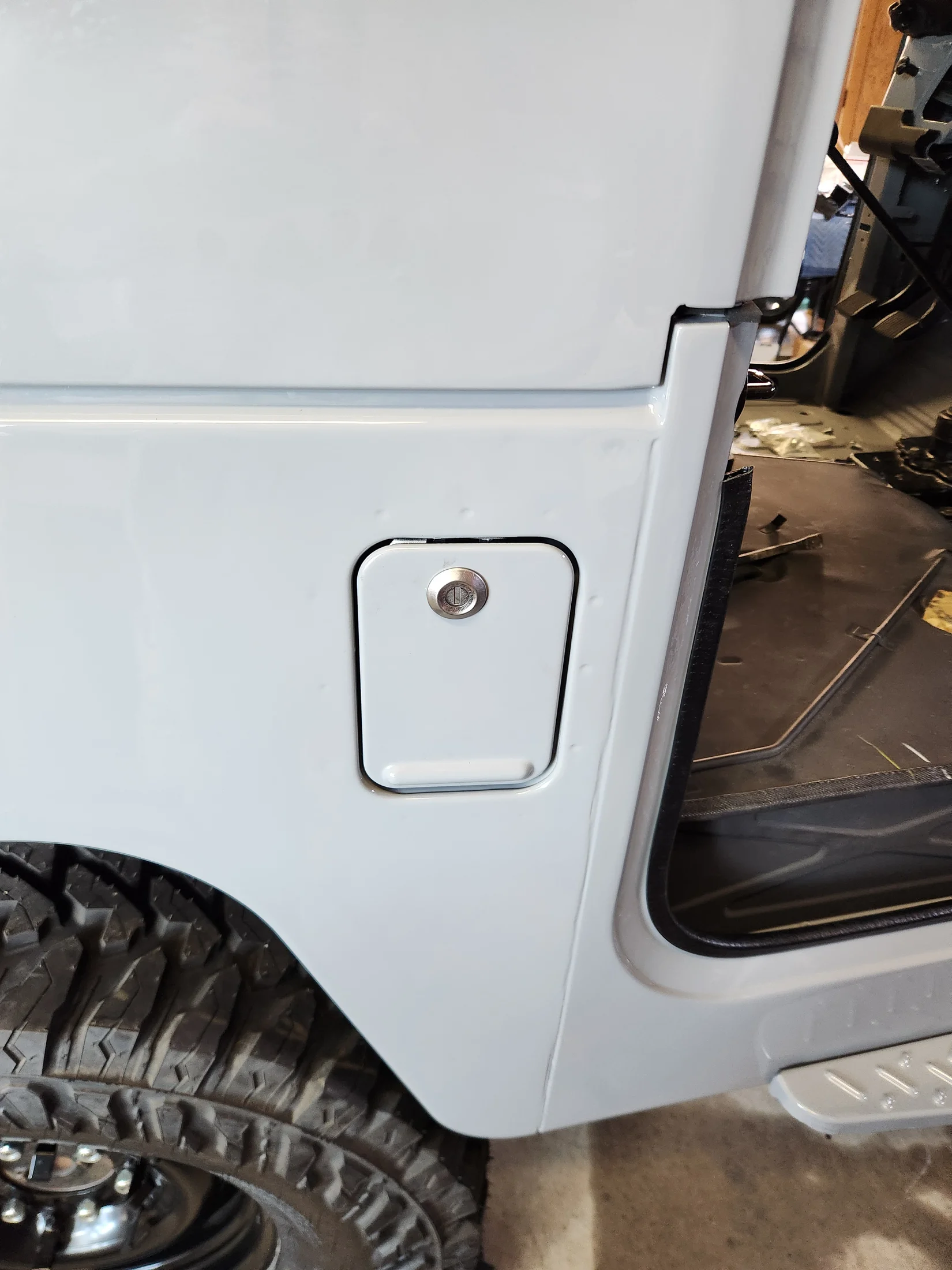

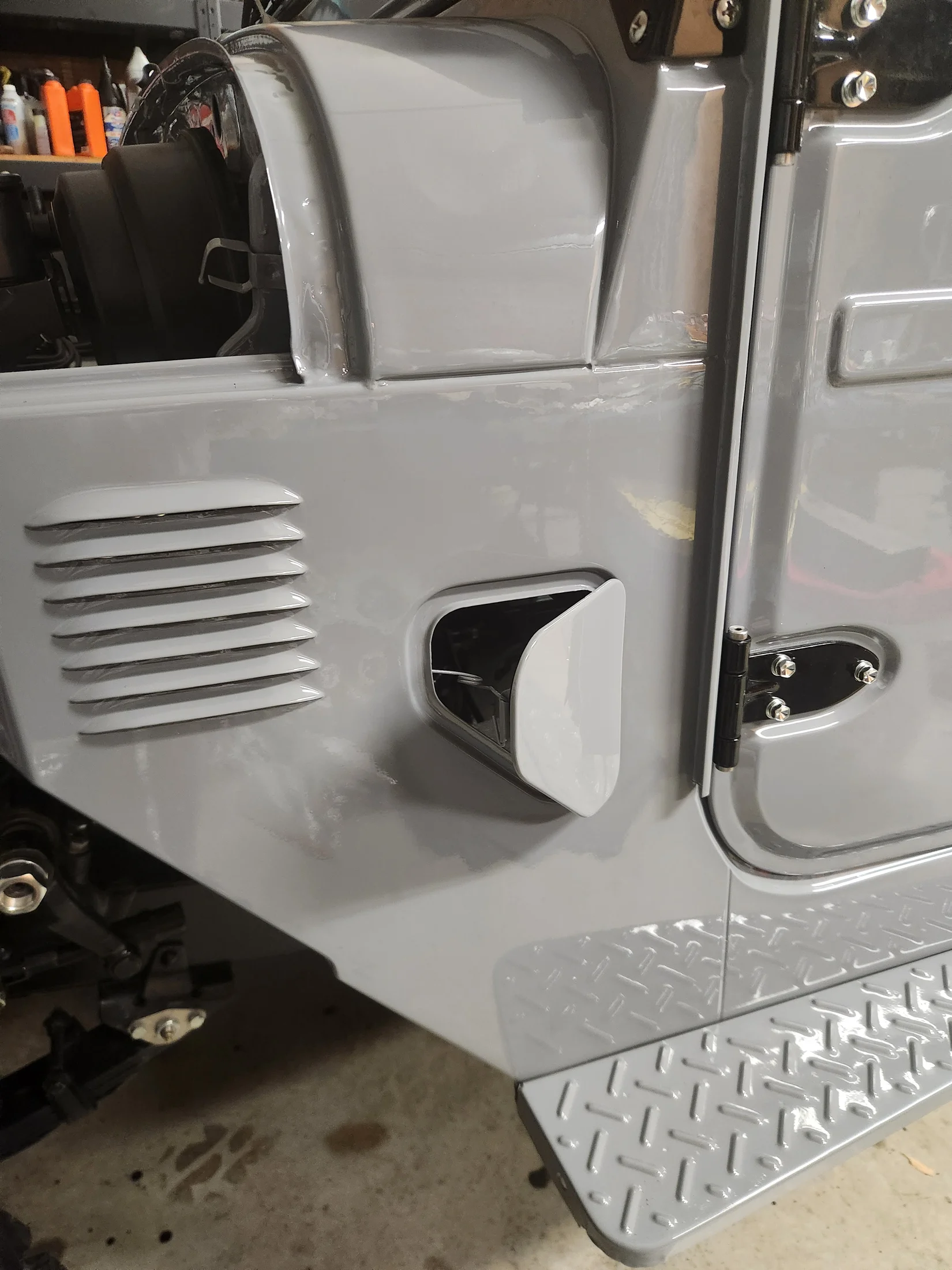

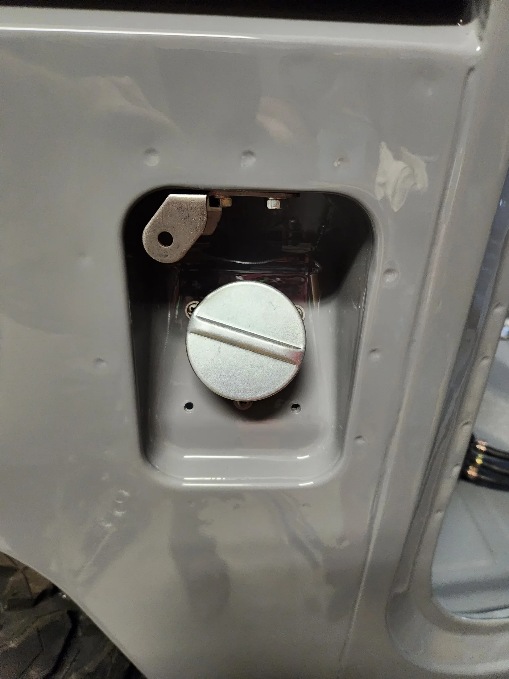

Screws and rubber stopper delivered so finished up the fuel door.

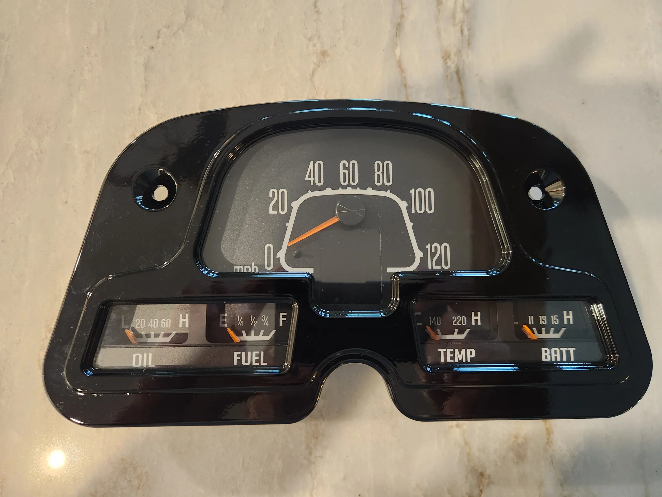

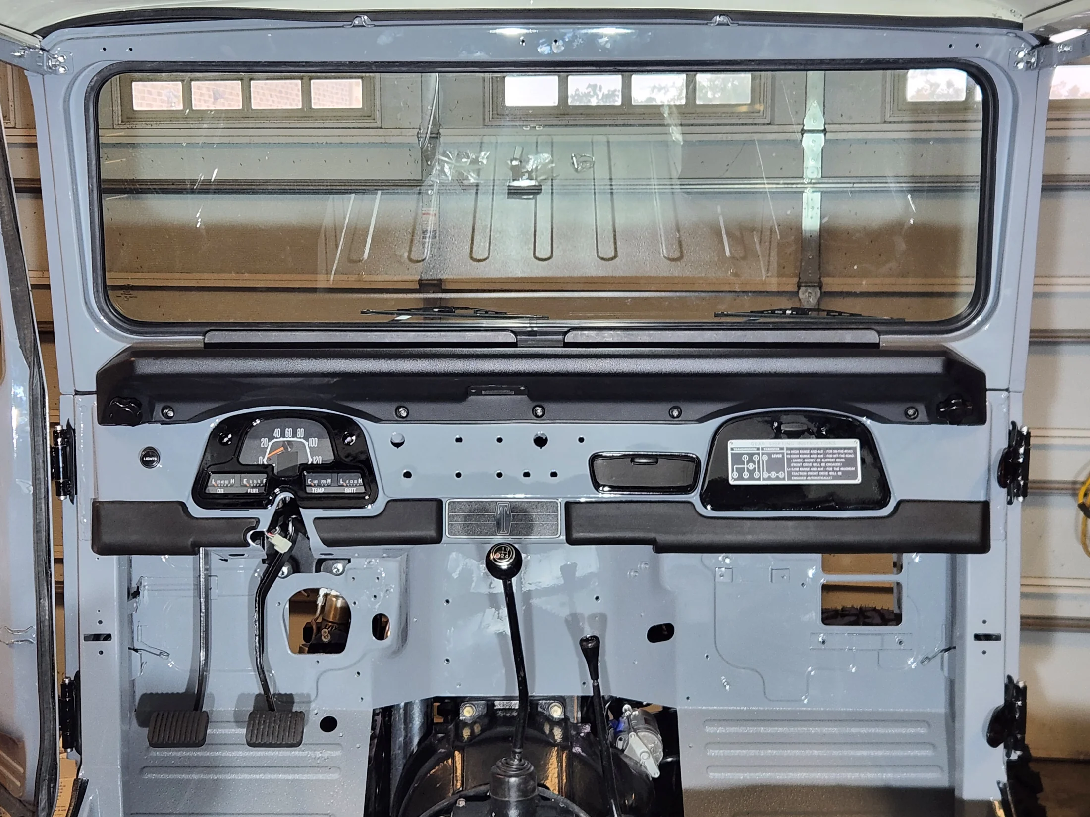

Had the Dakota Digital cluster face plate painted black to match the rest of the dash with the color scheme I have going on. Got it back from paint today.
Set in place just to see how it looks.

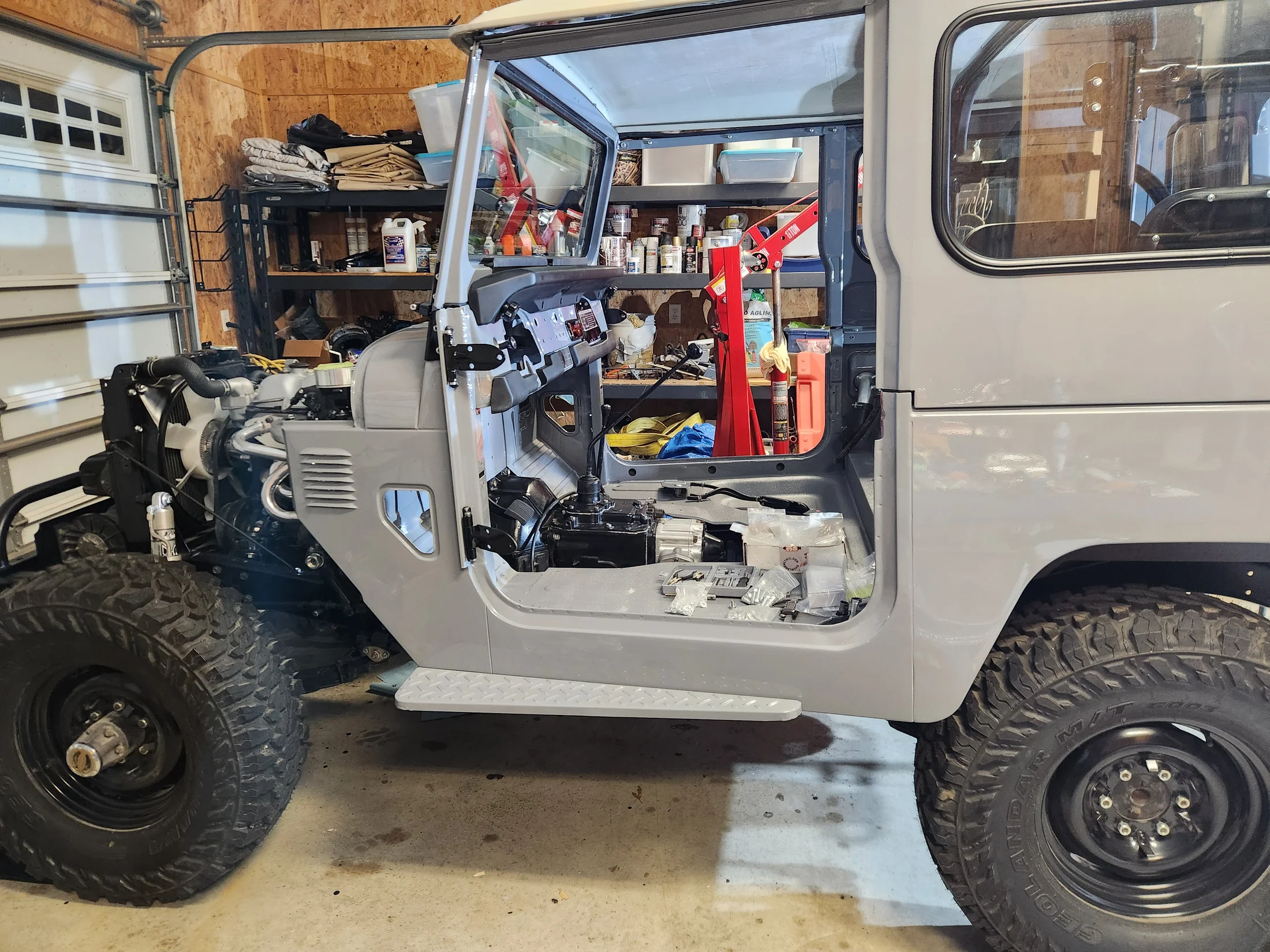

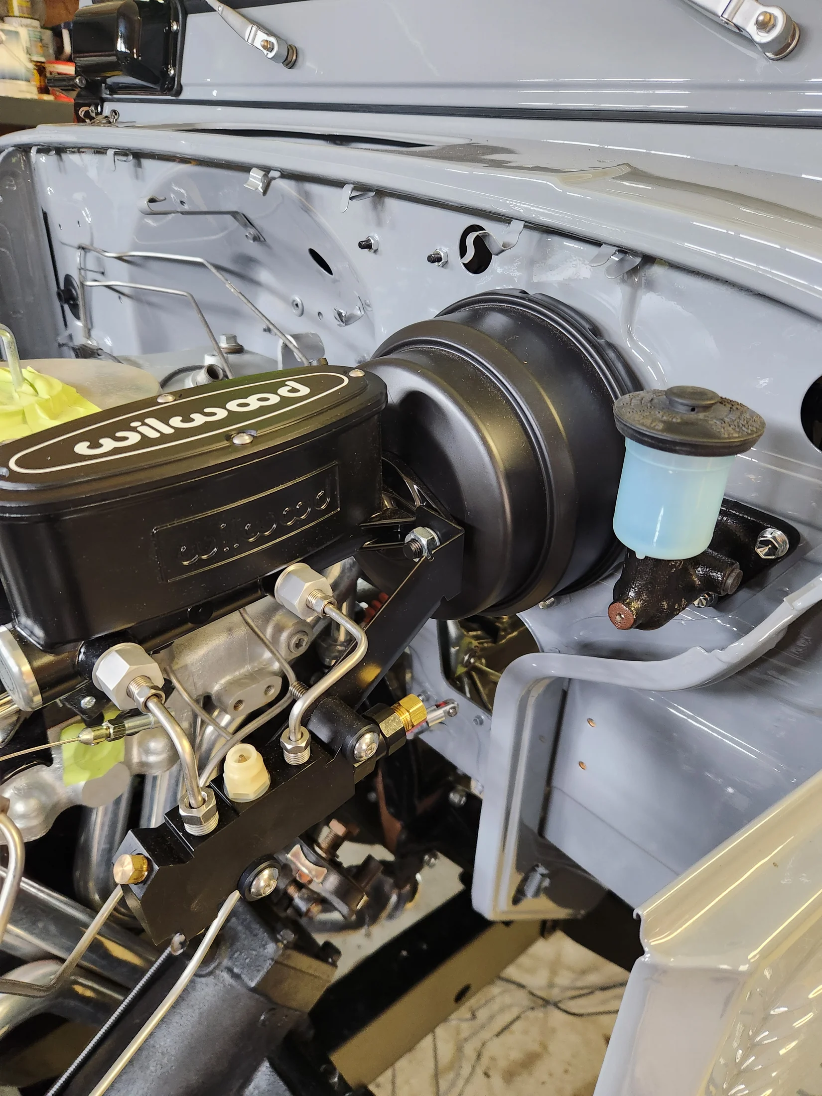

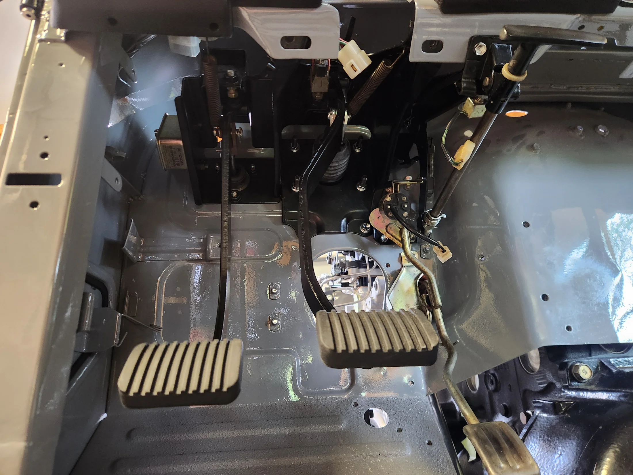

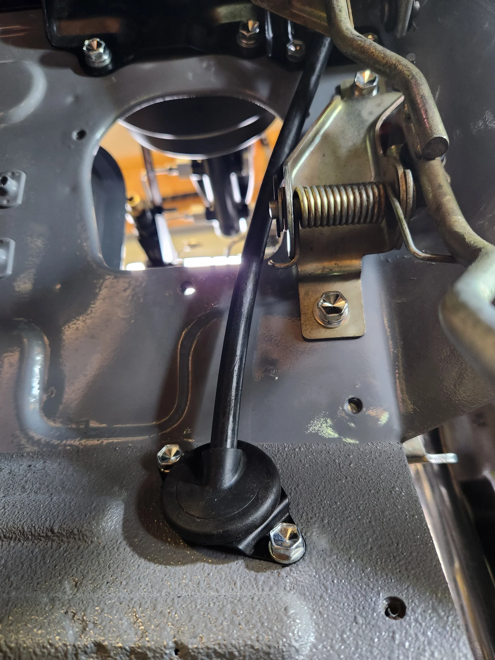

Parking brake and throttle pedal in place. Connected the brake master and the clutch master to the pedals. Just need to finish running the lines, fill with fluid, bleed out, adjust adjust adjust and will have brakes and clutch. Ready to connect throttle cable on firewall side.

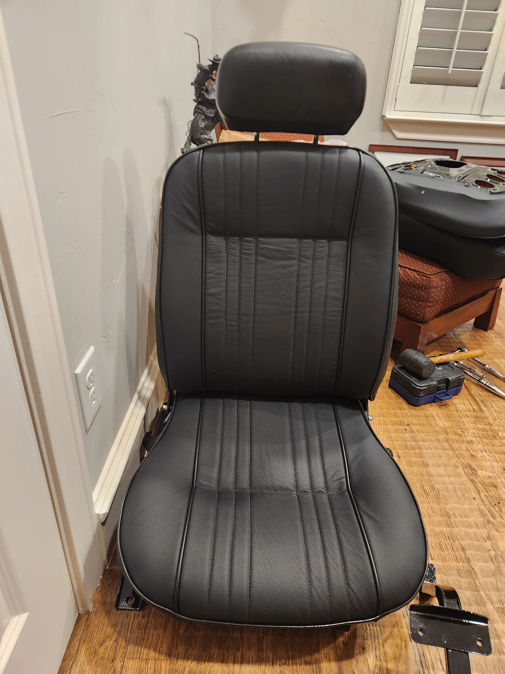

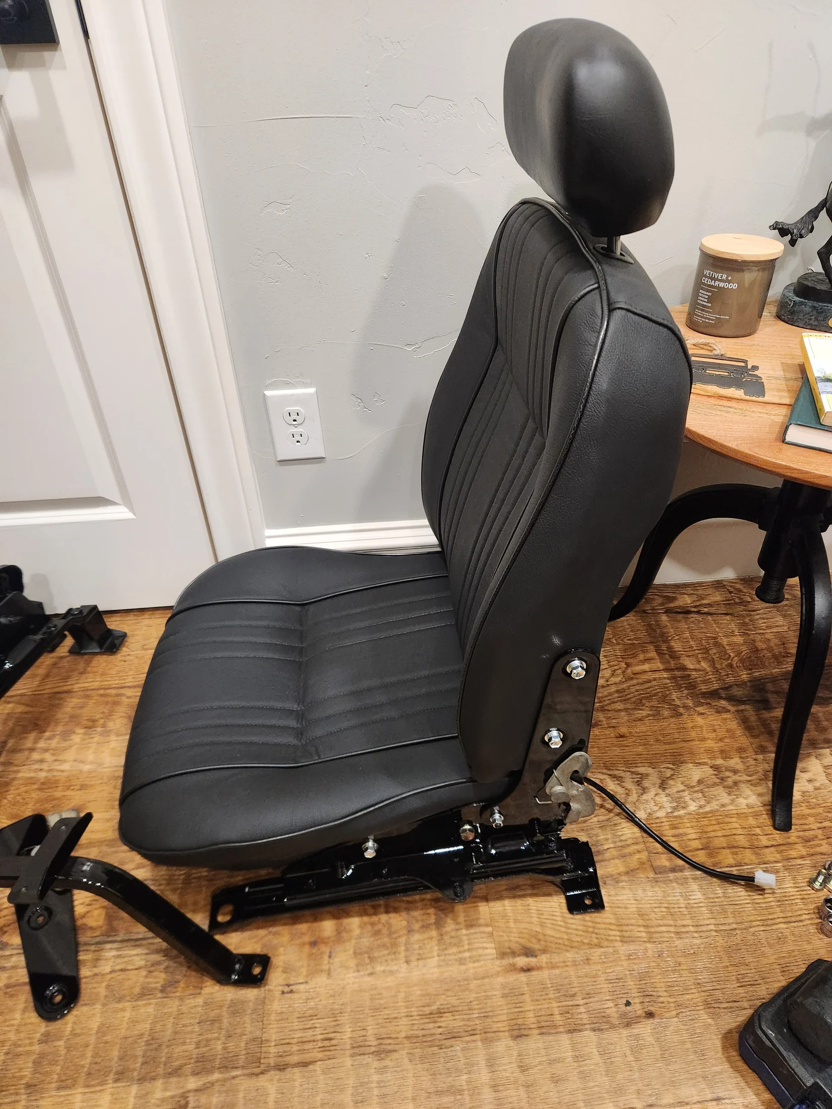

Reassembled driver's seat. Recovered w/Cruiser Corp special order black leather. Added seat heaters. Bought used OEM headrests on mud classifieds. Paint/dyed them black to match. Will finish up passenger side while watching some college football tomorrow!
