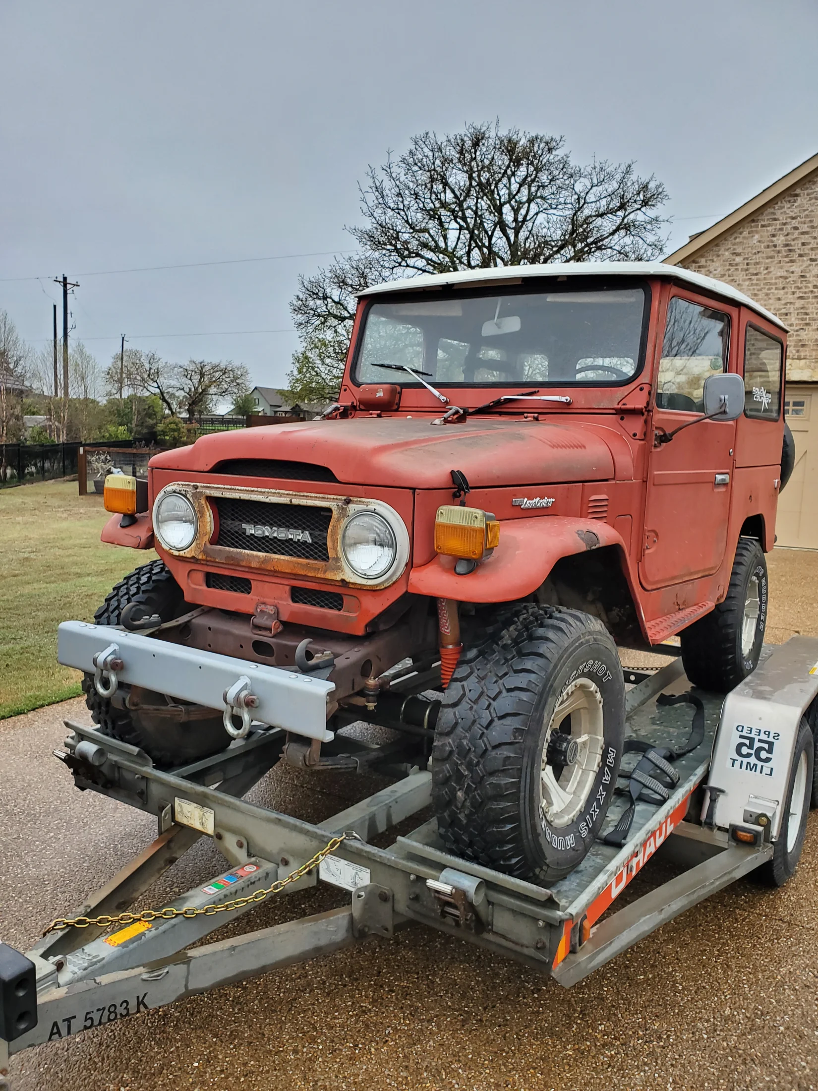

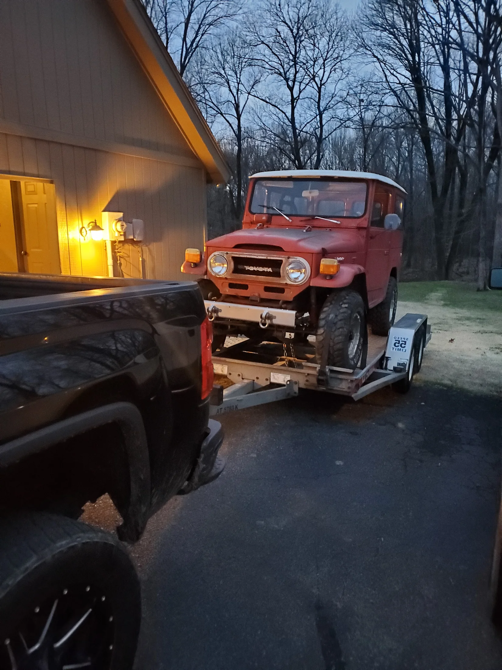

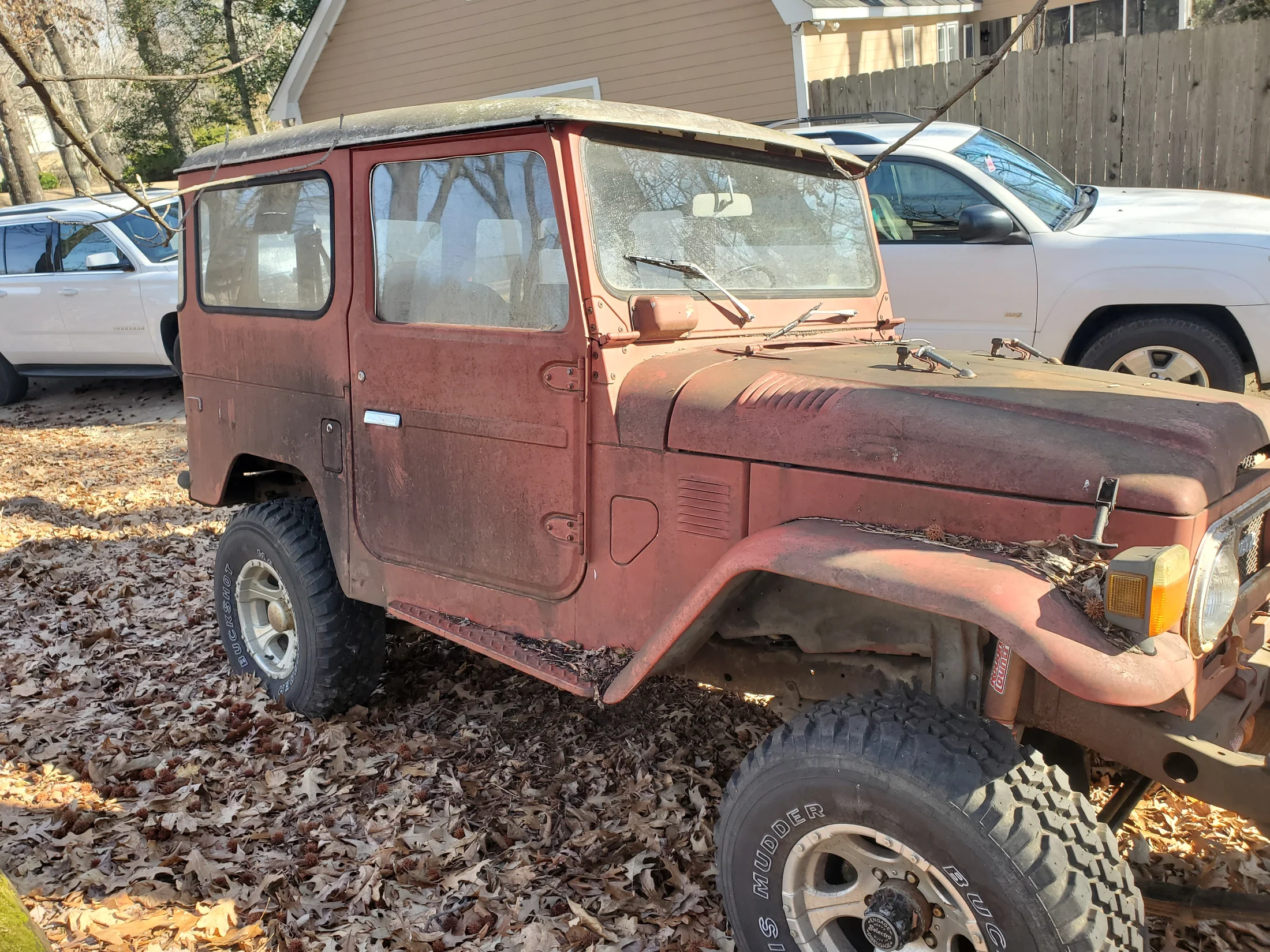

Sometime right before the COVID fiasco really hit around March of 2020, I drove to TN (I'm in TX) and picked her up.
As she sat:

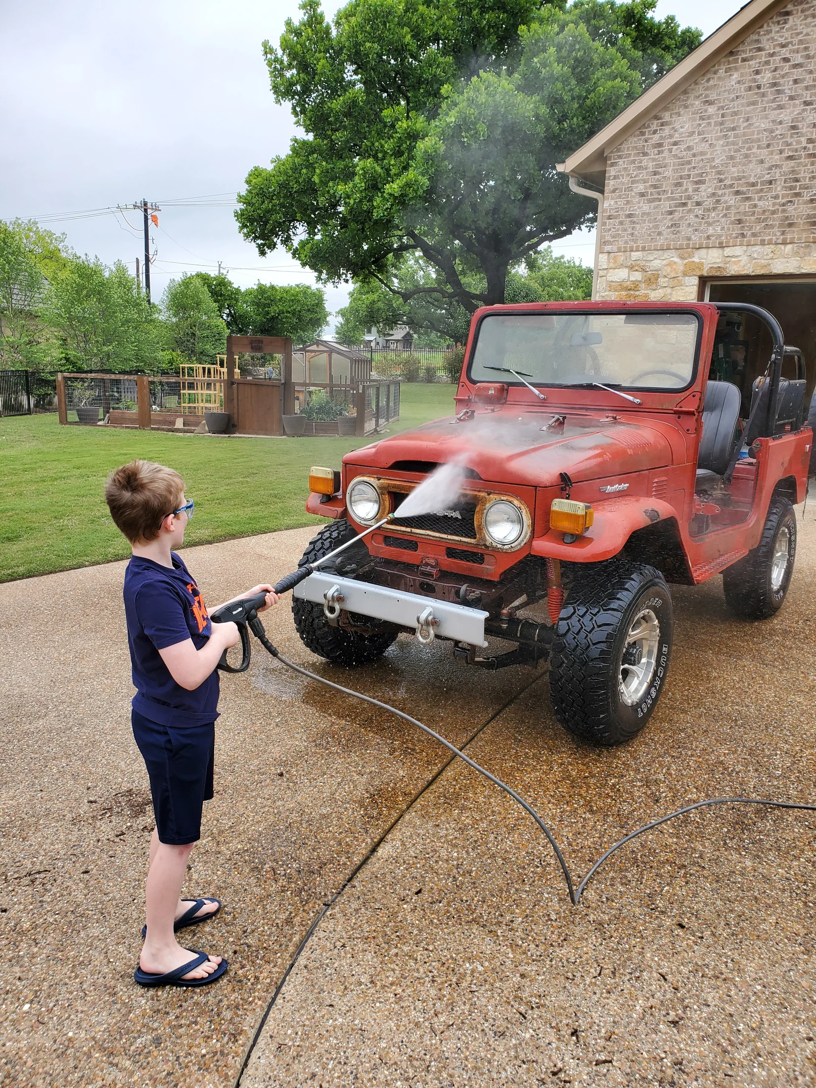

After a nice pressure washing, she was ready to head to TX - What's up with the upside down bezel? :)

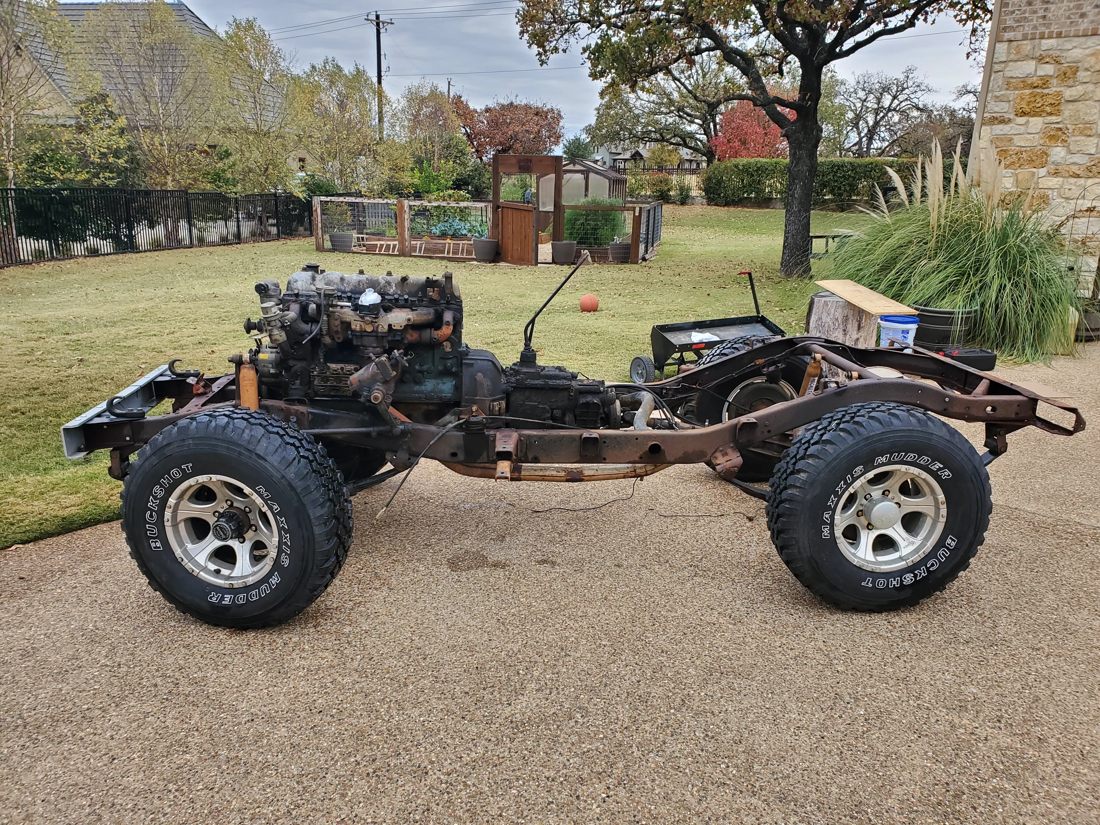

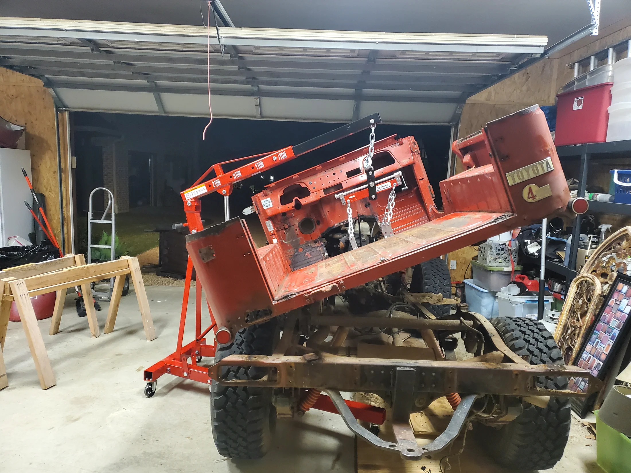

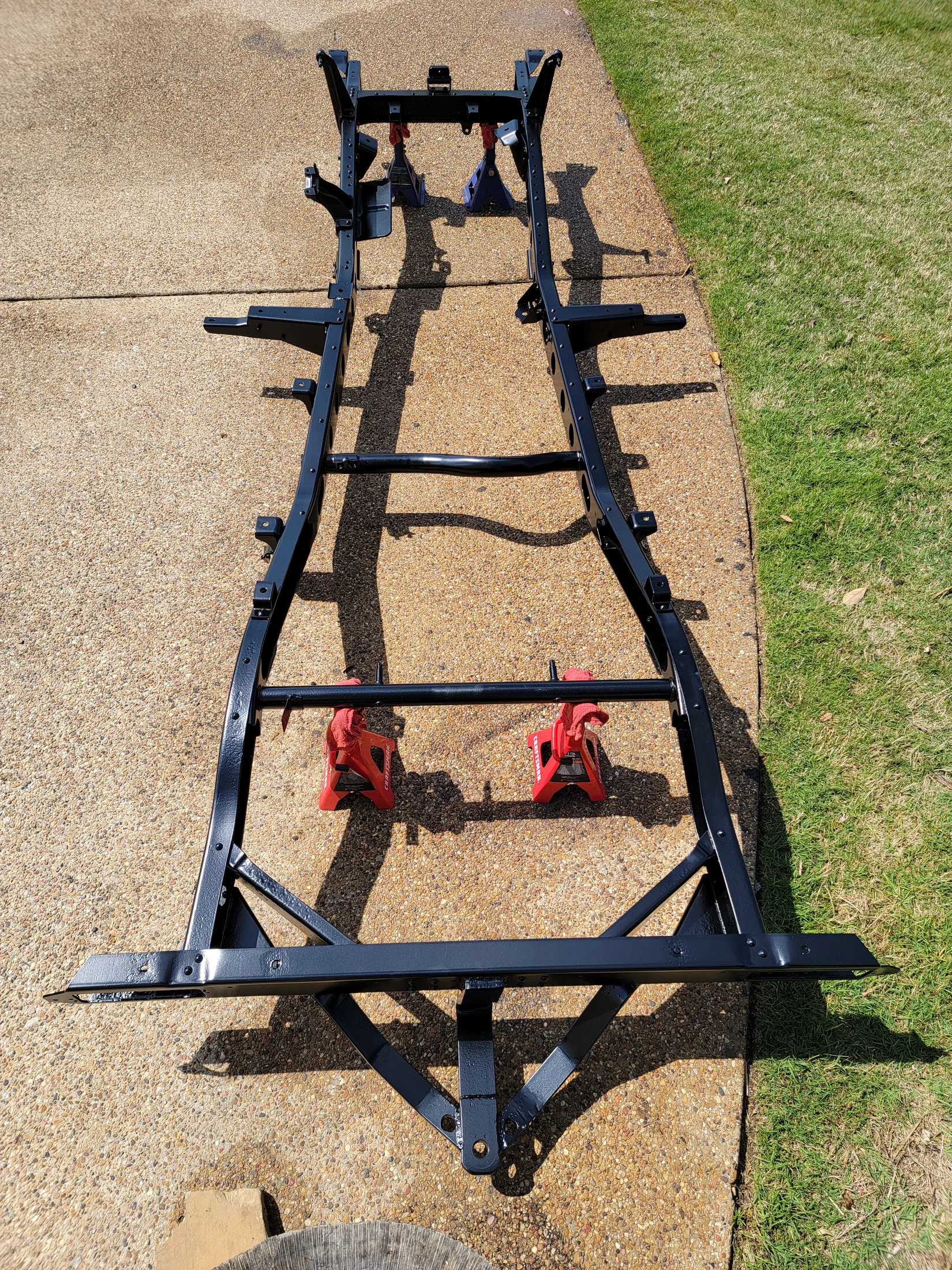

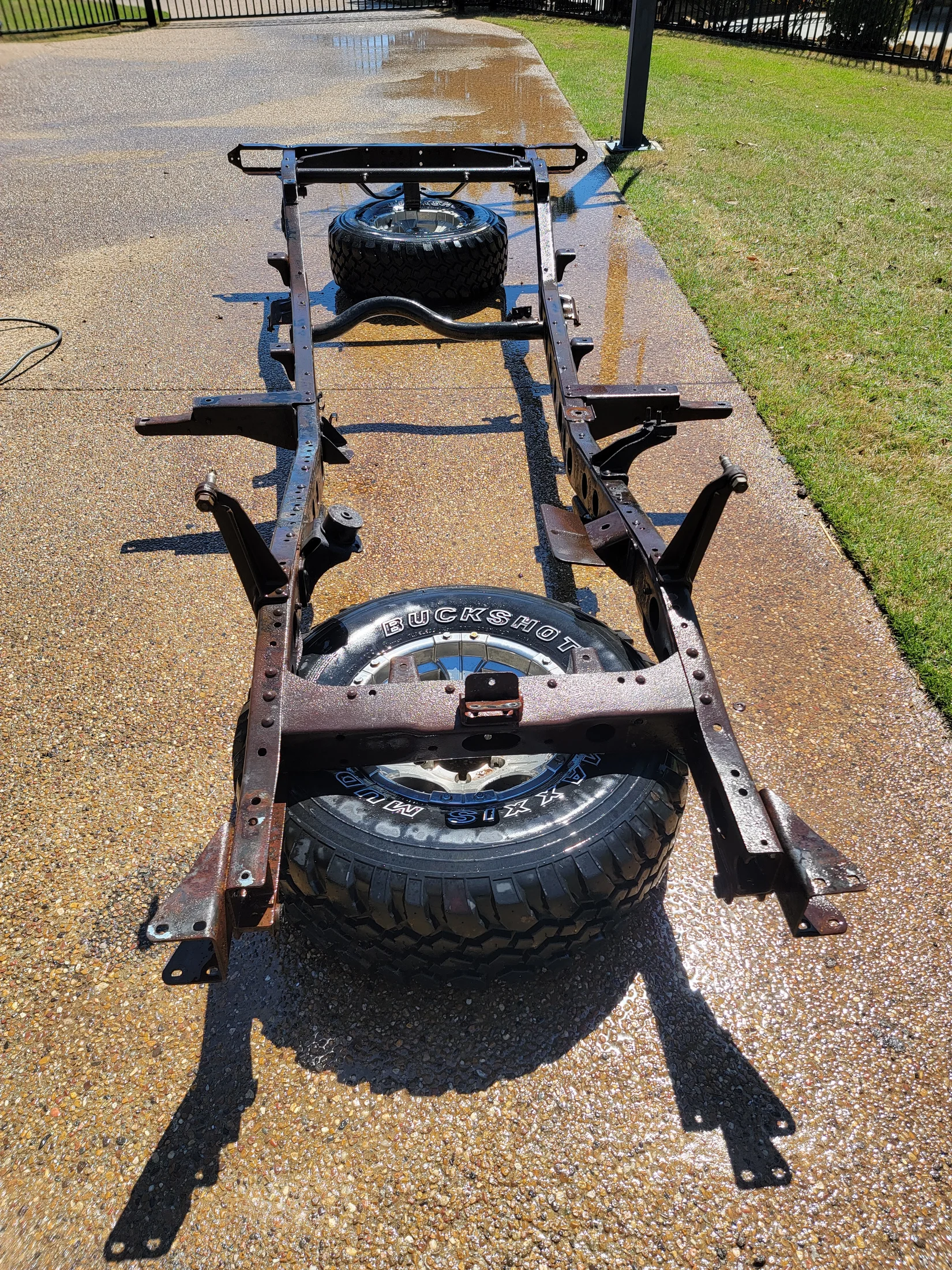

I plan to document the rest as I go with a lot more pics. I drove her "as is" thru the summer of 2020 and took her down to the frame in Oct of 2020. This forum and the vendors we all trust and know have been invaluable to me. Rarely does a day go by that I don't head to this section of mud and learn something new or see something that puts a smile on my face.

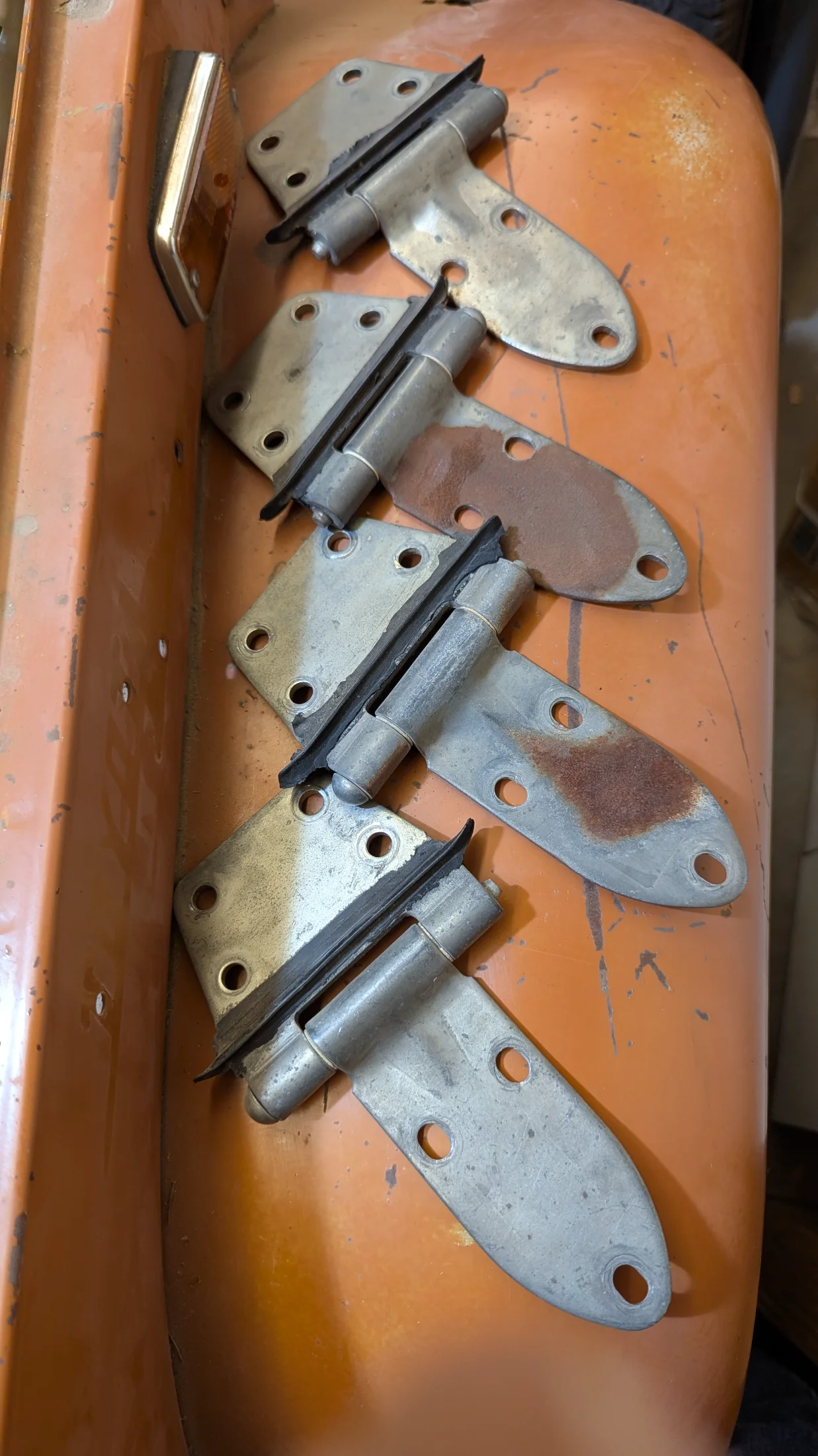

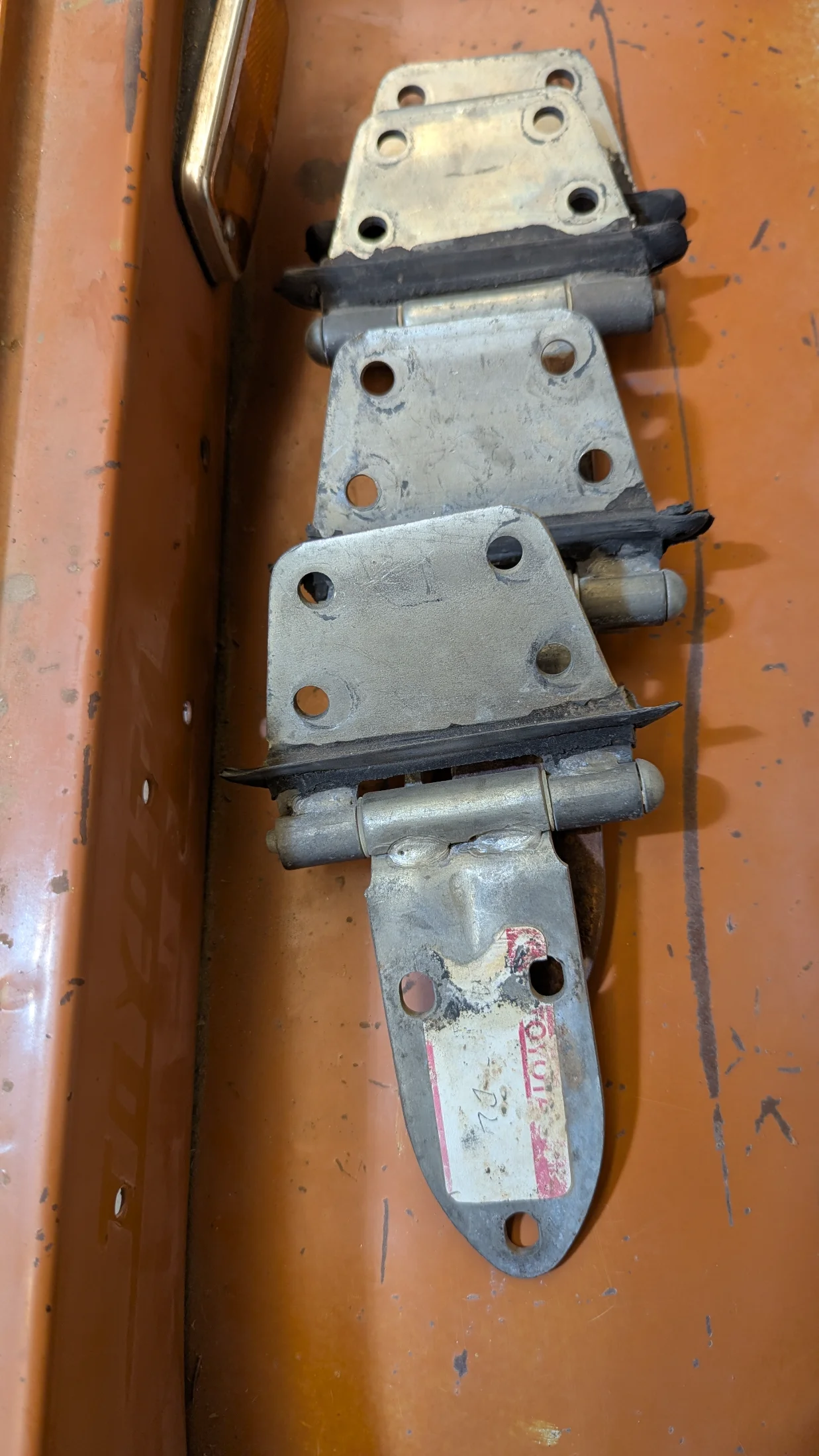

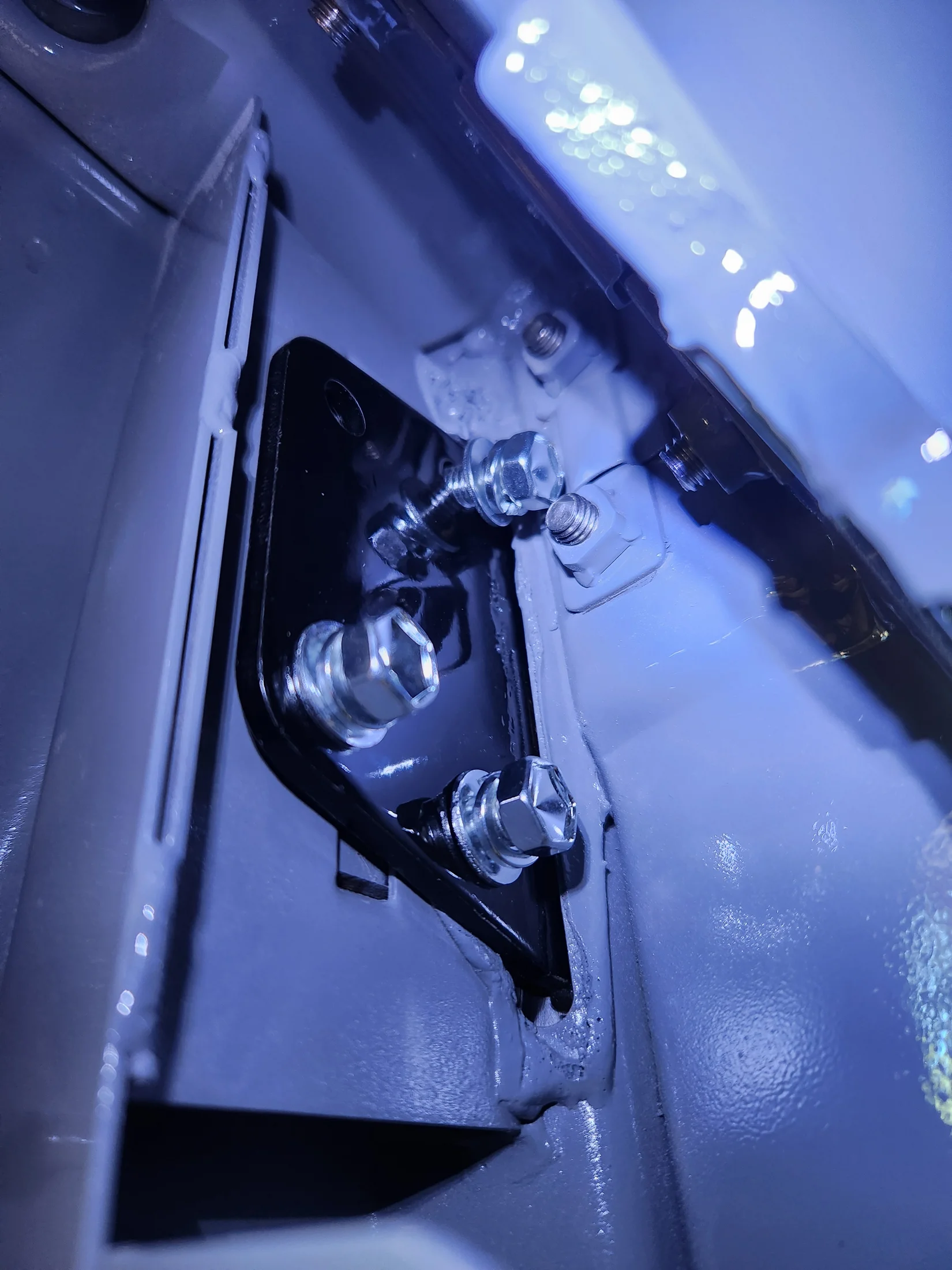

I use to change those regularly during the 1990s. I was switching between hard doors and FST door hinges on my 68 FHT. My 73 FST had a 72 hard top and hard doors when I bought. Finally got around to switching those a few years ago. Not as easy having had wrist surgery on my left hand and arthritis in the other wrist, but did it. I couldn't imagine working on the assembly line and installed these all day. Hopefully they were loosely installed before the tub was assembled. Then only needed tightening for final adjustment.
Can't imagine how difficult post wrist surgery and with arthritis! My hands and fingers are tweeked from squishing and weird positions. Surely they had some special micro tools on the assembly line for those folks. Ain't no way I do this every day. Funny though, every step in this resto that has been a pain has been an enjoyable pain. I'm now looking at my hinge rubber seals. Not sure I oriented them correctly. If not, it's coming back off and on again. Time to search the web for an example. I'm still smiling as I do it tho. :rofl:

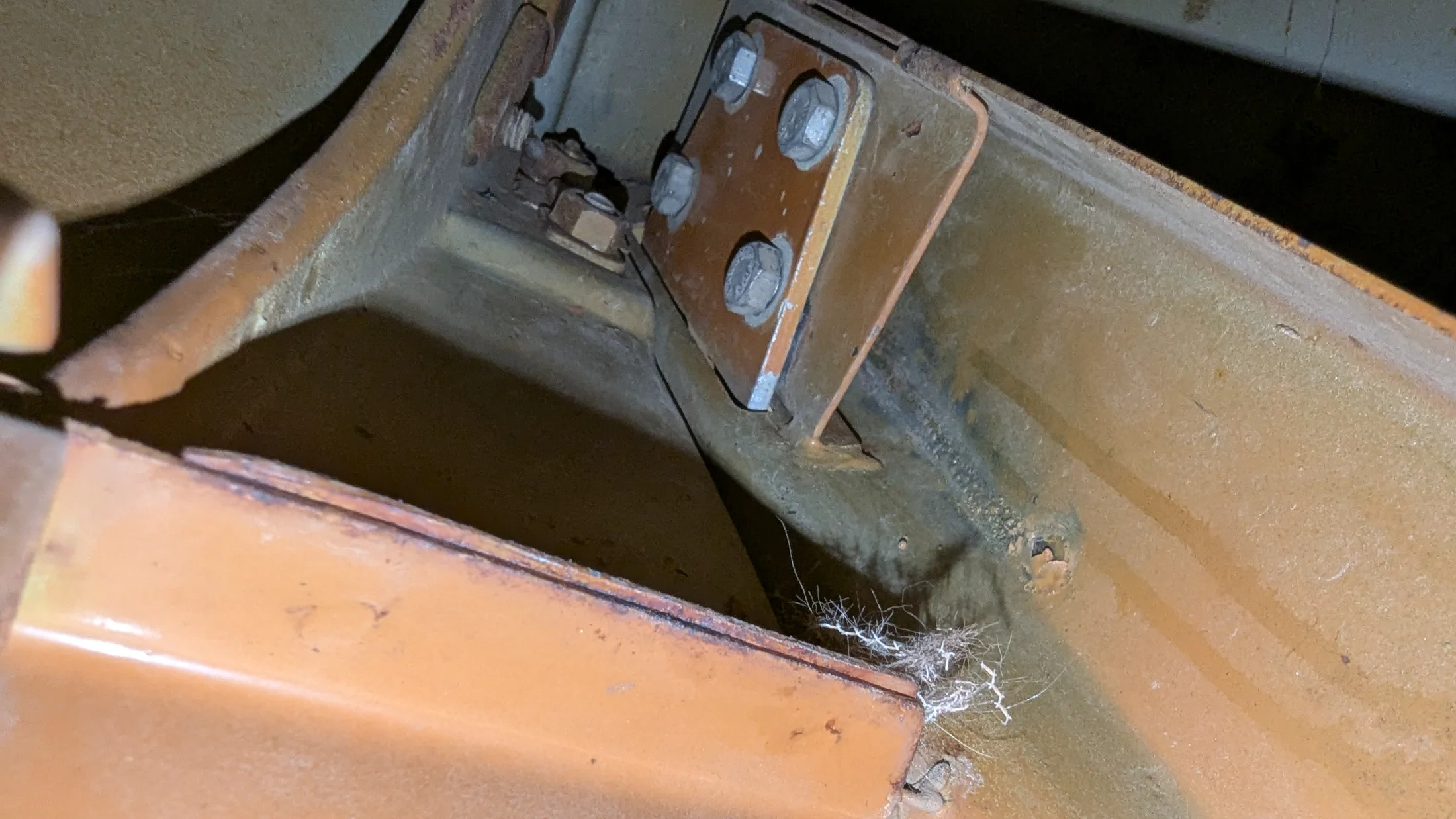

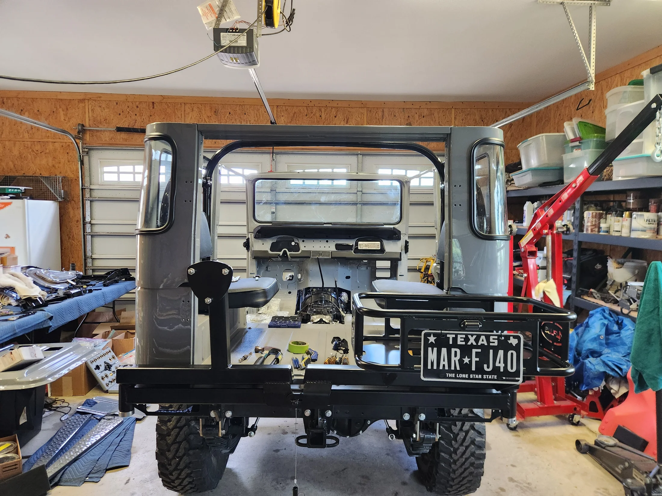

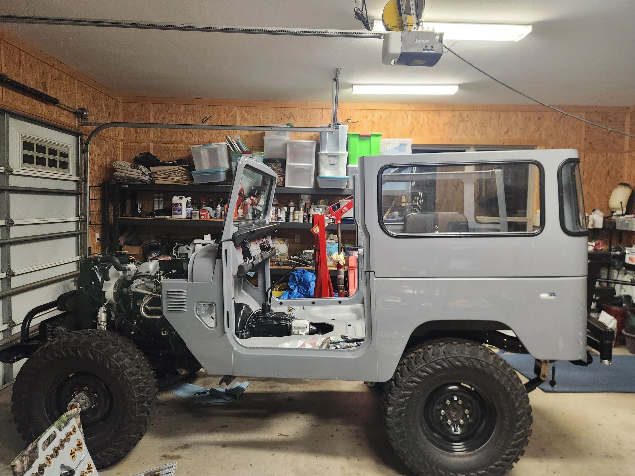

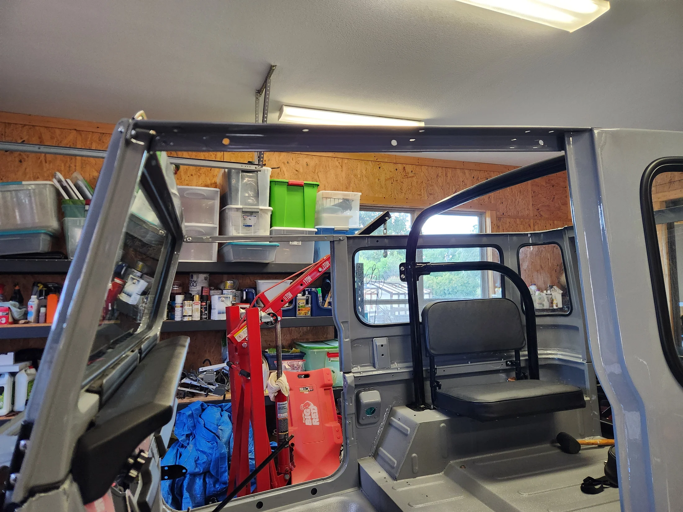

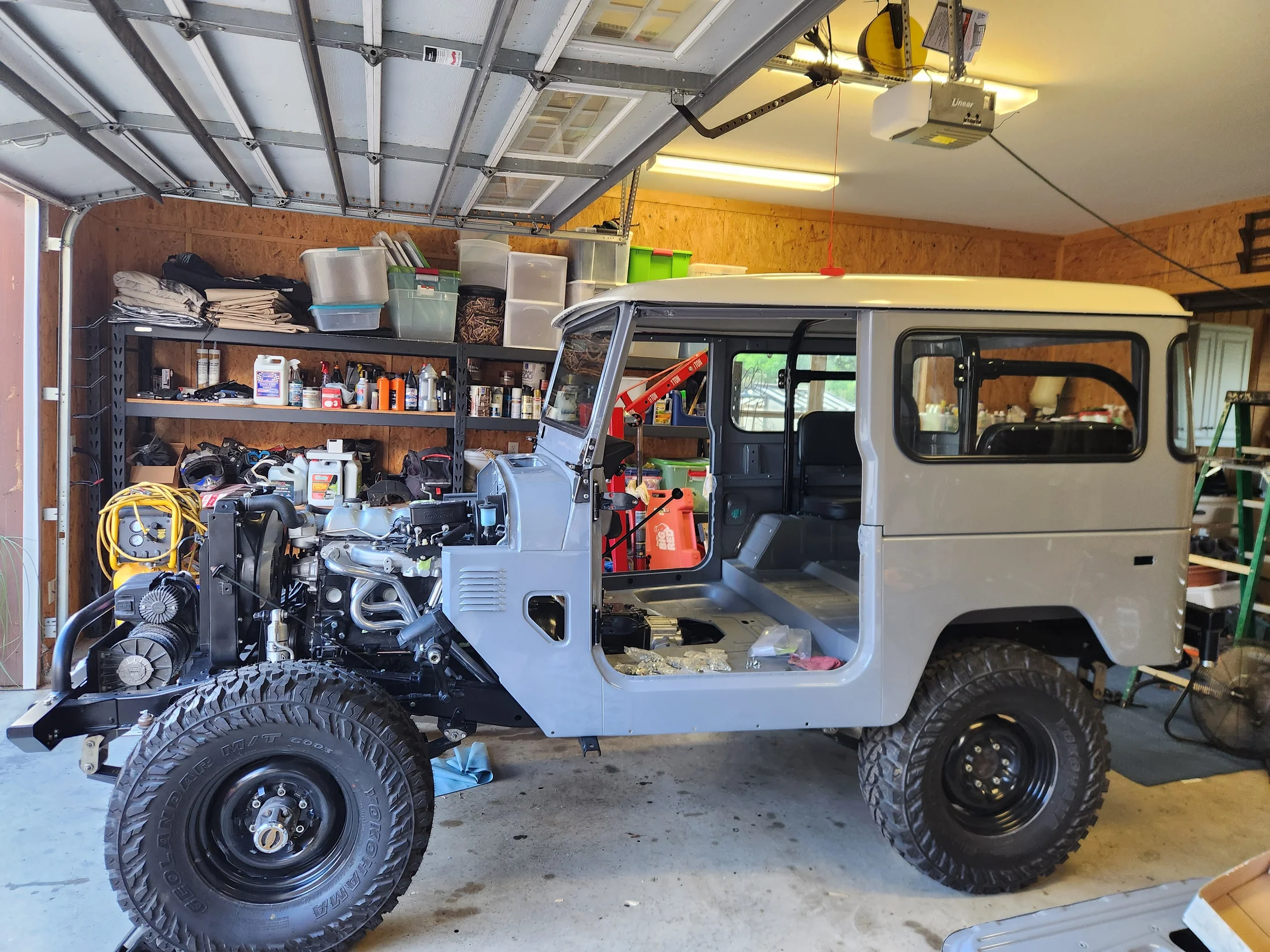

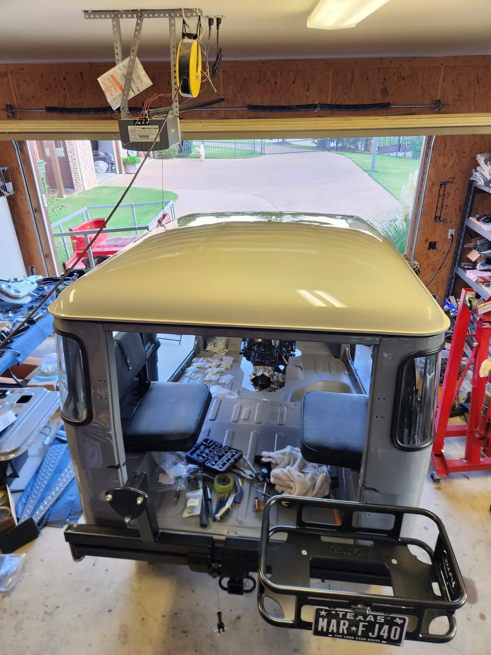

After loosely mounting the door hinges, I got the door headers in place, new roof weather strips laid out and put the top roughly in place. Plan to run some hardware in tomorrow to confirm alignment. Hoping it only needs minor tweaking. I did most all of the top resto, aside from primer and paint. Sourced a new metal drip rail from CCOT and riveted it to the top with solid rivets and it turned out great. How great will be determined once I get some screws in....
The nardo gray really shows the blueish undertones in sunlight. You can see in the last pic. Front firewall getting sunlight vs rear in the florescent lighting.
This is going to be a beautiful 40. Already is.
I love the Nardo gray.
Thank you. I struggled on making my decision to either keep the OEM freeborn red or change it up. I ran it by Mar, my Dad, and he was good with the change. That's all I needed to hear. It's a resto mod after all since I'm adding a few modern comforts, so color change it is. It's not like I will ever sell it, so don't care if what I do to it impacts market value one way or the other.

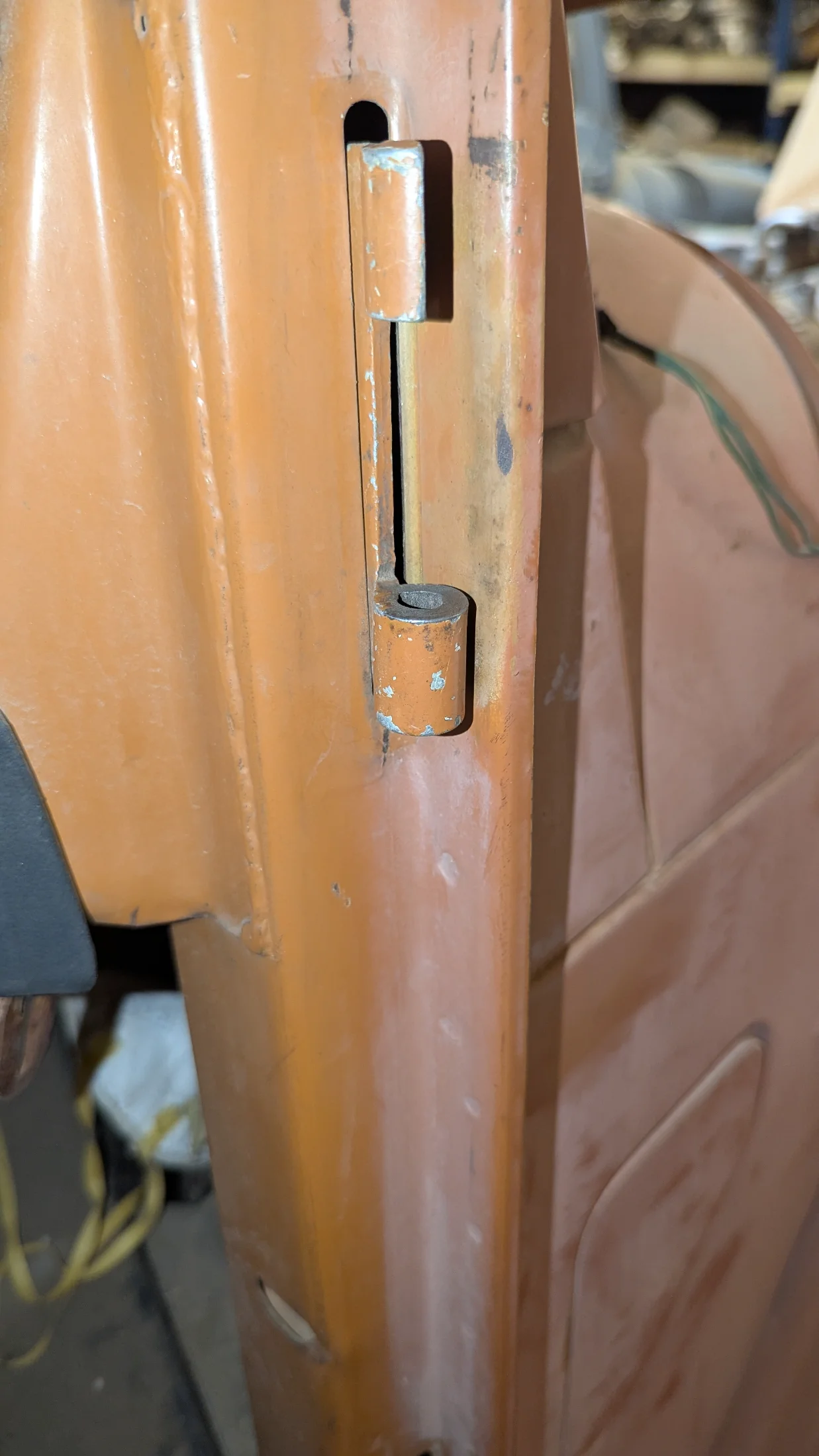

My 73 FST door hinges did not have the rubber seals. The hinges that were on it for the 72 hard doors did. Those hinges were installed before I purchased it in 1994. The license plates that was on it expired in 1988. Hinges are OEM replacements not original to the red 72 doors. The nylon bushings should be replaced. For not being painted the hinges are in great shape which guessing were installed around forty years ago. Even the rubber seals are pliable.
For full disclosure when I removed the hinges a few years back I never installed the original FST hinges. Figure I would give the upper passenger side a shot this morning.
Even with surgery limiting my left wrist it wasn't that bad. I've always had good hand dexterity. Starting and turning the bolt between the index and middle fingers it wasn't that bad.

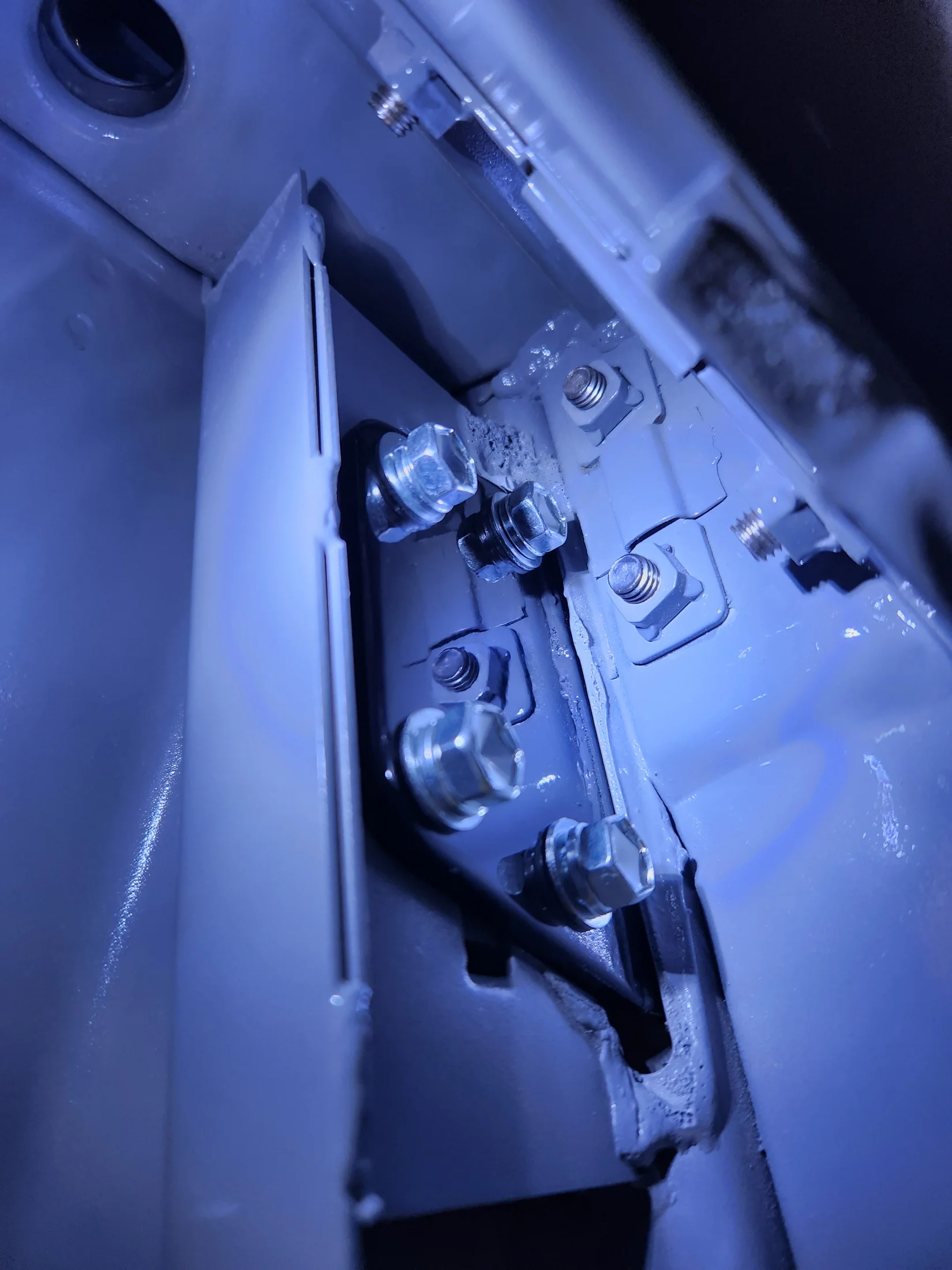

The floating screw plate is always a bugger for me. Ive tried different methods of getting it to stay in place where it's all lined up...screw hole in floating plate, hole in plate and hole in hinge then jamming the bolt in before it all moves. It's like I need three hands 😅. I determined (not 100%, but close enough for horse shoes and hand grenades) that I had my rubber seals aligned properly so I only did it once this time.

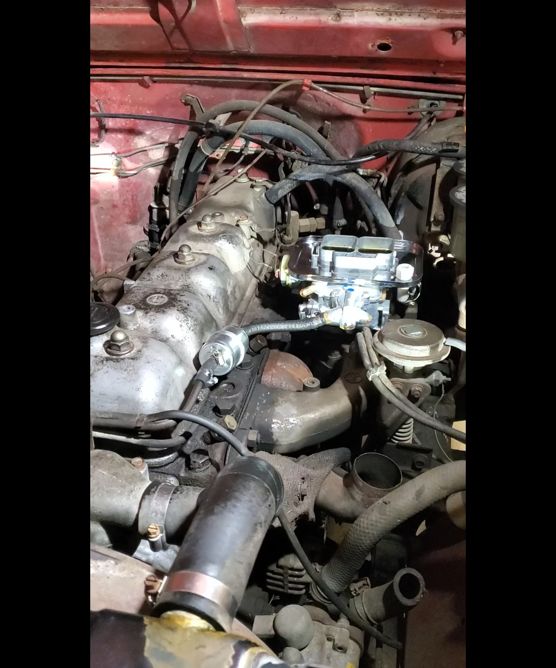

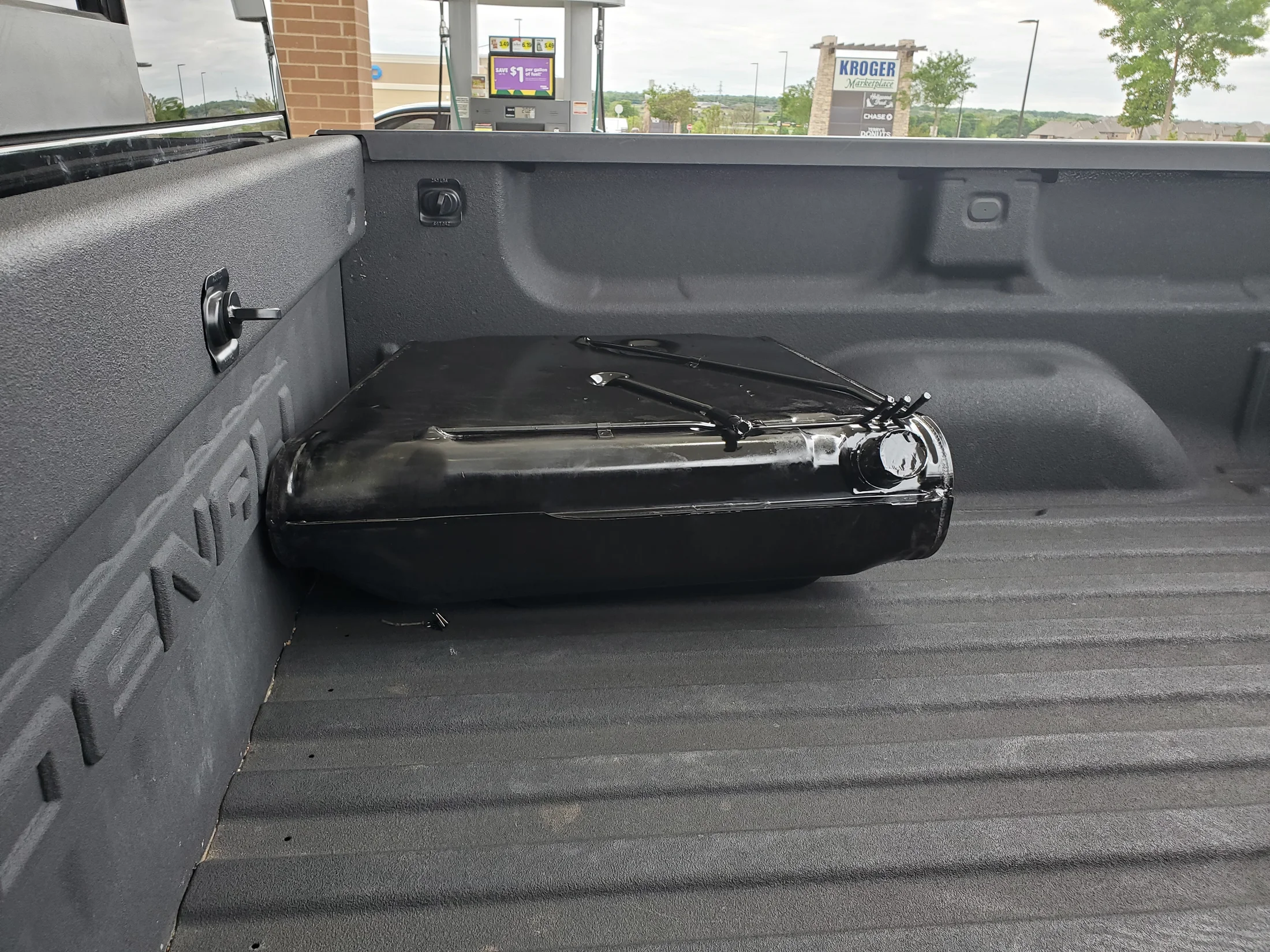

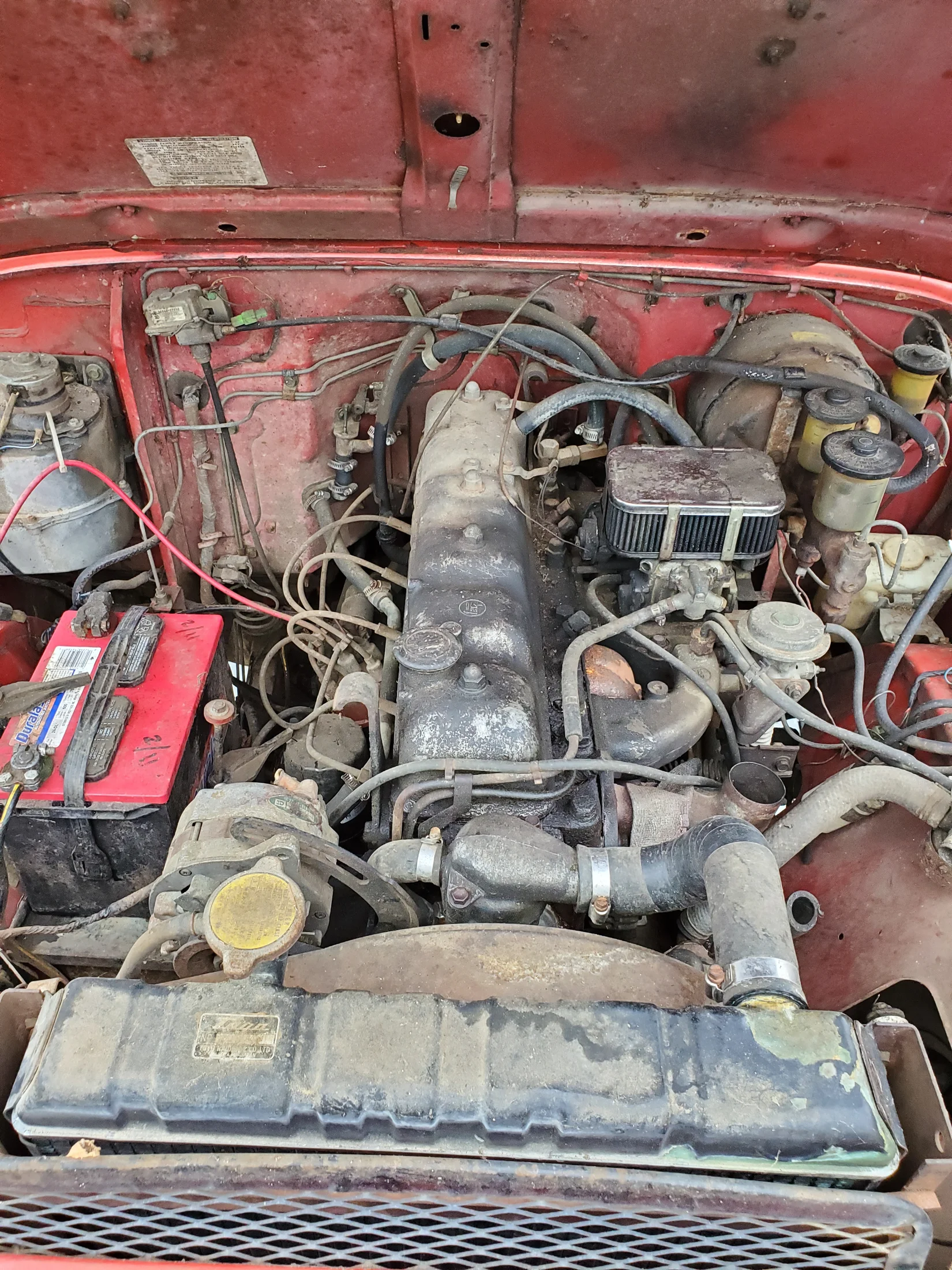

After getting back to TX, I decided I'd drive it through the summer and wait on tear down in the fall. I wound up sourcing a new Webber carb and pulling the gas tank and took it to a radiator repair shop for chem dip and repaint. All just temp adjustments to enjoy it for very local driving. I didn't want to go too far as I knew I was going to take it down to the frame relatively soon.
Engine bay
New carb and filter plus temp gas tank fix
Popped the top, flipped the bezel and she was ready for a summer of weekend run arounds. I even got my best buddy in on the fun.

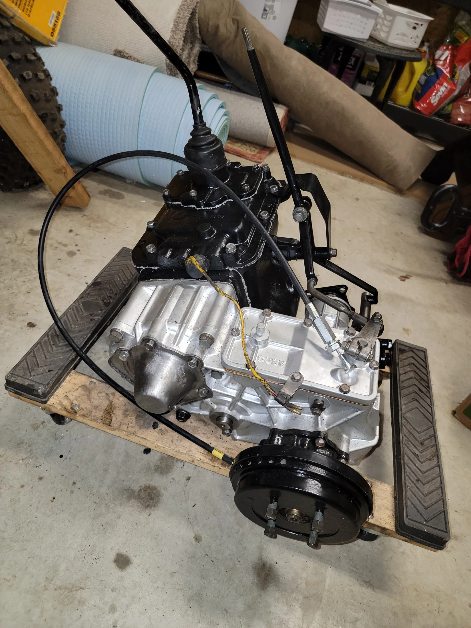

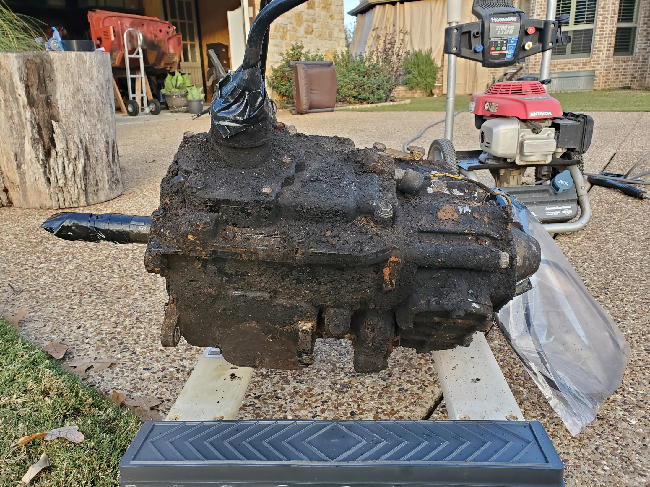

I replaced all the bearings and seals in the tranny/transfer and gave it a new coat of paint.

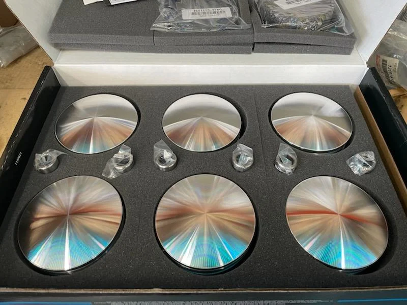

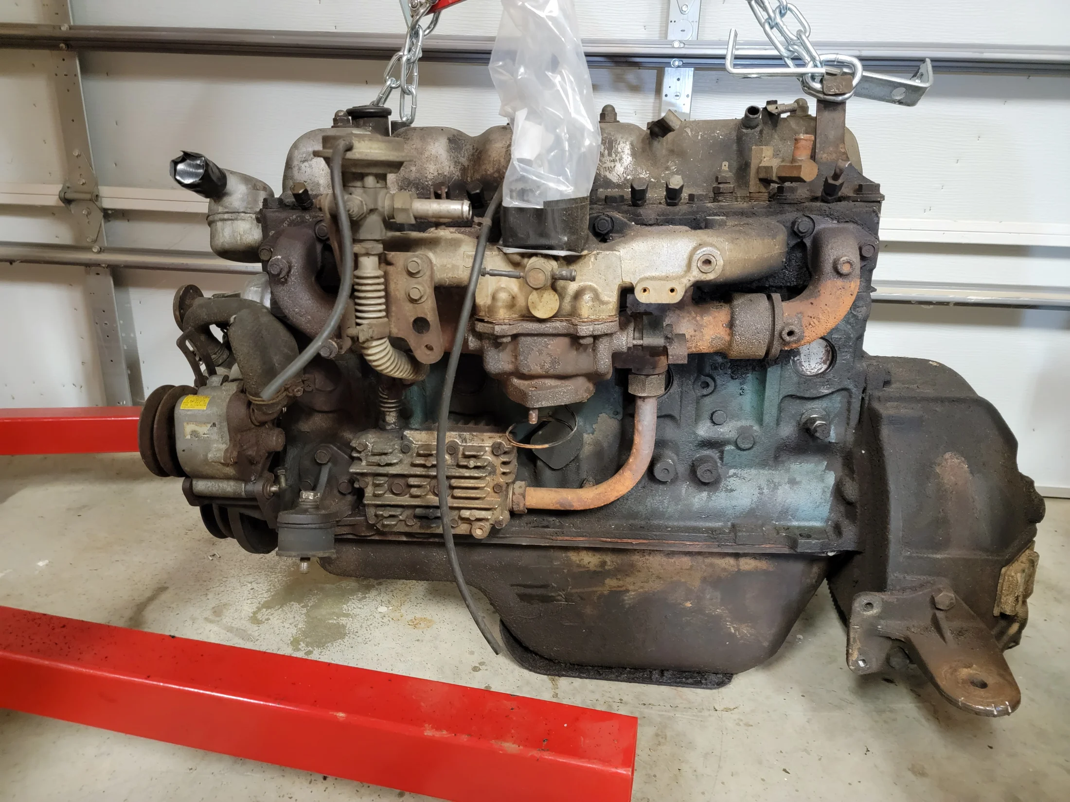

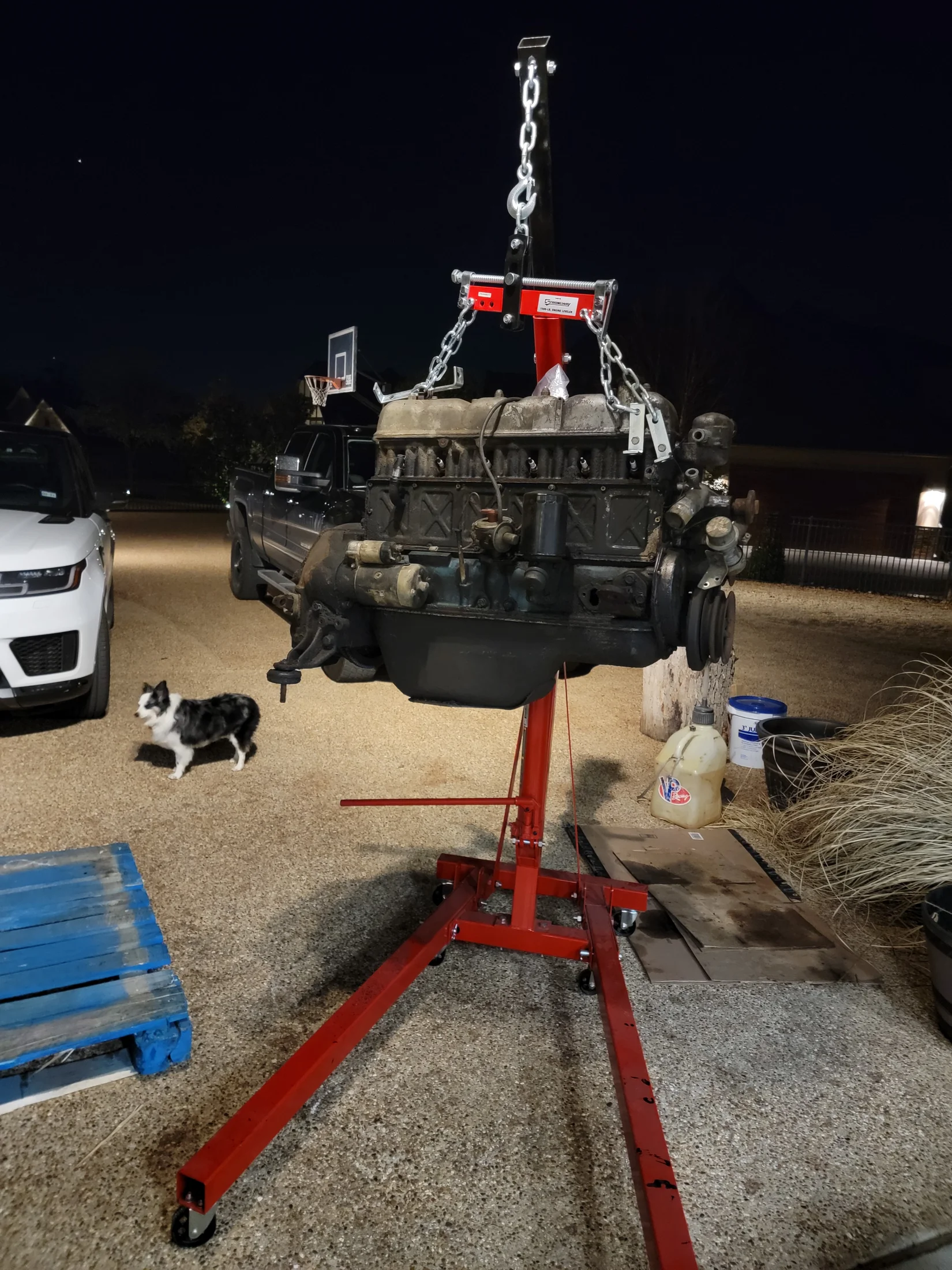

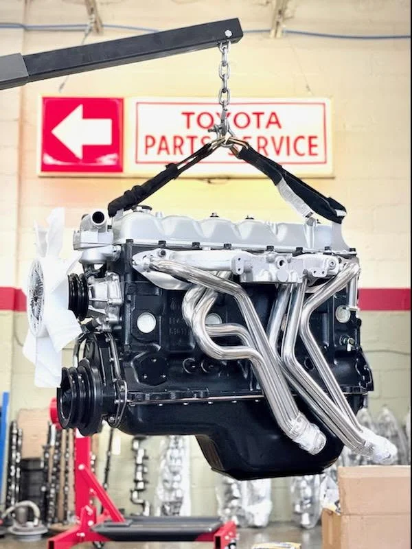

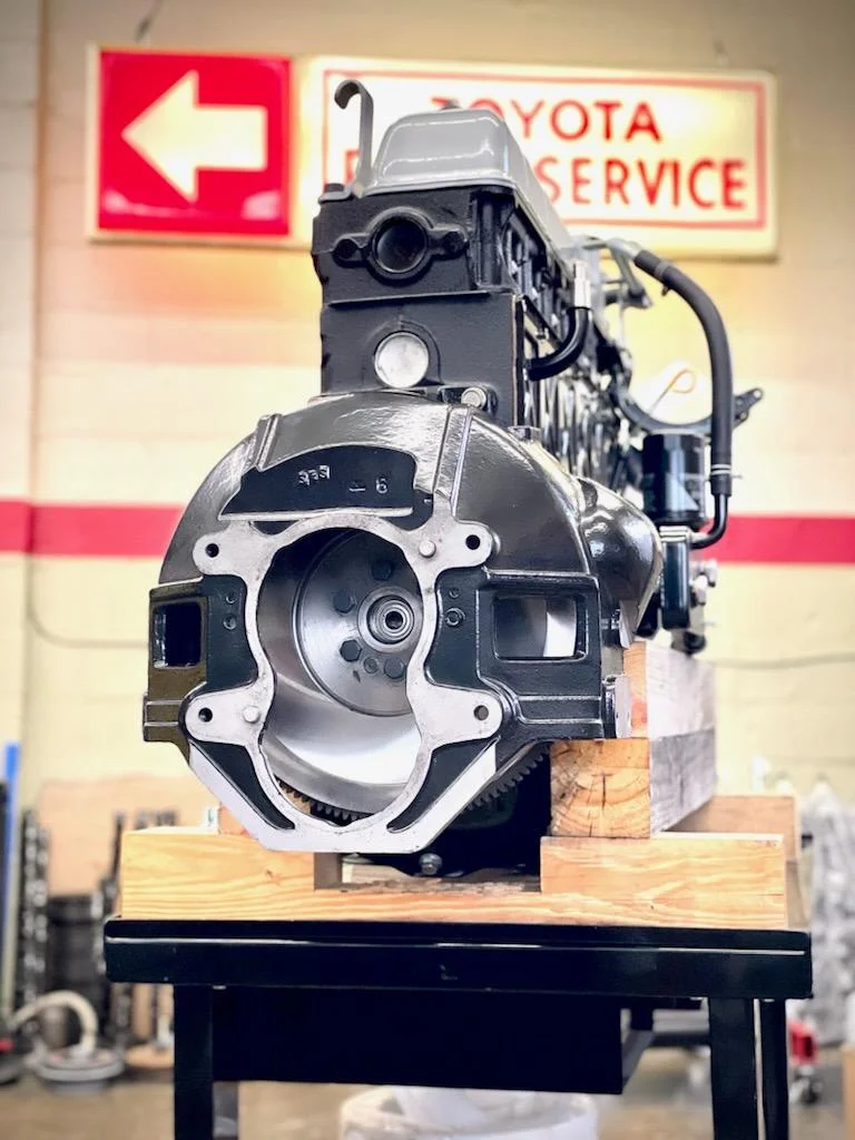

The motor made its way to @FJ60Cam (Mosley Motors) for his super hi-po cop motor builds. :cool: This was the summer of 2022.

I always have a drawer with old ball point pens. Could use lower half of ball point pens to center the upper two holes in the floating plate. Then should being easier to get the lower two bolts started.

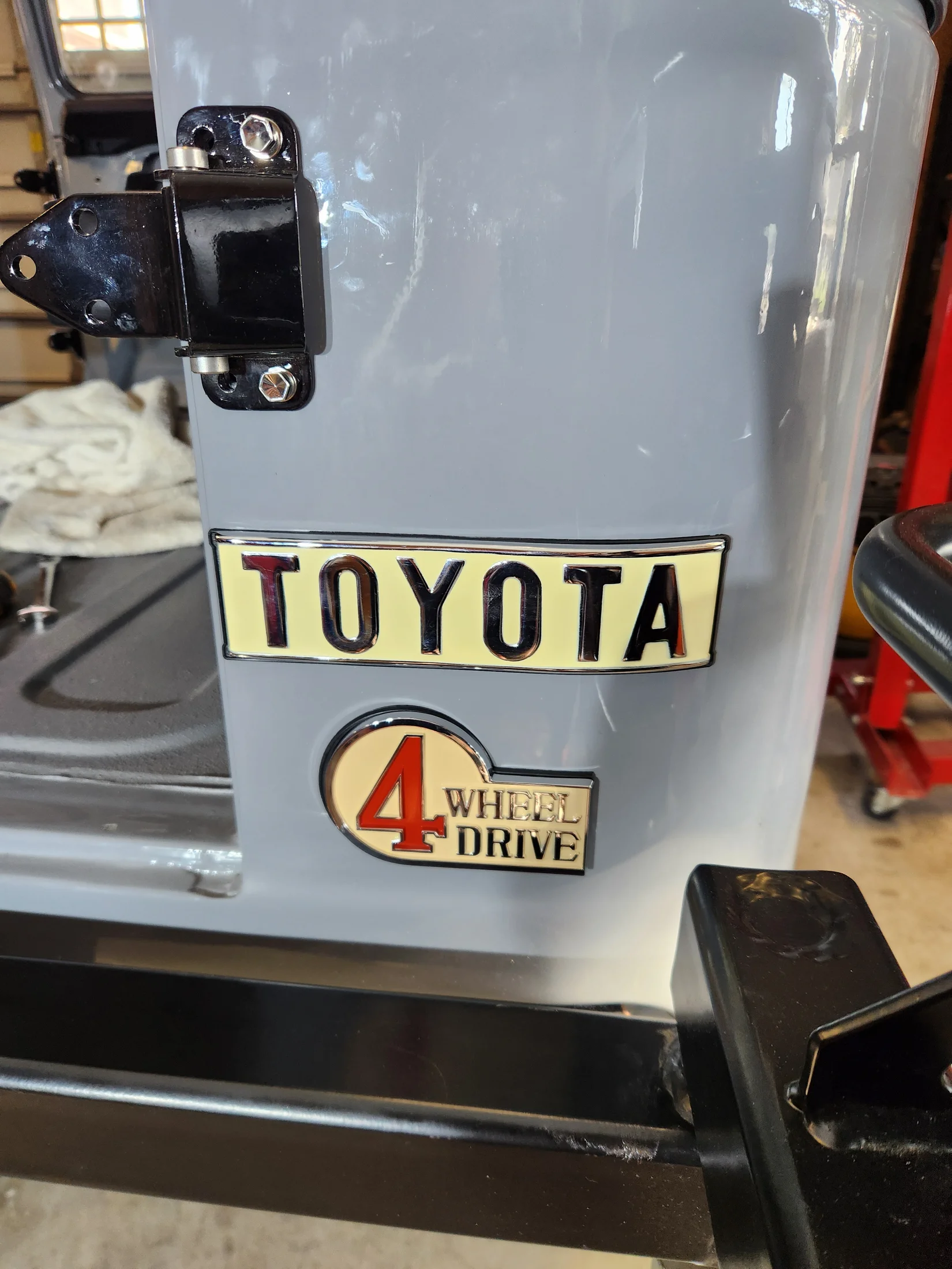

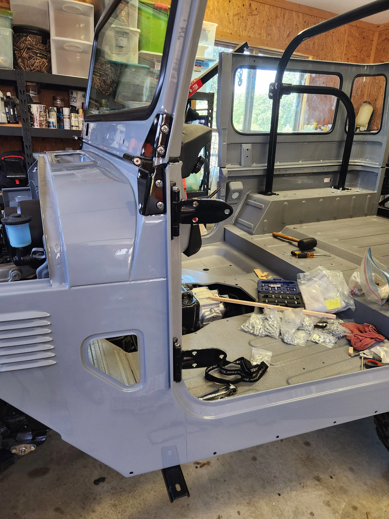

Didn't get a lot done today. Chased a ton of threads. Loosley mounted the rear ambulance door hinges, added the roll bar pads and put on the new rear emblems. I had to leave the top bolt out of the lower hinges due to the pins. Guess I'll need to screw to top off the pins, tighten the boot then put the pin back in. Really like these @SMG
Pins!!
