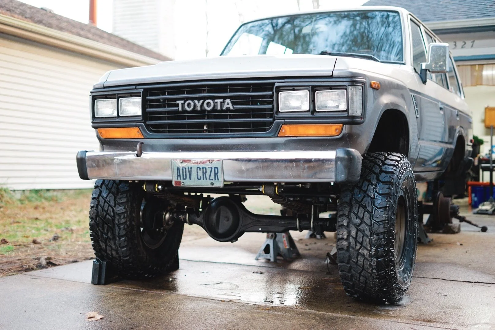

Well this weekend was very productive. Front axle is in! Placement is pretty good, I’m happy with its location. That Miller Multimatic 220 is an awesome welder, used flux core wire on the frame and it was fun and satisfying to weld with. I’ll need to rebuild the locking hubs because they felt tight as I was putting them back together and I messed one of them up when installing, but didn’t wanna pull it back apart because I don’t have the gaskets, so that will be on order soon. But you all probably just wanna see pictures....

Now that looks a lot better. Is it an illusion or is your pinion pointing down?
It may be, I assembled it with old measurements. Once I get it sitting more level I’ll double check and address, cut and turn would fix that though wouldn’t it?
Cut and turn comes after setting the pinion angle.
You set the pinion angle first by rotating it to the desired angle (depends on what kind of driveshaft you are planning to use, standard two joint or one with a DC joint in it) with the weight of the truck on the axle. Then you tack the spring perches to the housing. Are your spring perches just tacked right now or are they totally welded on? Once you get the pinion at the appropriate angle you then do a cut and turn on the knuckles to adjust your caster angle to accommodate for the new pinion angle you just decided on. I'll do the actual cutting on the axle away from the truck because it's easier but I like to adjust the caster angle with the axle under the truck and the weight on the axle. I like to aim for ~4 degrees caster but make sure you take into consideration a non level pad you may be working on.
That’s what I thought. I couldn’t remember if a cut and turn would fix that or not. I’ll make sure it is done right but I’m not to worried about it right now.

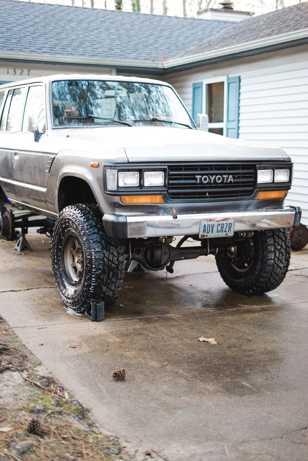

It’s update time. Cruiser is on all 4 wheels under its own weight. Brake lines are ran on the axles, LSPV is deleted and the Wilwood proportioning valve is installed. Hard lines and soft lines are all in place, just need to bleed the system. Ordered the power steering pressure line, because that decided to start leaking; should be here around Valentine’s Day. As was noted previously my front axle is pointing down, resulting in the pinion angle being off by 3°. That means I’ll have to take the perched off and fix it. I was hoping getting it on the back wheels would even it out but it didn’t. I’ll probably end up doing a cut and turn while I have it back off.

No good pictures yet with this update, only a dark picture I took at night when I got it on all 4 wheels.
