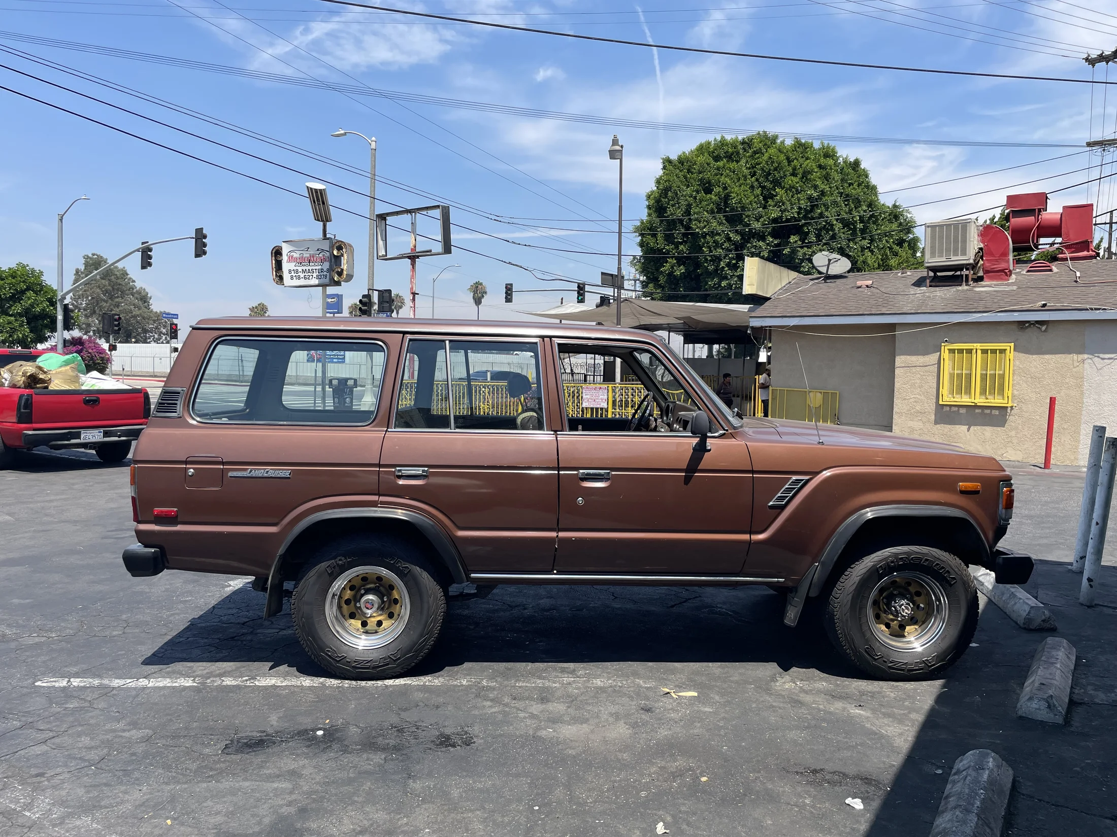

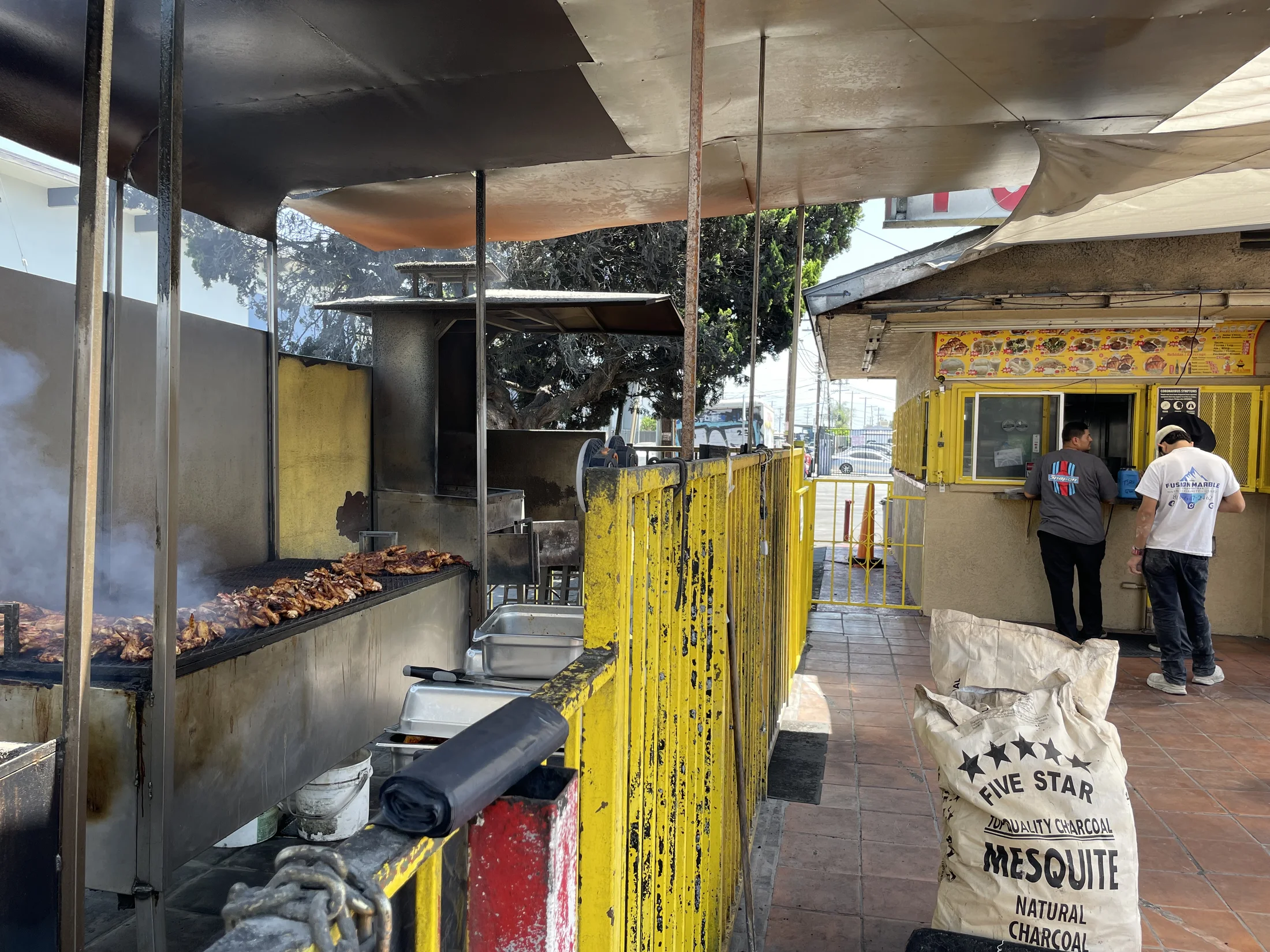

Woody on its first taco run. This one's for @Spike Strip, Woodman Ave and Woodman Pl near the Copart. Pollo looks legit. Picking up some jute under padding from Vic's.
Pollos Al Carbon ! Sketchy, but I've been there! :rofl:
I bought a 1st Gen Isuzu Trooper from that Copart, many years ago -- They burned me with a bad head-gasket!

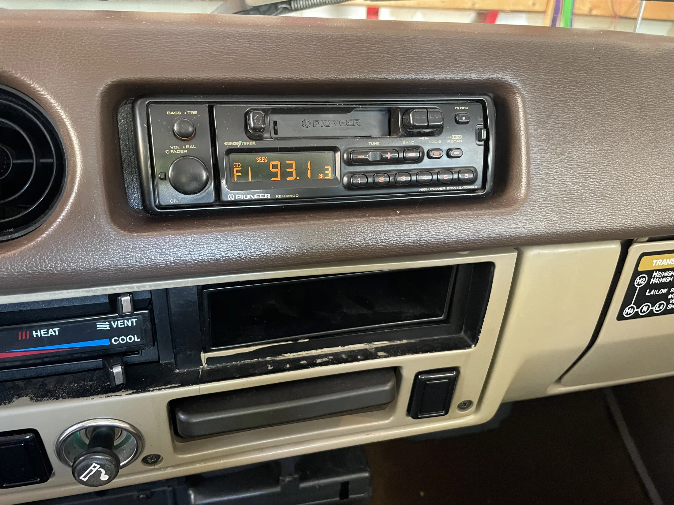

Spent some time with the audio situation this afternoon. I'm trying to keep this as low-buck as possible for now, so found the old Pioneer head unit that came with the 40 and installed that. Has a nice retro look to it, but it's radio / cassette only, which is fine. Wiring was a bit weird with a 5-wire setup and shared grounds for the front, but made it happen. There isn't a ton of room behind the dash to get a hand up there. Also ran constant + direct from the battery rather than try to find one to tap in the dash, just wasn't feeling it today.
I ended up using the Cruiserhead @ChaserFJ60 bracket, easy install and nice product. Very glad I didn't have to pull the dash for this.
Next up is replacing the speakers. Everything is wired, just ran out of time for the day. Also my antenna is super janky - I need to replace it but what I have is fine for now.

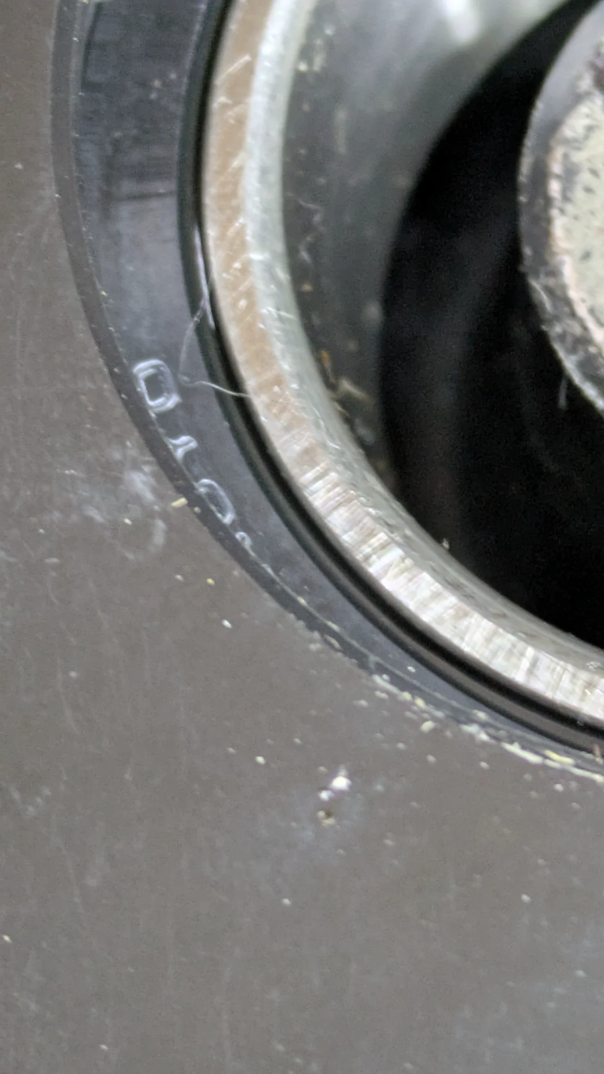

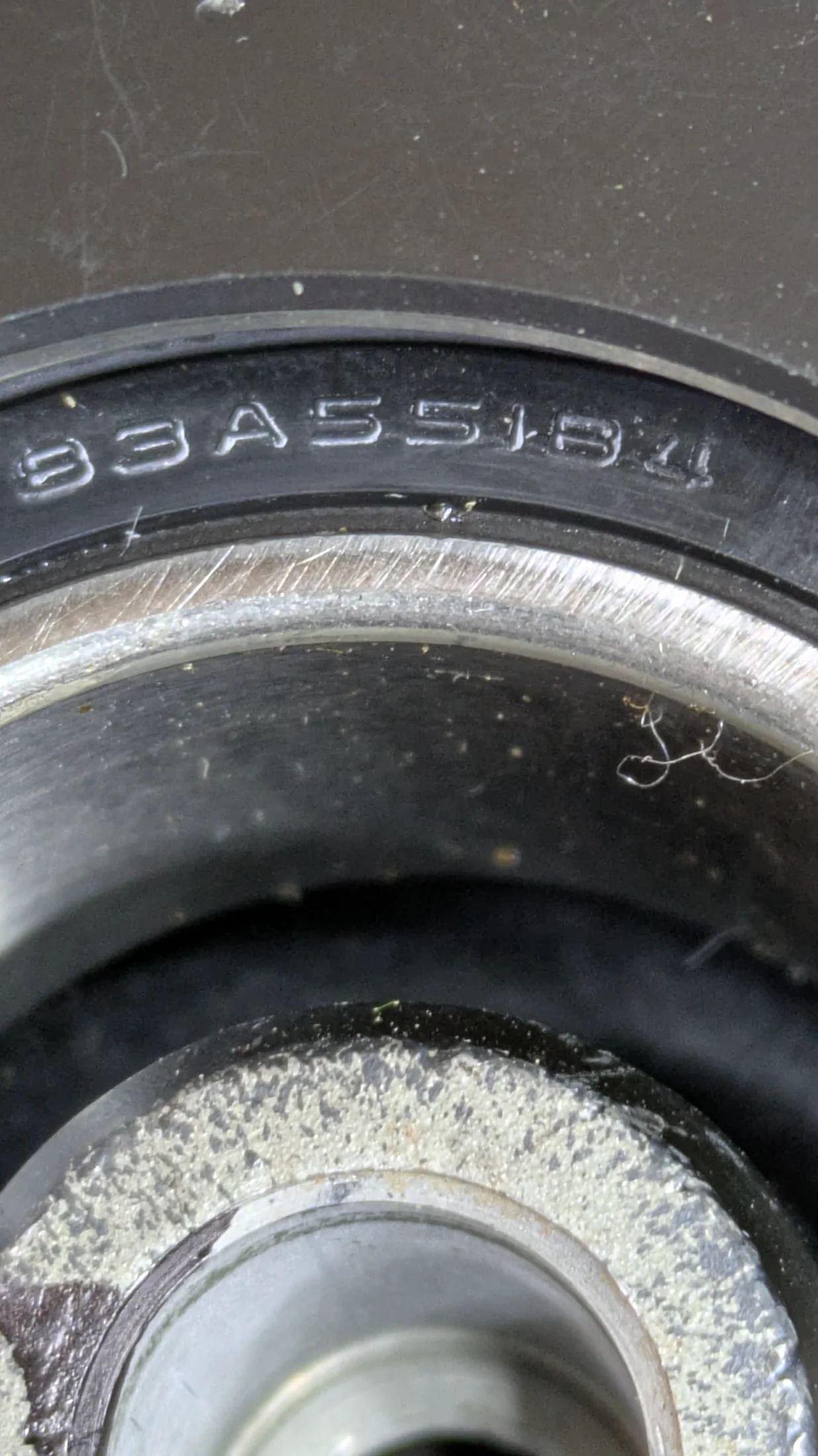

Now need to fix that damn AC compressor bearing.. and about 50 other things..
Have you sorted out the bearing yet?
This is the OE bearing
83A551B4 Koyo - But it's an old number so you'll have to figure out the updated Bearing Code.

83S551B4 Koyo - But it's an old number so you'll have to figure out the updated Bearing Code.

Thank you! I was able to find a bearing on Amazon that fit the dimensions listed for that one. I can't find a Koyo version of it for sale, however. There was a Nachi bearing that I was trying to get from someone on Ebay, they posted a tracking number for it over a week ago but never shipped it. I got one on the way from Amazon in the meantime, should show up tomorrow.

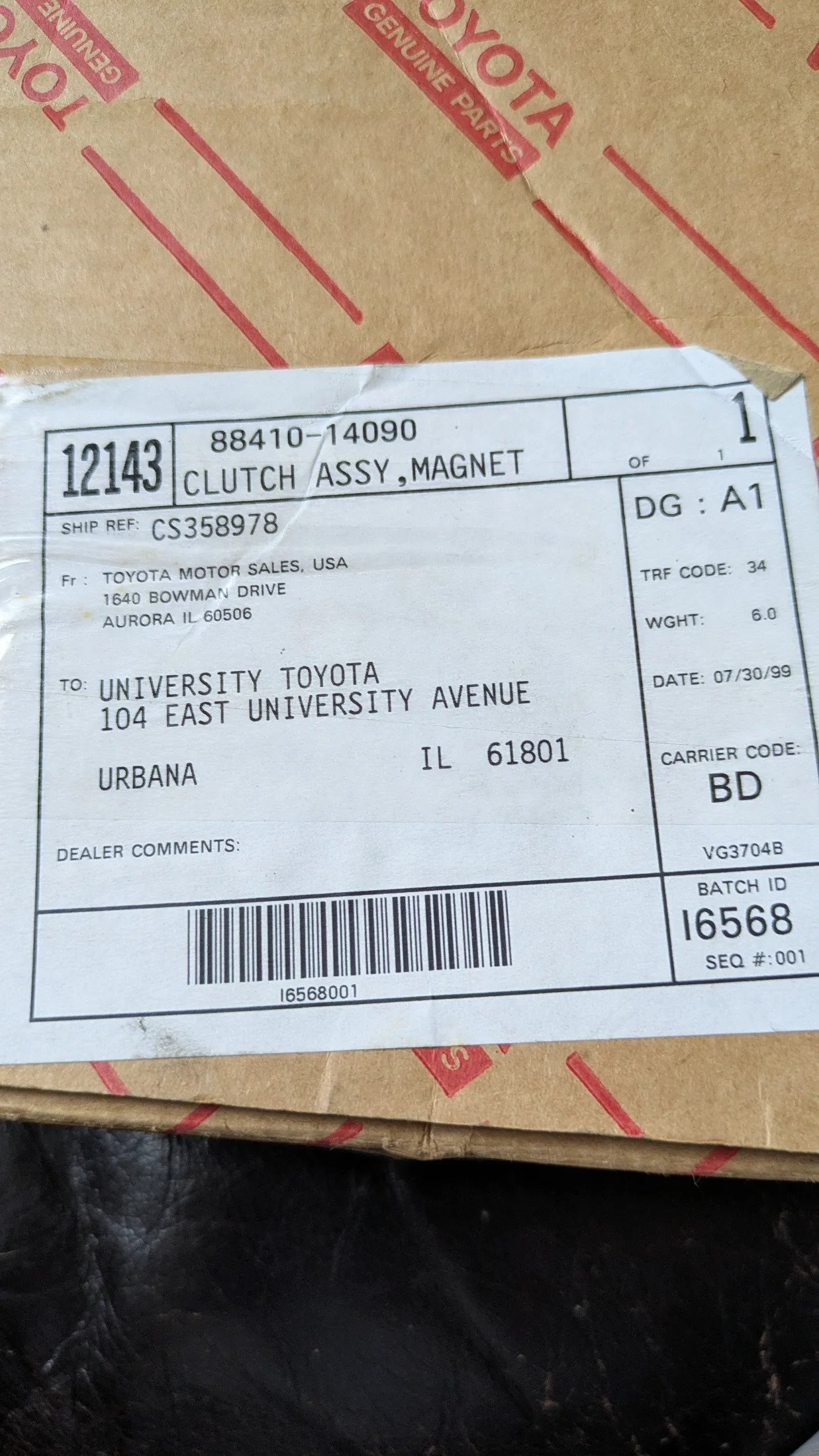

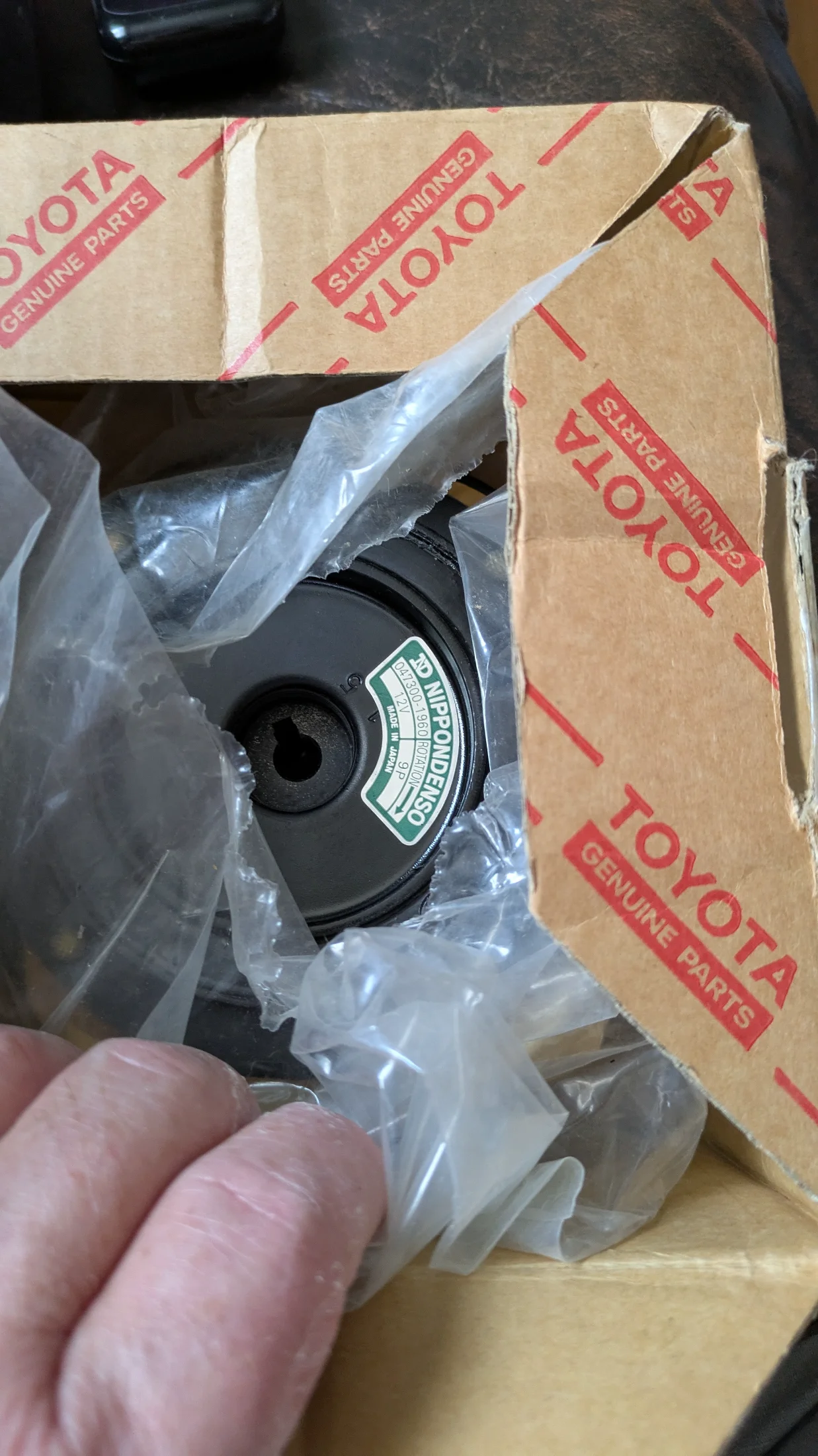

My electrical solenoid is bad but the pump is good. I got a used unit from someone and going to swap out the clutch and magnet. Really all I need to get my A/C going.
