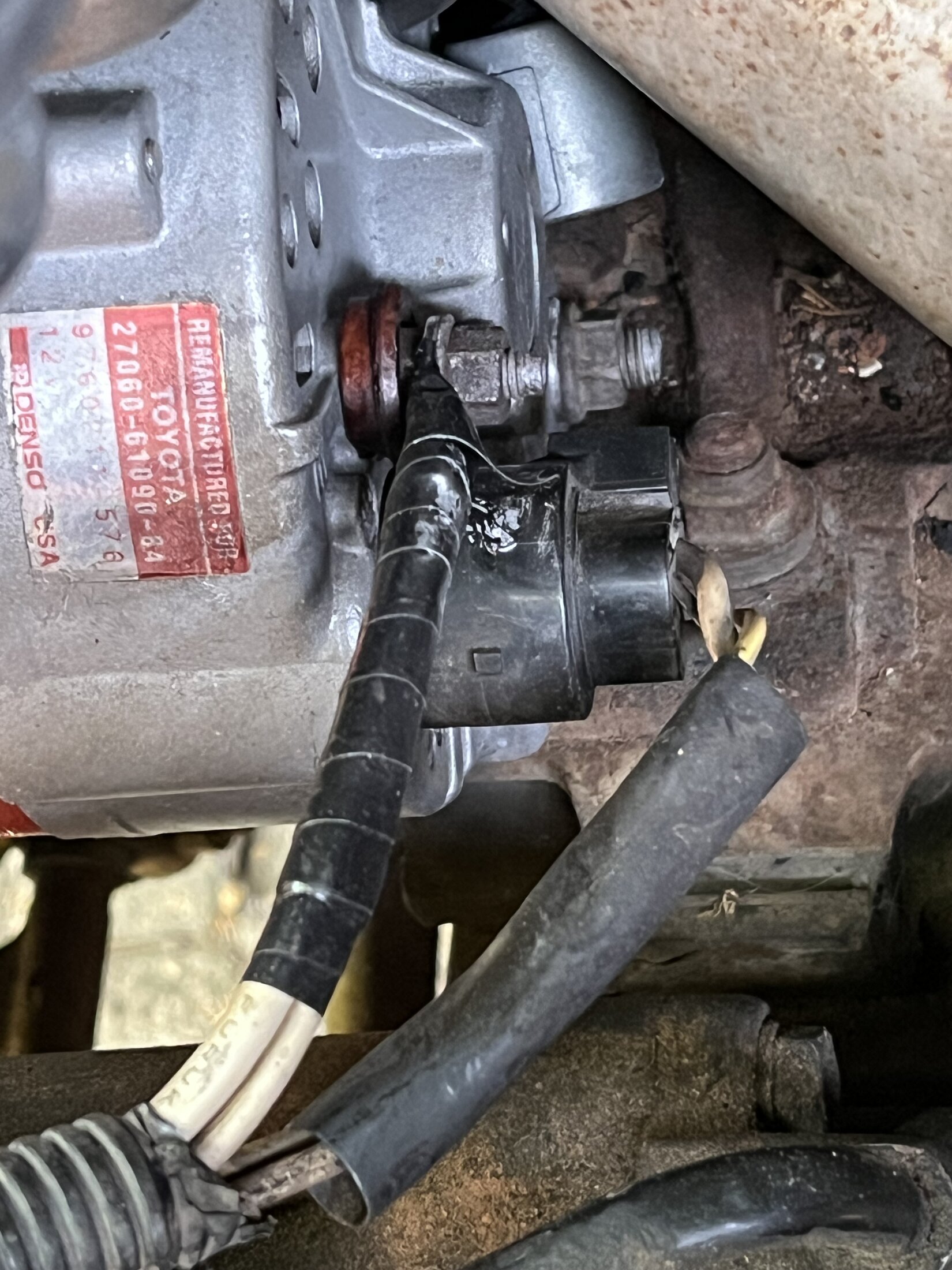

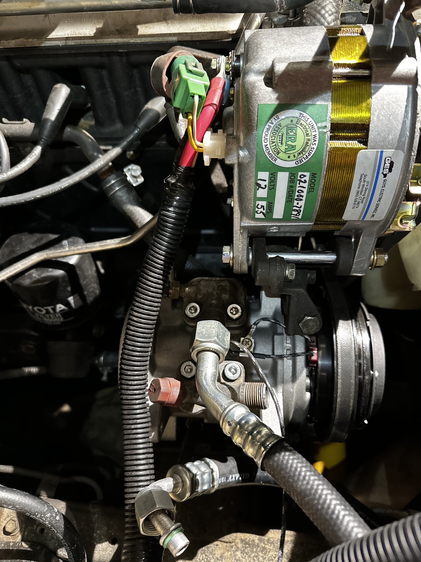

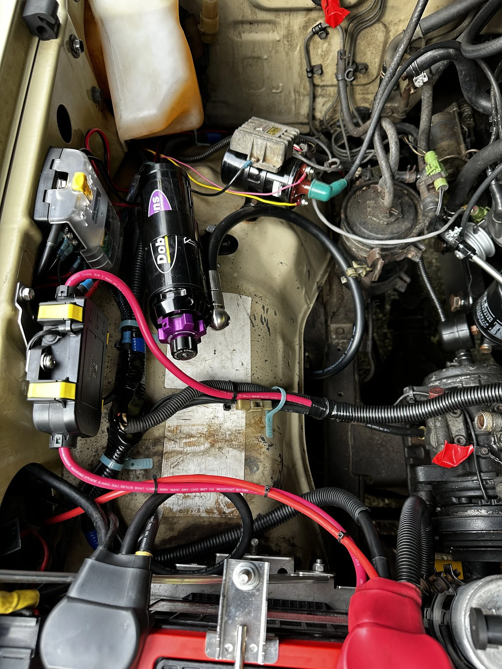

Now that I’m looking at it all it does seem that I have a lot of electrical stuff going on. Nothing to compare to as I’ve never seen under another FJs hood, but snapped these photos. Maybe it’s normal but it appears to have numerous pigtails and add ons etc…

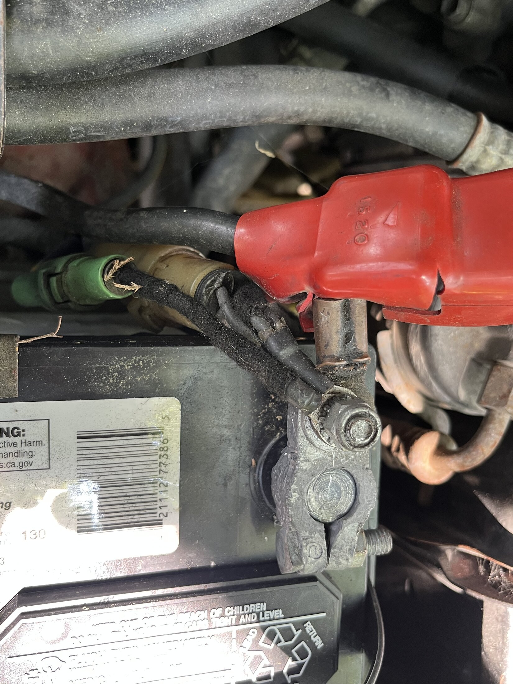

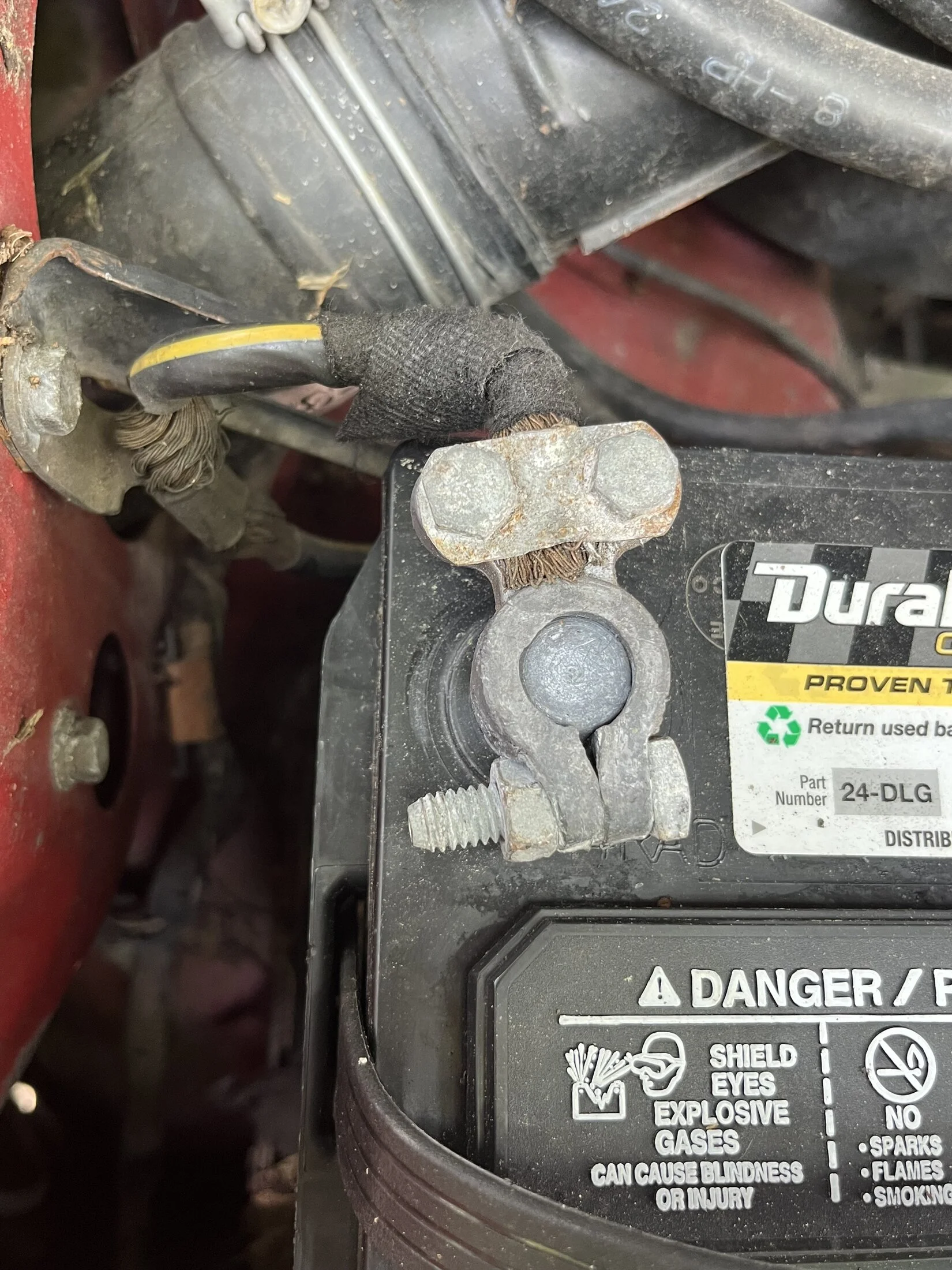

One of the alternator and then pos and neg on the battery.
I noticed wires running directly from the alternator to headlights and running lights… numerous connectors that weren’t connected to anything etc… can take more pics if these seem like there more be going on.
Wondering if it had electrical problems and someone simply bypassed things vs fixing if that makes sense.

I'm not an electrical wizard, but I traced a myriad of ghost electrical issues to a loose and corroded positive battery terminal connector. Those points are most sensitive than you'd think and I needed to clean the exposed copper and re-tighten the clamps to solve my battery charging issue. I sprayed some Napa terminal protector on it afterwards to seal it.

There's a few sins in your engine bay, running loads off the alternator output is inappropriate. I cant tell if there's a voltage regulator still in place in your engine bay (wider photo)?... I'm really leaning towards a basic alternator wiring fault and the only way to resolve that is with a basic working knowledge of alternators and more information on the current state of the wiring loom setup (internal vs external), some insight into the 60 series charge relay and a bit of technical curiosity that leads you to learn more along the way.

4. I’d definitely update your ground cable and connection to the battery. These can easily be sourced and fabricated which is always a good idea as aging wires do not perform as well as new ones.

Hello, You will want to make a test wire that goes from the + side on the battery terminal to the + post on your alternator. This will be marked on the back of the alternator and should be the one in your first picture but you can confirm as well by looking, at least my alternator has a + symbol.
Cheers, James
