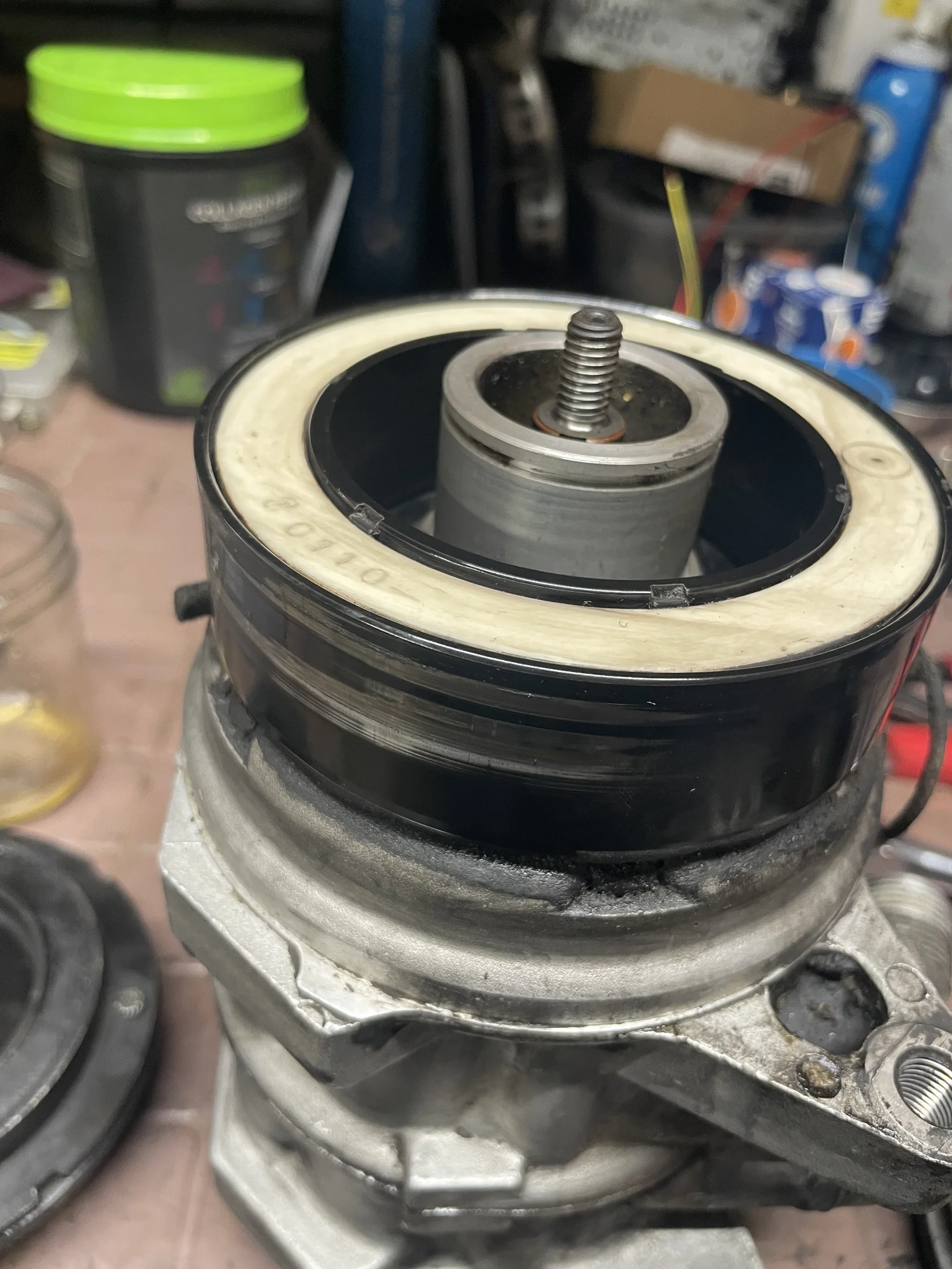

Nice work! My question to you is, was the compressor pulley making noise? Maybe I missed that part in your thread. I have an 84 which came to me without the belt attached and all hoses disconnected. The one thing I noticed with my pulley is it spins freely, like fairly easily. Any idea if that is normal?
Thanks, Matt
Definitely normal. If you look at yours, there should be a clutch plate that attaches to the shaft of the compressor in front of the pulley. The pulley and bearing sit on a boss (that silver cylinder in the center, the threaded post is the compressor shaft) that is concentric with the shaft and part of the compressor body. When you hit the AC button in the cabin, that energizes an electromagnet pulling the clutch onto the pulley, mating them together and driving the compressor shaft. This cycles on and off based on the pressure in the system.
The part that's making a little noise is the inside of the pulley rubbing on part of the electromagnet assembly - it may be slightly out of round or something but it still works fine. You can see the witness mark down below.
Wow, very detailed explanation..thank you! Makes me even more curious why whoever disconnected all of my AC bits did it.

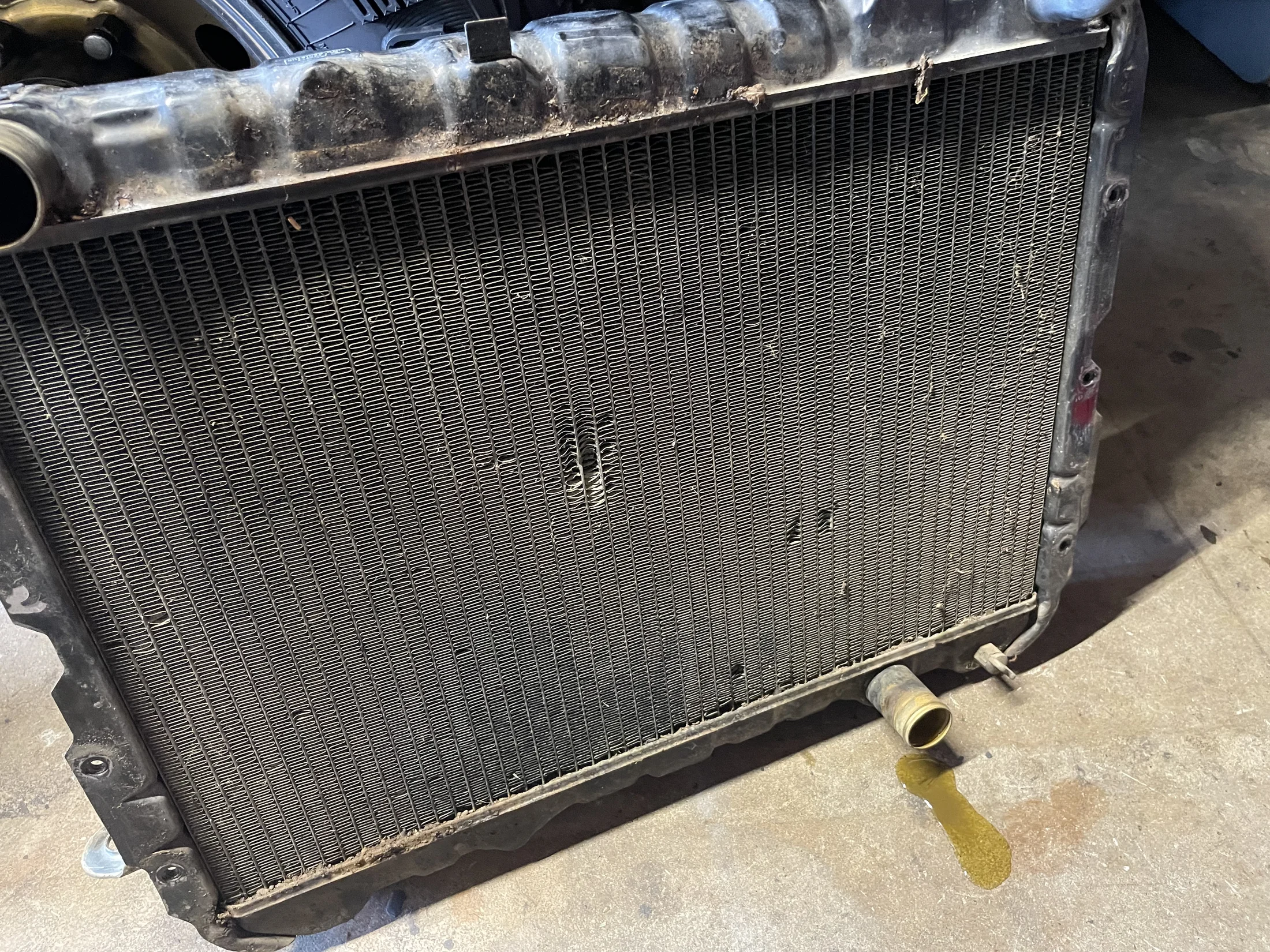

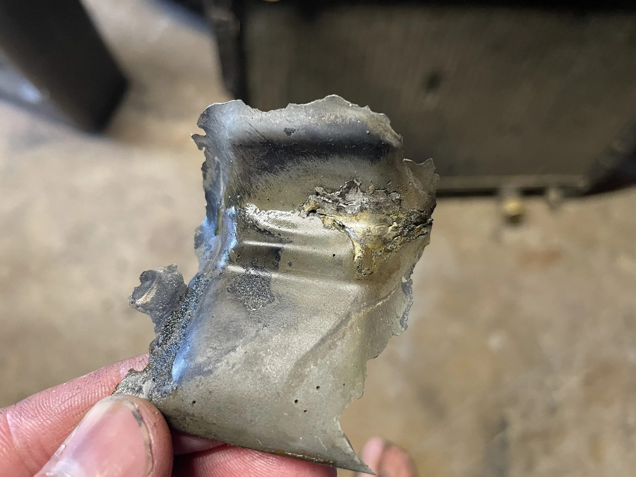

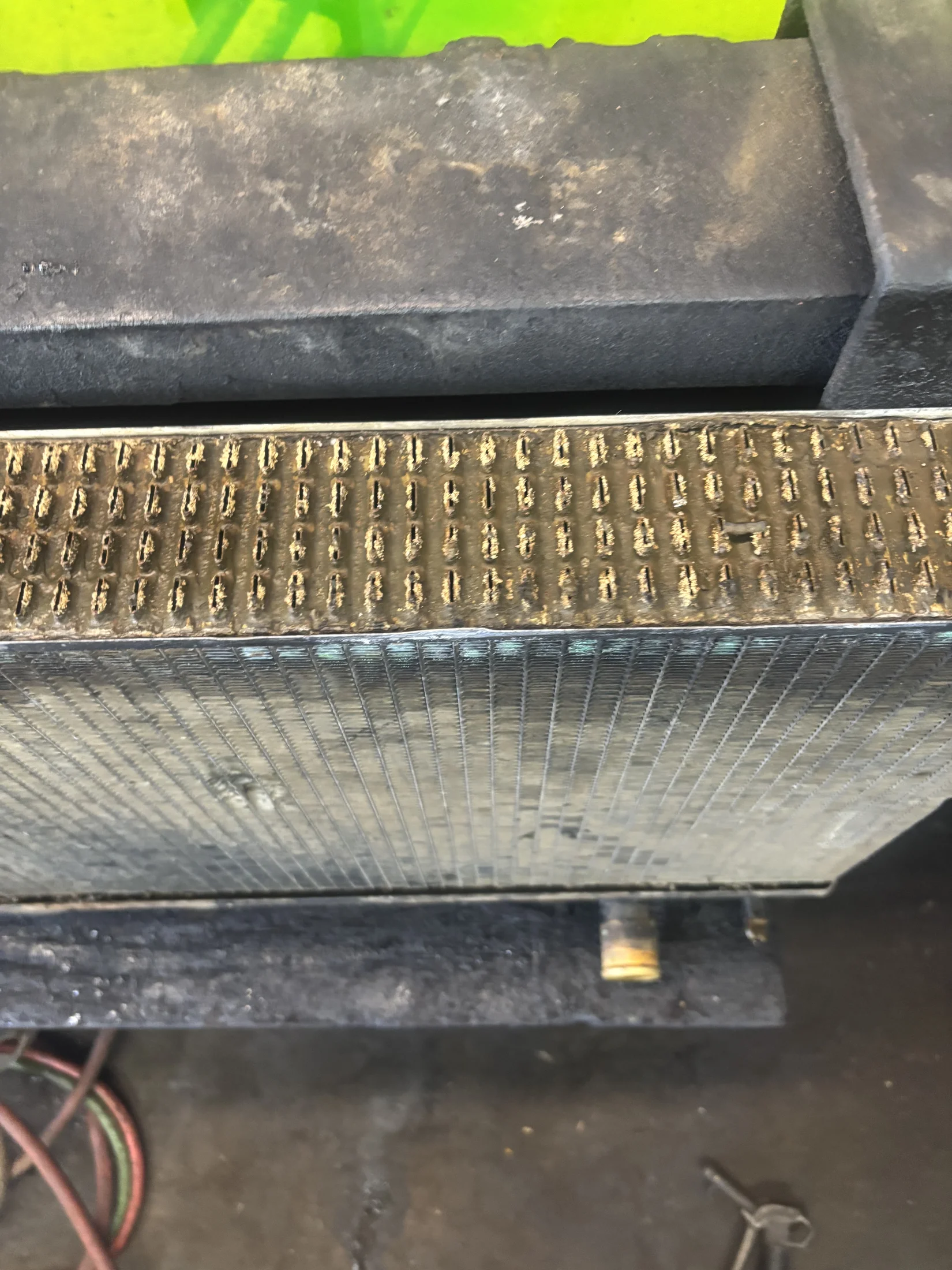

Pulled the radiator today. Time to get it over to the radiator shop and repair the top tank and have it rodded out. I pulled the JBWeld repair right off without much effort...

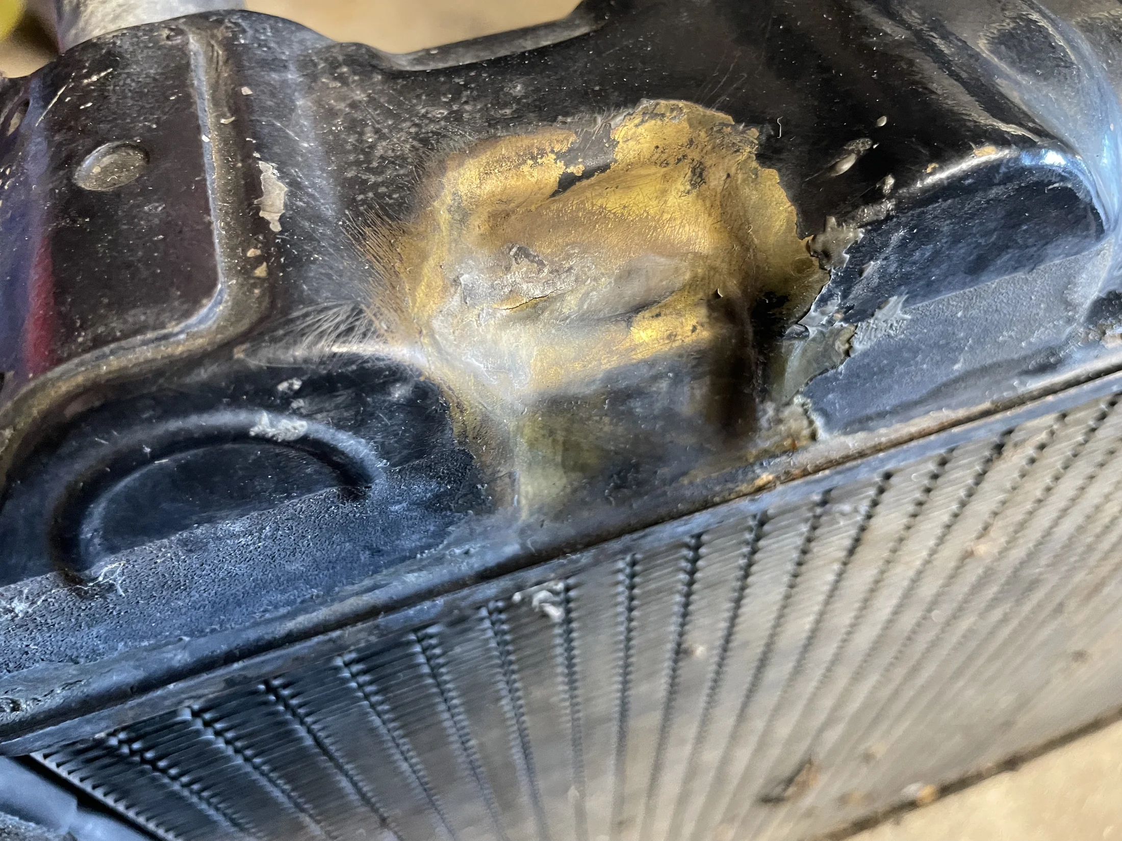

And the corresponding part of the tank where it was affixed. Pretty easy to see the small crack this was holding down. That may have been a little bit of brazing or solder that was affixed to the JBWeld.
General view. That ding in the middle is just a ding, no cracking but will leave it to the rad shop on how to repair.

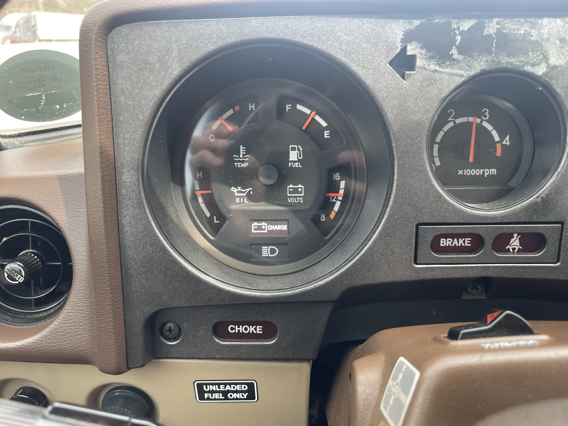

Done. This was after climbing up the big hill on the 210 east heading home from Costco, 95* and 90% humidity, air running full go. I put in a lower temp thermostat from Mark @65swb45, after we chatted about replacing the gaskets between the two halves and connecting to the block.

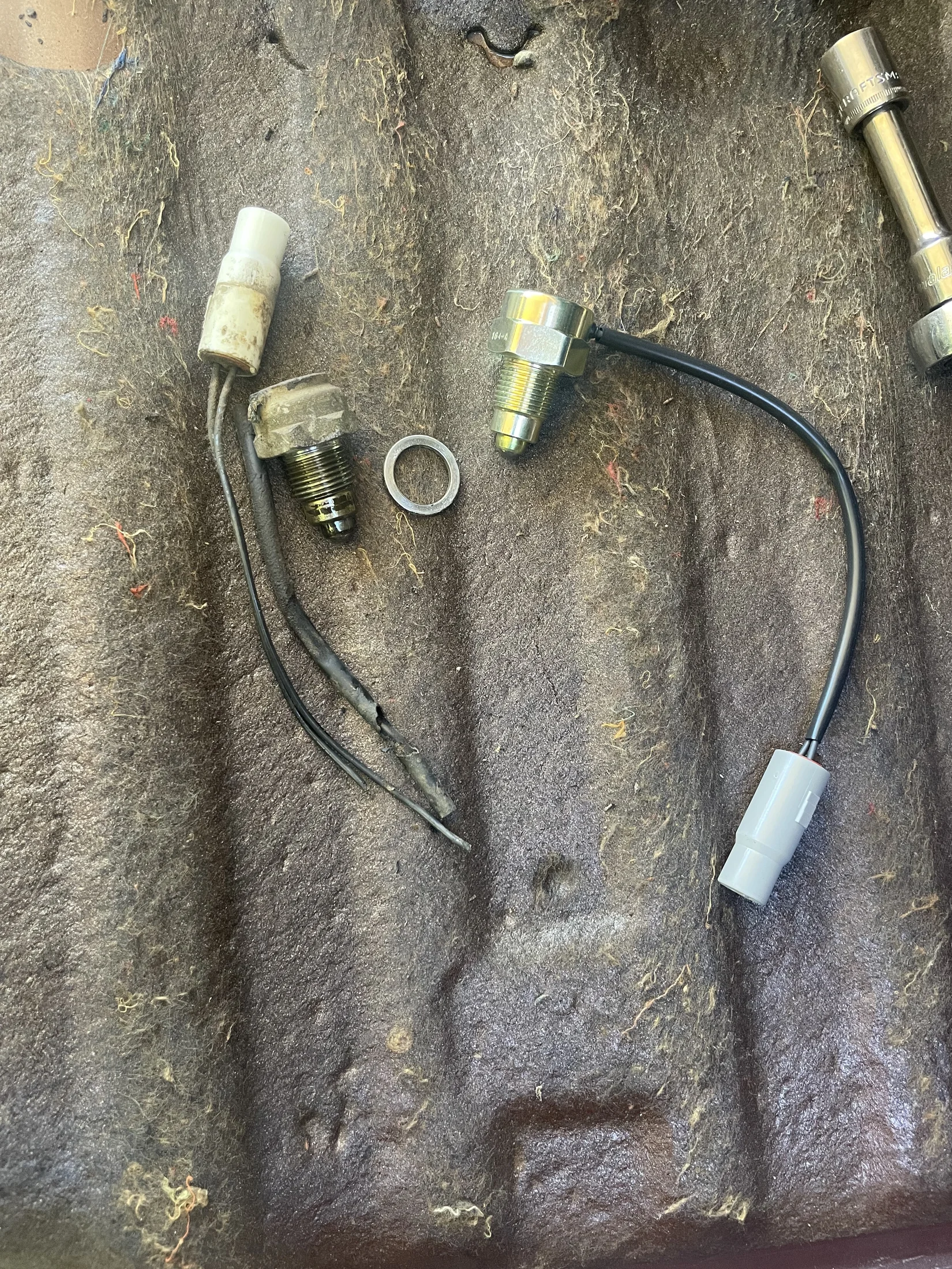

Couple things yesterday and today. Got after the reverse light no-worky problem, turned out to be our Deadmau5 friends again. This is sort of a pain to get to, pulling seats, carpet, etc. OEM was $80 for a $25 Rockauto switch, holy crap. But the rig was apart, and wanted to get it done, so pay the man and move on. Fortunately the lights work great, don't have to chase any busted / chewed wiring further down the harness.

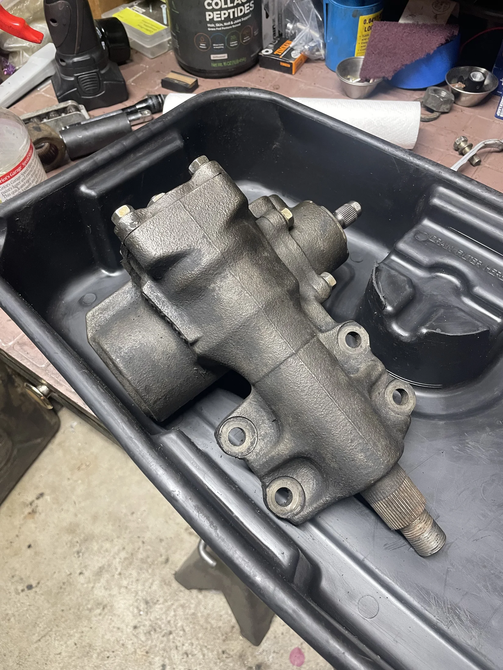

Alrighty! Next project is to rebuild the power steering box. It's not leaking, but making a groaning noise when turning right even after replacing the PS pump and bleeding it multiple times. Found the kit from a vendor in Australia, this was in Melbourne on Sunday night. DHL for the win!
And the box cleaned up off the rig. Needs just a bit more degreasing before starting to break it down.
The kit. Looks legit. I was able to find the Daihatsu one on eBay but only vendors in Indonesia had it. This got here much faster. Price was about $55 USD, but then another $30 for delivery, $6 for customs (tariff), and a whopping $18 for DHL processing fees ON the tariff. Stupid but beats the $195 that SOR wants for the kit. Too bad Toyota discontinued these not too long ago, time was you could get them from Amayama for ~$50 delivered.
