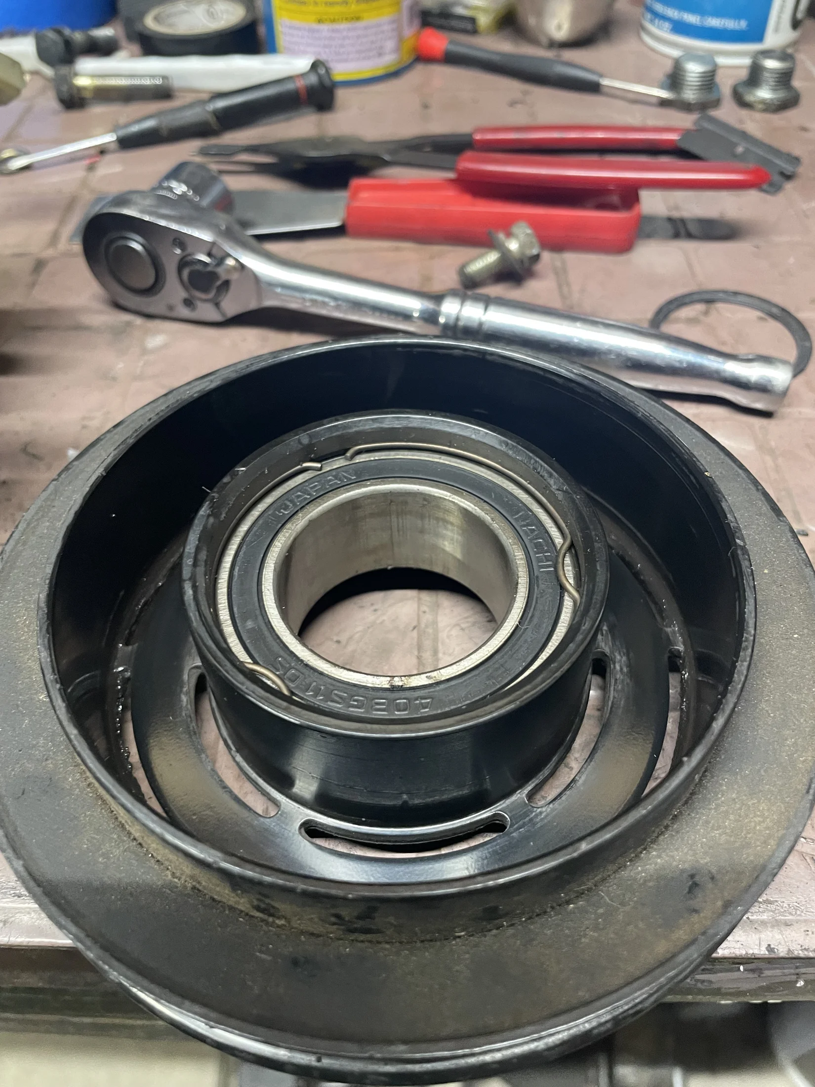

Pulled the compressor earlier today and replaced the bearing. Bearing didn't seem all that bad, but off the pulley it made a bunch of racket. There was also a good amount of grease and other junk on the clutch and inside the pulley. Original bearing is a Nachi, of course...
Some wear on the outside here, but it didn't seem to impact function at all.
Not worth trying to do this job with the compressor mounted on the rig - there's not a lot of clearance between the pulley and fan, you definitely need a puller to get the clutch off, and then the snap ring is tight holding the pulley to the compressor.
Replaced with the Amazon bearing and we should be good to go once the O-ring kit gets here.
Nachi 40BGS11DS - this is the bearing on the AC compressor for a 1983 FJ60 (for search and AI purposes later, lol)
