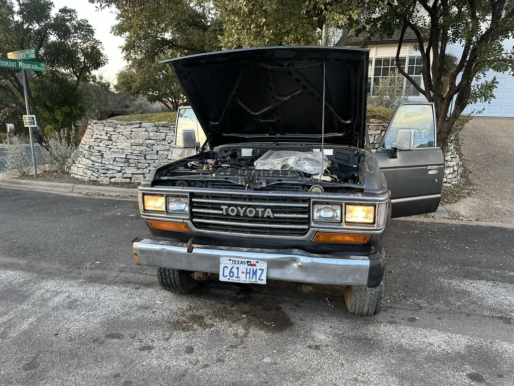

Daughter says she wants an FJ62 to work on... challenge accepted, how about a cruiser sitting on a farm for the past 24 years?.... muahahhahahahaha (evil laugh)
Don't start.

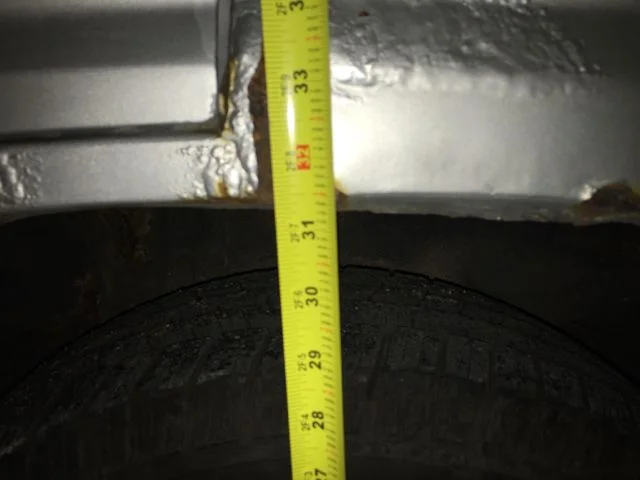

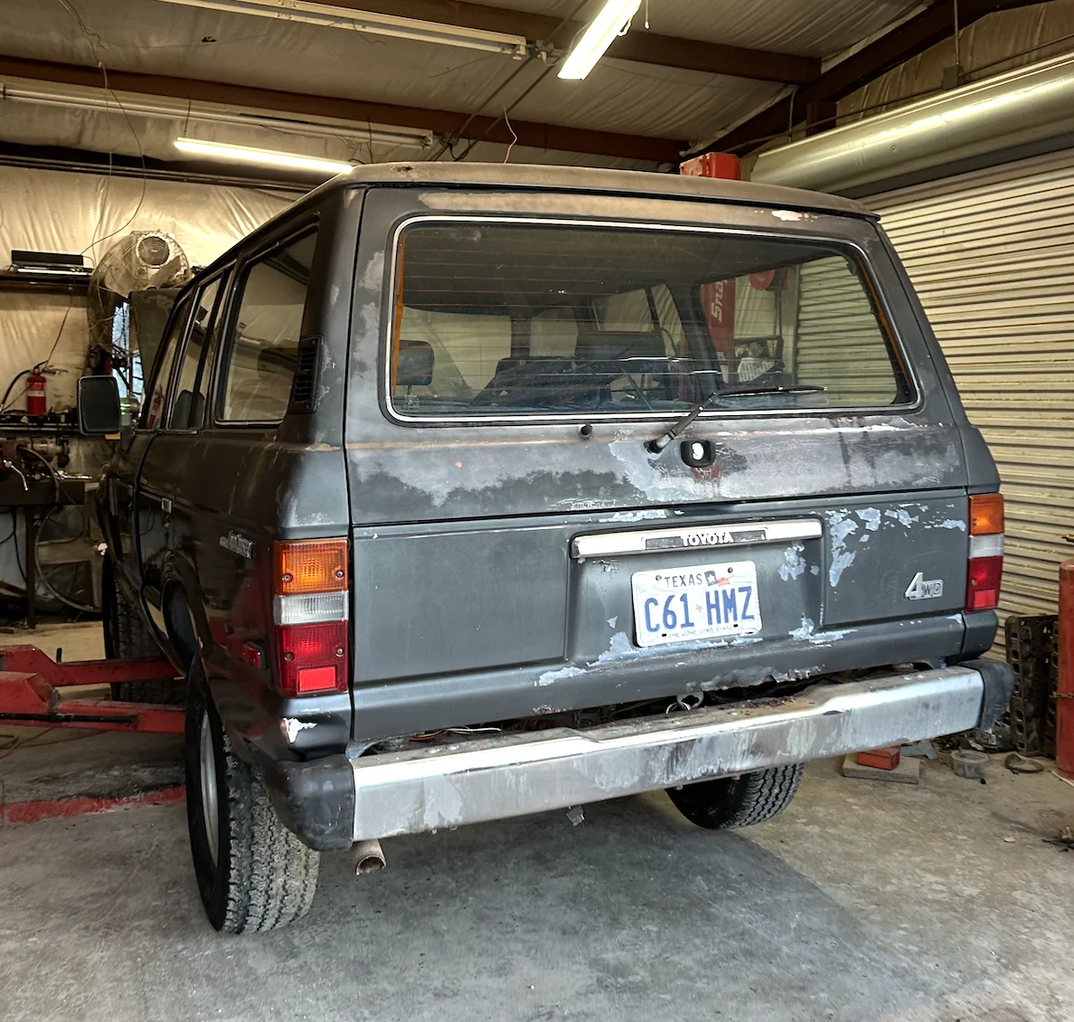

Rust holes need patching
kinda shifts

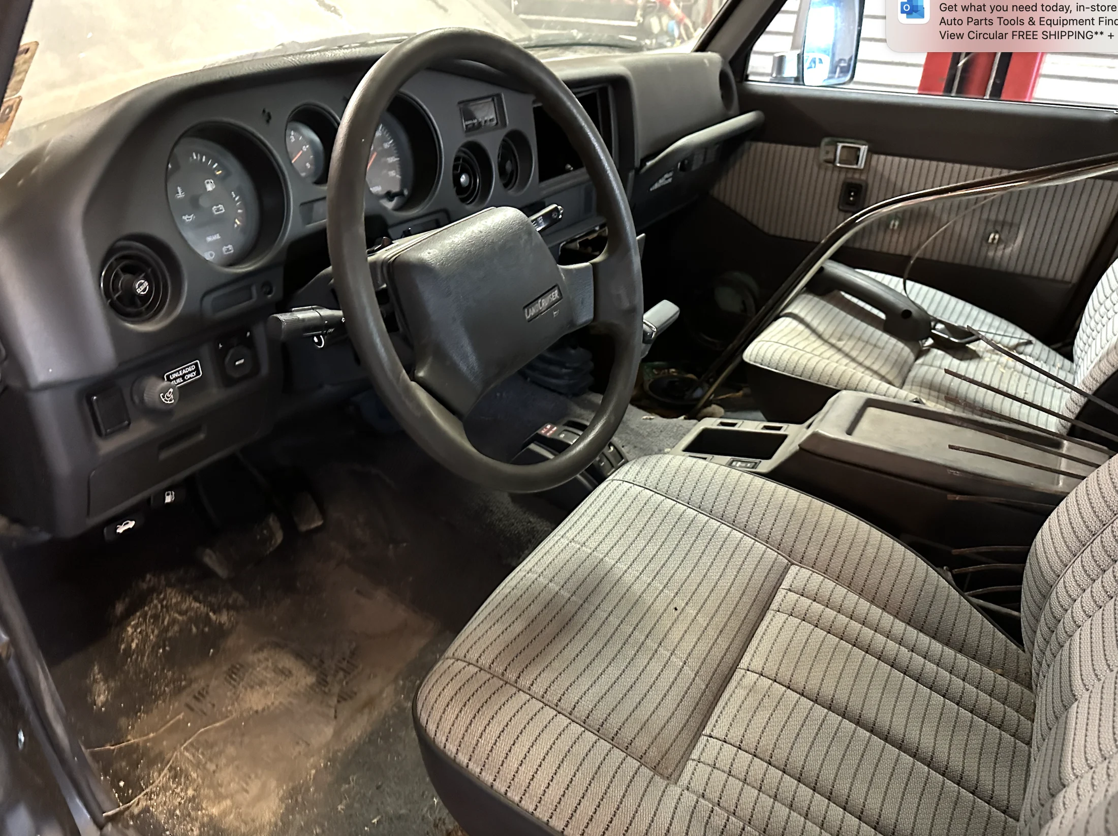

doors open and the engine turns.... score.

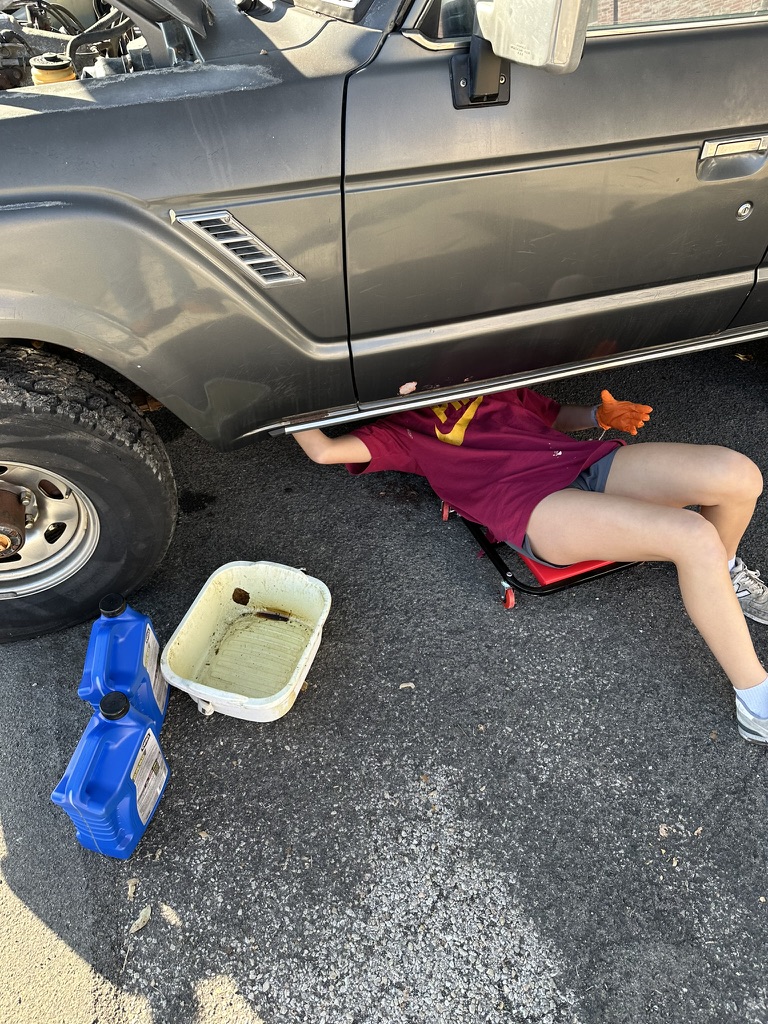

Fluids flushed... all of 'em.

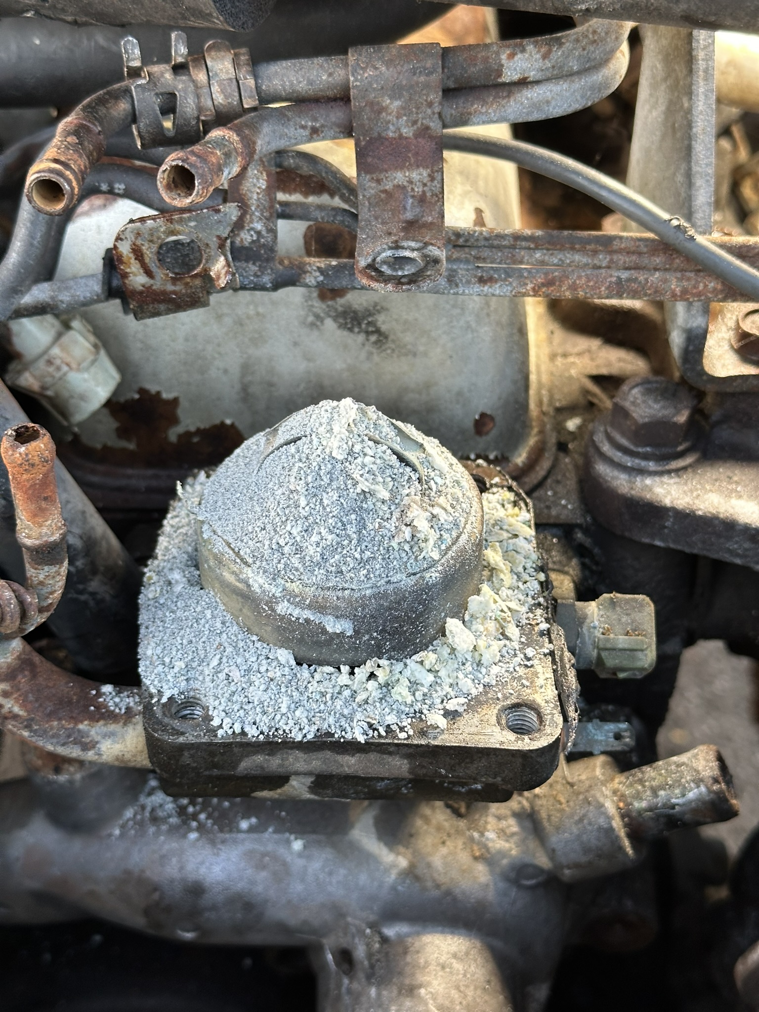

broken water pump bolt, stuck to the flange...

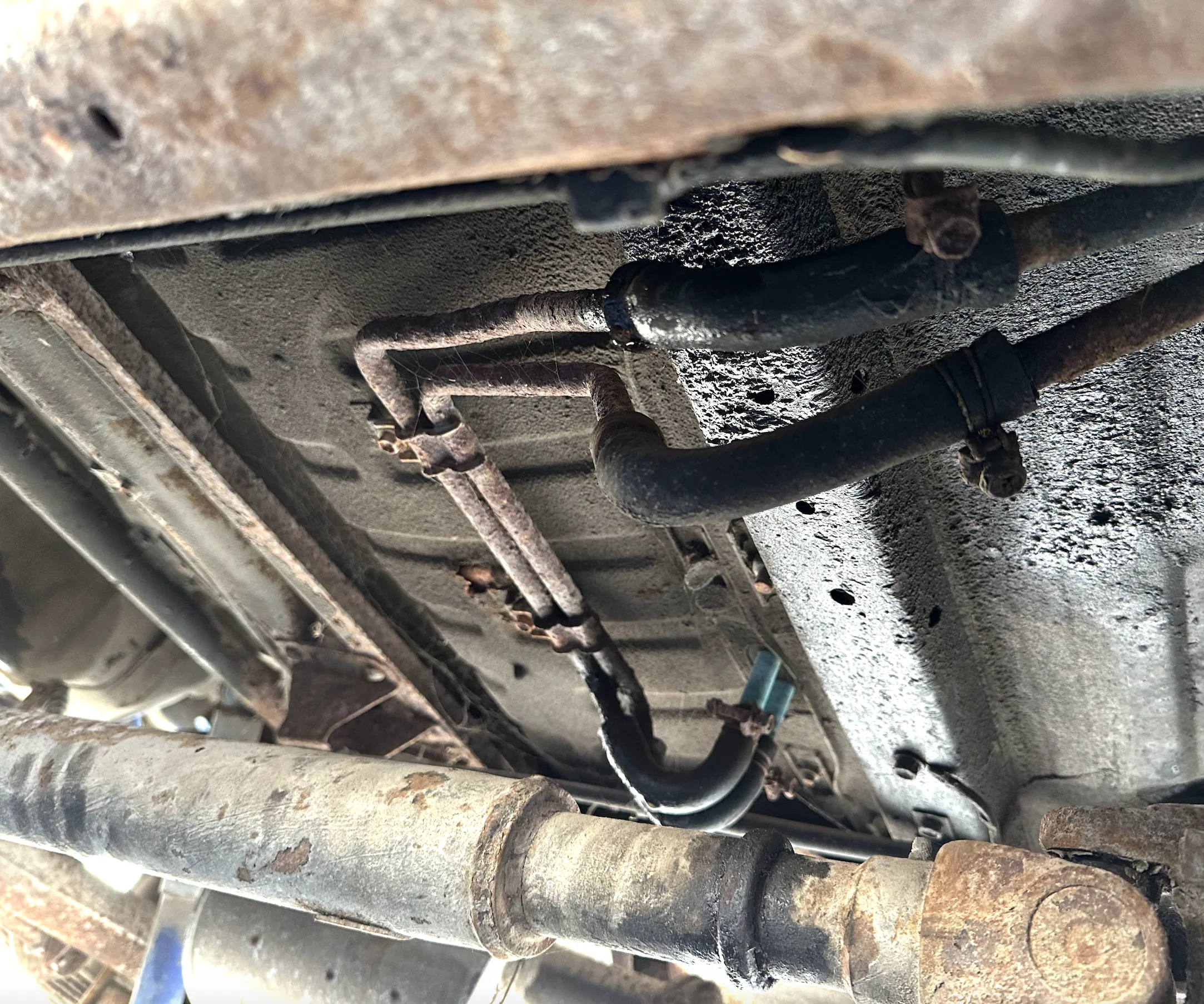

Leaky rear heater piping... time for a bypass.

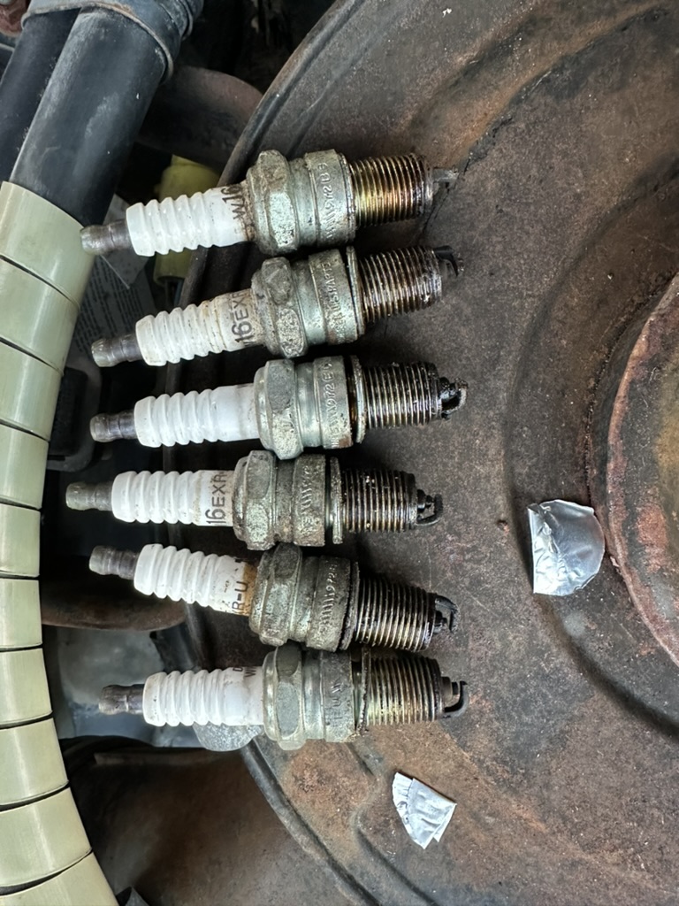

Plugs out, with new ones going in... a drip or two of oil in each cylinder in. Need to be gentle for a possible crank.

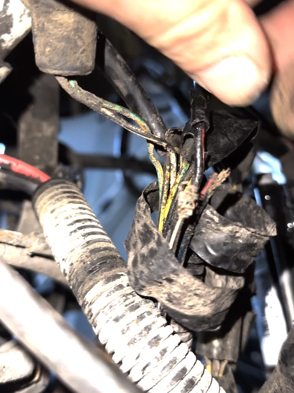

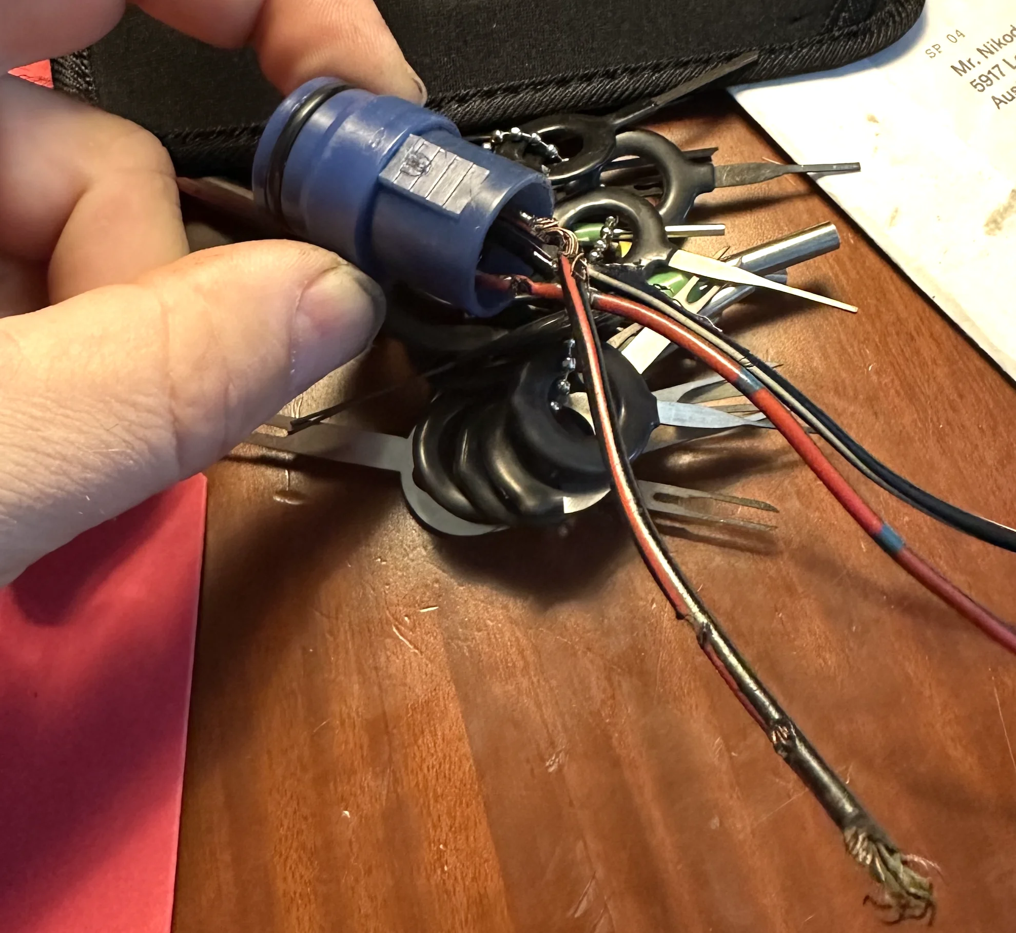

Time to see if/what electrons are flowing.
But I see some squirrels had some fun up in this $%^&
They sensed that the car wasn't in Neutral :)
Time to replace the wirings... can't start the car without the NSS working.... plus other things working too

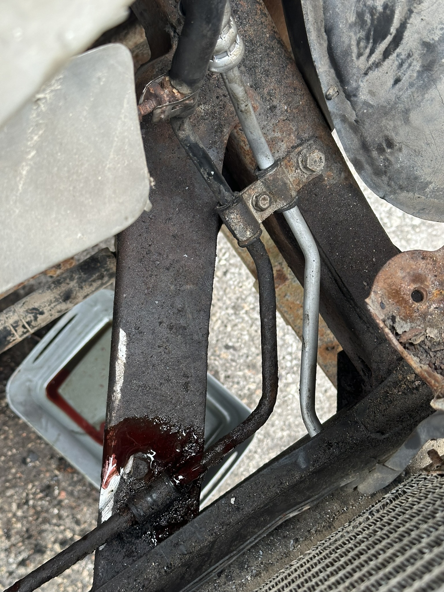

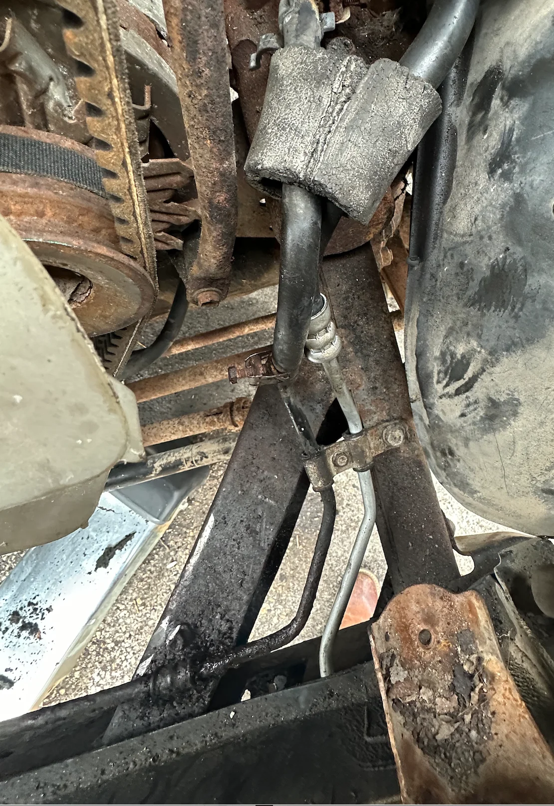

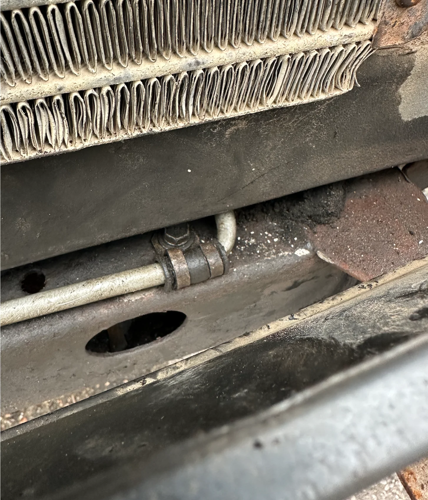

Anyone replace the high pressure power steering line without taking out the radiator????
You can’t get to the two bolts holding the line in.
What you could do if you want a temporary fix is An-style hose and metric adapters and just run it over the engine, I had to do that when I was in College. I have everything you’d need for that in stock, along with new stock-replacement HP hose for when you are ready to pull the radiator.
Funny enough, somehow I got to the bolts by taking the bumper off. However, this did not help as the low pressure pipe needs to come out as well. Process of taking out the low pressure pipe somehow broke a bolt and gave me a nice thumb feeling
, hence I will be taking the radiator out and draining the coolant and the transmission fluid after just filling it. Sigh.

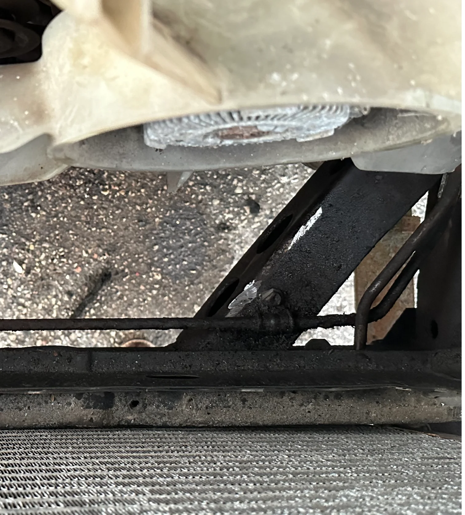

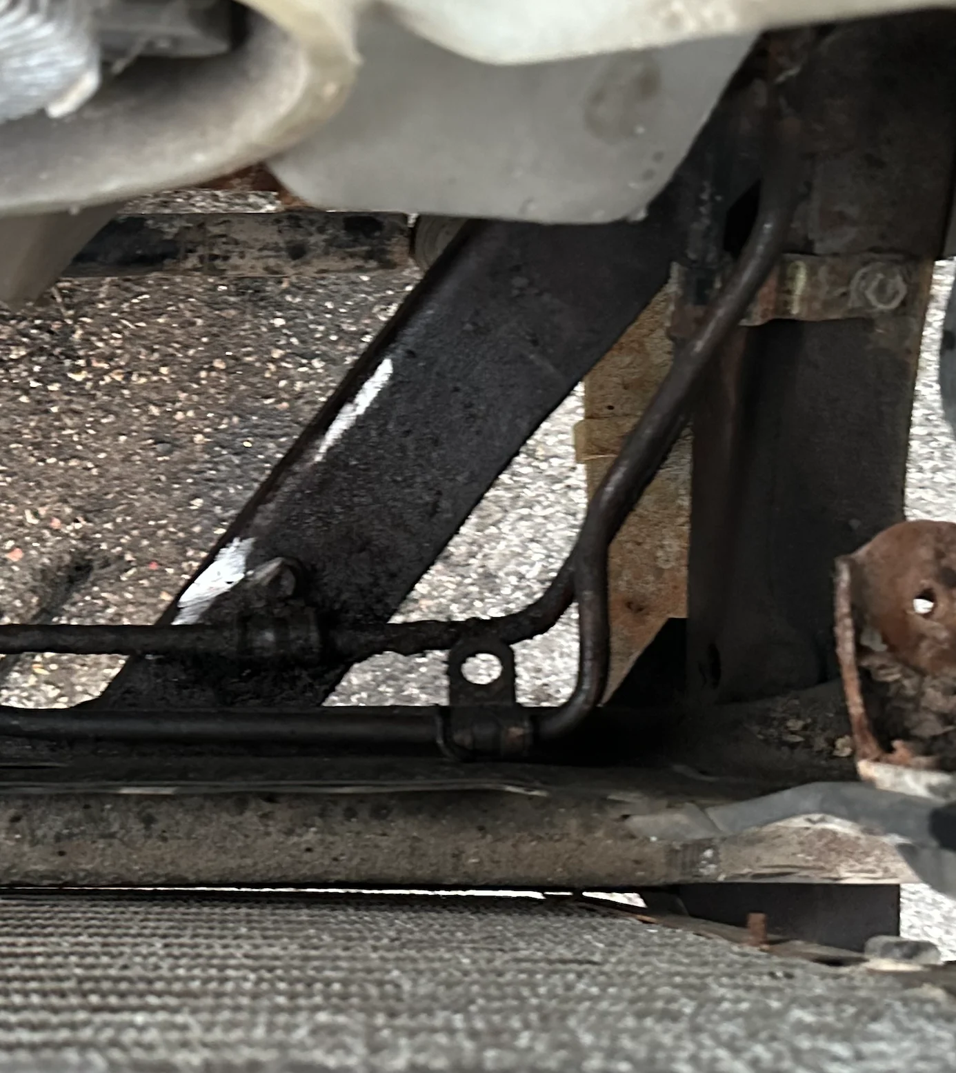

Radiator out. High pressure hose still hidden under. Question is do I have to take out the low pressure hose to get the HP hose out. As you may notice the bolt holding down the LP hose has stripped
I was able to get to the HP clamp bolts and could sneak the HP hose out from underneath.
just to get the PS line out.
New HP line in.
able to fit the bolt through the front under front cross member with bumper off.
Well, put the ATF in to test the HP line... seemed to work...
But of course now the LP line leaks. :frown:
