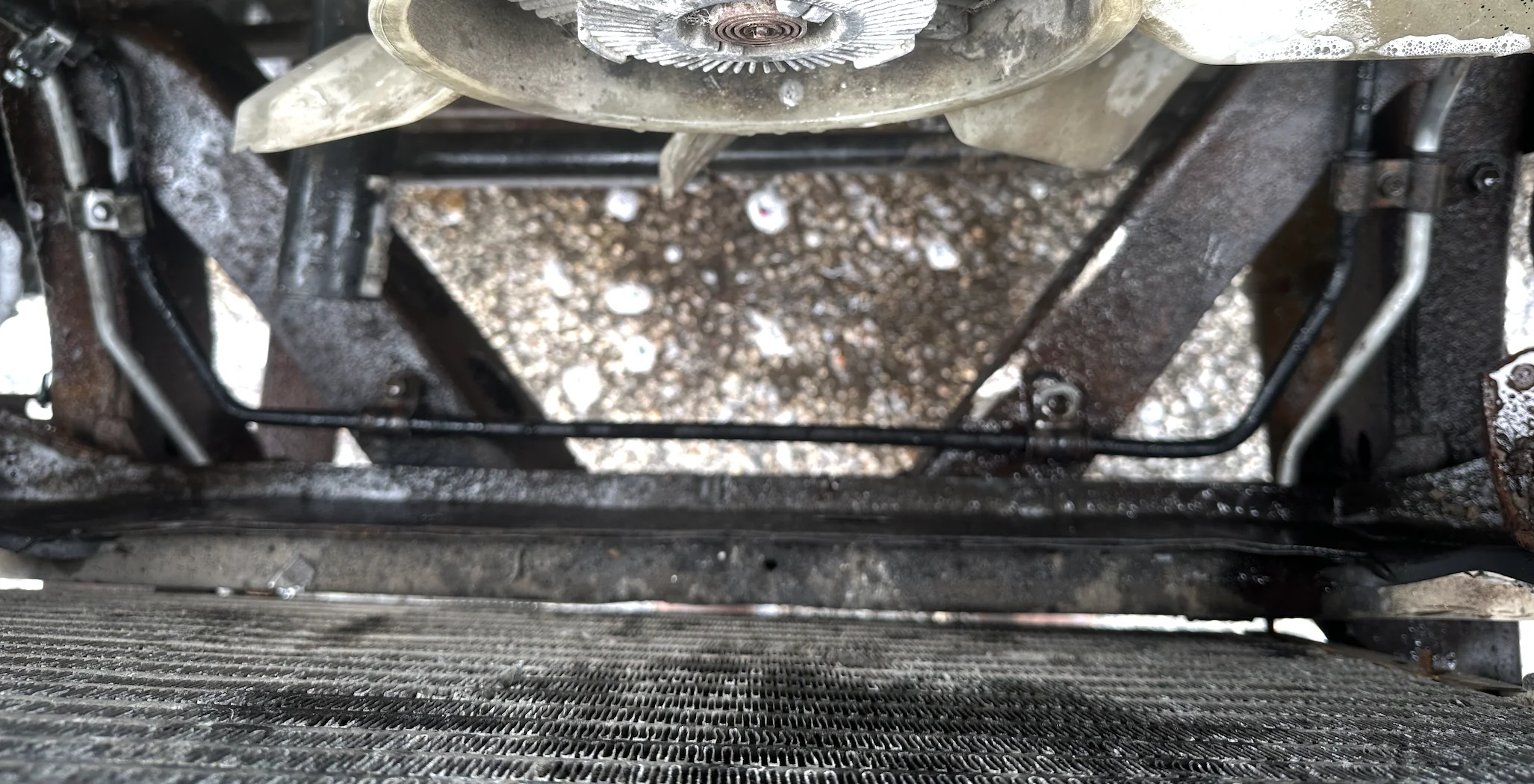

LP power steering line installed !!!

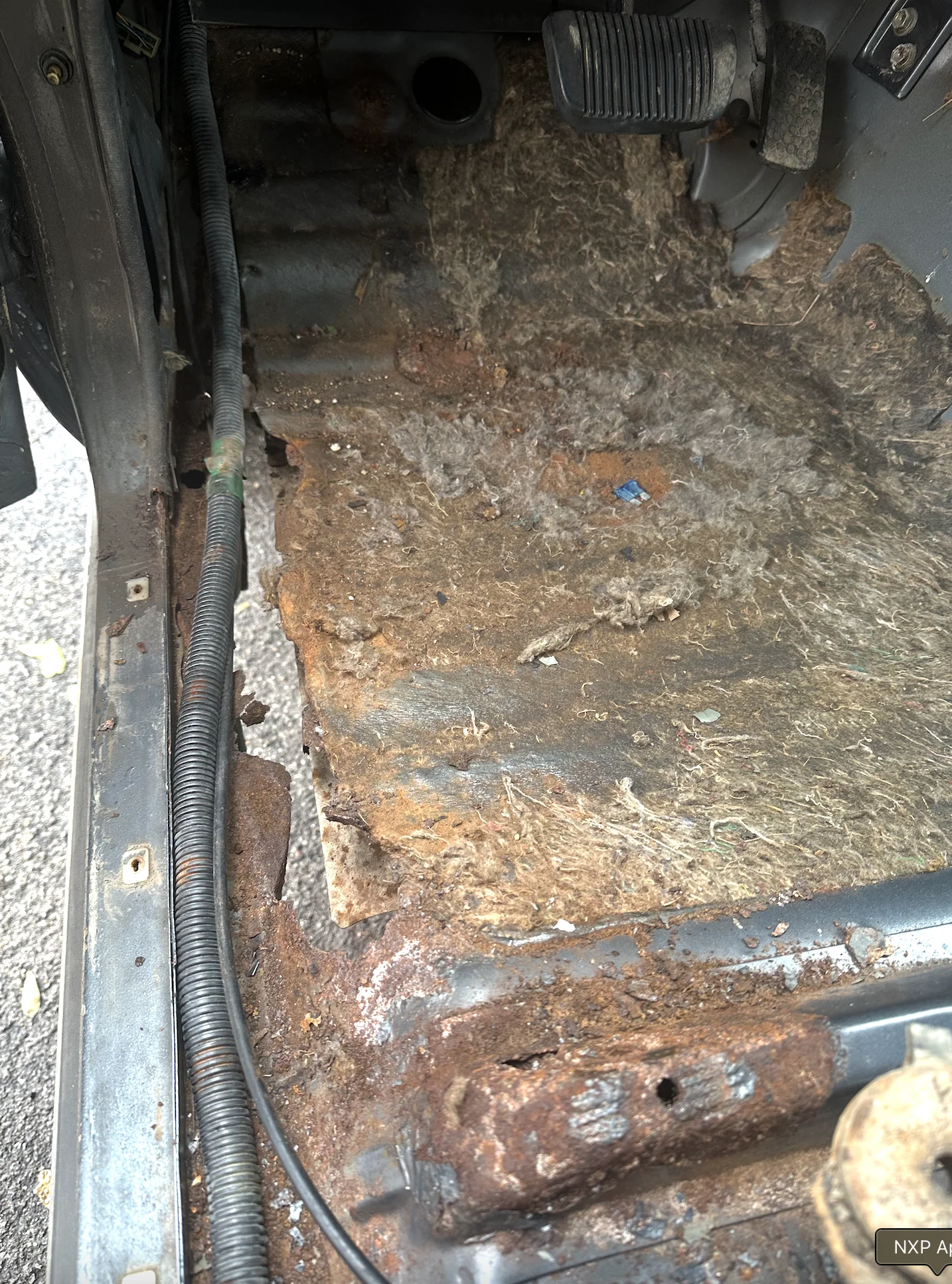

preview of what is to come... floor board work. The deeper I go the more I'm SMHing. 🤦‍♂️

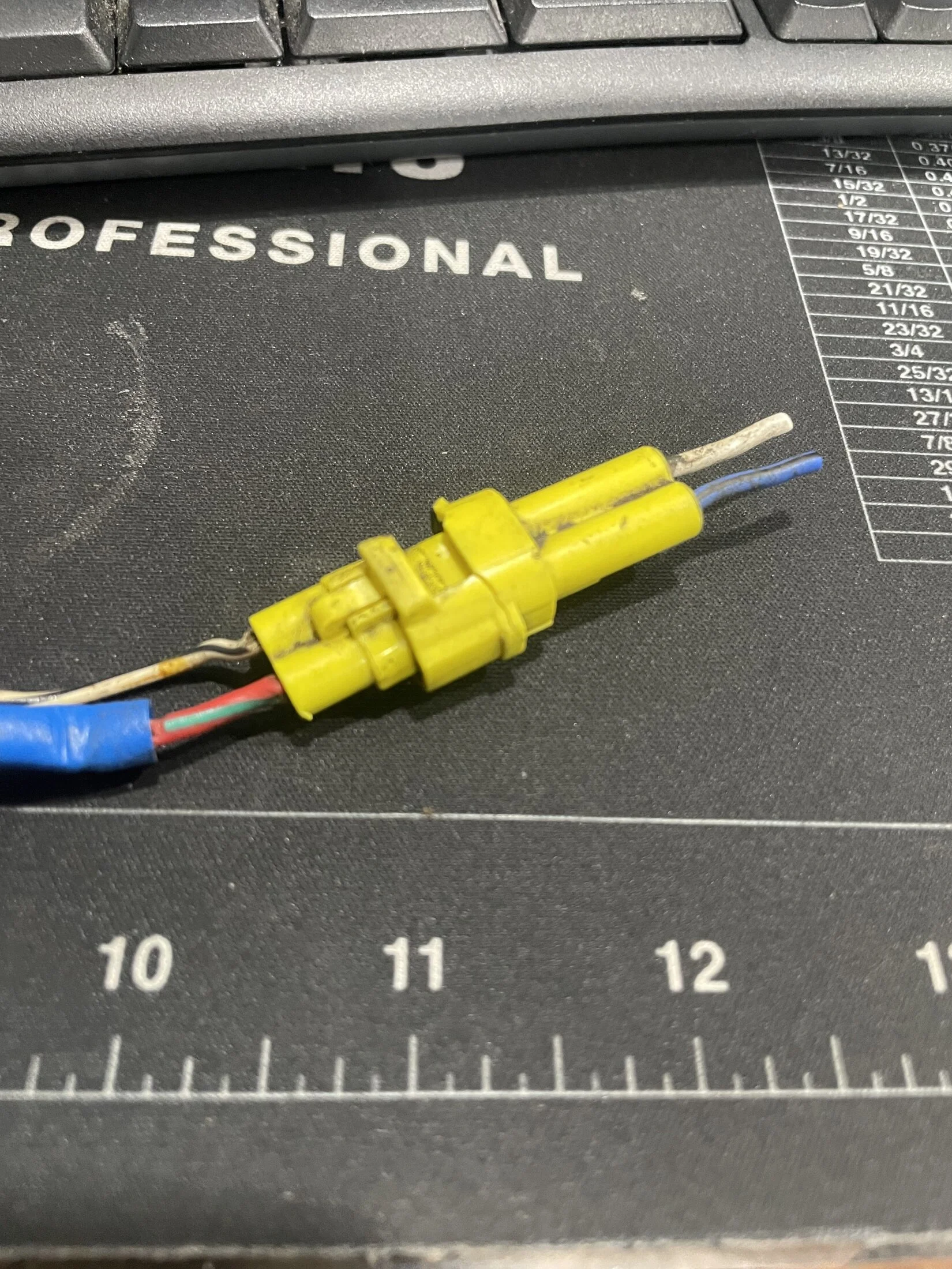

Next comes the fuel tank... seems like the fuel pump isn't working after taking the back cover off and applying 12V to the leads... can't hear anything. Connectivity between the leads is somewhat there...100 Ohms... don't know if that's right. I'm just guessing it's seized up.
Are you sure you were putting power to the pump and not the level sender? This is what the fuel pump connector looks like, I don't think you can access it without dropping the tank a few inches.
Yellow connector, red/green (+) and white/black (-) from the vehicle, blue/black (+) and white/black (-) going into the tank.

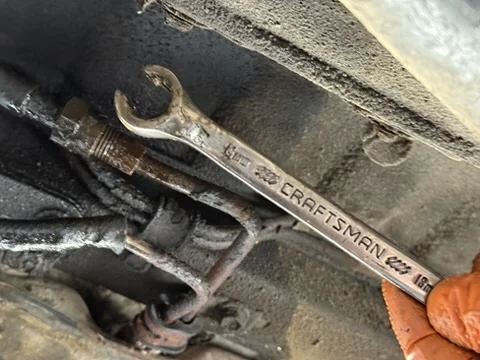

oh the dreaded fuel lines in an old truck.
Never buy these flare nut wrenches from craftsman... pretty quickly started slipping on fuel line 14mm. had to use my normal wrenches which eventually worked fine.

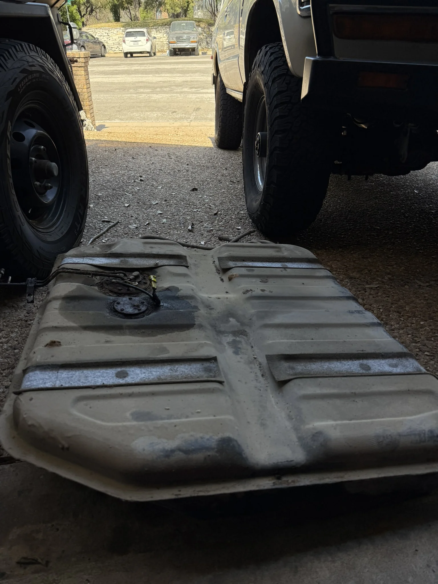

tank out...

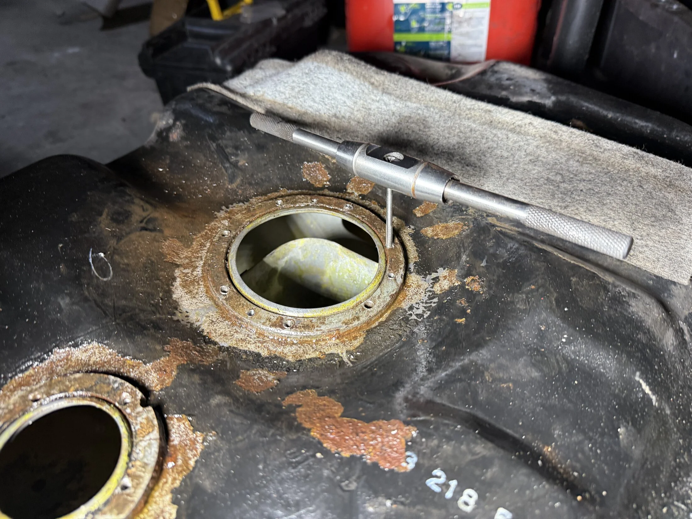

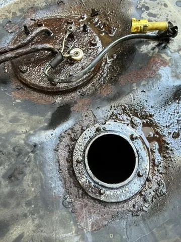

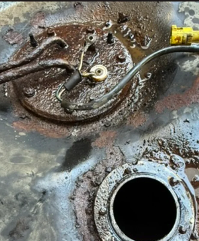

After spraying it with deep creep. was not able to get the screws out of the sender, had to chop them off. Any one know if this ring with the notch can come out or do I have to extact the screws the old s***ty way?
broken bolt count: 8

the ring is part of the tank assembly. so yes you would need to extract those screws.
I'm pretty sure nipples are my specialty... I got this.... gonna try to weld it????? JB?
Repairing the threads after drilling out the broken bolts... all of them broke. Let's hope this works

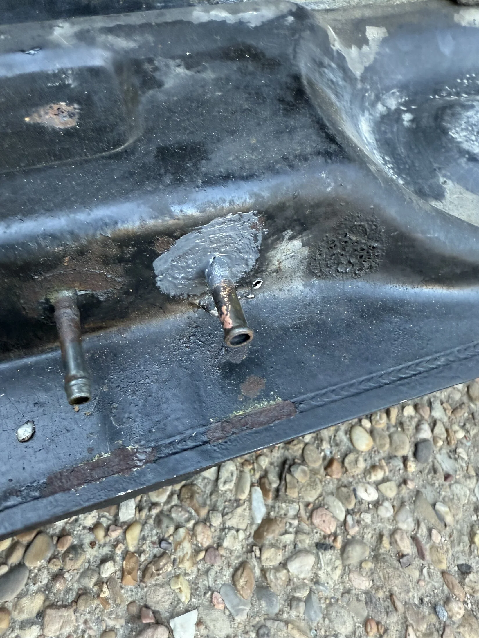

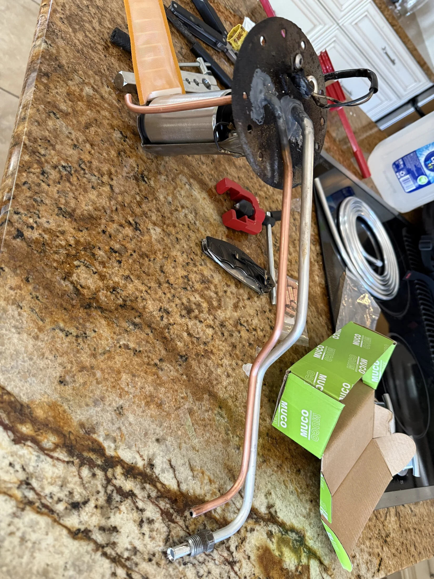

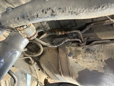

Both the high pressure and return fuel lines had holes in them

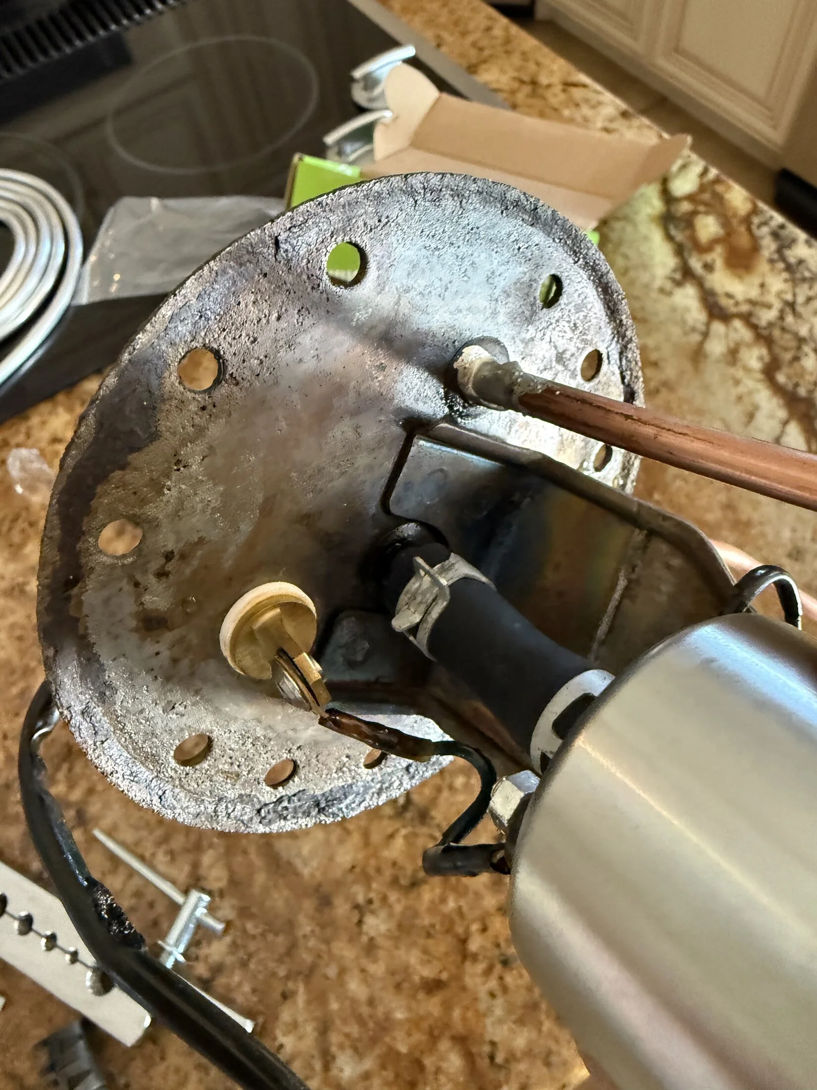

soldered in some lines... used copper for the return and then found out Aluminum was recommended for high pressure. wasn't sure I used the right solder to get aluminum to stick to steel so I ended up going on top with JD Weld.

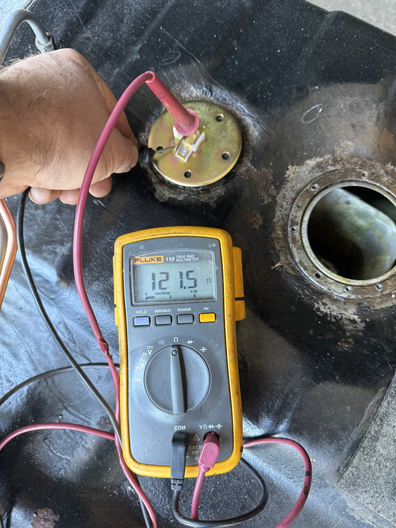

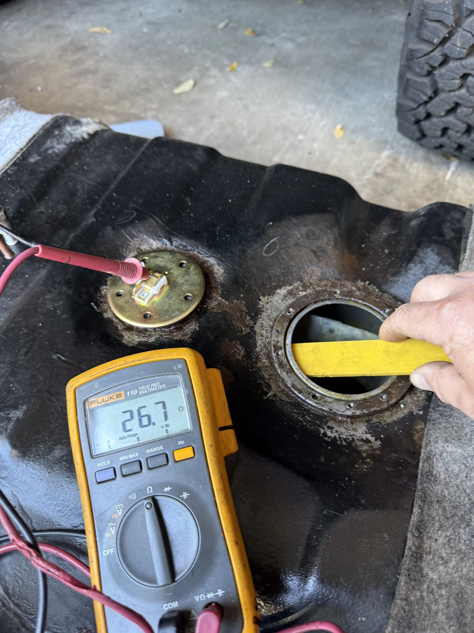

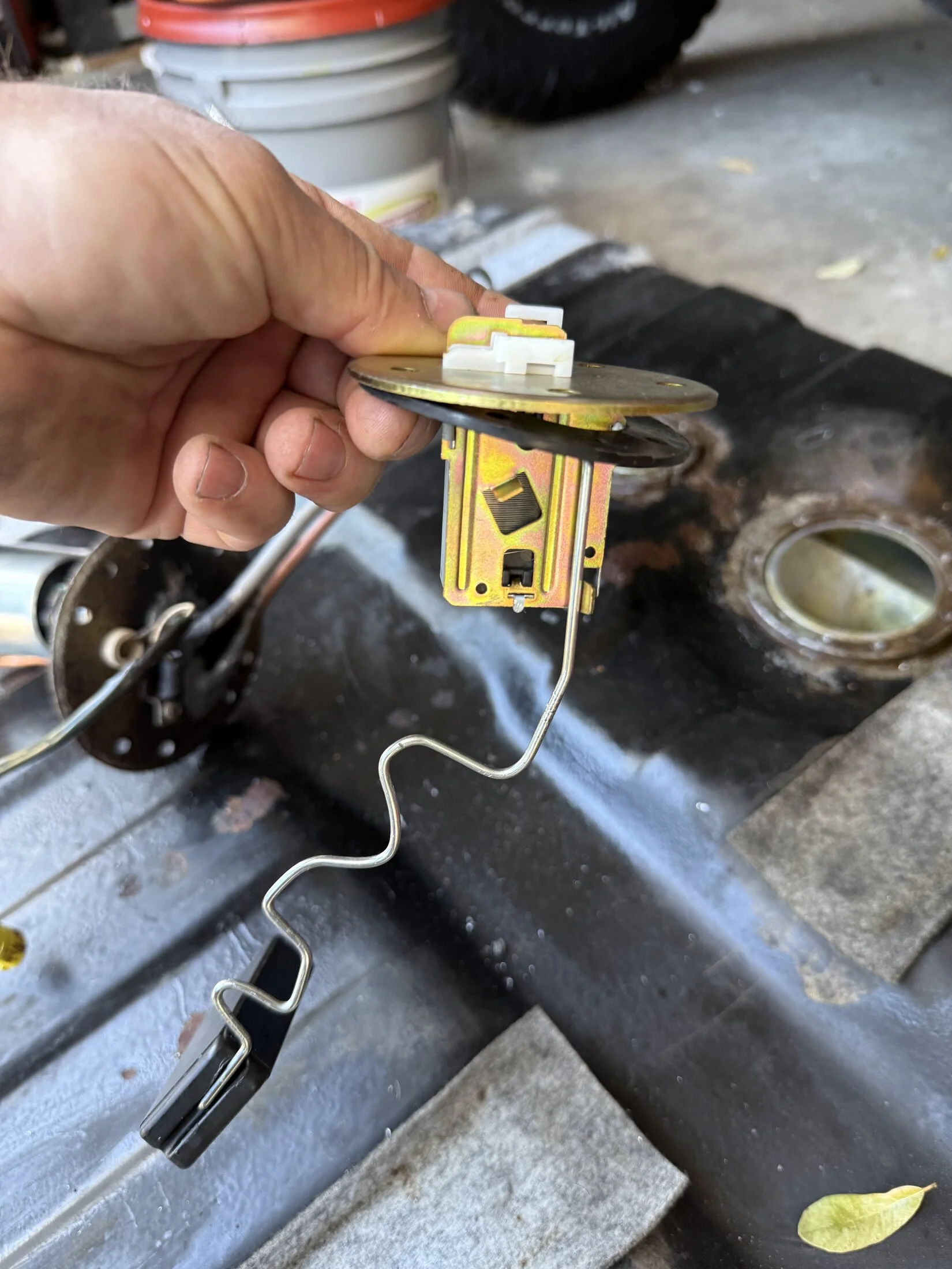

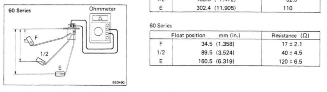

Fuel Sender I bought on the cheap was too long... of course. Went ahead and did a snake move to shorten it
made sure the resistance lined up with the floater up and down.

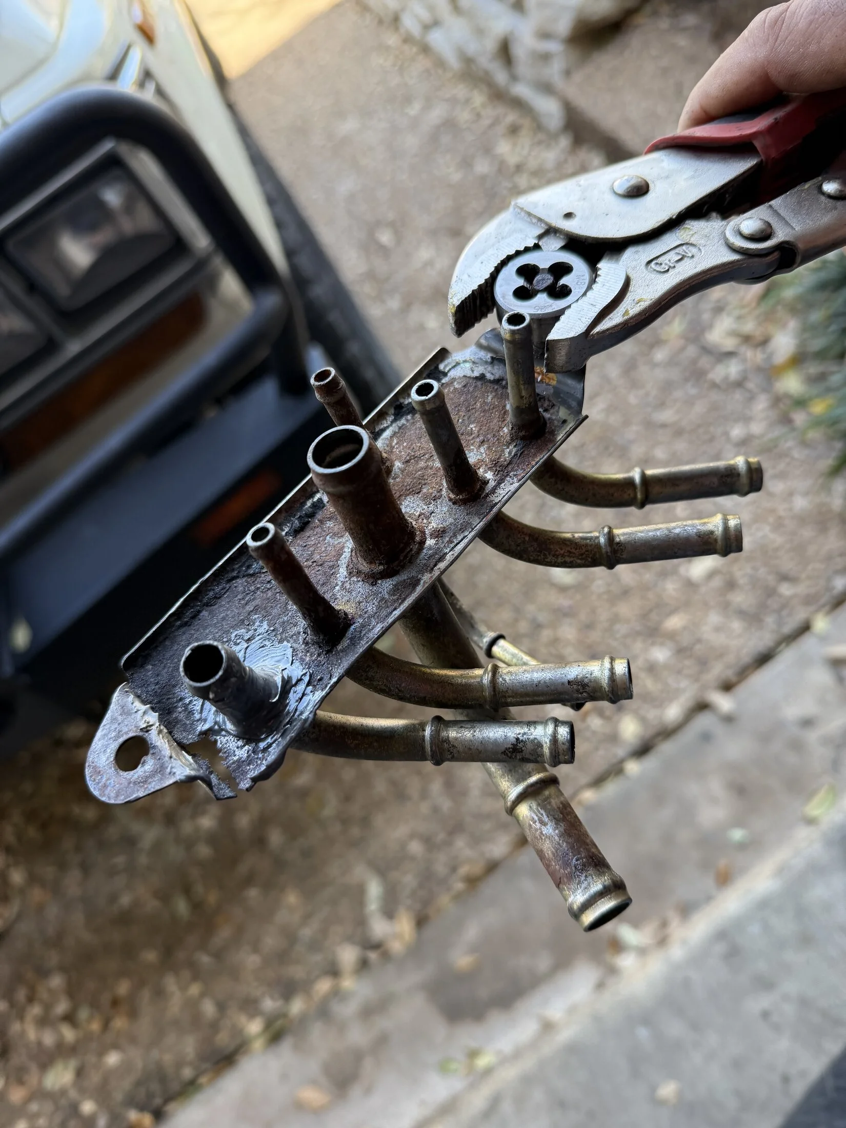

another nipple on the fuel liquid vapor coupling thingimajig needed repairing... and the bolts too.
That’s exactly what ours looked like after 15 years in a field.
