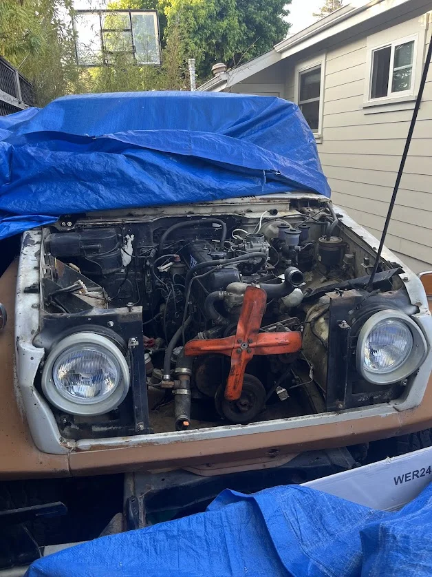

Not yet. I am waiting until I take it out as it would be easier. The rear main may be the issue and cant get that cap off that w/o pulling the motor so it seemed like a good idea to wait unitl I had the other engine and picker in hand before moving fwd. hoping in the next few weeks I'll have it. I might clean and paint the engine bay while I have access. As we know, one project almost always leads to 1-5 others 😏
You know what they say,
I am sure I'll have plenty of questions once I start. Once I have everything removed and ready to install, I am thinking removing the driveshaft and have a trans support so that lining up the splne will be less frustrating than it has to be. There are usually tricks to do this, just haven't read up on doing this w/ a 55.

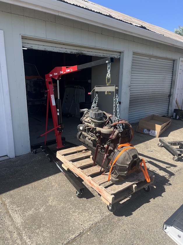

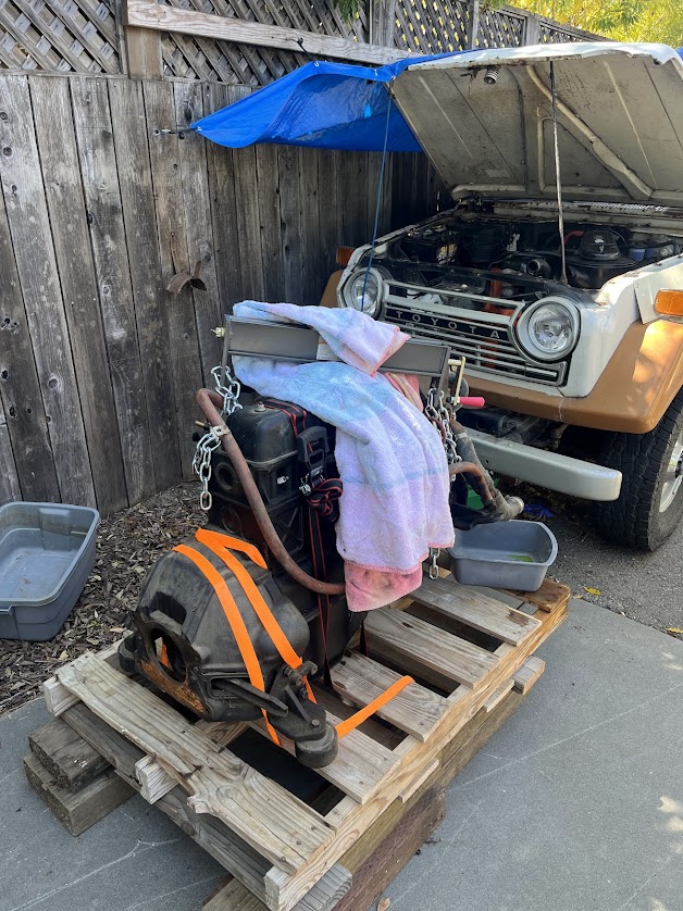

Thinking about finaly swapping engines starting this weekend. I'll have better data on the engine I'll be swapping soon and will know what gaskets, clutch, bearings etc have been recently changed but aside from the usual stuff to consider when doing a f emgine swap, should I consider new motor mount bumpers? My current ones are looking a bit crusty.. Also, is there a trick(s) to aligning the input spline into the motor when I install ?
I have a trans lift to move the trans or take the weight off of it but, for those who have done this project before, any input would be helpful/appreciated .
TIA
Get 2 long bolts for the bellhousing to trans. Cut the heads off, use a band saw to make a slot in each for a flathead screwdriver. Put them in the top 2 holes of the bellhousing to use as guide pins for aligning the trans to the bellhousing. This will line up the input shaft perfectly to the pilot bearing. You may have to turn the transfercase output to spin the trans slightly (leave in gear) to align the splines. Put in the bottom 2 trans bolts, unscrew your guide pins. Install top 2 trans bolts. Have a beer 🐖 🍻
