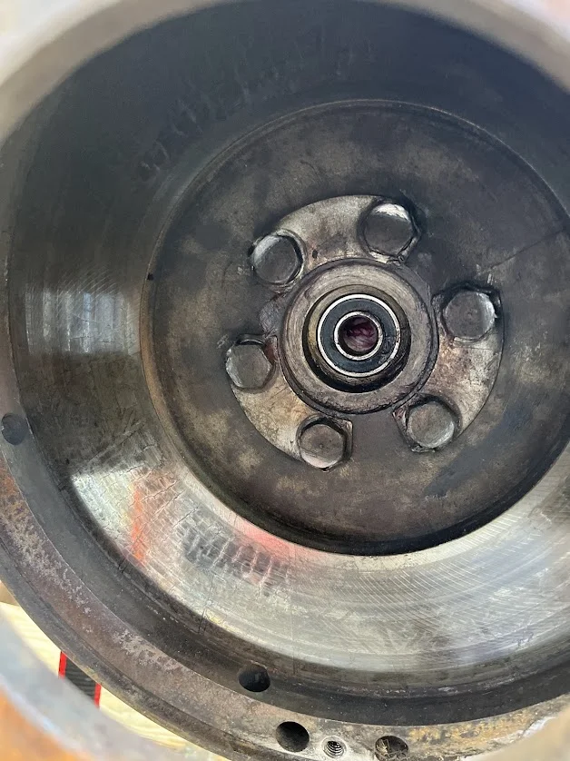

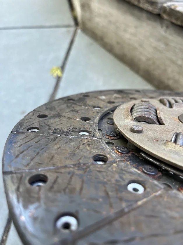

thought I would dig a bit further & scope out the clutch parts.. Glad I did.
clutch looks like plenty of life left, pressure plate, pilot bearing look ok but flywheel need resurfacing. Might have to check the one on my old motor before having this one resurfaced. Gotta keep it under the 5K budget right :)
Since as often the case the Sty wonders aimlessly off topic at the slightest talk of Riboflavin or other such nonsense, I'll close the loop on this.
You need it resurfaced. Don't take it to the chain shops listed above. They will use a brake lathe and it won't be done properly, you need it actually machined properly from a machine shop. There is a step in the flywheel and that spacing needs to be machined to factory specs for proper clutch engagement. Find an old school machine shop if you can. Mine does it while I wait and depending on his mood that day normally costs me $40-100 cash.
