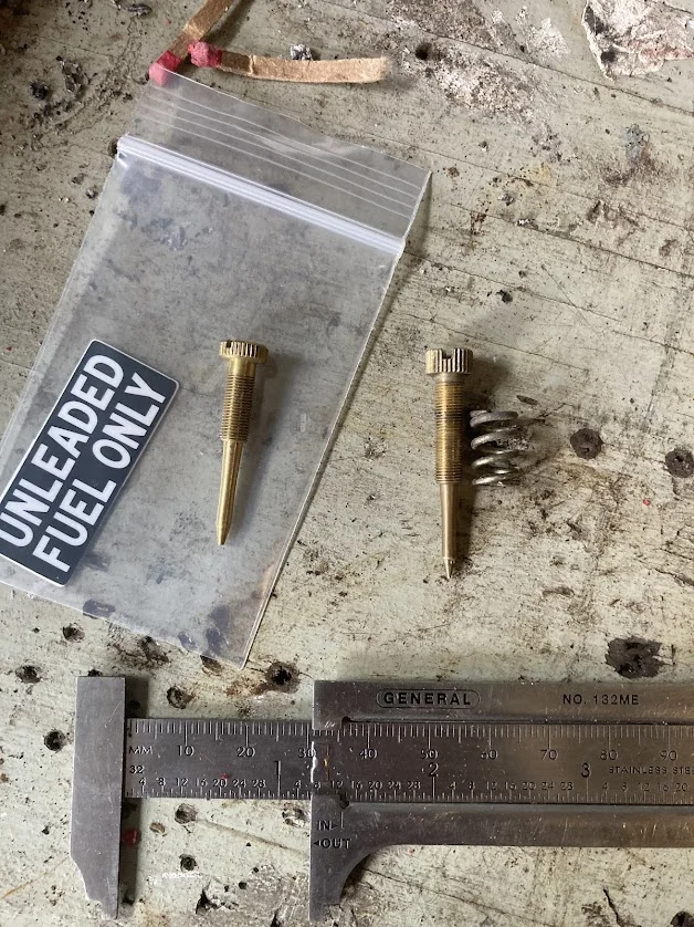

Going ok so far. The mix screw does cut the engine off when I turn it close to all the way in. So now the idle port is working.

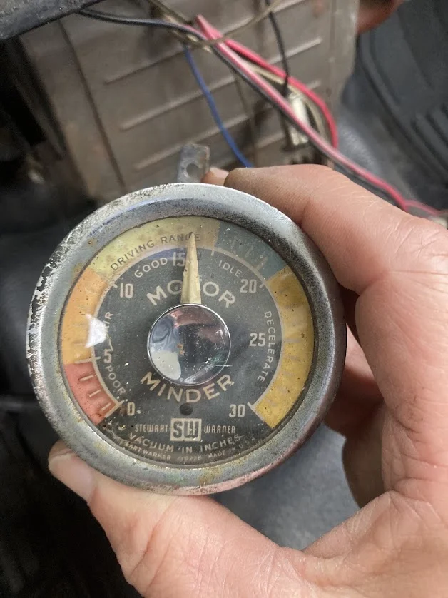

vac at 15 + which isnt great but seems to idle well. remembering I purchased a new mix screw only to find it 4mm shorter so not sure if there are enough threads to make it work. I was only 3 turns out from the bottom after finding max idle.
Not satisfied with that vac reading so I did some additional digging on mud. Now that the manifold leak is solved, there may be another small leak at either the booster or maybe even the throttle shaft bushings. I found a thread where someone did a DIY throttle bushing replacement. Fingers crossed its an easier fix than that. Its amazing the number of ppl here on MUD that have groveled through this same issue over the years.. Sure helps us newbies :)
Identified the leak which seems to be near the insulator, all the other hoses including the one for the brake booster are fine and no leaks present.

It is a significant enough leak to prevent it from idling properly as the vac is just low enough that it sometimes dies when coming to s stop.
I suppose I could advance timing or increase idle speed a tad but I was hoping to get to the bottom of this prob.
