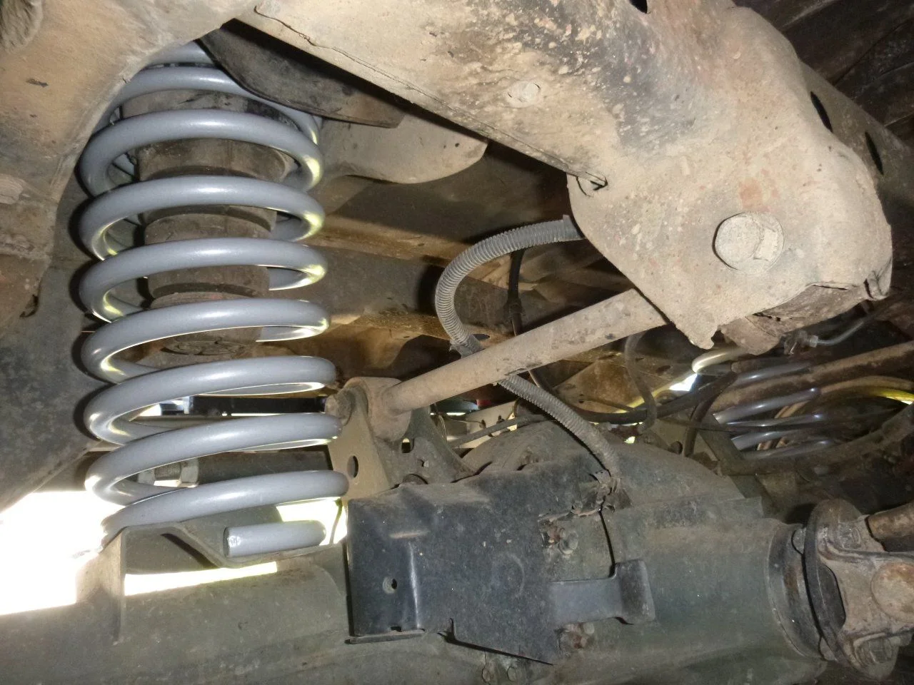

got my rears, waiting for the front to come in off the boat......
