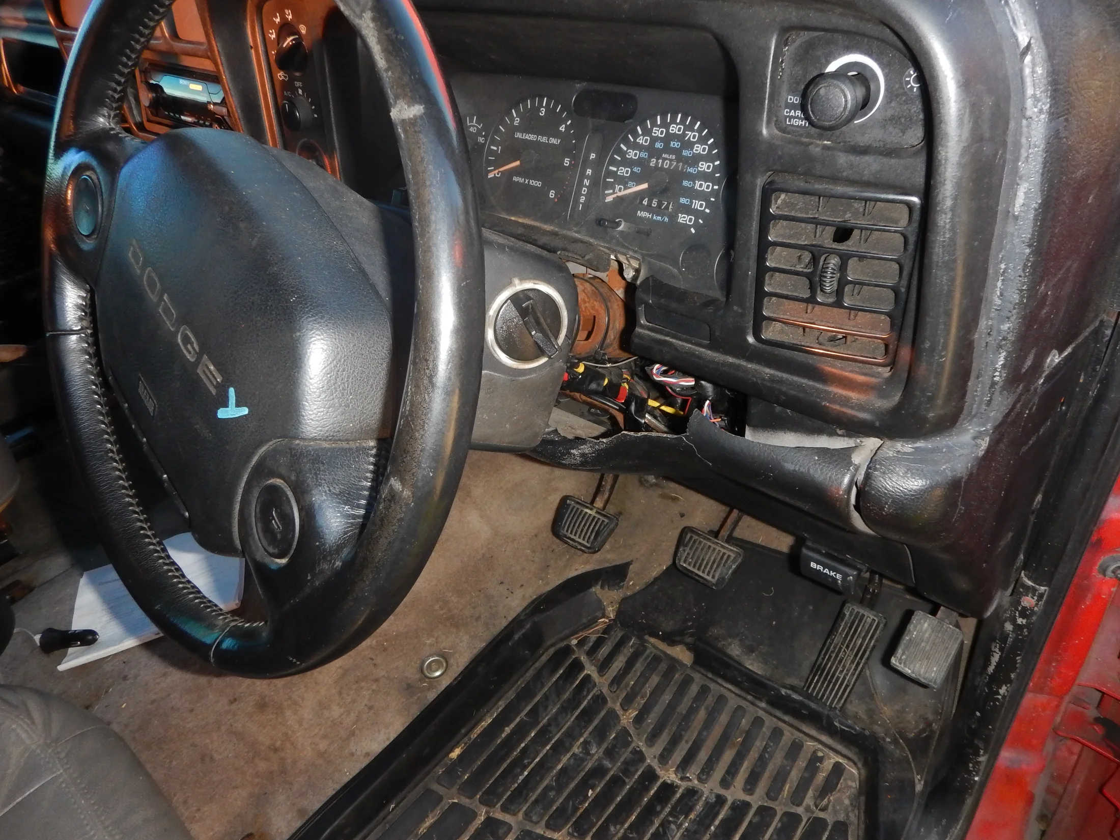

Cool. Happen to have pics of the dash? I can't imagine what they do, but it the dash isn't crumbling into potato chips then it means they did a better job than factory.
Yea nah, its a bit rough. The photos don't really show all the black silicon.
The trucks been messed with a fair bit, was originally a petrol and apparently went through 3 of the dodge v8s before they put the cummins in it. And this it the second cummins its had, the first one is in a land cruiser in the south island somewhere apparently.
Cheers
Ha! Impressive, the replica RHD dash is holding up good. That kick panel below the steering wheel is crumbling because is probably the LHD part repurposed.

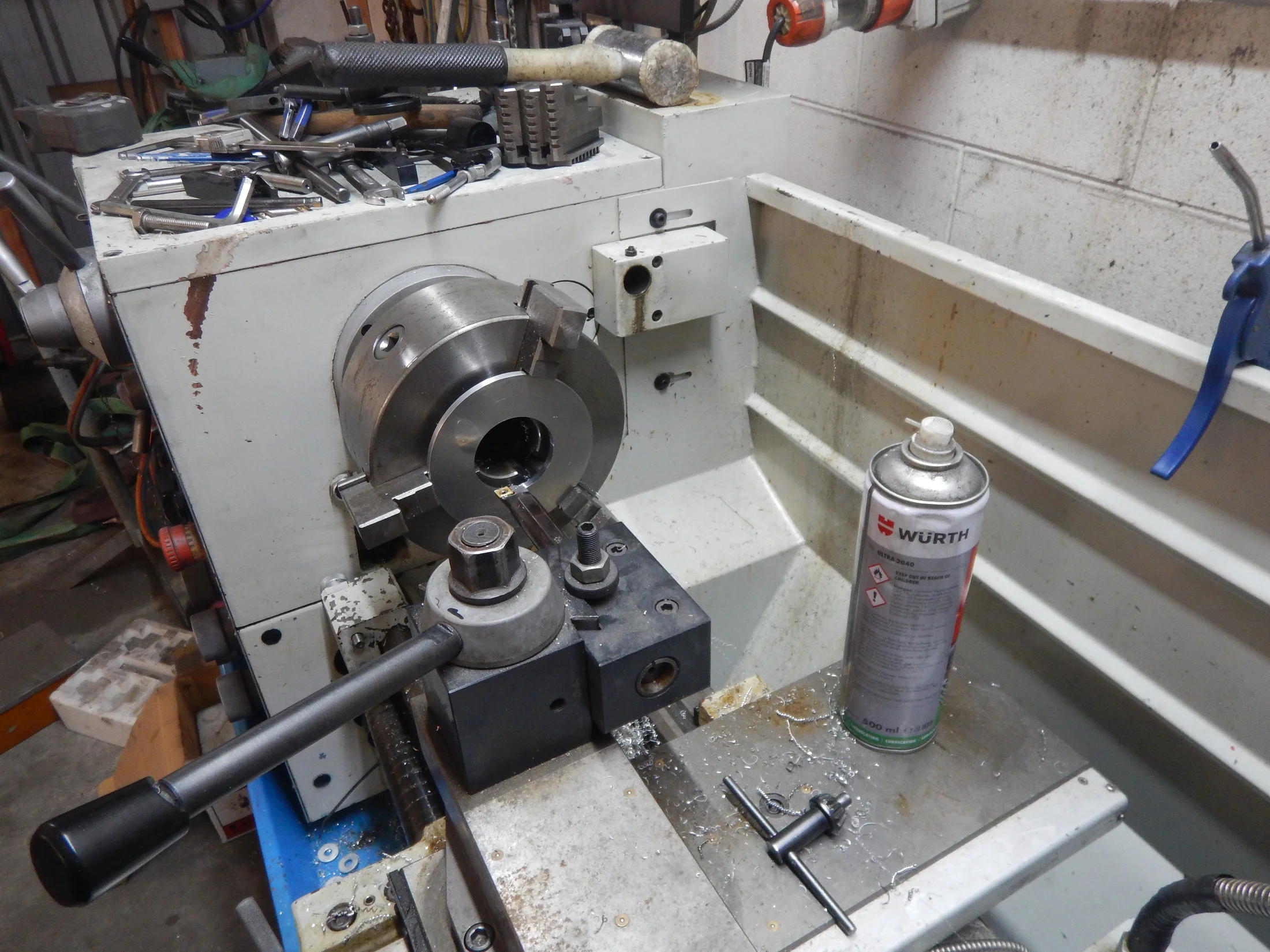

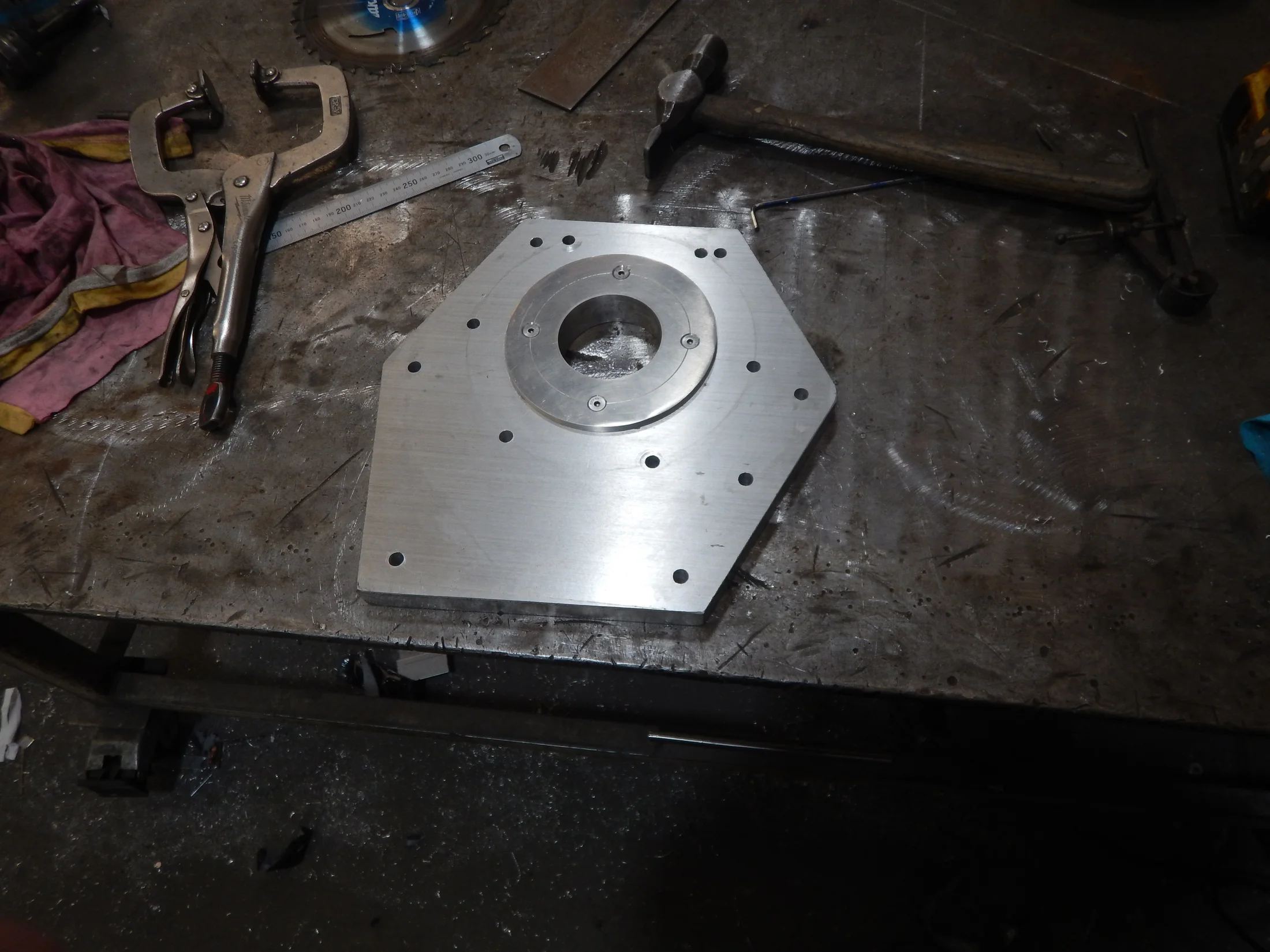

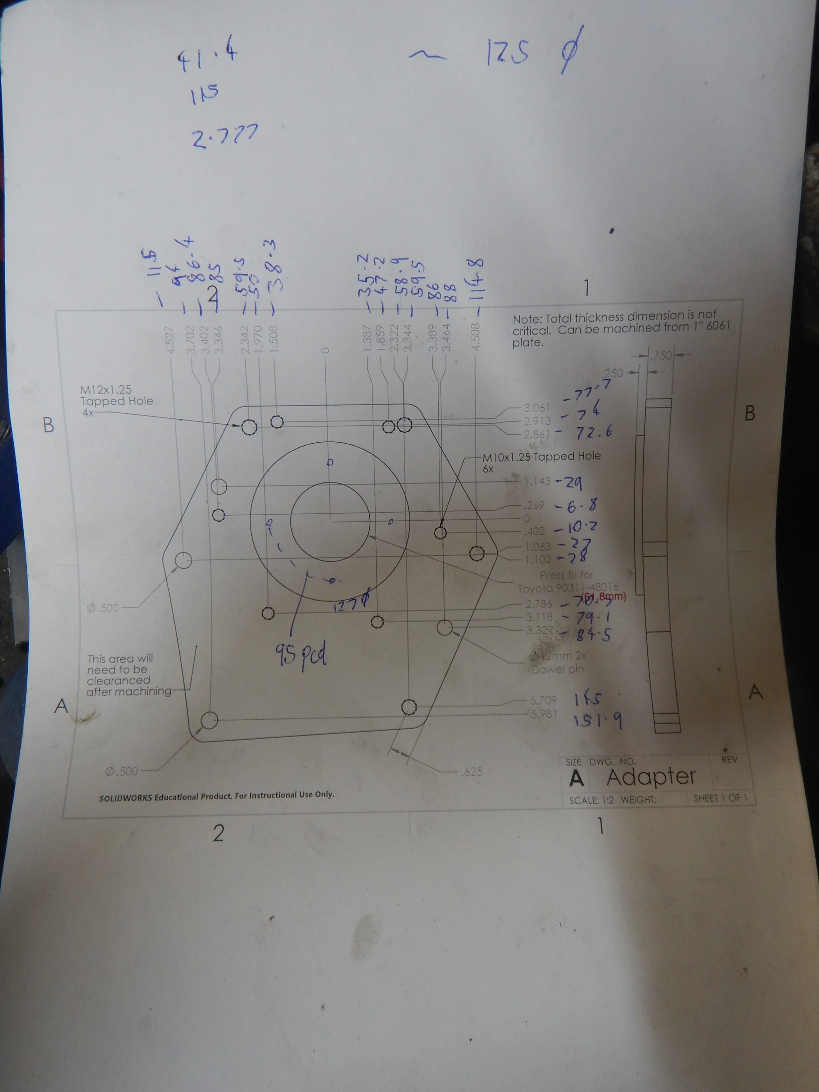

I'm too tight to buy a NV4500 to HF2A adaptor kit, luckily some legend posted plans on how its done on the internet.
The adaptor plates you buy have a 1/4" step machined in them to align with the dodge gear box, I haven't got the gear to do that, but I hate paying people to do things I could do my self so I made it bolt on. This obviously isn't as strong but once the gear box and transfer case are bolted together it will never be a problem.
I got a wicked deal on a decent off cut of 20mm aluminum, Marked out all the holes and roughly cut it out with a skilly with an ally blade, leaving heaps of extra material on
Once I have a transfer case on the bench in fount of me Ill mock up the plate and mark out all the extra material that needs taking off.

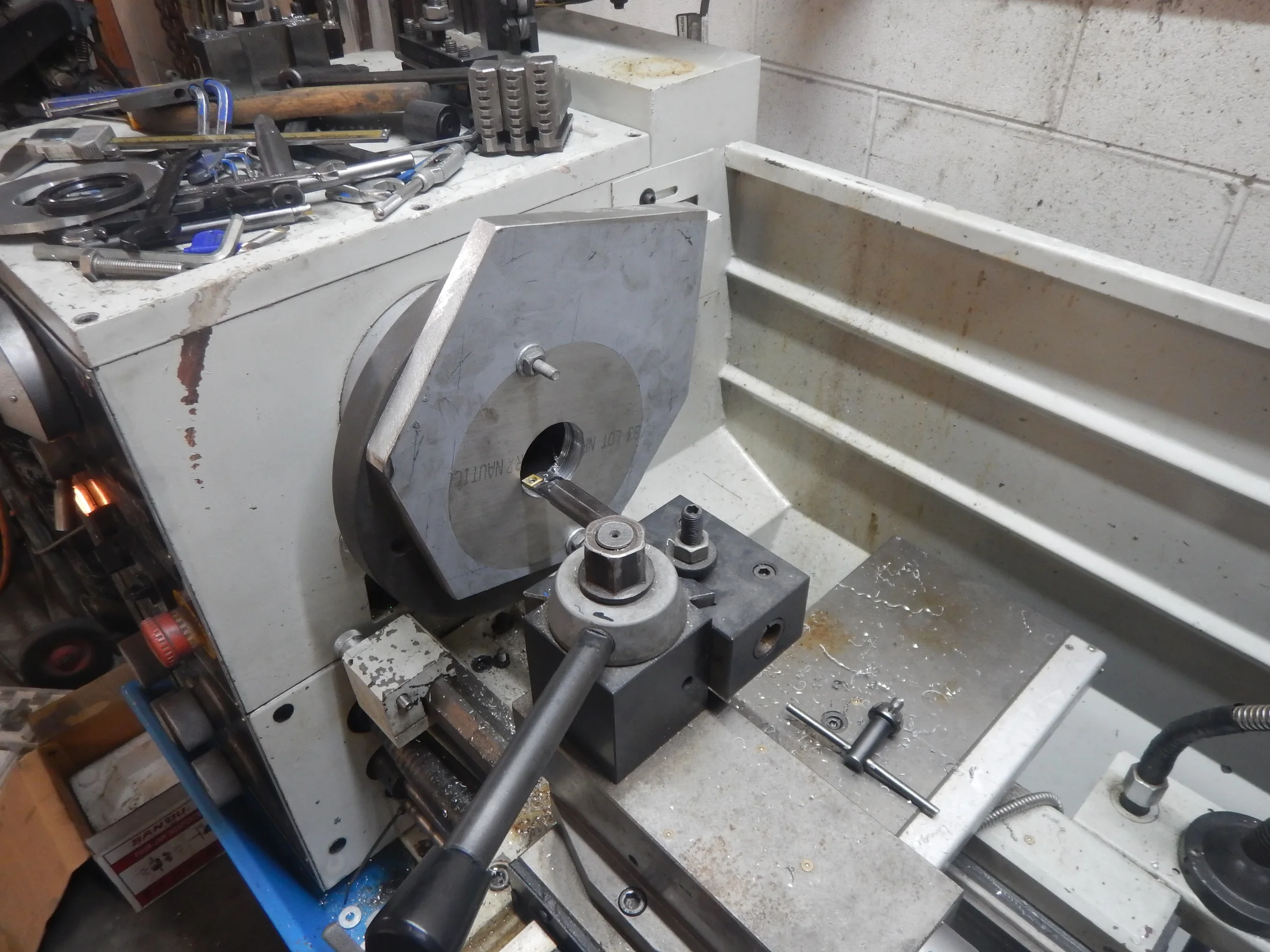

Machining the hole to make a press fit for the seal.
