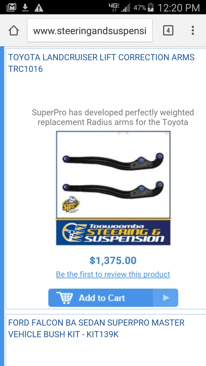

2 degree and washer mod.
But some new material bushes we are trialing right now with corrected arms too.
3 deg caster reading at 3" lift, new material bushes that allow 19 degree flex angle on the bush, and offset rear bush to move diff forward a tad if required.
Wow, well there you go.
Do I see an outside skin around the whole arm plus the aft axle bushing relocated up?
This would help with the the tie rod bind issues, but what about the control arm to axle bracket bind problems when dropping down with the longer shocks?
I'm in the process of trying to narrow my arms... making the arms wider will make the problem worse.
did you see the bit about the 19 degree bush flex in these ?
They are designed to give 3 deg caster reading at 3" lift, so bush has to be relocated to rotate diff to do this ;)
19° deflection sounds great., but what is stock?
Stock bushings flex best but don't hold up.
So the real question is... is the 19° poly bushings flex as good as stock but last longer?
Also, will you post pics of a stock arm next to this modified arm & on a 80?
It also looks like the aft of the arm is straiter than stock.
OEM Contol arm bushings don't hold up? This is the first I've heard of this.
That has got to be a whole new arm and not a modified factory arm. It just has a similar cross-sectional shape.

And stock bushing is nowhere near 19 degree's.
More pics to come on the arms then, when I get a chance.
