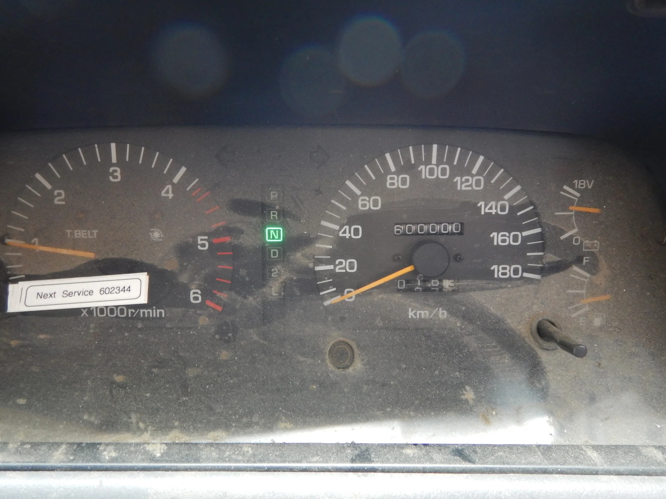

I've had my 80 series for a few years now. I've put almost 120 thousand km's on it, its up to 612000kms at the moment.
Its done me well, Mechanically its faultless. But I want more horse power.

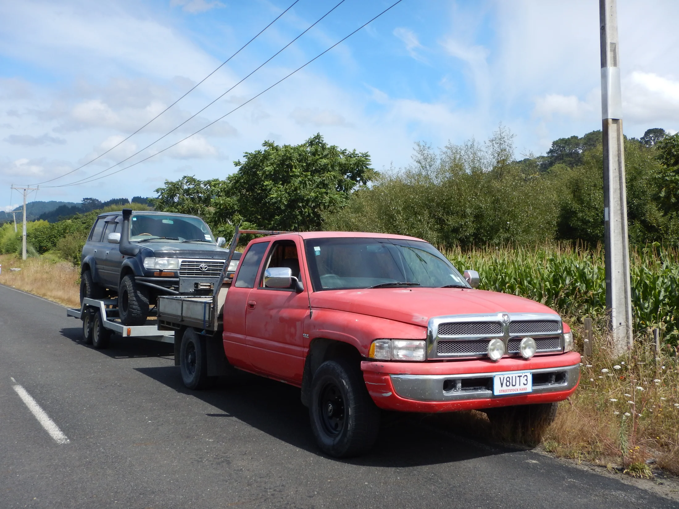

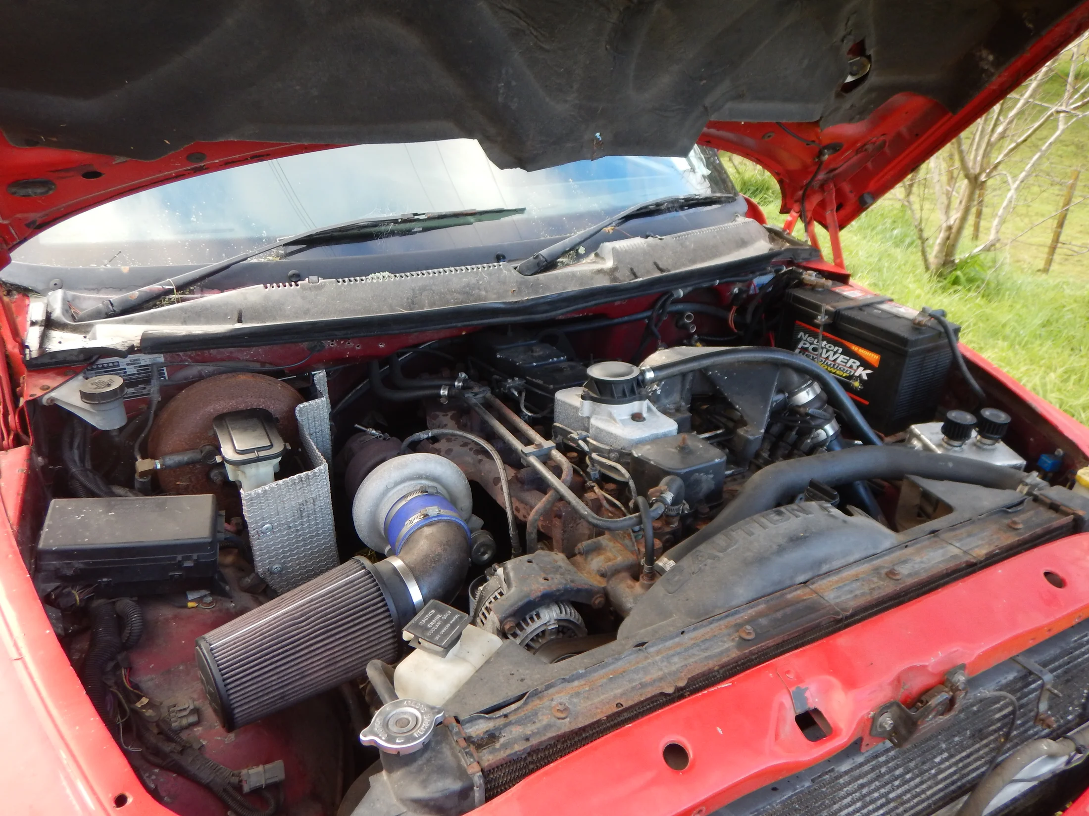

I bought the Dodge about 6 months ago as an engine donor, But had second thoughts.
But after I priced up importing a used 6BT Cummins and a used NV4500 I realised its cheaper to sacrifice the Dodge. But id like to replace the engine and trans with some thing and keep it on the road. It would be a bit of a shame to part out a Dodge, given how uncommon they are in New Zealand.
I'm still collecting and hoarding parts getting ready for the conversion, But I'm committed now and I hate it when projects drag on longer than they should.

Bloody oath the 1HD-FT is an amazing engine, my one has done 612600km and hasn't missed a beat and will have no worries doing another 600 thousand k's. It will go to a good home when I'm done with it.
In the states the mentality is completely different. We often refer to the dodges as fancy engine creates because, aside from the manual tranny, everything surrounding the engine is junk. The only difference seems to be that it's a rarity for you, whereas here they're a dime a dozen all with disintegrated dashes
Question. Was that Ram built in the states as a RHD, or was it built a LHD and converted in NZ? The brake booster shield doesn't look OEM.
I looked up the rego, supposedly it spent its first 2 years in the USA before it was imported here in 98'. so it would have been originally LHD.
Cool. Happen to have pics of the dash? I can't imagine what they do, but it the dash isn't crumbling into potato chips then it means they did a better job than factory.
