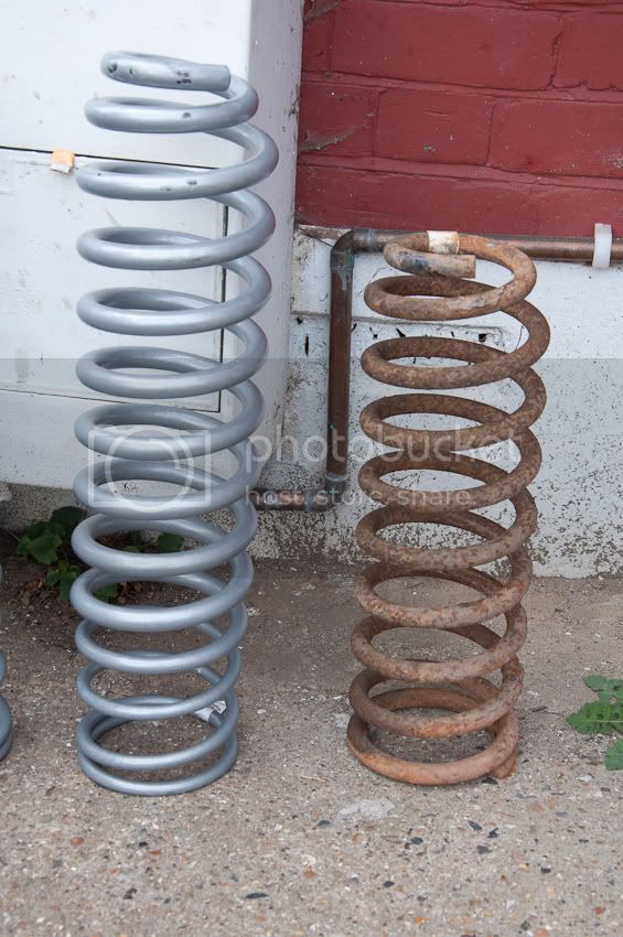

Here is a pic from @Thomo with a front Slinky vs. OME 850J
So 70mm is about 2.75". Are we to assume this is over stock height or over saggy 200k+ mile height?

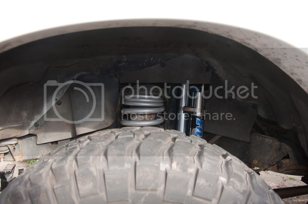

Just measured my rig. Stats in signature. Measuring as pictured above: DS F & R is 31.5" (800mm) PS F & R is 31" (787.4mm). The average on that is .25" (6.5mm).
Having said that these would give me a ~+ .5-1" front & rear.
