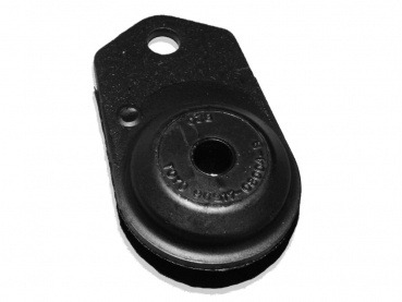

Going to replace the muffler and tailpipe on the truck and was looking for an equivalent to the old tailpipe hanger. I saved my hold hanger that had a rusted out piece of tailpipe attached to it and it looked similar to this. I think the bracket changed around 67 to a rectangular "cushion" similar to what is on SOR's website. According to the internet this is toyo 90917-08004. Most websites show the part number as only the cushion but a few show a drawing of something similar to this model which i found on a german website. I think this would work on our early trucks. I wonder what the current part actually looks like? Ideas? @Indygbd can you get access to actual parts or drawings to compare?
I recently bought some of these from Toyota (my local dealer). I used the part number from a mid-late 70’s BJ40. I have some original NOS ones from the 60’s and the look the same. Remind me to take pics and find the part number.
Yep the ones I looked at we're for 1970's bj40/42. Sounds like a score. Funny how NLA sometimes just means finding a new part number for a different vehicle.
Reminder for @Splangy . Any help is appreciated
