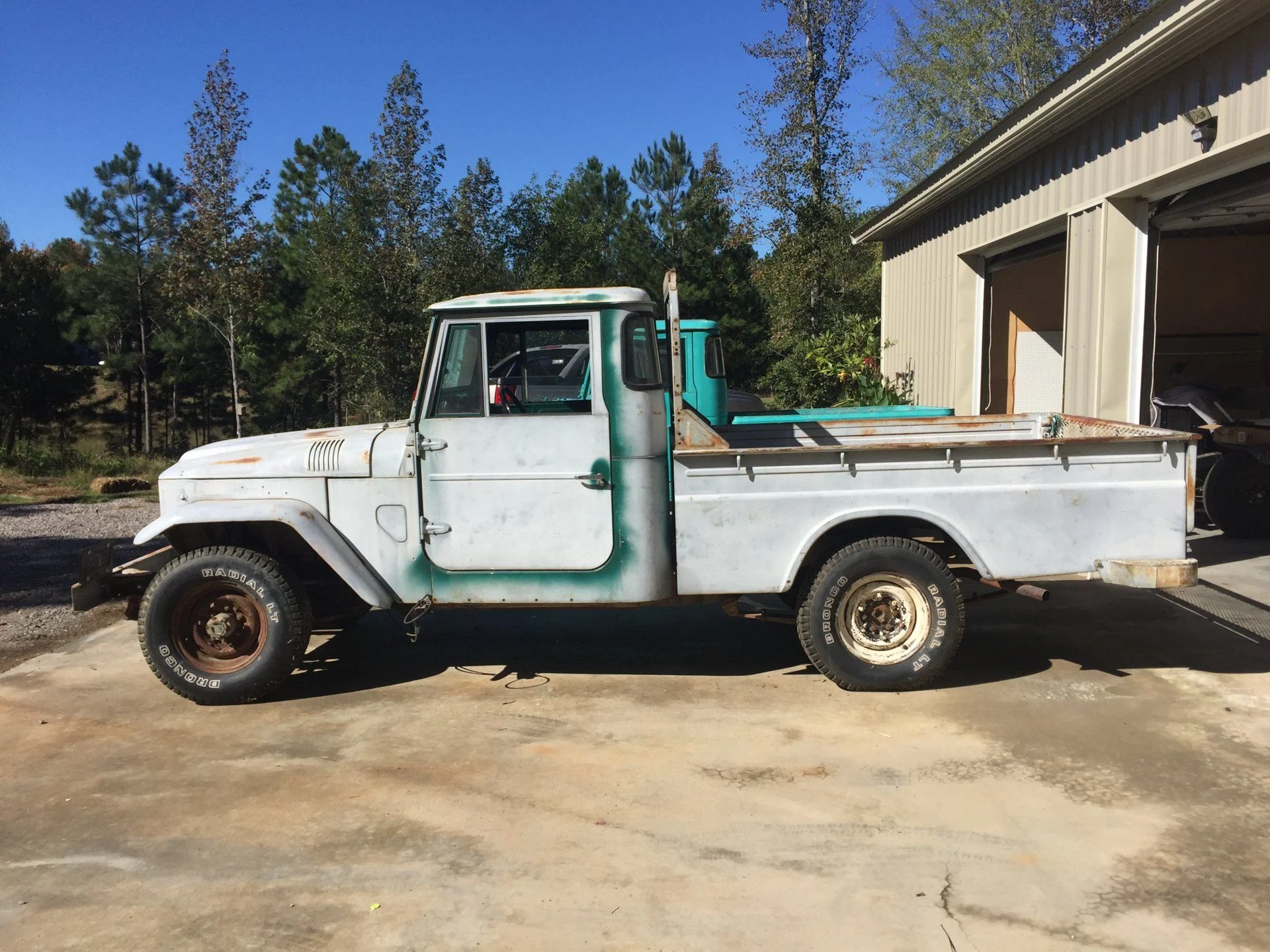

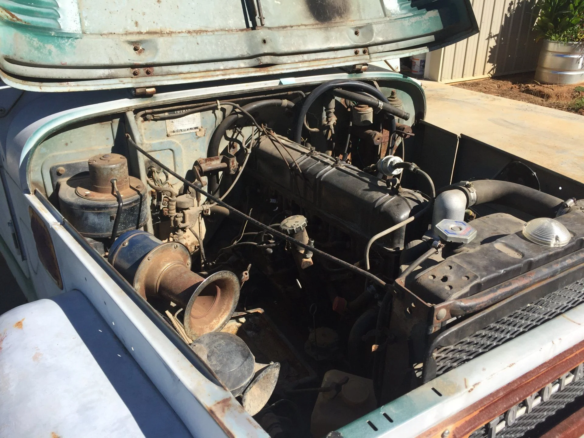

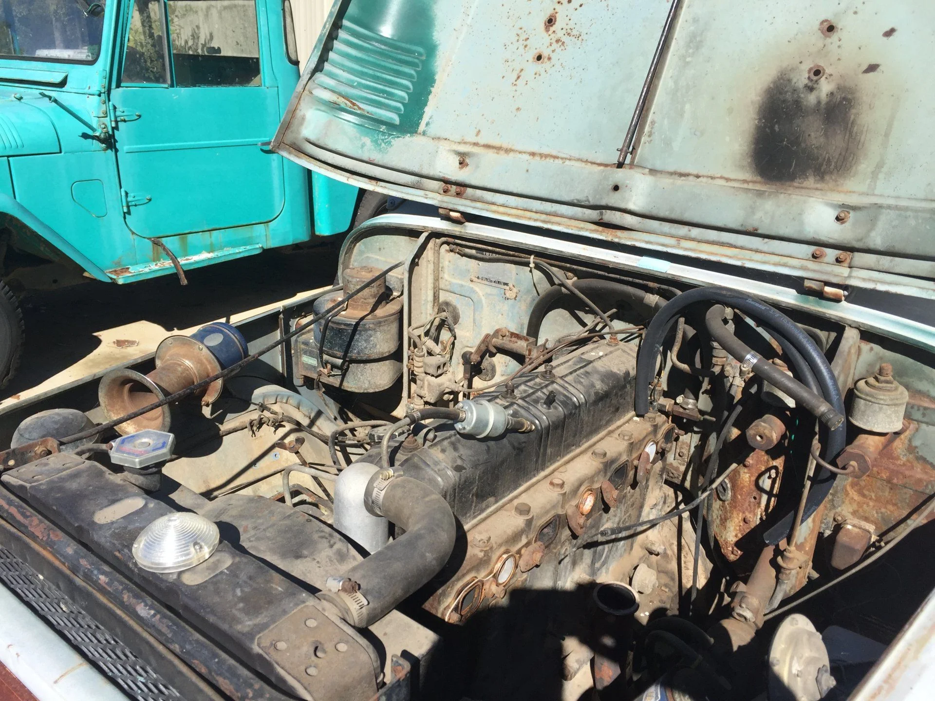

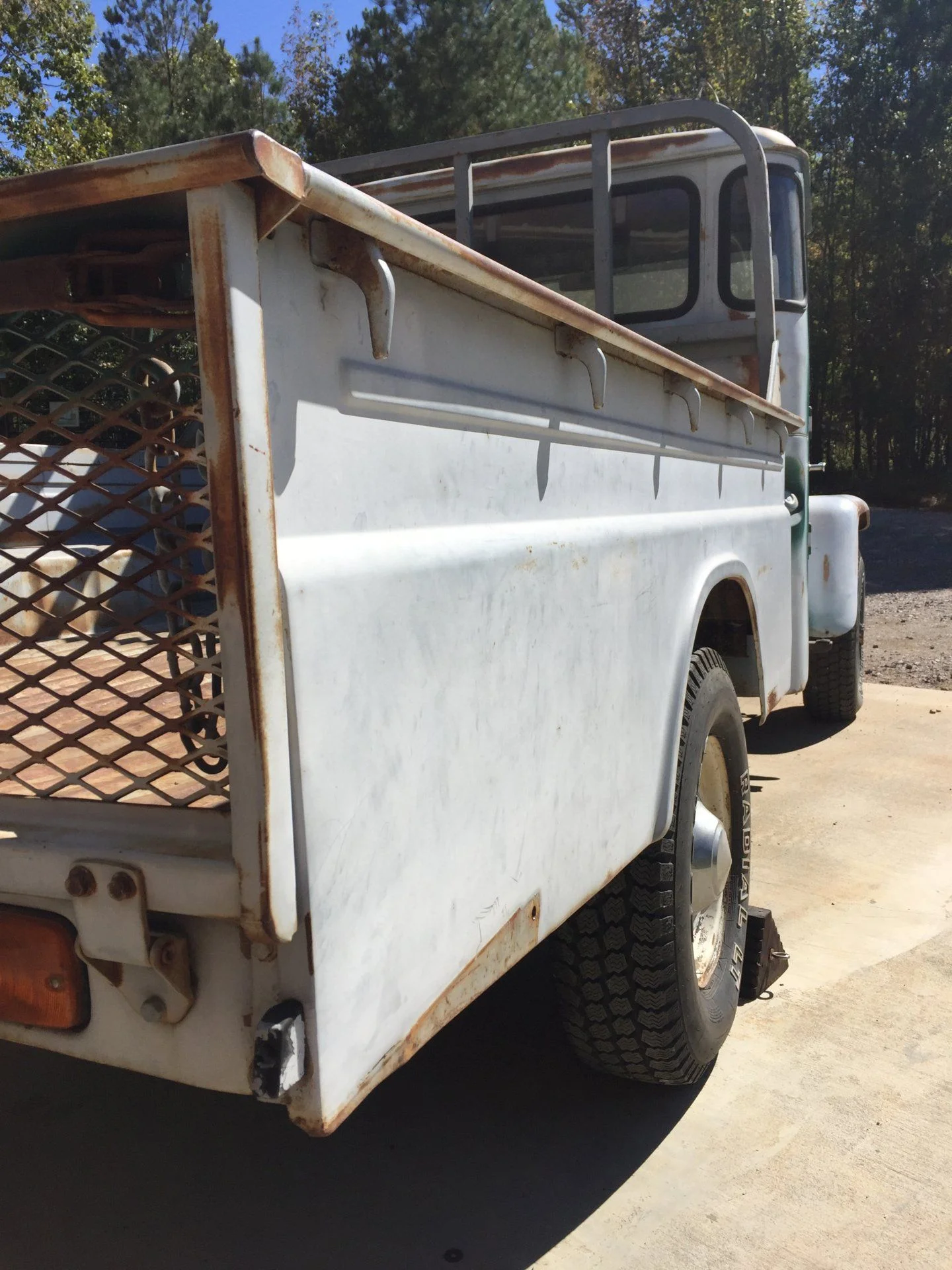

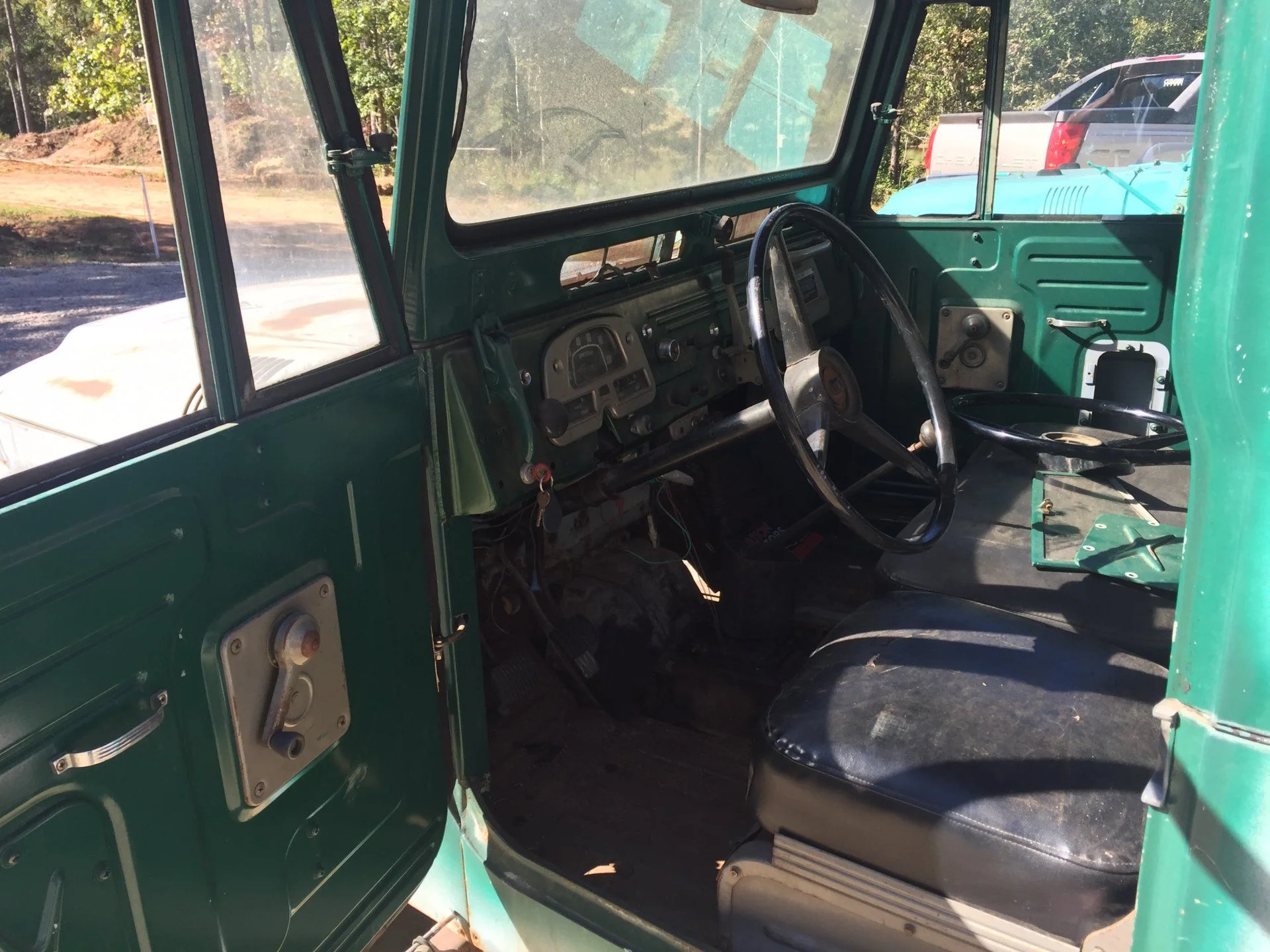

Let's start with some pictures of how she currently stands. This is by far the cleanest, straightest, and most rust free 45 I've ever owned. Let's just hope it remains that way after I strip all the paint off :D I don't have much back story on her as I bought it from some flipper on eBay, but I have tracked down the owner prior to the flipper. He lived in Yreka and is who I believe started the restoration of it and owned it for roughly 30 years prior to my purchase of the truck. I am going to reach out to him and see if I can get some history on this old girl. Though I'm not overly optimistic as a quick google search tells me he is now 86 years old :doh:

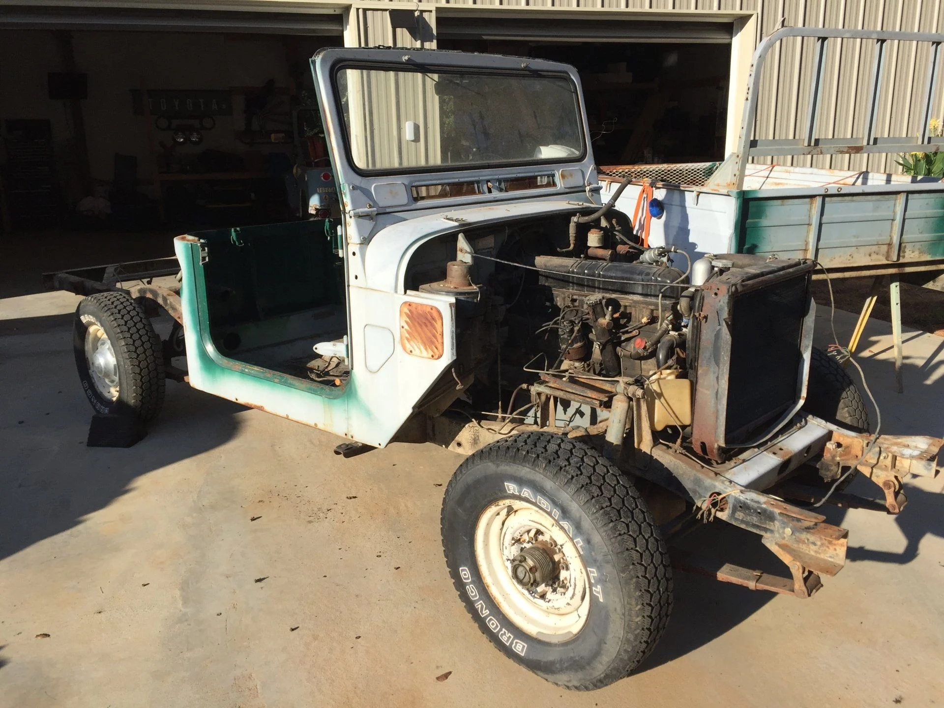

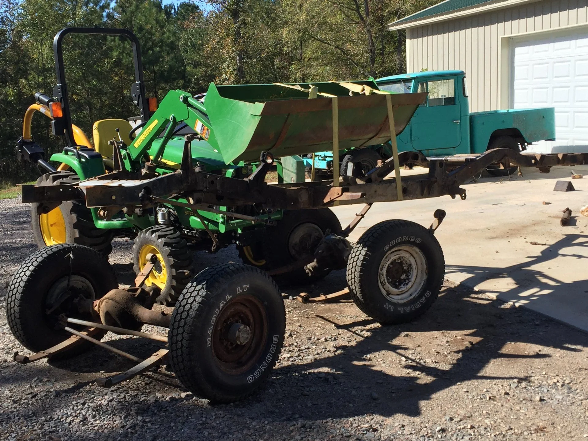

One of the main reasons I love working on 40/45s especially these early models is their admirable simplicity. With 4 hours time this afternoon and 10,12,14, and 17mm wrenches at my side I was able to go from complete vehicle to essentially a rolling chassis.
Time to put in a call to Coolerman!!!
That's all the progress for today. Hope to be down to a bare frame tomorrow :beer:

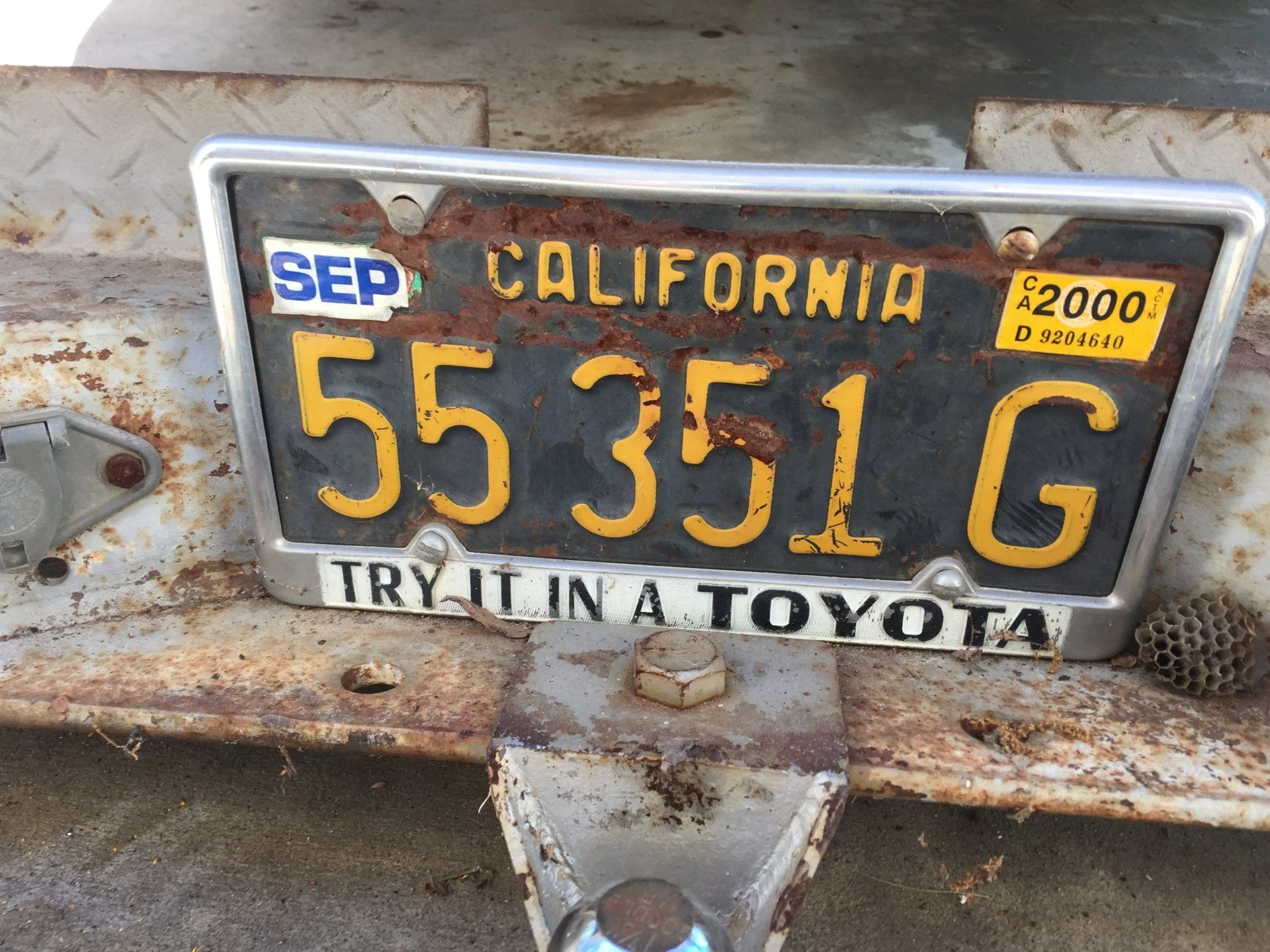

Cool info on Wheeler's Toyota Mark. If I can get a hold of the prior owner in Yreka maybe he can confirm where the 45 was originally sold. Mine had this cool Toyota license plate on the back that I haven't seen before. Anyone know if is period correct for a '65 or if it was a later Toyota slogan?

Not sure on the date for the license plate frame, but I did have a similar one that stated" Do it in the Dirt" and looked the same. It was from the early Seventies.

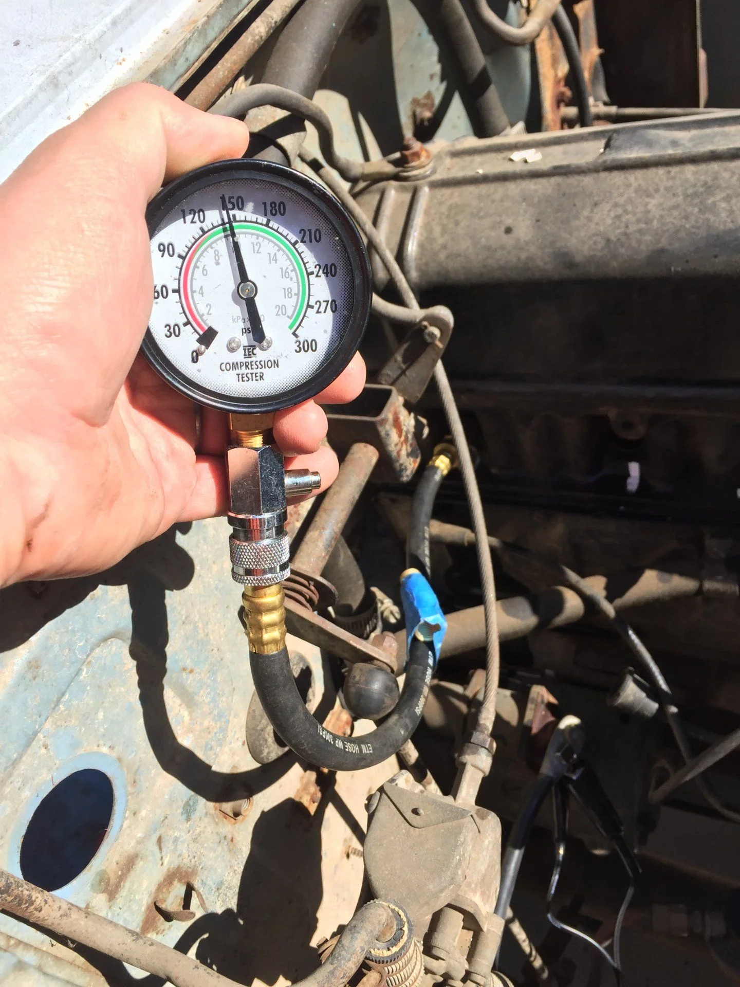

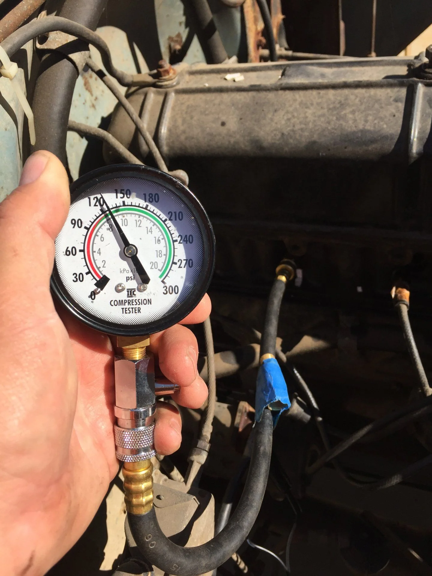

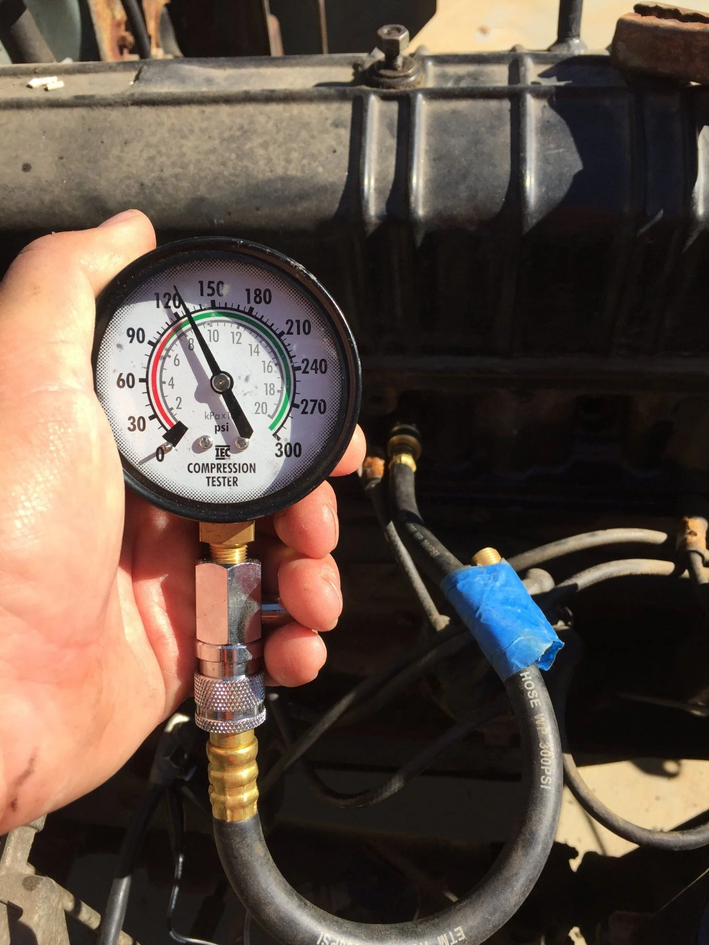

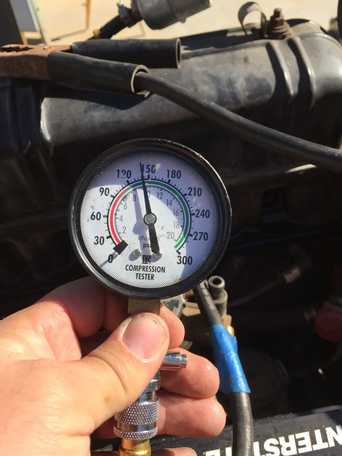

Small up date. Did a preliminary compression check of the engine and got so, so results. roughly 120-140 psi across the board. I was planning on doing a head job as a minimum but after seeing the numbers I'm now leaning towards doing a full rebuild. This is the first F engine I've had that was on the low end of the spec.... guess I've been lucky up until now with these old girls.
last compression number

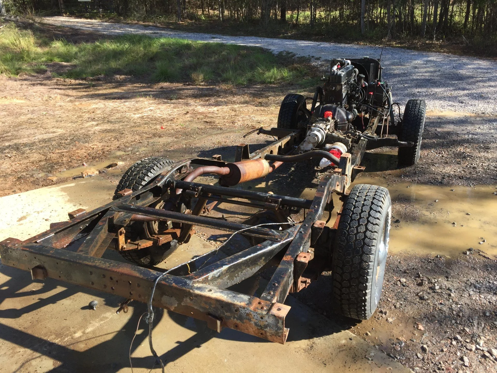

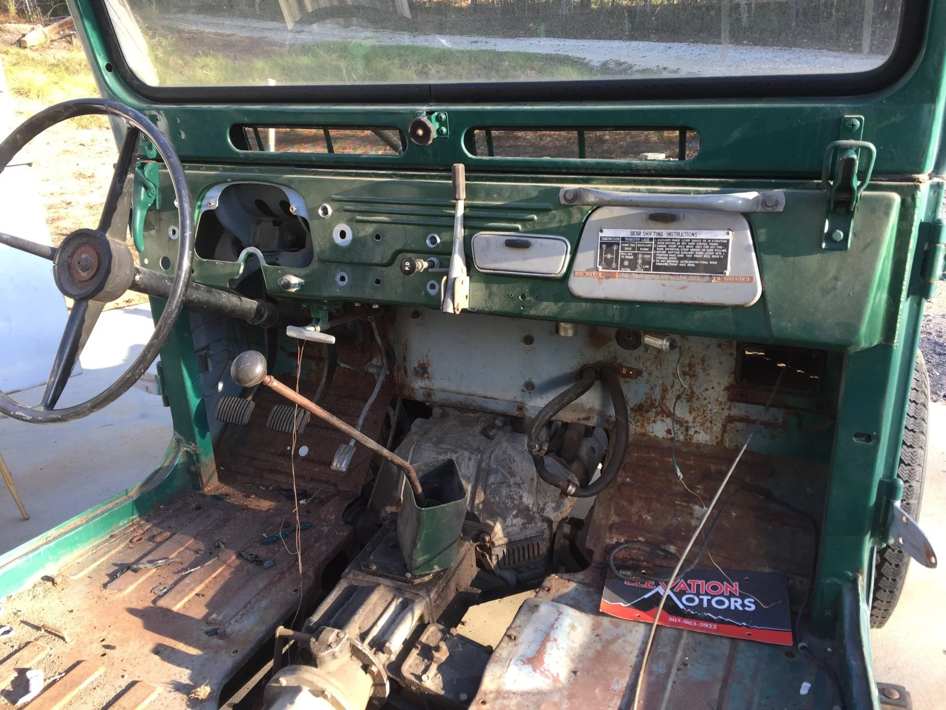

After the compression check I pulled the cab off the frame and left just the bare rolling chassis and drive-train. Then I spent a good hour with the ole pressure washer knocking off all the loose grease, grim, and dirt. The frame rails were particularly clogged up with years of dirt but I was able to blast most of it out. Overall the frame is in fantastic shape hardly even any surface rust... God Bless California :D
Finally I liberated the bare frame to ready it for some sandblasting tomorrow. I have to say the best part about leaving the city behind and moving out to the country is I now get to have a tractor and what a useful tool it is :beer:
