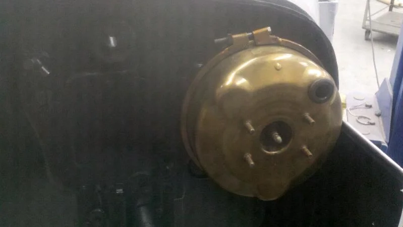

I didn't rebuild it with any new parts. It worked OK and I don't know if parts are available. I just disassembled it to get the canister to bare metal to sandblast and powdercoat it. It's pretty easy. The big clamp around the outside unbolts. I put it in a vise in case the spring was really tight, but it's not really that bad. The diaphragm and air valve are an assembly and don't have to come apart. The front and rear seals are held in place with a push in star ring.
The whole process including powdercoating and baking took less than an hour.
Cool, I had no idea. I thought that rebuilding it entailed breaking the seal to split the halves. I will def. do it now. Thanks.
Here's the booster.

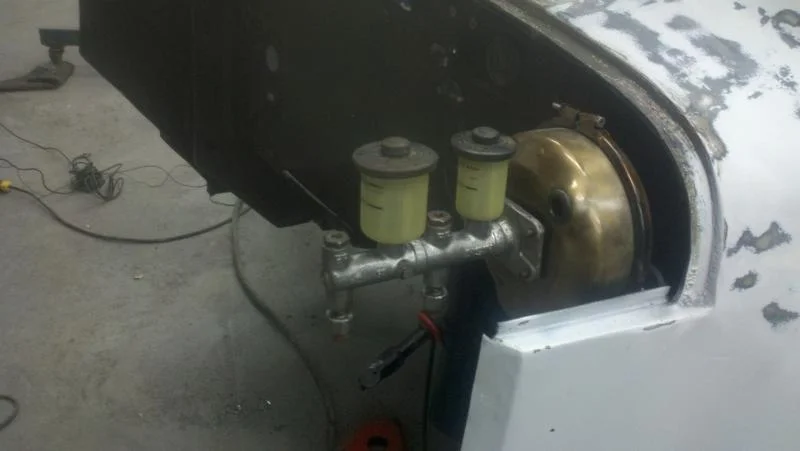

and the booster with the master.

it looks great but isn't that the spot for the clutch master? or did I miss something. if not where did you get your clutch booster? I want to try one to see if that solves my clutch problems.
jason
The Booster/master doesn't fit in the stock location because of the 1FZ intake manifold. I'm not using the clutch master because the truck now has an A343 trans. Some PO down the line re-fitted the truck with power brakes and discs so he moved the clutch hole and cut out the rib. I filled all the holes and re-drilled to put the master on the clutch side. I moved the reinforcing plate on the pedal assy to the clutch side as well. I will bridge the clutch and brake pedals so the brake pedal makes the clutch pivot actuate.
I'm thinking about putting the rib back.

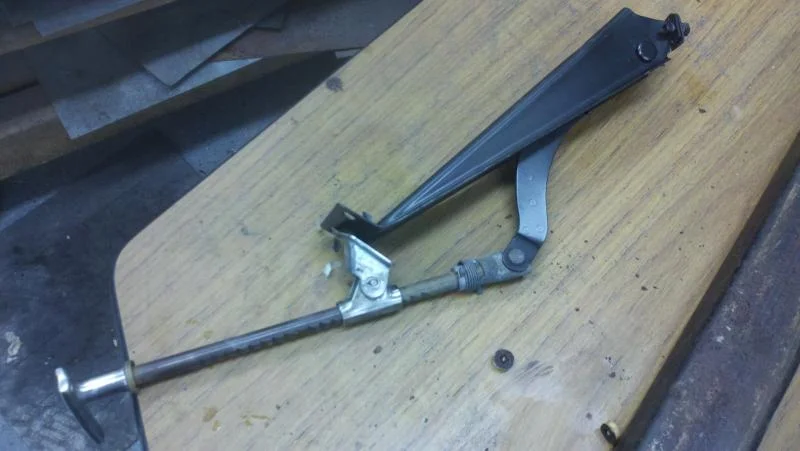

Did the e-brake handle assy. and the grill.
Blasted, primed and painted the wiper assy. Too many plastic bushings to powdercoat.

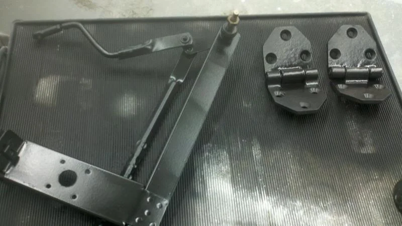

Welded the pedals together, took them off the bracket so I wouldn't melt the bushings and powdercoated the bracket too.

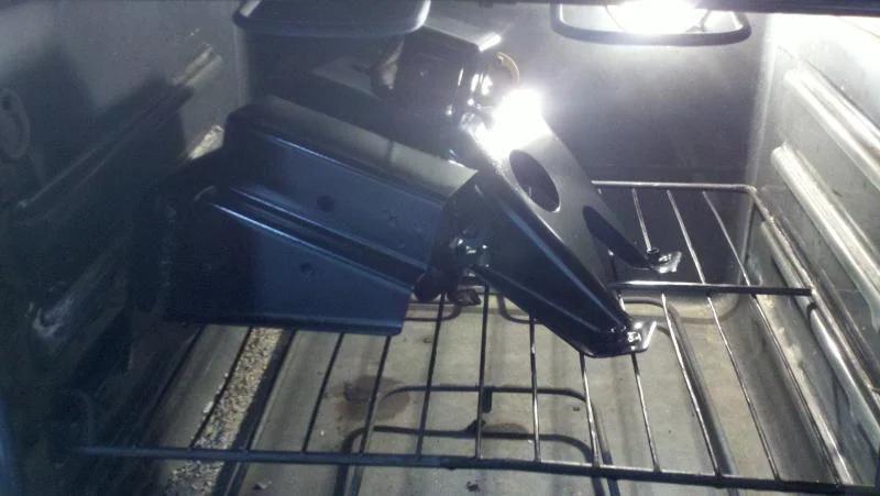

Are you just using regular oven for your powder coating? i am just wondering if this is something i should look into doing for my own stuff would you mind giving us a brief run down of what is needed and what not? everything looks great!
Eastwood Company powdercoater. I use the Pro gun, but the cheap one works very good. I have an old 220 V oven that I got from someone remodeling their kitchen. Don't use an oven you will ever use to cook food in. The coating gasses off and gets in the oven pretty bad. You would want 220V or gas in your garage for that oven. You don't even want to do it in the house even if it was a dedicated oven. It's 17" across so I can just squeeze a 17" rim in there.
I built a stand to hold the rack while I coat it and while it cools out of some angle iron and some tubing. I can raise and lower the rack so I can do hanging parts or parts sitting on the rack like in the pic above.
I like it a lot. I use it for all kinds of things. I've been doing it long enough that I have a lot of colors of powder. I go through a lot of high gloss black, but I use clear, cast iron, aluminum and some regular colors as well. Most colors I buy a small container (2#?) of. 4 rims usually take a 5#er with a bit left over. The anodized colors are pretty cool too.

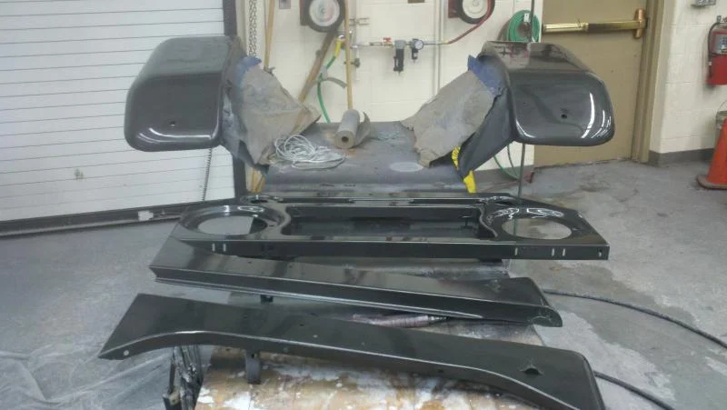

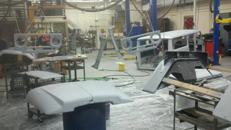

Running out of primer really put a weird twist on the timing of everything. Rather than being ready for paint when it showed up I had to get back to priming and blocking. This morning I knew the paint was coming, but I didn't know when. I moved the chassis outside and cleaned the shop. I took the fenders off the chassis and lag bolted them to a bench top. I hung a bar from the ceiling so I could hang some parts.

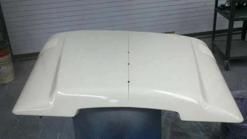

When the paint showed up I hit everything with high build. Had to take a break for a while so things could dry enough to sand it all back down. Then I hit everything again, mostly with the final coat.

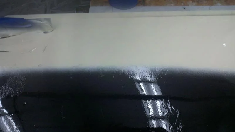

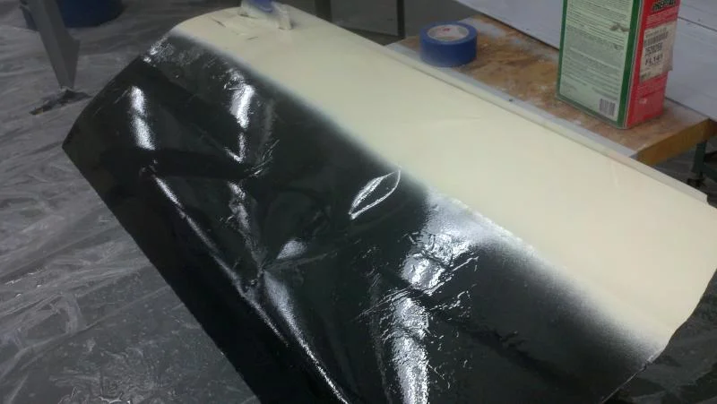

I mixed the minimum paint that I could measure with my measuring cup, about 7 ounces. Then sprayed a test panel. The lily white is yellower than I expected and the Pyrite is grayer than it should be and more metallic than it looks like on the Toyota trucks. I have to see it out in the light tomorrow to tell how much I like it. The test panel was just a door skin. I didn't primer it or anything, just sprayed right over whatever was there. Actually, it's a 1969 Camaro RS Convert door skin with remnants of Garnet Red paint on it. Not quite as rare as the LV, but maybe more desirable to people who don't know any better.
I'm really glad I sprung for the Concept rather than the Omni. It was about $100 more a gallon and the bill I got today was pretty staggering, but it sprayed so easy and looks really, really good.
The only problem at this point is gonna be my prep and color choices. Hopefully, it'll work out OK.
Are you shooting a layer of thinned epoxy as a sealer coat?
