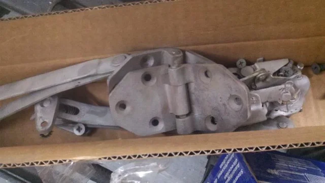

Then I stripped the tailgate of parts and paint on the inside, sandblasted the hardware, and pulled a bunch of dents.
Got to use my stud gun/puller. Worked great.
