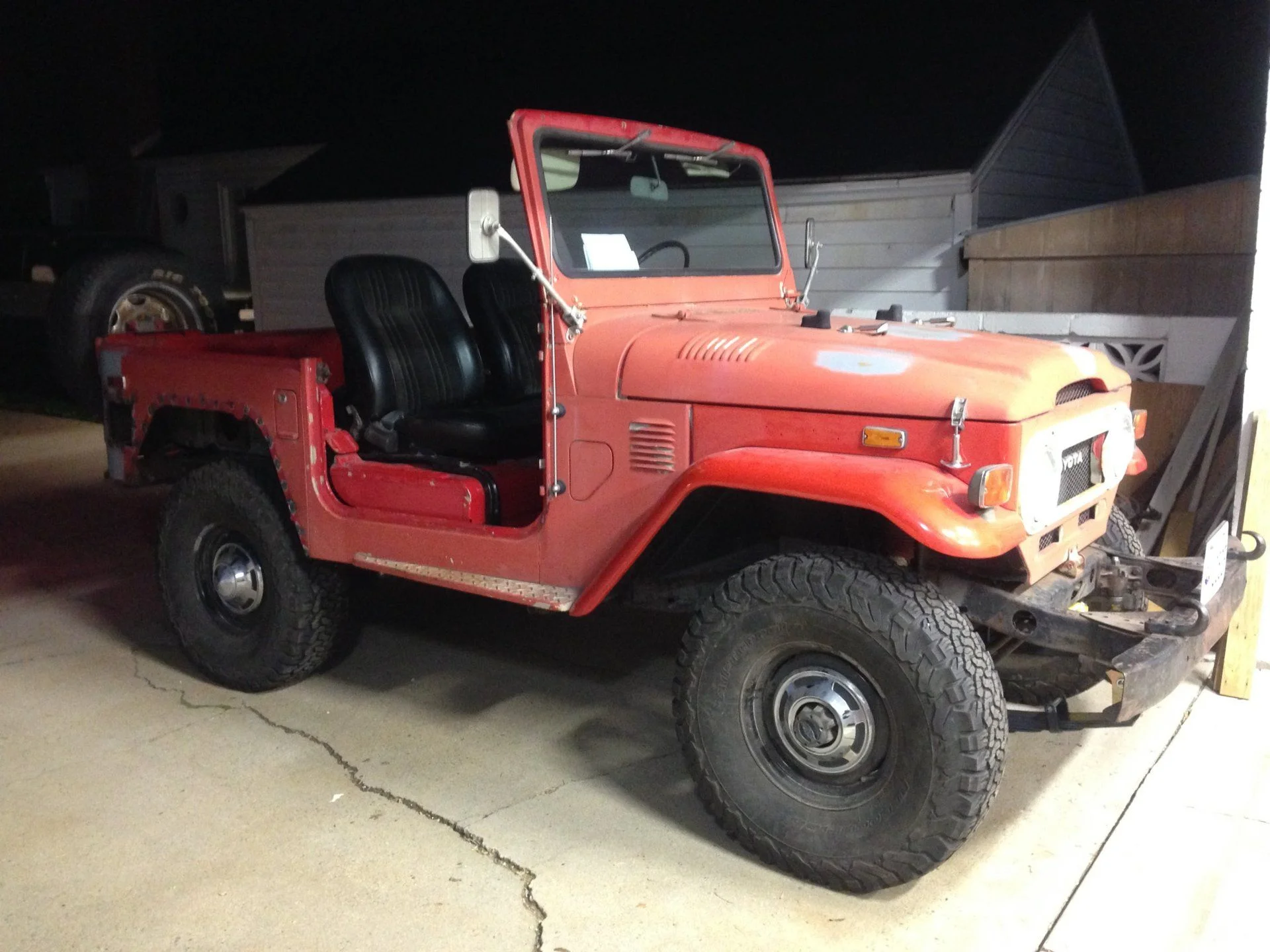

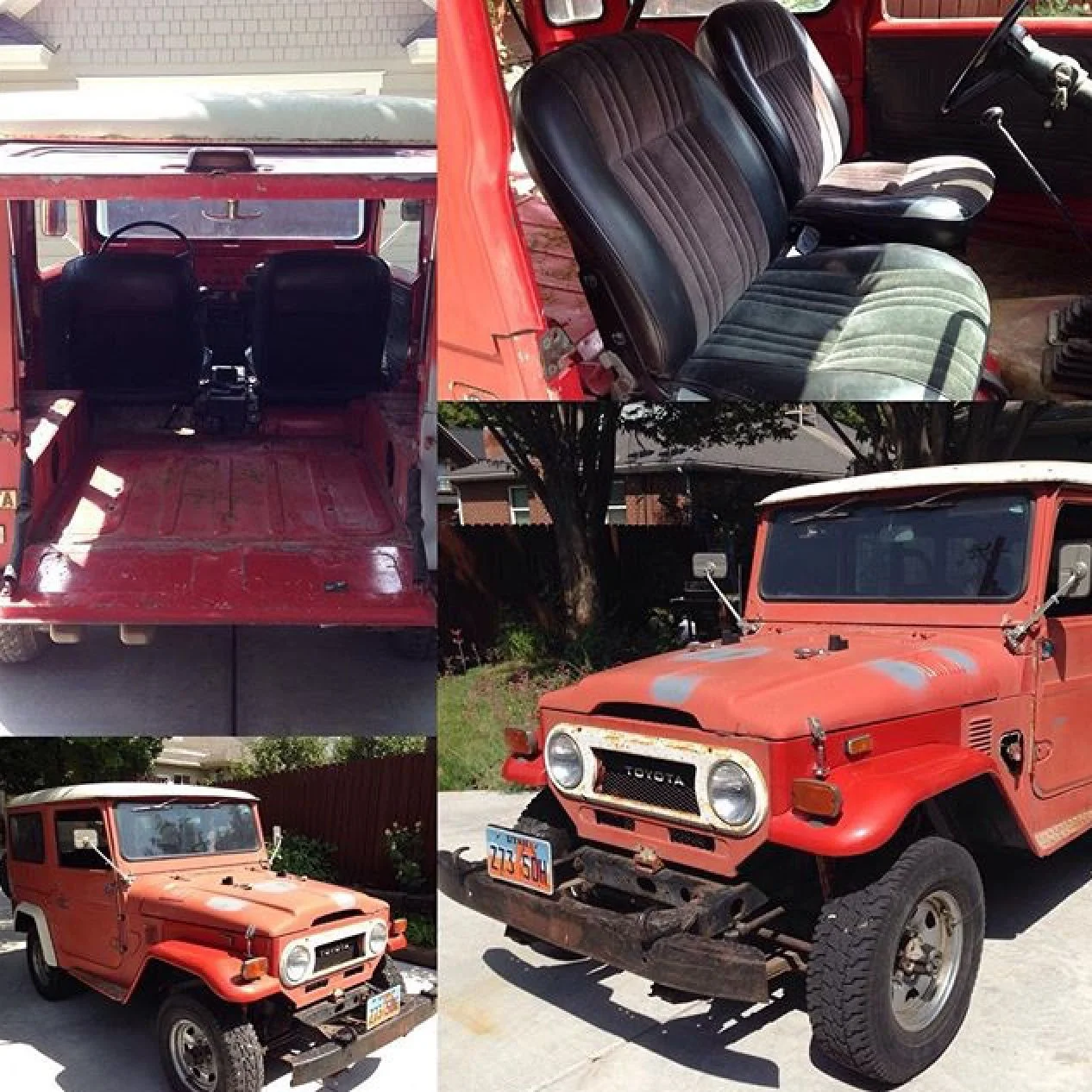

So this rig kind of fell into my lap. a friend from high school called me up to come look at her fathers cruiser and tell him how much to sell it for... i wasn't looking to buy since i have a '96 80 and a 64LV in pieces. I gave a quick once over and gave him my thoughts then went home and was telling my wife that it was in good shape, ran and drove, super clean tailgate next to no rust and on and on... she said "well why don't you buy it?" and i thought, "don't have to tell me twice.." so i went and drove it home with my 4 yr.old as co-pilot.

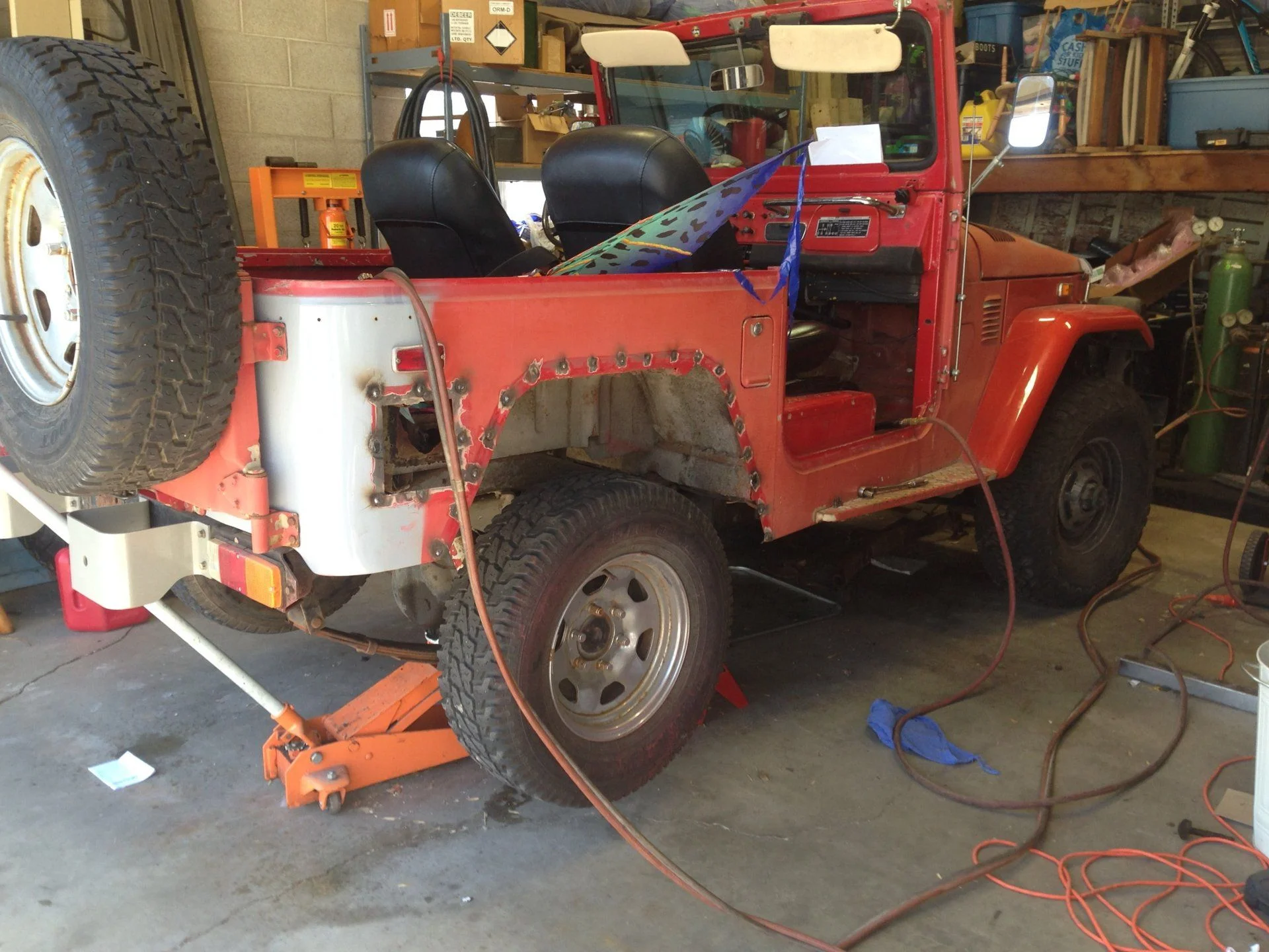

first things first, i replaced the tie-rod ends and the rebuilt the center arm so it was relatively safe to drive around. we were planning to keep this as a daily driver and mild off road truck that everyone can enjoy, so with @cruiseroutfit down the street and some other parts sourced from Member of Wasatch Cruisers we dove in and swapped to a full OME suspension with factory wheels and caps. as for the tires 33x9.5 MT would have been the first choice but slightly used 33x10.5 AT's for less than half the price will have to do..
since this is a '74 it has the F.5 motor and Drum brakes, both these are on the short list of things to go. I was able to source a set of axles from a '84 BJ42 so those have been cleaned up, gears redone (3.70's) and rolled under the truck.
the Motor will hopefully be out and swapped prior to Christmas for a 1-HZt with a H55 5spd behind it. I think this will be a great combo for drivability as well as off road use.

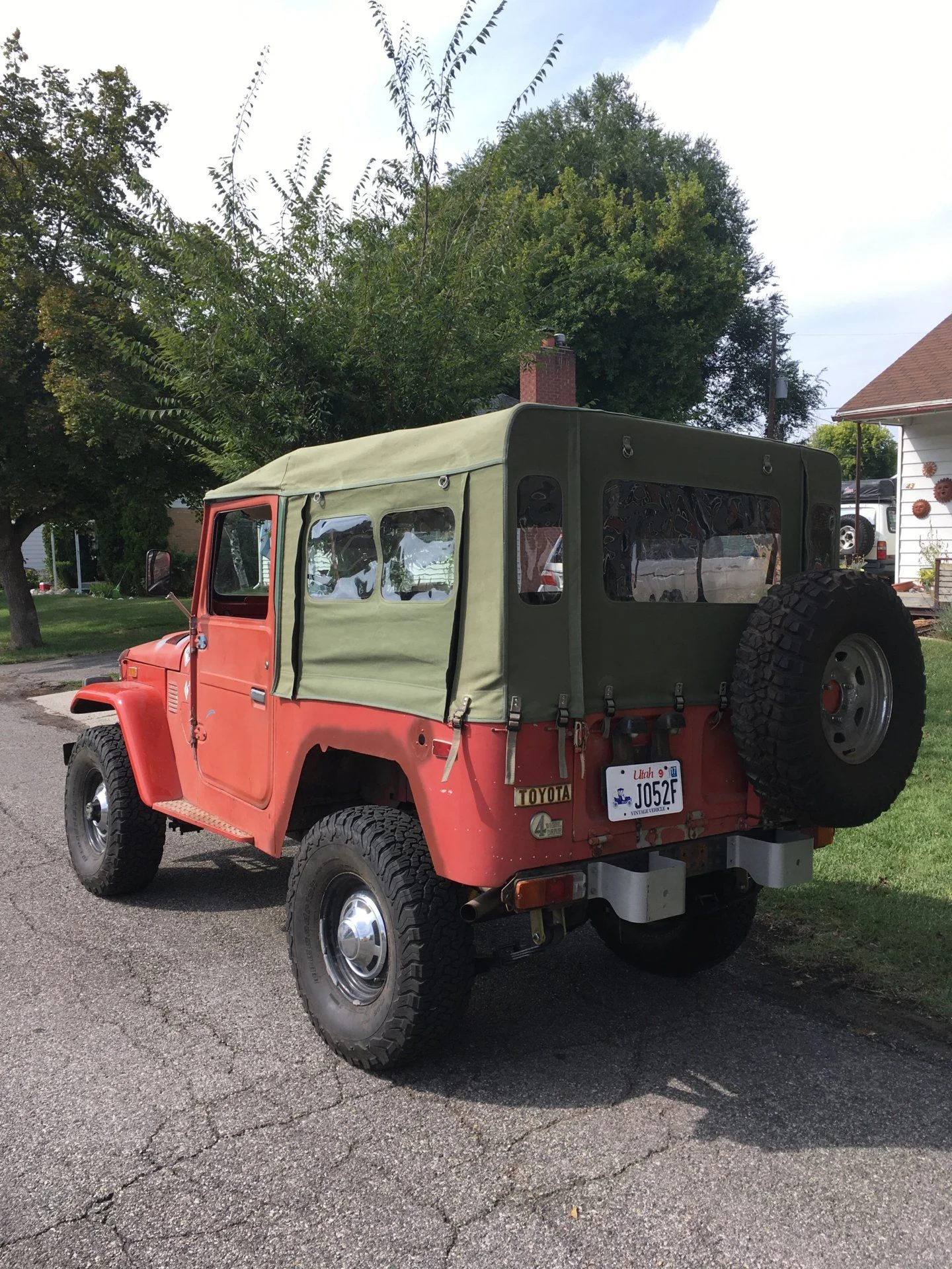

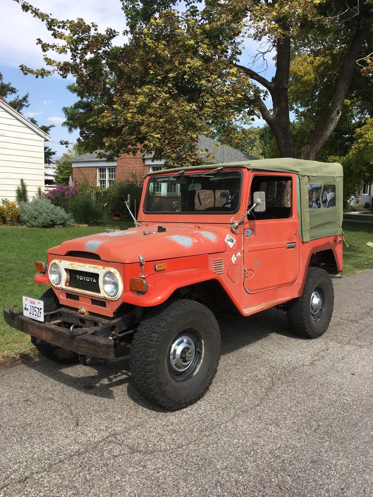

also, since this came with a hard top but is a FST i have opted to find a FST for it. I was able to pick up a paki-repro top from another mud member, Eshan made this one and as with my other dealings with him there are a few things that aren't awesome but it will have to do. there are no snaps on the side and the windshield channel doesn't really hold top if you go over 40mph..

that looks like it is an OCD top, rather than a Paktop by Eshan. It also looks like an OEM soft top windshield frame, although I don't know if they were different in any way in 74. If I were you, I would just push down on the top of the windshield channel & tighten it down a bit to hold the front of your top in higher speeds. Don't push it too hard, or you'll bend it in too tight & make it tough install/uninstall the top.
