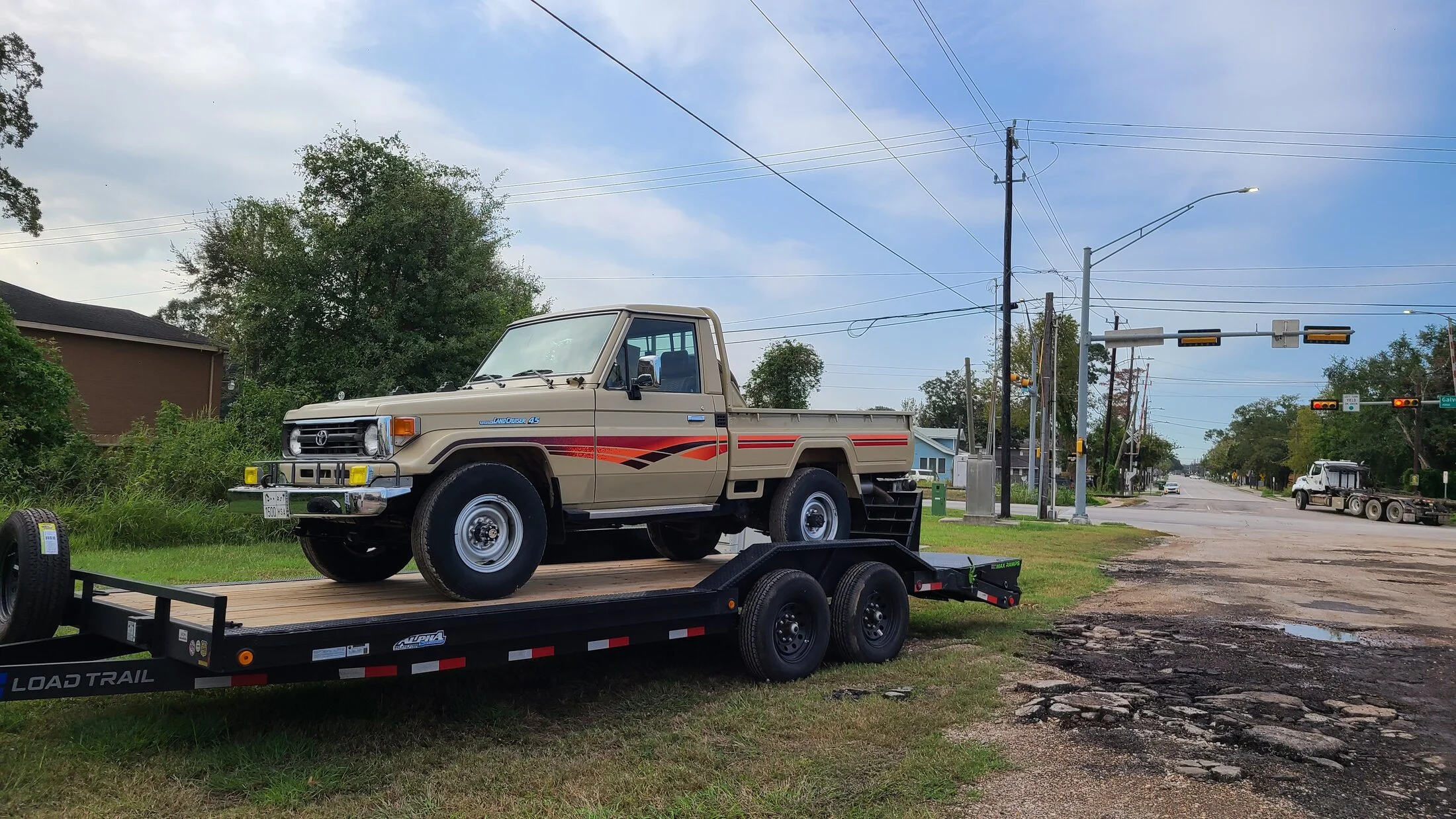

I got back this weekend from the road trip to Houston to get our new (to us, anyway) 1984 FJ45. Before we get into all of that, here are a couple of pics.

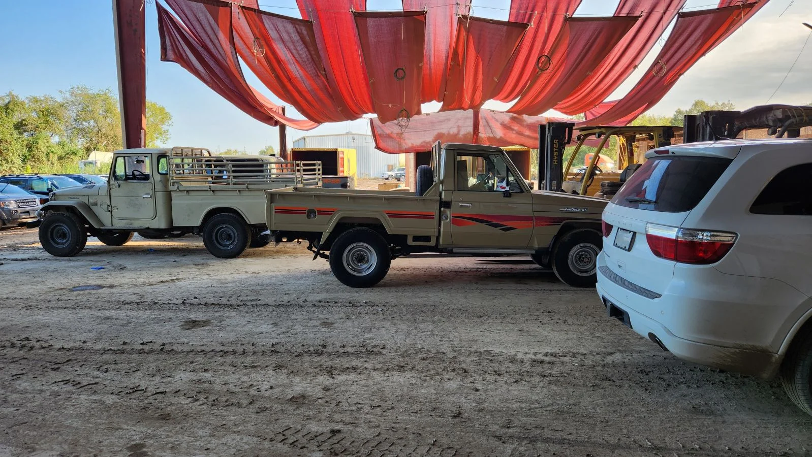

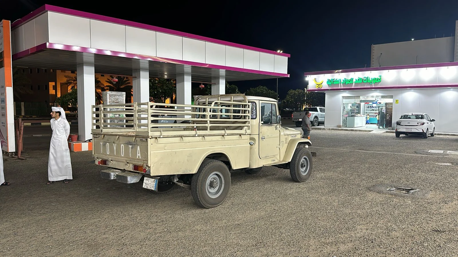

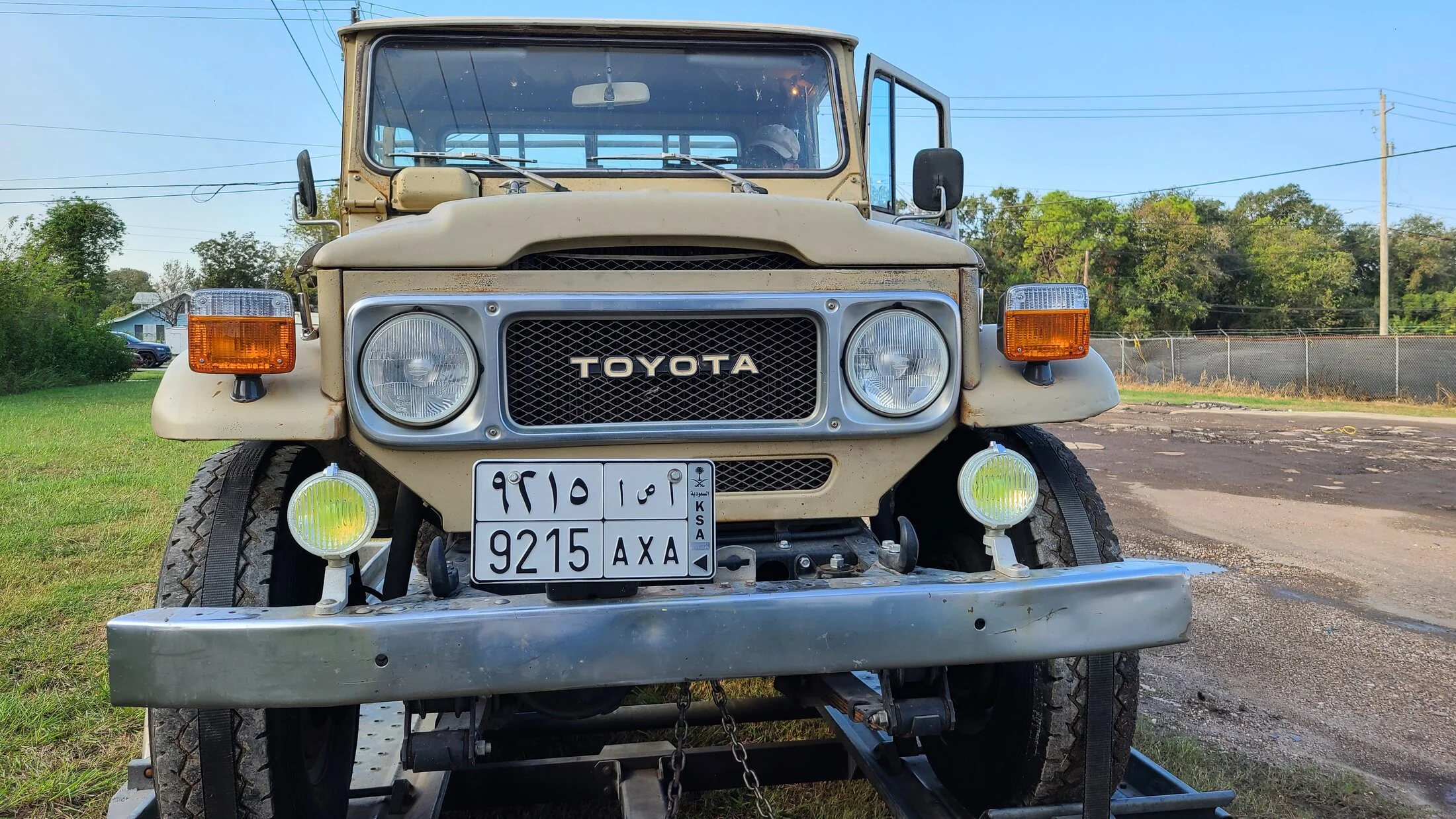

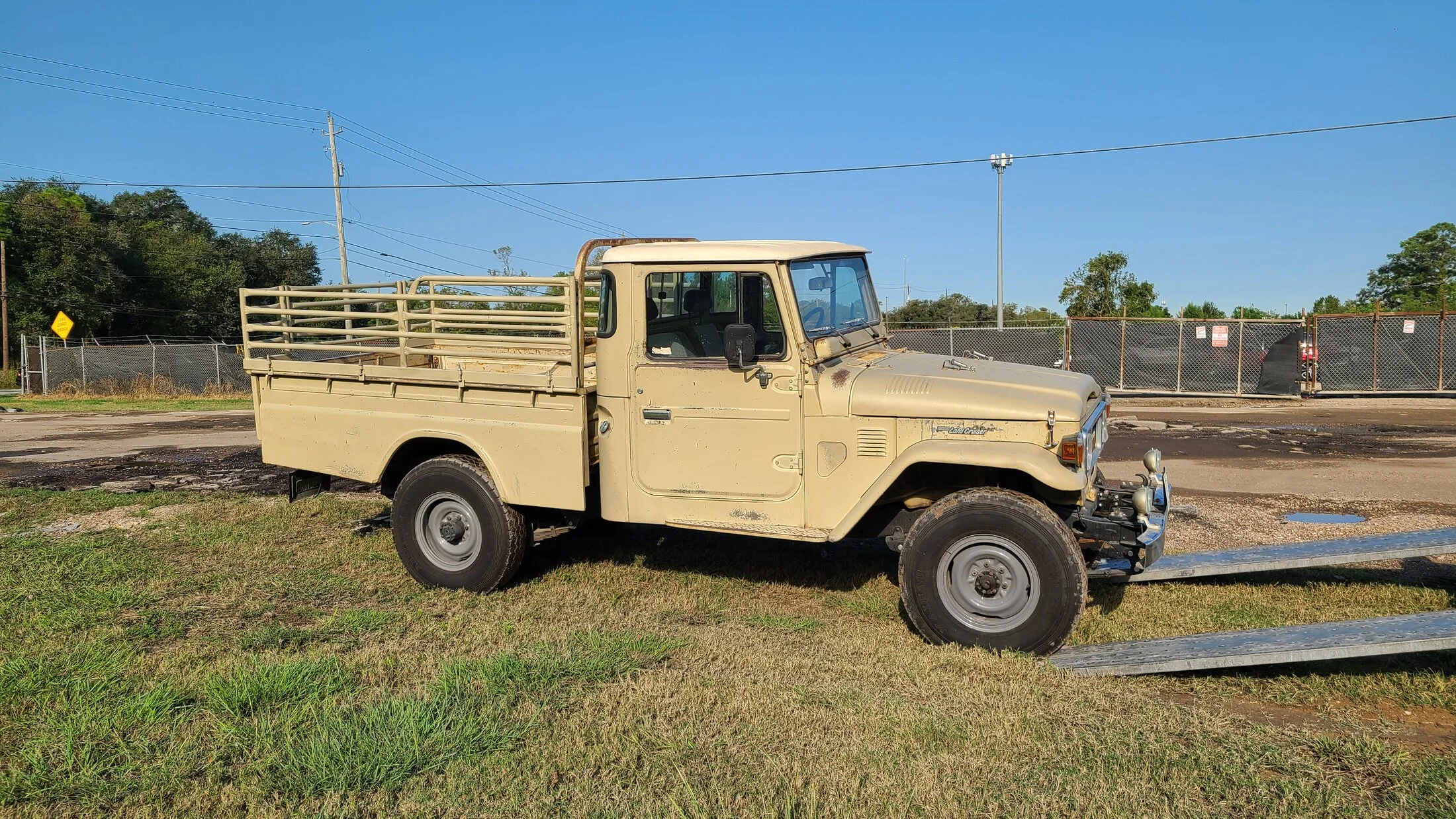

After several weeks of WhatsApp discussions to determine that we were on the same page and looking at a bunch of pictures, the truck was found by @Meshal in southern Saudi Arabia near Yemen. It went to Riyadh, got loaded in a container with a 70 series truck for @wngrog , then to the port of Jeddah and on to the container ship. The ship was able to go through the Canal, missed all hurricanes and tropical storms, and was only slightly delayed by the short dockworkers strike. The total transit was 46 days.
@DickM I am glad this truck made it safely.

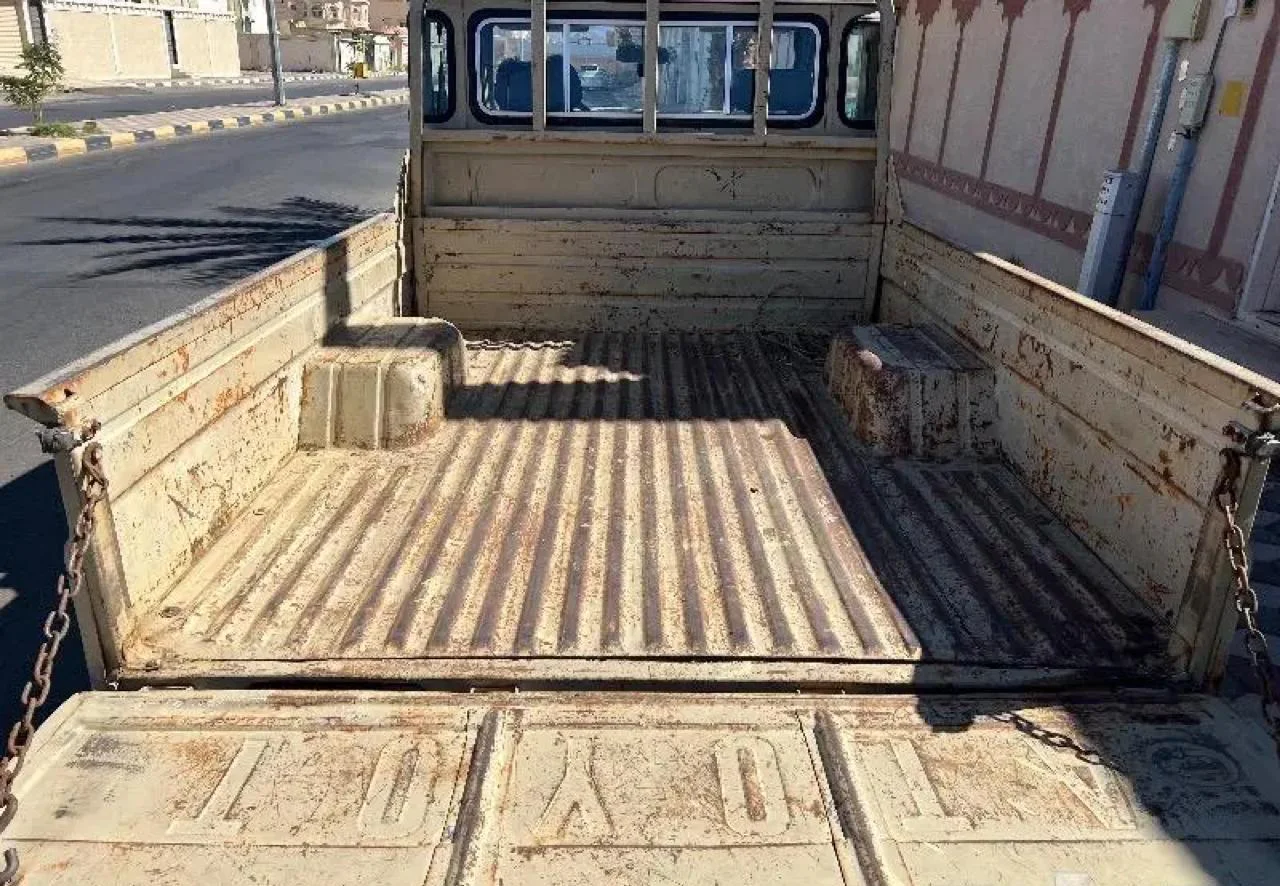

this truck got my attention because of the bed. i haven’t seen a stock bed like that in many many years.
This truck was owned by a man who grown up with and eventually became an old man who can’t drive it no more. And before selling it, they included the bed rack that was used.
Richard asked for specific things that were “must be or no” Rust-free and patina and man what a lucky guy I worked with haha

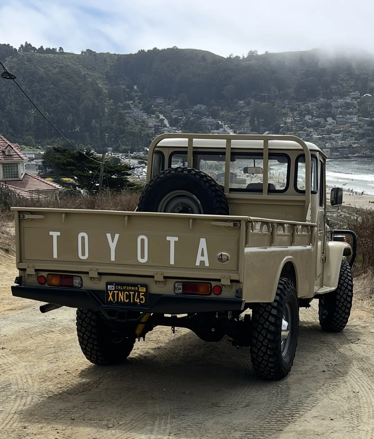

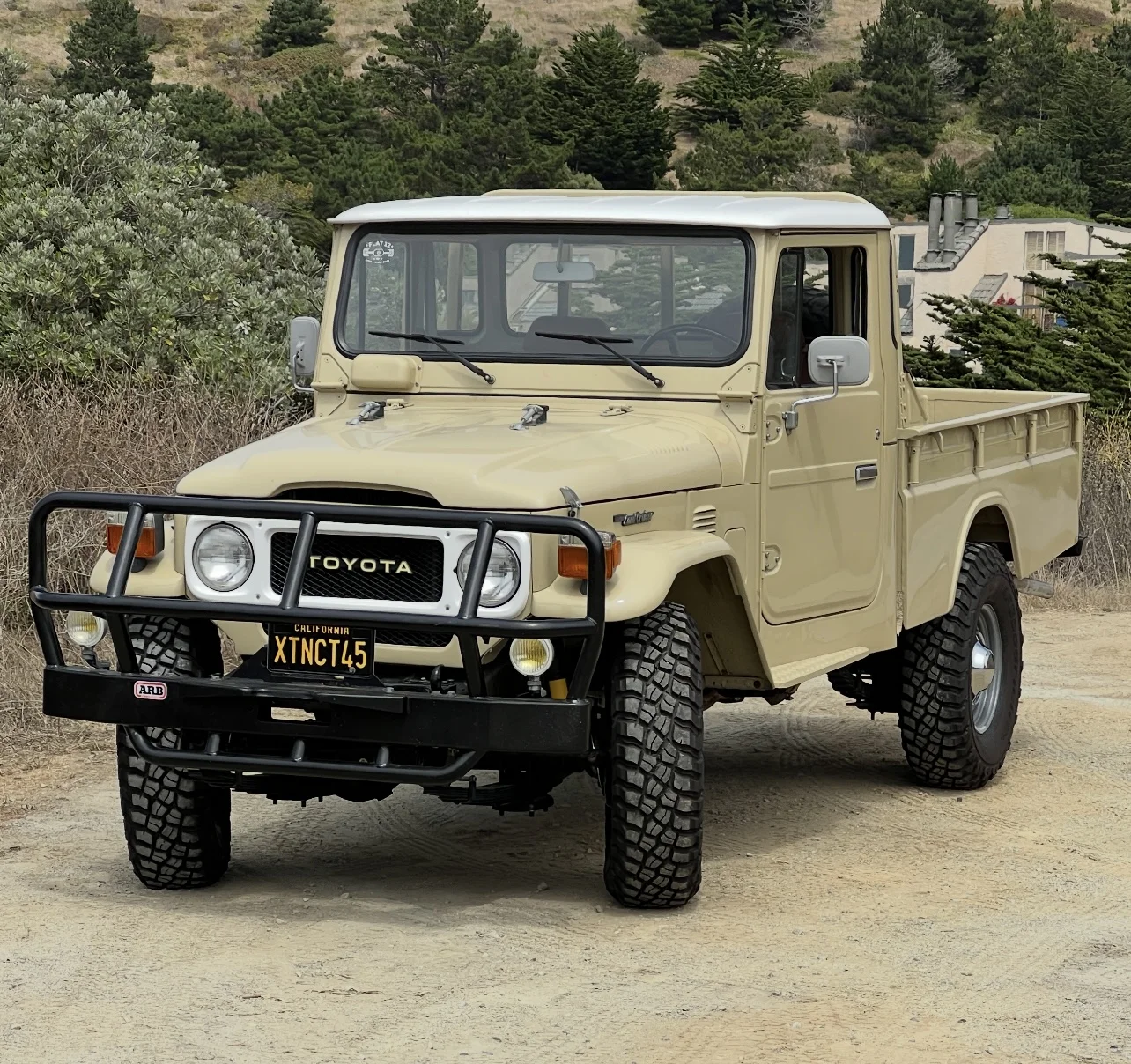

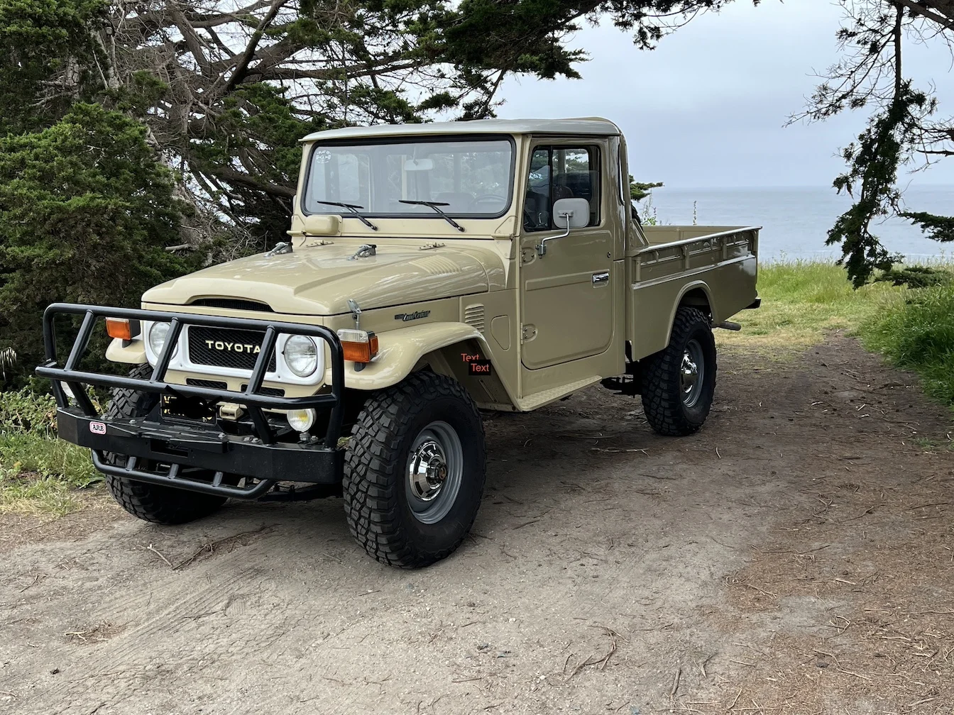

Congrats!! A real beauty!! Here's my 1980 that started it's life in Saudi, ended up in Dubai and then with me here in Norcal.
Here's it's story: 1980 FJ45 in Dubai - Saved From the Sands - https://forum.ih8mud.com/threads/1980-fj45-in-dubai-saved-from-the-sands.829317/
What a parts stash you had! Unfortunately the intervening years since you got yours have not been too kind to parts availability. Even with Meshal's help, we could not get nearly all the parts you did. But, as they say "hope springs eternal" , and the search goes on.

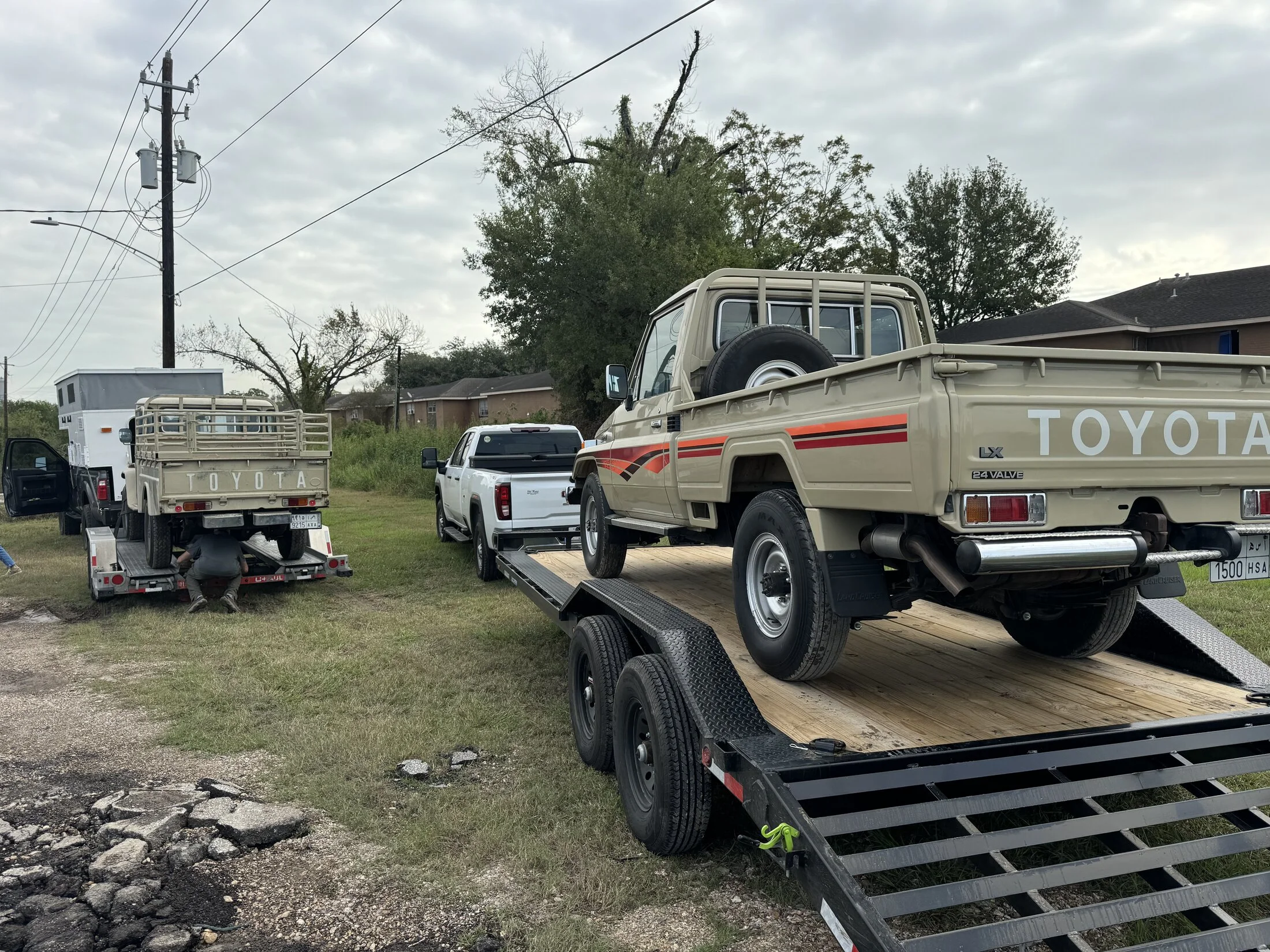

Also big thanks to @wngrog who handled the export/import side . He too was awesome to deal with, and another guy you can trust to treat you right. It was great to meet him in Houston to pick up the truck , chat a bit, and put a face to his huge presence here on MUD.

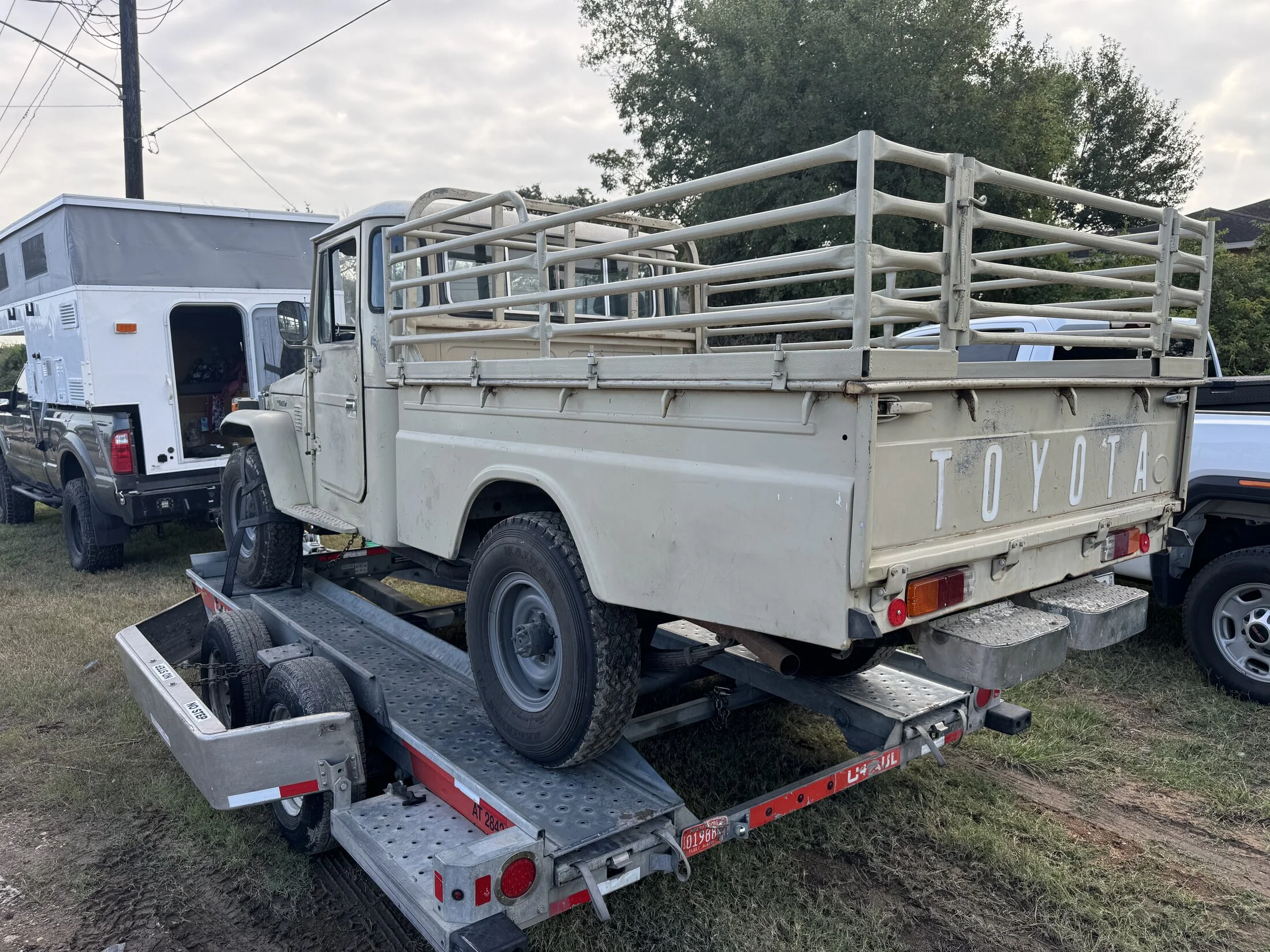

A couple more Houston pics with @wngrog and his beautiful 70 series
