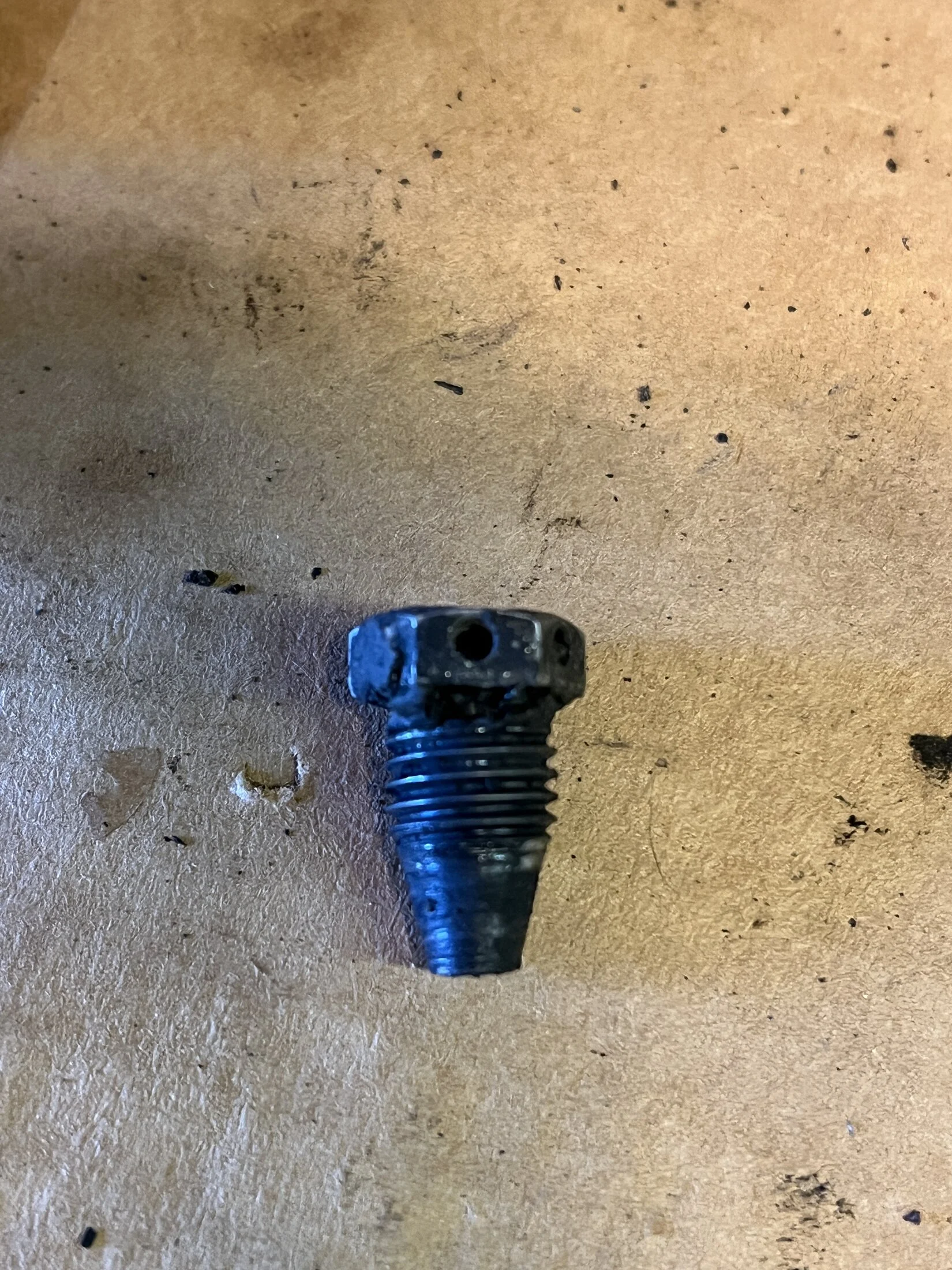

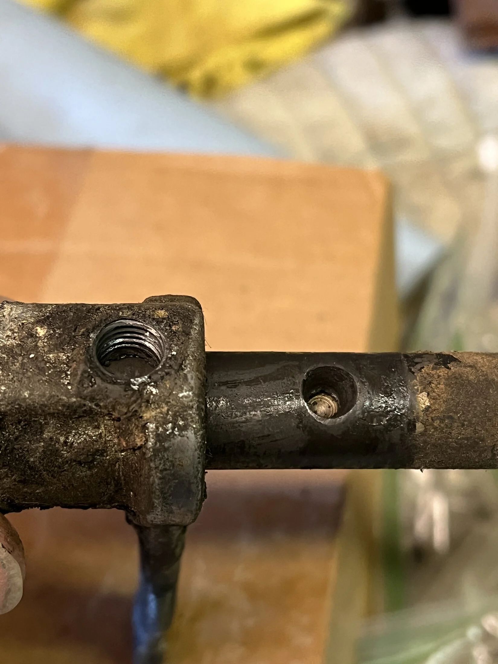

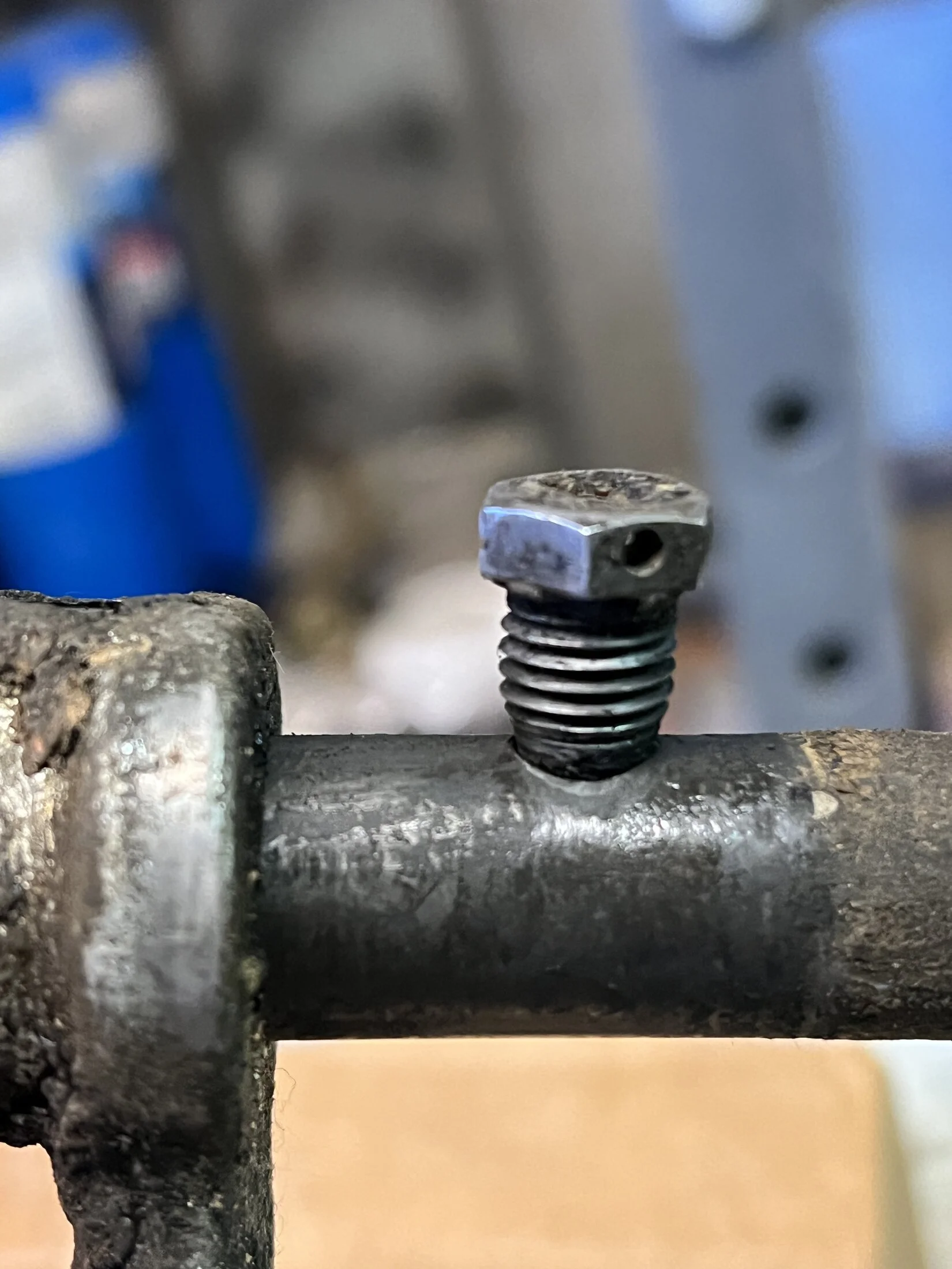

I think I remember that one I worked on had a safety wire in there
His has the tire wire present in the videos. Mine has that tire wire present. Keeps the little set screw that locates that shift arm casting on the shift rod from backing out. It is pointed, and the rod is drilled out for it.

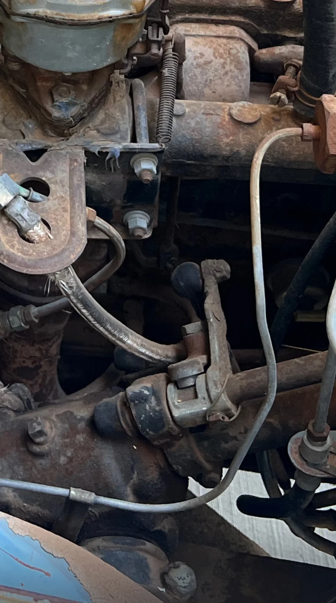

Copy. I assumed (likely incorrectly) it was a reference to this wire wrapped around the bolt….
Yes I was referring to the one you have retaining the washer there. Mine has the lock wire on the shaft bolt.

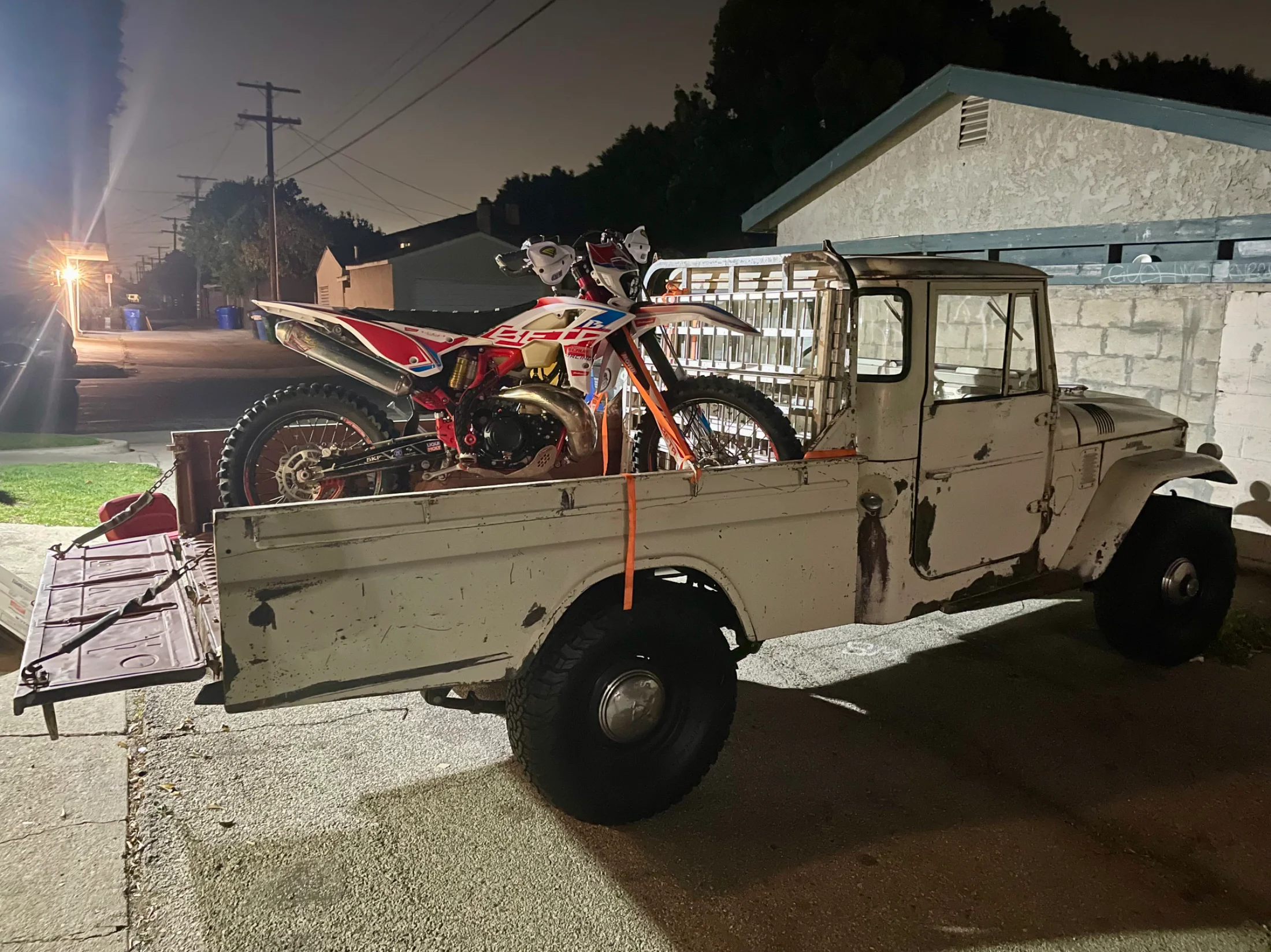

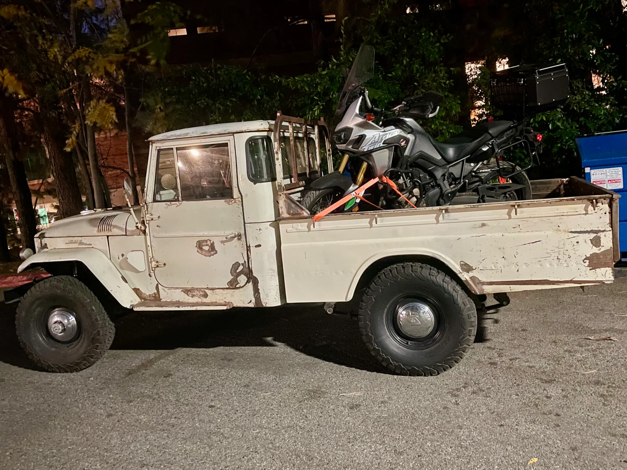

Pics of it with the bikes in the back
Didn’t take a photo with 1100 lbs of bikes in the back today- wasn’t too proud of how saggy it was looking! But handled it no problem. Here’s the dirtbike headed out to the desert this earlier summer. The Ram does it’s fair share of hauling.

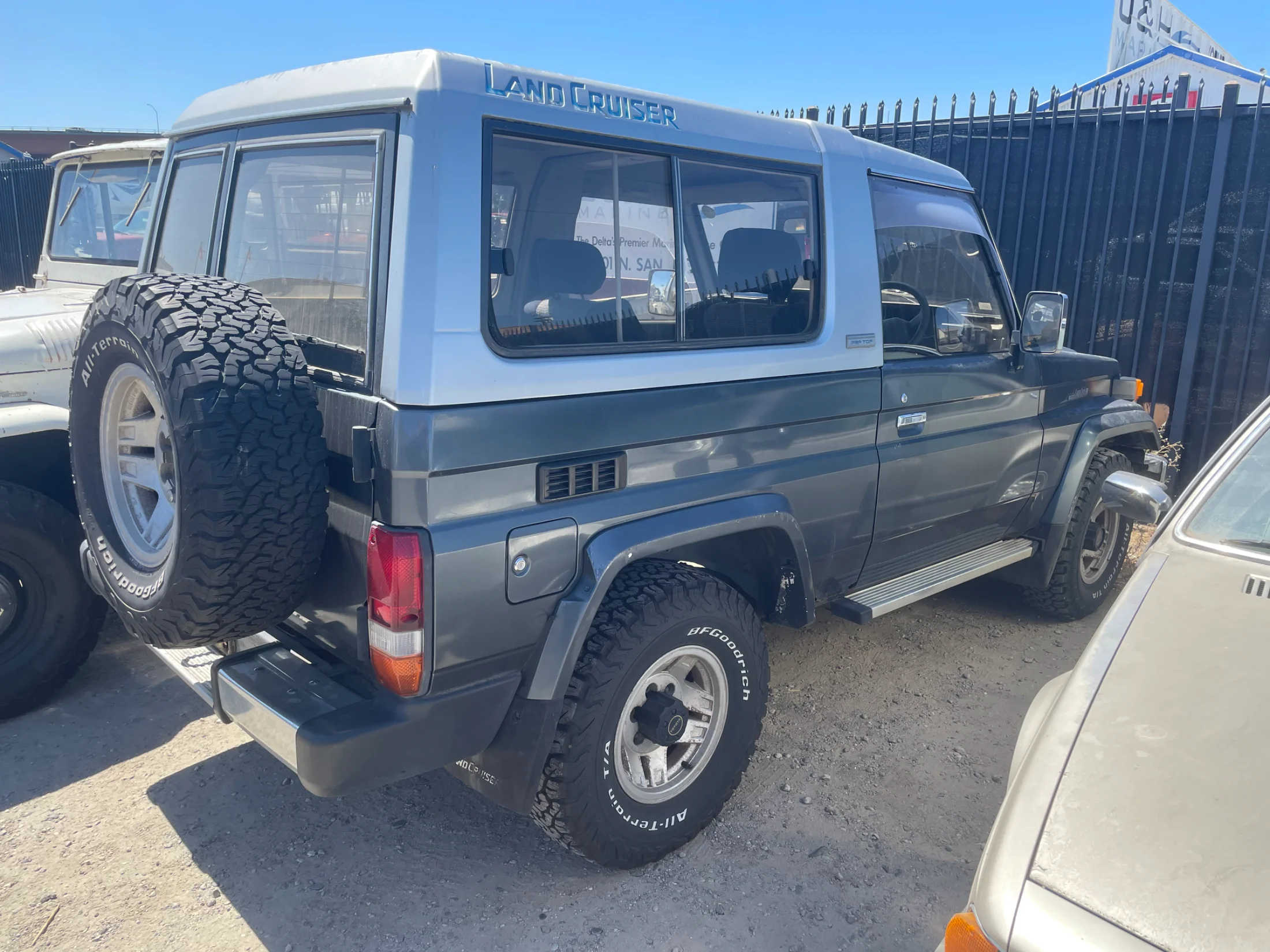

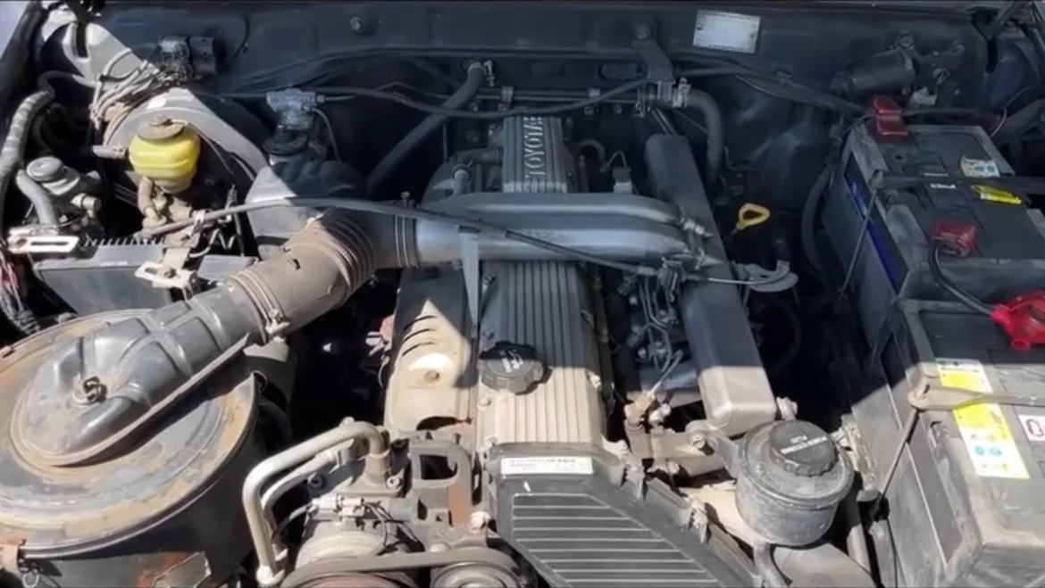

I drove the donor back from Denver to LA on Tuesday. It’s a 1990 JDM HZJ73. I was surprised at the compression:
1: 515 psi
2: 520
3: 540
4: 490
5: 500
6: 500
This engine must have been rebuilt. 584k km on clock. No blow by.
Gonna be a great addition
