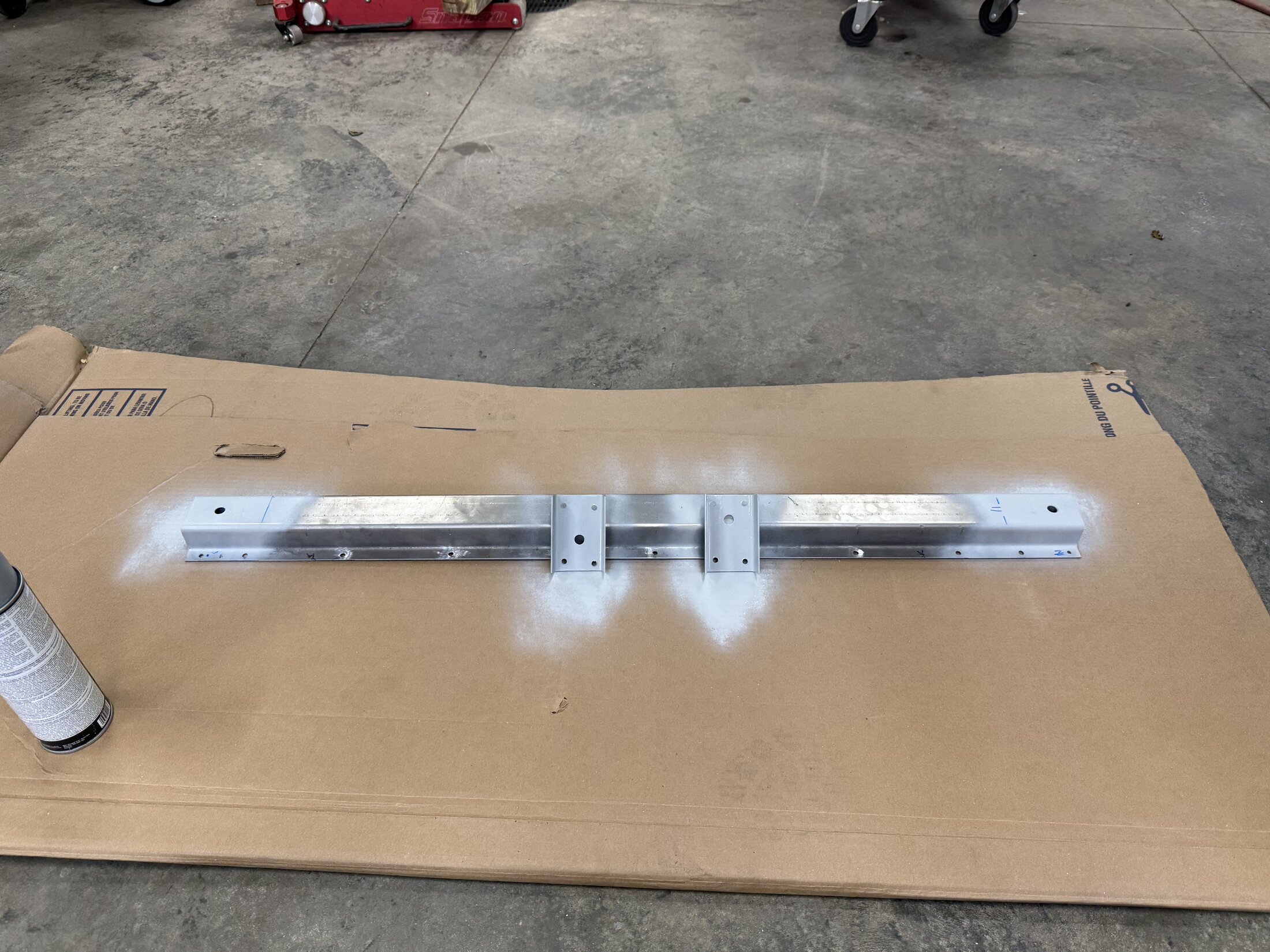

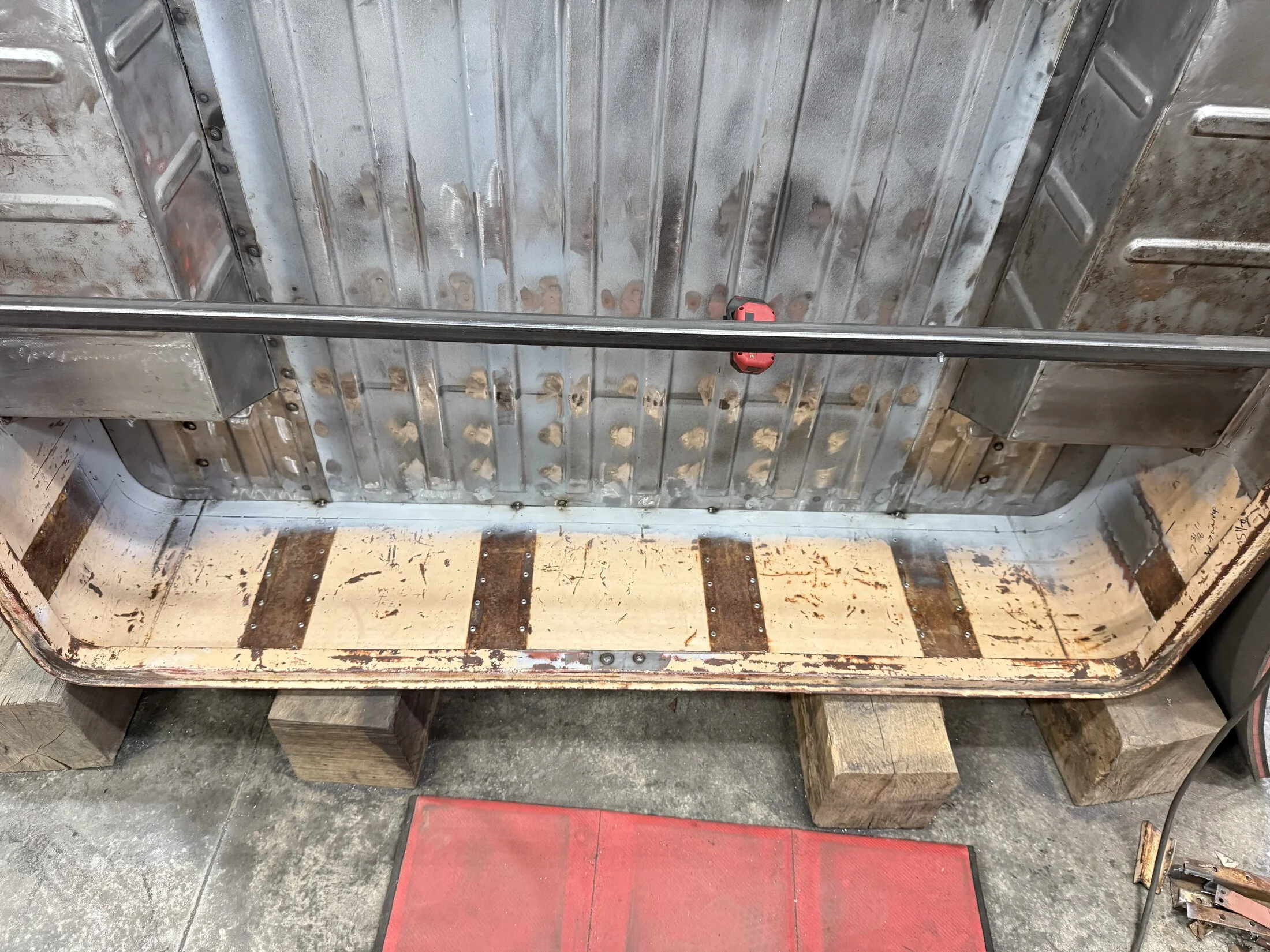

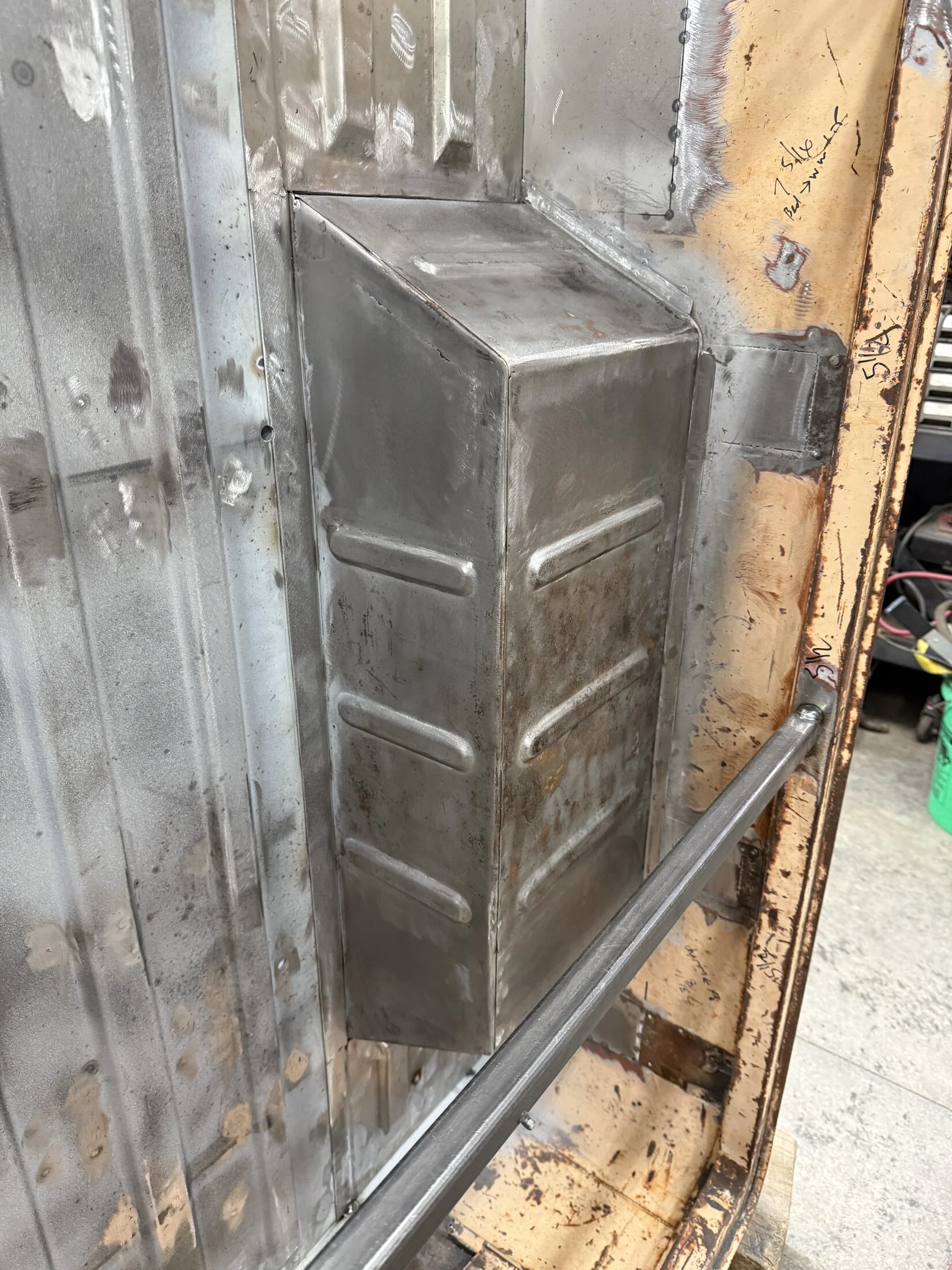

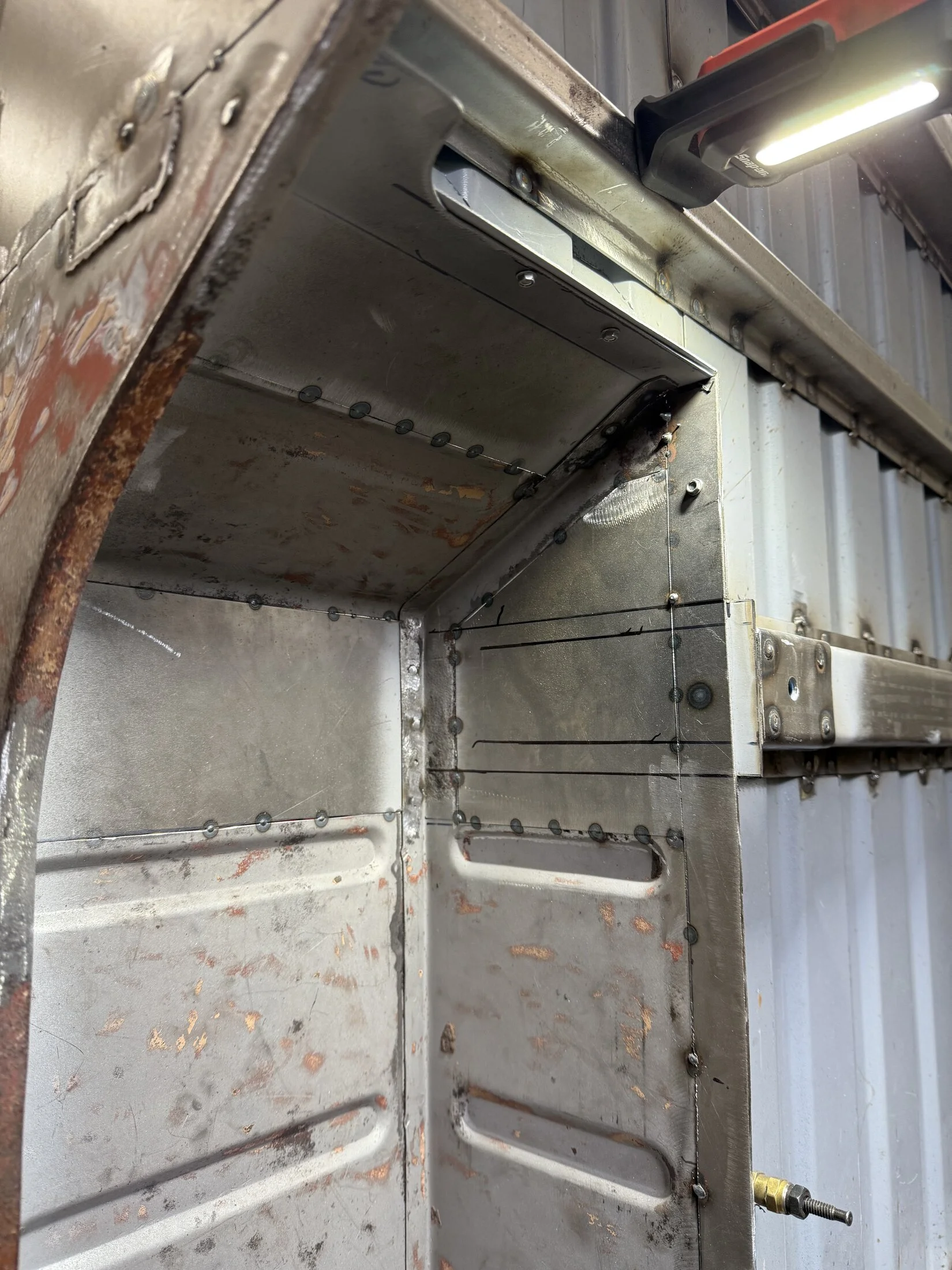

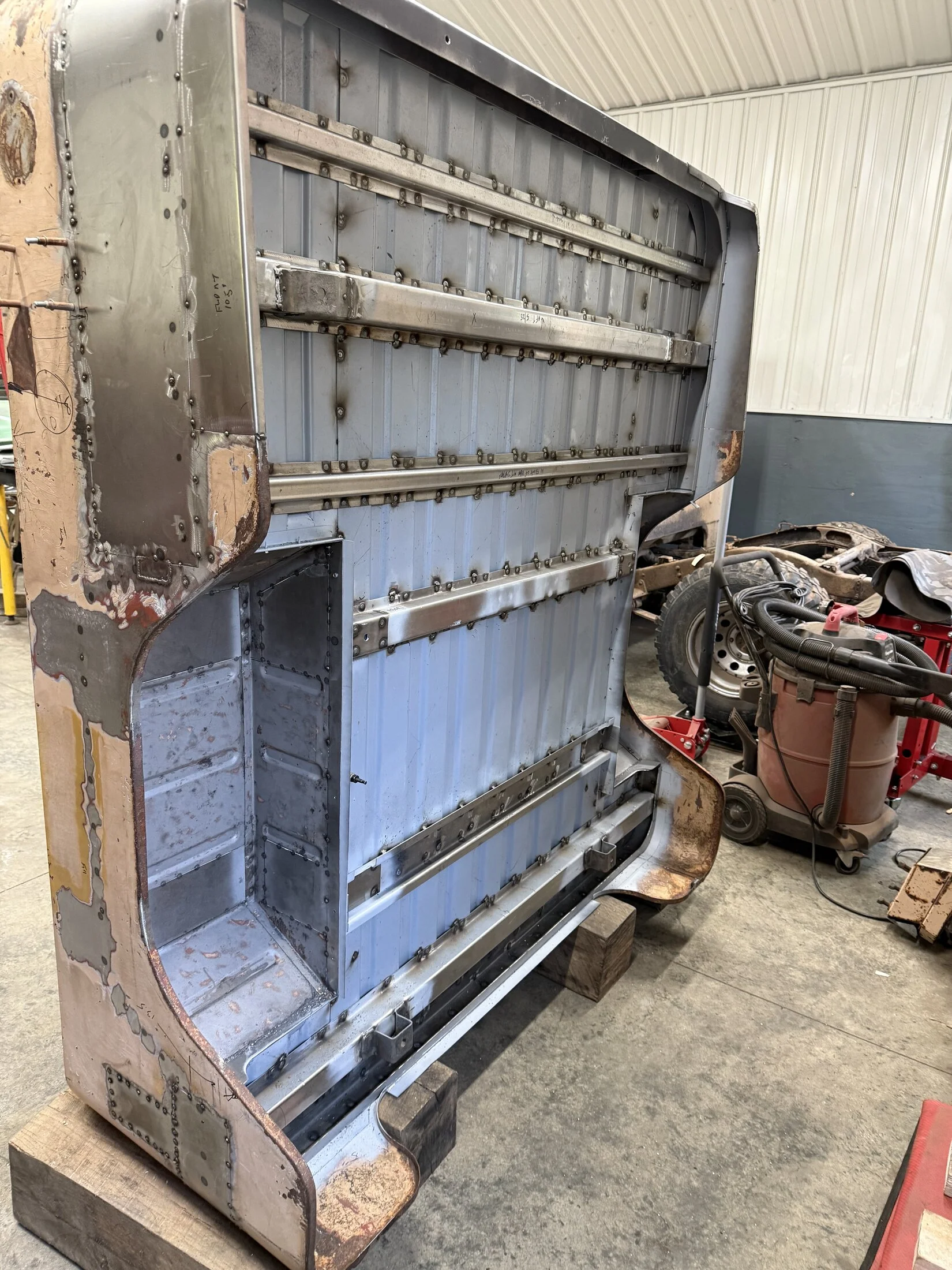

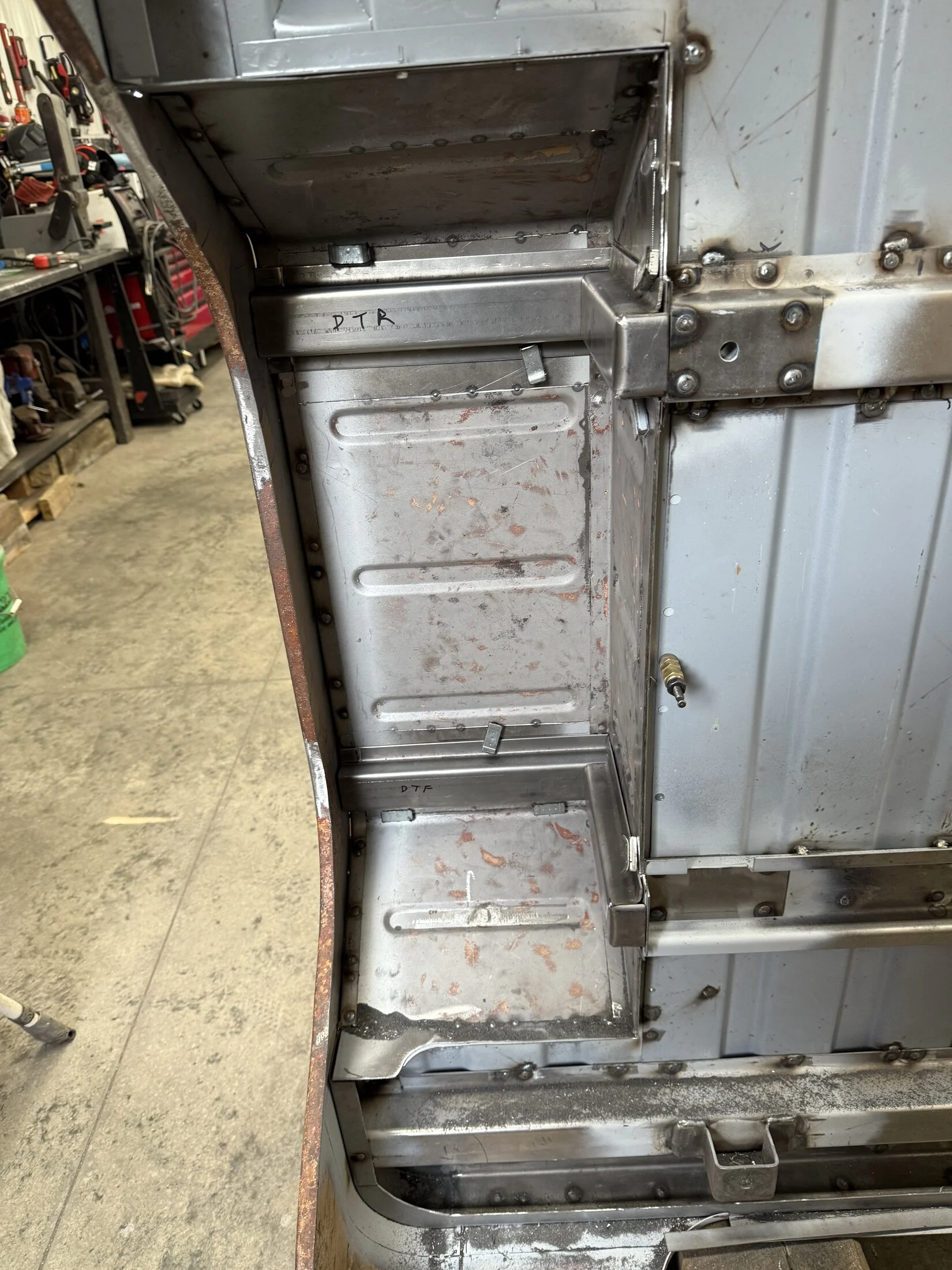

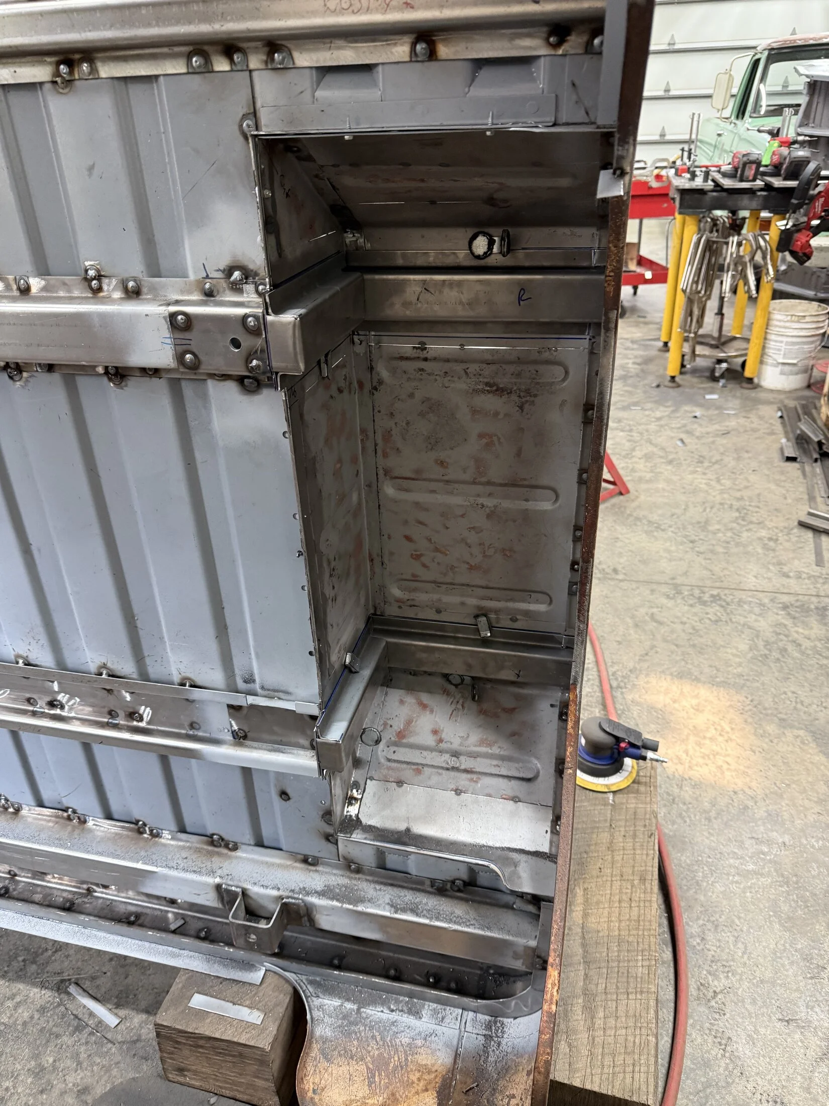

Finished welding bed supports , removed floor bracing and cleaned up some spot welds. A lot to go.
Great work. How many hours do you think you’ll have in the bed when you’re done?
If I had to do it over I think I would buy one, but will have about 1k into this bed so thats something to consider. I guess I also like the challenge.
Where would you buy one? I’m trying to figure out if an s10 floor is the way to go. It’d be nice if the short beds were available.
I built a new LP bed had about 200 hours with no body work they are an incinerator for time if you take your time and build it right and figure in for no warpage. What the hell I have more time than $money

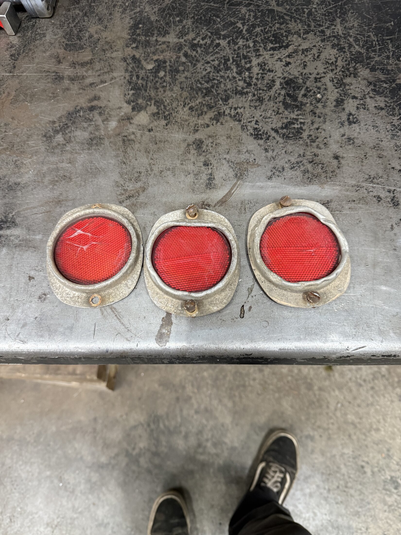

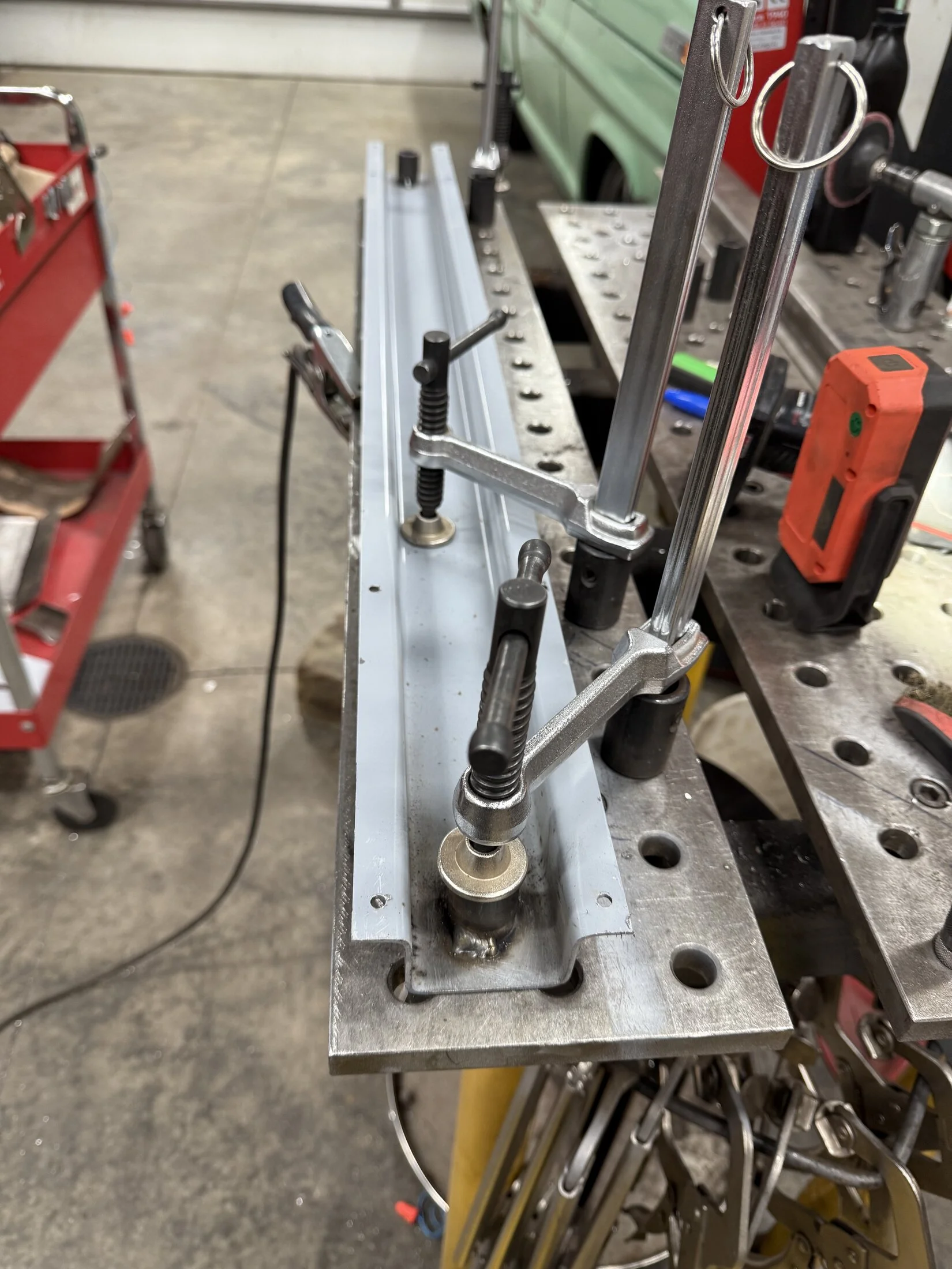

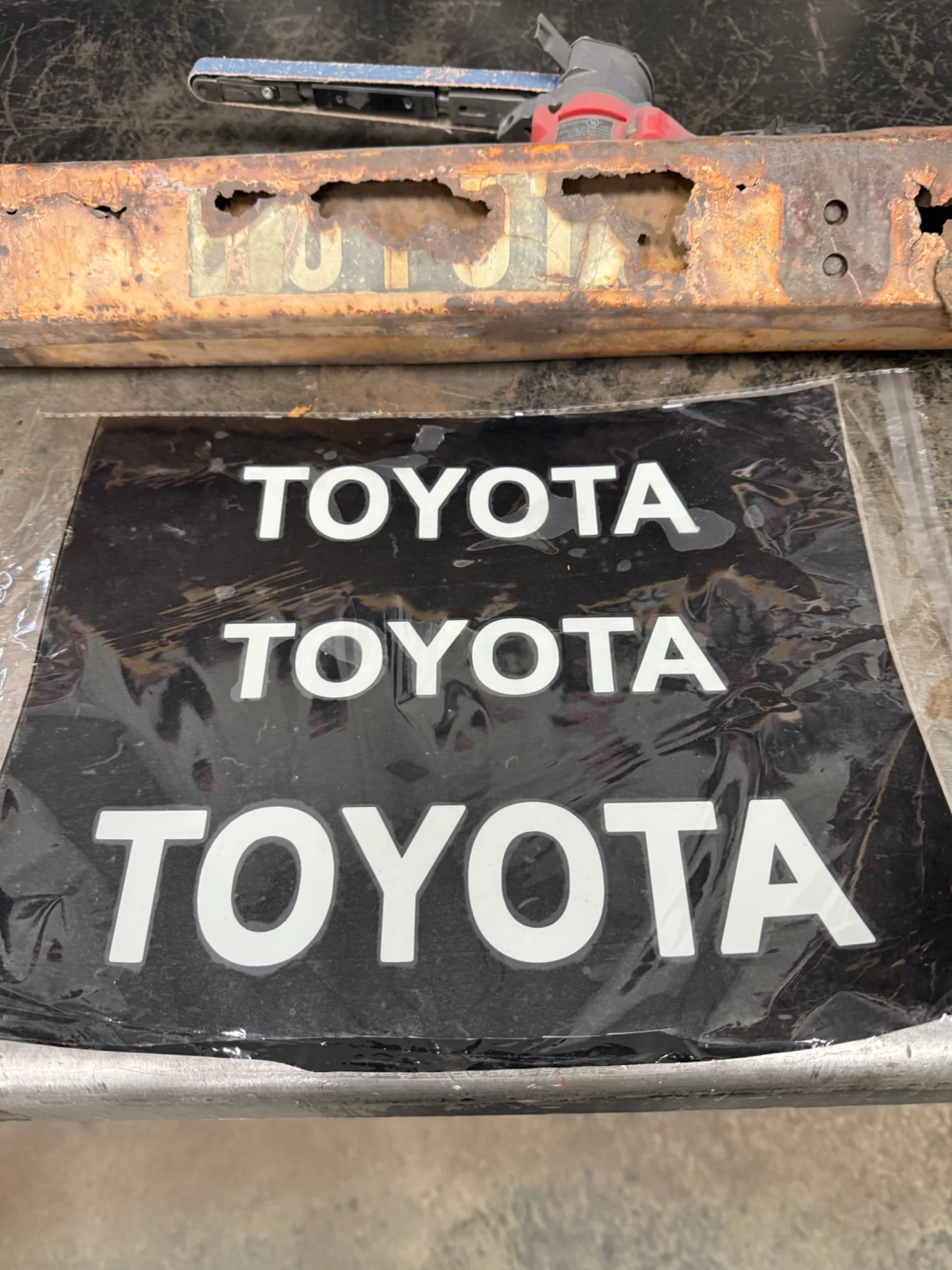

Is there any reason to keep these? Are they available new? Im leaning towards filling holes and deleting.
I’ll take them if you’re going to toss them.
They are still available new:
I guess I was typing it at the same time as @tahoe40/45. 🤣
