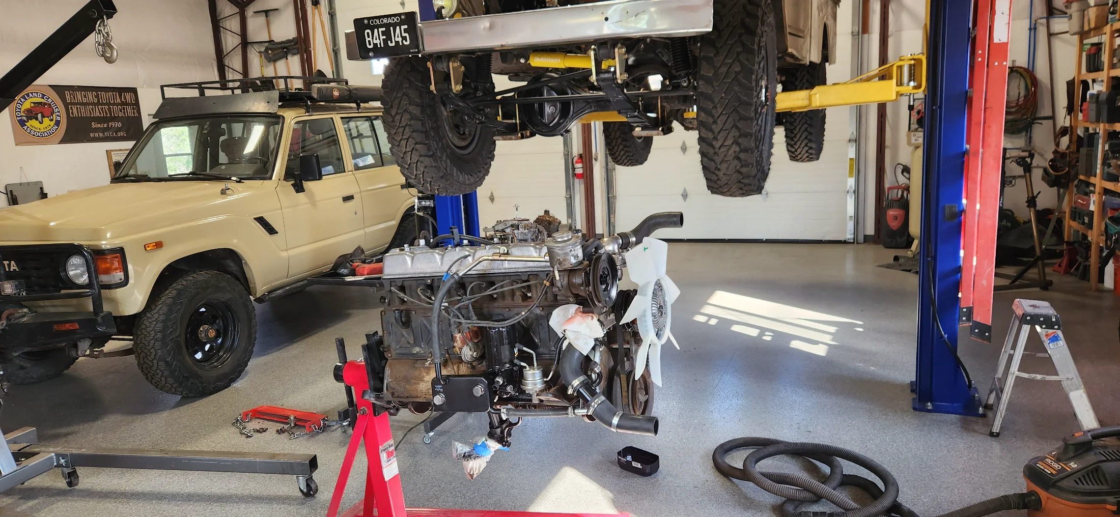

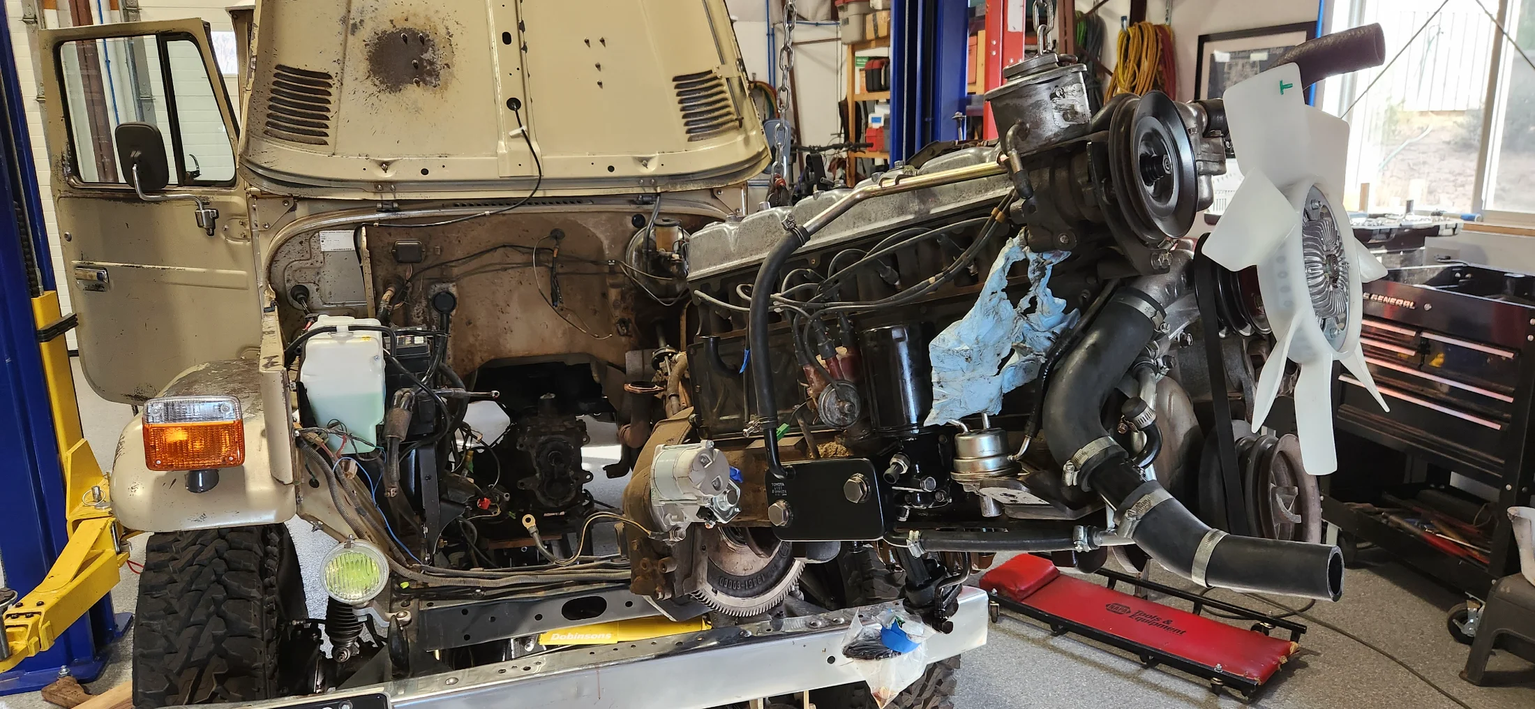

Tranny/transfer and motor out.
Clutch cover and disc, flywheel, starter, and bell housing removed.
Motor on the stand ready to start taking stuff off tomorrow.

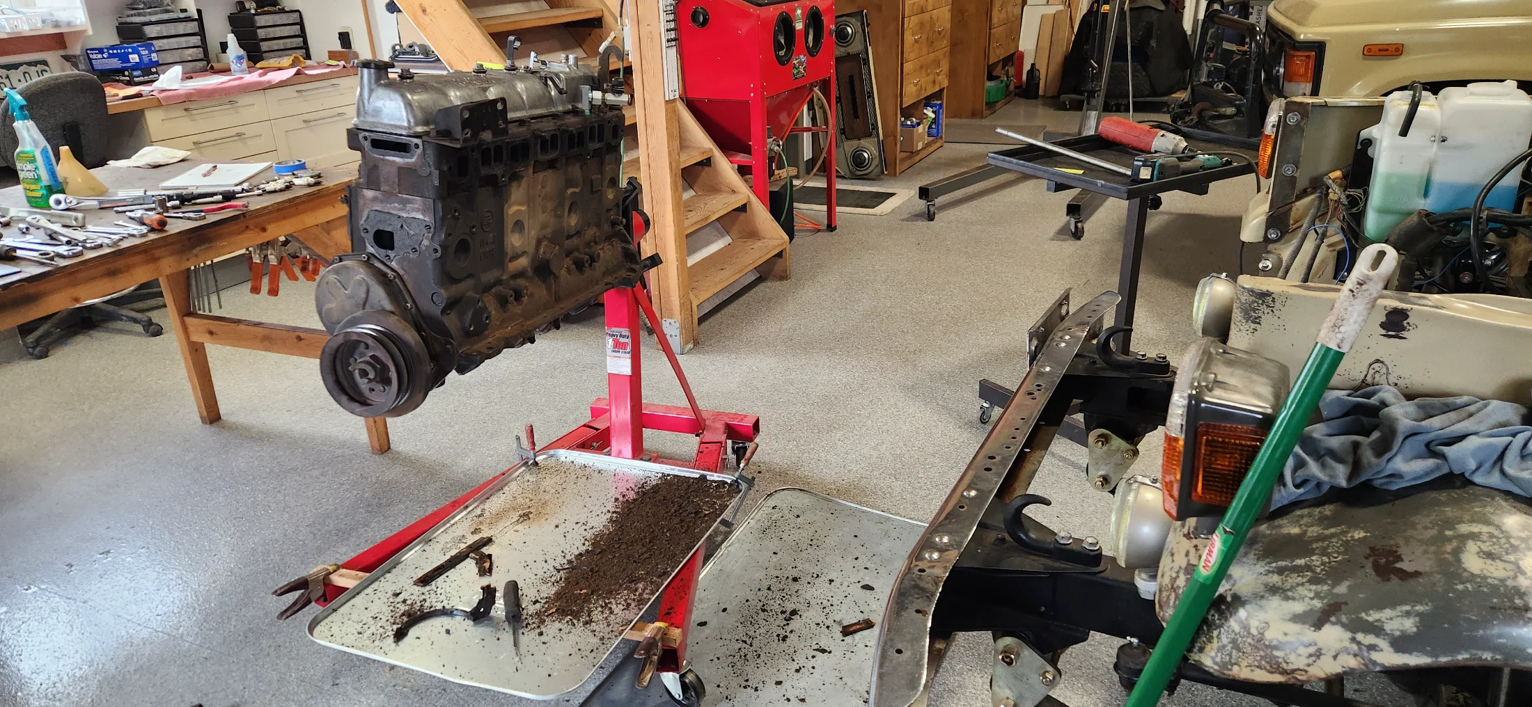

Didn't have a lot of time today, but got the block stripped down and the worst of the "Saudi cement" scraped off.

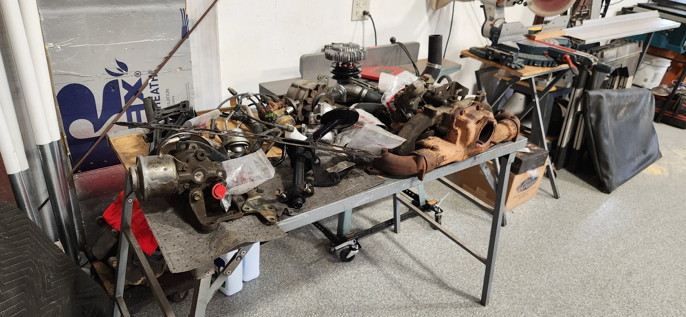

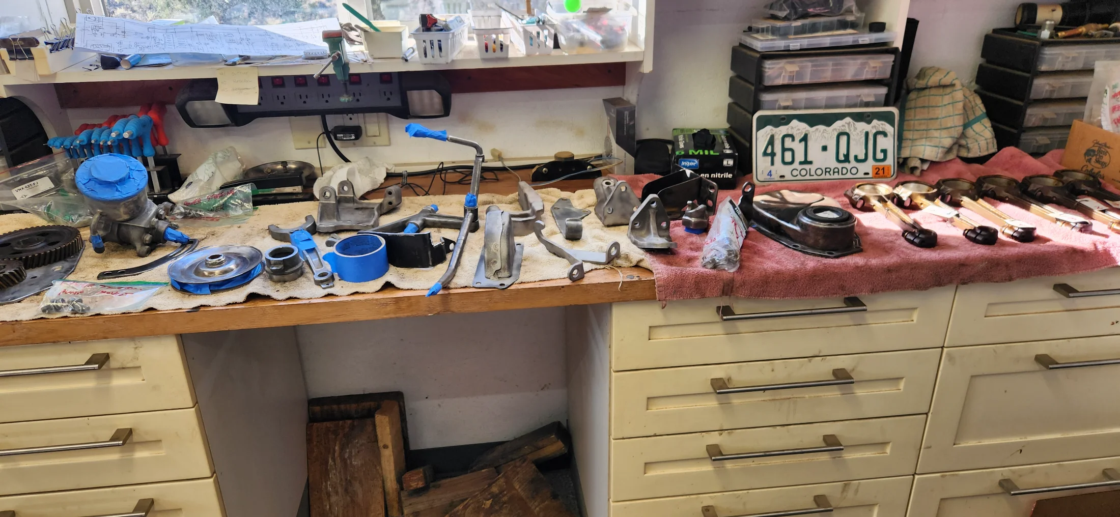

A table of treasures
All torn down. The only thing left on the block is the crankshaft, and that will be out tomorrow morning.

More parts
And don't forget there is more work after the motor.

Crankshaft is loosely installed in the block for transport to the machine shop. Head with valves and springs and rocker arm shaft assembly installed, connecting rods, harmonic balancer with nut, flywheel with 3 dowels and mounting bolts are all ready to go as well. I will probably make the drive next week.

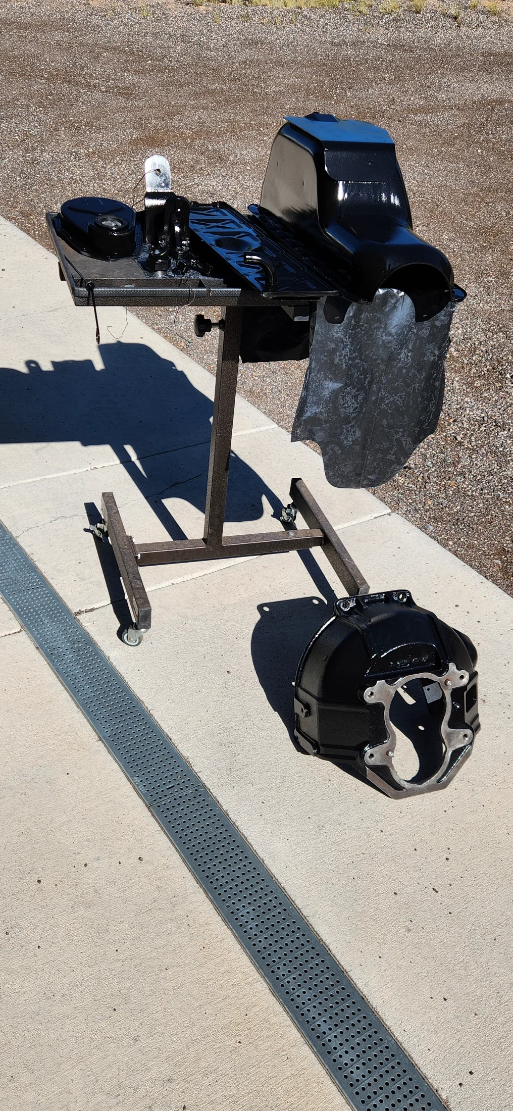

In the meantime, been cleaning parts and prepping for painting- love that Saudi Cement.

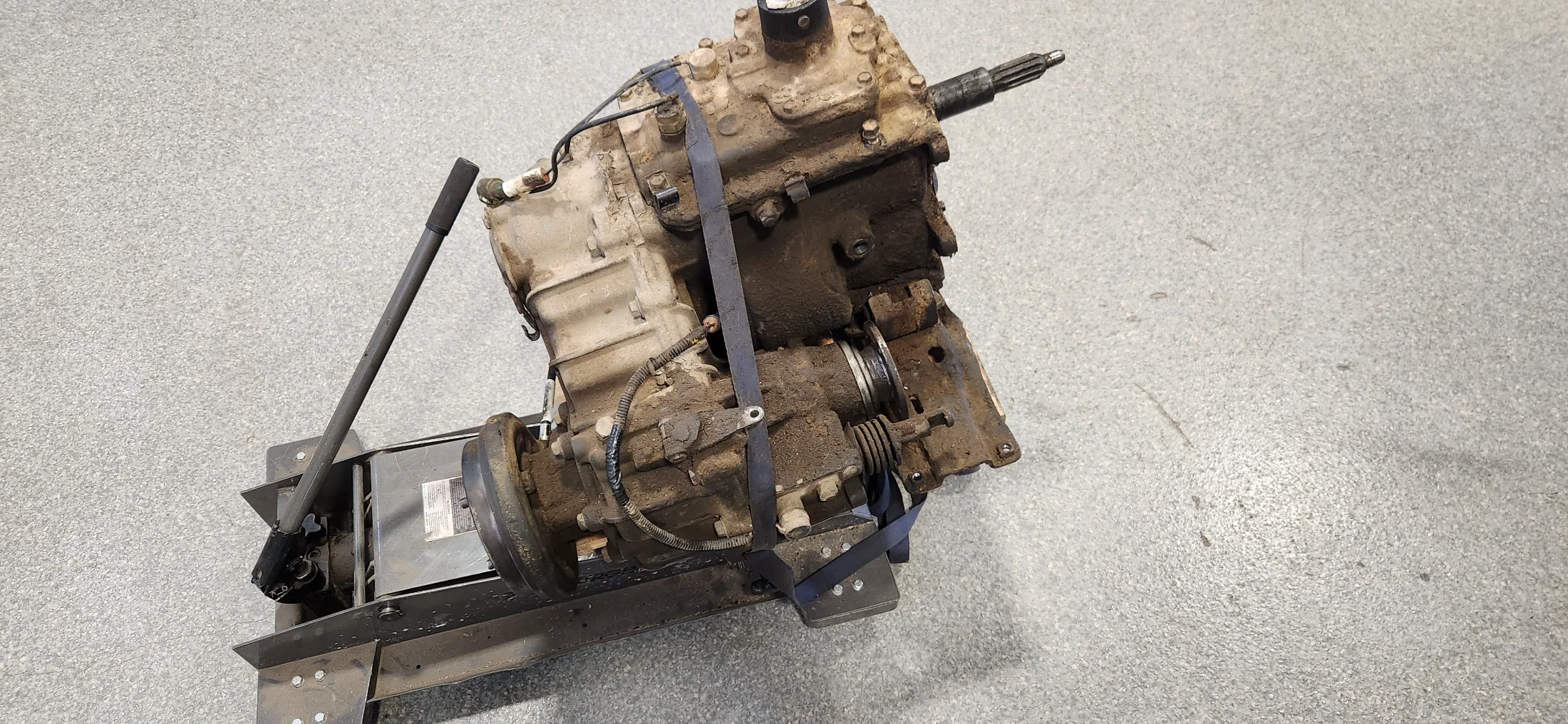

Took a first pass at de-grunging the tranny/transfer. Zep orange soak, scrape, scrape, scrape, scrape and then scrape some more, power wash, and prepares to scrape and wire wheel.
Almost have myself talked into separating the tranny and transfer to get them really clean and to do a "since you are in there" transfer rebuild.

More cleaning and painting to do in the mean time, and looks like now the transfer will definitely get a rebuild.
Poor man paint curing at 6700 ft elevation on a cloudless Colorado day. IR gun read over 150 F.

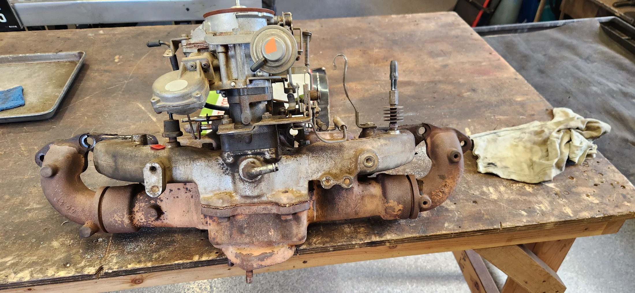

Intake/exhaust/carb next on the list for spa time

Did get the manifolds cleaned up.
And some new gaskets for the intake /exhaust manifold connection.
