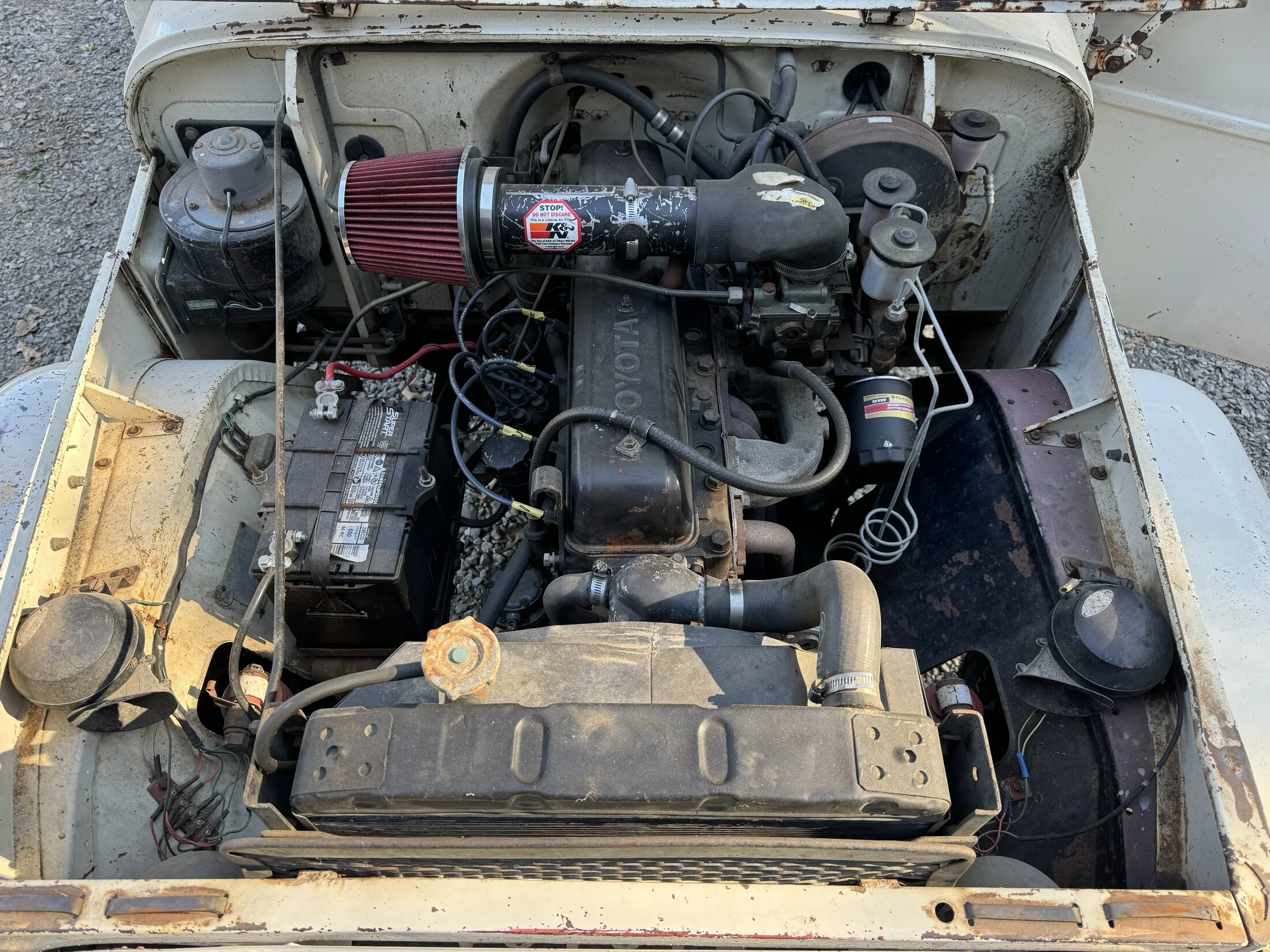

Here is the last photo of this truck ever with that hideous K&N filter setup. RIP

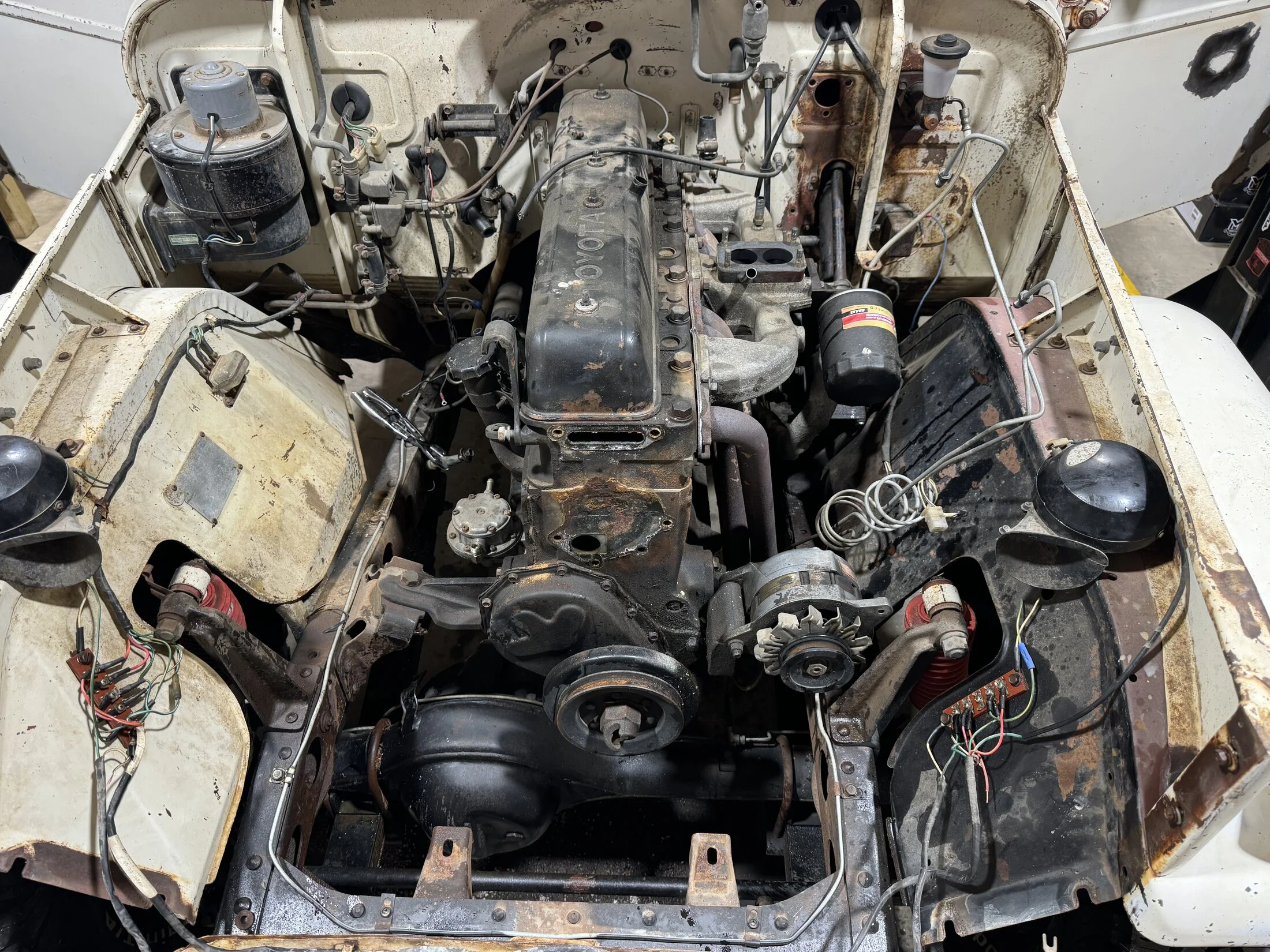

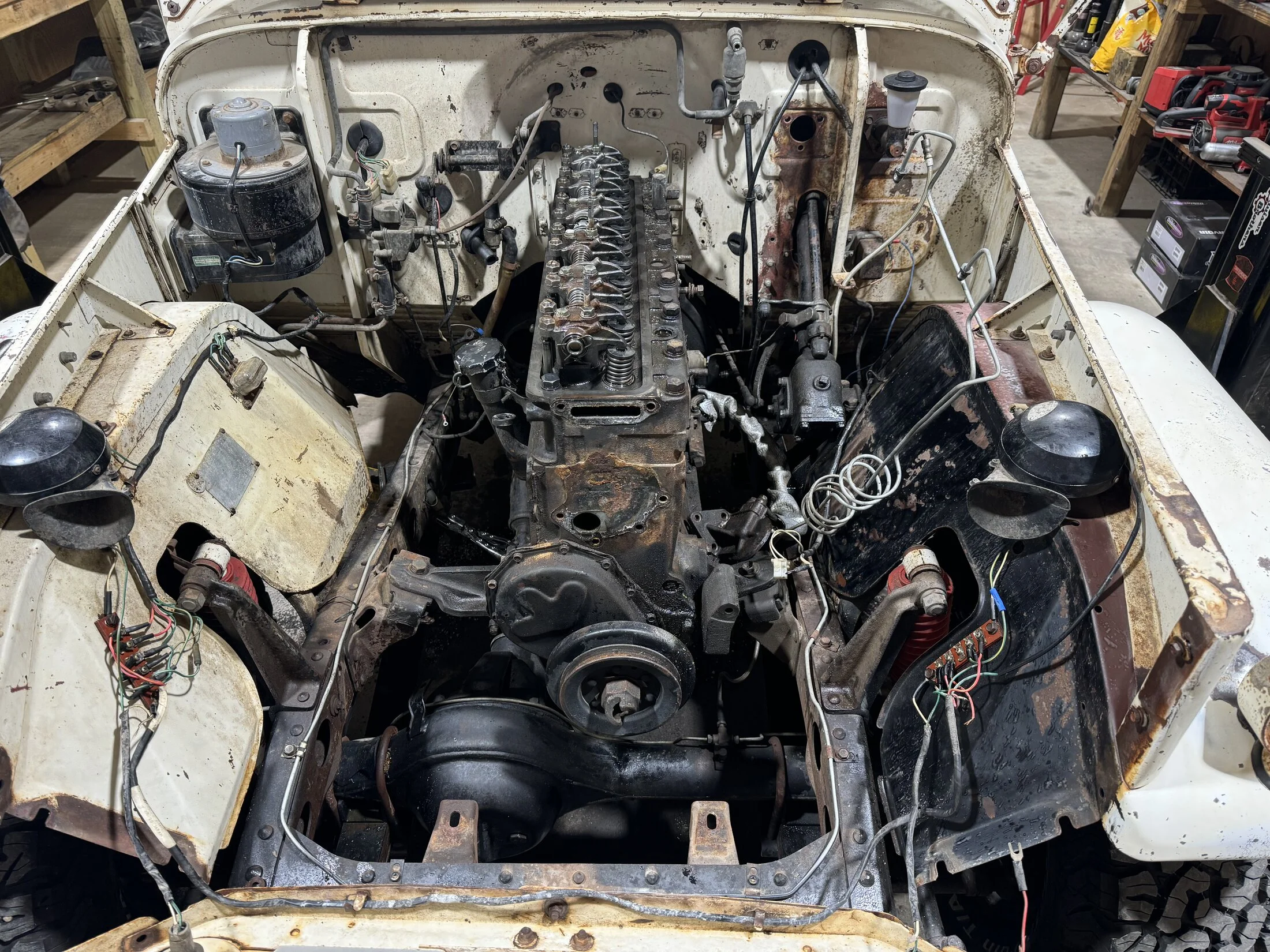

As mentioned earlier, this one was modified but really other than that air cleaner they did a great job. The 1971 F145 is certainly a great motor when replacing the F135. Much easier to modernize as is the plan
And those that follow my builds know I like to strip them down to the long block and have everything powdered and add new accessories all around to know when it leaves here everything I could touch got replaced or repaired

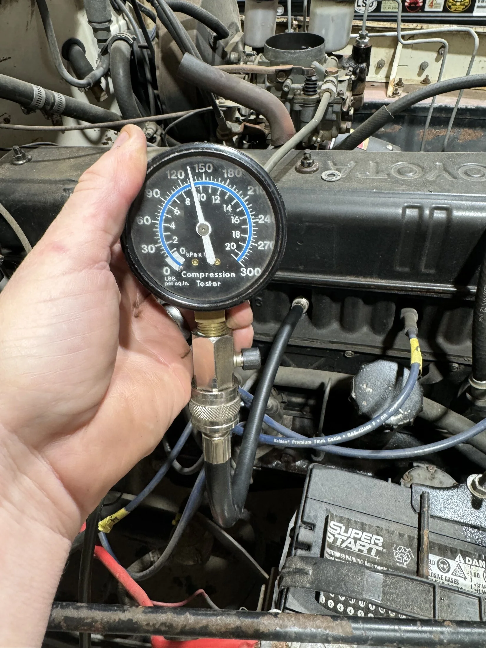

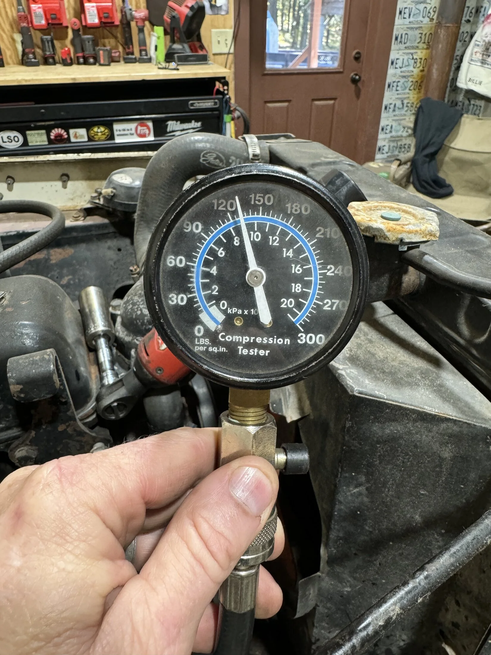

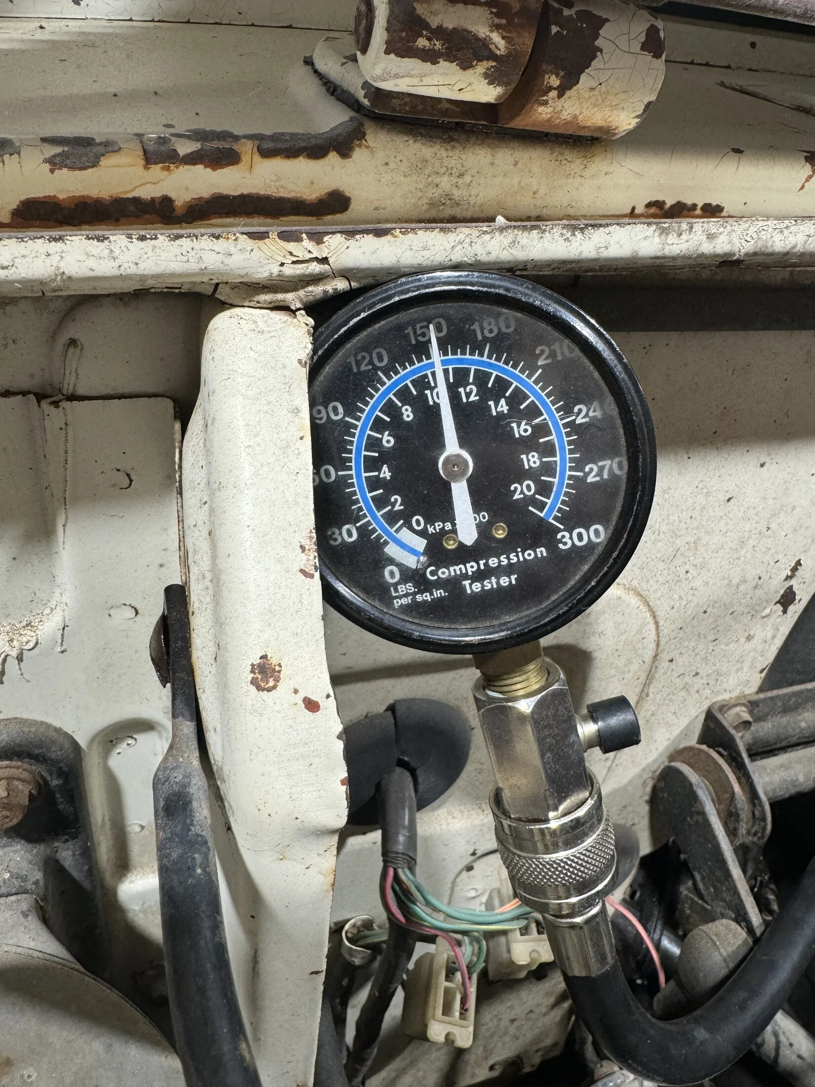

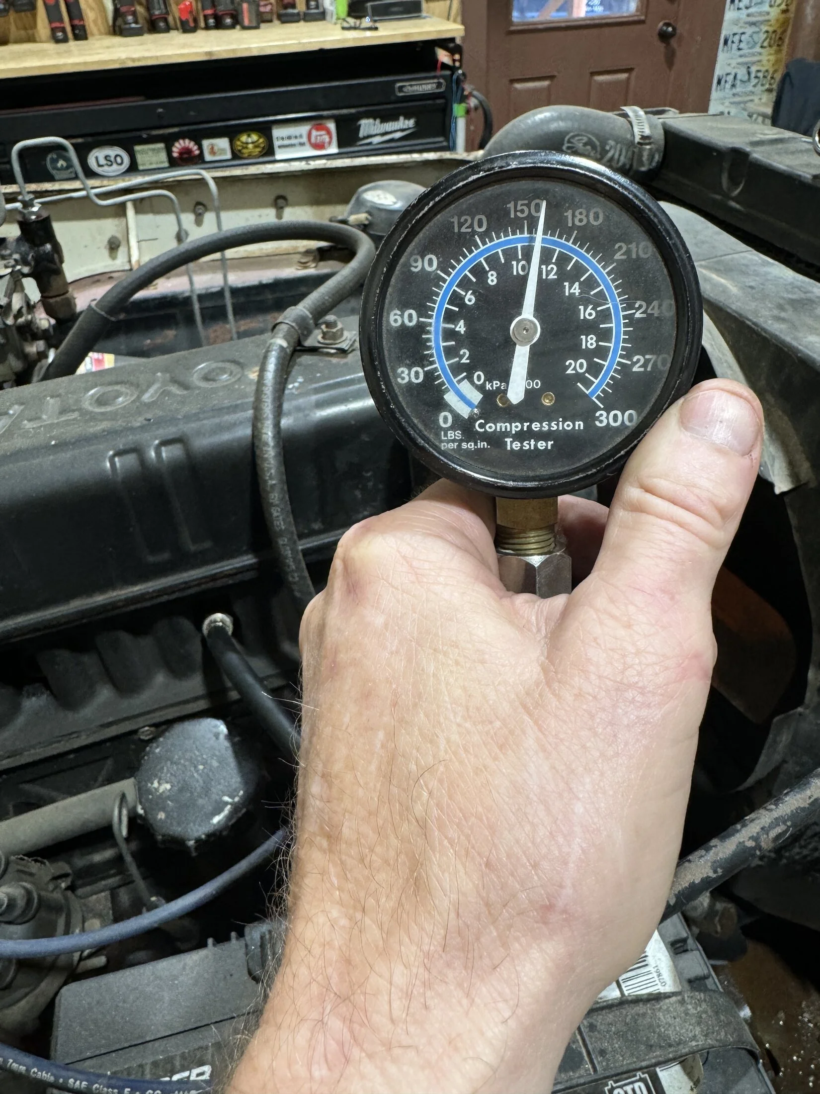

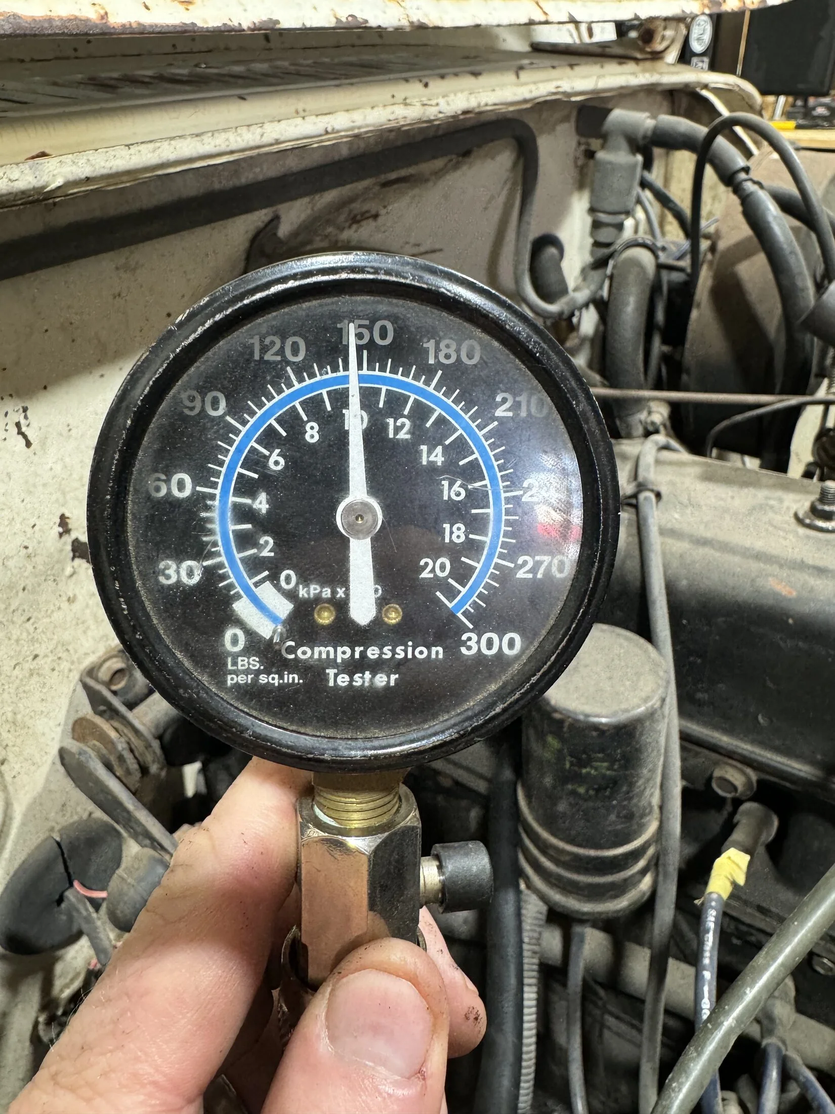

Before I unhooked the battery I went down the line #6 to #1 and confirmed this is a very solid F145. It felt good and sounded good and these compression numbers show it’s very healthy.

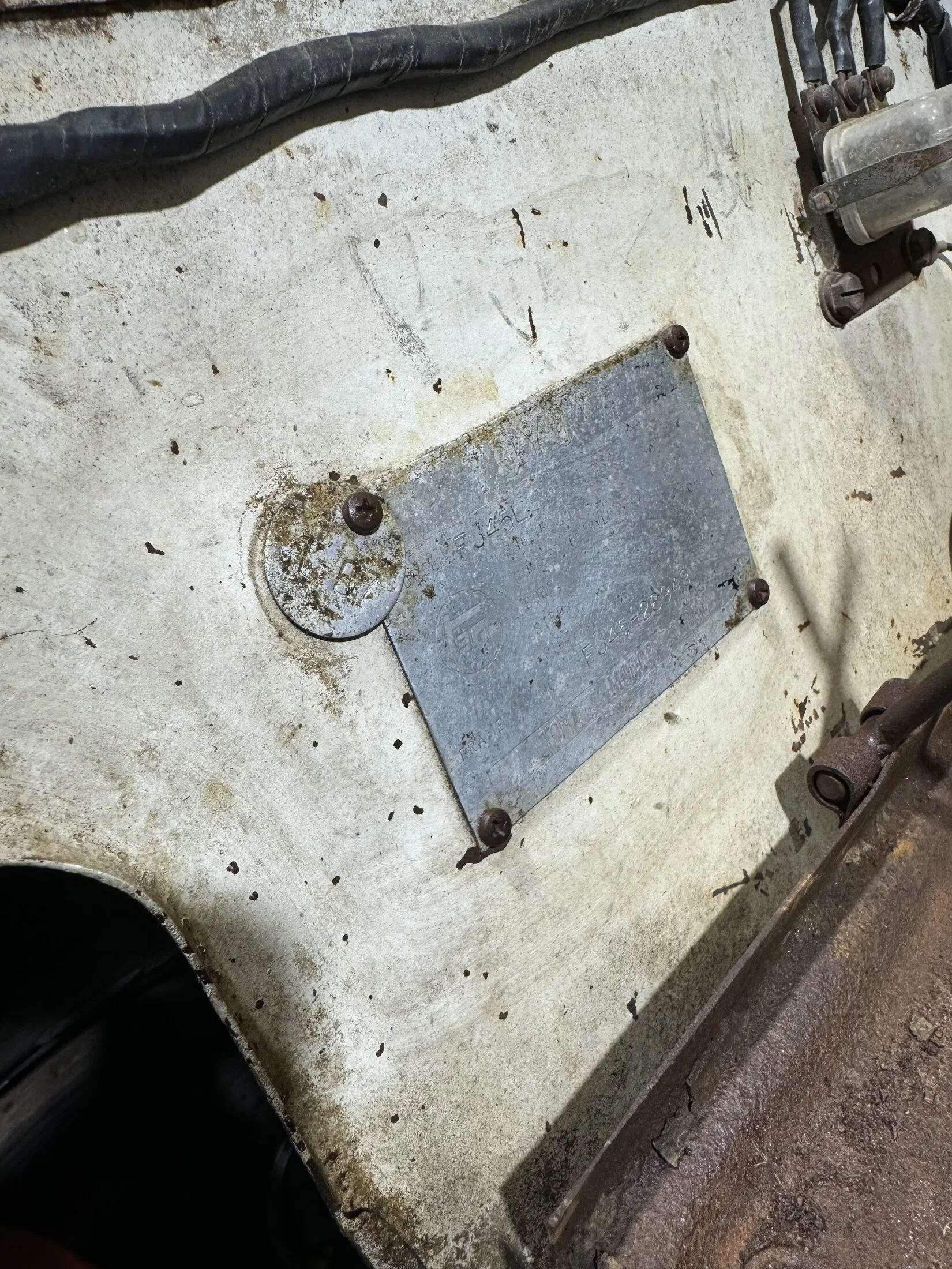

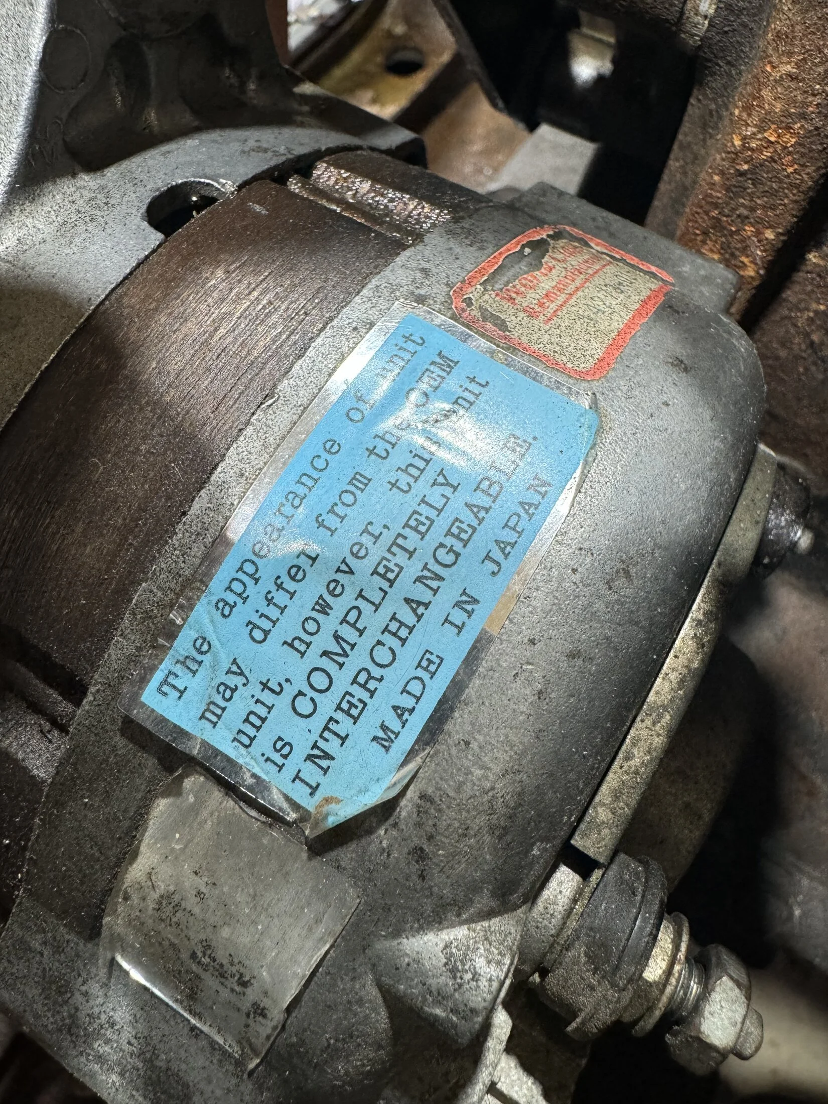

Cool sticker. Have never seen that one before

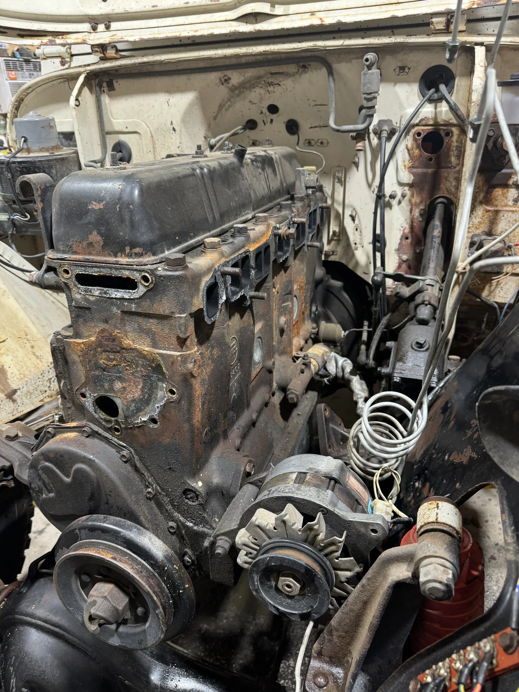

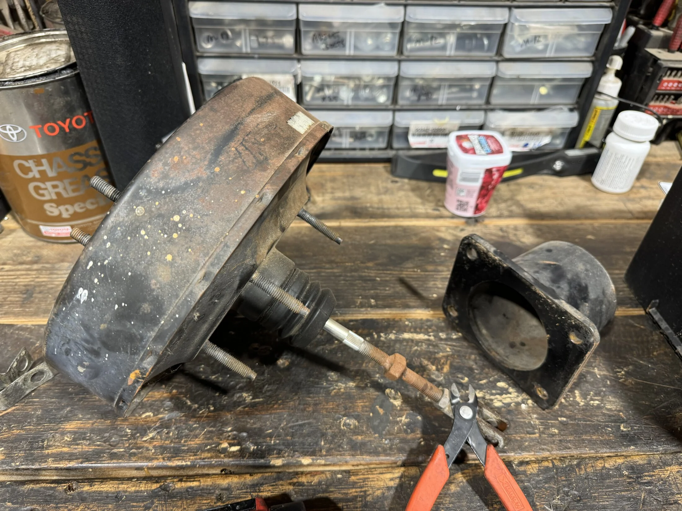

Not sure who made this booster kit back in the day. Man. That thing was a bitch to get off. Makes it SUPER crowded by the carb. I doubt it would even work with a linkage carb.
We are adding rear disc brakes and going full manual with an 80 series master like on my 45.
Getting there
Always pop the rear plug on these things if you don’t know the maintenance history. If that’s clogged up then you will always have cooling issues
One side down
Look at the heat shield they used for the oil filter lines

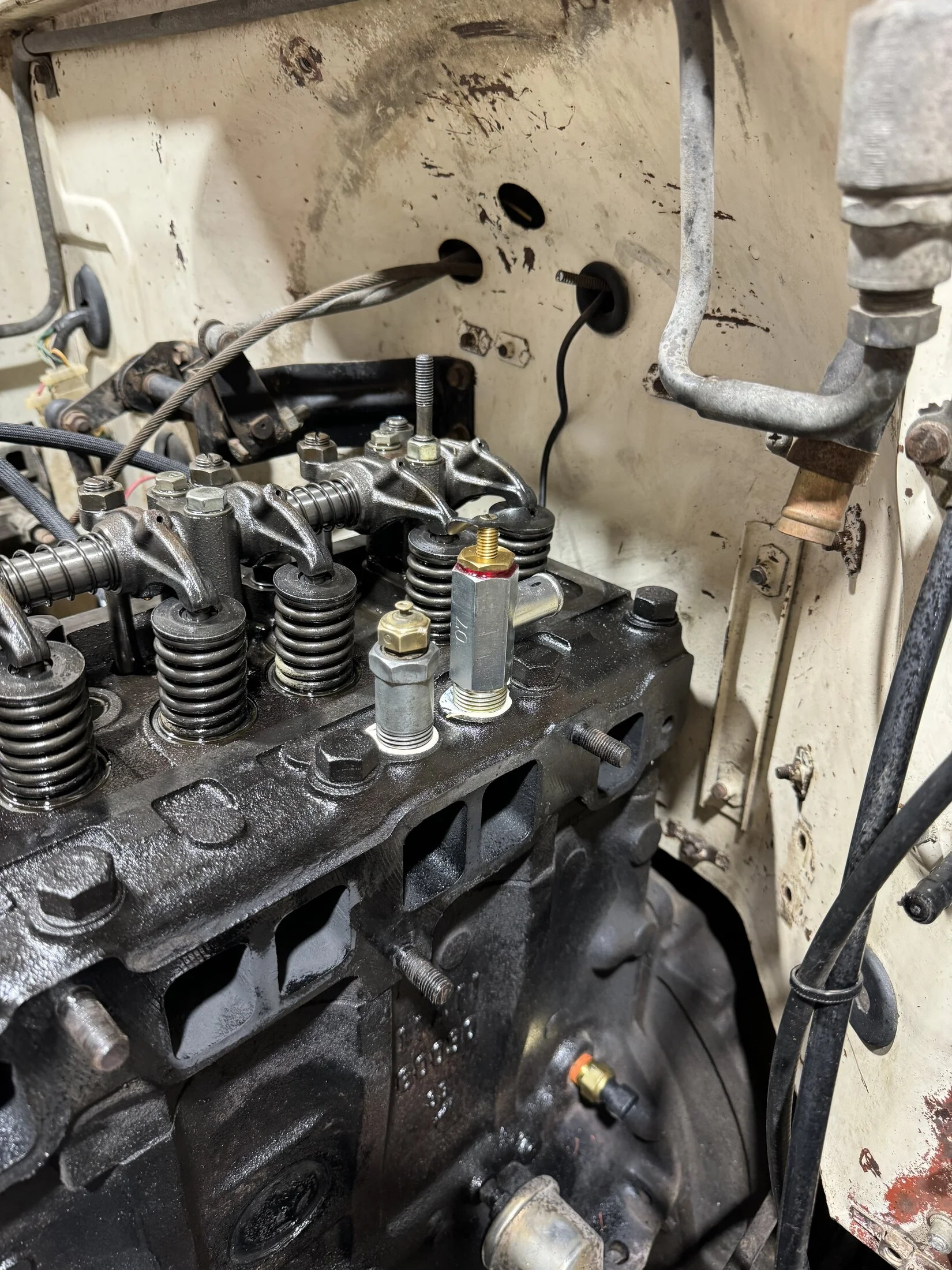

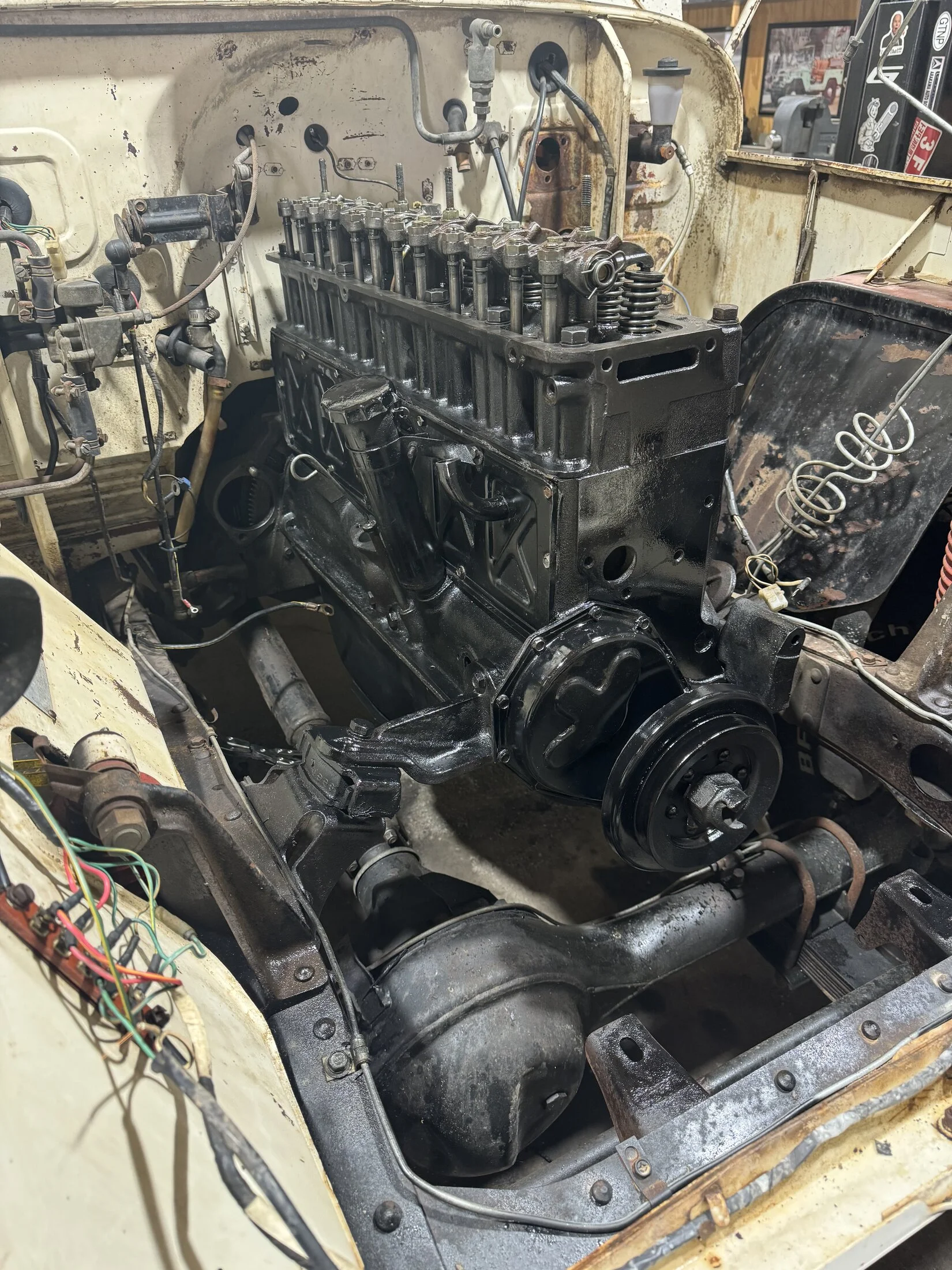

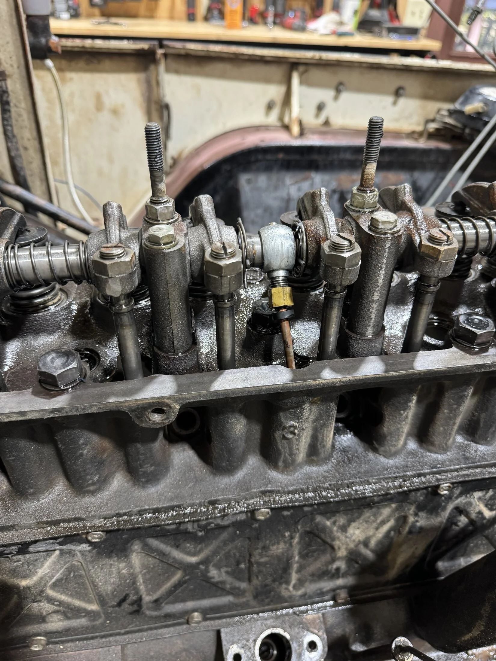

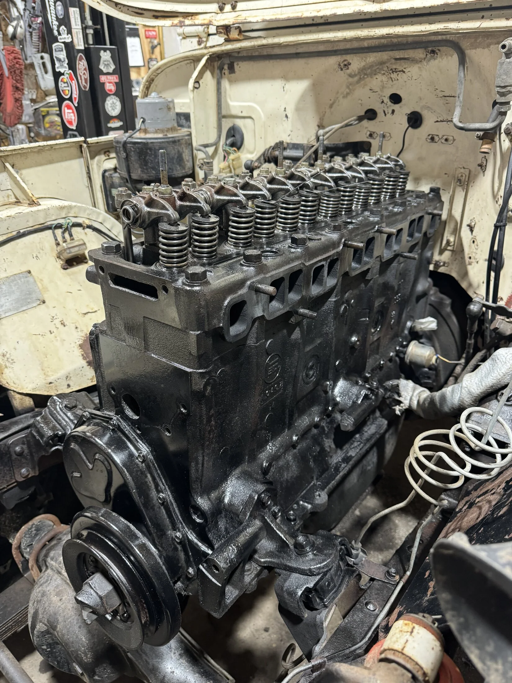

Popping the top you can tell this was a nice fresh motor. This goes great with the high compression numbers

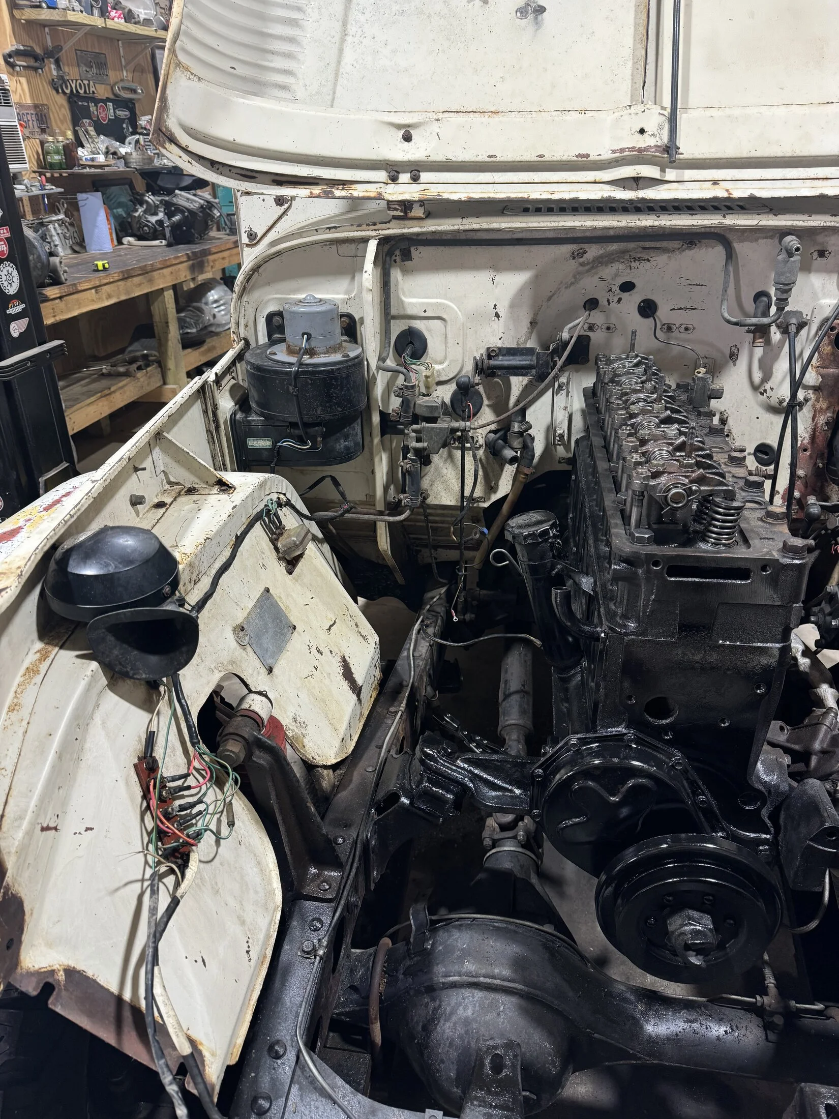

There it is. Naked and not afraid.

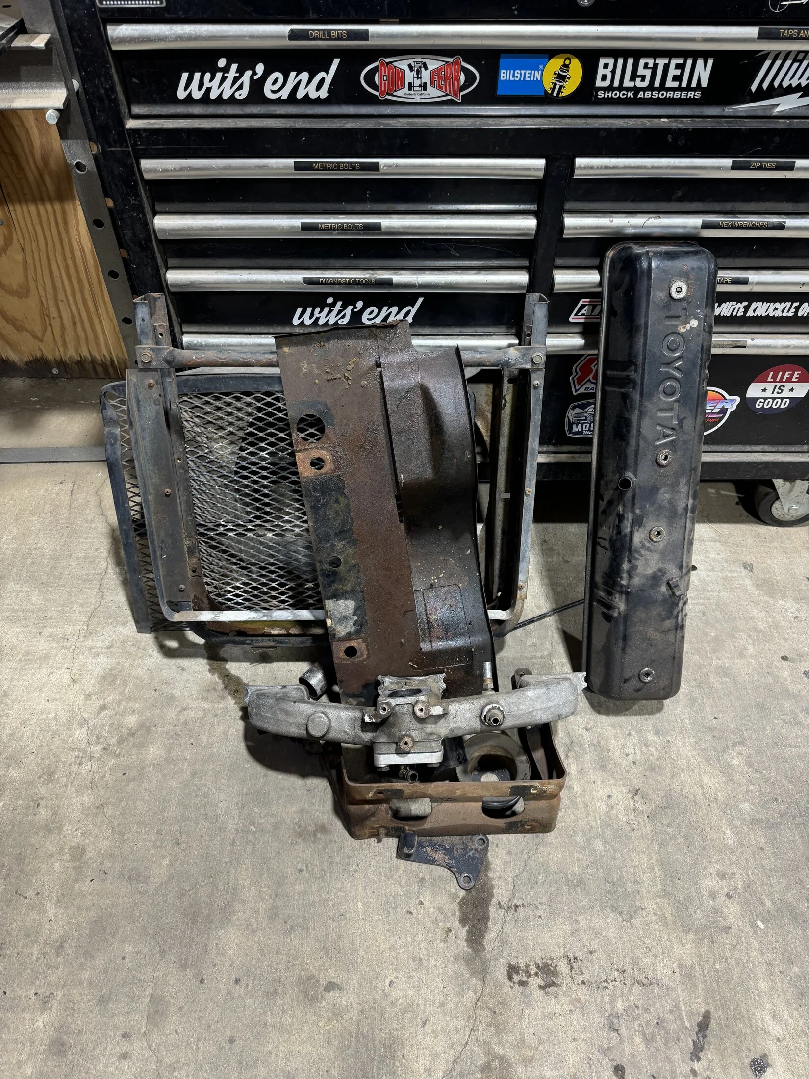

This is the pile of parts headed to Powder Keg on Monday

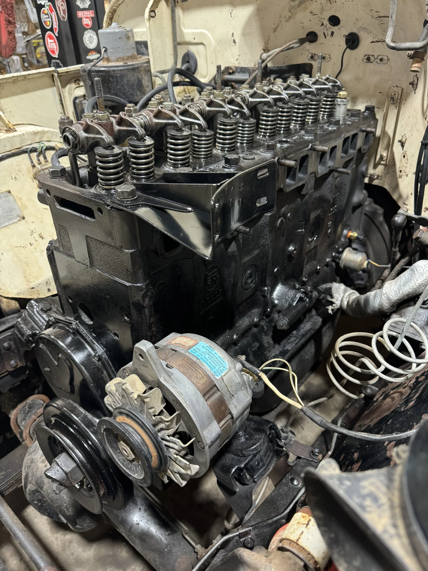

Got the entire engine degreased and repainted. Nice and leak free it seems.

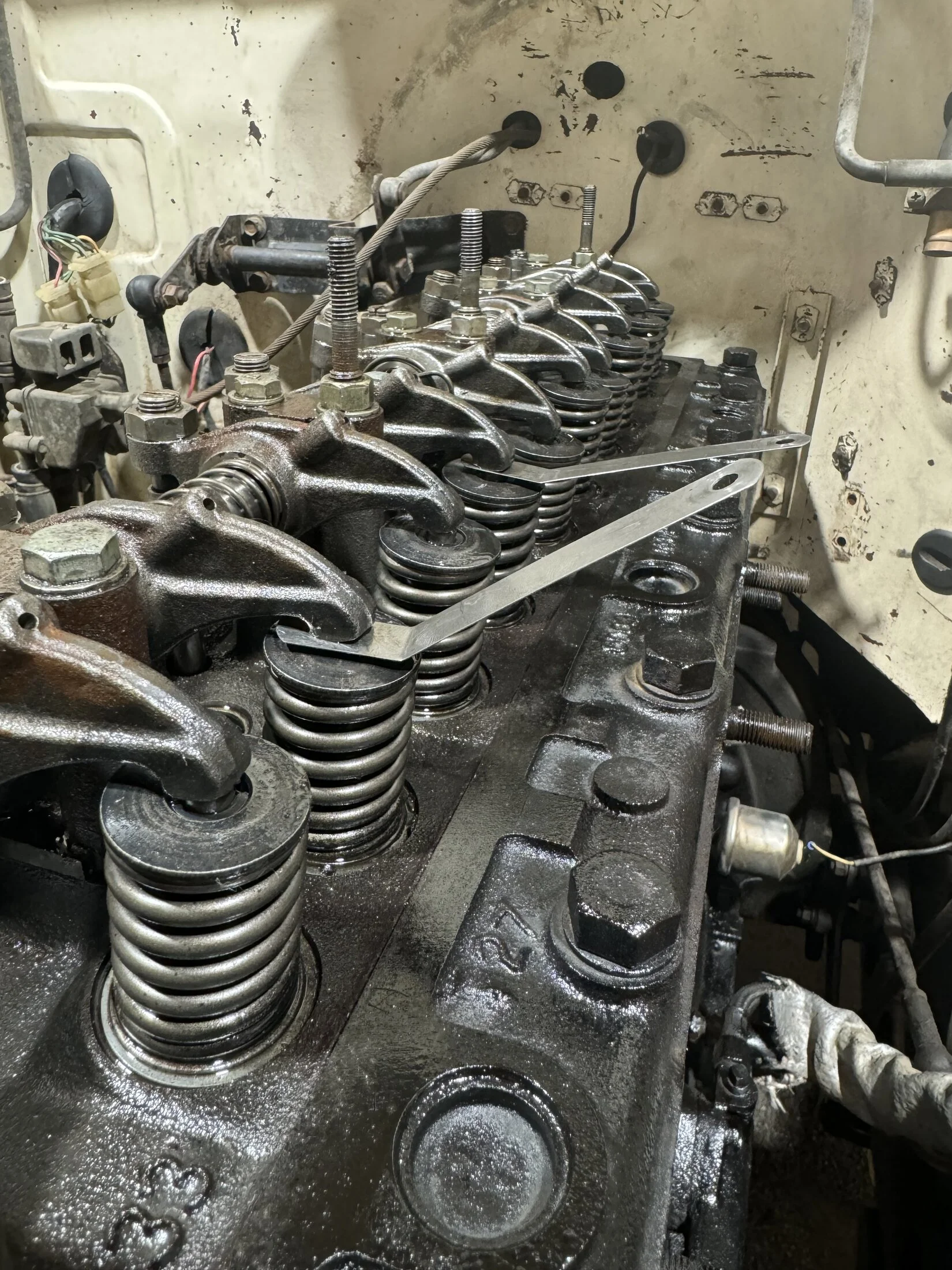

Valves were a tad loose so they got snugged up

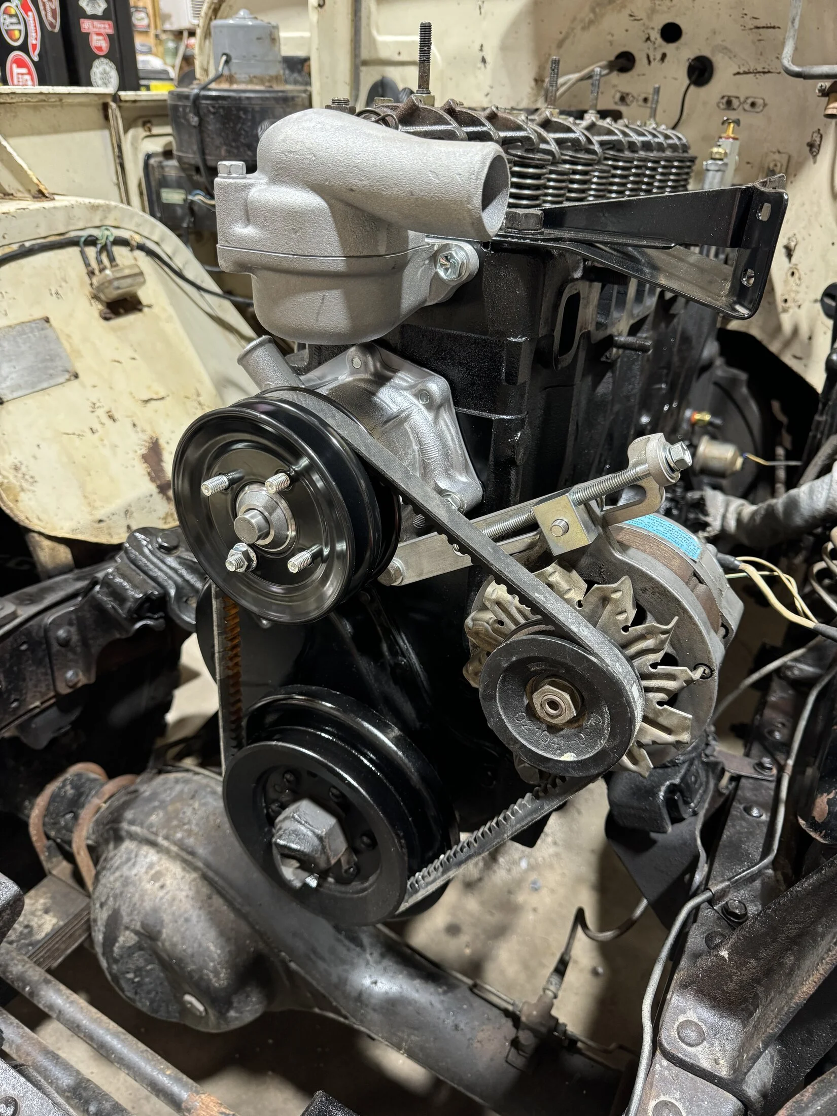

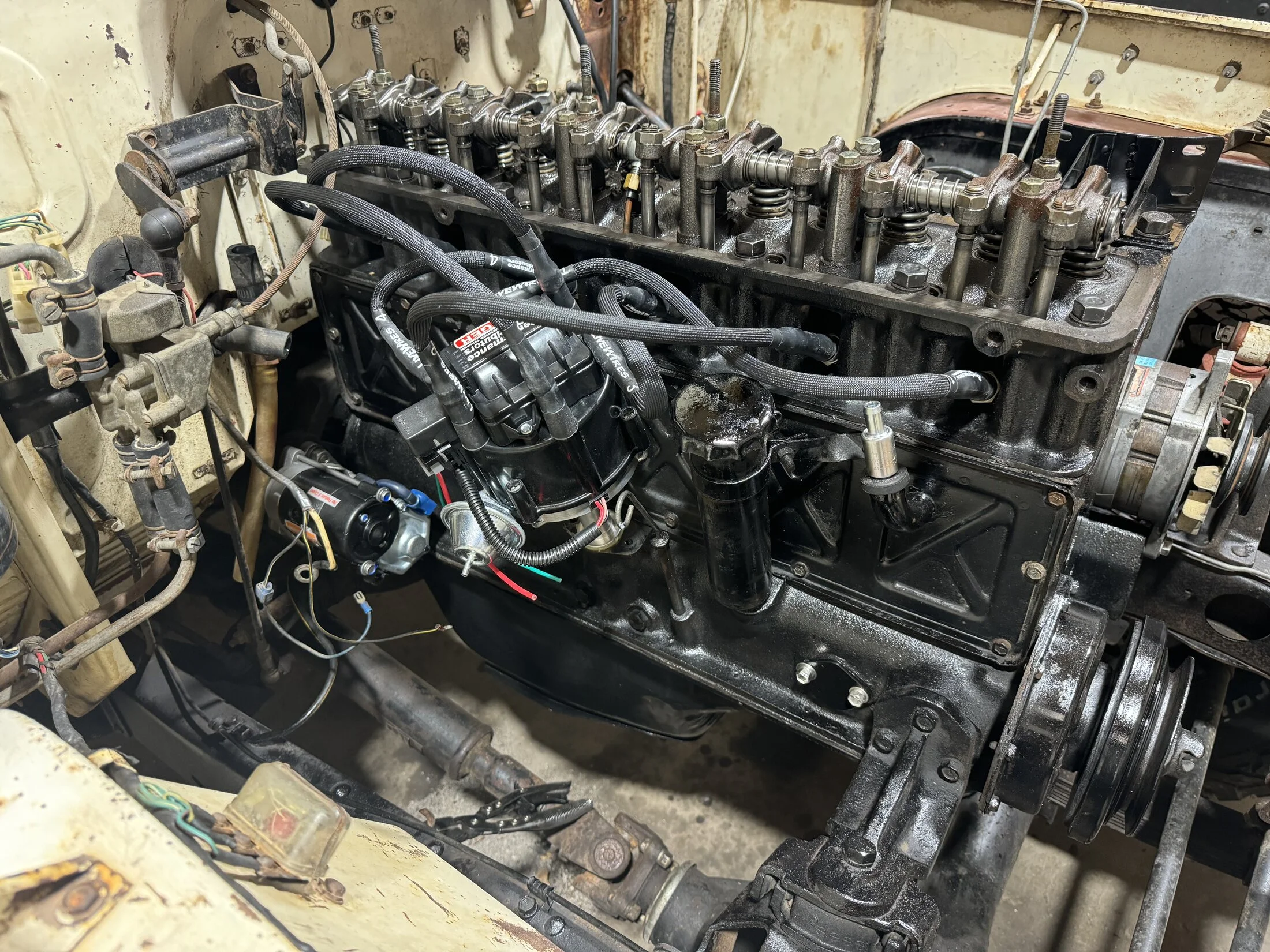

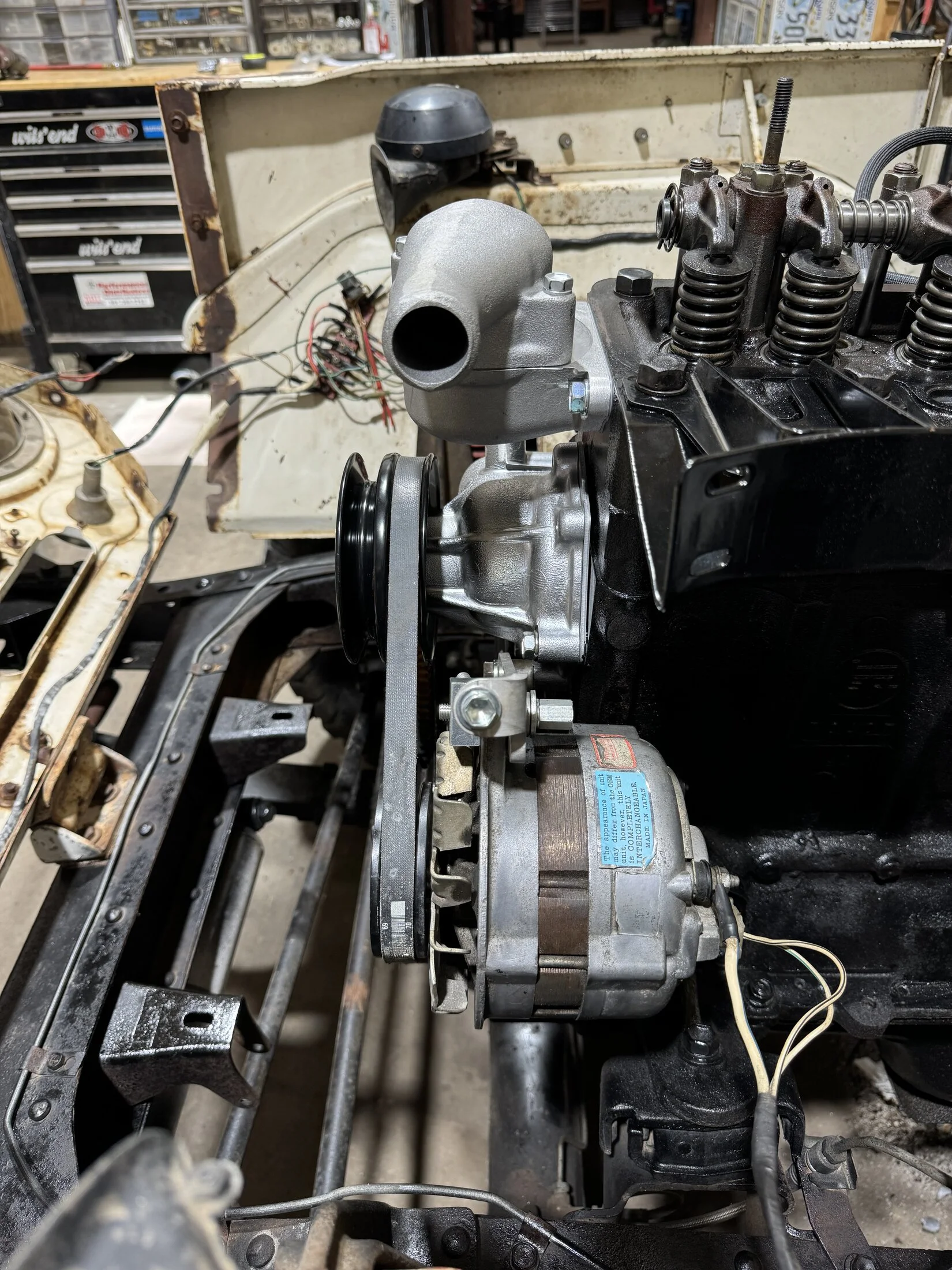

Started putting the few parts that arrived last week on. Sniper sensor. Air cleaner bracket. Cleaned up the alternator
This side. Fuel pump plate. Toyota PCV and new gasket. Gear reduction starter. DUI distributor and live wires with new Denso plugs.

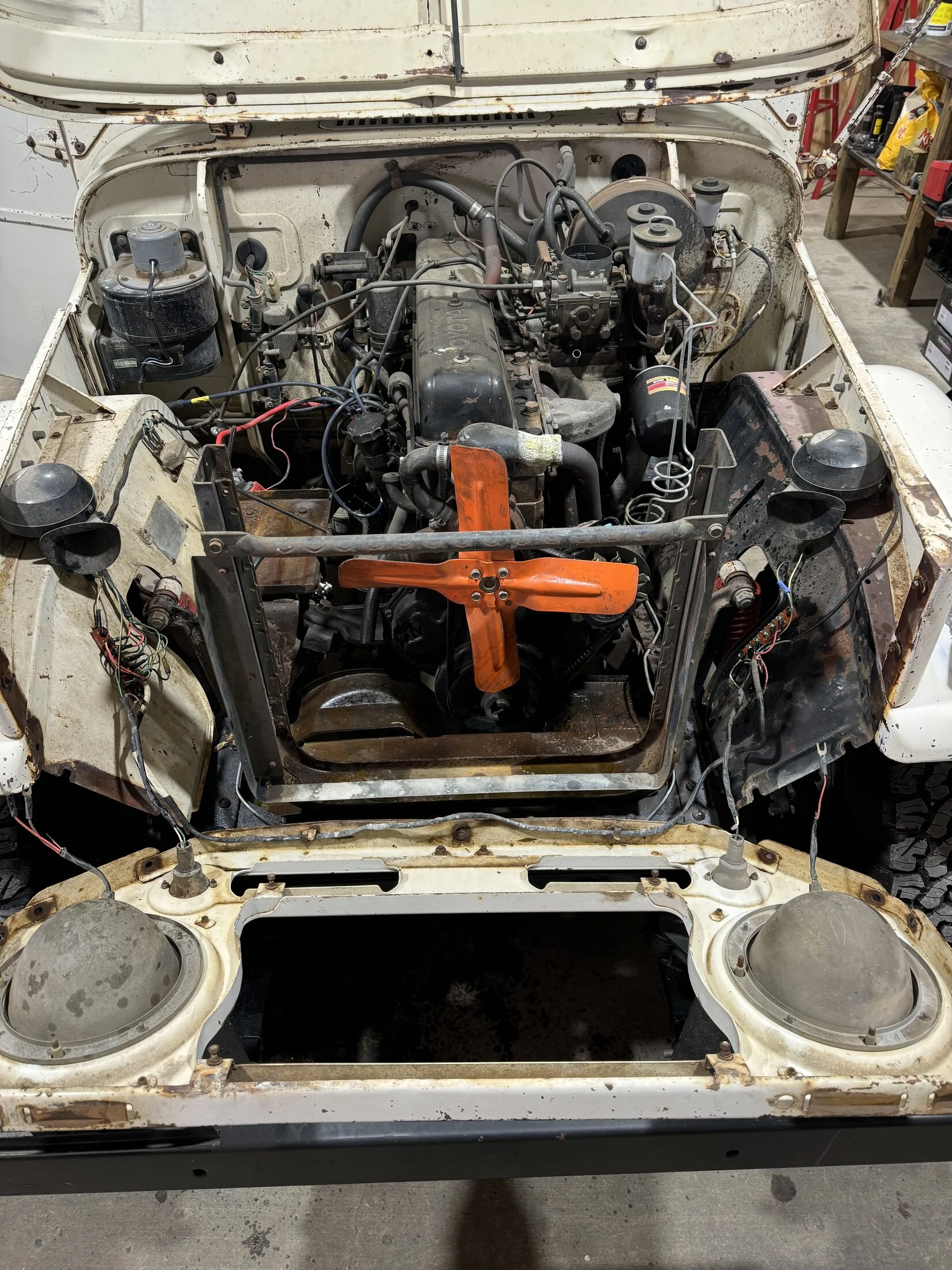

Took most of the day off from this yesterday. Had to go buy a new trailer. Get a new battery for this thing and spent some time organizing the parts that came in.
Today I started at noon because I delivered a 40 this morning.
Bolting stuff on.

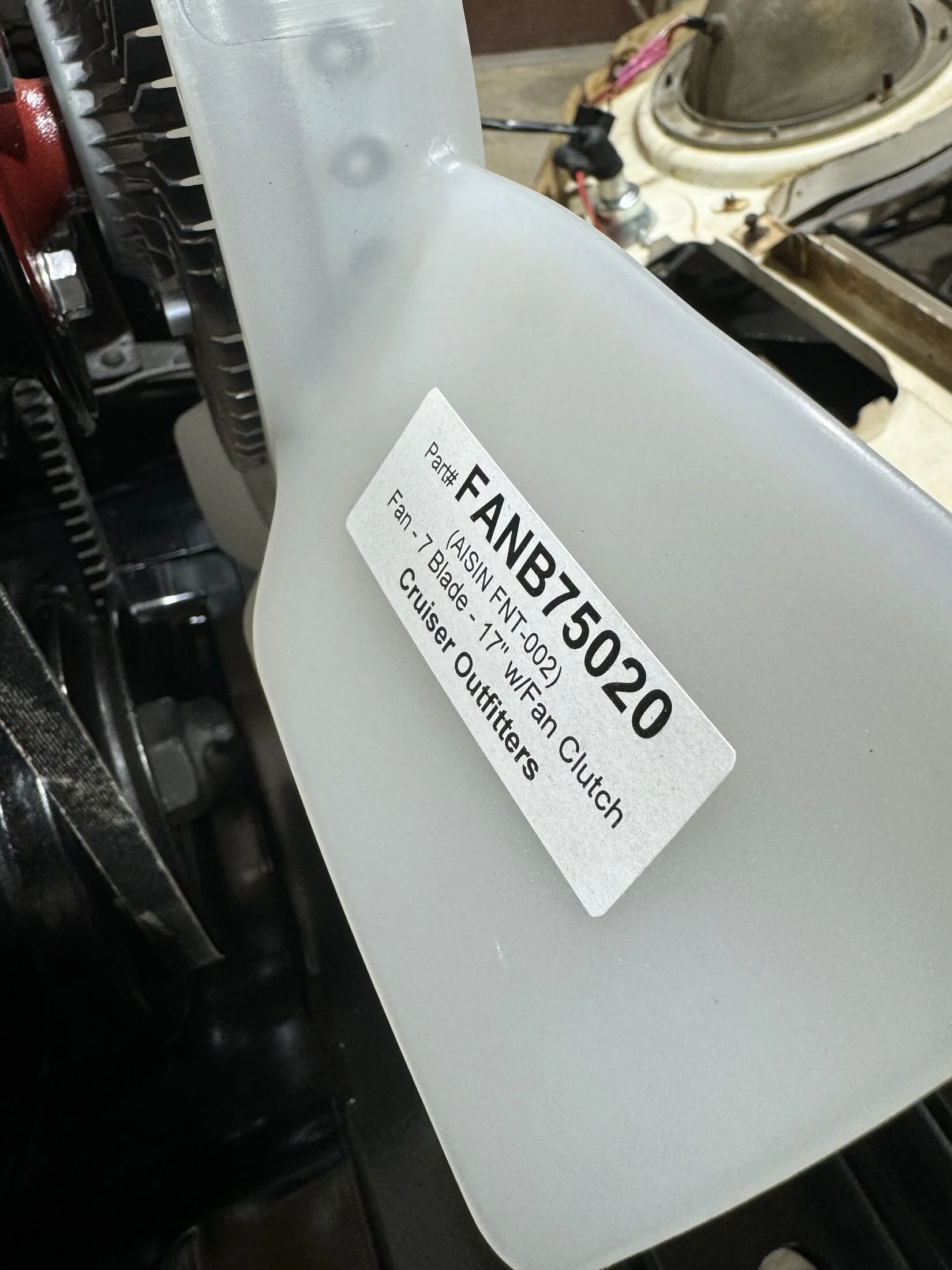

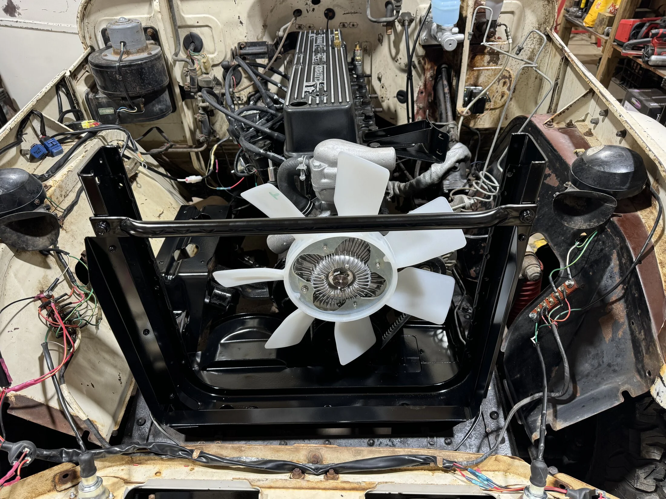

We decided to squeeze a fan clutch setup into this one. Much quieter for sure. It and the fan are arriving tomorrow
Water cutoff from Toyota Matt
Tensioner from Matt as well

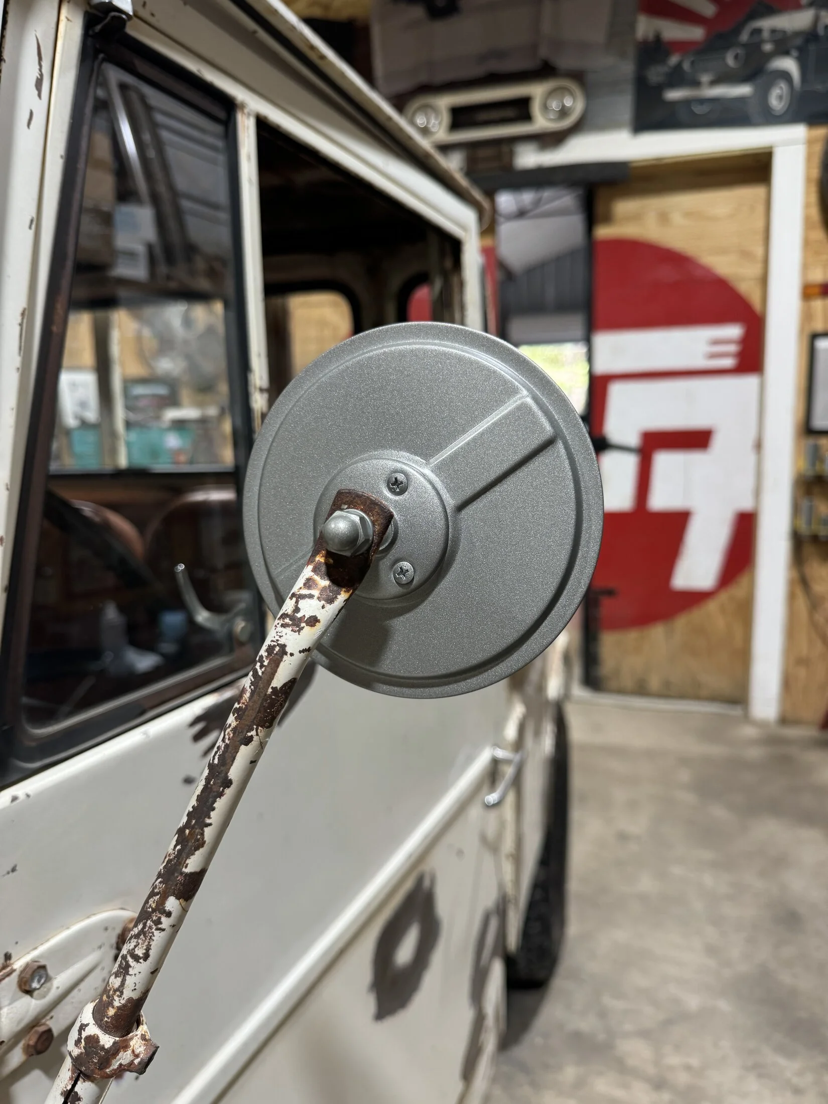

New mirror head

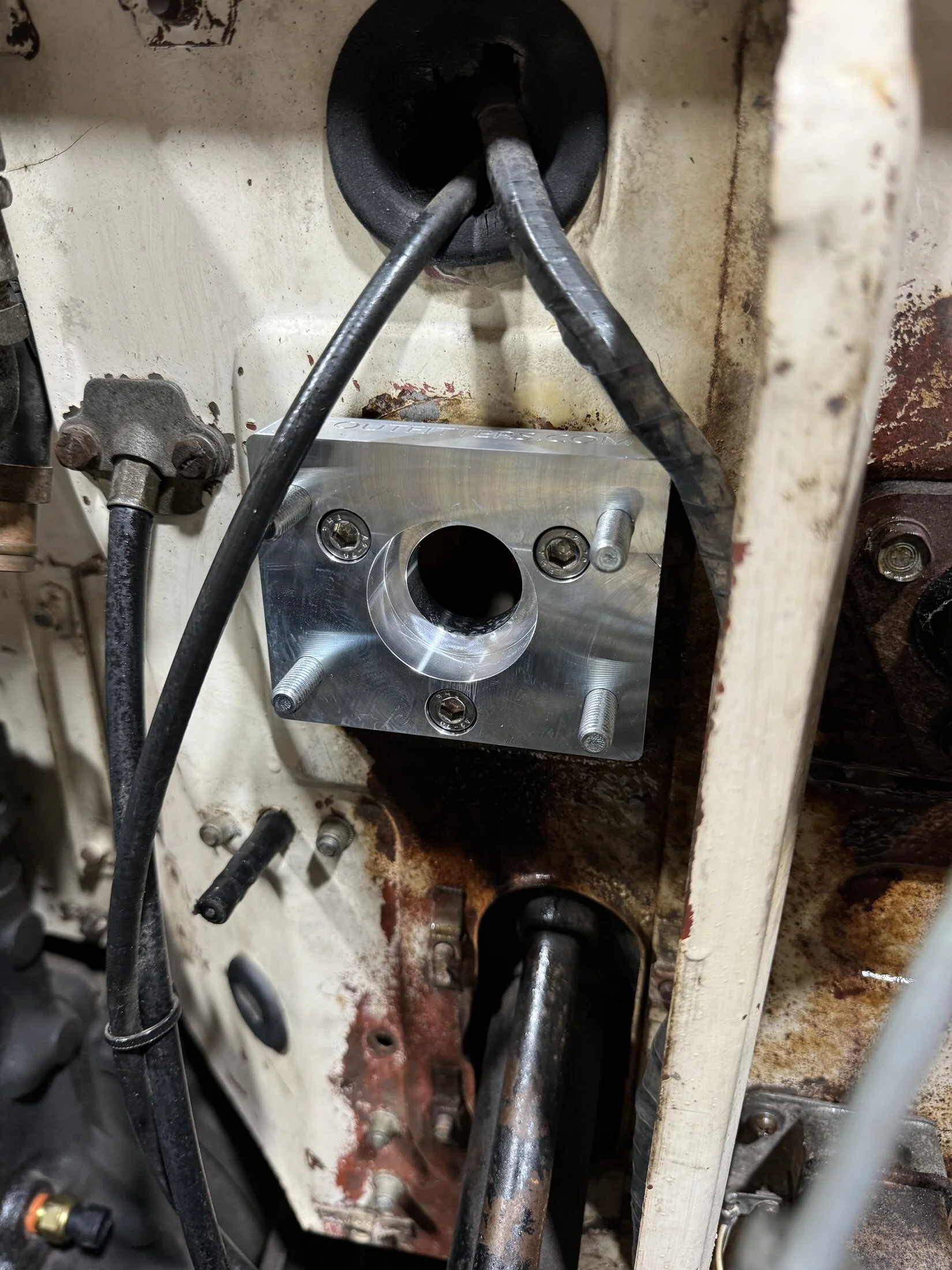

JTOutfitters adapter for 80 series master

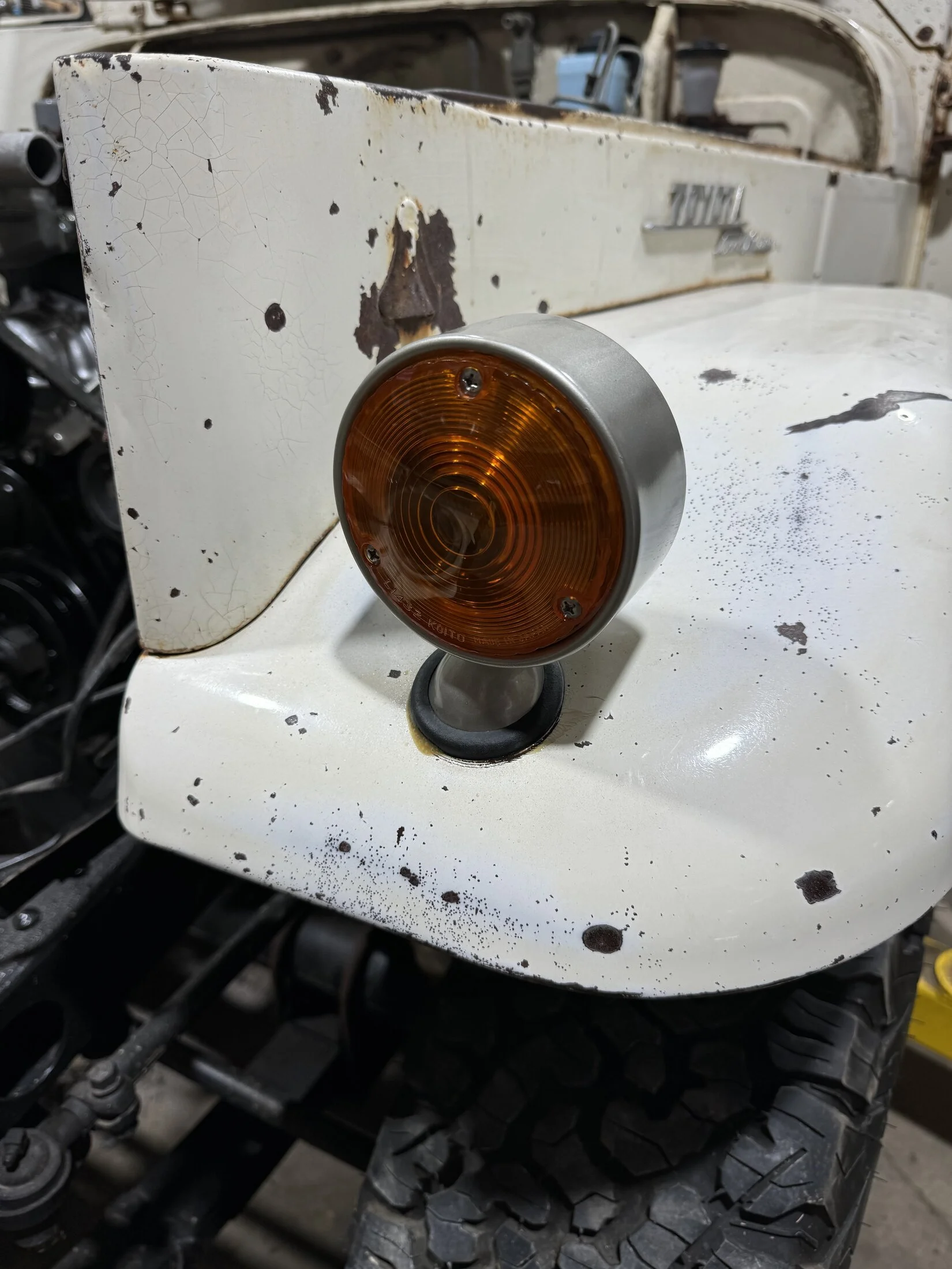

Turn signals
Master installed
Got to work up a rod. The one that was in here was butchered for that booster kit

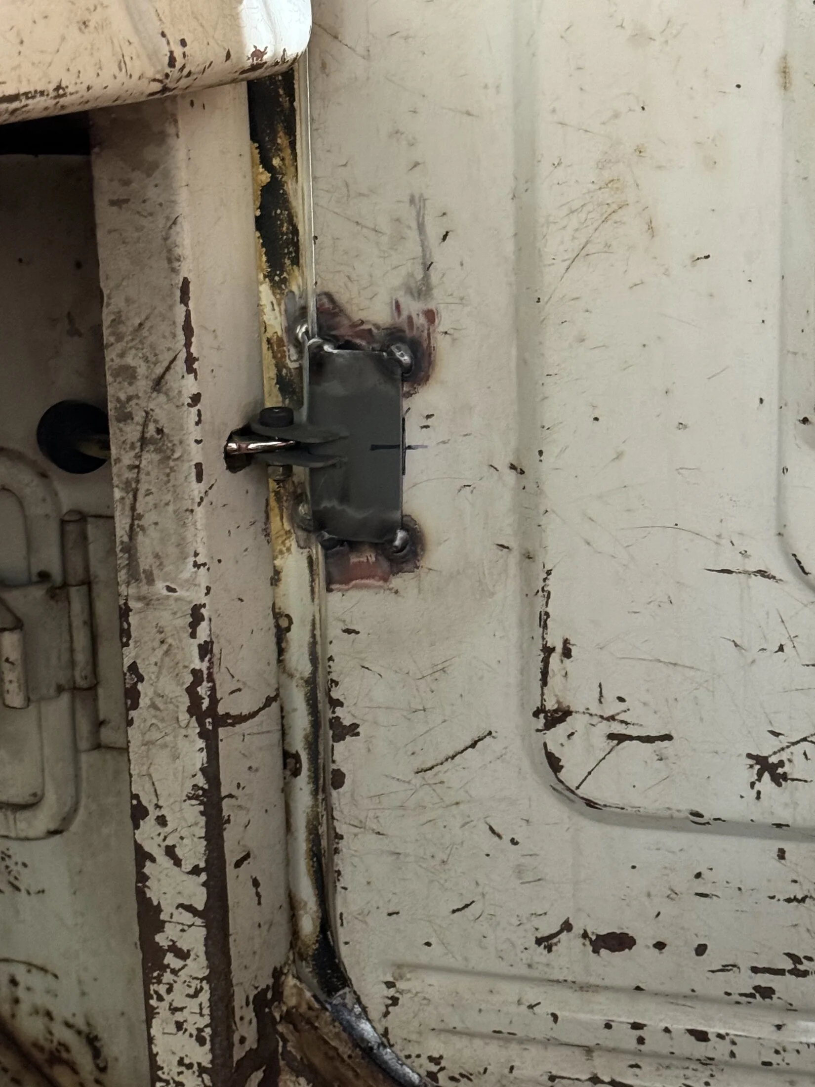

The Wizard came over and welded in these cool plates from SOR.

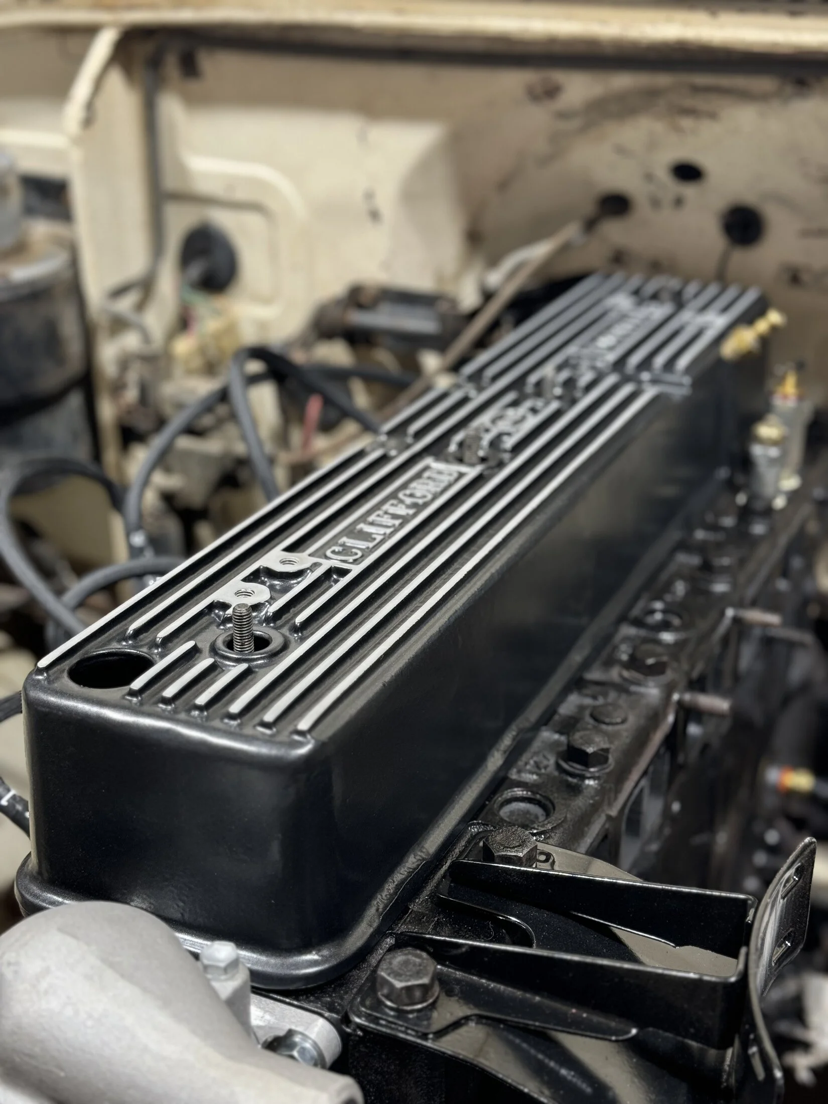

Im a homer for OEM stuff but also love period correct things like Con-Ferr and such

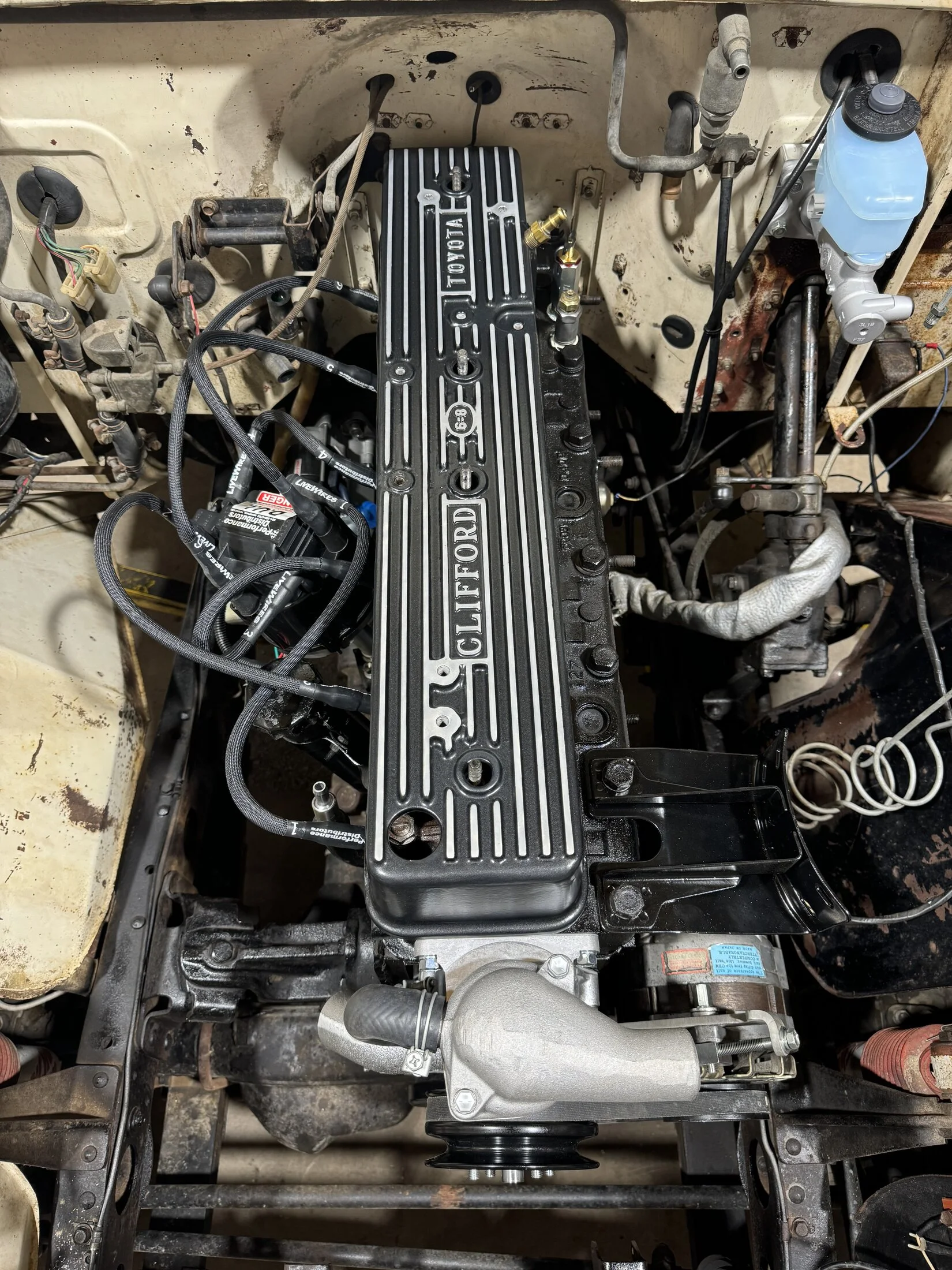

This Clifford cover was found by @Cal40 and man it’s cool AF.
Just had it freshed up at PowderKeg….
I vote yes. What say you?
Is there a 45 left in this country you haven't worked on?
It’s pretty awesome I’ve been able to build so many rare trucks.
I am always a fan of vintage speed equipment! Not that it makes it any more horsepower, but it sure looks awesome!!

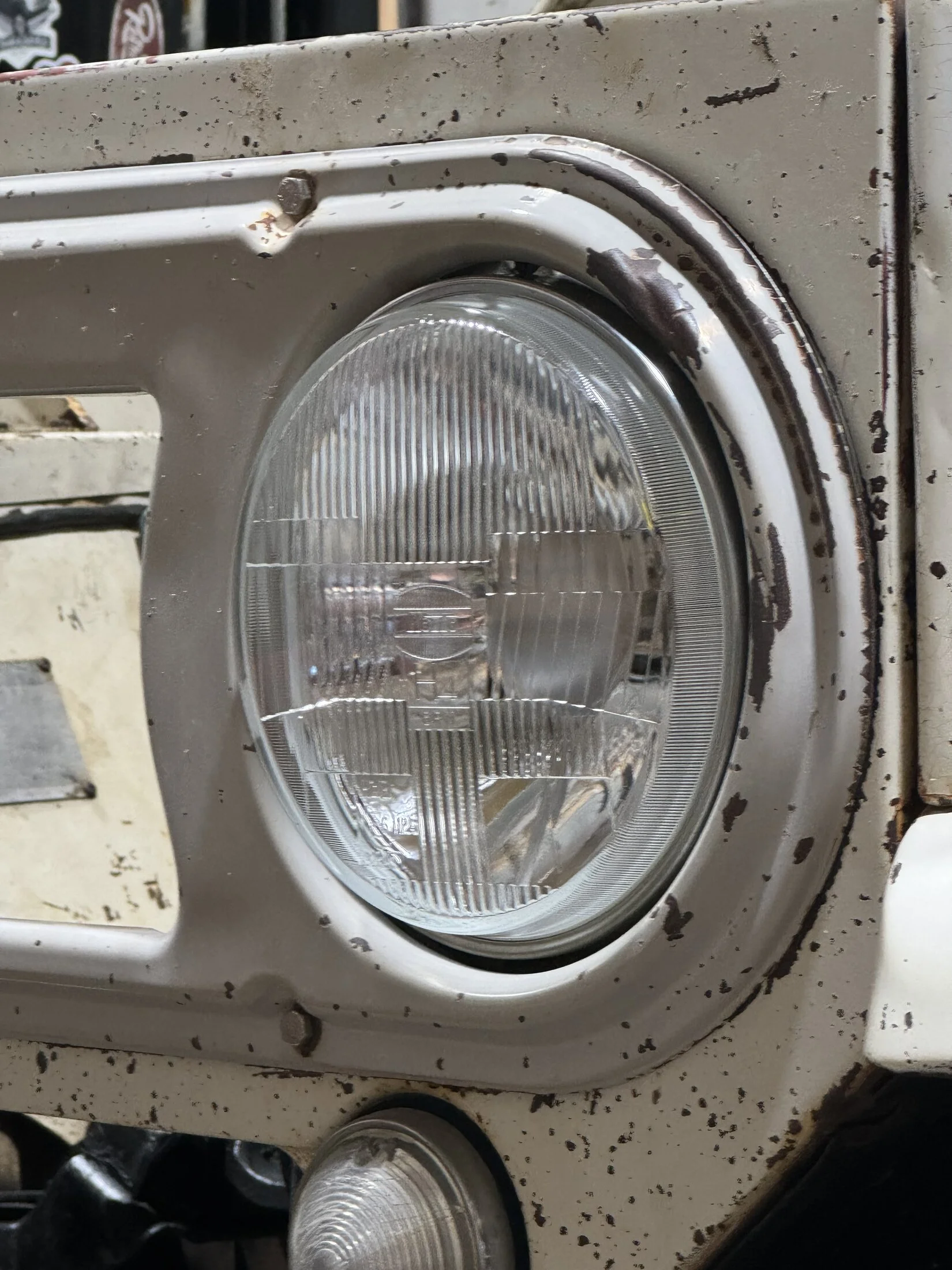

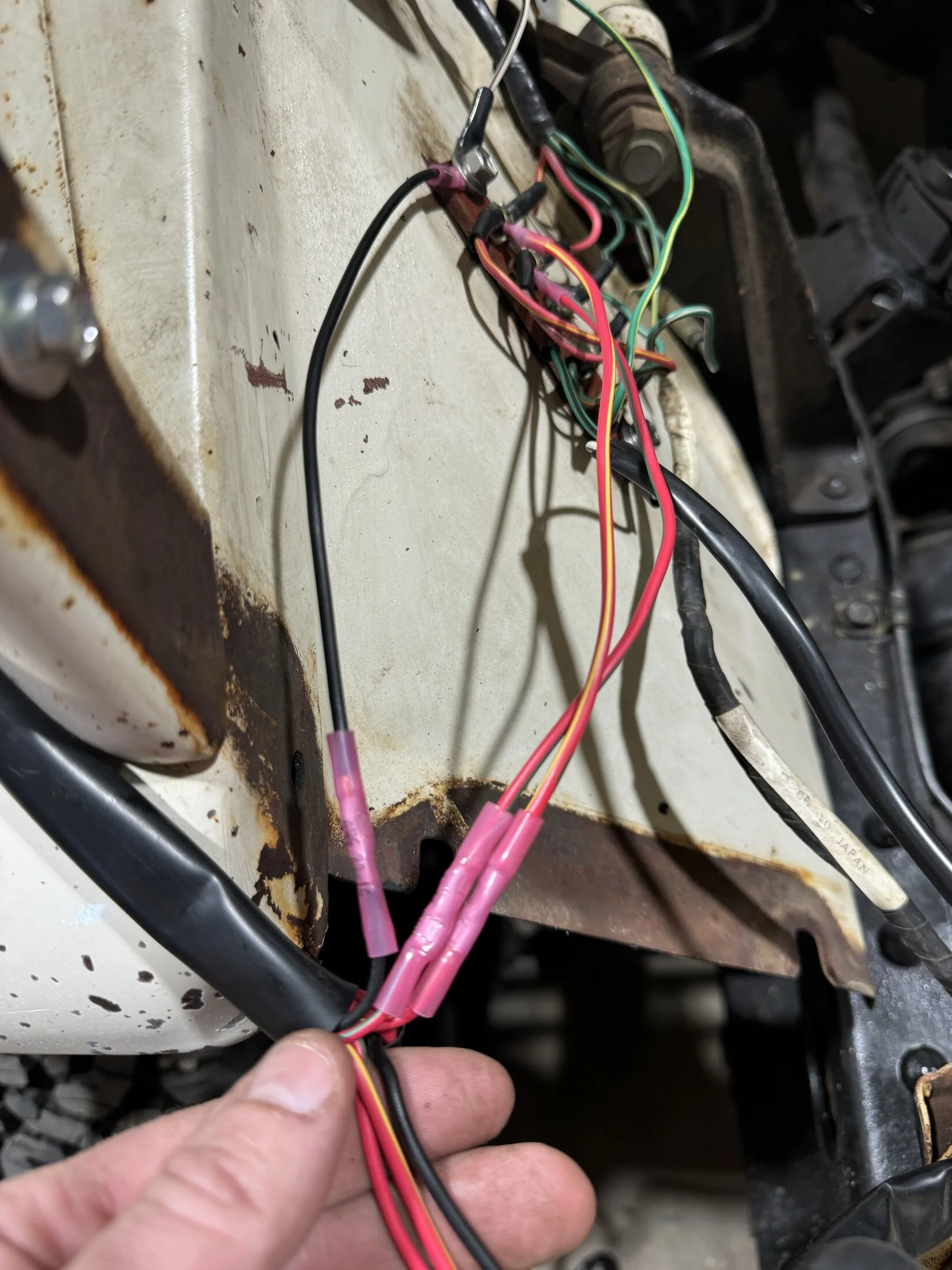

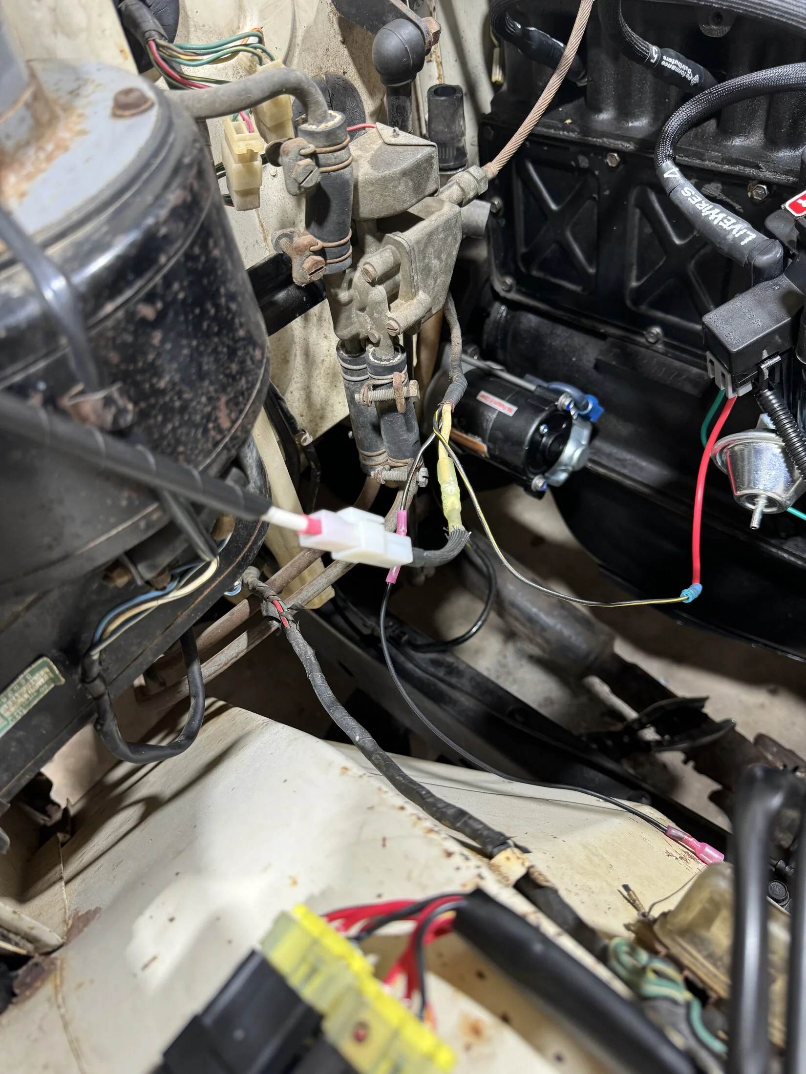

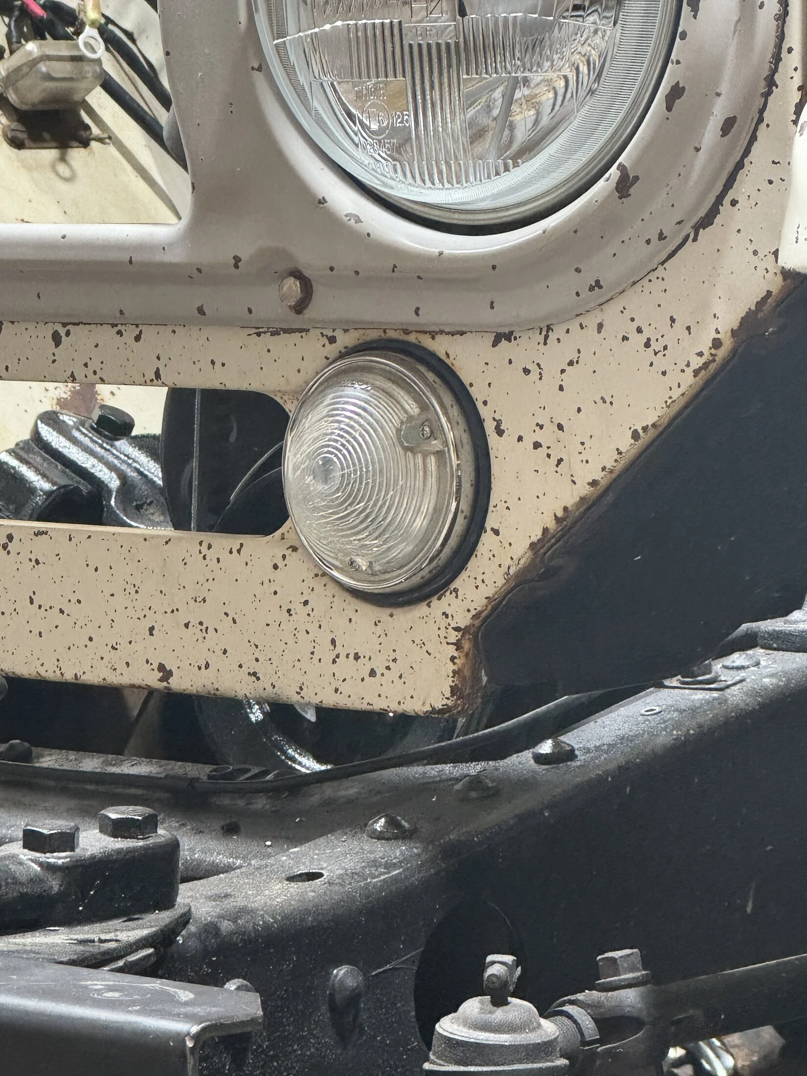

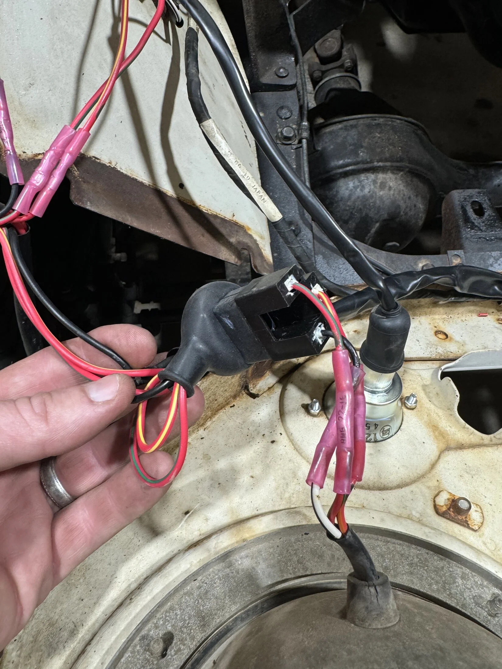

The new grill lights came in. I swapped in the old white lenses onto the new lights. The old ones had wires hanging off the back

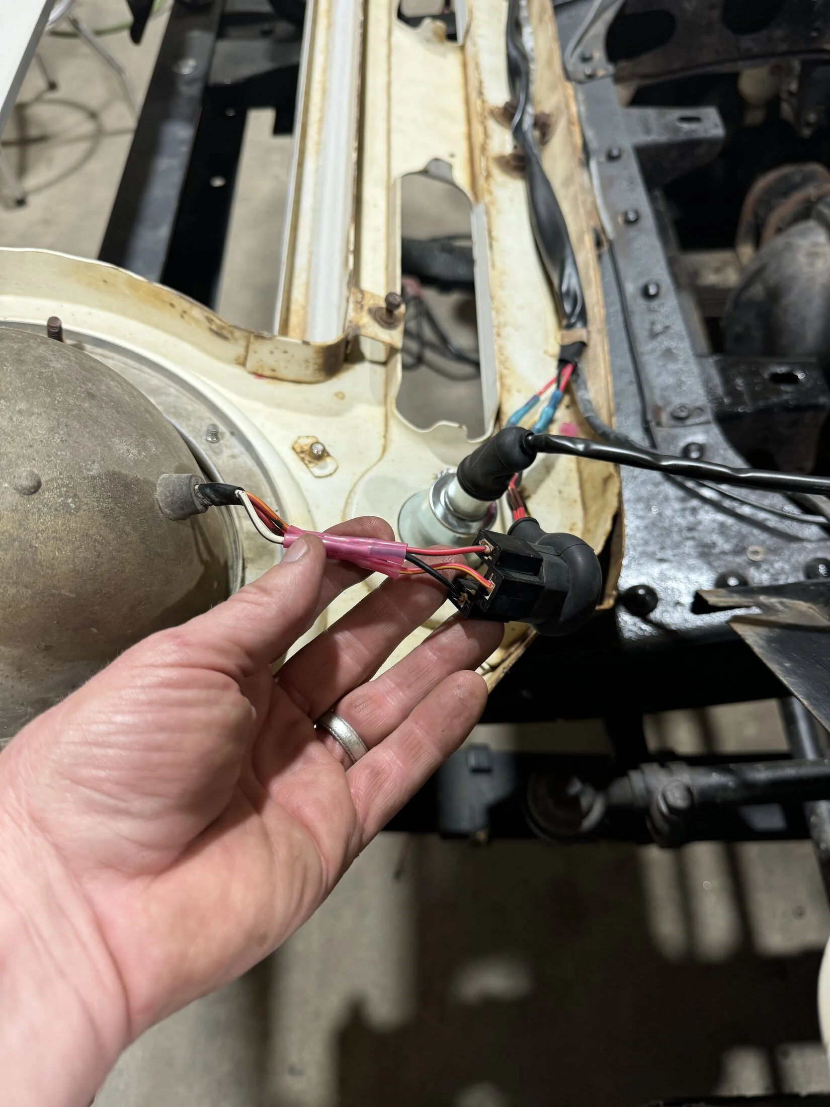

While I was wiring them up I decided to go ahead and wire in the H4 light harness.
If you have the round light covers this is how I do it.
I add in a Male plug on the drivers side and then shorten that harness. You need a spare male plug. Coolerman has them.
Passenger side you can use the one that’s in the harness and attach it to the wires coming out of the light cover
Then where you cut out the male plug you use some of the wires you cut out of the extra loom and wire it into the fender junction
These early trucks did not come with a Fusable link so I get them from Coolerman and add them. Cut out a couple of scotch locks someone had installed for dissy and starter wires. I’ll loom those loose wires later

I was actually wondering the other day how to accomplish this, did the light upgrade on my '74 40 and really want to do it on the '67 45 but have the round covers.
Might look into that fusible link addition too.

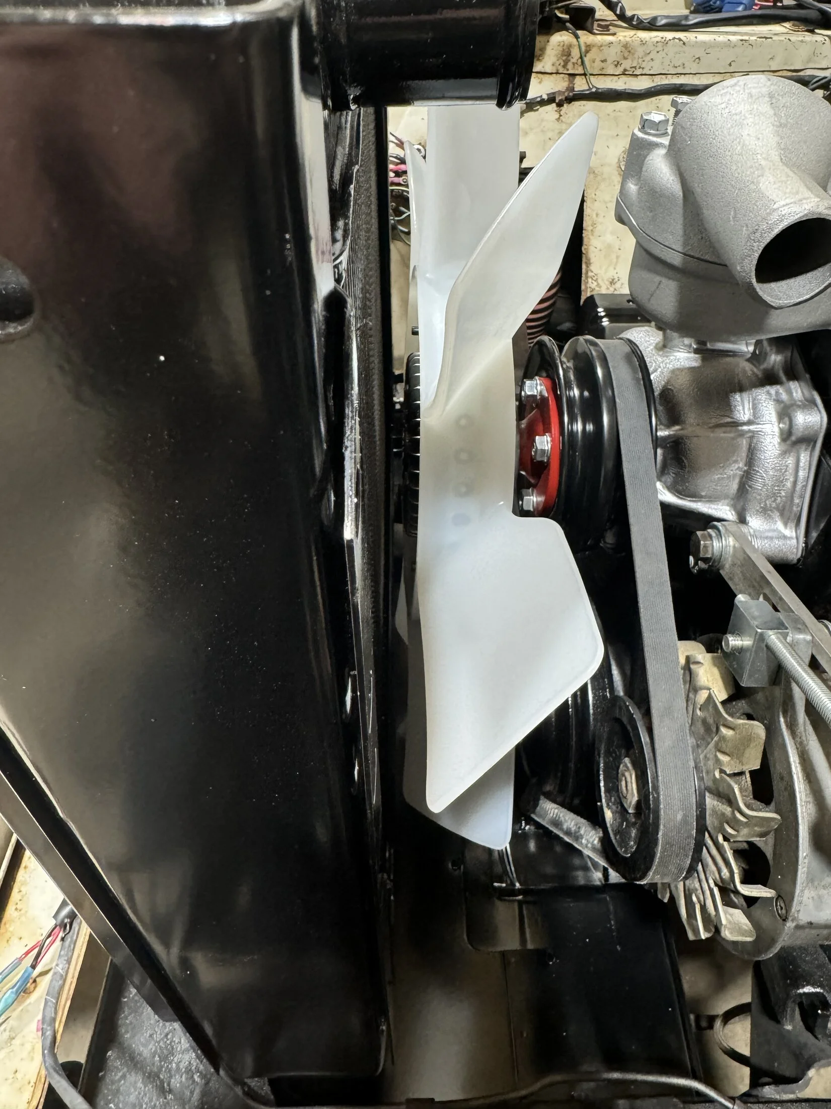

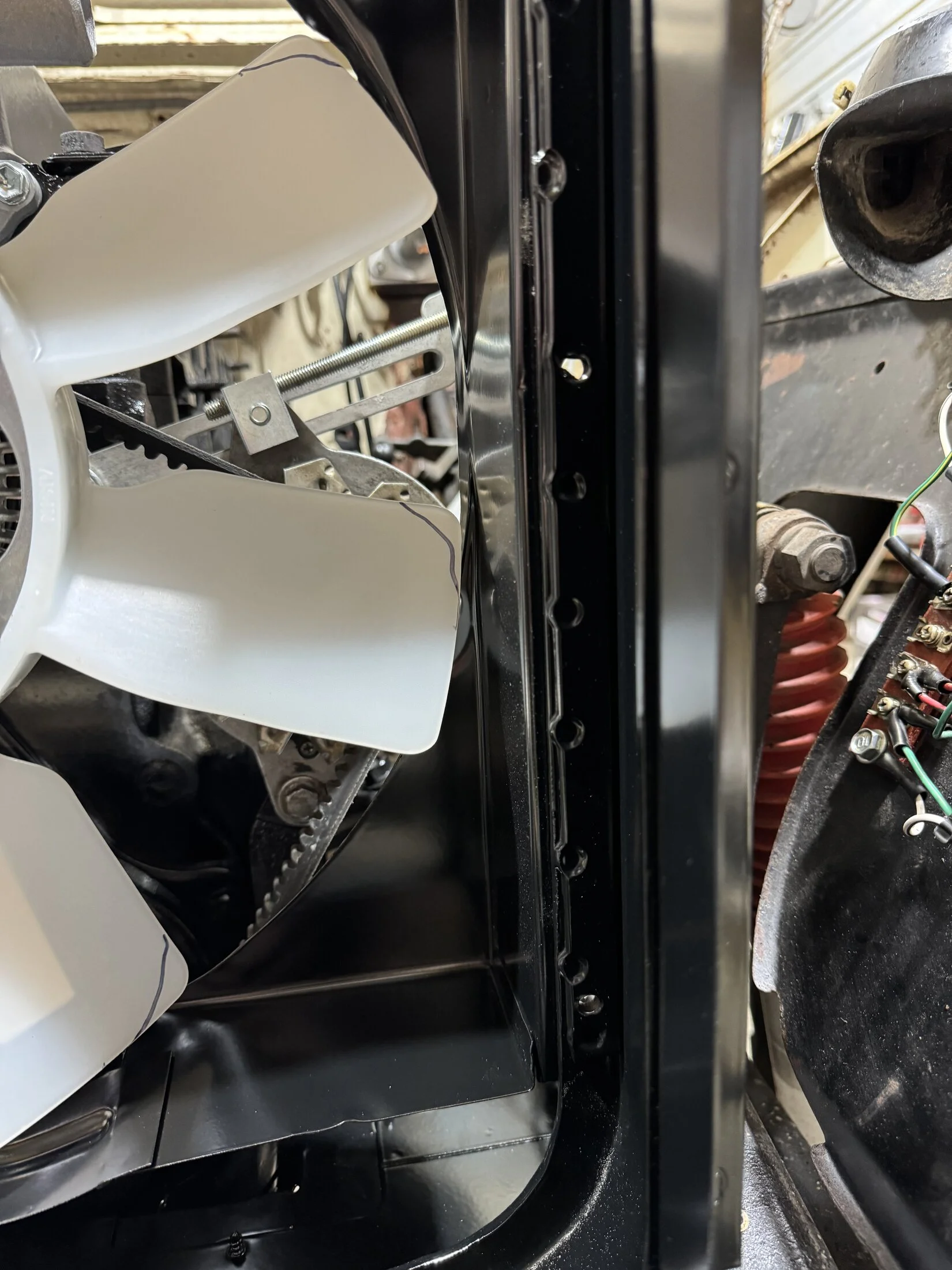

This is the proper fan if you want to add a 2F water pump and fan clutch and keep the F style fan shroud.
This fan cleared without grinding but it was close so I took a little off the ends
I have about 1” between the front of the fan and the radiator
