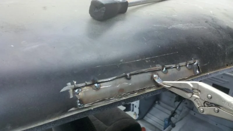

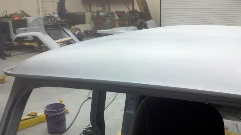

Three hours to put in two patches in the roof. The second one was some pin holes when I started and was about 5 inches long when I finished. Total of about a foot of roof line patched. Hopefully not too much more than double that left.
I flanged three sides of the patches and slid it in from inside. There was no way to get a copper backing plate behind the weld so I wanted to have a flange to back up the weld. My bead roller makes pretty good flanges.

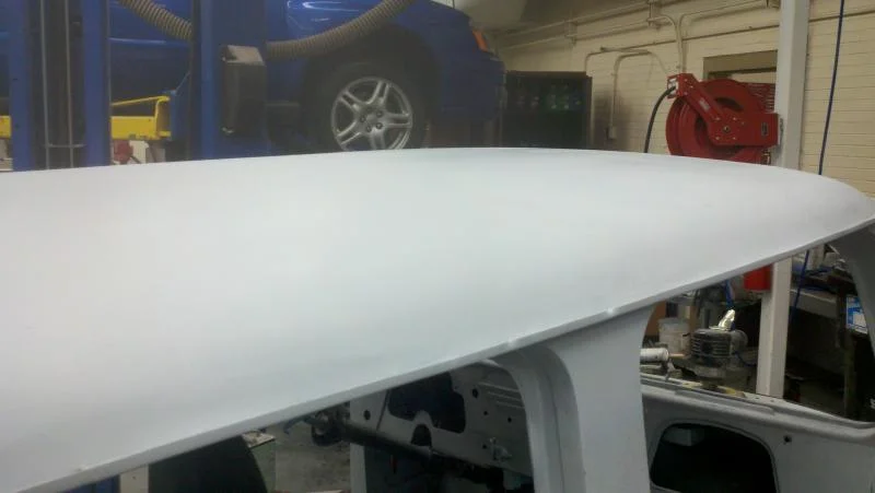

About four more feet of roof patch, but it's all done.
The studs work pretty well to pull the patches into place and follow the curves in the roof.
I pulled the body off so I could do the roof standing on the ground. I also needed to get the part above the w/s. It would have been a giant PIA with the motor in the way. Got the roof all cleaned up and sealed too.

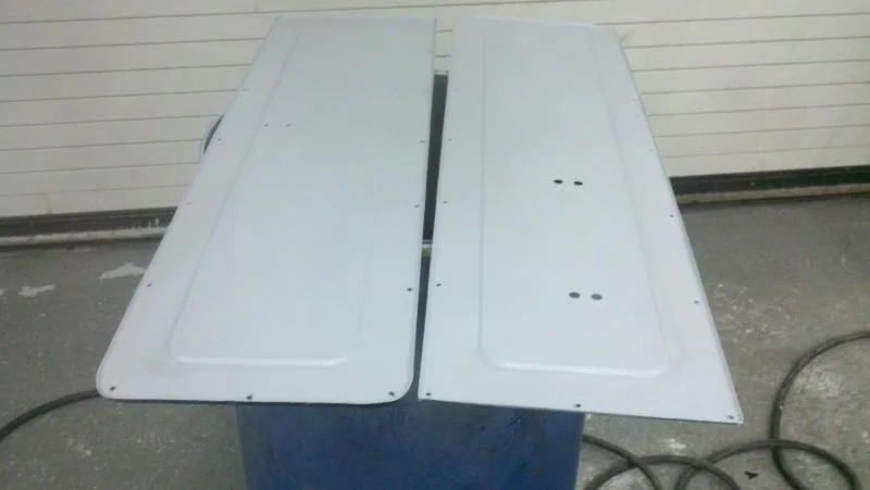

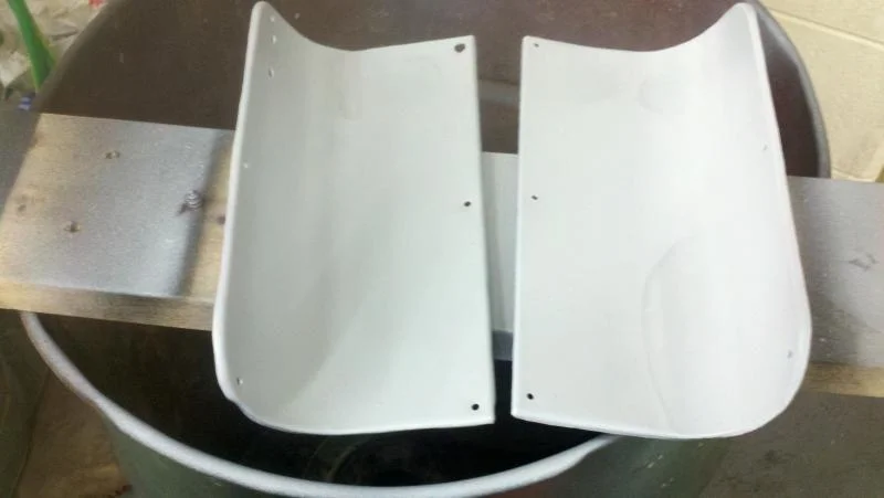

The inner panels were bare metal, but were all surface rusted, so they all got sanded down.
The tailgate panel got all the big dents hammered out.
Got all three primers on them.
Everything else got another 2-3 coats of high fill primer too.

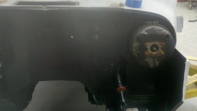

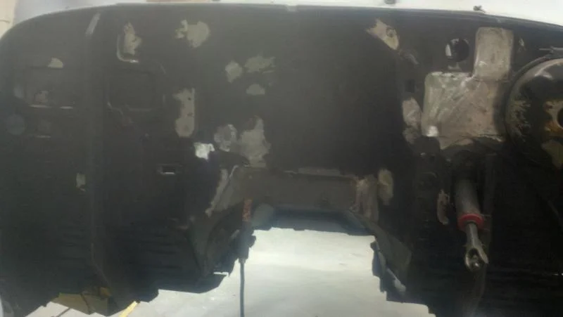

Cut out the holes in the fire wall. I couldn't decide if I wanted to cut out everything to the left of the trans tunnel and make it flat or work with the stock beads and fill a jillion holes. I ended up with a combination of the two.
I hit the bead with a flap wheel so I could see what I was dealing with. I cut along the edge of the bead and welded in a thick piece of steel. So I still have the ridge on the outside, but the inside of the oval shape is smooth. The upper arm was cut out and a new piece welded in too. It was bent and holey. The new steel is plenty thick to support the booster and I can choose where I want to put it now with everything flat. The plan is to put it on the clutch pedal side so the booster clears the intake of the 1FZ.
The other holes I'll just end up welding up, I guess.

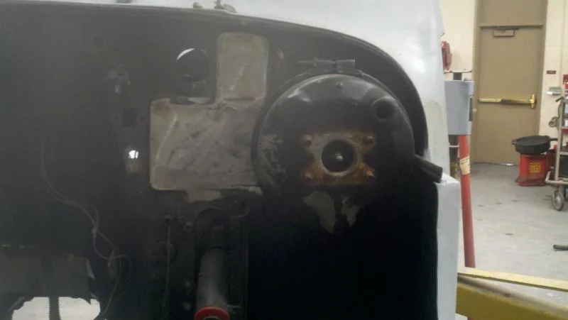

I cut the booster mounting plate off of the pedal assembly and moved it over to the clutch side, then welded it back on where the booster would line up right with the clutch pedal.
Bolted the hanger in place so I could locate the holes. marked them and drilled them.
Found the booster in my boxes of parts and lined it all up. Looks like it's going to work.
Then I stripped the firewall from what was left; the VIN plate and wiring and such.
I had a bunch of holes to fill including some big ones. For those I welded a washer in the hole and then filled the washer.
There was a bunch of holes to be filled.
Painted the firewall

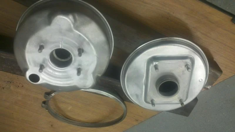

The booster was ugly so I disassembled it, sandblasted it, polished it with the wire wheel.
I powdercoated it with clear, but baked it at too high of a temp which yellows the clear and makes it look pretty cool, more like the zinc coating. Unfortunately my phone didn't save the pic for some reason. I bought a camera just for this build and haven't been able to find it for the past couple of weeks.
Sandblasted the master as well, but again no pic.
I didn't rebuild it with any new parts. It worked OK and I don't know if parts are available. I just disassembled it to get the canister to bare metal to sandblast and powdercoat it. It's pretty easy. The big clamp around the outside unbolts. I put it in a vise in case the spring was really tight, but it's not really that bad. The diaphragm and air valve are an assembly and don't have to come apart. The front and rear seals are held in place with a push in star ring.
The whole process including powdercoating and baking took less than an hour.
