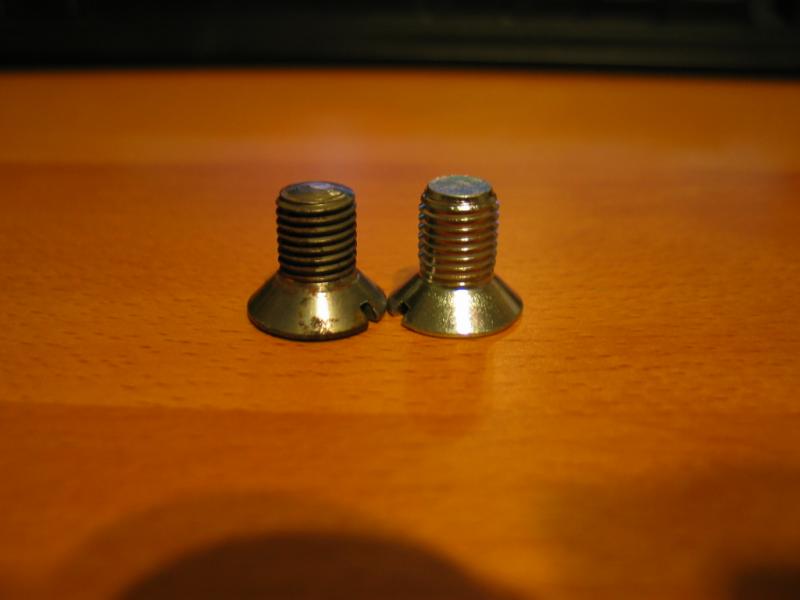

FYI: Check the length and fit of the torx screws folks recommend for the timing cover plate...
Now that I am working on sticking the cam in, I was in the test fit mode, to figure out what screws went where, so I didnt ruin the OEM toyota timing cover backing plate gasket I use in place of the Fel-pro one.
As I was test fitting the torx screws I noticed they were tight, but the plate was not. So I backed one out thinking I might have something in the hole, or worse cross threaded... neither was the case.
So I compared the original flat tipped screw to the new torx screw, and discovered the torx screw was about 1-1.25mm longer and lacked the slightly convex point of the original, and I think that was causing it to bind in the block before fully clamping the gasket and plate.
Just something to check, at least with early blocks, as I am sure tapped depth varies from block to block. The timing plate would leak like crazy if you didnt have it fully clamped to the block since the oiling passage to the cam gear squirter is sealed by the gasket.

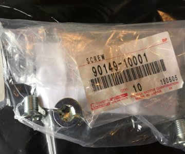

Where did you get those torx screws?
